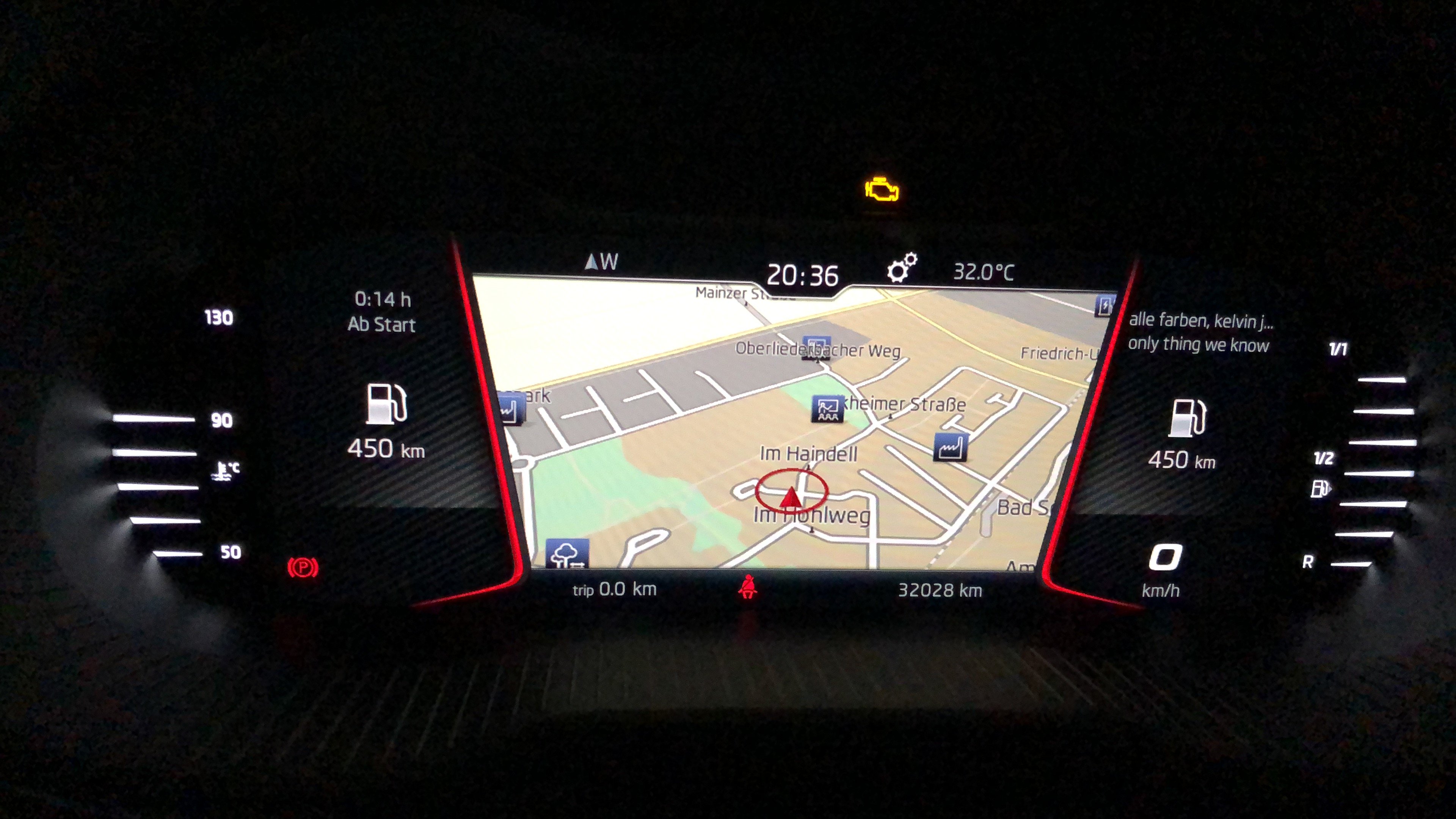

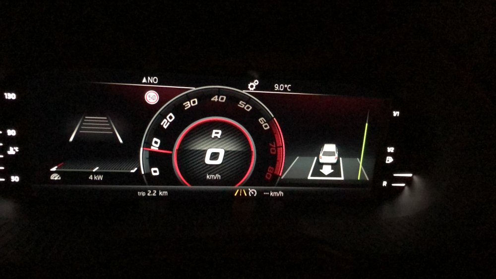

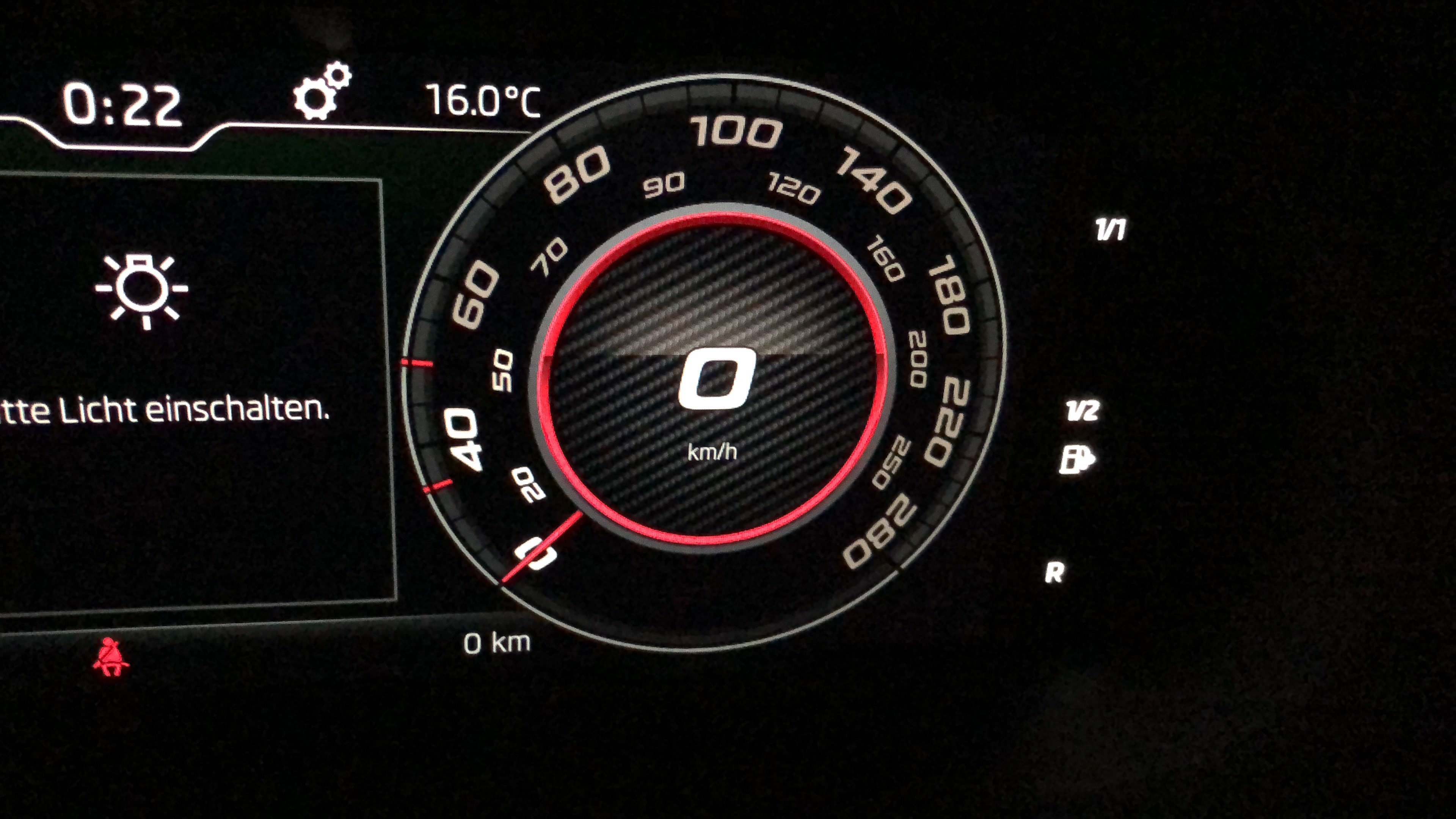

Hi there, sorry i had some problems with my account.
some new pictures:
I'll have it on my new car, I prefer digital displays to analogue ones, that's why I chose the option.
i don't miss the analog cluster too ;-)
that looks like an expensive retrofit. Im assuming you need a specific headunit?
Yes, MY18 Amundsen or Columbus with fibre optic cable on specific firmwares and a new CAN Gateway for the cluster. The radio swap isn’t much more expensive/complex than a MIB2 retrofit and the cluster itself isn’t hard to install but to get the personalisation on the cluster you need an FL BCM and hundreds of lines of coding. It’s a cool toy but I’m not going to go through swapping the radio again unless I’m really stuck for a replacement car now I can’t spec a new 245 to my requirements. I’m not sure I really want a Superb.

Honestly I think Škoda could've done it better and it sucks! I used to love Škoda, but since I started doing car reviews, testing other cars I feel like Škoda could do much better!
It is not the worst, but certainly not the best.
Just look at Audi virtual cockpit or Mercedes. That GUI is great, this Škoda is unimaginative and boring. It's copy of VW GUI. And those lights for temperature and fuel tank are awful!
On other hand, since when is alcantara available on steering wheel? I was mentioning this to Škoda to add this option on RS. :)
Can you put another picture where we can see the whole steering wheel? Thanks!
EDIT: ok I see this is retrofit.
There is still hope Škoda will do this better for Octavia.
