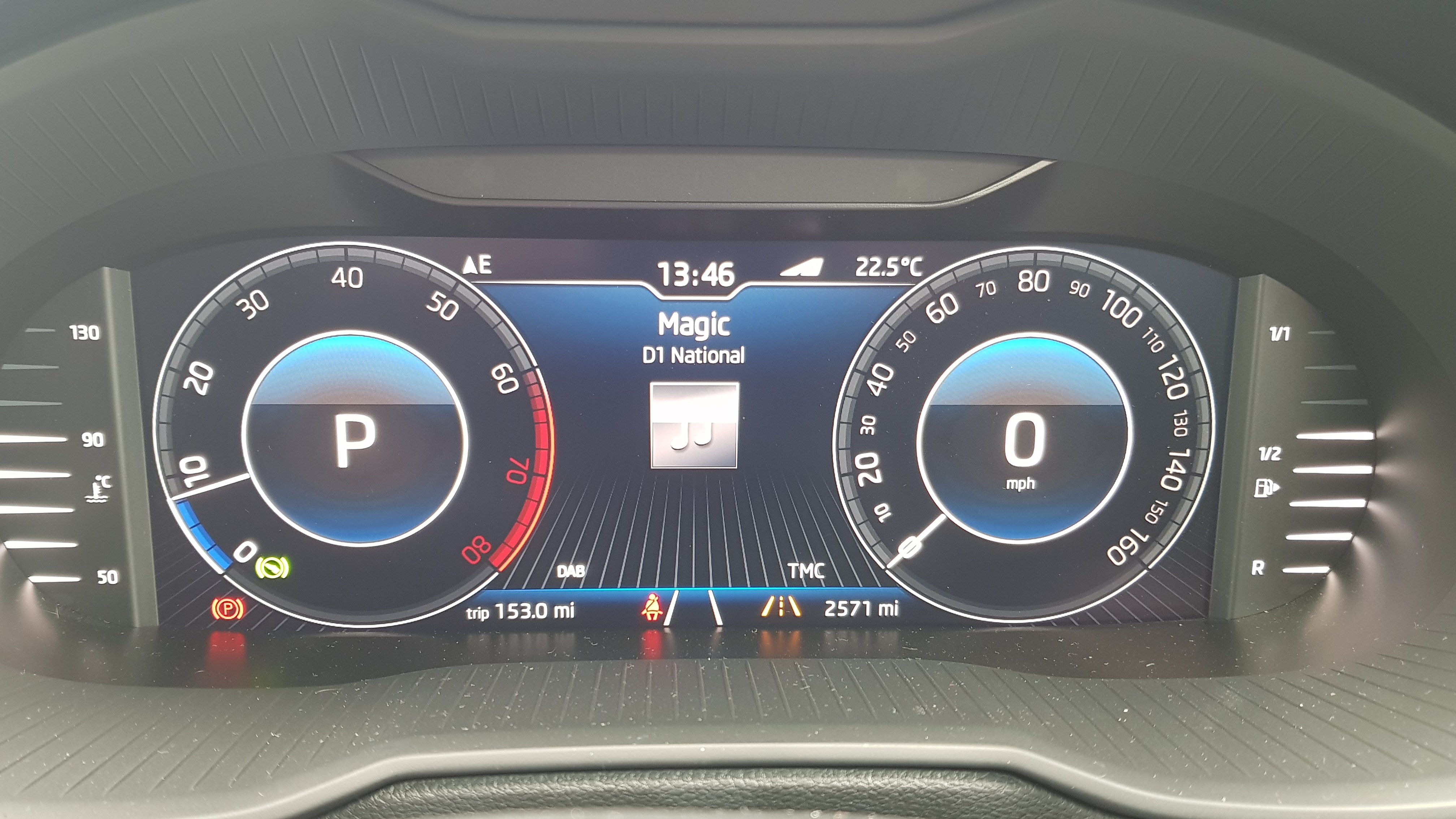

I was having a look in the dashboard settings of the VC via OBD11 and found an adaptation regarding resolutions.
Resolution 1, 2 & 3. The default seems to be resolution 3.

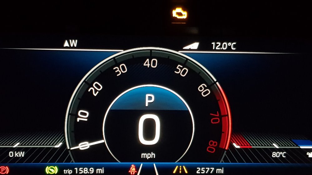

I have compiled a couple for the Octavia vRS Mk3 group site. 10 mph increments, vRS skin and speedo end value adjustment. That’s about it as the Sport view is already enabled.

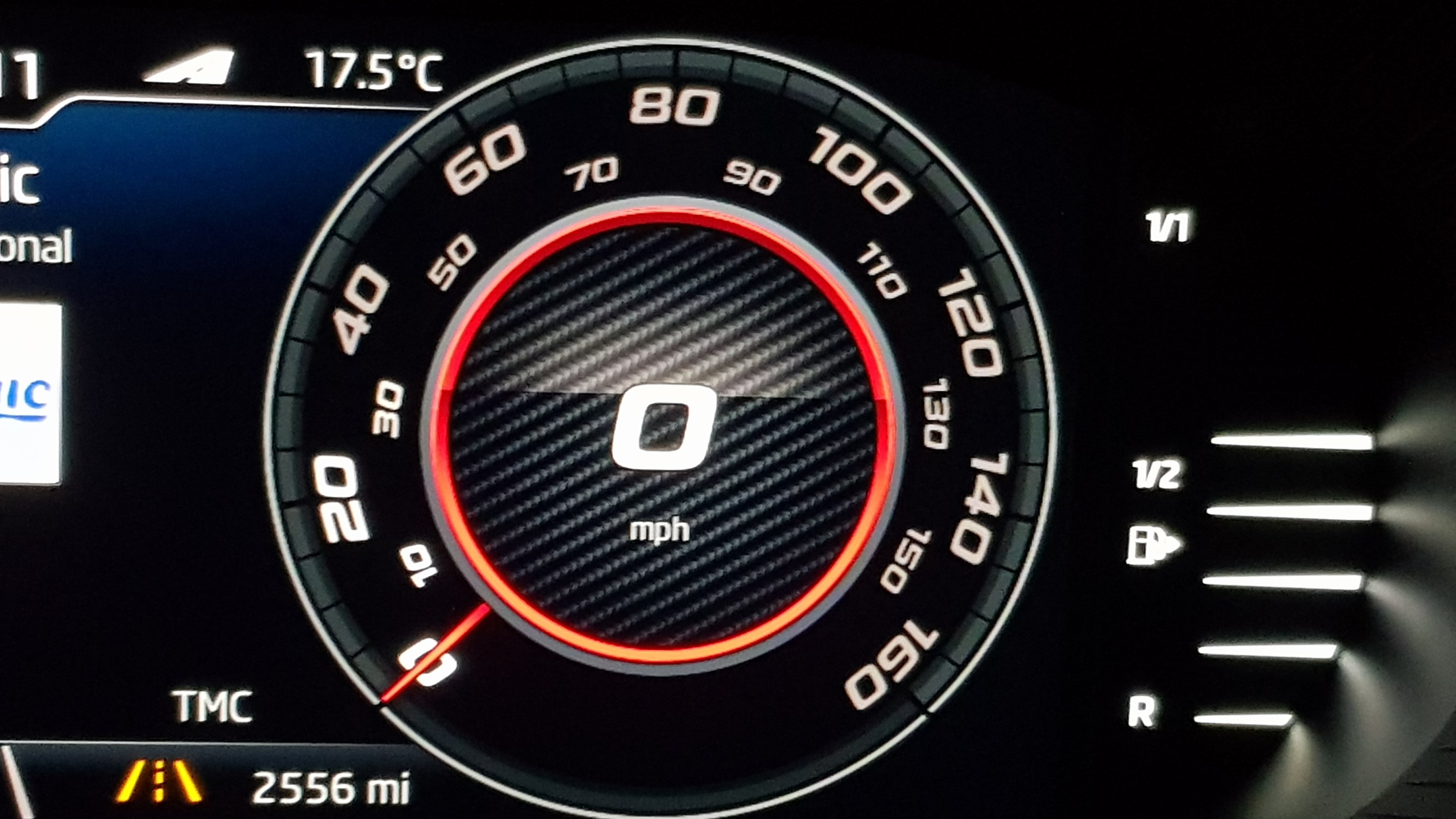

That looks great.
Is the carbon look centre dials standard or added? I haven’t noticed it on mine. 🧐
Cheers.
The carbon dials are part of the vRS skin :)
There has been a slight change in the way you get the final value on the speedometer and you have to use:
Tachometer final value
Again make a note of the current value BEFORE you make any changes.
There are also now just two variants of design of speedometer. RS and Standard (Non RS).
Edited by TheWanderer
Cheers guys.
Just sorted the above.
Went for option 4 10mph increments and 160mph top speed.
It was the tachometer final value as you said Wanderer.

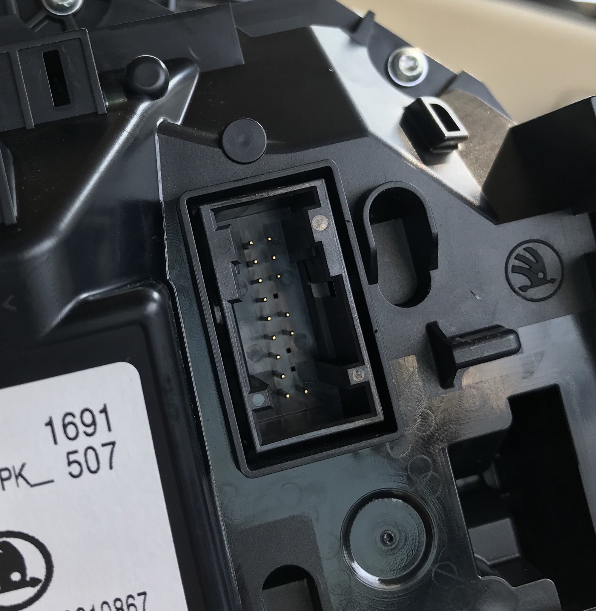

I found a place to do the coding but they seem abit afraid the connection from the analogue dials won’t be the same as to power the VC screen. I take it everything just plugins in and the only new addition is the optical cable to display the nav?
is the below VC connection the same on Superb with analogue with matrix screen? imageproxy.php?img=&key=00da0a65627968c1
