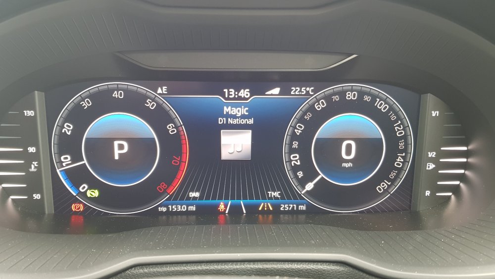

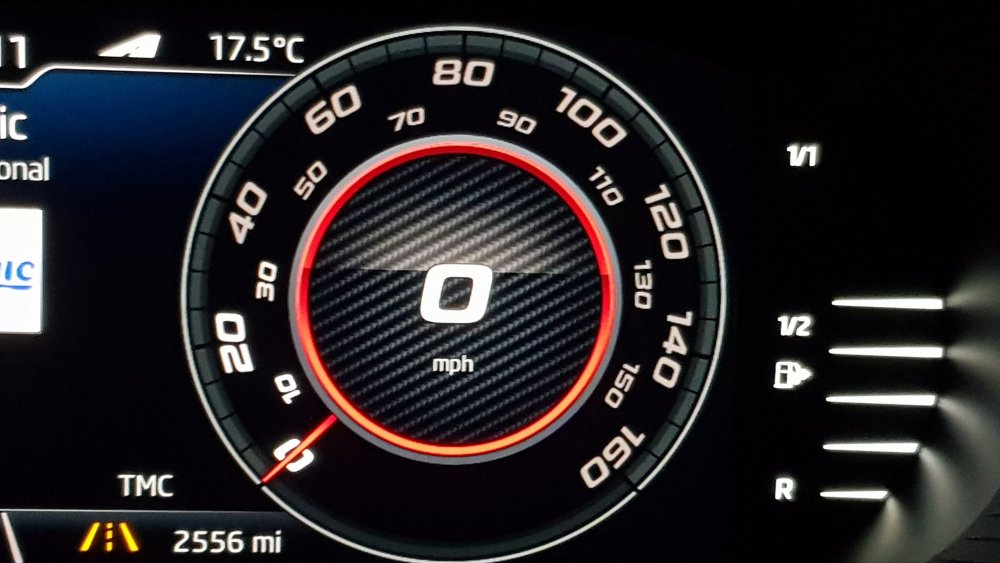

On 01/11/2019 at 00:39, aki78 said:
Not sure if it's been mentioned before but it's possible to activate album cover, radio station & call picture icons:
5F  /  Adaptations
ENG122230-ENG122341-Dashboard_Display_Configuration-coverart - 'OFF' to 'On'
ENG122230-ENG122342-Dashboard_Display_Configuration-stationart - 'OFF' to 'On'
ENG122230-ENG122343-Dashboard_Display_Configuration-call_picture - 'OFF' to 'On' (needs 'Security Access' code 20103)
If coding not accepted change this first:
17  /  Adaptations
IDE13094-Tachometer end value - 'Version 0' to 'Version 4'
Some before and after pictures:
Anyone know is there any requirements for album art size so that it will be displayed on the VC?
I done this adaption, but it will not appear/show on the VC.
Thanks!
you need the optical cable, do you have it?
 Normal album art needs to be less than 500 x 500 IIRC.
There is a specific program that easily changes the size if you needed to further reduce it too.

20 minutes ago, aki78 said:
Here you go! This is my factory adaptation map & coding.
I didn't change the coding, only the 3 red marked adaptation channels I mentioned earlier.
When I (cold) start my car I have to wait cca. 5 seconds for the coverart picture to appear on the virtual cockpit but that's the only 'issue'.
SW:5Q0-035-840-C   HW:5Q0-035-840-C ---  Information Electr. --- SA: S12345
Component:MU-S--ER      H41 0475, Coding:037302000000000041110002000002002F020BE40120040003
IDE00001-Production mode,00 00 00 ,3
IDE00346-Summertime-automatic,Europe ,1
IDE00758-Base volume of telephone,50 %,1
IDE00759-Base volume of speech output,50 %,1
IDE00760-Microphone sensitivity,0 dB,1
IDE00769-Number 1 for Info call,FF FF FF FF FF FF FF FF FF FF FF FF FF FF FF FF FF FF FF FF FF FF FF ,23
IDE00770-Number 1 for roadside assistance,FF FF FF FF FF FF FF FF FF FF FF FF FF FF FF FF FF FF FF FF FF FF FF ,23
IDE00820-ENG117828-Activating and deactivating all development messages-Infotainment_CAN_Messages,OFF ,1
IDE00820-ENG117829-Activating and deactivating all development messages-MIB_CAN_Messages,OFF ,1
IDE01996-MAS00076-Installation list: specified installations-Instrument cluster control module,Yes ,3
IDE01996-MAS00839-Installation list: specified installations-TV Tuner,No ,3
IDE01996-MAS00844-Installation list: specified installations-Radio,No ,3
IDE01996-MAS00847-Installation list: specified installations-Digital Sound System Control Module,Yes ,3

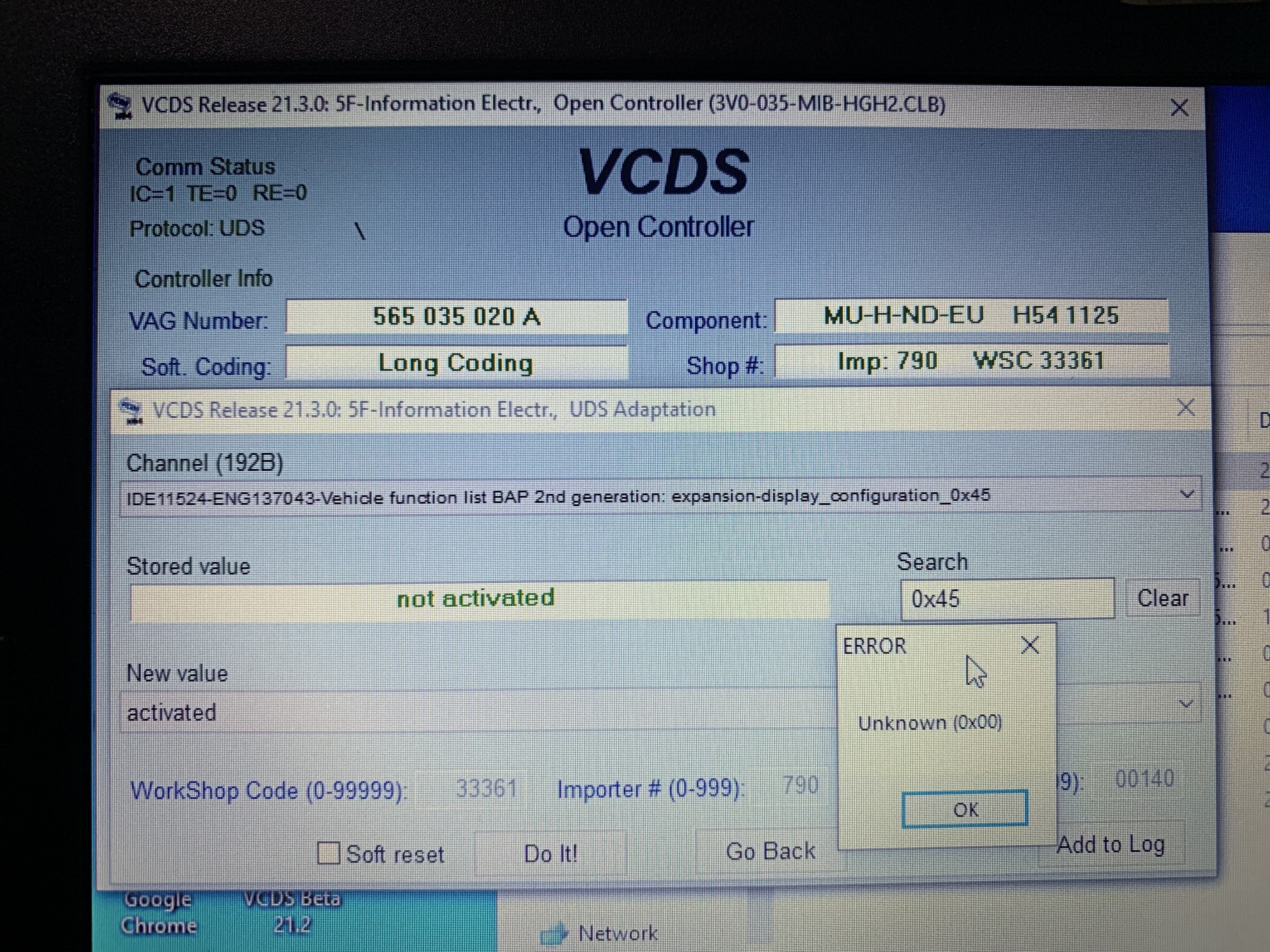

Did anyone find a fix for this, this is where my issue lies on IDE11524-ENG137043 I can’t activate it
The fix is a MIB2.5 radio :)
I have a mib 2.5, just keep getting this error
What VCDS cable are you using? If it's not a Hex-v2 that might cause issues...?
Might be worth contacting Rosstech for advice :)
