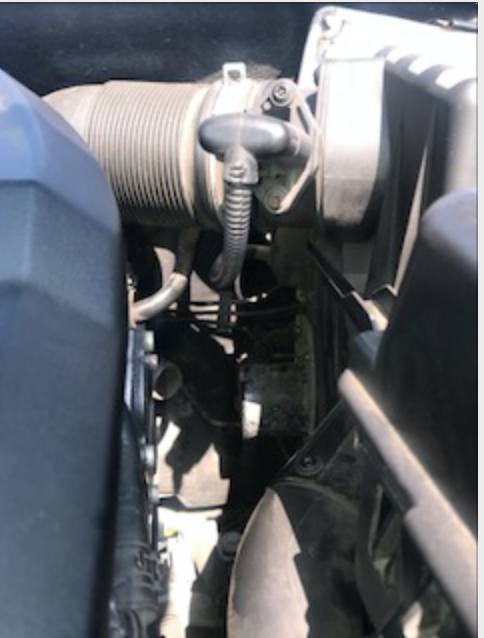

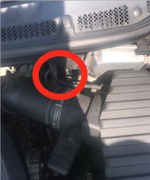

so looking from the top the connector will be here dig your arm down from behind the air intake just behind the MAF.

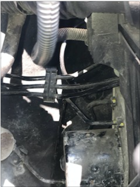

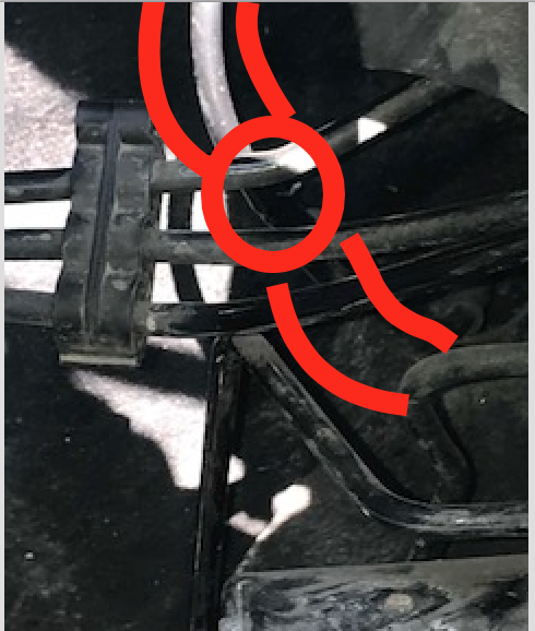

Then zooming in from the front of the block just below the maf sensor you will see 3 horizontal pipes fixed to the bilk head the washer pipe connection usually rests behind these pipes
Edited by Hmmbutterscotch
you can just see it resting behind on this shot like I said you need to get you arm right down and fish around to find the bit that comes from the reservoir
