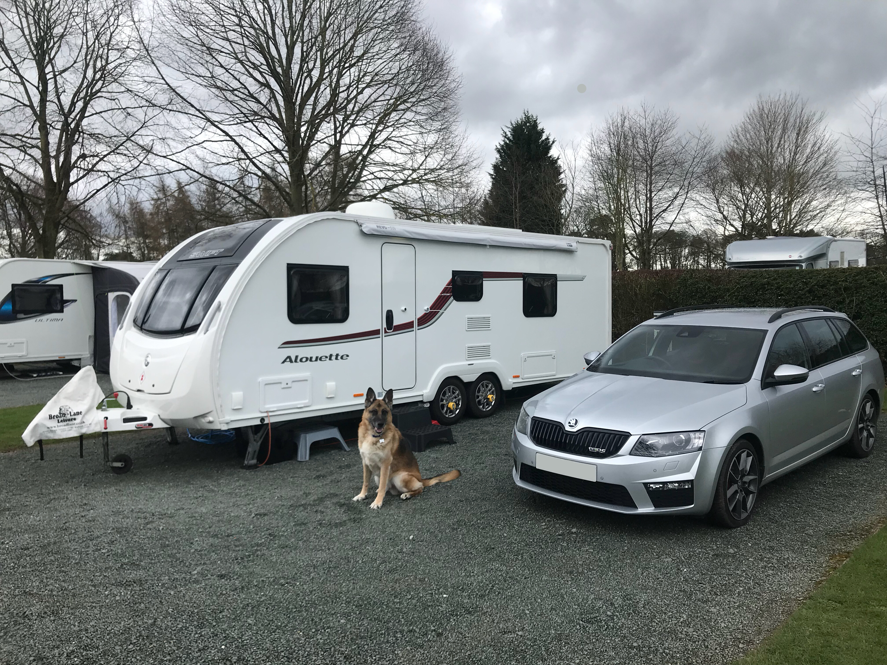

C4452E0F-EBA1-454B-B691-34618294C5BC.thumb.jpeg.17feec85a4e203e9aaa184060f69a3a6.jpegYes you can tow it no problem as long as your license allows.
Edited by Adcooper
What does that work out at? 106%?
Do you have a problem with nose weight?
Normally get on ok with the nose weights as now use a alko jockey wheel with the scales. Actually easier after changing to a twin axle.
No idea how to work out % but within the 1800kg limit and tows better than our others (single axles up to 1500kg).
If I’m going some distance I do put some of the weight in the rear foot wells and back seats though to help with the weight balance.
I will say although legal it’s not my recommendation.
