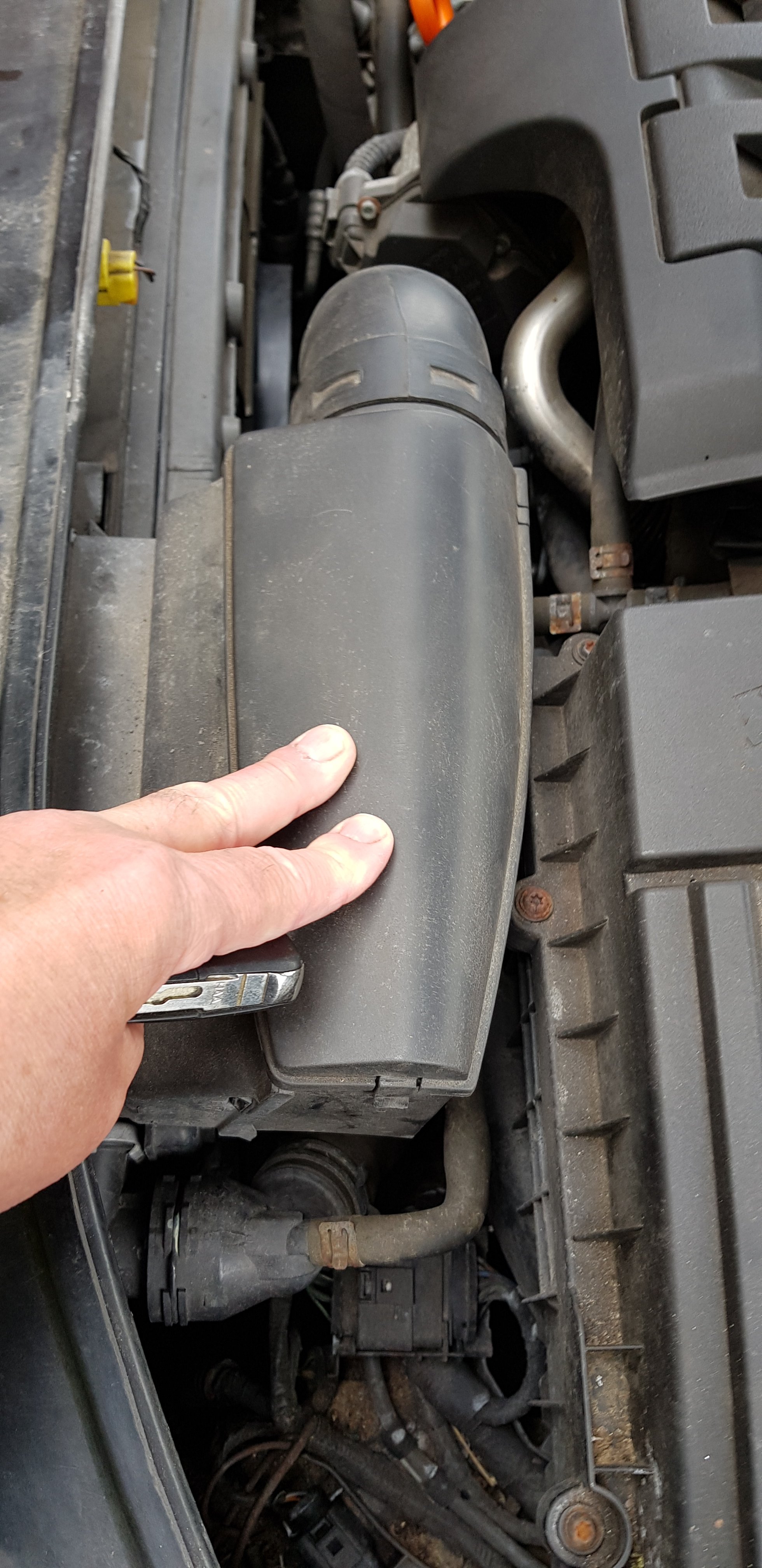

I`ve had what I`m thinking is a similar noise coming from the engine bay of my 2.0L CDR. It sounds like to me the exhaust has blown but after reading this thread I finally decided to investigate.
I found the noise I was getting is coming from a longish plastic box at the front of the engine bay. If I press down on it the noise goes away as per this Car noise.m4a file. I haven`t decided what to do about it yet but I`m glad its not an exhaust problem.
Edited by ashfan

That's the cold air intake plenum.
I have read comments somewhere - maybe not this forum - about a droning noise being due to vibration/resonance in the air intake. Putting "intake noise" into Search brought up quite a few comments on intake rattles and noise.
I was taking a look at that very part of the air intake last night. It does seem to be relatively loose and prone to vibration. Might also explain why it seems worse at speed (more input air turbulence)
Ashfan, how much pressure do you need to apply to the lid of the box for it to quiet down? Is it just the lid vibrating (so a cable tie might do it) or is it the whole box do you think?
Something in the air intake does 'feel' about right given the symptoms of the noise.

Ashfan, I just noticed your audio clip (thanks for that btw, top foruming). That sounds a lot like what I'm hearing. I'll take a look and report back.
Cheers,
iep
It seems to be the whole box thats making the noise. I mostly can hear it when the car is fast idling or pulling away so low revs. When I`m cruising on the motorway its silent, apart from the normal diesel engine noise.
I wedged something against the seat and pedal until the noise appeared. I didn`t need to apply much pressure to stop the vibration
Ta, I might try adding some tape to the rim of the box/lid and around where the output tube connects to make them a tighter fit. See if I can stop the vibrations that way.
iep
Took a look and while it 'moves' the box is well attached and damped and does not rattle or resonate. Tried moving through the rev range etc and no sign of any vibration from the air intake.
iep
