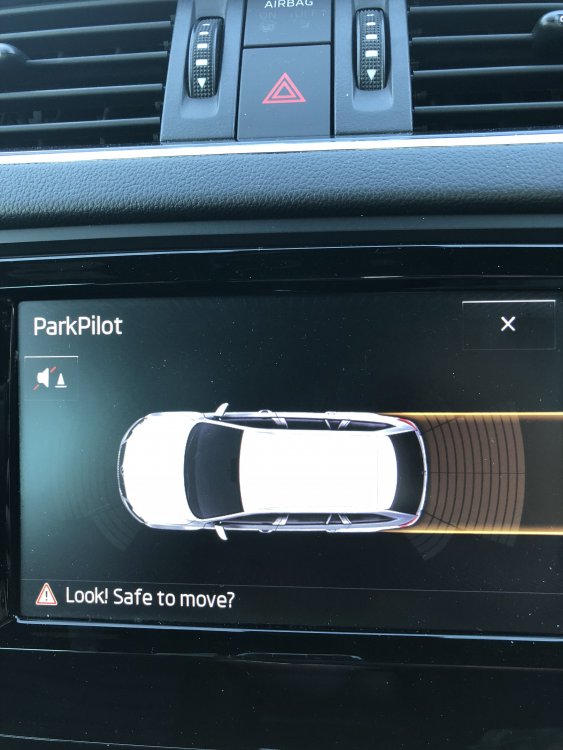

Does my park pilot park my car?
I have a 2016 vrs and have park pilot menu - I have read the instructions but makes no sense.
I have no rear ear camera but have front and rear parking sensors.
My reverse lights work when engage reveal as have read this has been an issue for some?
so my question is - do I have facility where car will do the parking if I do brake, accelerator and it does the steering?
ive tried for 15 minutes to get it to bloody park and it won’t.

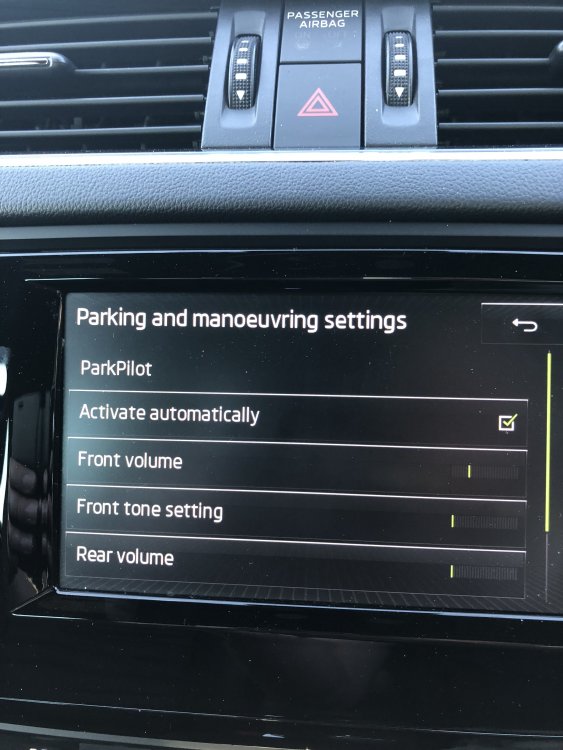

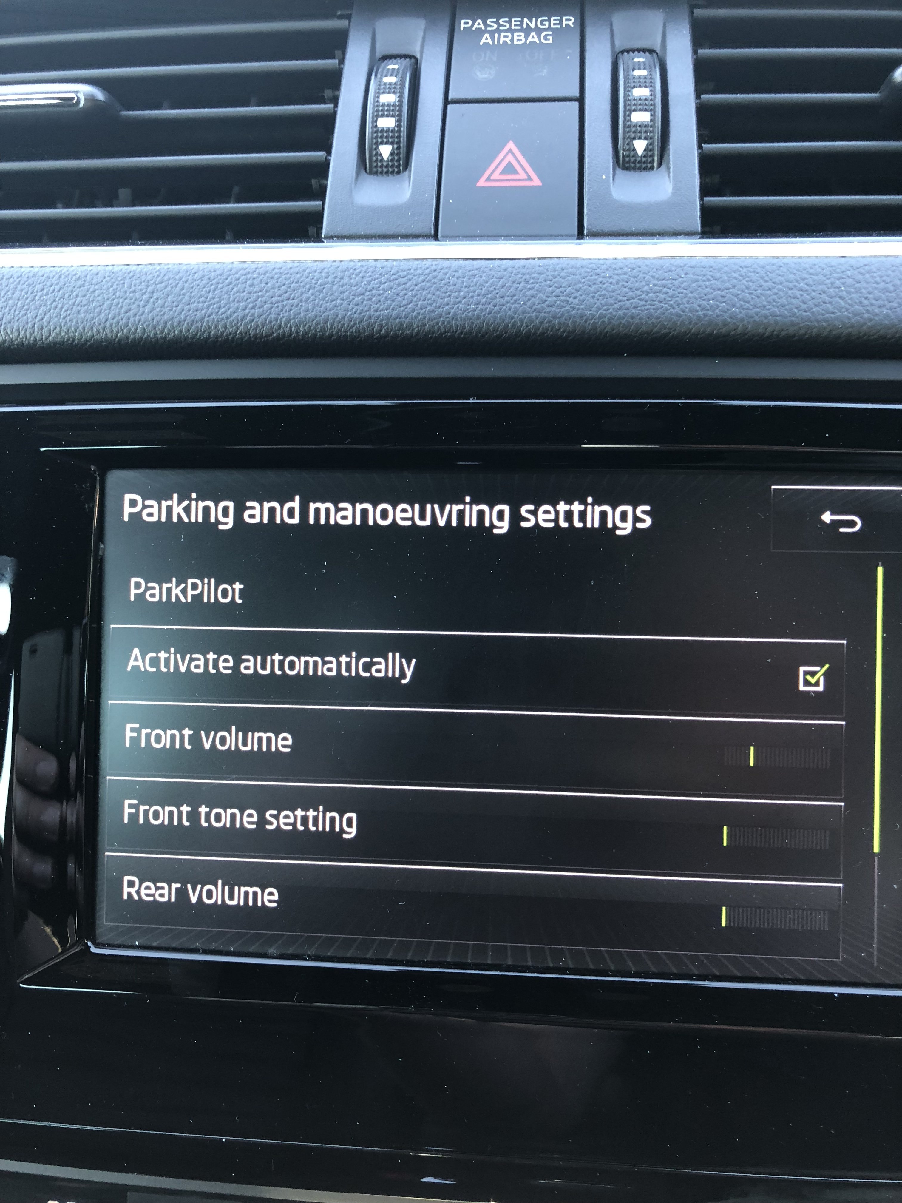

Screenshots from car.
I have ‘p’ button and cone in front of gear knob.
Any help or advice appreciated.
Ryan.

Do you have the all round sensors or is it just front and rear? The ones that park themselves have sensors all round. I seriously need to fix my parking sensors as everytime I see a post about them or reminds me that mine don’t work :sweat:
When you say all around - where are the other sensors apart from the front and rear bumpers :blush:
sorry of if that’s a dumb thing to ask??

On or around the wheel arches, front and back
Edited by Auric Goldfinger
As above, self park cars have 12 sensors in total :)
Well I’ve checked and none on sides around wheel arch - just on front and rear bumpers -
I guess that means I don’t have park pilot? If not wasted 15 minutes in a car park this evening - getting very frustrated. Doh

Park pilot is different to Park assist, pilot is just what VW Group use instead of the term Park Distance Control. Assist is what actually parks for you.
In addition to the front, rear and side sensors as mentioned, you should also have an extra button on the panel near the gear lever, which has a steering wheel on it and a letter P if you have Park Assist.
I used it once and panicked it was going to ruin my wheels so I took over and never used since. OP you aren't missing much! Oh and the extra side sensors have a tendency to trigger randomly when in slow moving traffic and other cars are beside you!
My tuppence worth.  You can have 120 sensors around your car...
...but unless you have that 'P' button with the steering wheel symbol alongside, then you don't have the self-park option fitted.
