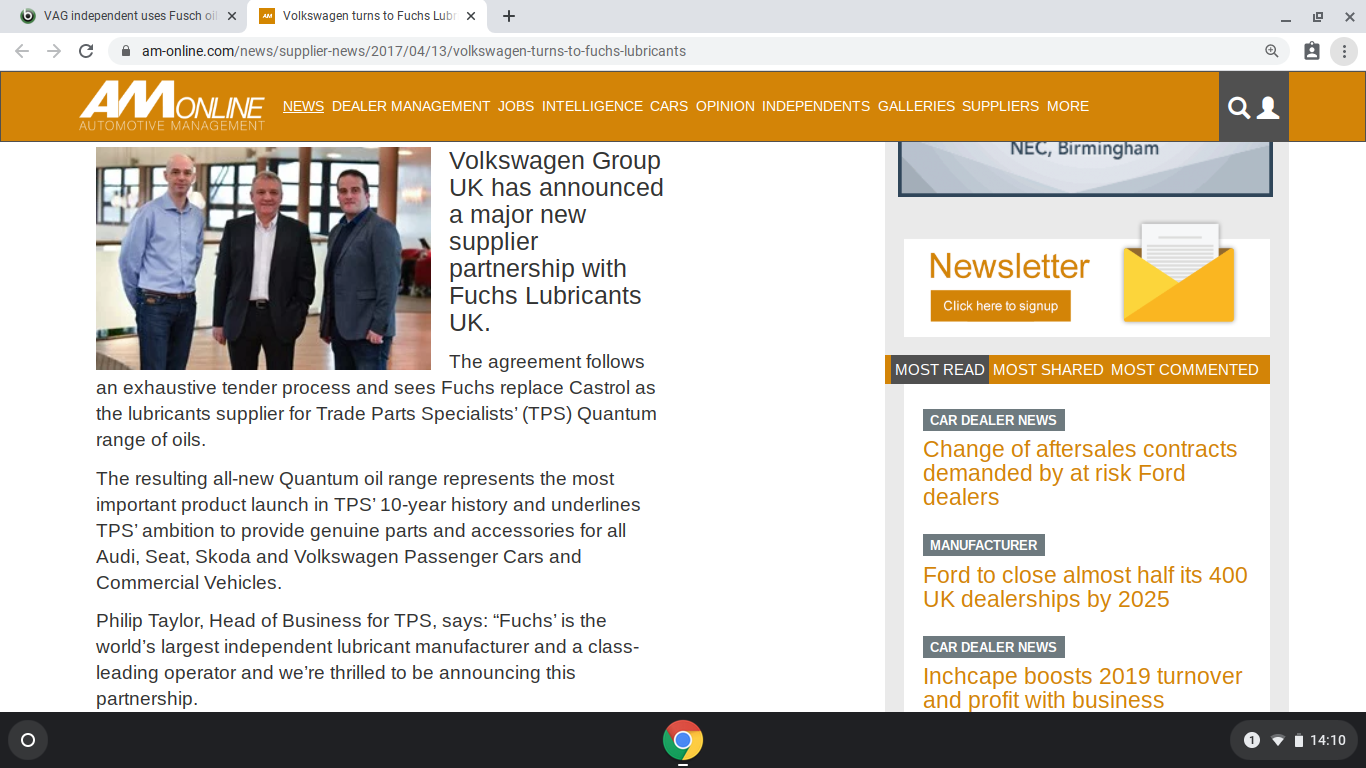

The "junk" oil you mentioned, Quantum, is VAG's own branded oil. Until recently is was manufactured by Castrol, more recently Fuch's.
It's an expensive Castrol branded container you're paying for, as often that's the only difference.

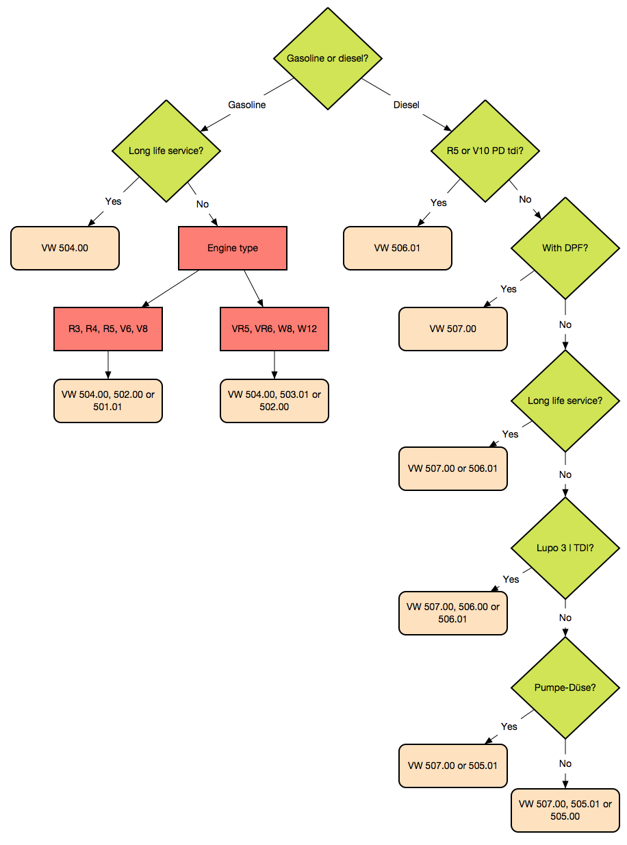

VW 502 so 5w 40 FS is perfectly suitable for Fixed Service intervals with a 1.4 TSI / 1.4 TFSI be they Euro 5 or euro 6 and ACT / COD or not ACT / COD
(If someone at Skoda UK Customer Services says otherwise then they are so wrong.)
& this is for Variable / Flexible Servicing.
Then the bottom diagram an oldie but a goldie.
Pre VW 508 / 509 days of 0w 20 FS IV
I understand your point only problem with it you can never be sure what cheap oil VAG buy and put in it. And you pay premium price for who knows what.
The Castrol container in the other hand is what it says on it.

http://briskoda.net/forums/topic/476057-vag-independent-uses-fusch-oils
Fuchs / Quantum is manufactured in the UK too.

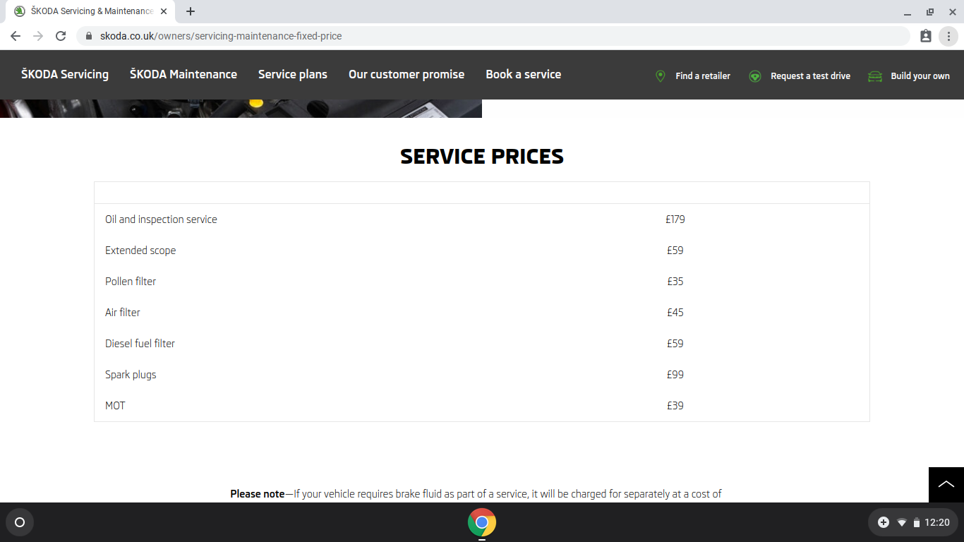

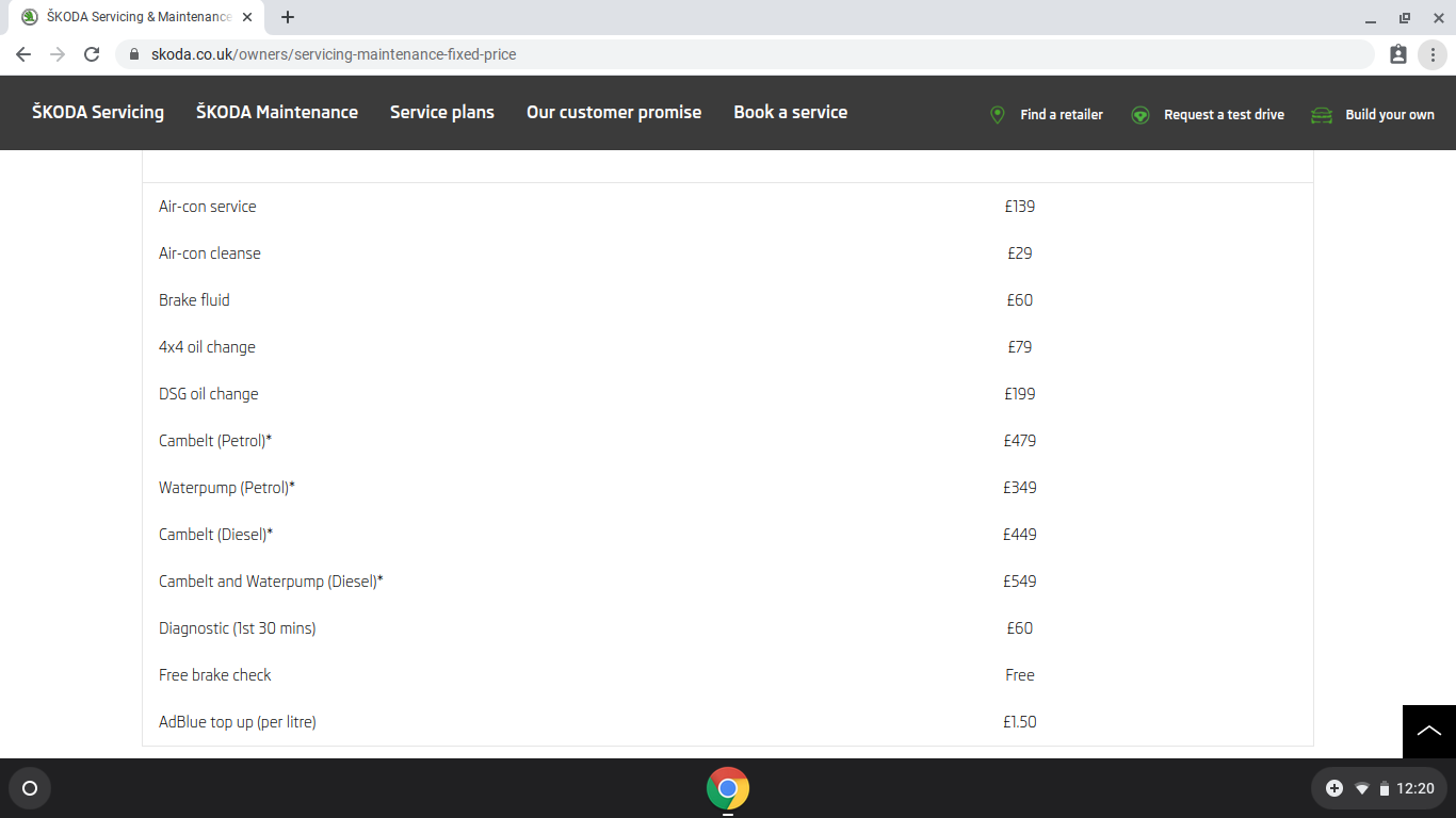

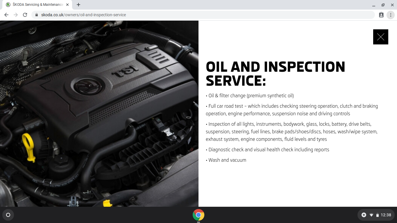

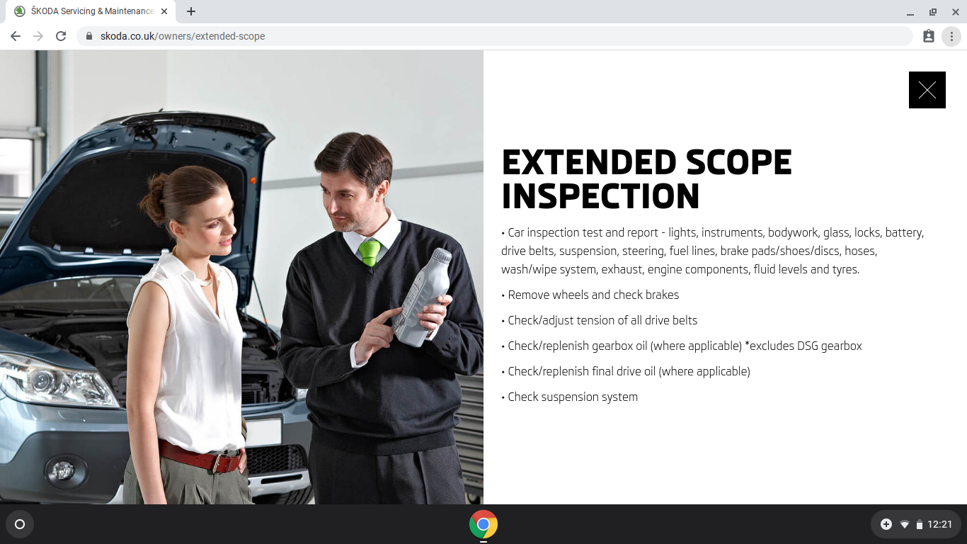

5 hours ago, Scot5 said:
Having the 3rd variable done by a franchised dealership is something I've never come across - would be interesting if you could find out what work is involved. I'm guessing the work would be the same as the 1st variable.
I was always on the understanding, that regardless of model / engine that nothing over and above the oil, oil filter and pollen filter were changed on either service interval prior to 3 years / 60,000 miles.
So I was on the same wavelength as you, being able to get the second service included on a 2-year service plan when on variable would be a challenge, as the fuel filter or spark plugs and air filter would not be covered under the service plan.
I wonder if these additional service items are now not changed until even later, and therefore a second variable service (upto 4 years or 36,000 miles) still only involves oil and an oil filter?
You really need to ask now if a 2nd 24 month service so at 48 months or sooner on a service plan includes any parts other than oil, filter and sump plug and top ups.
ie, Are you even getting things looked at like the air filter box opened.
Nothing for nothing anymore really with the Fixed Price Servicing at Participating Dealers,  you need to be clear what the Service Plan is giving or is the Tech the one deciding.
