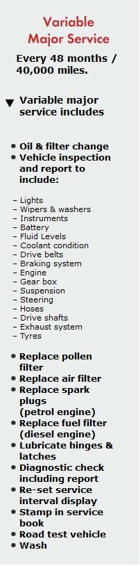

Its the 'how long is a piece of string' answer because as you know there is no consistancy within VAG. Pointless us even looking on forums because most of us are armchair experts who make up our own rules. And I have first hand experience of phoning around various garages ( no matter whether it be the Audi, VW, SEAT or Skoda's I've owned ) where not only different franchises will give different answers but even garages within the same franchise will give different answers.
My understanding is the following for a 2nd variable because it's the only piece of hard evidence I've found and it's exactly what VW told me when I had a 2nd variable done on my Golf some years back:
I was just a tad sceptical that MrTrilby's dealership done all of that effectively for the price of a simple oil change service. As I say it was a few years back and after much honing around, it cost approx £250 for a 2nd variable (excluded the pollen filter which I fitted myself). As a reference, a basic oil change service at the same garage cost under £120. For arguments sake, you could say 2nd variable costs over double the price. of oil+filter.
