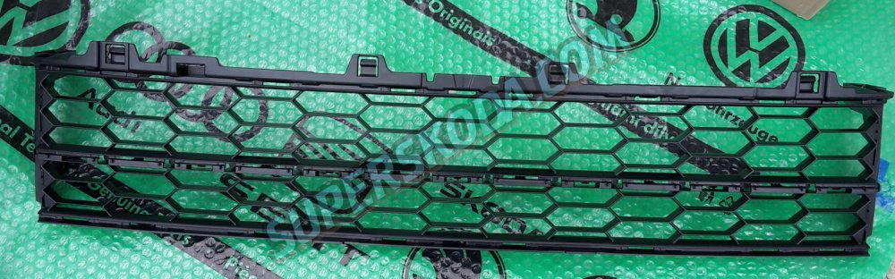

I had a cracked grille and the bumper has to come off .
It has to come out through the back of the bumper.
as u say, sadly a bumper off job.
this pic from superskoda plus another chat confirms it further.
it shows the grille from behind.
Edited by JR RS
