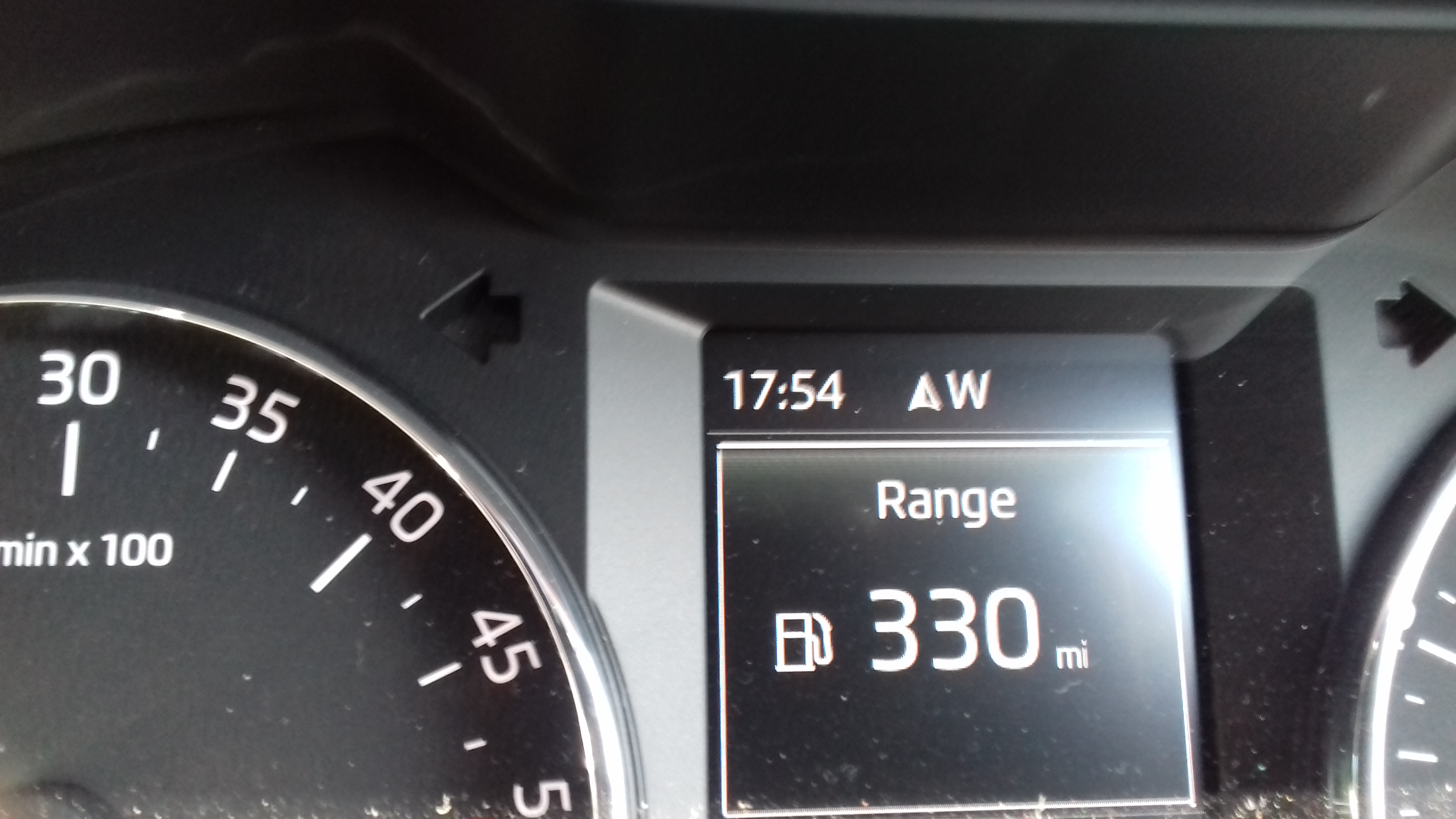

        I am in need of some advice I have got a 2013 Octavia elegance 1.9 diesel,I bought tis in April this year and she goes well,no problems with anything
except on the dash were I used to get the stop/start symbol I now have the symbol in the photograph,and of course the stop/start does not work,does anybody know what it means other than a fault,Thanks.
The direction indicator and W? It's the compass from the nav. It's the direction you're facing (West). Not related to start stop at all.

Hi Ahenners,
                      Thanks for your reply,compass indicator showing west I havent got a SD card yet for the navigator yet so maybe its just a glitch in the system somewere
and hopefully when I get the card it should clear it.
