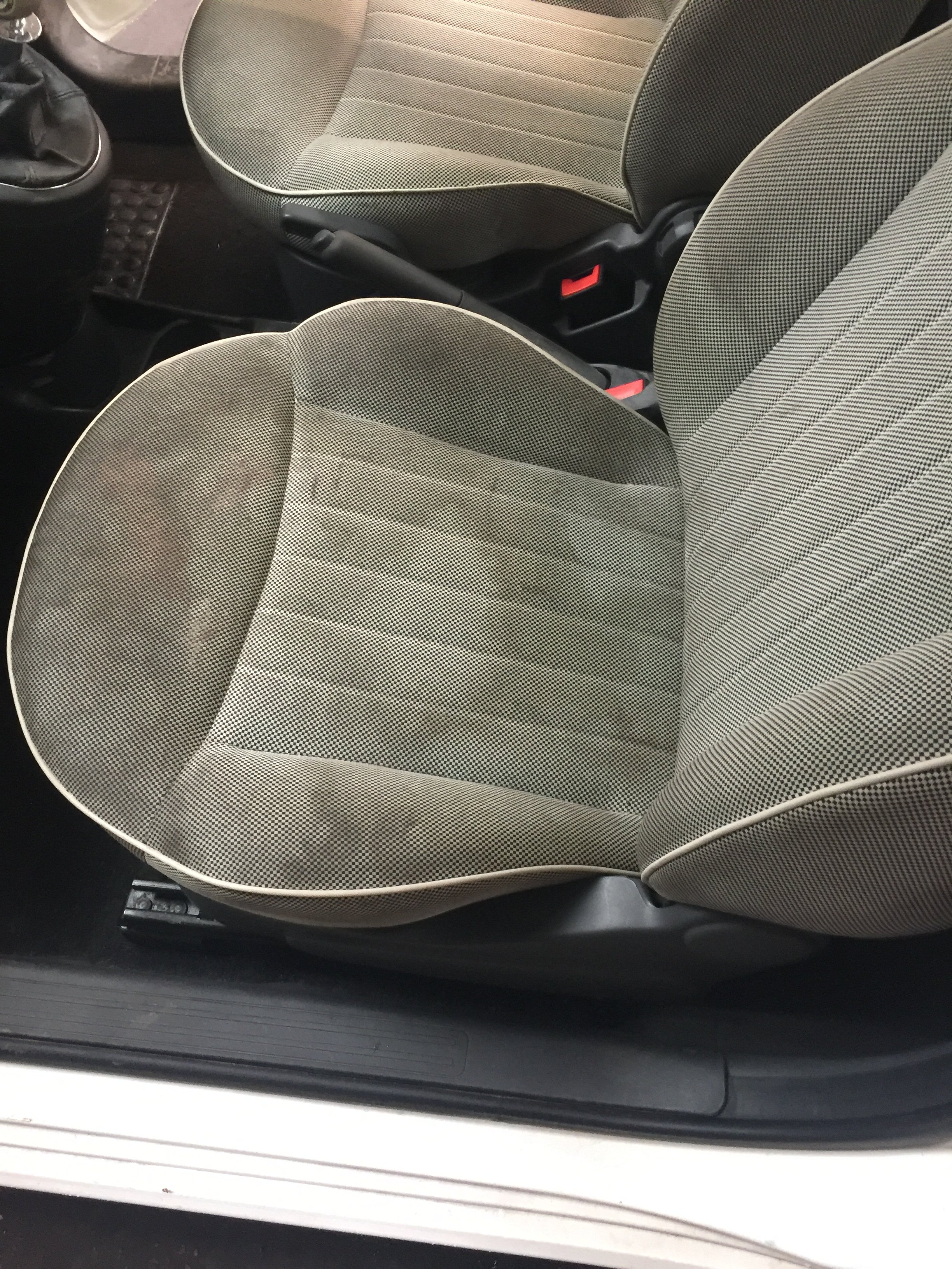

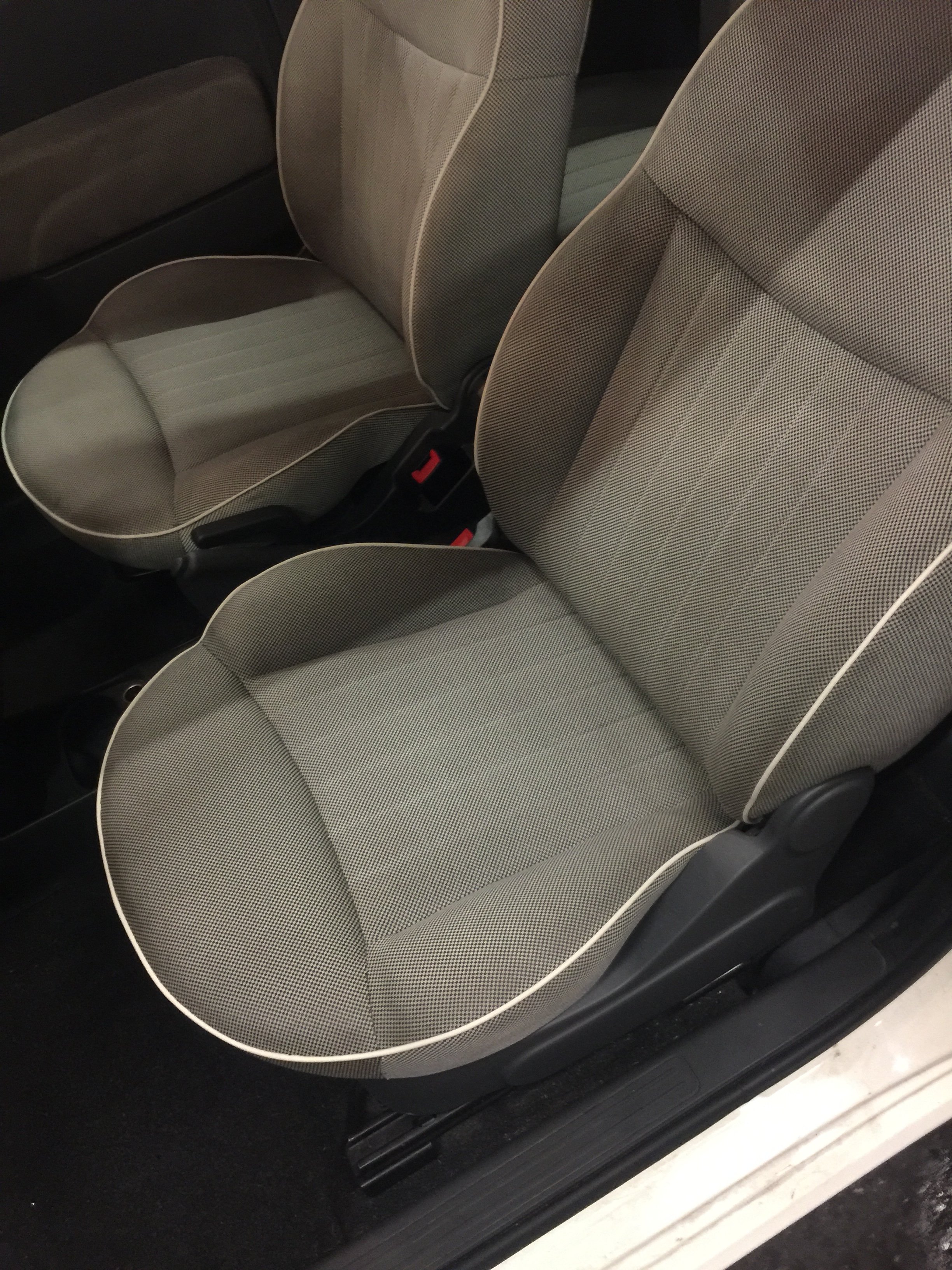

I used vanish stain remover on my seats, spray, leave for a minute, use a clean stiff brush to agitate the dirt then use the wetvac to suck the dirt in, here are some before and after pictures to show that it works
