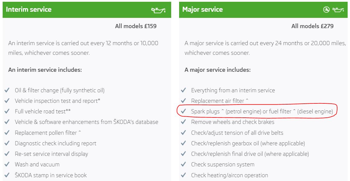

The Manufacturers Schedule / Guidelines might be 60,000 miles to suit 'Fleet / lease'  VW Group.
But Skoda / VW / SEAT / Audi dealerships are charging 'Fixed offer' prices on a Major Service, taking labour, parts & VAT at a fixed price regardless of if parts are supplied and fitted.
How can the VAT be the same if a Air Filter, Pollen Filter, Spark Plugs are not be changed or even checked.
Variable / Flexible service at 2 years or 4 years and no Air Filter changed yet £279 charged, sounds like fraud really,  does the HMRC get VAT on parts not fitted but the customer pays VAT.
http://skoda.co.uk/finance-and-offers/service-and-maintenance/simply-fixed     Simply needs investigated,  Fixed Prices, customers ripped off not some 'Special Prices' if work not done and parts not fitted IMO.

As we all know, servicing is a grey area throughout the VWgroup empire. Offski is 100% correct, a major service includes an air filter change so if it wasn't changed then I'd be back to the garage asking questions.
But with that in mind, VWgroup also offer another 2 services plan (£279 ?) when the car is new (or up to 1yr old)  - the oil service and the oil + inspection service. So did the garage carry out an oil +inpection service rather than a major service? That'd explain why the air filter wasn't changed.
As I say, servicing is a grey area which dealers themselves can't seem to agree on so what chance have we?

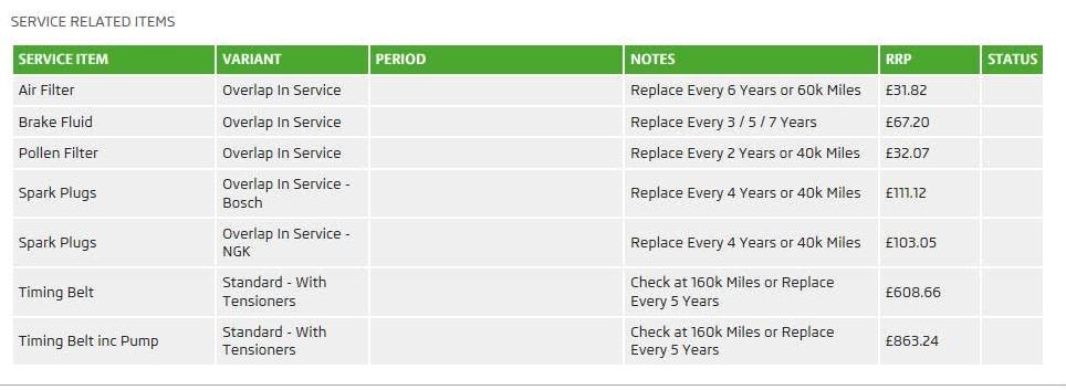

Looks like Skoda dealer charges £31.82 for the filter too. Presume this is to supply and install...
Check the price of the timing belt for this engine too!!
The timing belt for the 1.4 tsi is a story in itself. The actual skoda service schedule was posted by someone in another thread and it says : Inspect at 240000km (150kmiles) then every 30000km. There is no mention of 5 years. Everything you can read about these engines say the timing belts are Kevlar reinforced and effectively maintenance free until 240k km which most cars will never get to.
Skoda Uk say every 5 years, which I think is just backside covering.
I can believe it is £608.66 to replace as, having read the workshop manual, it looks like an absolute barsteward of a job to do - which is because it is classed as a major disassembly of part of the engine, not a maintenance item. The only maintenance designed for it is to remove the top plastic cover and visually check it after 240000km...
Edited by classic
Interesting, cheers Classic. I am not sure what to do when my car reaches 5 years.  The picture from my post above showing that crazy price was actually sent from the Skoda dealer here, so guessing that is something they reference when you ask them for pricing on various jobs.
I've seen a few threads on the timing belts for the 1.4 and the fiasco about times/schedules/mileages etc.  As you say, Skoda are covering themselves.
I must get around to asking on the VW, SEAT and the Audi forums to see what they have been told about the timing belt replacements their 1.4 TSI engines.
I don’t think any 1.4 tsi Octavia’s with the CHPA engine will be 5 years old yet, and if there are any really high mileage ones they won’t have reached 160000 miles. I predict a number of timing belt threads in the next year as dealers say they need doing and then realise they can’t do it for £389.
I noticed your dealer quotes £863.24 for the timing belt and water pump ! The water pump is driven by a separate toothed belt off the back of one of the camshafts - again with a 240k km inspection.
Given those prices at least it looks like your dealer knows what is involved.

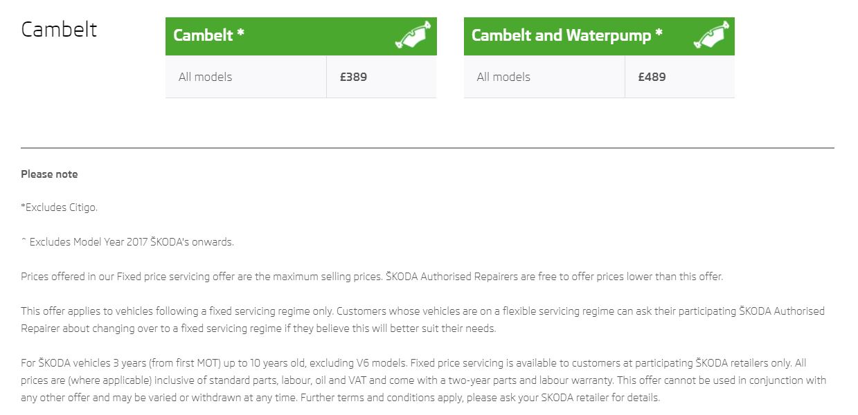

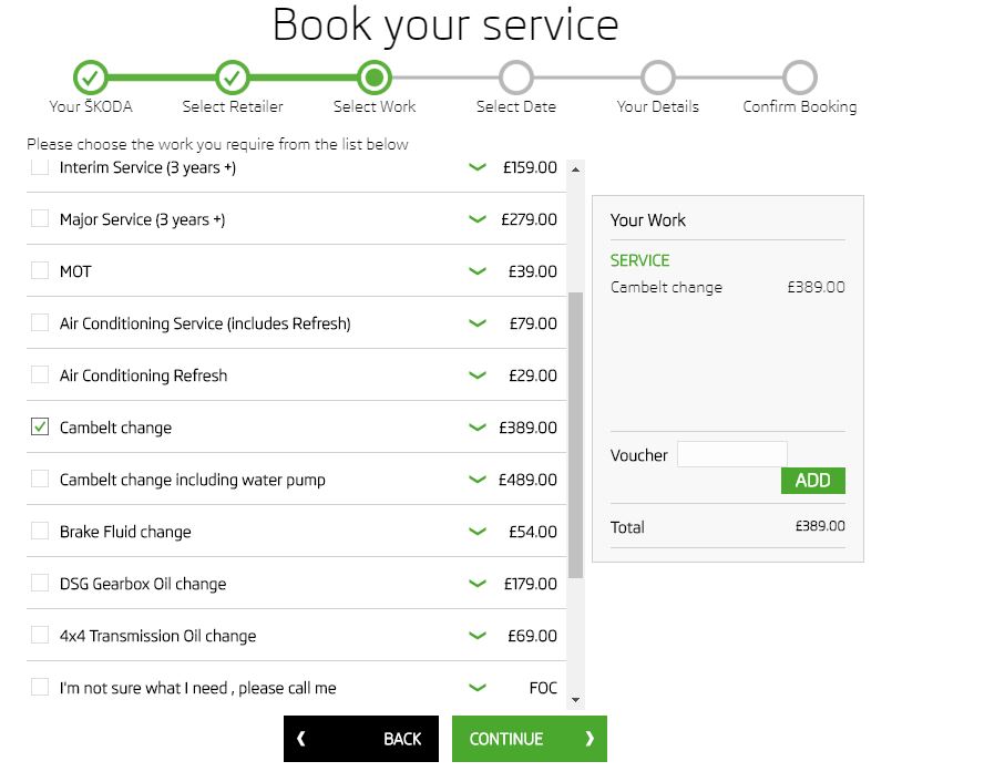

Dealers can quote whatever they want via the phone or on their website for a cambelt and waterpump.
You only need one sucker to stump up almost £900 and that compensates against those getting the work done for Skoda UK's fixed pricing policy of £489...
http://www.skoda.co.uk/finance-and-offers/service-and-maintenance/simply-fixed
My local Skoda dealer priced matched an independent, albeit on a diesel Superb, but they're still making money doing a belt and pump for £340...
