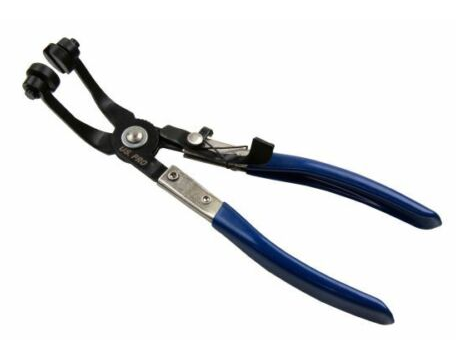

I've ordered myself a set of hose clip pliers to help with the air box removal...

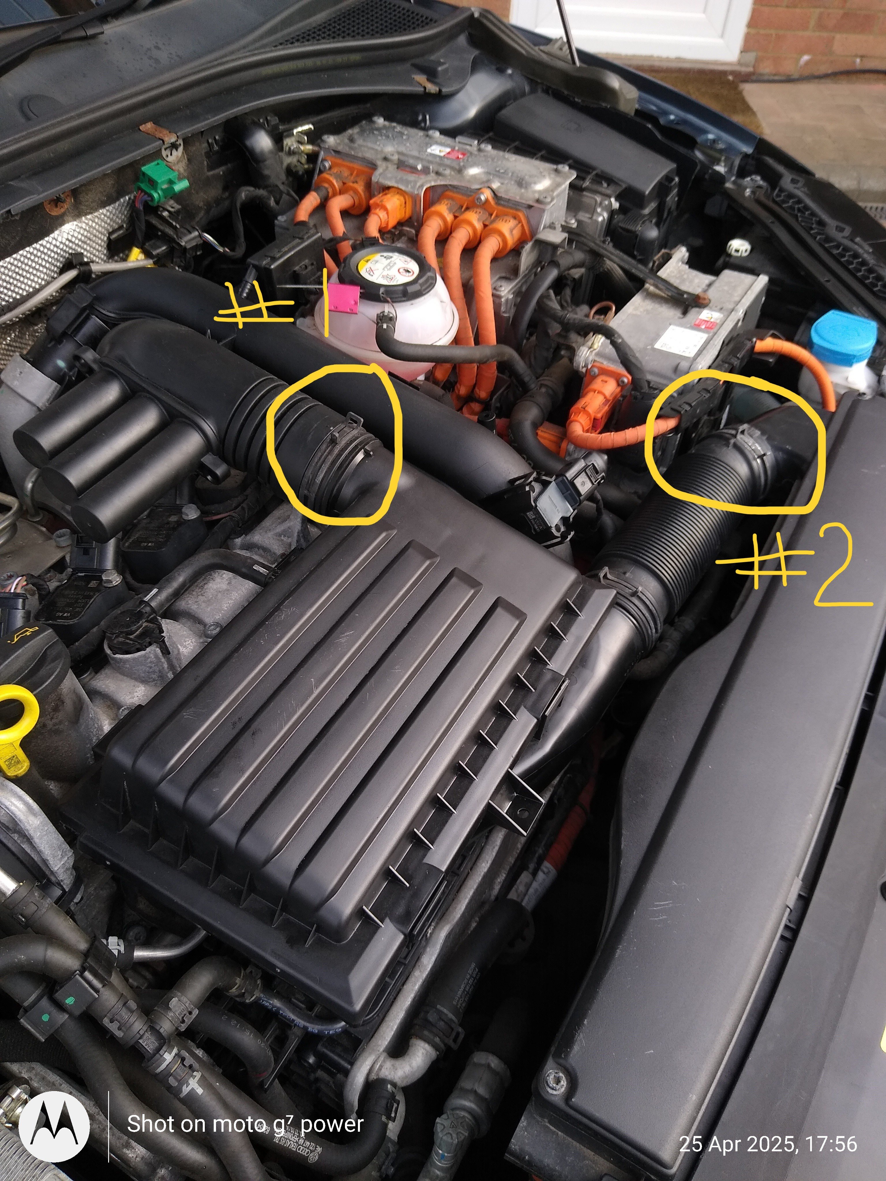

@Plantman Thank you for what you had shared about replacing the air filters on the Superb Mk III. Right now, you're likely the only person on this planet who has shared this info!
Help!!! I've tried but am still hesitant in removing the air filter-box as you had described. I don't suppose you'd ever consider doing a video showing the process in the future?

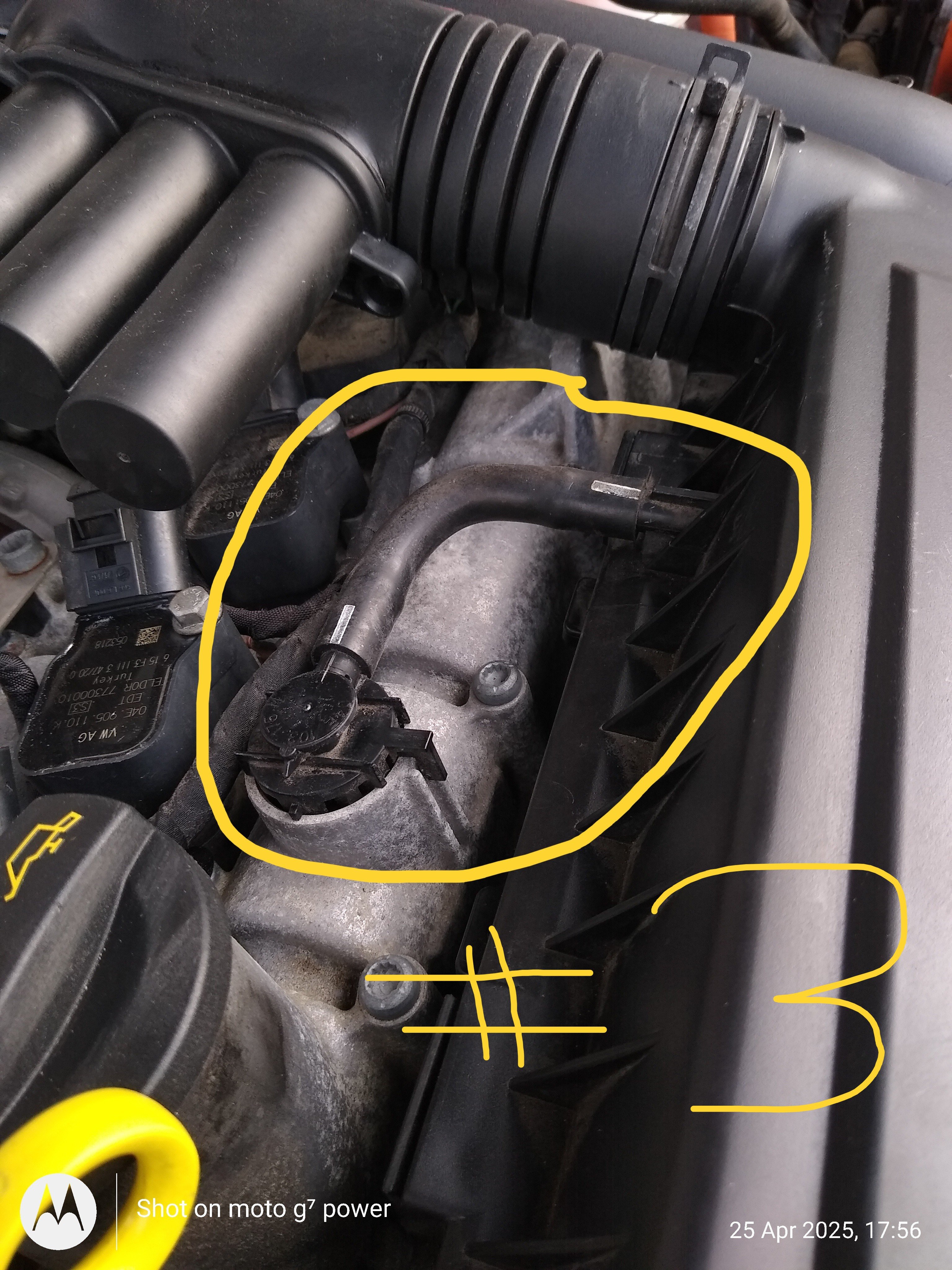

The pipes secured in place by the 2 retaining clips all feel very fragile and without a video, it just felt like a tug in the wrong direction would cause something to snap. Also, that small hose connection. The plasticky housing likewise felt like it would snap into pieces..
1. What's a good order in which to remove the 2 hose connections #1 and #2 in the photo? How much tugging can the parts withstand?
2. How should we disconnect that small hose and connector #3? Is there an order in which we should do this?
30 years ago, an air filter change would have taken all of 10 minutes and brought about satisfaction. Nowadays, I can't seem to do anything with the car without some plastic part breaking ☹️

Hello, welcome to the forum.
I found no specific removal order of the hoses necessary.
Tip 1 - Make sure the hose clamps are completely clear of the internal spigot of the air induction ducting, the convoluted hose will come off reasonably easily once you do this.
Tip 2 - definitely recommend in investing in a proper set of hose clip pliers as shown in Silver1011s post, they are not expensive and make removing the clips so easy. Get the type that will lock in open position so that the clip can easily be moved up the hose, clear of the clamping area.
Tip 3 - for the push-on breather hose, gently twist with your hand before pulling off elbow.
Tip 4 - Don't be mislead in thinking that it's only the sprung clips holding the airbox lid to the body, there are screws (pozi-drive I think) hidden on the underside of the airbox too - only accessible from beneath! If you think that's a stupid idea - so do I!

@Warrior193 Thank you. That's all very helpful. I can confirm that there are indeed 2 screws on underside of airbox.
A lot of faff to replace a single air filter ☹️
