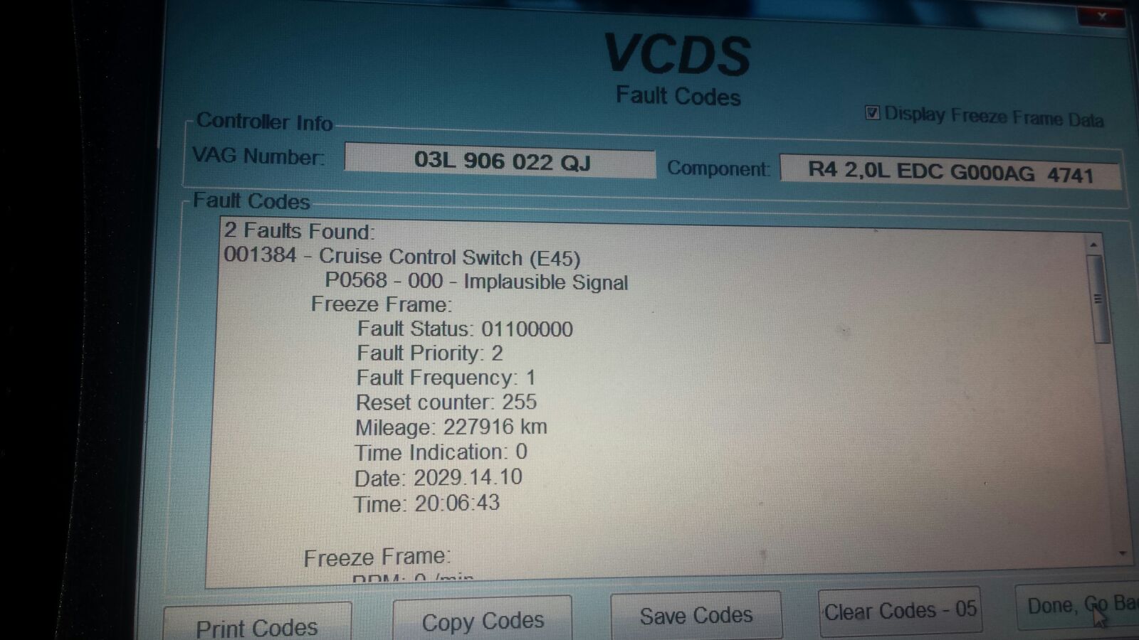

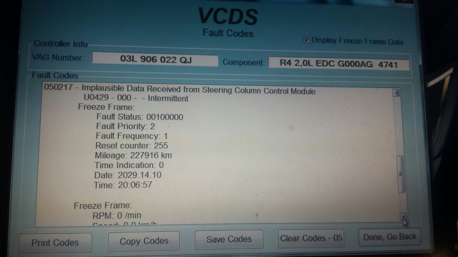

Hello guys. I got a prob with the cruise control on my skoda superb 2009. I got cruise control retrofited and it worked all good for 2 months. Suddenly, in the middle of using it on highway, cruise control turned off itself. From then on, i cant turn it on again. I took it to the guys in shop where they retrofited but they cannot found where the error is. :( All the buttons work in VCDS i am getting "implausible data received from steering column" error. Pics below. Any ideas would be great, iam despite. Cheers lads. Regards from Croatia.
Screen shots of the fault mean little. Post a full autoscan so that all relevant data can be seen.
