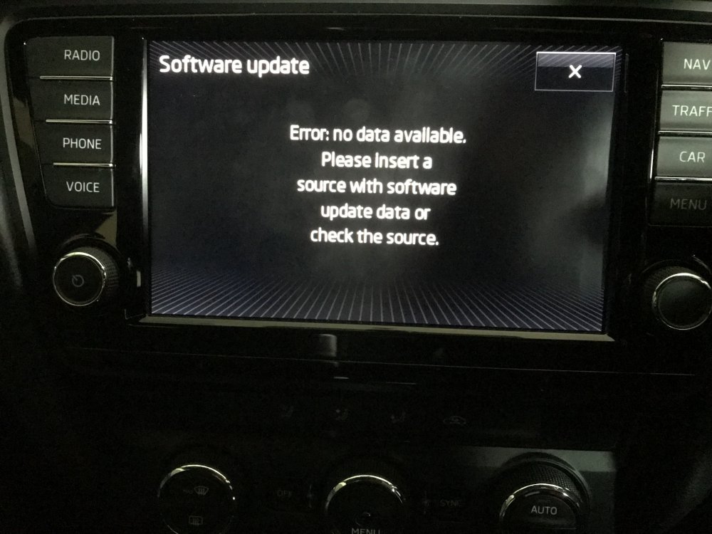

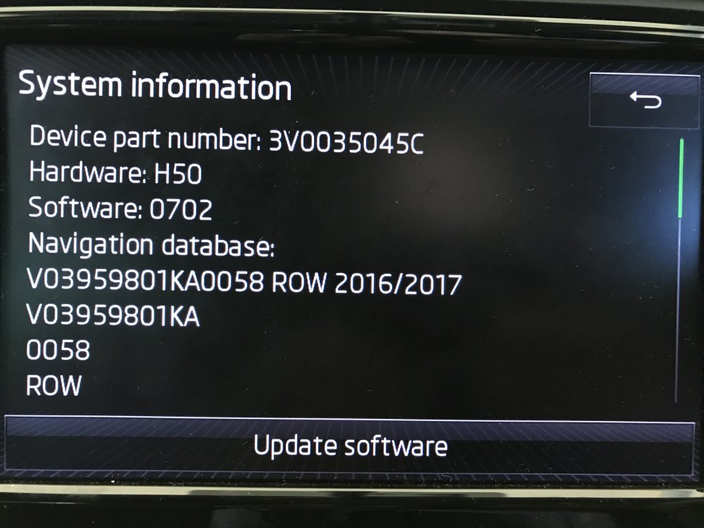

Hi team. I have an MY17 RS in Australia and although the Columbus recognises an update is available on the SD card it cannot locate any files to update it. I have the 2016/17 update as shown. The current version should be later than this but just doesn’t work despite following all the instructions here and on the Skoda website. Anyone able to tell where I’m going wrong with this?
I have ensured that the SD card has the three important items in the root folder, the text file and the MIB1 and MIB2 folders, and nothing else. I did this on an iMac. I haven’t cleaned the card with CleanMyDrive as was suggested somewhere. I’ve tried slots 1 and 2. Both register that there is an update available immediately after inserting the card but then when asking it to update through the system information screen it fails to find the software update files. Did anyone else with a Mac struggle to update their Columbus?

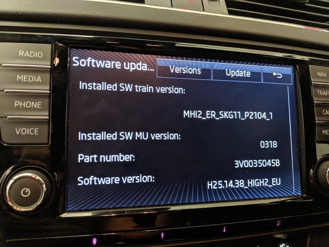

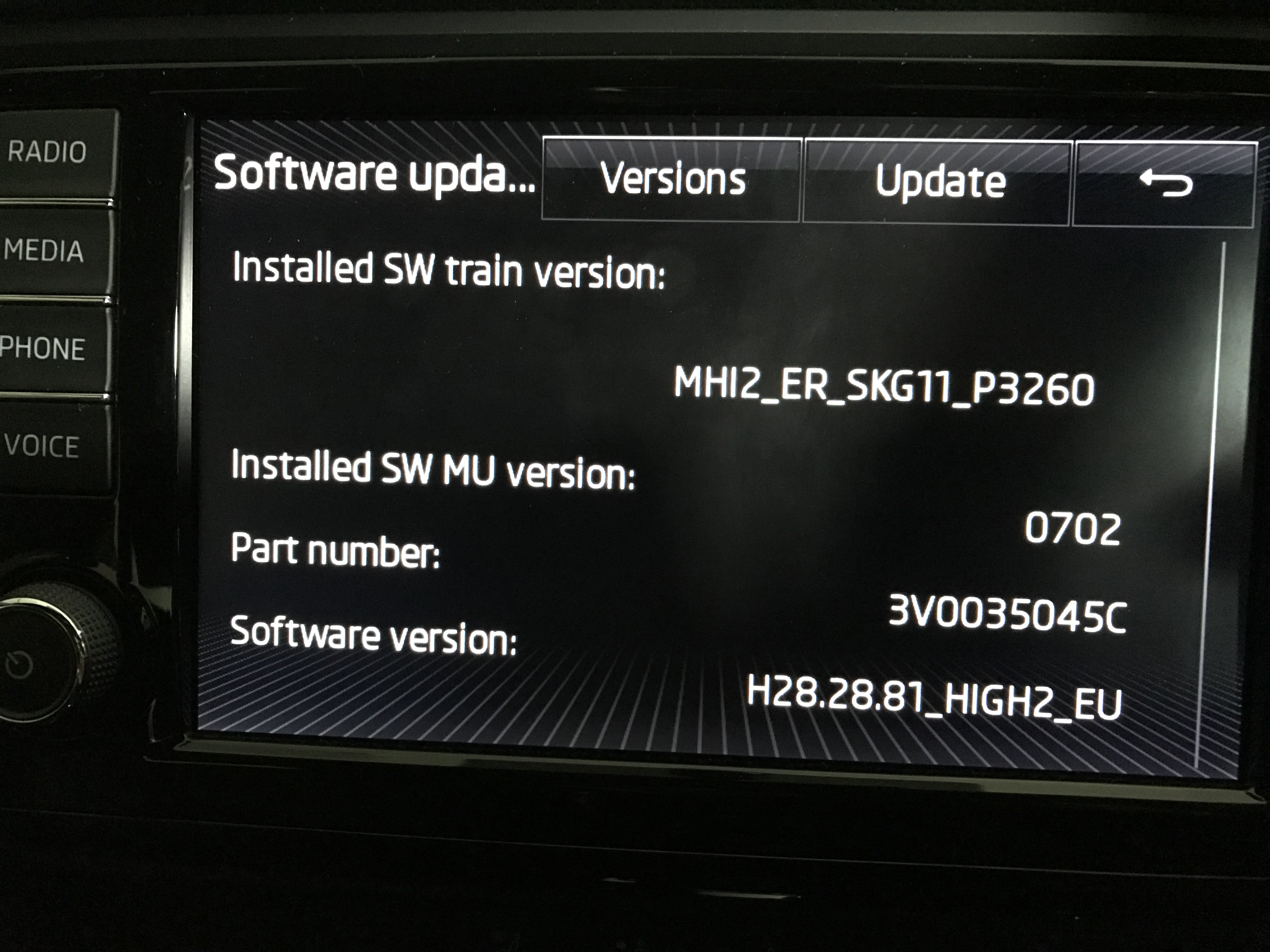

Are you trying to update the satnav data, or are you trying to update the units software?
Because that software update page in the picture looks suspiciously like the unit software update page, rather than the satnav data update page...

I have been trying to update it through the System Information tab on the Settings menu.
Clicking on Update software ended up in a long search for files but didn't work.
Until I tried the above instructions, again cleaning up the SD card with Terminal commands, and this time it is working. Many thanks for your advice.
That procedure is for system software update. For maps data update, press "Nav" button - touch "Setup" (bottom right of the touchscreen) - touch "Version Information" - touch "Update Software".
