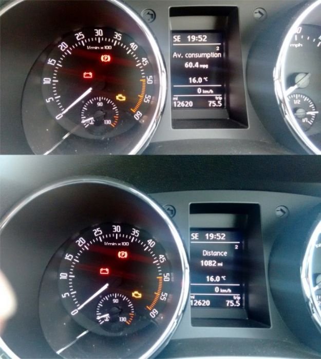

Mine does about 58mpg
This shows 60.4 mpg  over 1082 miles
Best I've had was about 74mpg over 72 ish  miles.
