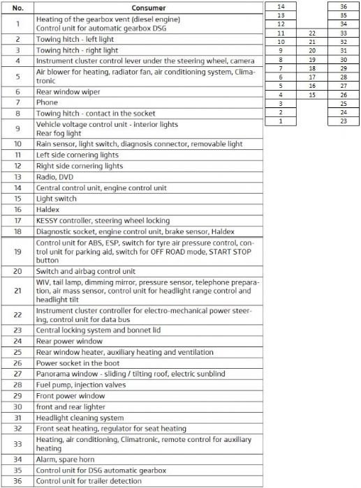

Most folks hardwire with a piggyback into rear wiper fuse 7.

Oops, as you can see I meant fuse 6  :blush:
Quite easy to do.
Slide a thin blade under the fuse box cover to lever it off.
Kit off ebay comes with piggyback fuse, voltage converter, and cable.
Pull out fuse 6, replace with piggyback connector, and insert old fuse into it.
Connect earth wire to one of the bolts holding the fusebox in.
Tuck voltage converter in fuse box.
Hard part is threading cable out of fusebox, then gently push up under trim.
Replace fusebox cover.
They do say check the piggyback fuse is in correct way round by not inserting old fuse and checking rear wiper doesnt work with ignition off.
