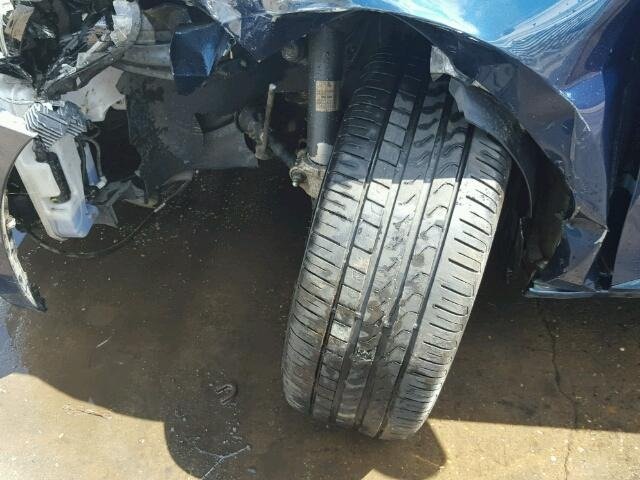

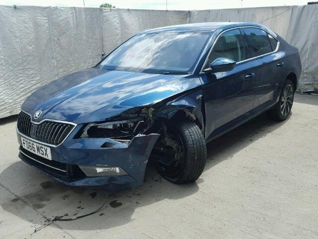

When I said it needs a little bodywork, I meant this:

That'll buff out ;-)
