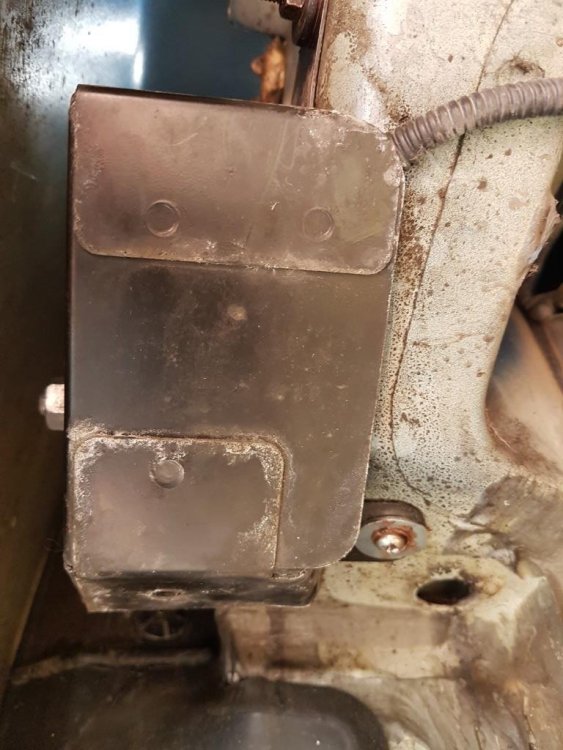

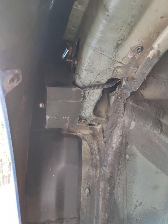

The alarm unit is mounted on the driver's behind the front wheel liner and on the lower bulkhead. As you may imagine, it deliberately arranged to be difficult to remove but past posters have included photos and show how it can be changed easily by removing one screw and bending a metal cover. Easy to change once you have seen how.

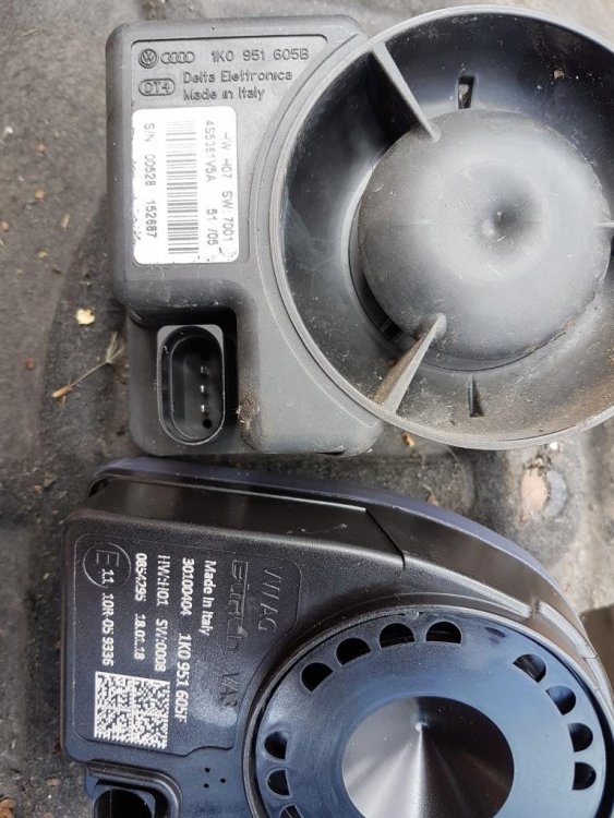

I swapped my unit to one from a 2015 model Audi last year bought cheaply from an auction site. The part number was the same and I plan to sell the car before 2021.

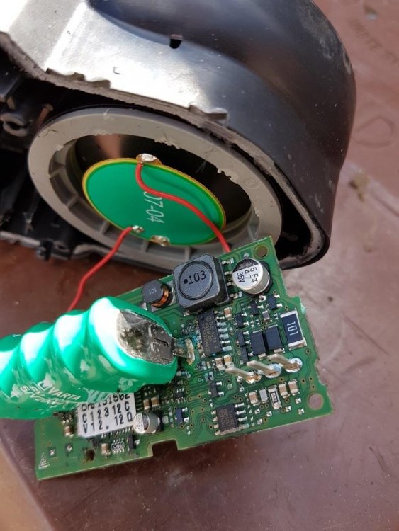

Mine had not been replaced from new so it was 12 years old!! I fitted a new one from Skoda myself. As you will see there were a lot of leaves behind the guard under the wing. Very simple to change and no more false alarms now thank goodness. I cut the box open and the battery had leaked onto the circuit board rendering it scrap, but if caught early enough then a battery replacement would be fine.

1K0 951 605

I have a problem with my alarm siren. One day the alarm sound stopped and never sounded. I decided to disassemble the part from the vehicle and replace the battery (As I have seen the posts of battery changers on the forum site). Everything went well, but when I removed the alarm siren circuit, I found that the battery leaked and caused oxidation on the circuit. I wanted to clear oxidation through the circuit, but the circuit path was broken because circuit path was destroyed by oxidation. So here is my question. Where can I find the circuit diagram or photo of the circuit? They want an unnecessarily expensive price for this component in my country. Since I have electrical and electronic knowledge, I want to repair it myself. I hope you can help with this. Thanks for your help. Here is some photos of my work.
