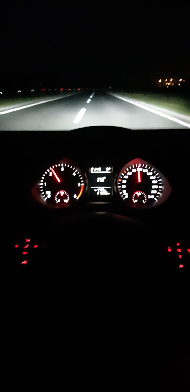

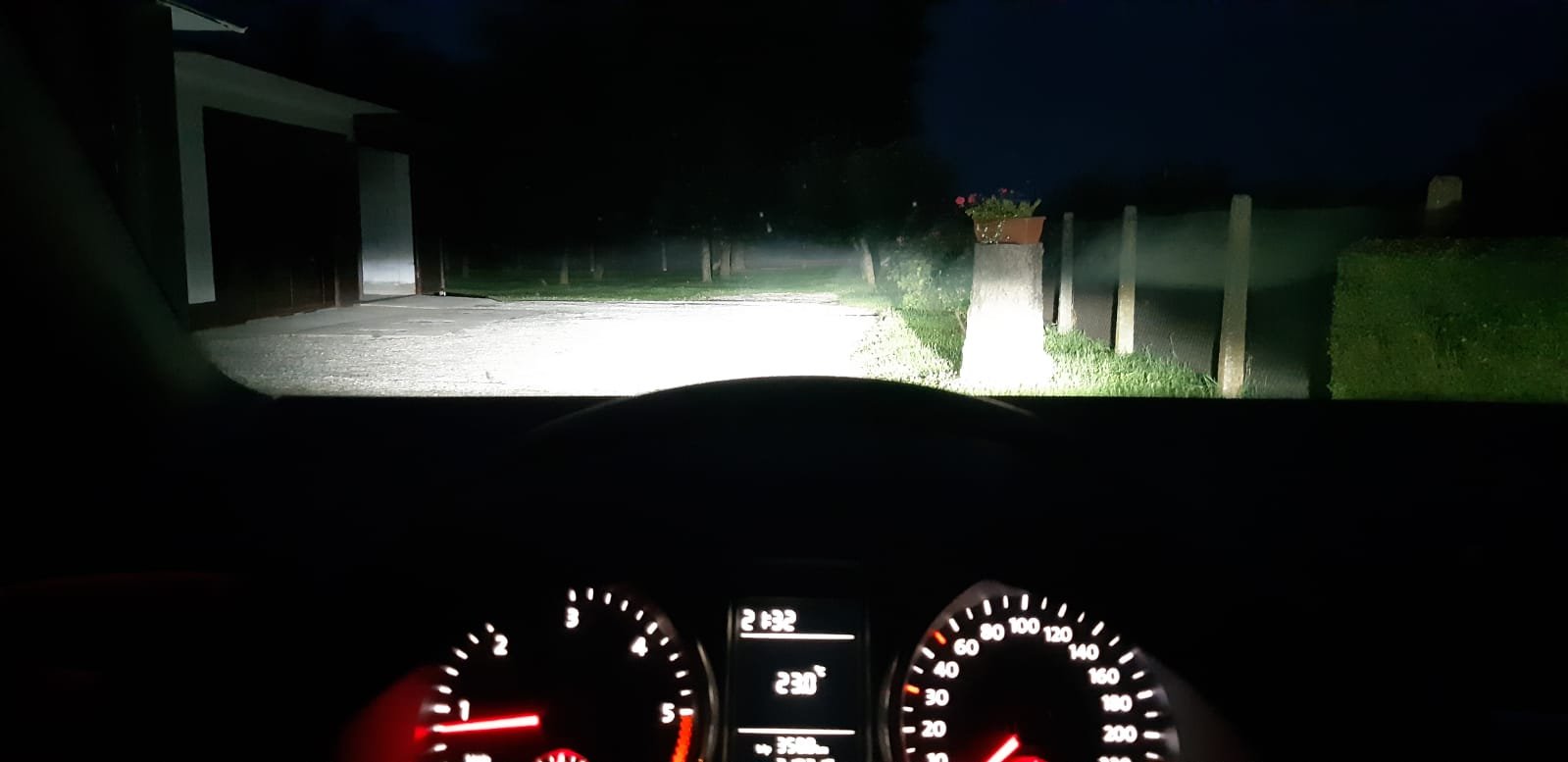

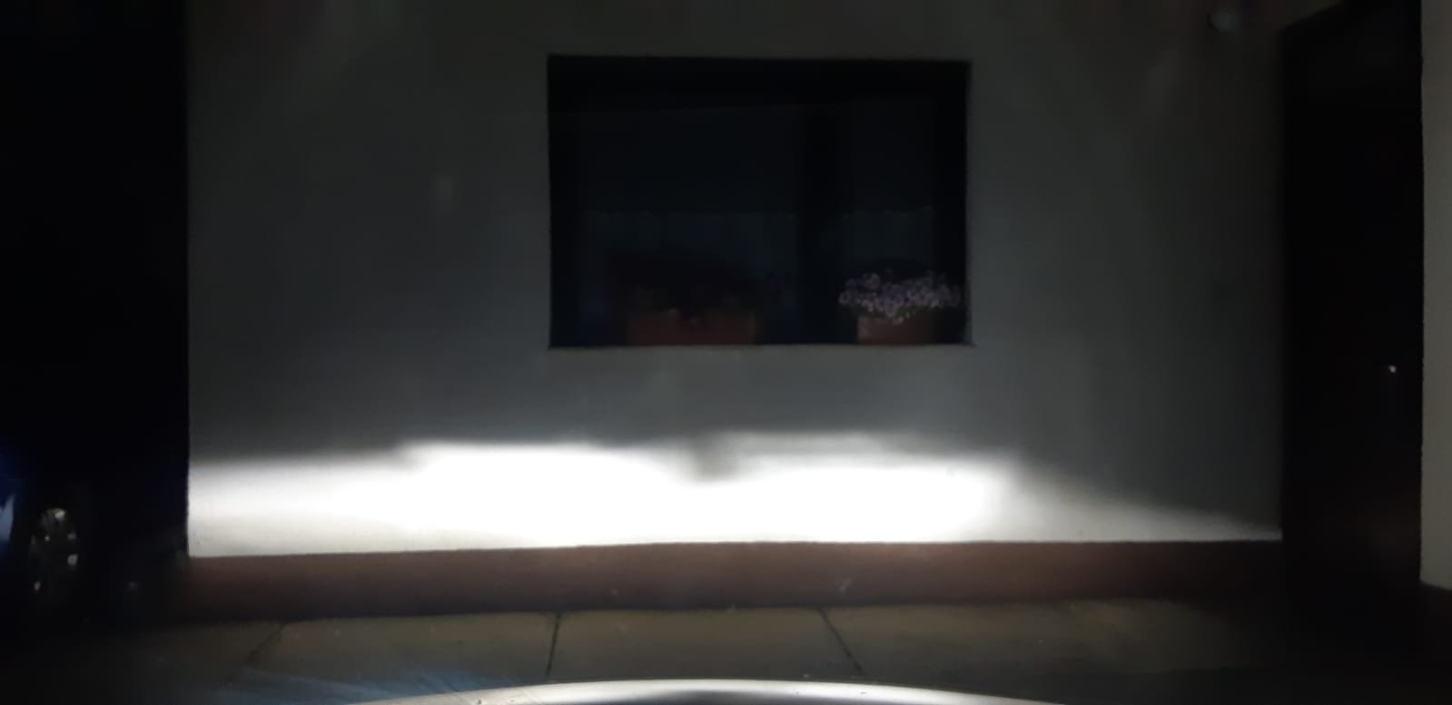

BUT!! Few days ago, friend of mine put Erfolg LED h7 bulbs in his golf mk6 halogen headlight, here are the link and pictures... http://erfolgled.com/en/homepage/

Beam pattern is great as you can see, and he says that light output and visibility is great...
The price is around 100€/pair of H7 and may be a little expensive for "two bulbs" but i think i'll give it a try... I know that projector headlight look much better on the car but at least no more yellow light with these LED's :)
Edited by lux4zg
Hmm. Fairly sure my beam pattern on OEM LEDs looks more defined than that at the edges.  I’m wiling to bet that’s scattering light everywhere when looking head on.

Yeah they will be as they’re behind projectors. Always annoys the hell out of me when you see some idiot with badly retrofitted bulbs - it’s like someone driving towards you with floodlights on the front of the car!

@lux4zg that beam pattern of the LEDs on the MK6 halogen doesn't look great to me. It's not even and it looks like there's a fair bit of scatter.
An F30 LCI 3 series has factory LEDs behind reflectors and the beam pattern looks far better than the images above. Reflectors don't have that lovely sharp cut off that projectors have, but dedicated LED reflector units do a much better job than halogen ones with LED light sources.
Of course the beam pattern can't be like one form projectors... Look at the beam from standard halogen headlight with standard halogen bulb... pattern is pretty much same as pictures above

That is true but the reflectors are designed to be fitted with low output halogen lights with a warm colour temperature. So light is scattered but glare is minimal to other road users.
Fit high output HID or LED to halogen reflectors and the light scatter is usually a major distraction to other road users.
That's why there are strict laws for high output lighting such as different hard cutoffs, auto-leveling and headlamp wash.
