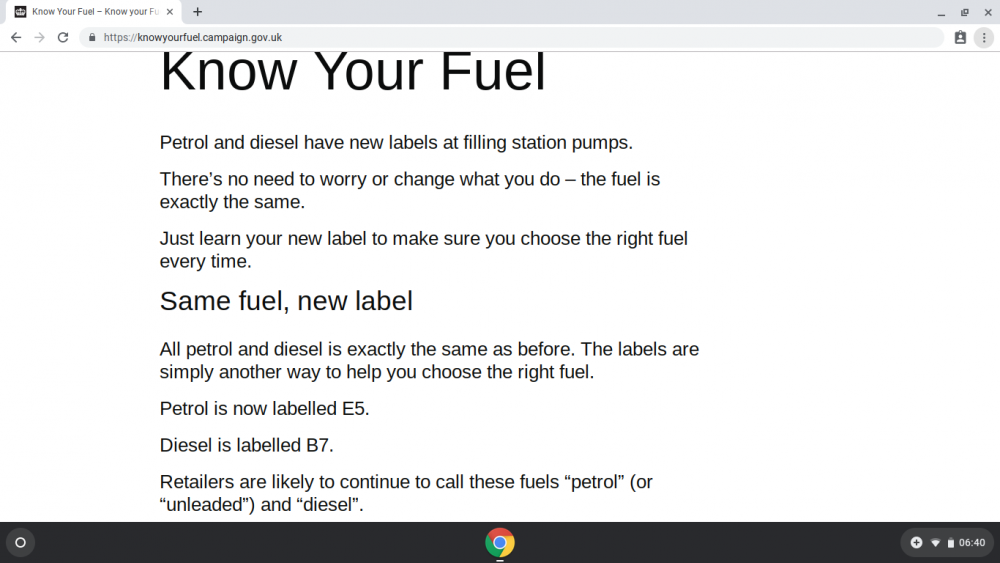

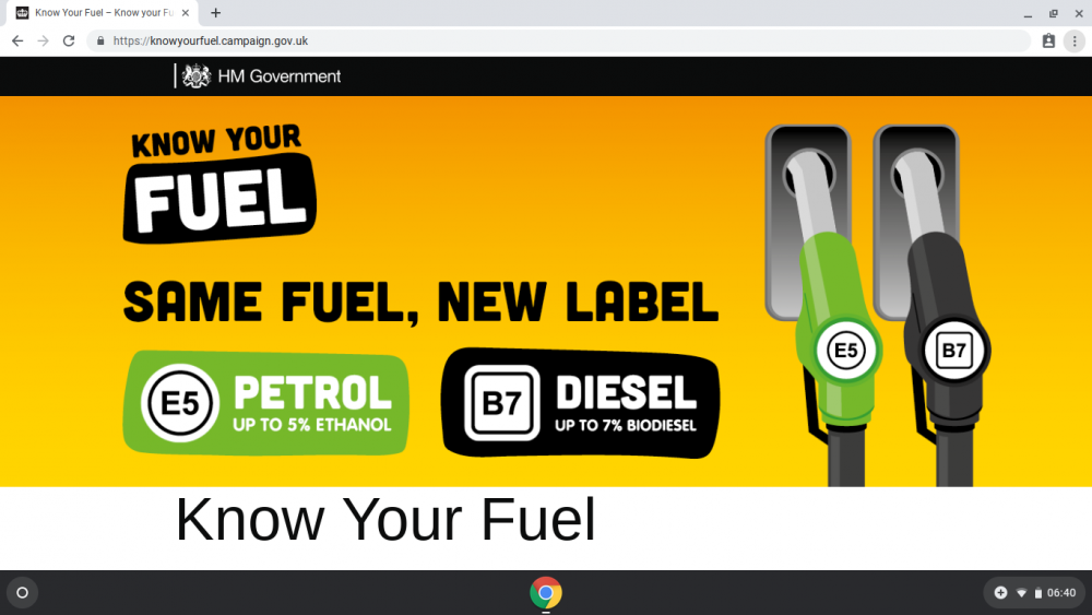

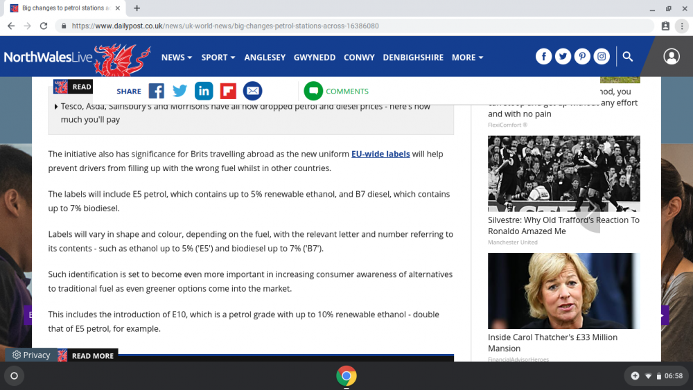

All 95RON fuel in the UK contains a minimum of 5% ethanol by law.
Tesco Momentum 99 contains 5% ethanol. (Greenergy docs)
Ethanol is extremely hygroscopic.
Sainsbury's super unleaded anecdotely is the same as BP ultimate, both 97RON min. Again anecdotely, they don't contain ethanol. If that's true then less likely to absorb water if you don't fill up very often
Now in the UK seeing as it is mid October fuel leaving the Depots for Filling station tanks stating in the North of the UK and later further south is Winter Spec Diesel & Petrol.
So the diesel has Anti Waxing formulation and the petrol has components to make it less hygroscopic.
Ethanol is quite hygroscopic.
The winter fuels in the UK will be getting delivered to filling station and other fuel tanks until at least late March 2019.
Maybe someone wants to check on that.
Winter grade 95, 97 & 99 ron Minimum is lovely stuff IMO.
