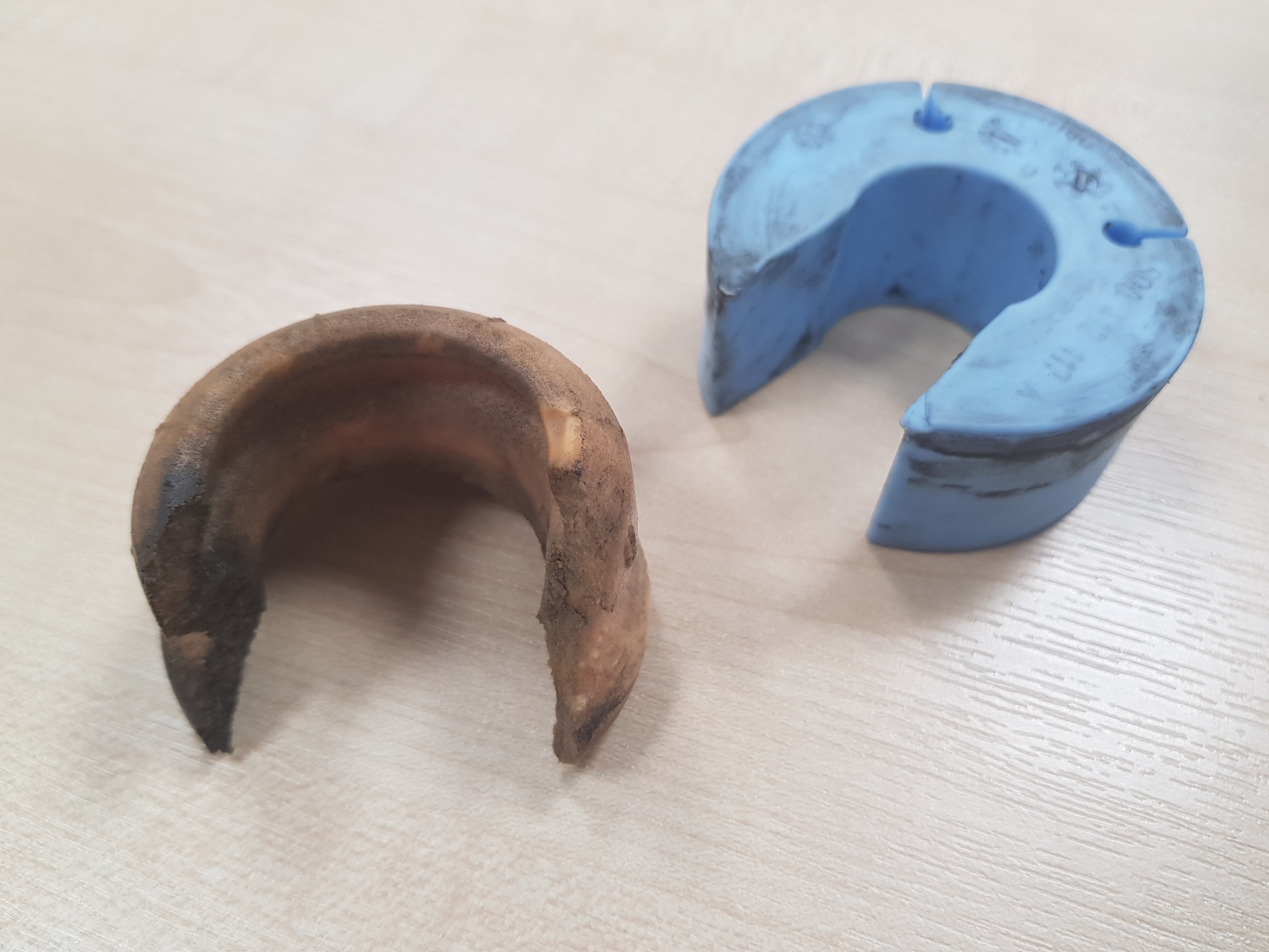

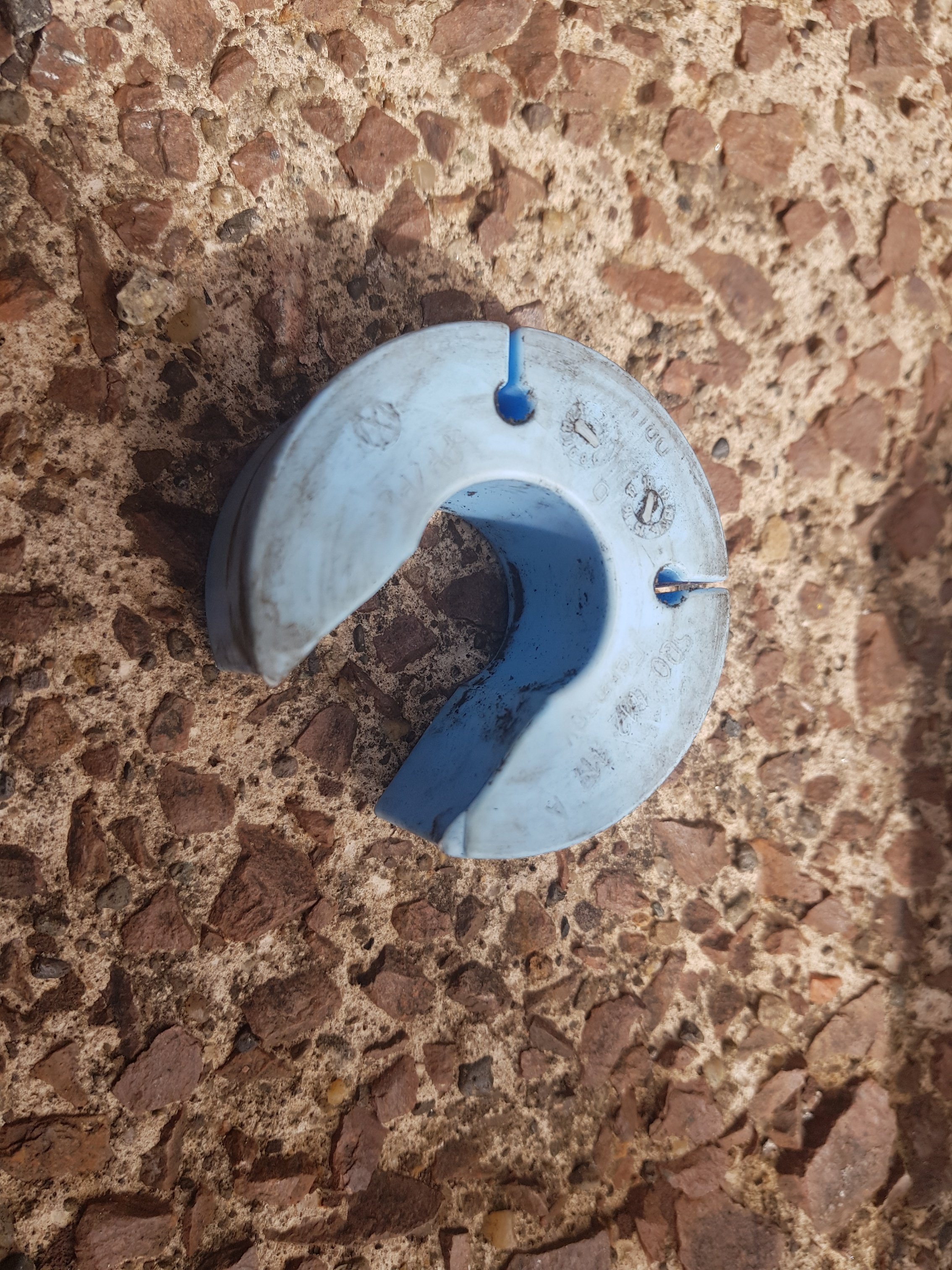

I purchased my 2016 Skoda Superb SE L Executive 2.0 TDI 190 in May, it has now covered 27k miles but had been developing a knocking noise coming from the NSF suspension over the last few months. I discovered today that one of the shock absorber delivery spacers (part no. 5Q0 412 117 A) was left in place (see photo). These spacers are used for delivery of a vehicle from factory to dealership and must be removed before sale.
This is a severe quality control oversight by the original dealership and has resulted in a dangerous vehicle. The NSF bump stop is now completely destroyed (see photo) and has damaged the shock absorber and possibly resulted in further damage.
Has anyone else ever seen this before and can recommend how to best go about making a warranty claim? I have emailed Skoda North Wales (where I purchased the car) but I'm in Glasgow so obviously not taking it all the way down for repair.

If it is sitting in such a way that there's a big arch gap you may be able to get in and prize up the plastic boot on the shock absorber and look under it. Easiest way is to jack it up a little. Don't have to take the wheel off.

It is now booked into Skoda, they are going to sort it free of charge and are providing me with a courtesy car.
What have they agreed to do?
They haven't agreed to anything in particular but have agreed to fix any damages. I will be pushing for a pair of front shock absorbers and bump stops at the very least.
I expect all you'll get are bump stops.
I think the top bearings will have taken a beating, the shock absorbers should be ok though.
