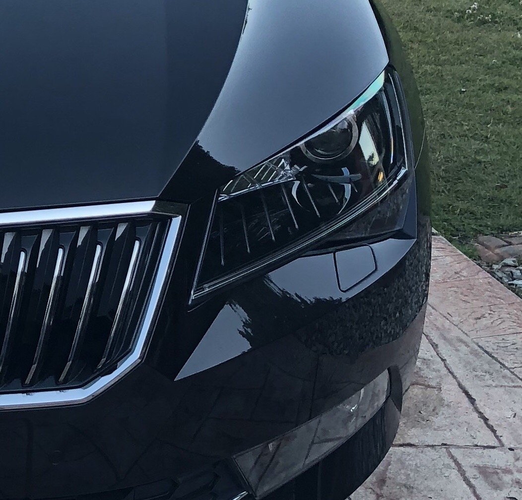

I’m waiting delivery but I have attached a pic of the lights.

They don’t look like they have the LEDs (but they are difficult to spot)
