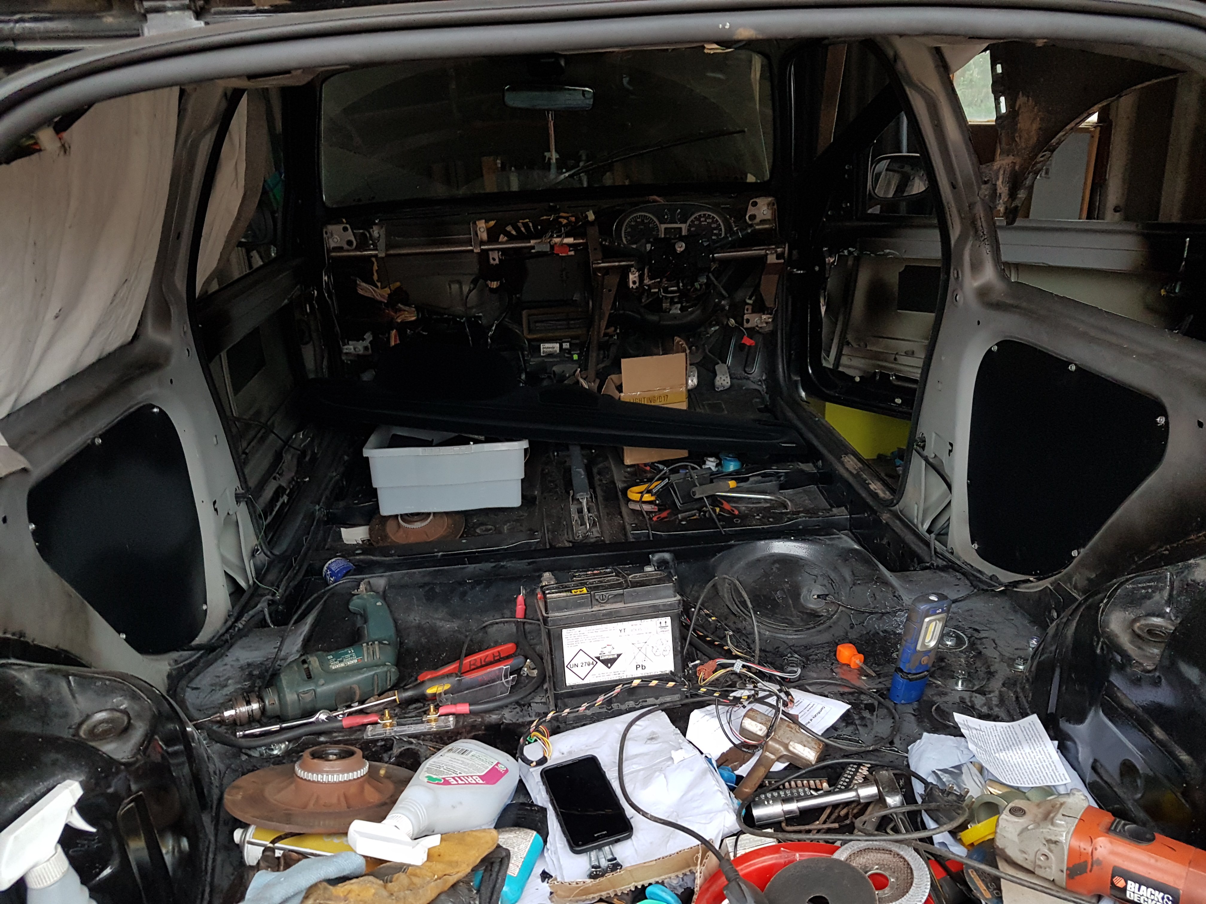

Interiors cage ready.

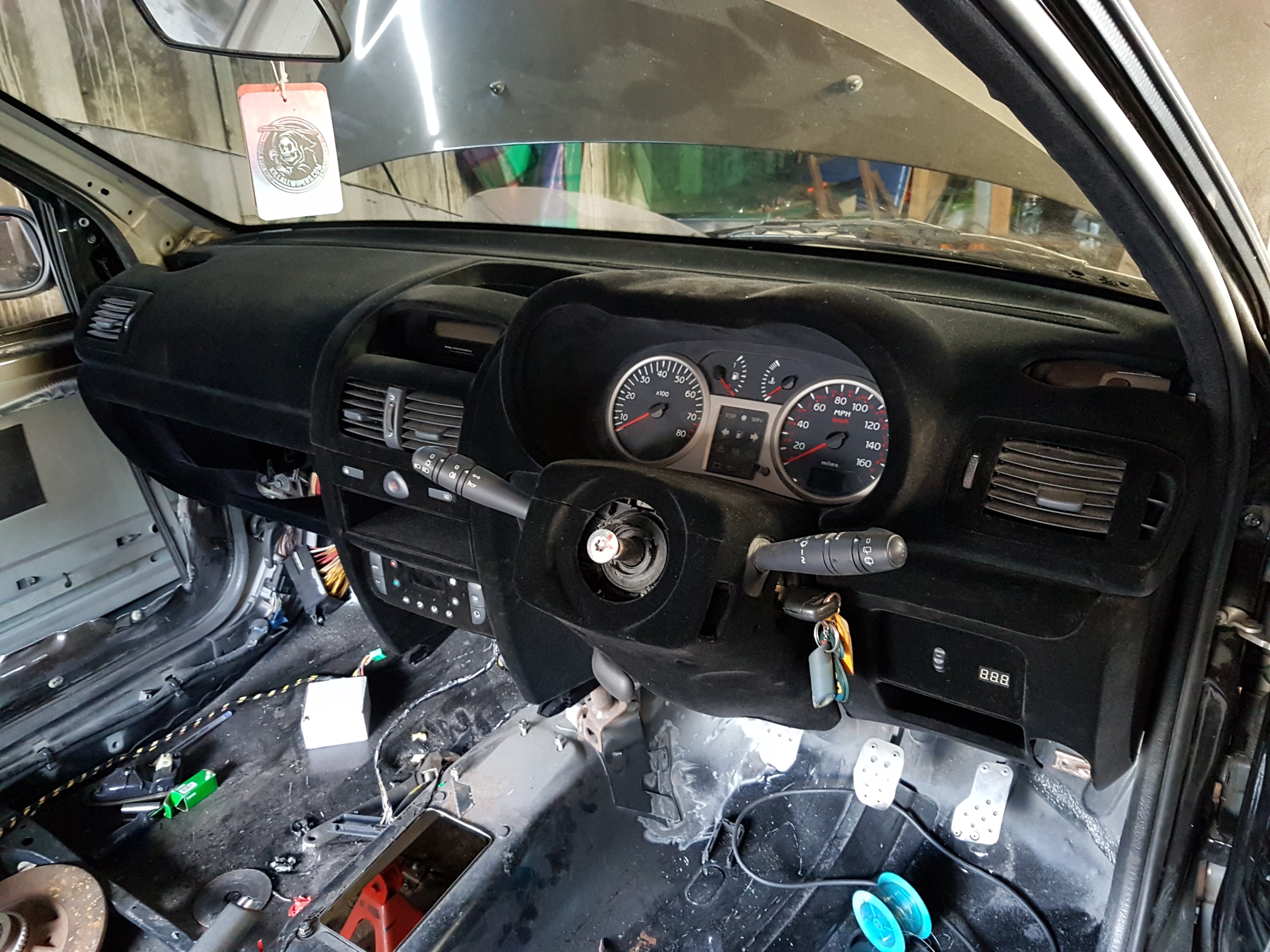

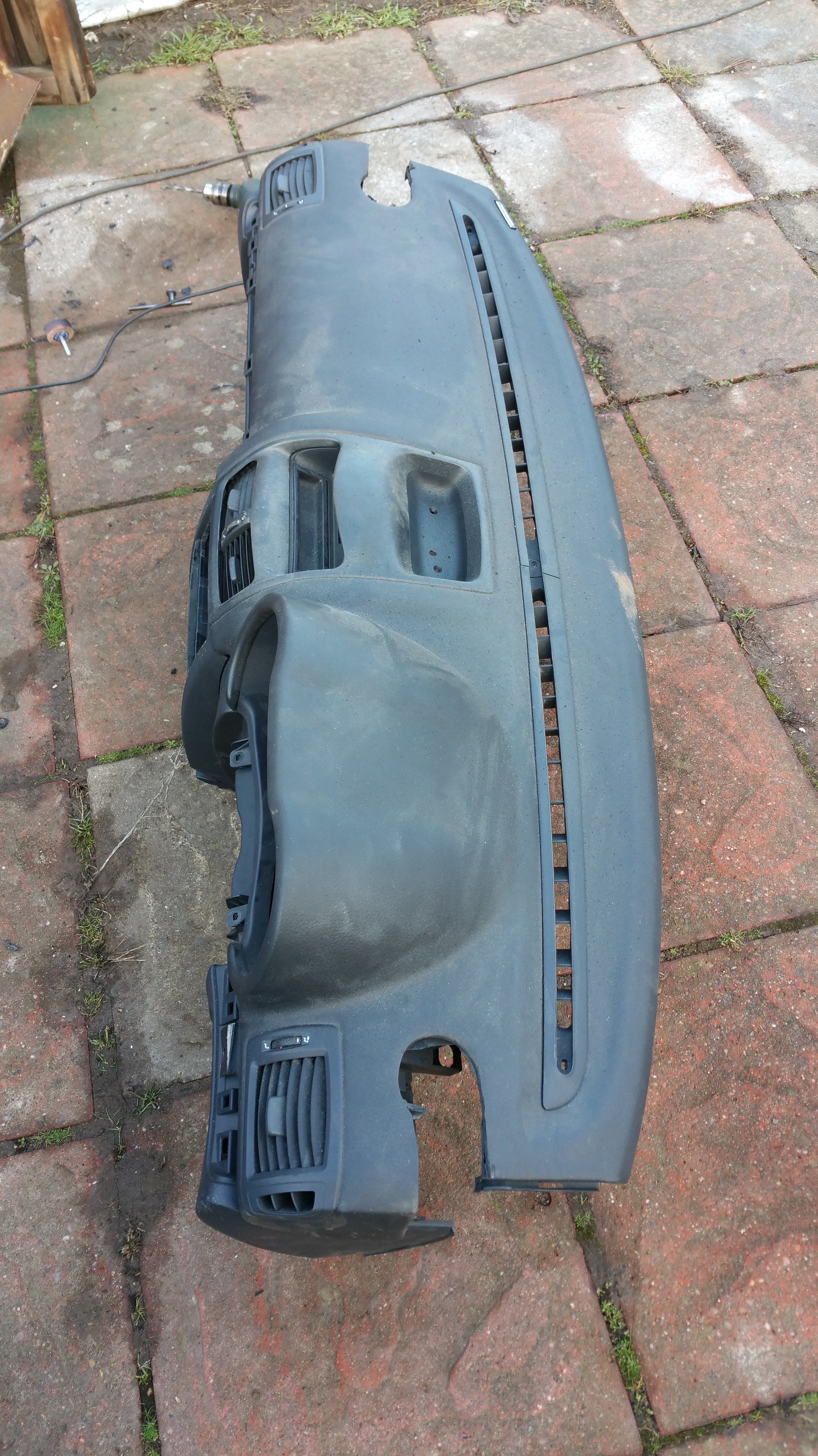

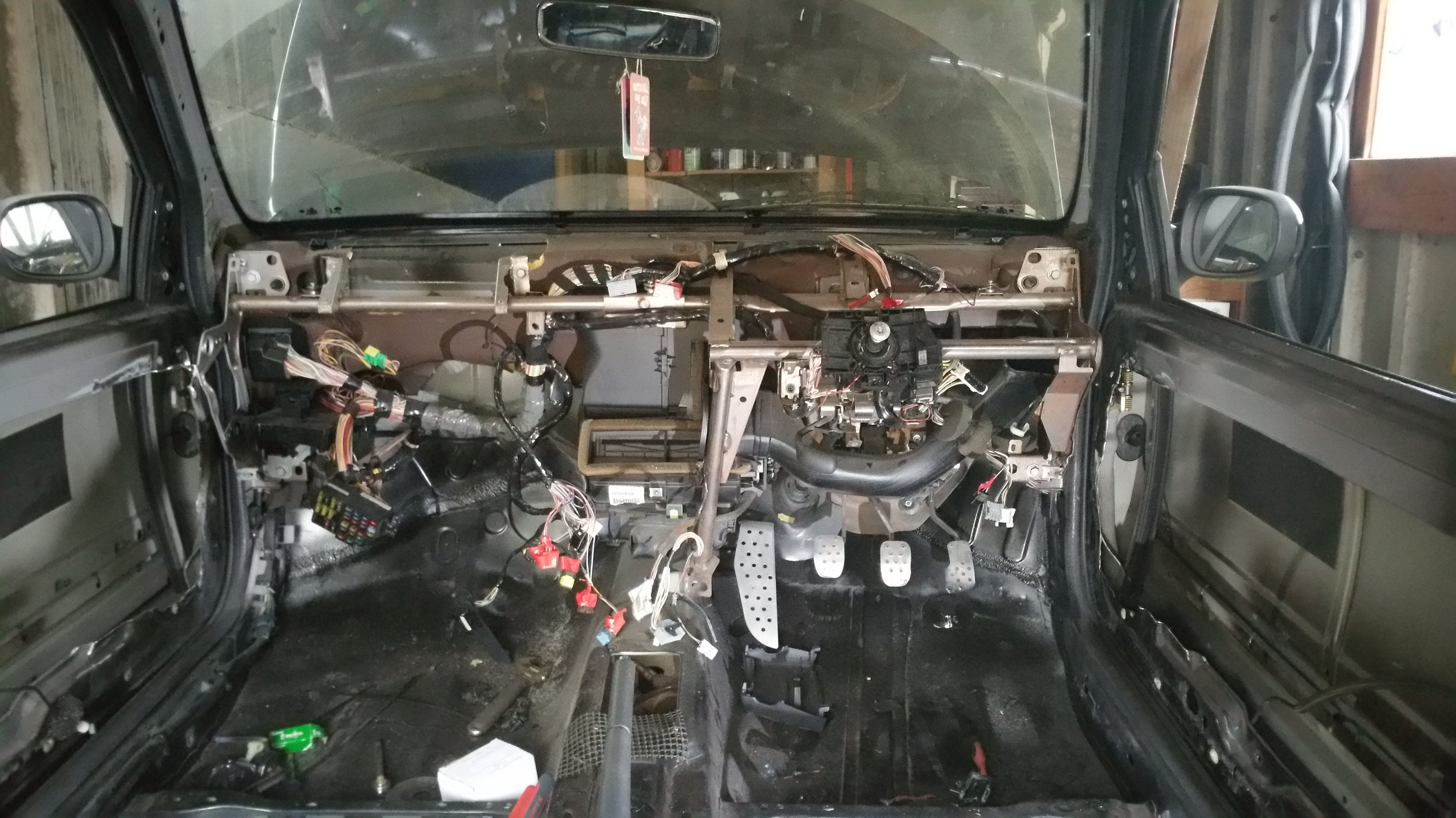

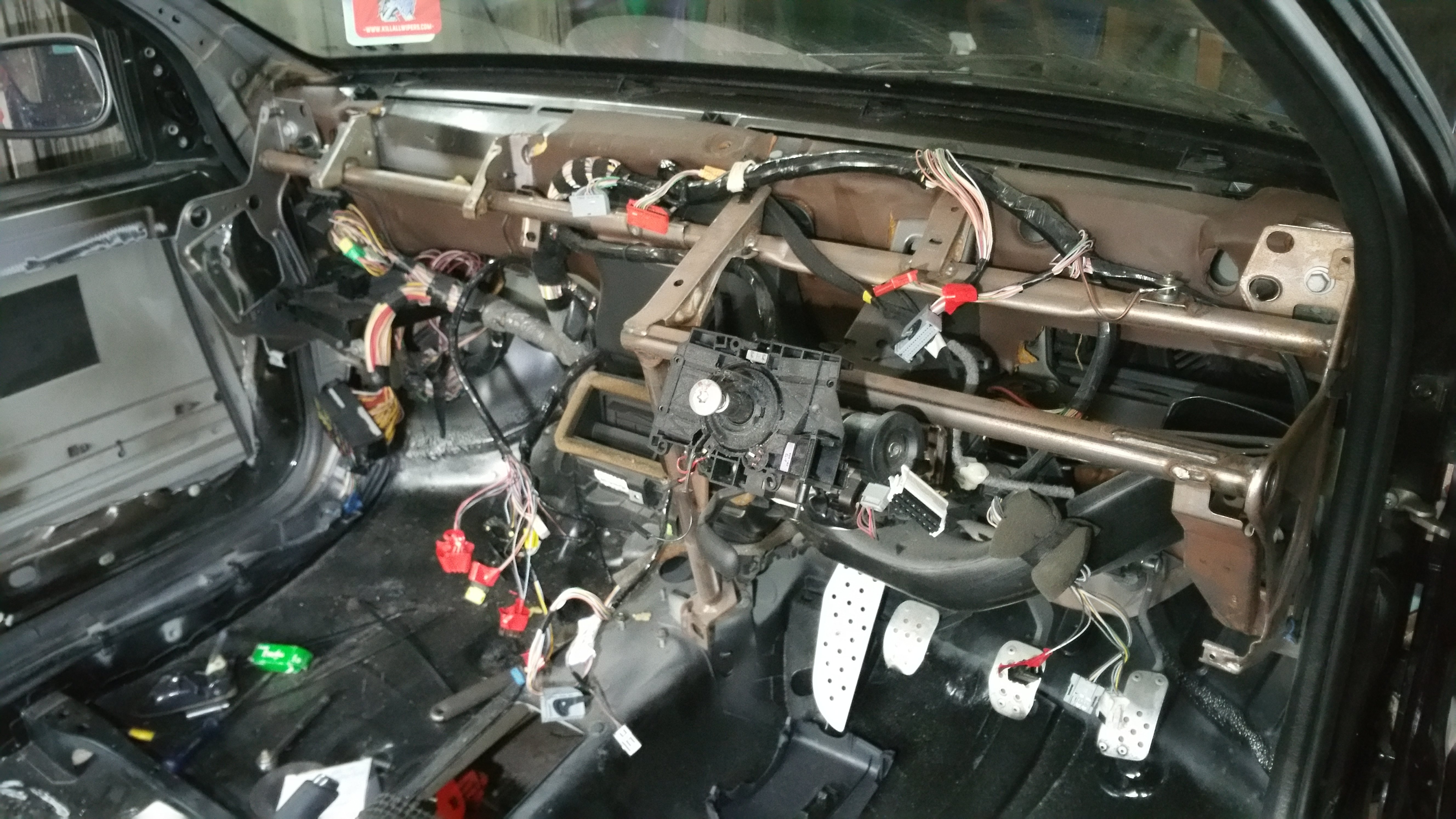

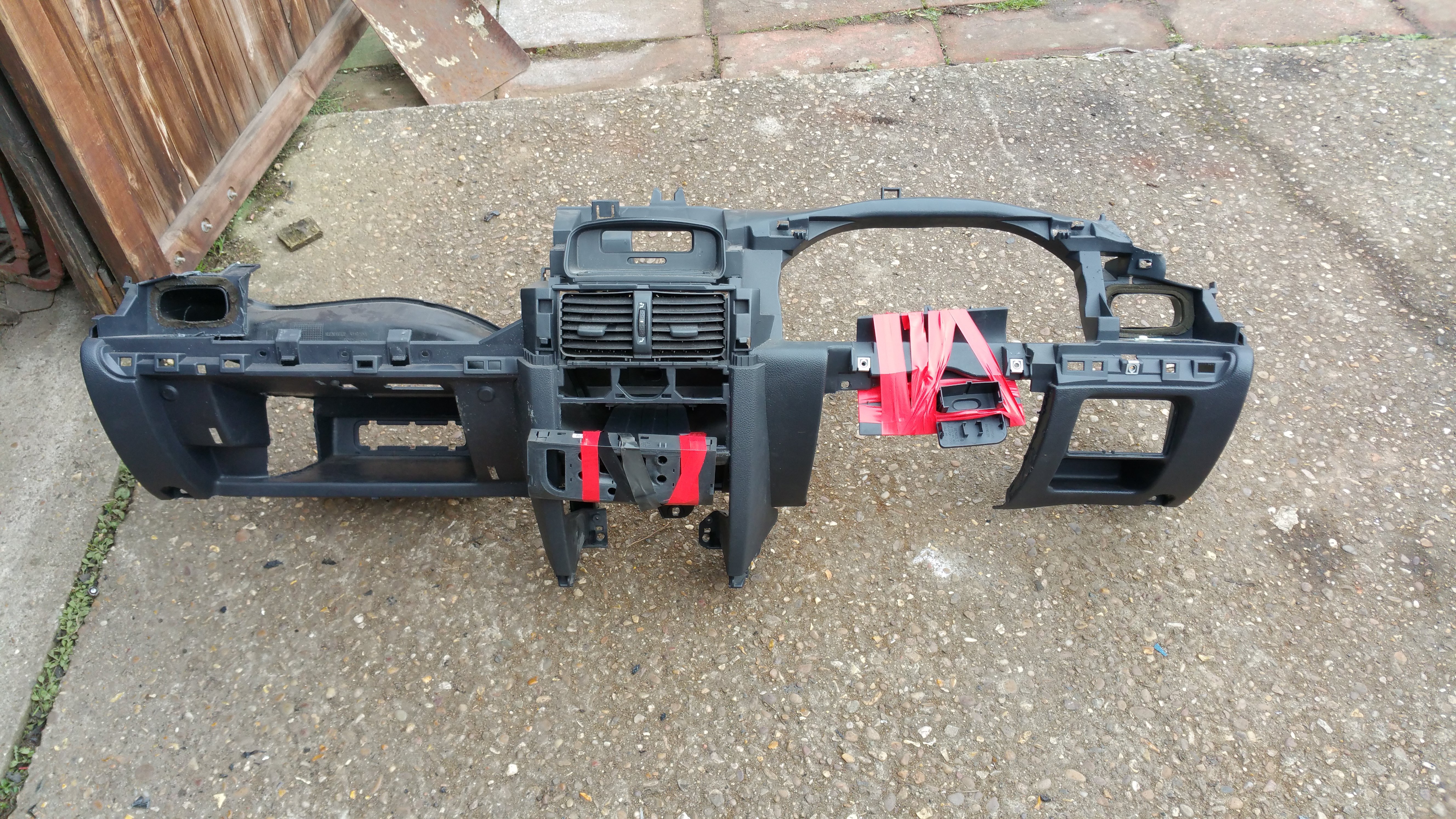

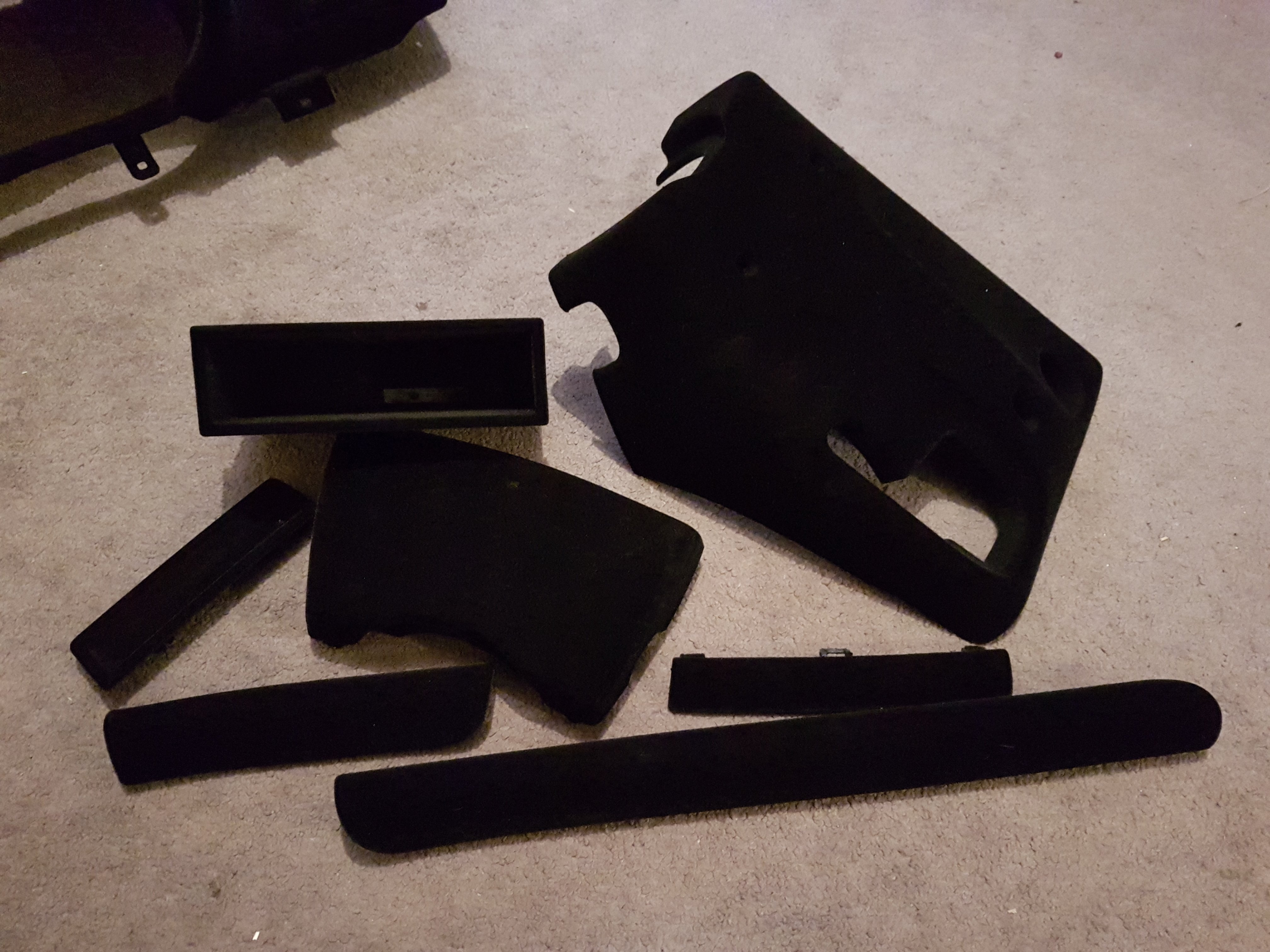

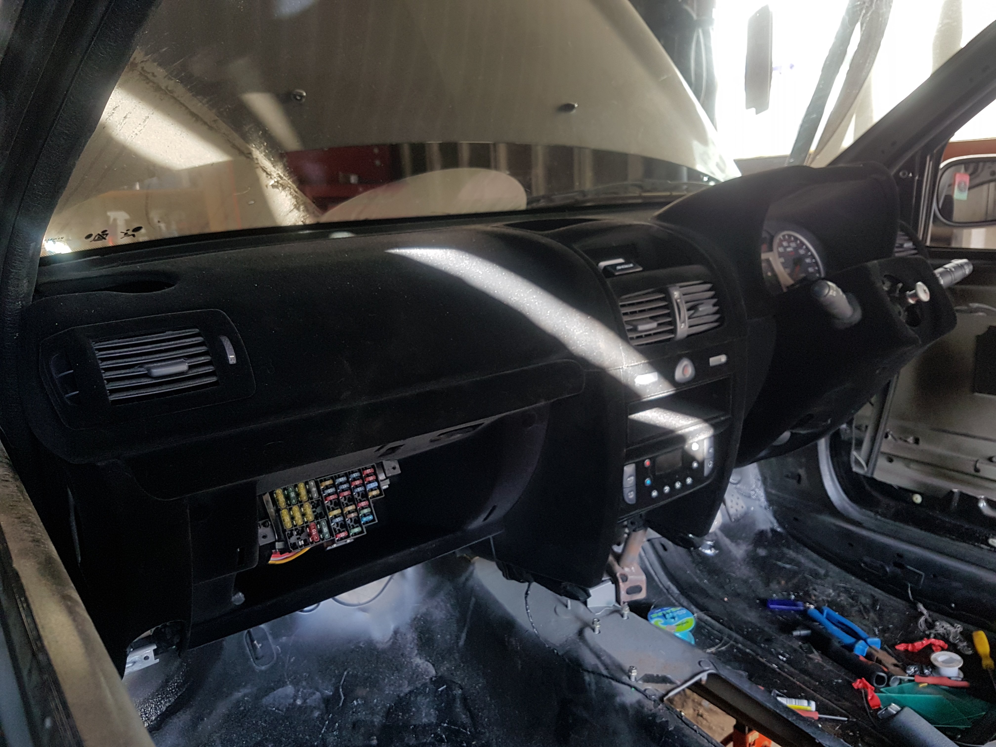

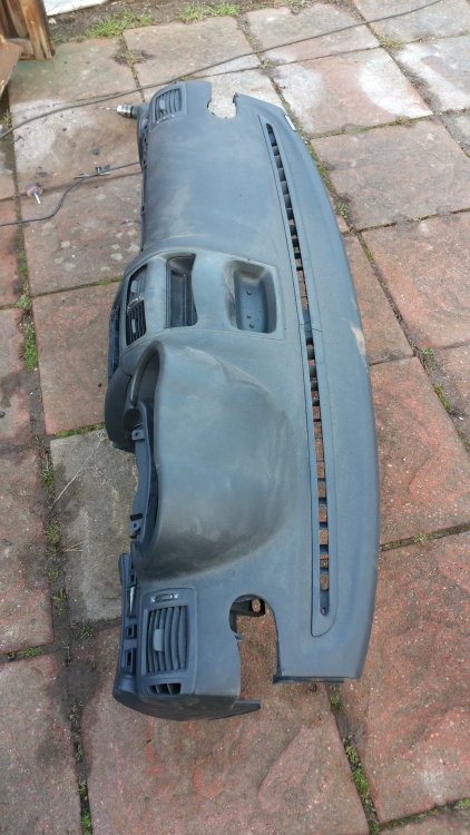

Rest of the dash stripped out ready to go to flocking with the top half, not sure I'll have to trim any of it to fit round the cage so I might hold off flocking for the minute.
More wiring gone so now all that's left are the essentials to run what's left in it.

Dash is all trimmed ready to fit round the cage

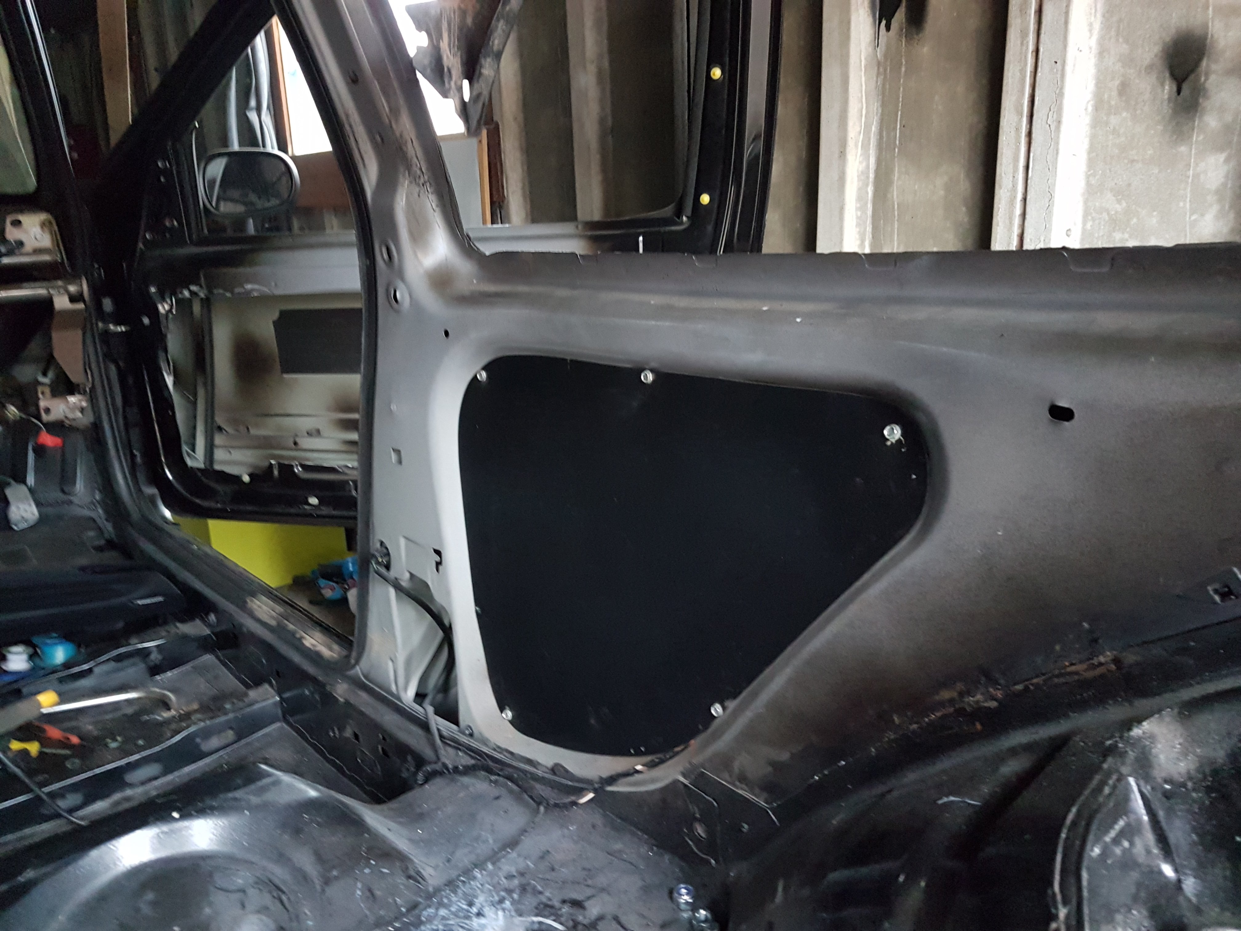

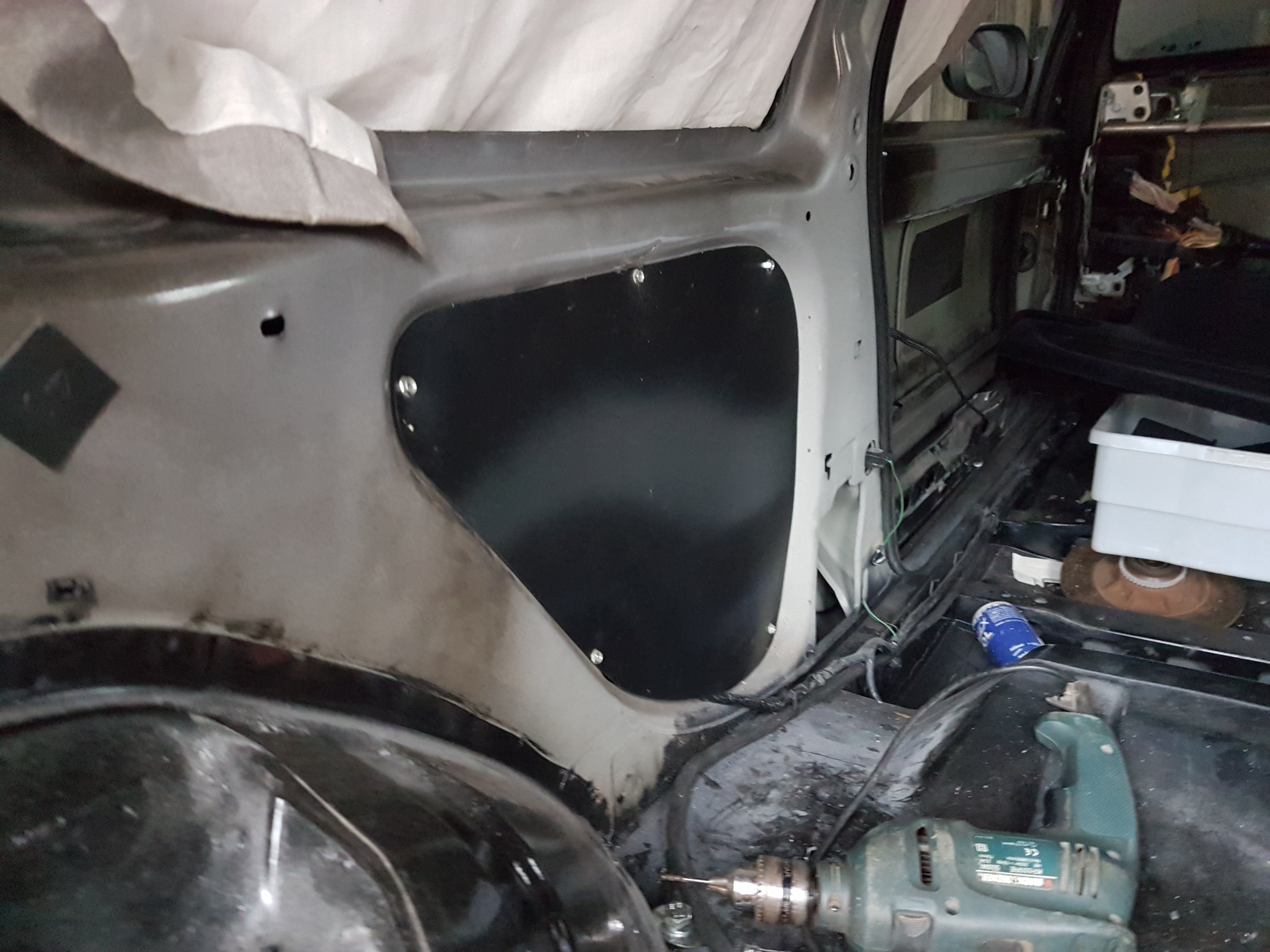

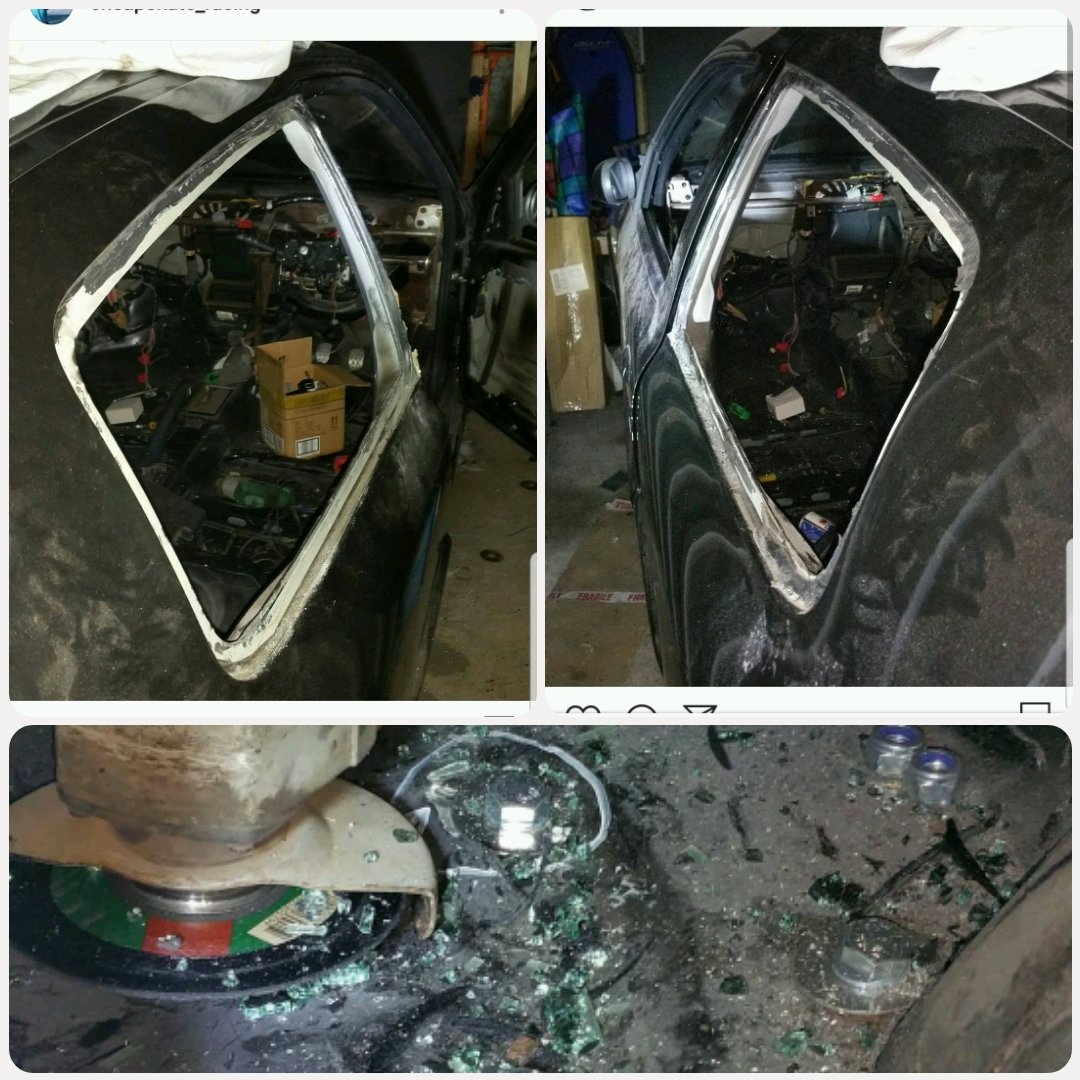

Rear quarter windows removed........with force :D

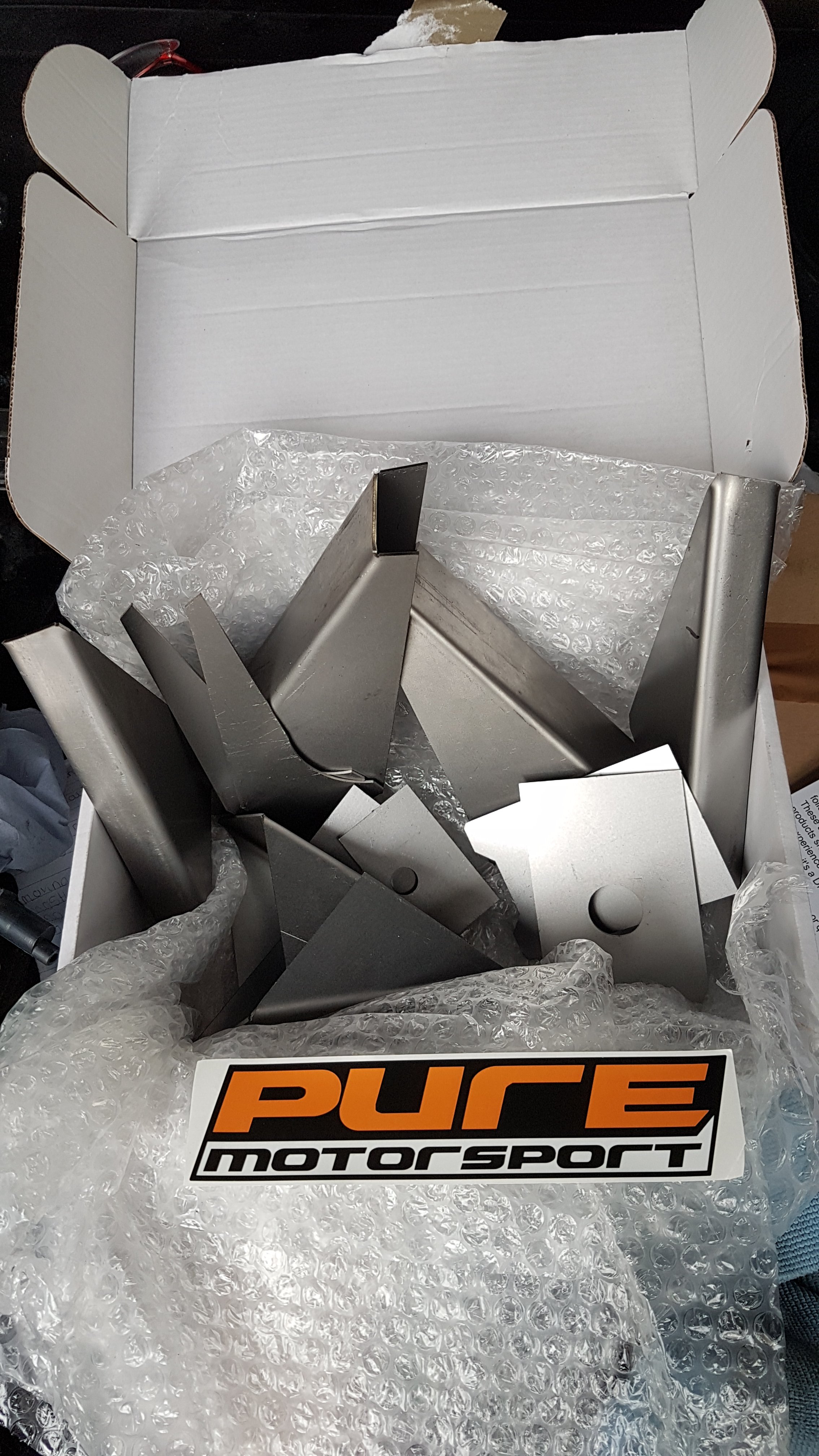

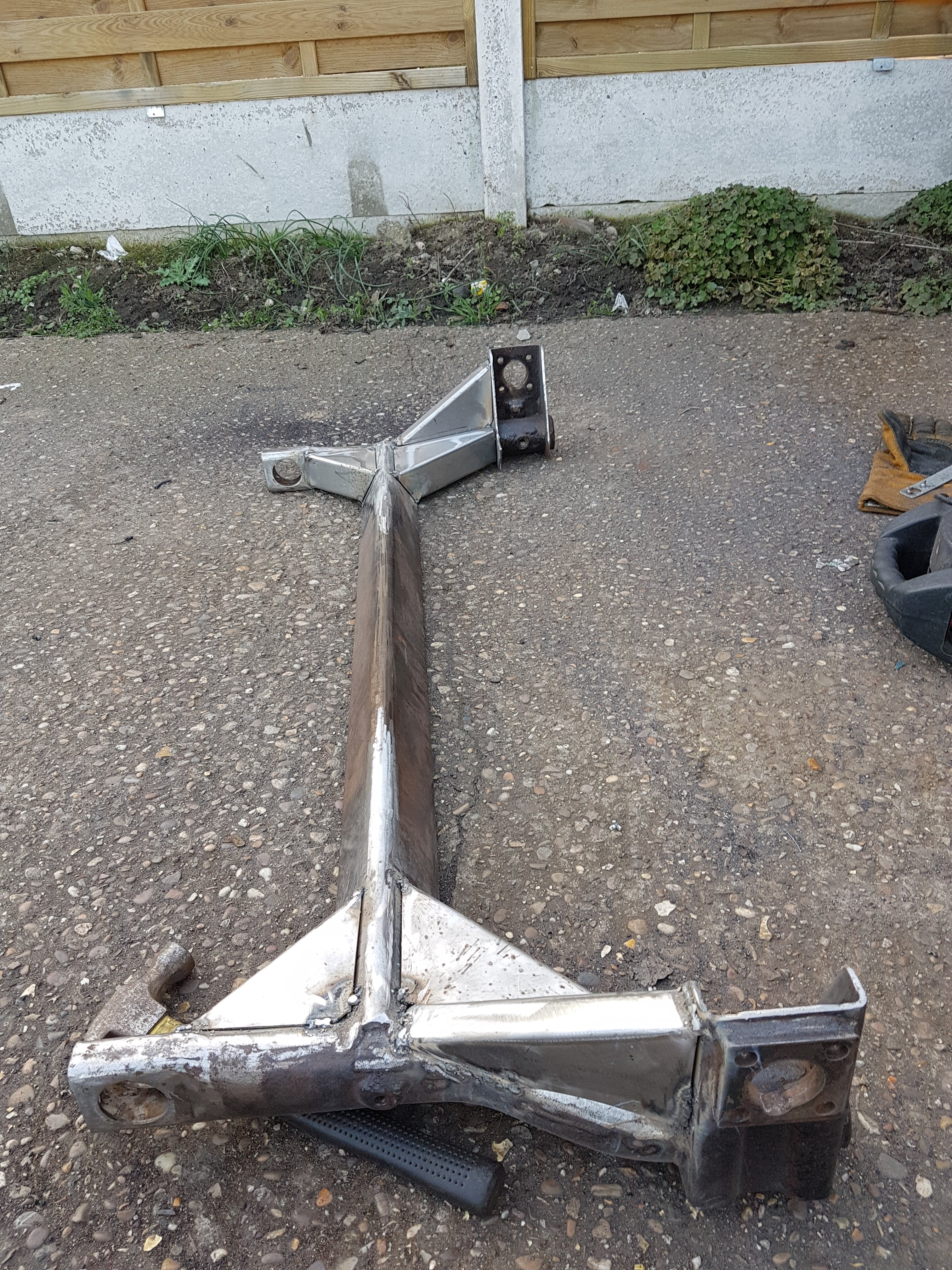

PMS rear axle strengthening kit order.

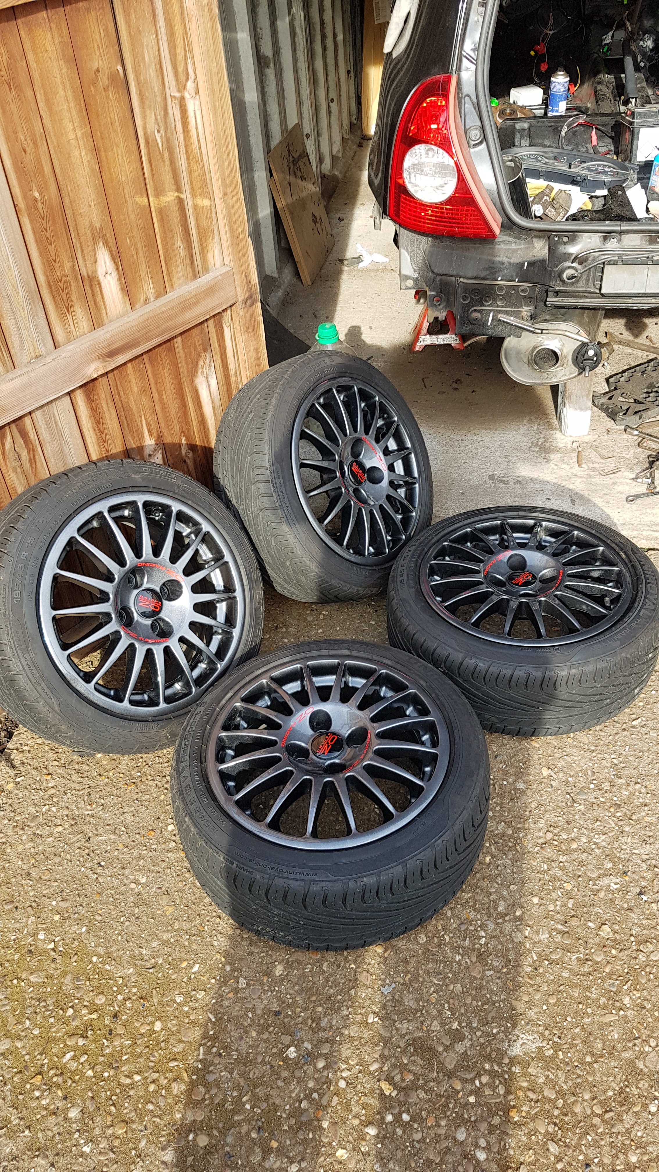

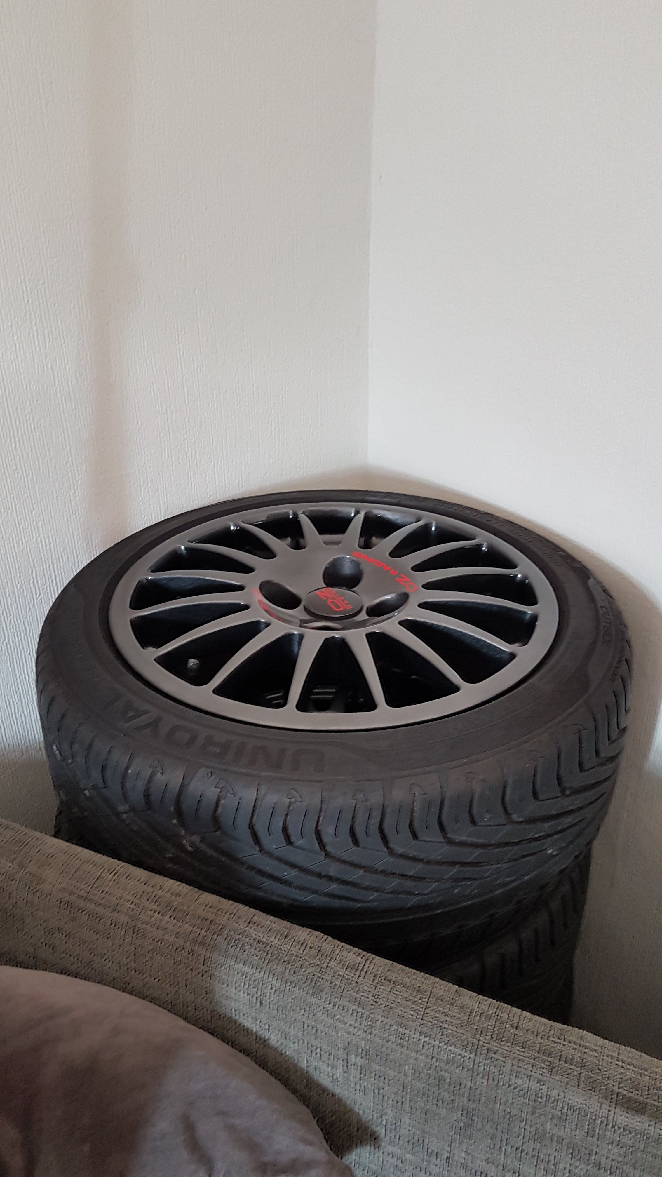

Wheels collected and living in the house :D

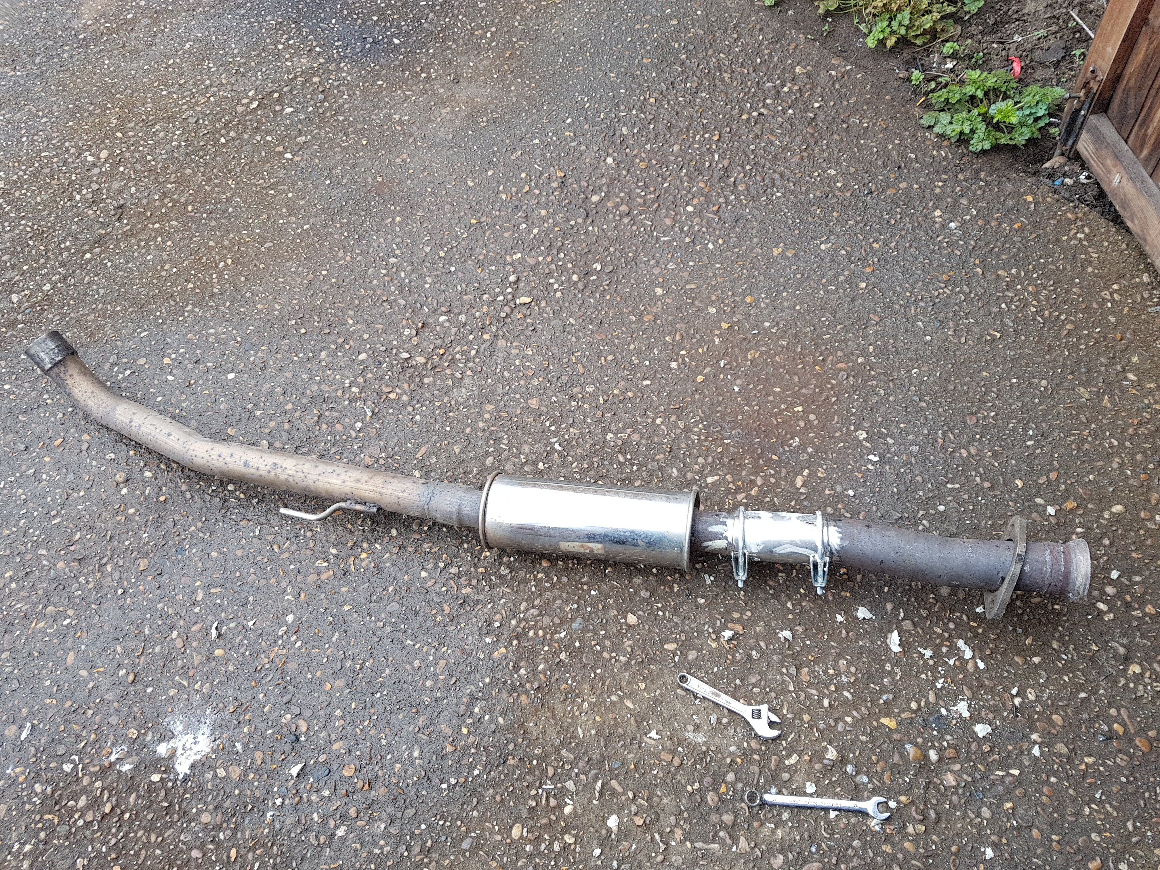

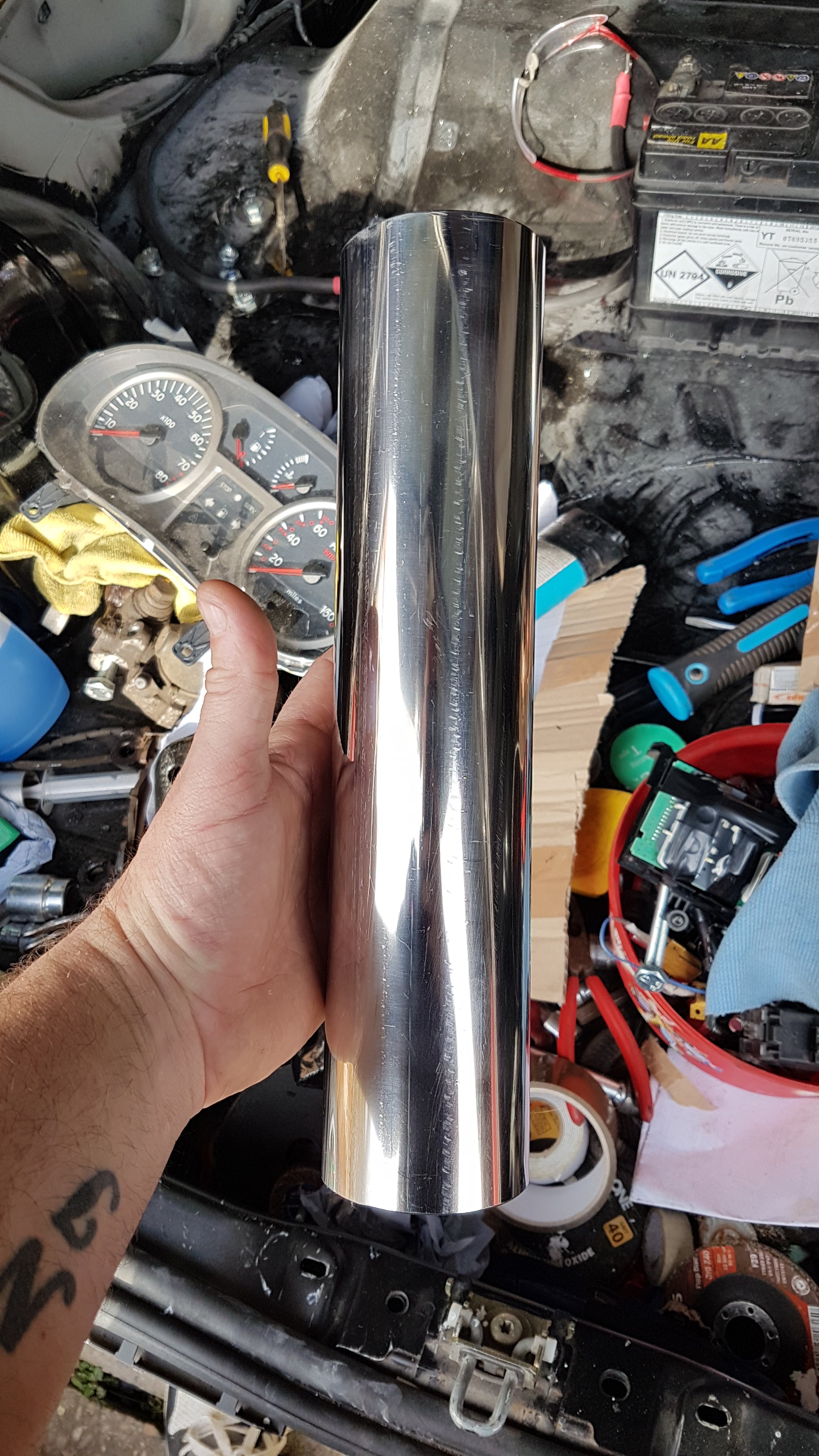

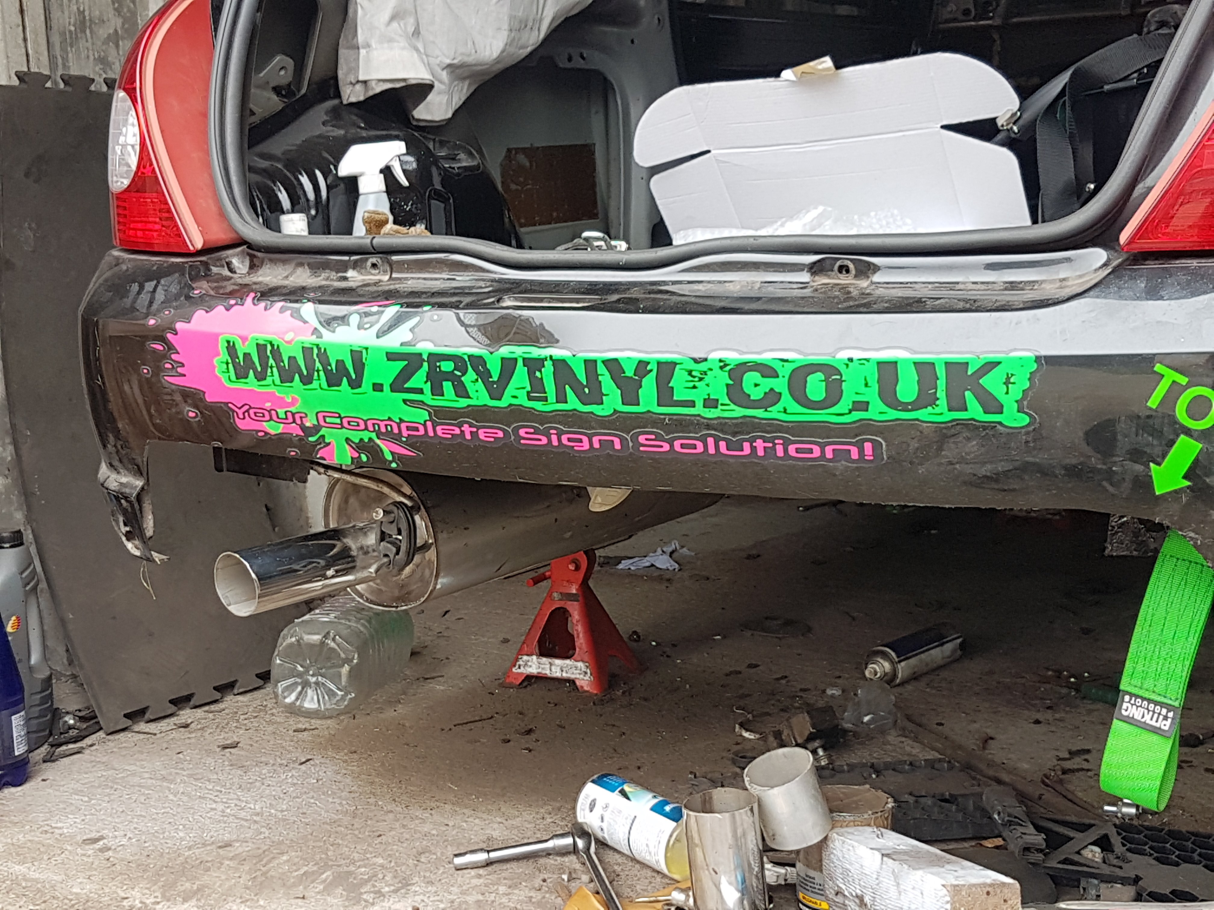

tailpipe all polished up from its raw state.
Rear axle strengthening kit turned up from PMS :)

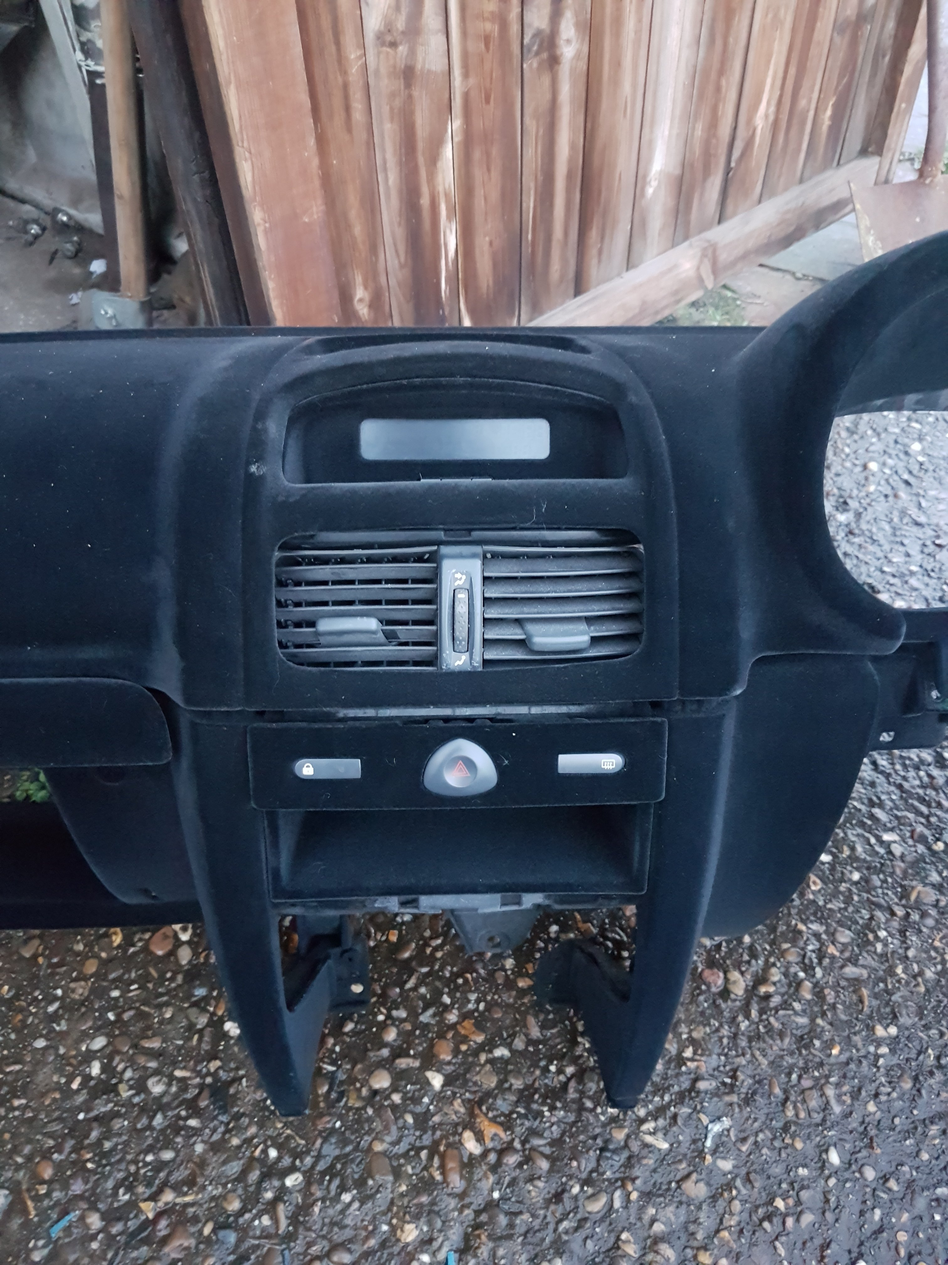

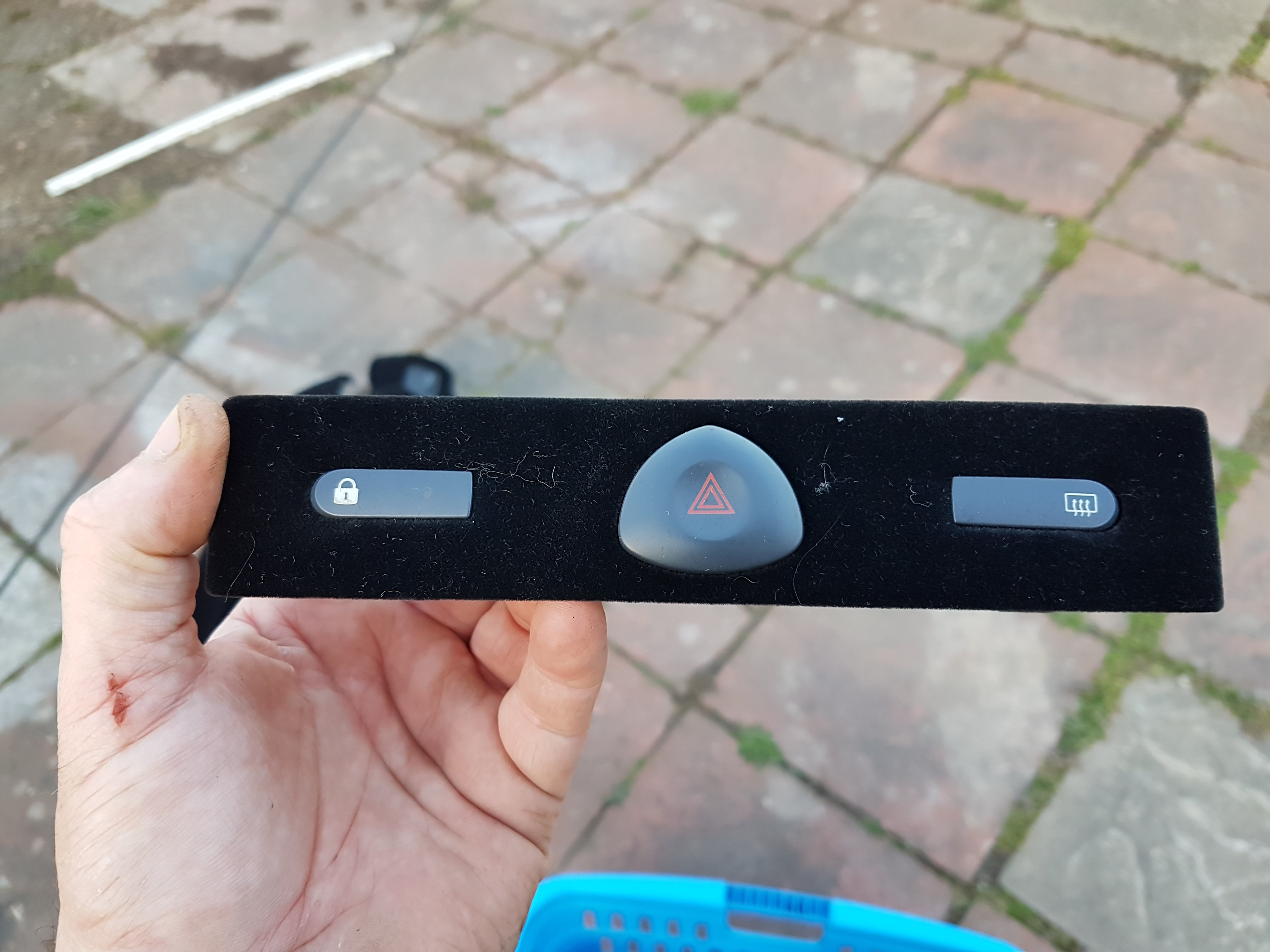

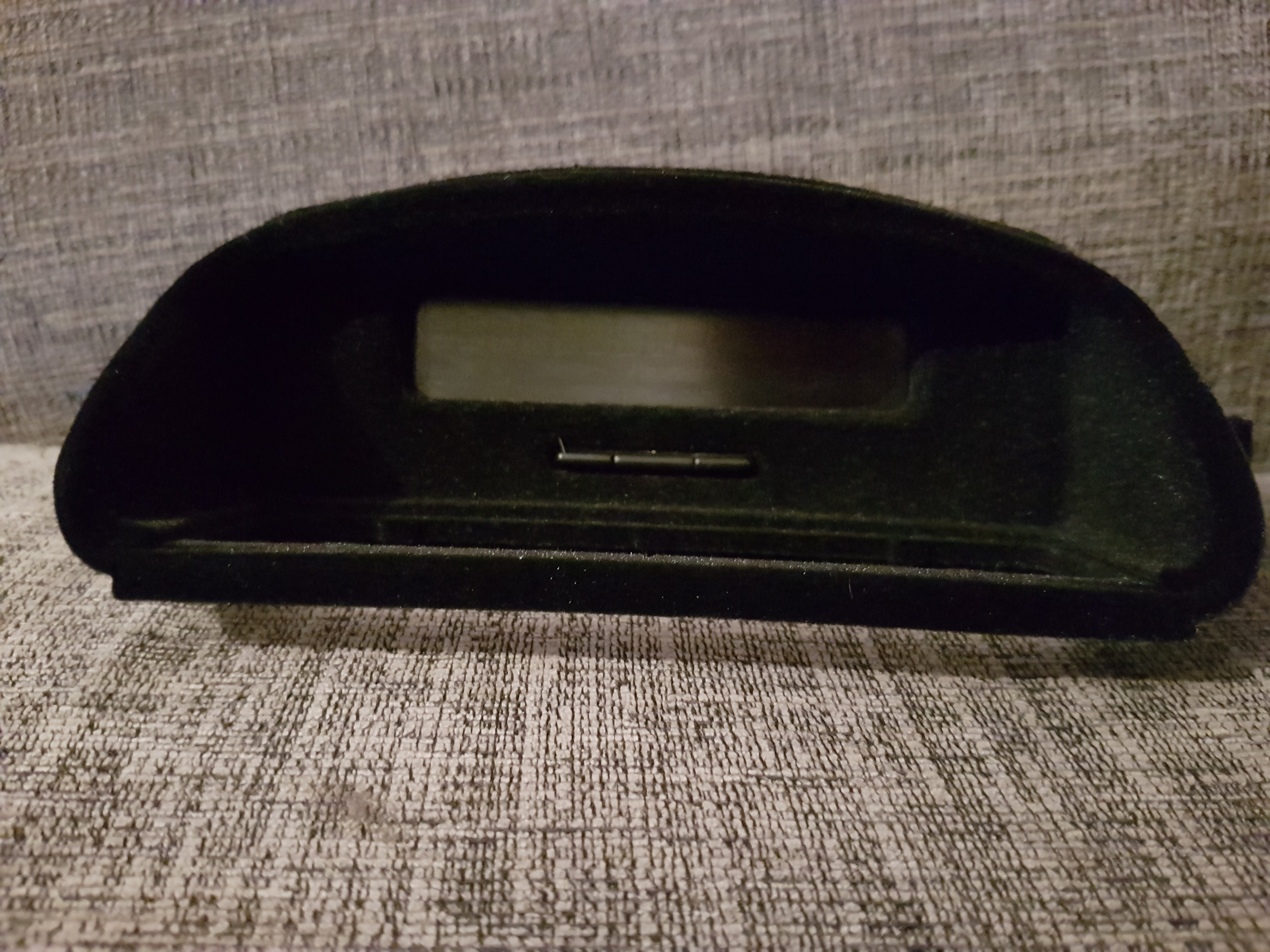

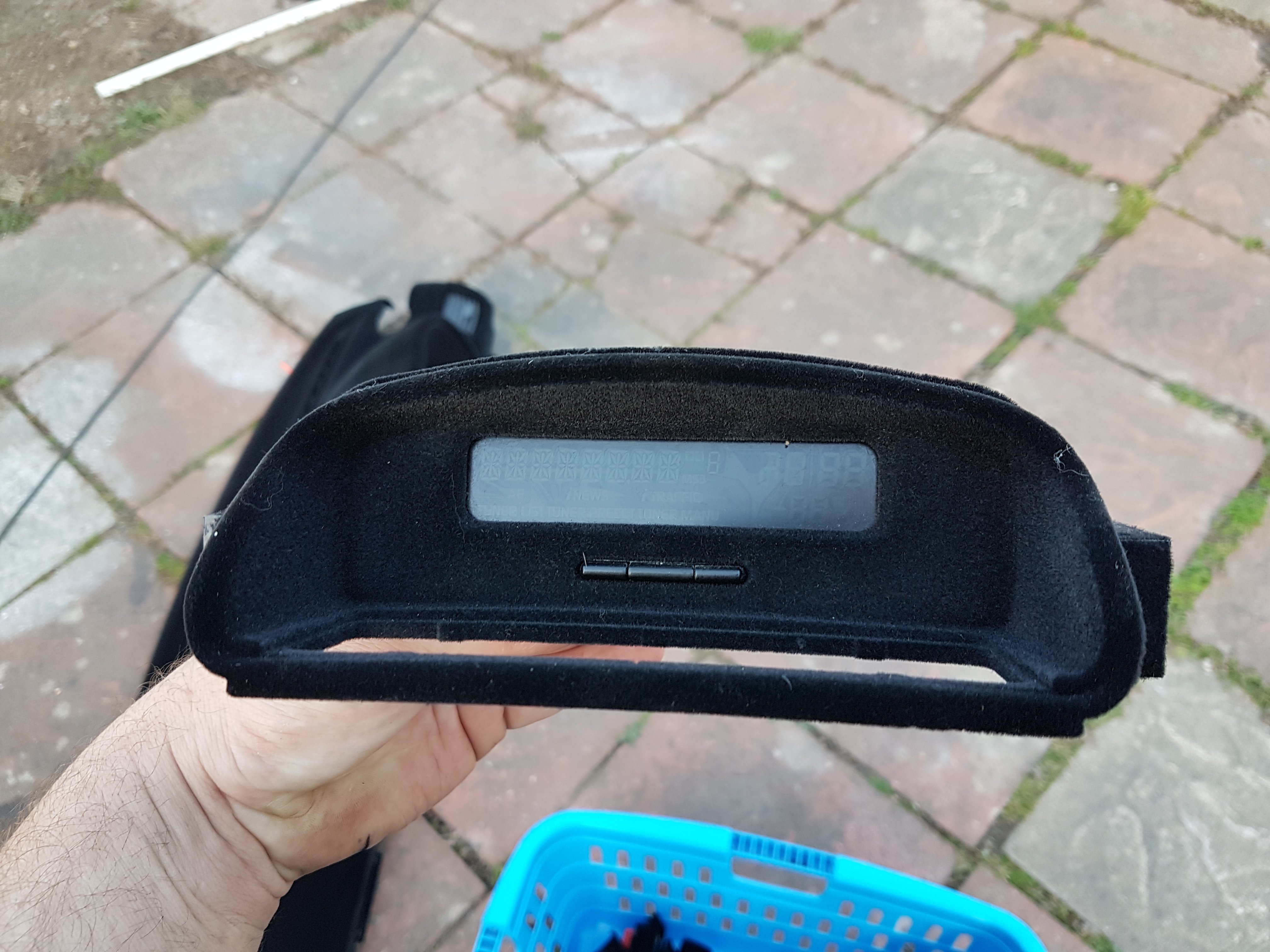

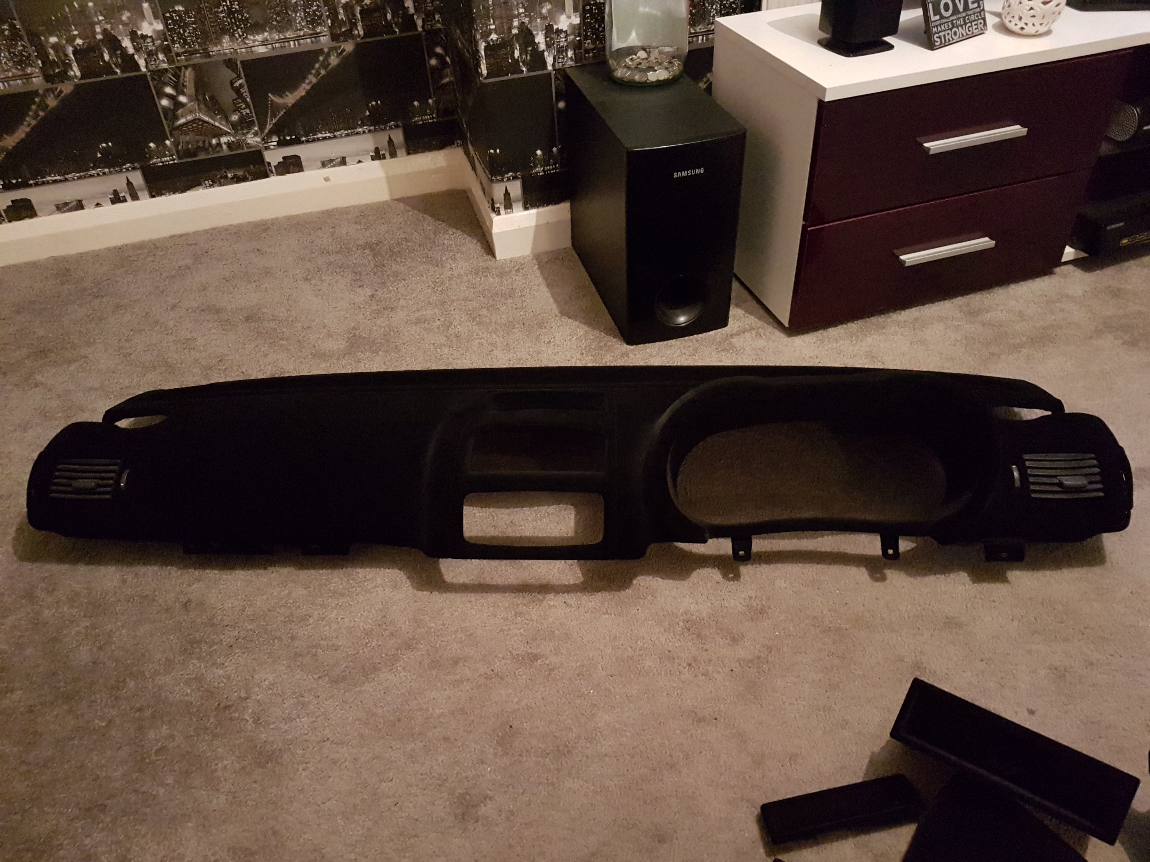

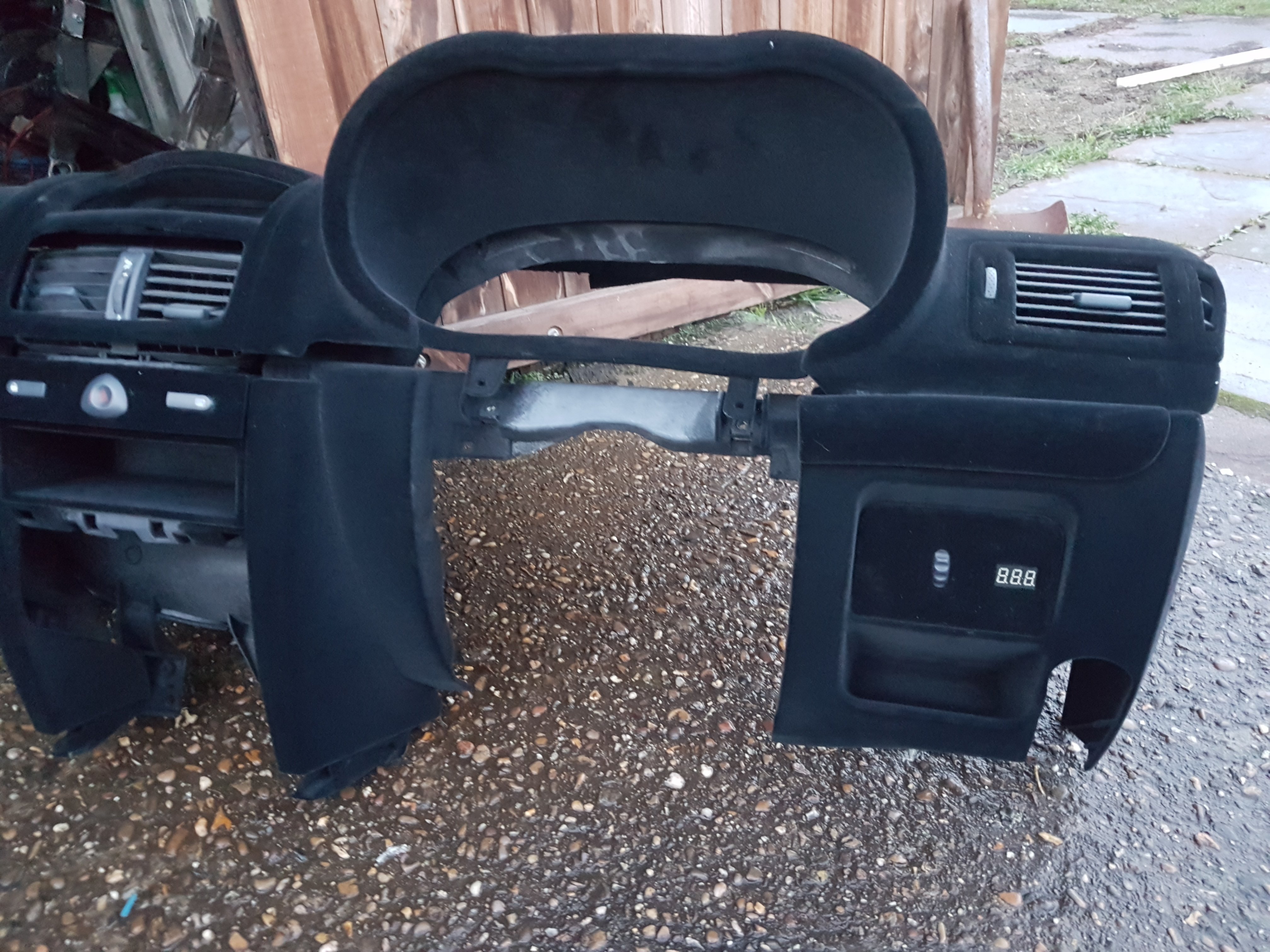

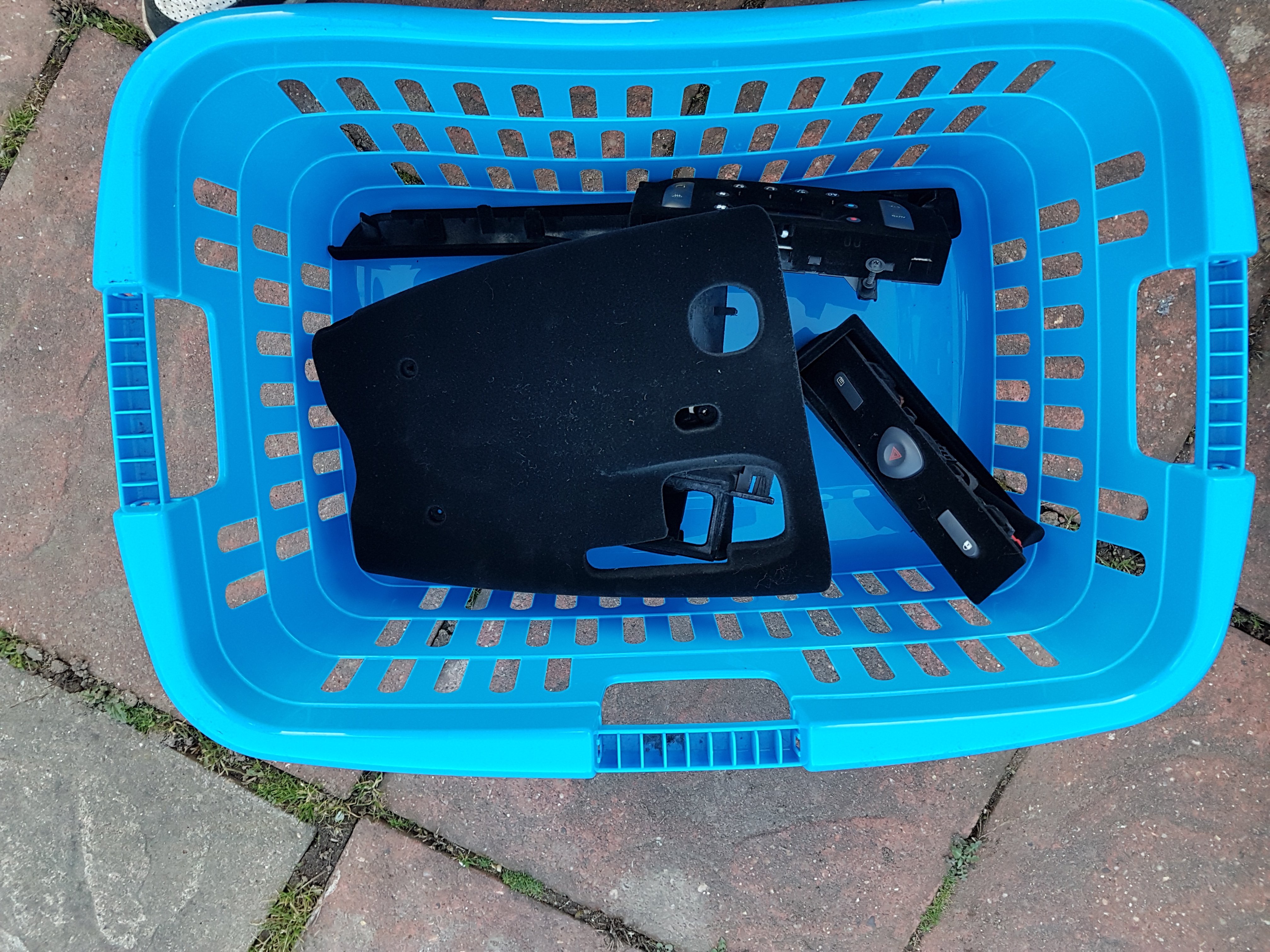

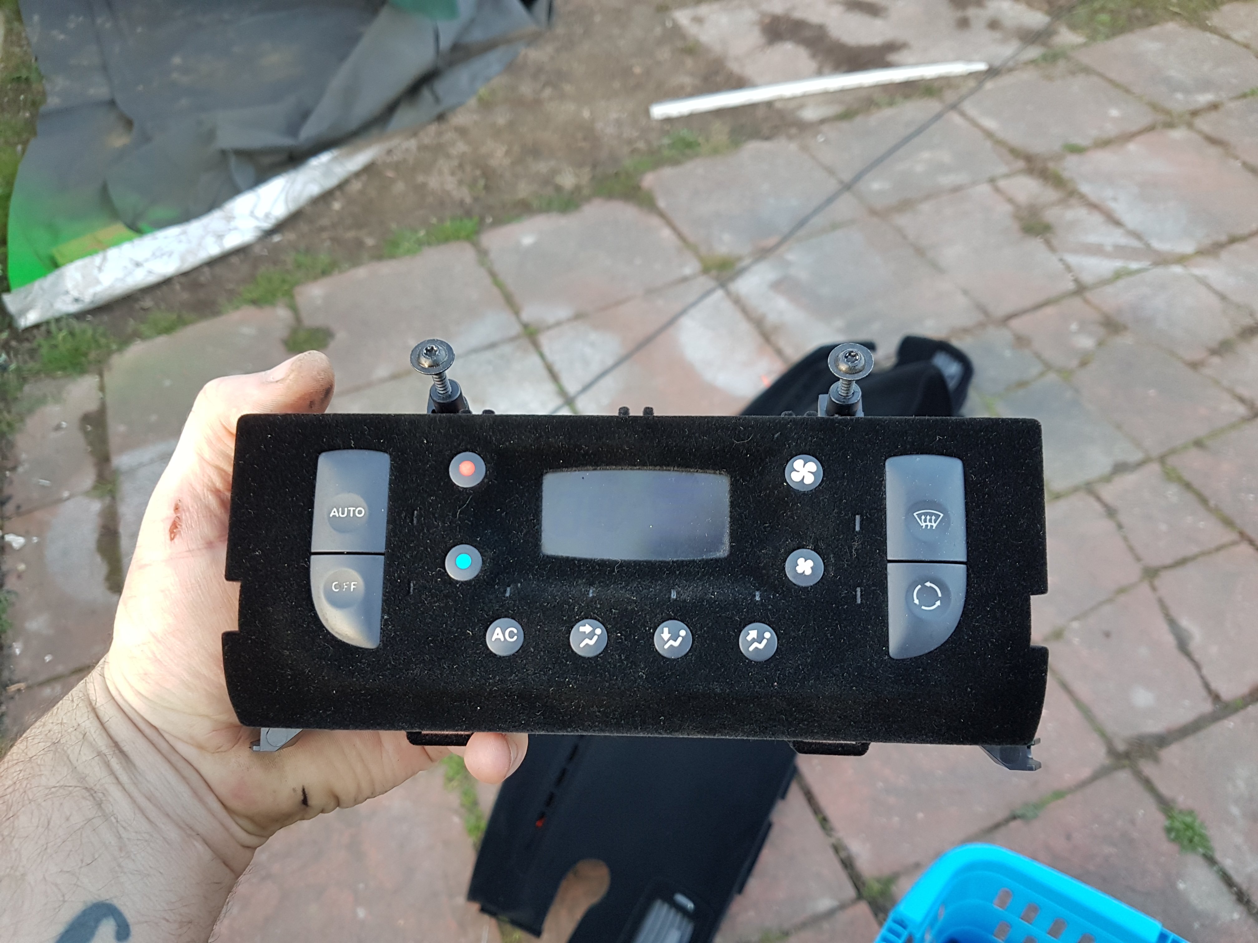

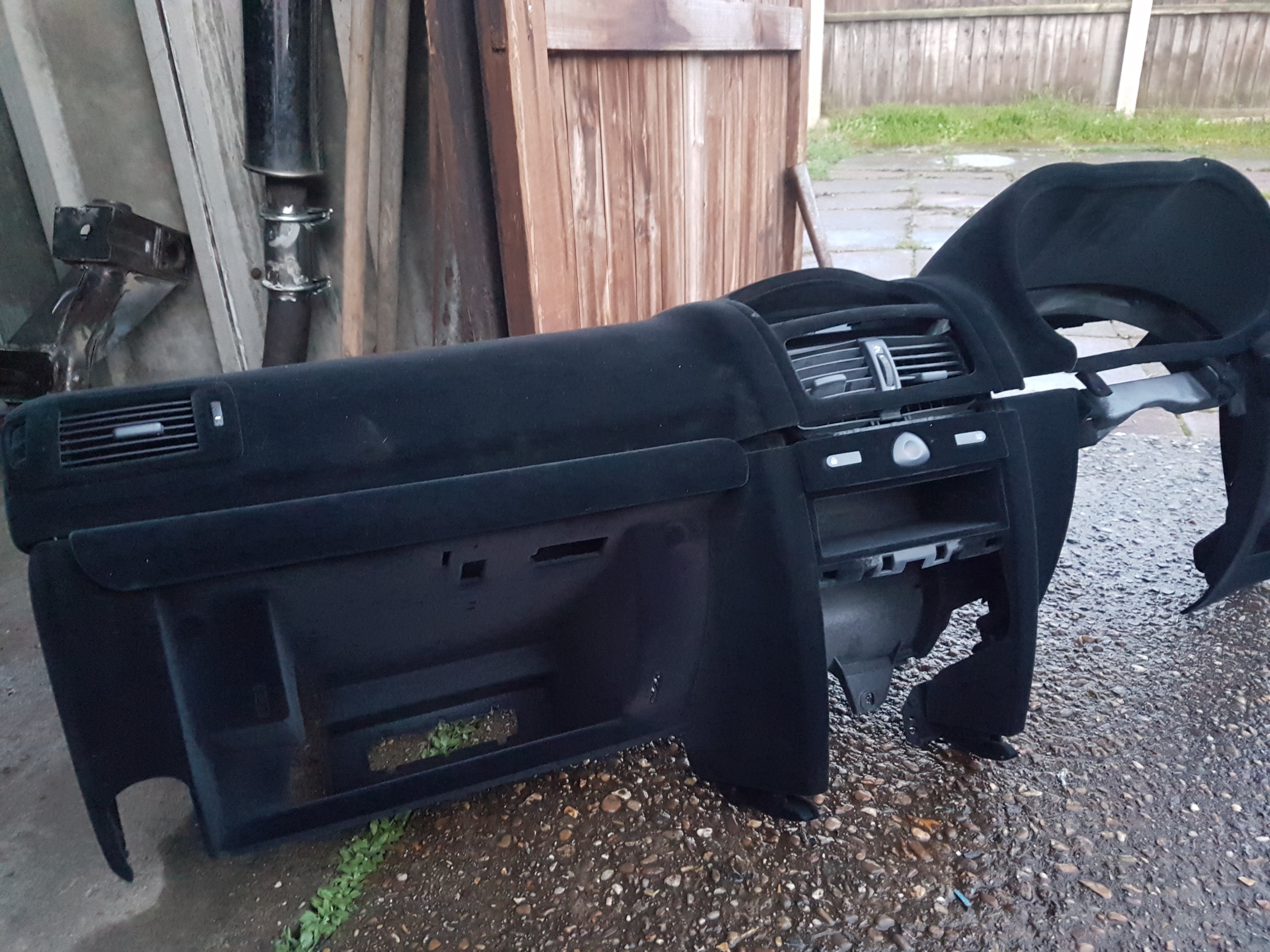

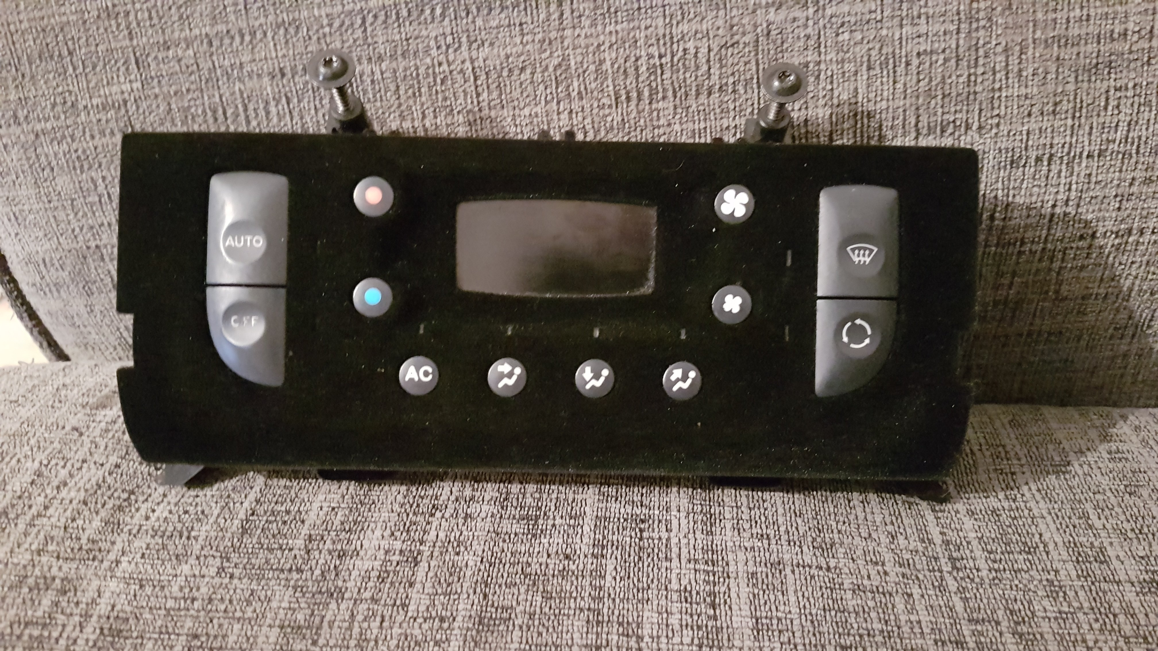

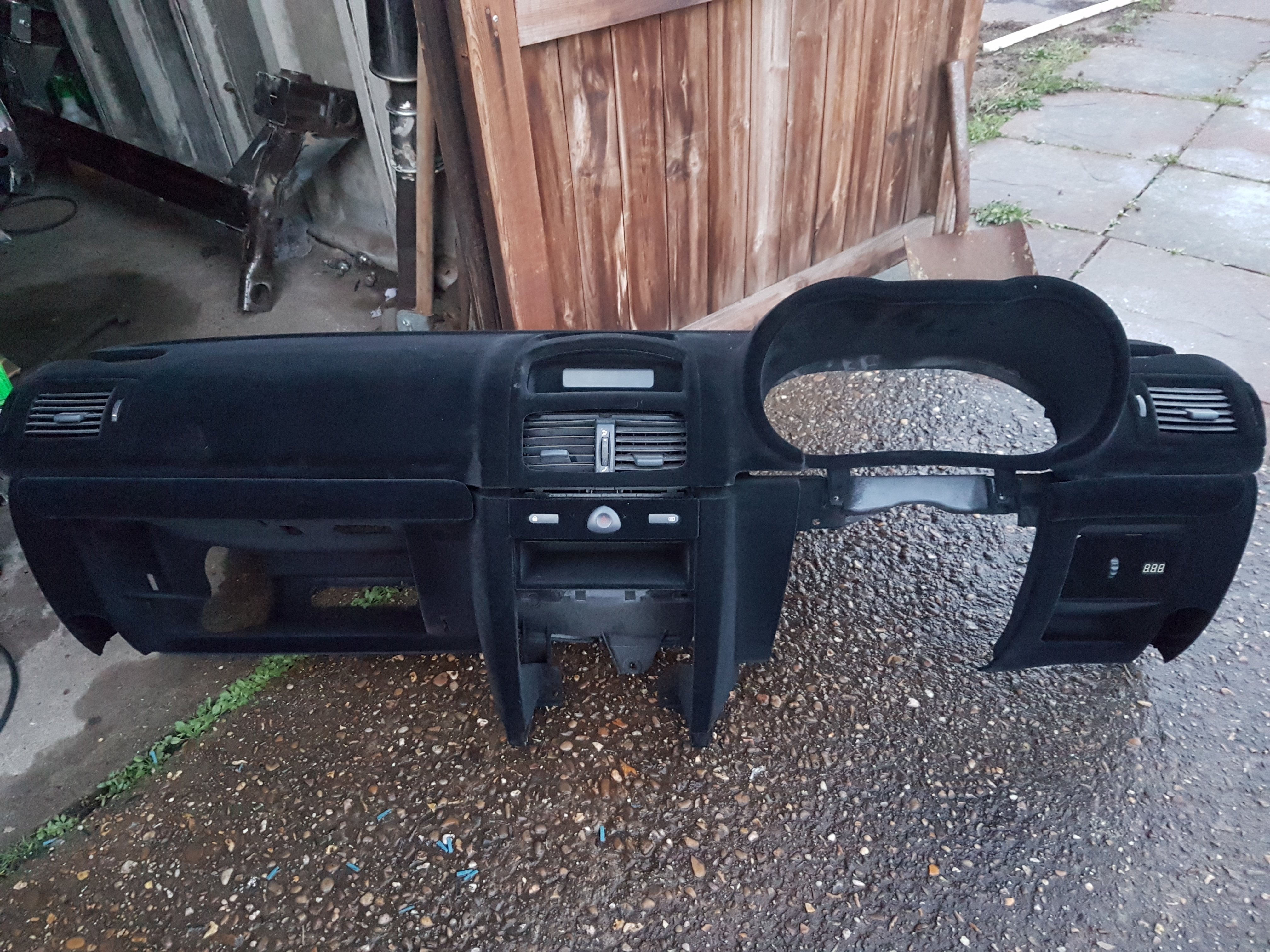

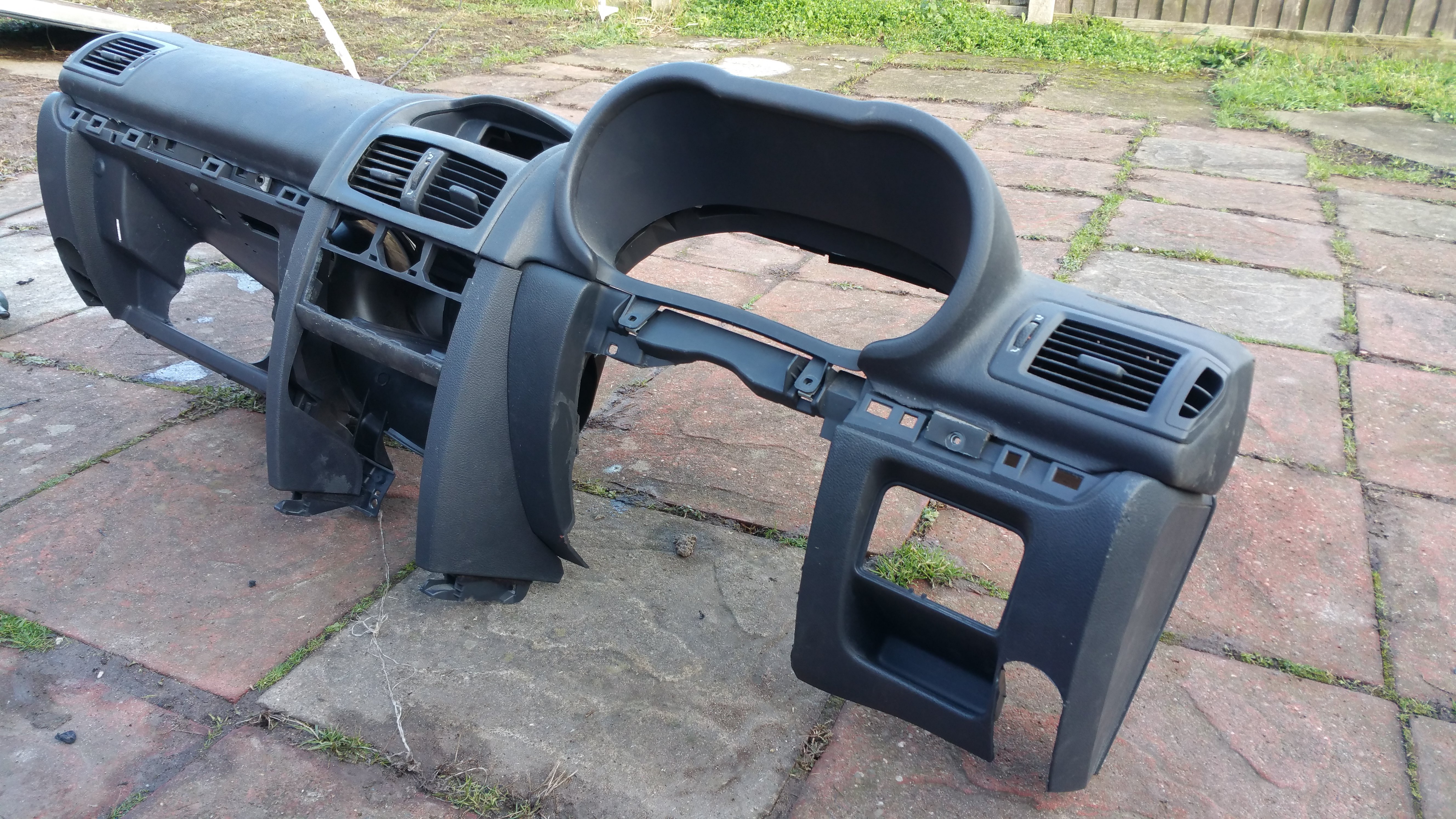

Dash and all the little bits are flocked and ready to collect. Only dropped it off sunday :)

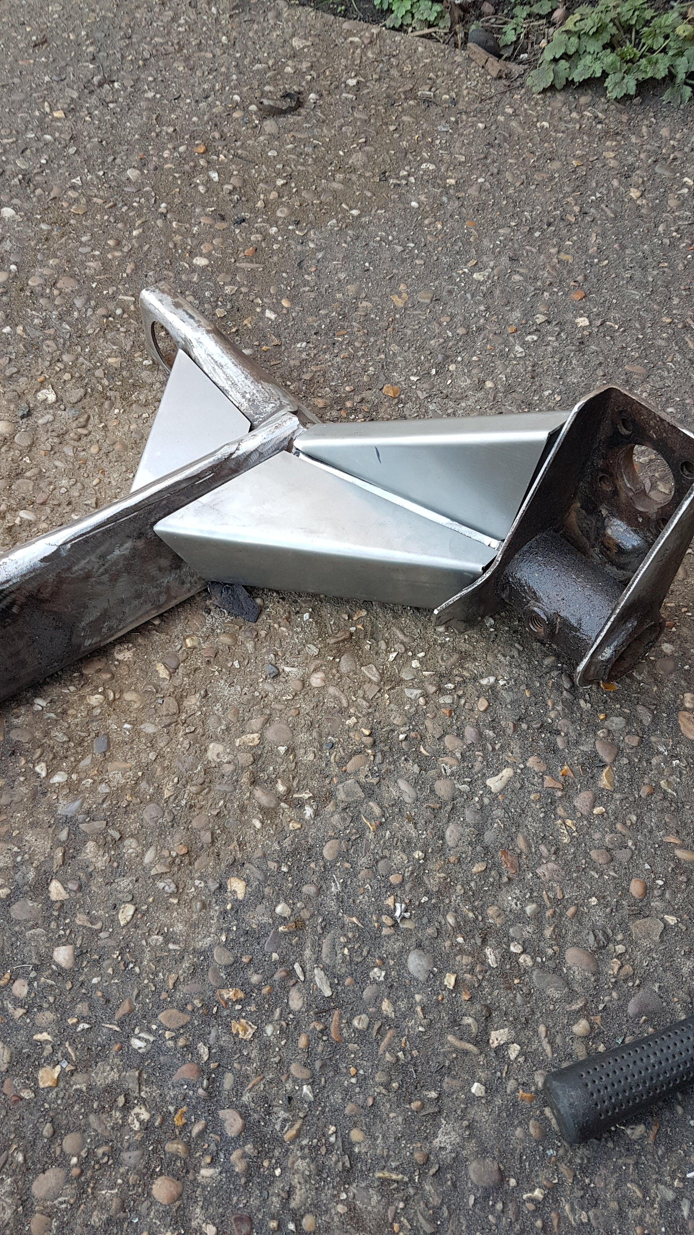

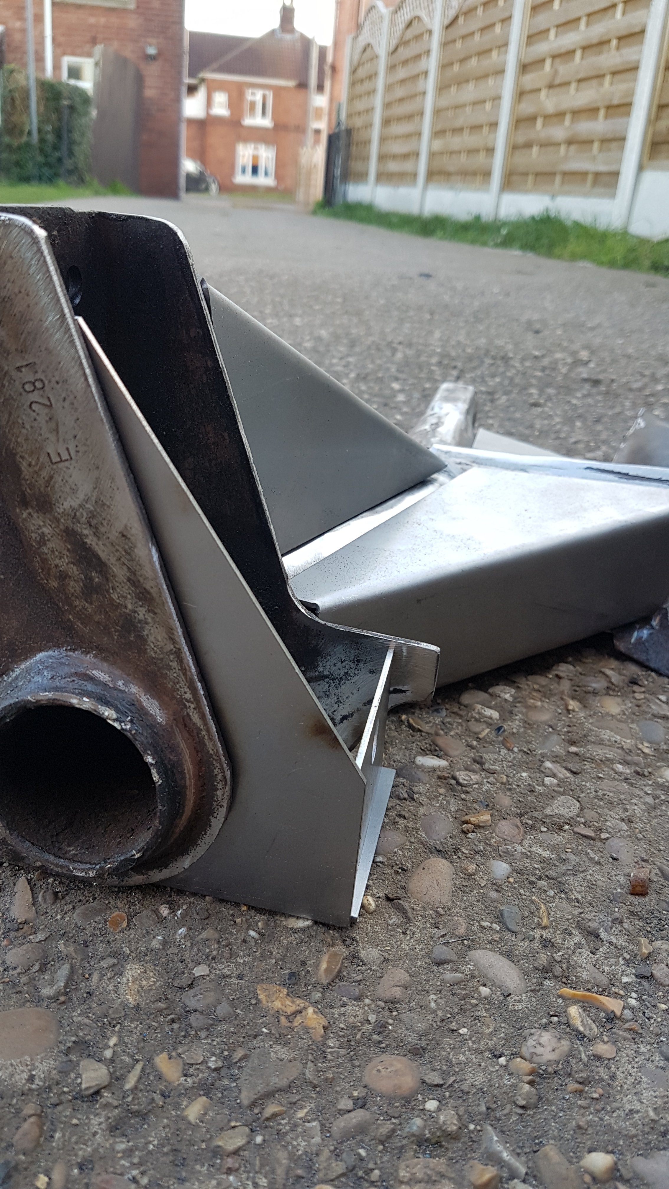

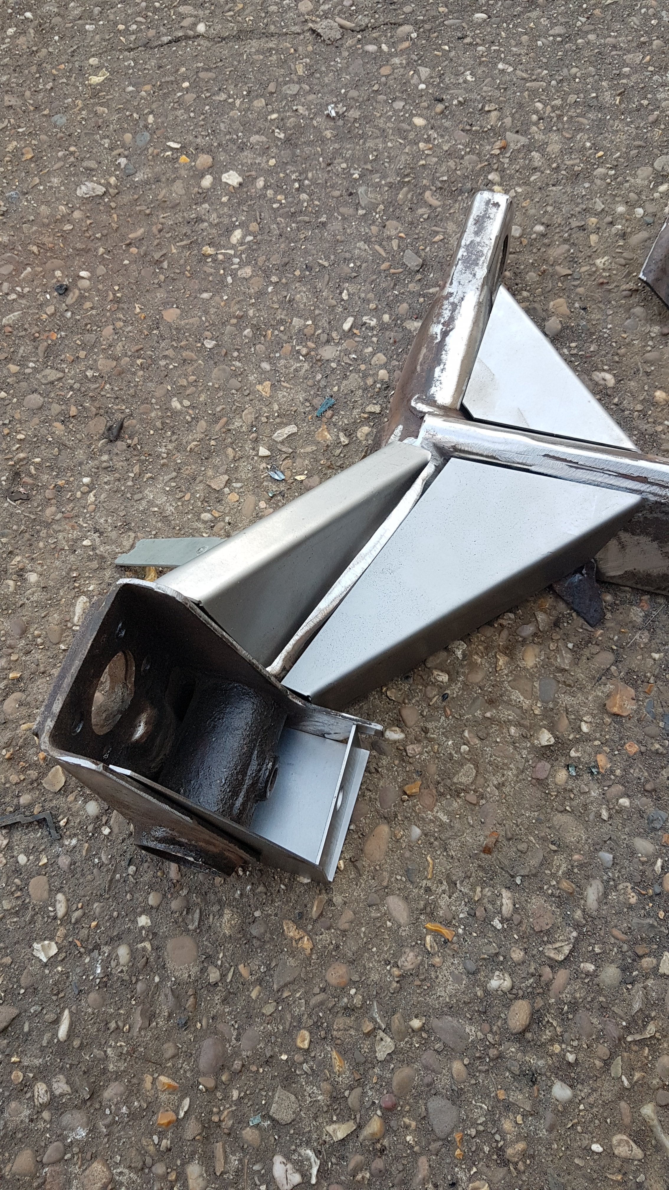

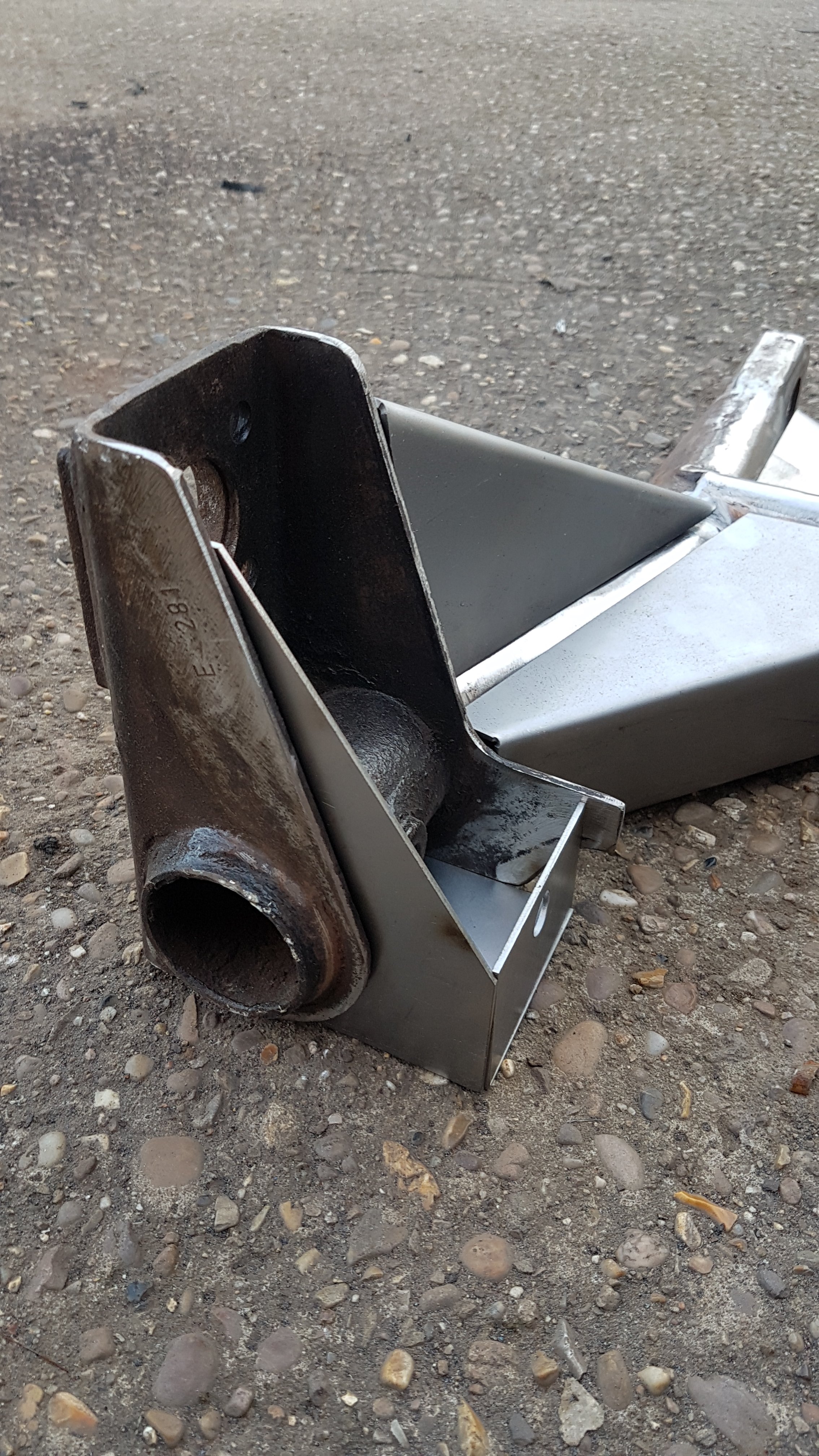

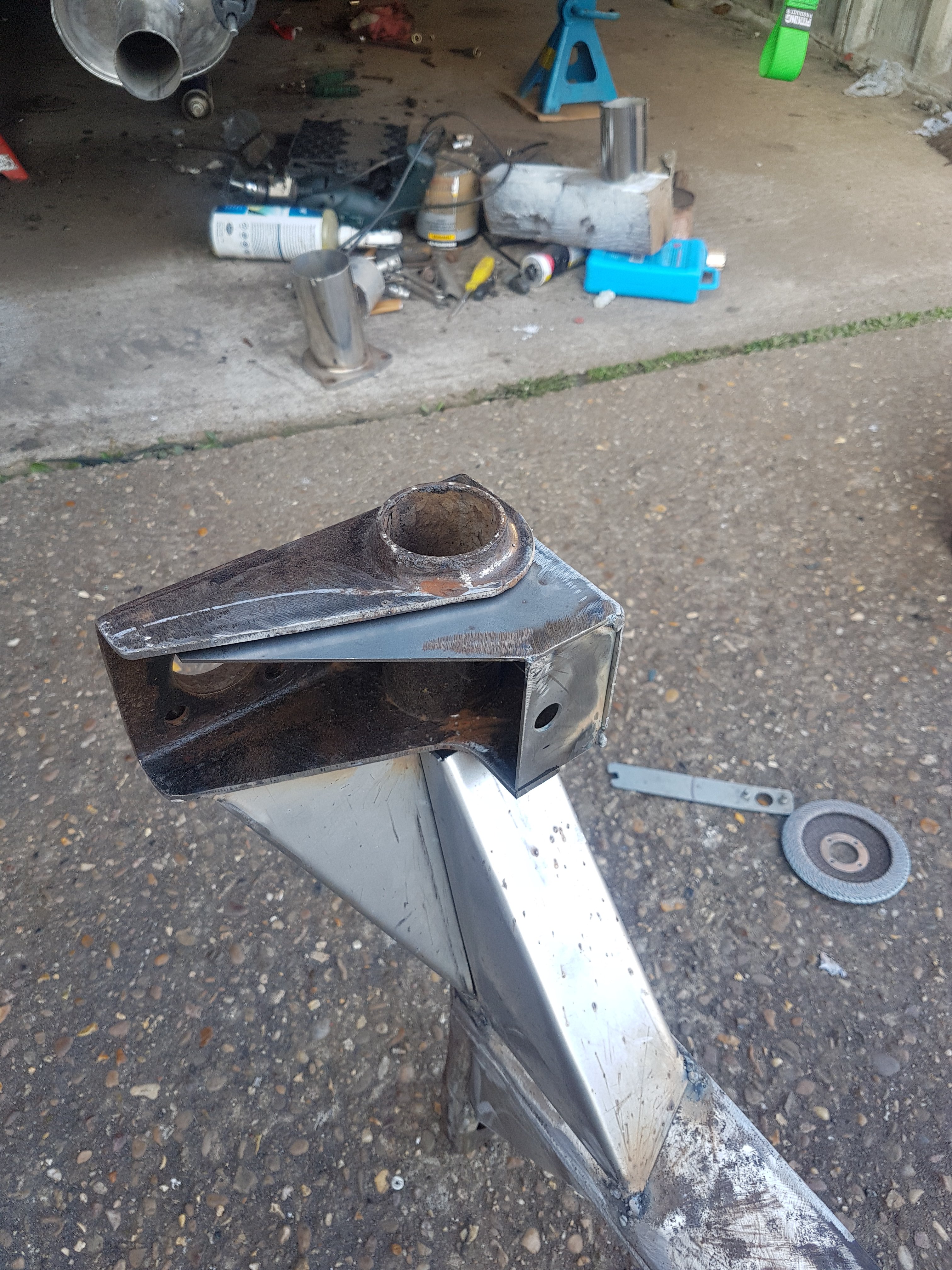

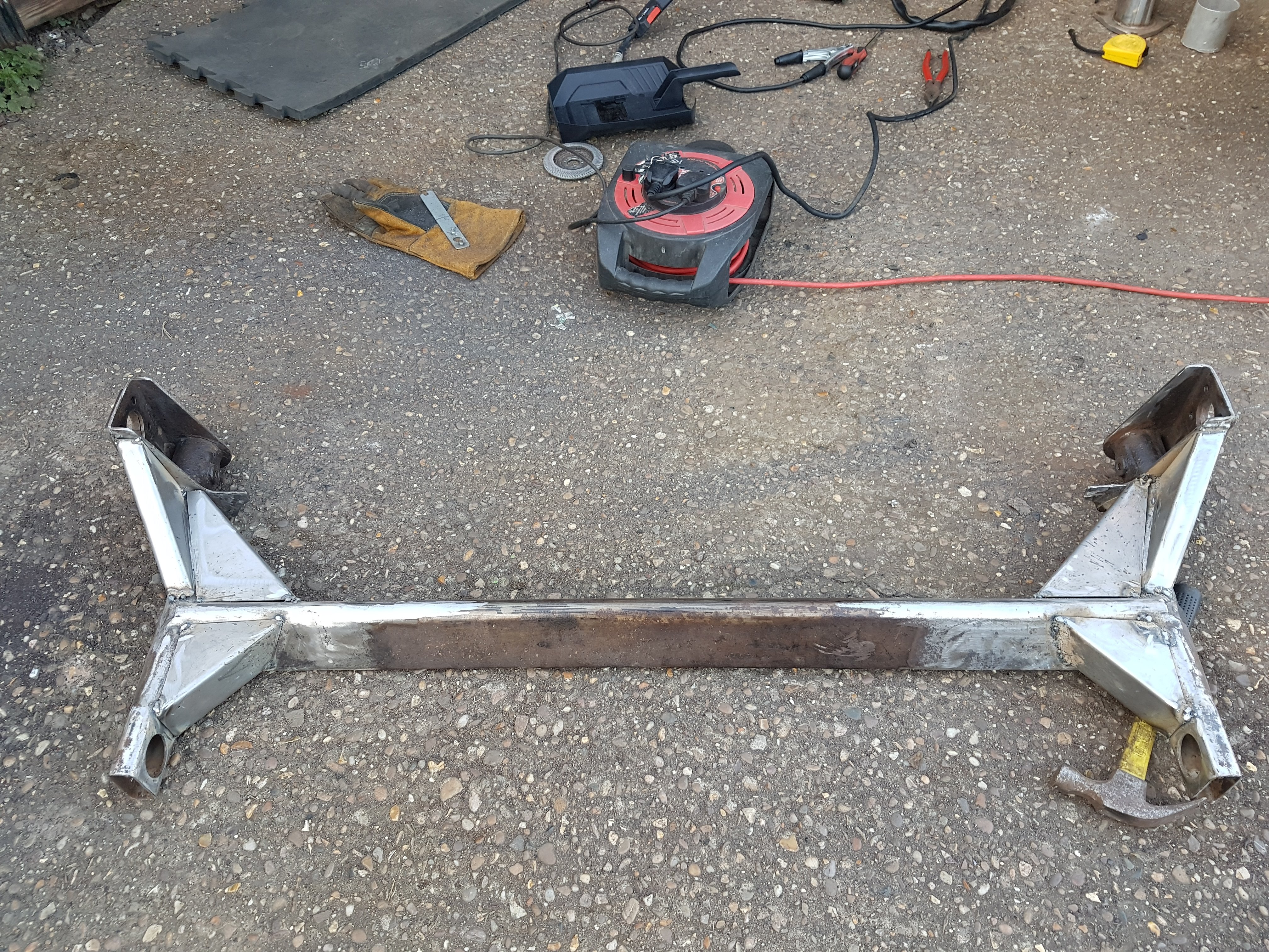

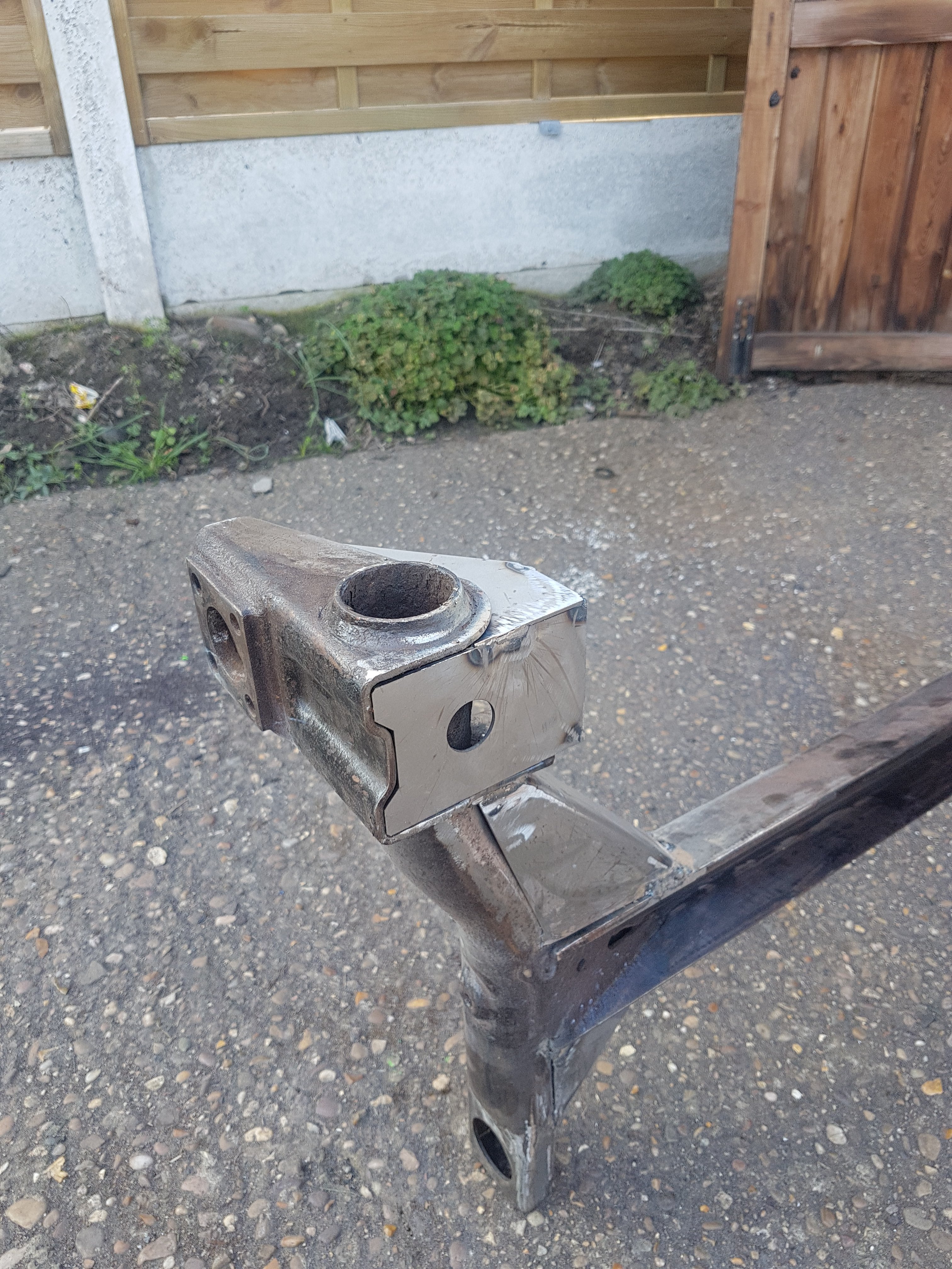

Today i set about the rear beam to mock up the PMS kit.
Decided to fit it all and removed the spring platform which means my suspension choice is now gaz golds
Edited by SNH
Flocked.
Just waiting on the bottom half of the dash as I'd forgot to tell him i run no glovebox lid so he'd not done inside it.

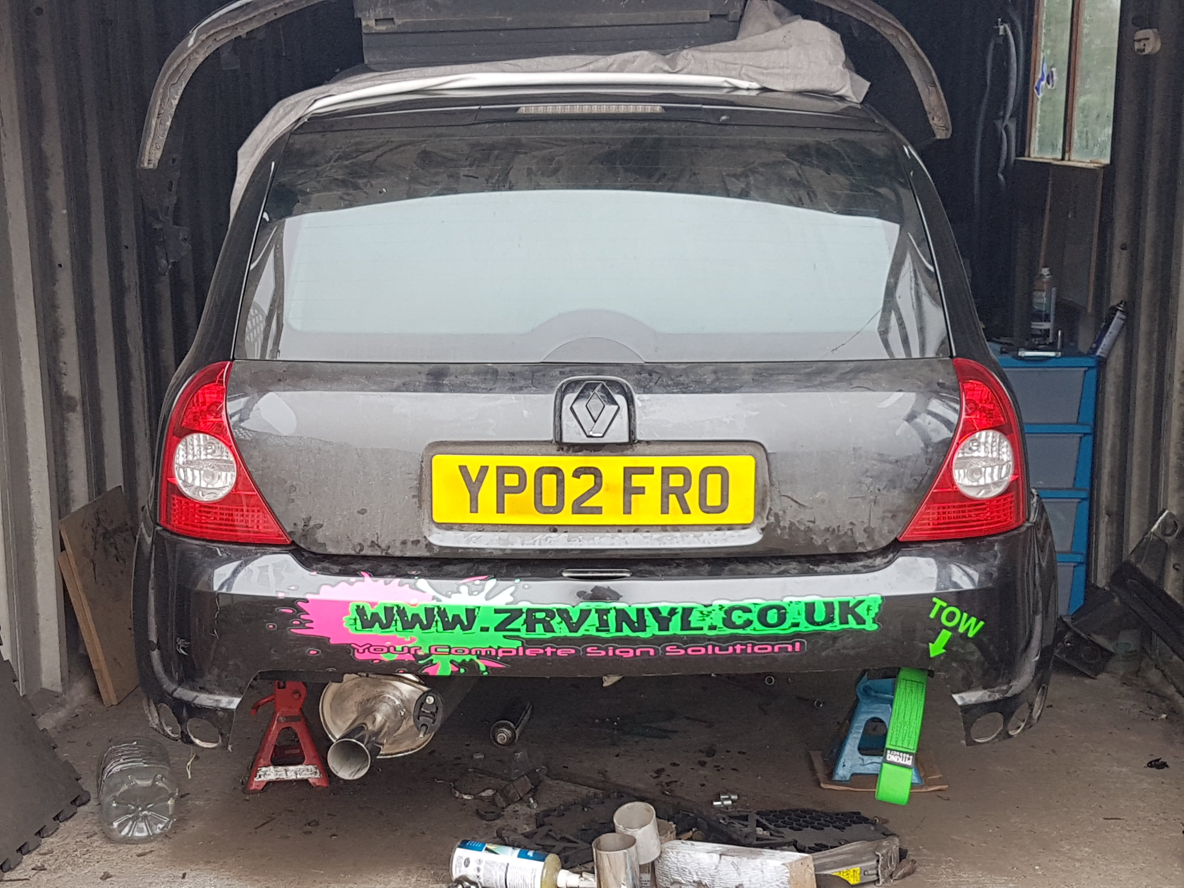

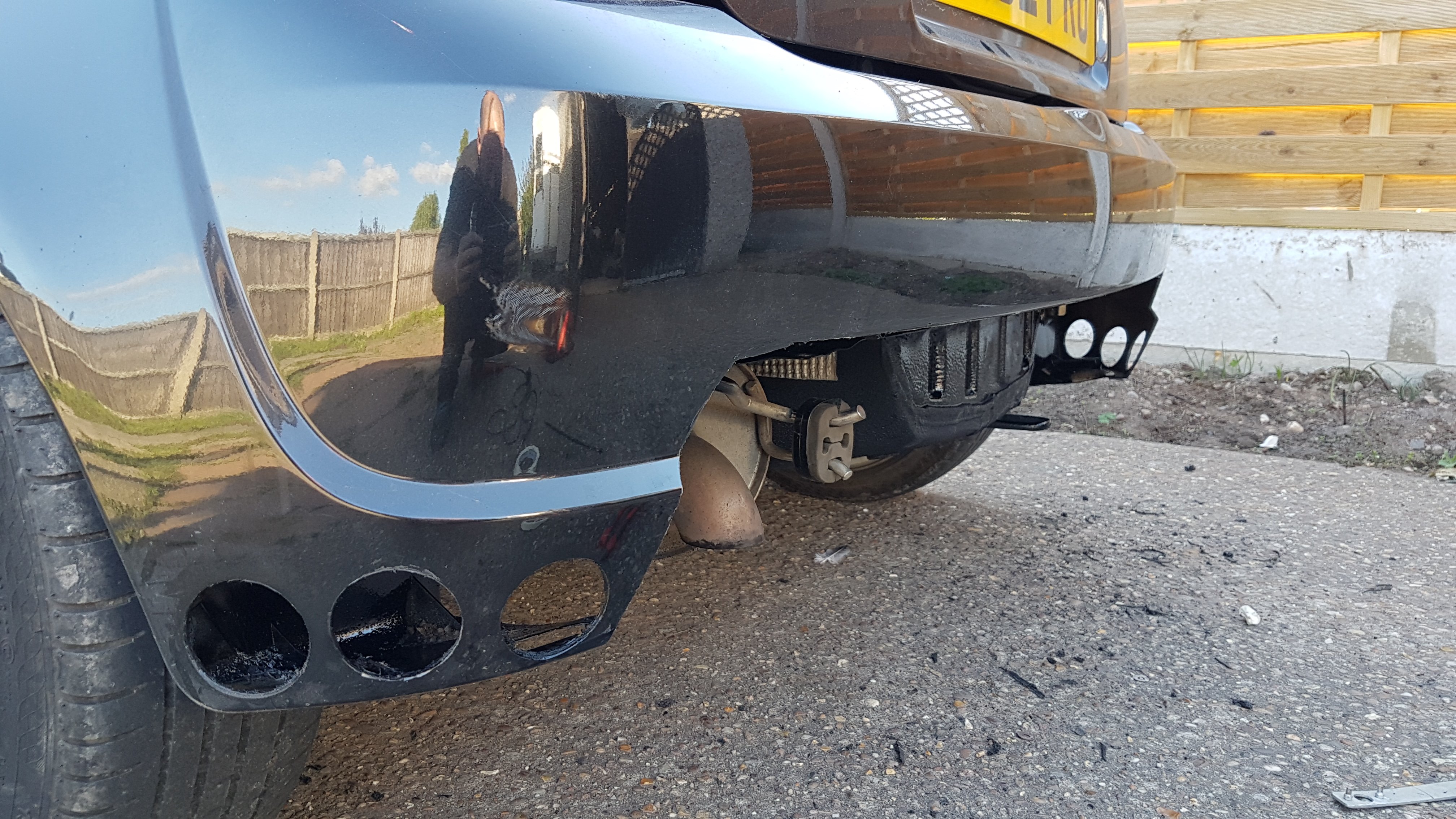

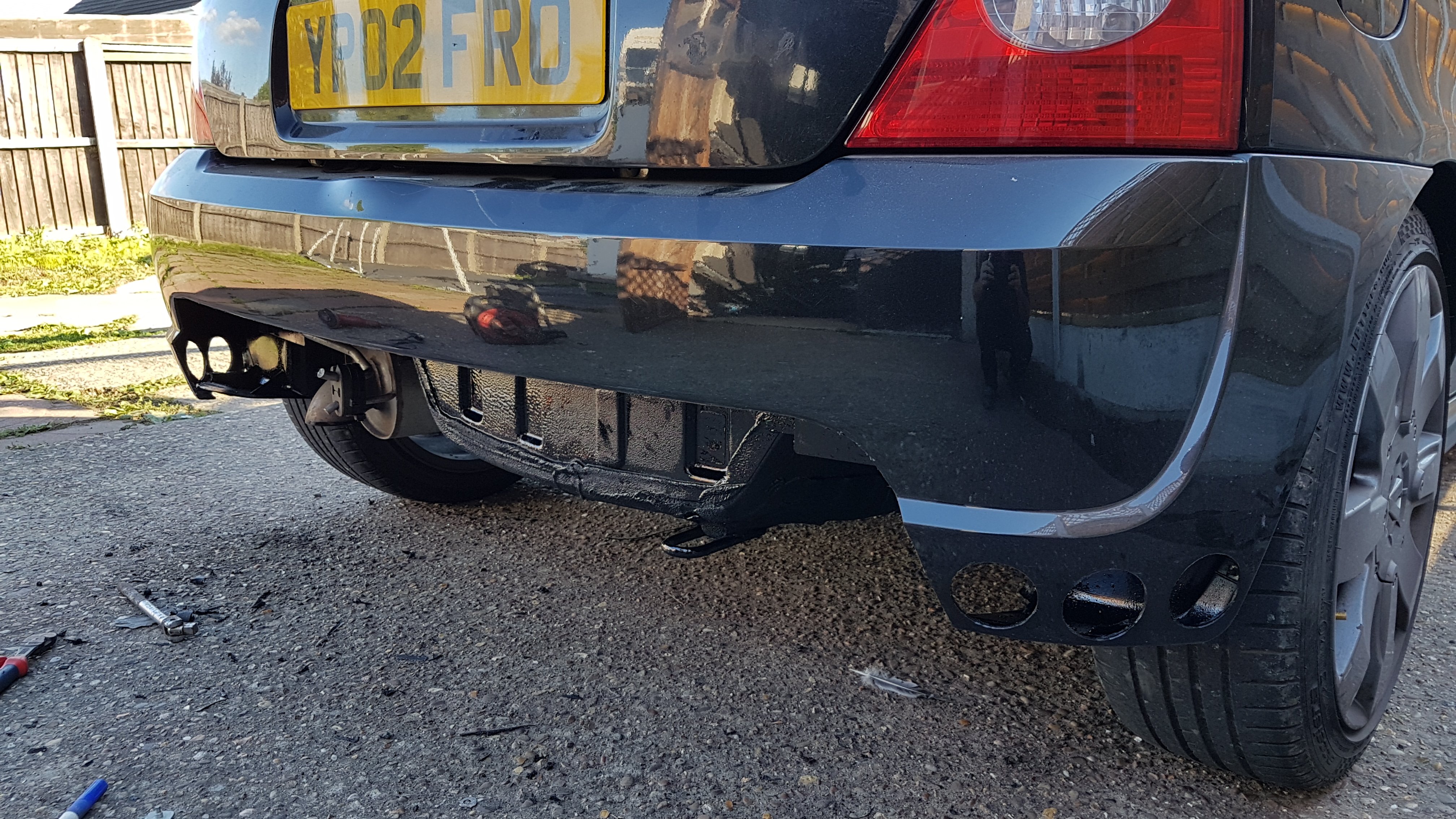

Its has a tailpipe :D

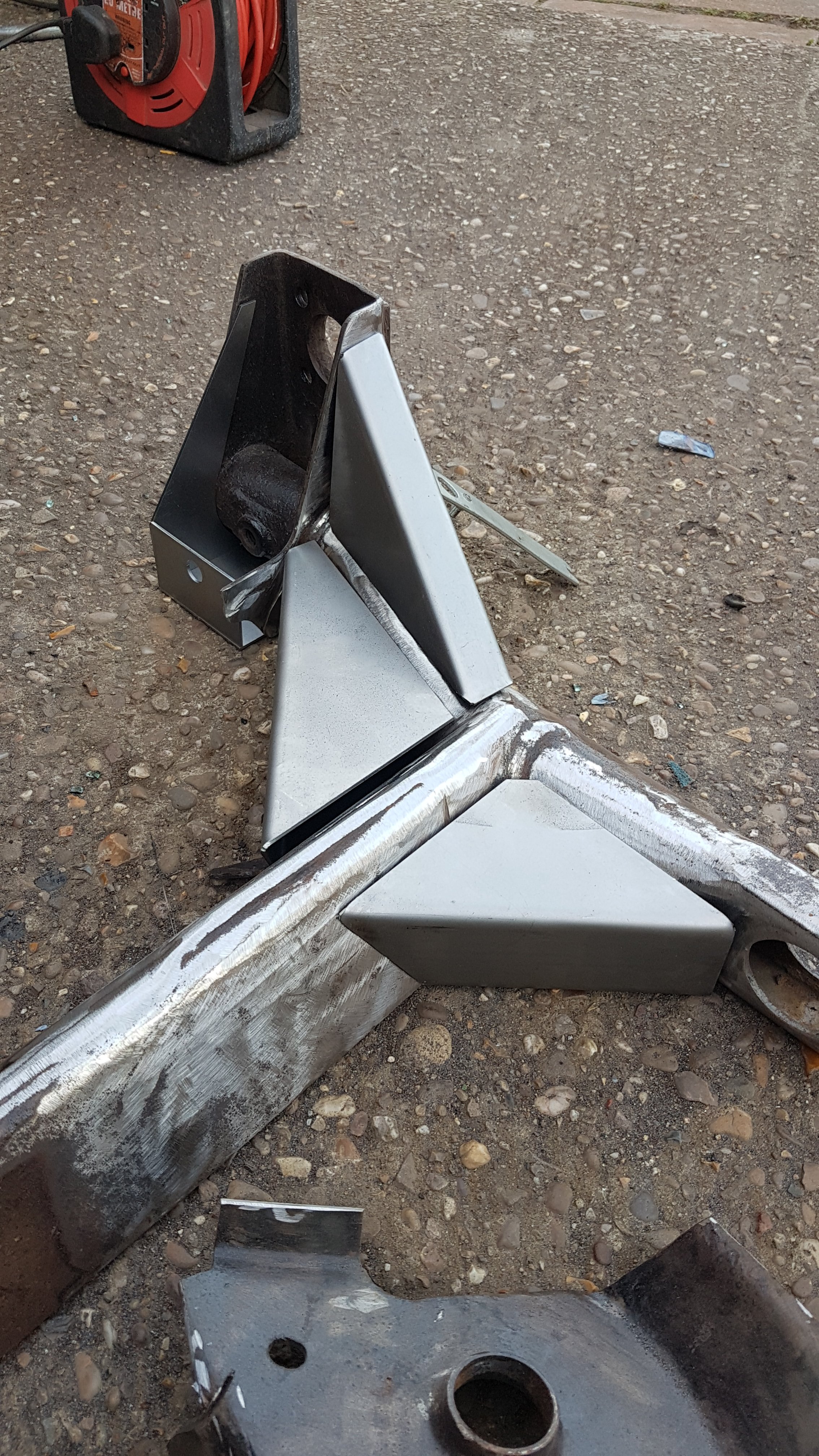

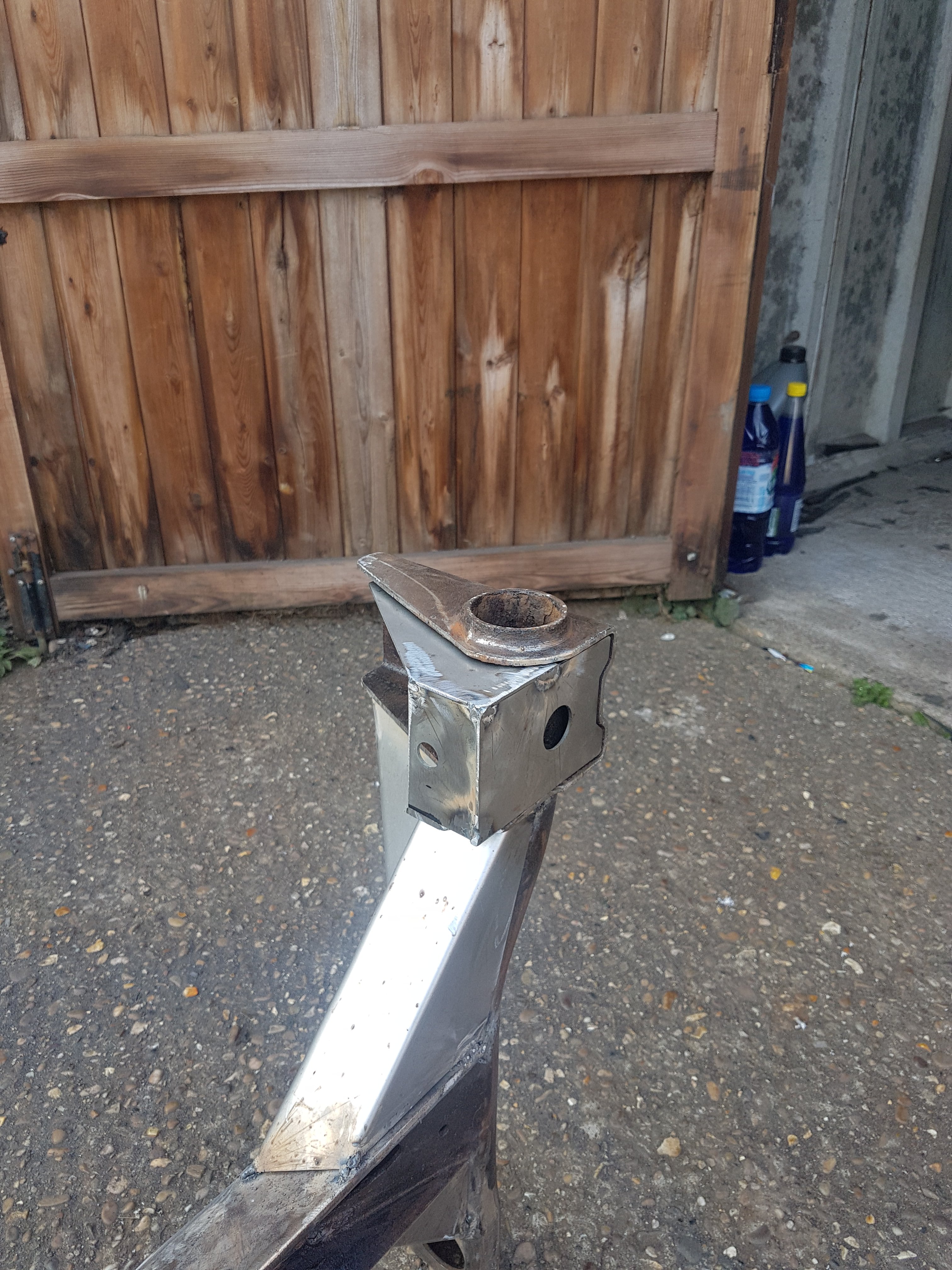

Rear beam tacked up

Last bit of the puzzle tacked up :)

On the hunt for a 182 breaking so i can cut the floor and and get rid of my wheel well, also think i need to change the stealth tailpie now.
That exhaust reminds me of most of the diesels I have owned pointing down to the ground as to not offend the noise police LOL.:D
It was a lot quieter with that one on than it is with the straight one :D
Mate of mine offered me some lightweight rear cards for cheap, would've been rude to say no.

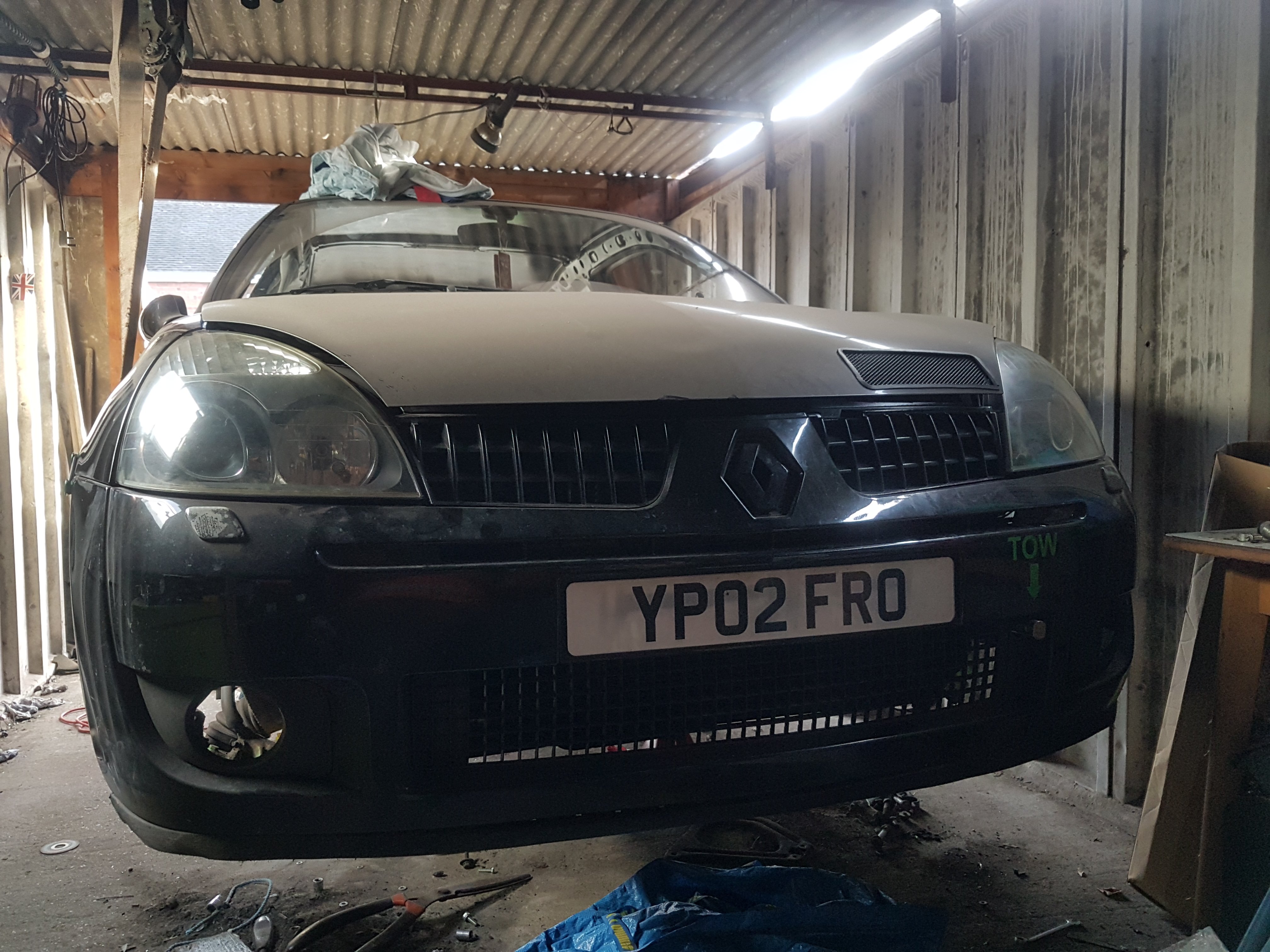

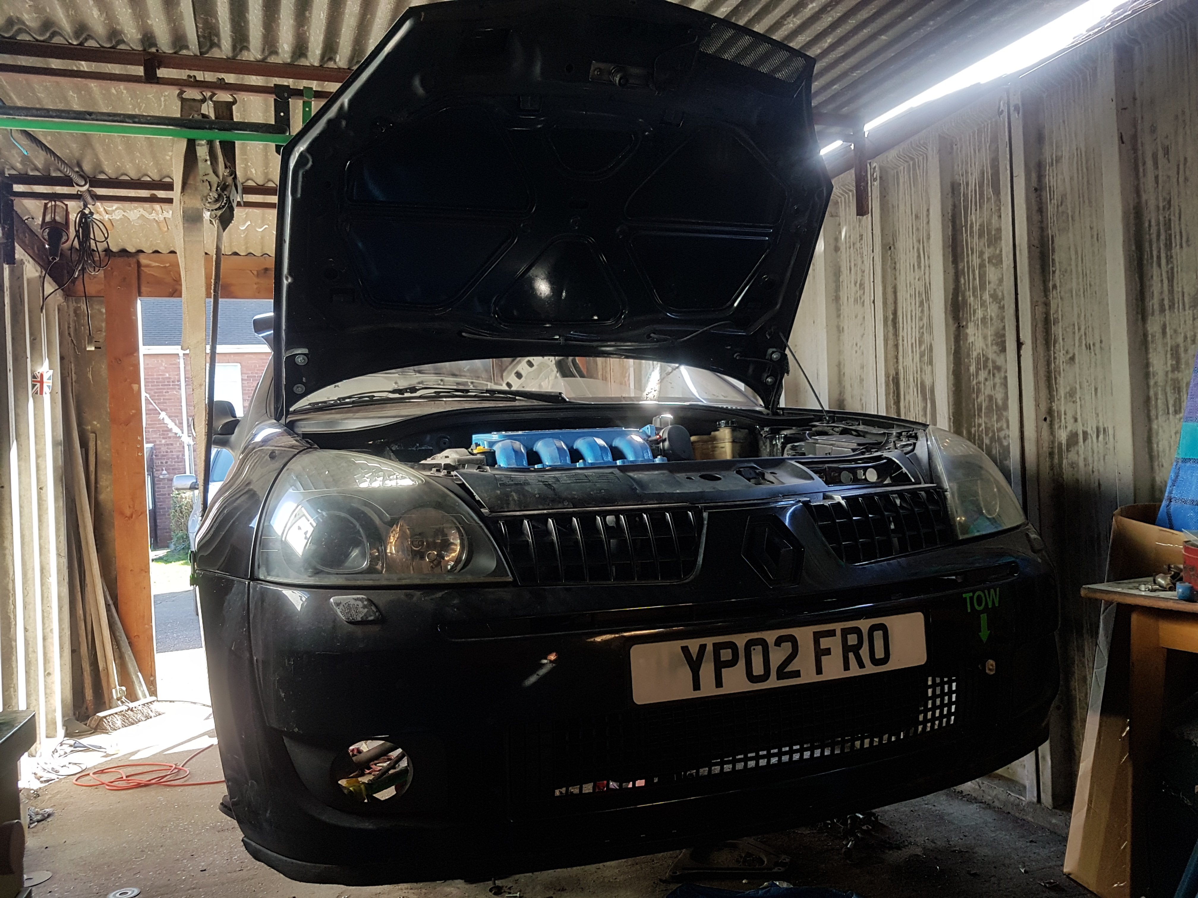

It runs!

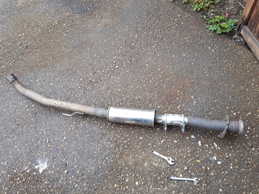

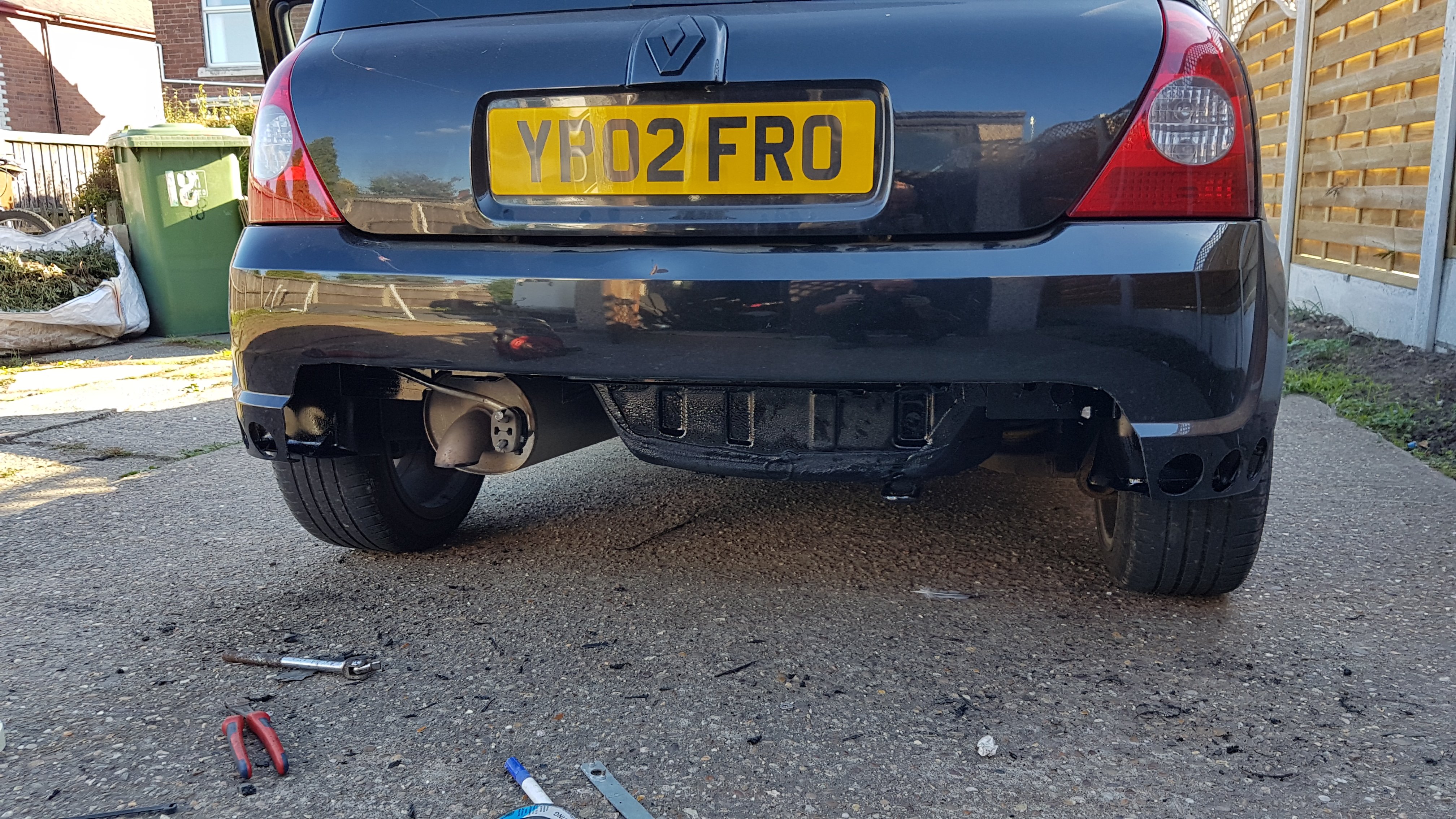

Now its all stripped out and on stands I've gone over the exhaust manifold and system and i must say whoever or whichever powerflow dealer built the centre section needs to be ashamed.
I've got to weld up the joiner as swapping manifolds means the system is different but the original welds on the rest of the system are shocking. Holes galore and look like pigeon poop, i could have done better and i can't weld for toffee :D

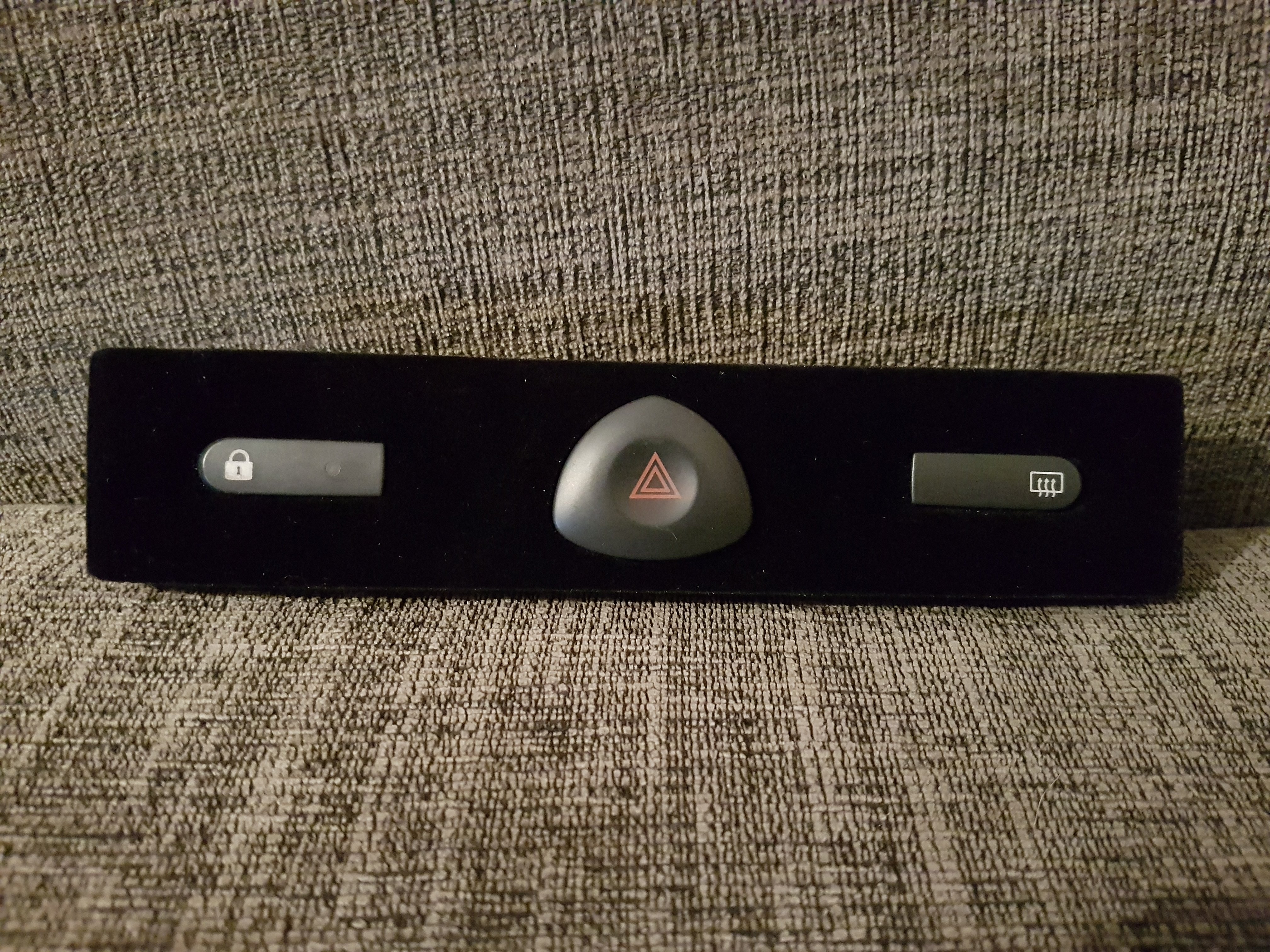

The bottom dash is back :)
Edited by SNH
3 minutes ago, SNH said:
But the main thing is.....
Flocked to within an inch of it's life. Who needs Alcantara. Should reduce sun glare to a minimum though.:clap:
Exhaust is welded up and on, no blowing.....its loud :D

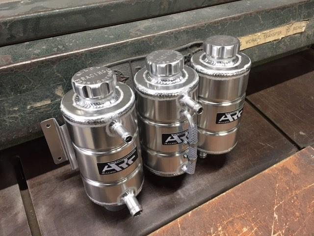

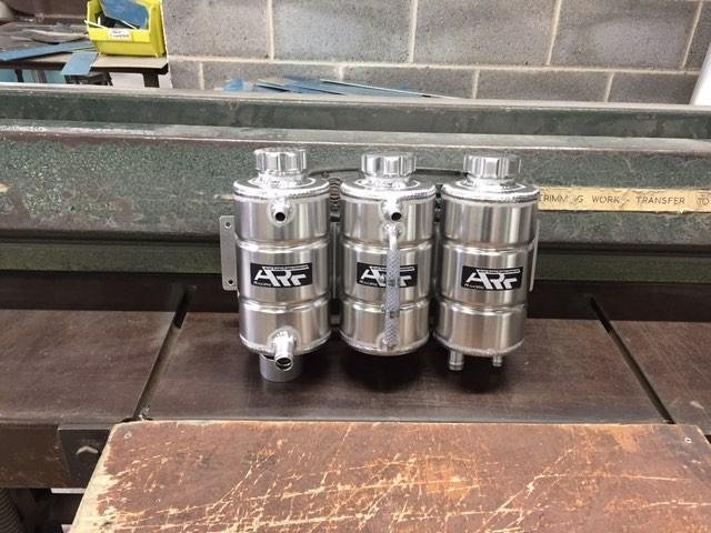

Axle has gone off to be welded, battery box being built this week hopefully and space measured up for the alloy header, power steering and catch can combo.

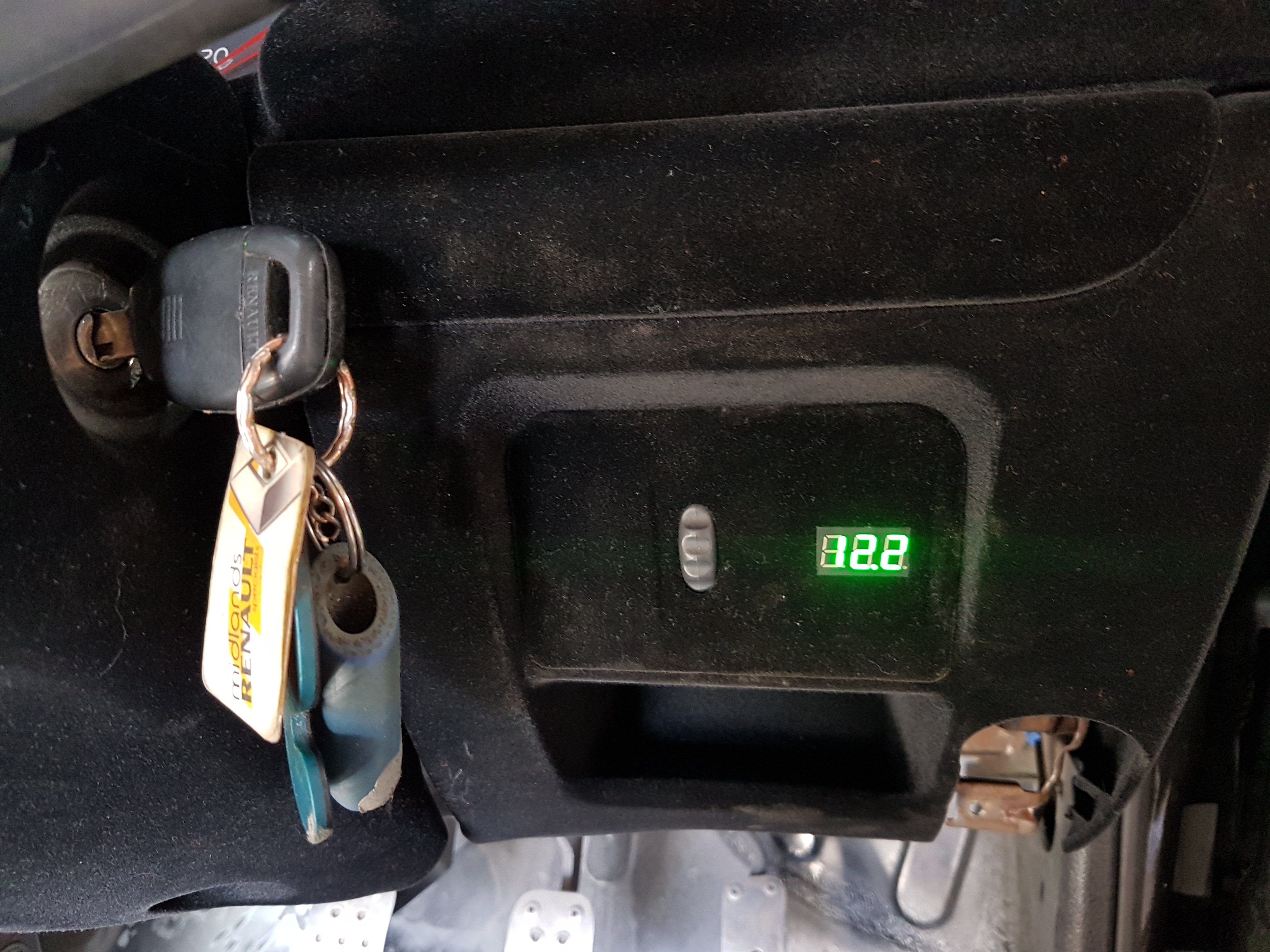

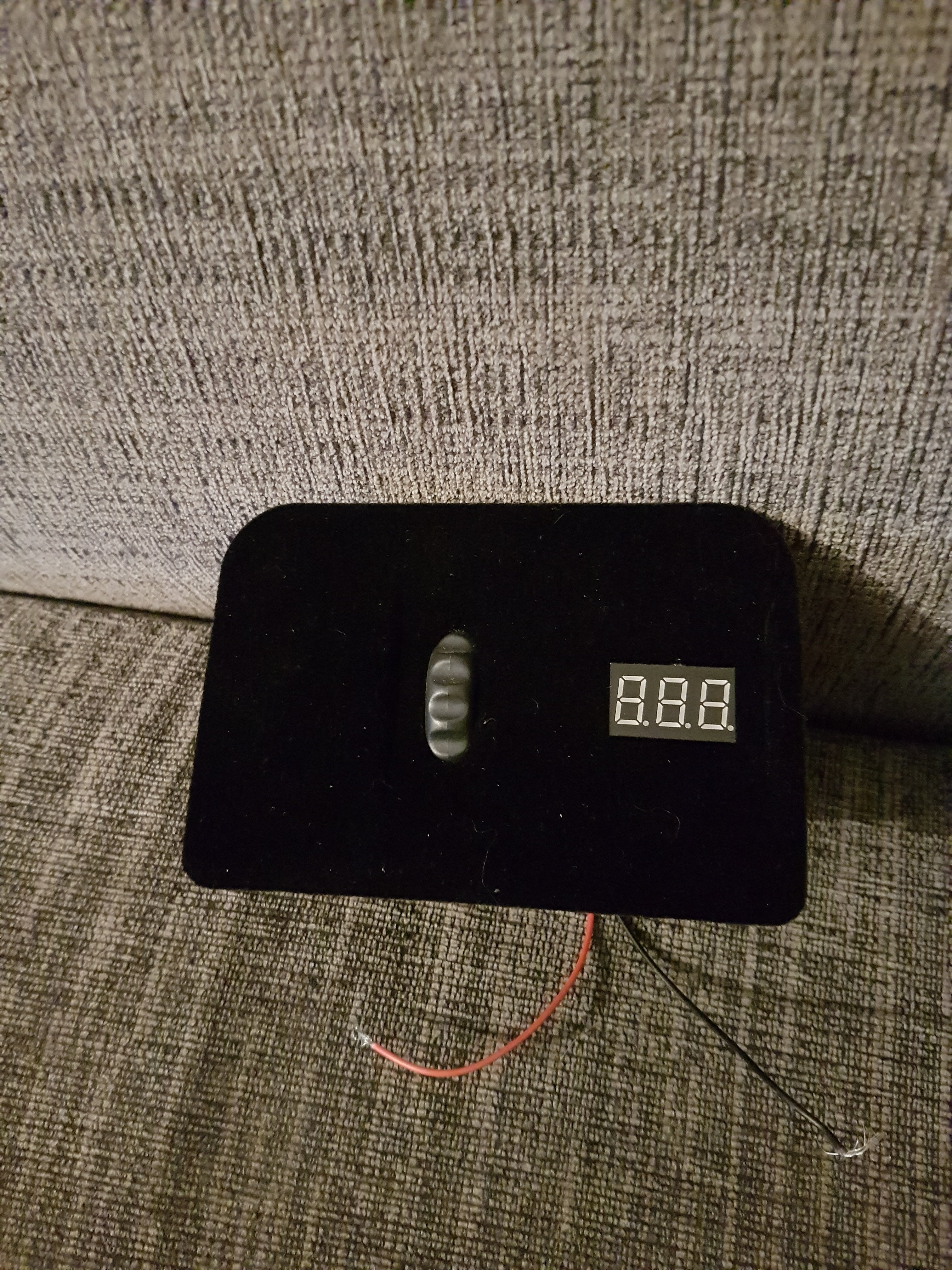

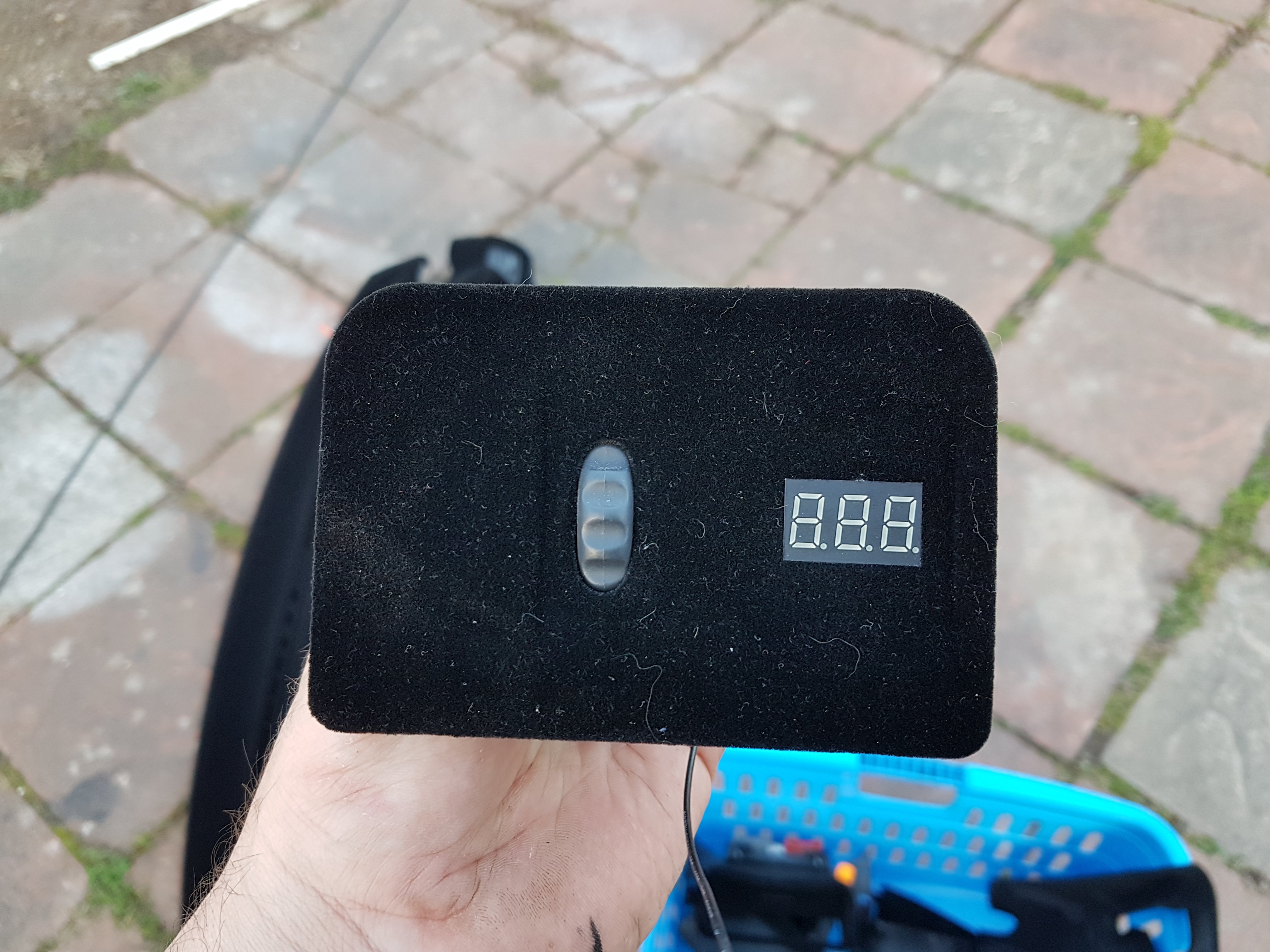

Dash is in and wired up but ive got my eye on a carued tyre pressure and temp monitor to fit where the standard clock display is.

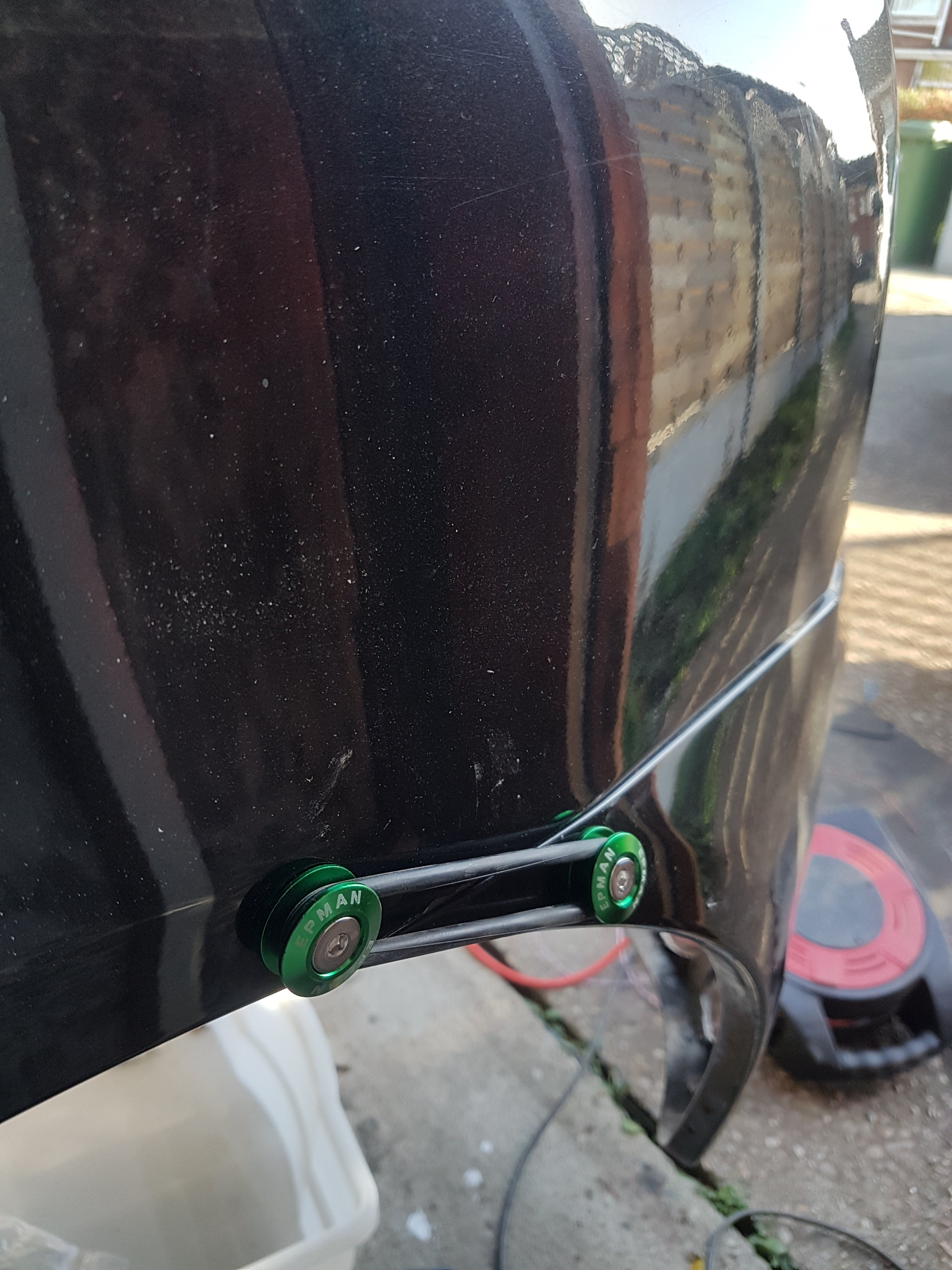

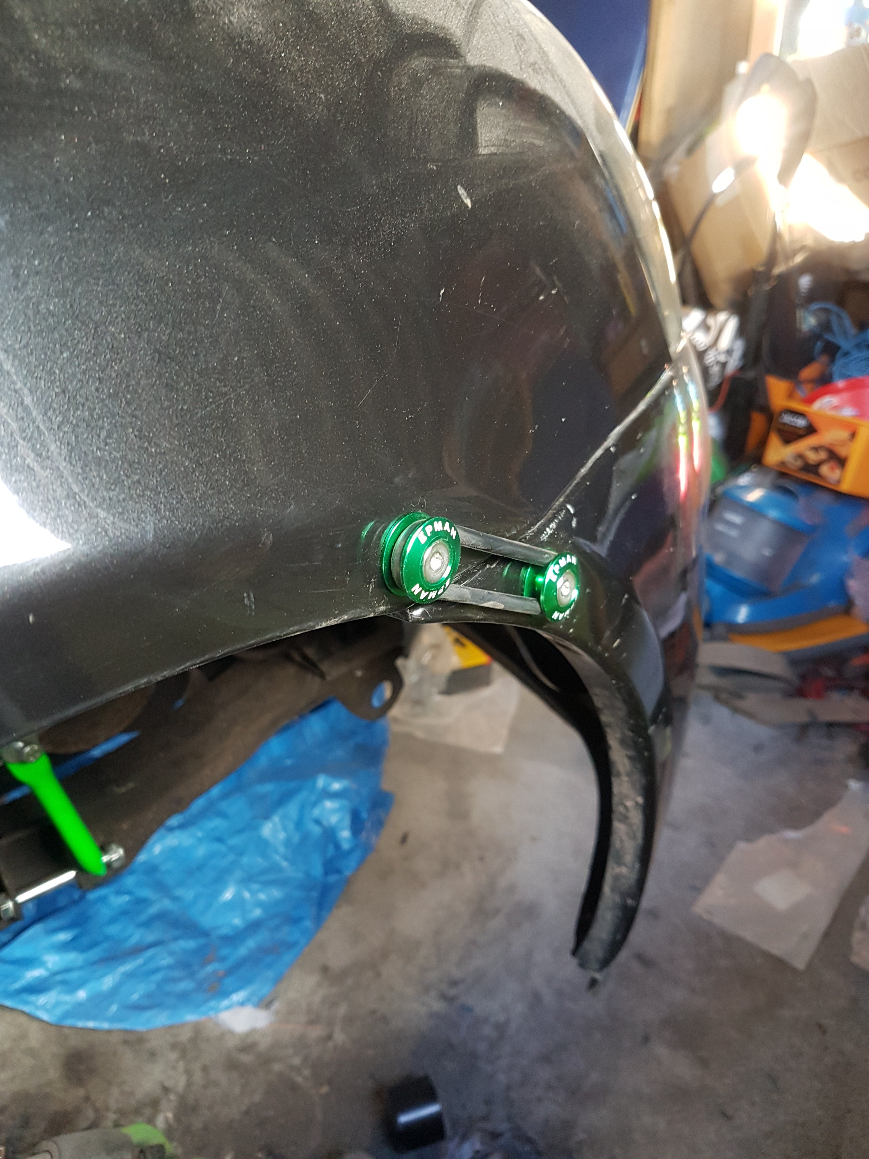

Quick release bumper thingies fitted.

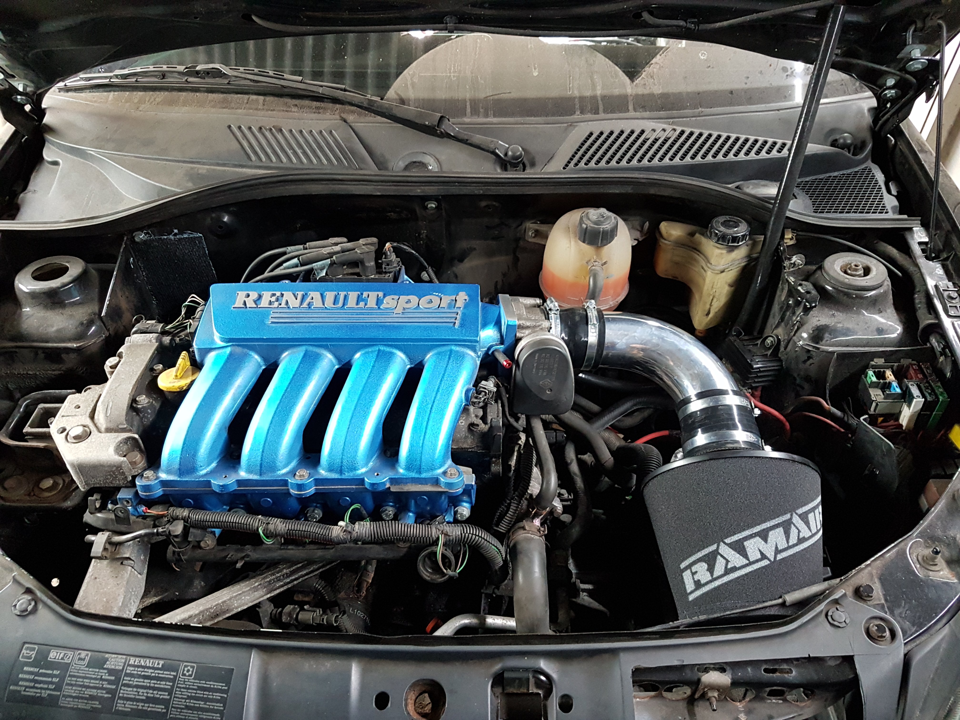

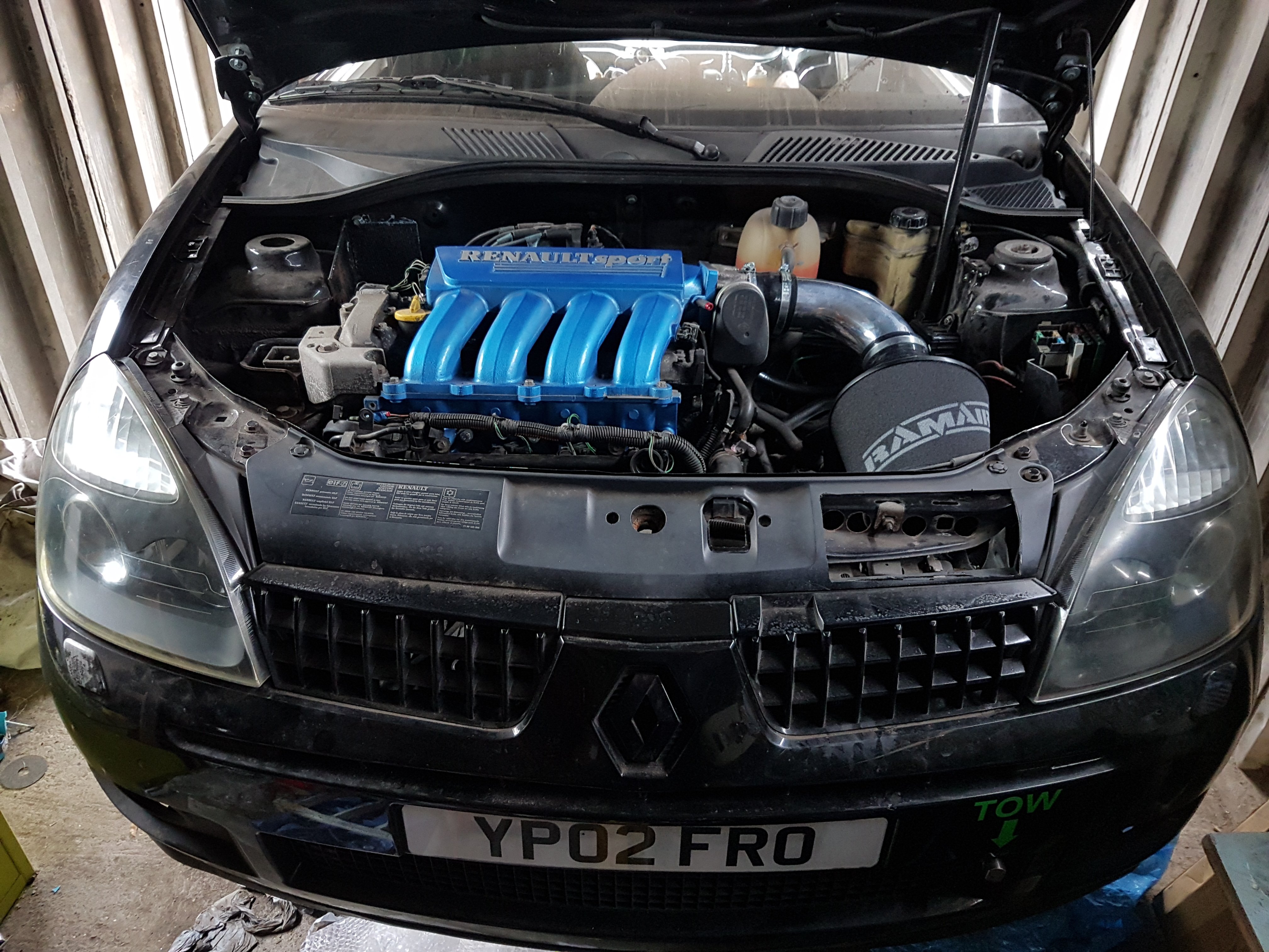

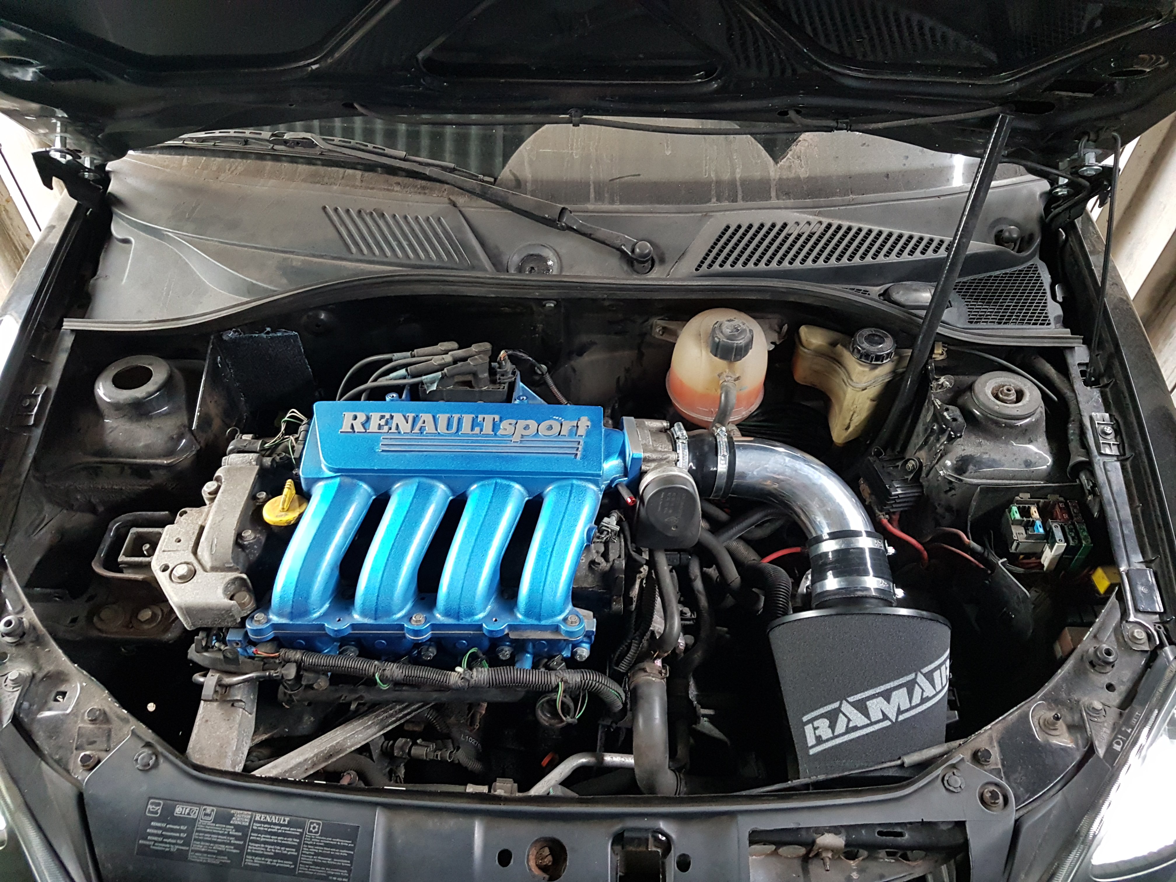

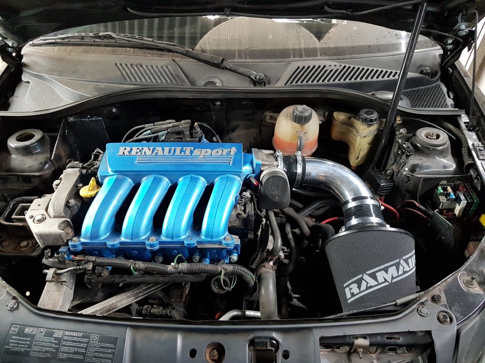

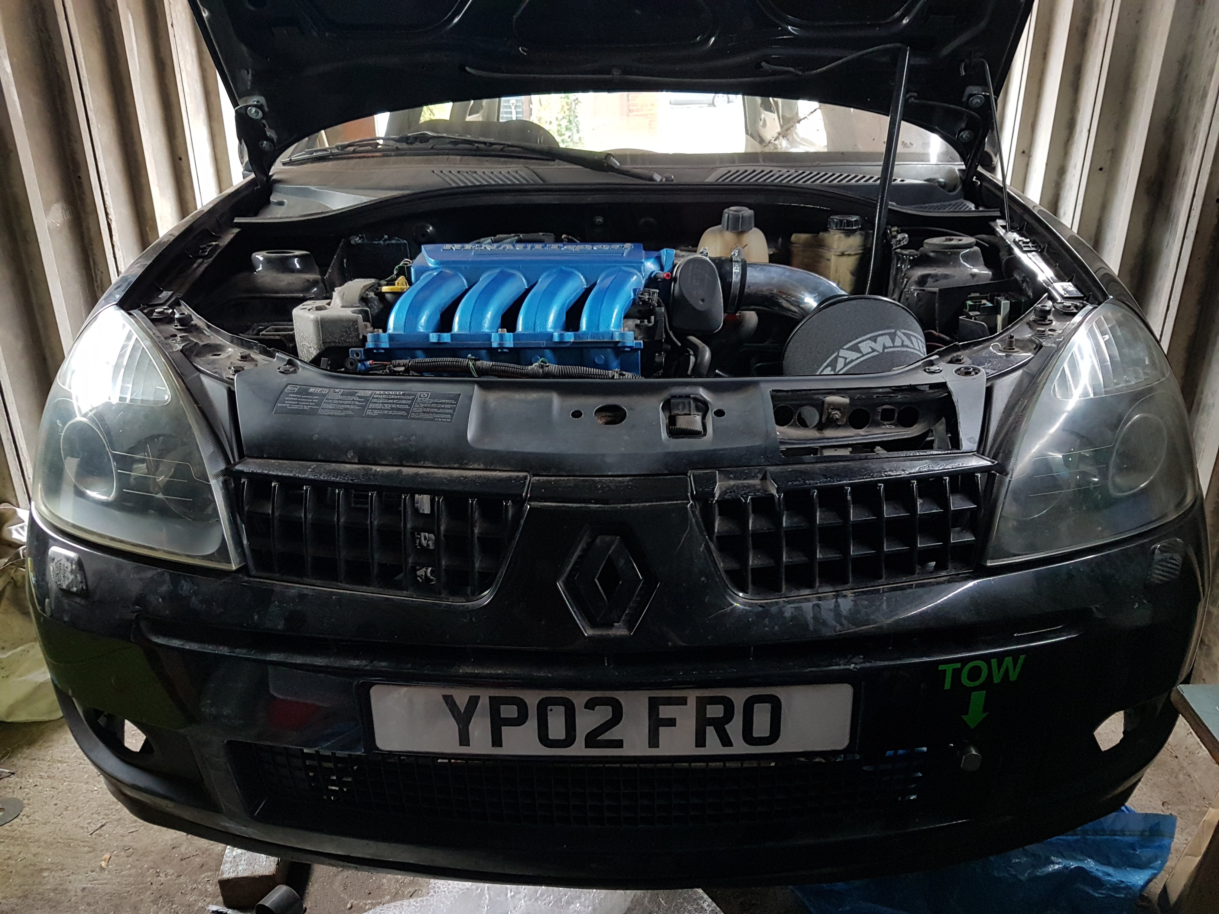

Bigger induction piping and xl ramair filter ordered to finish that side of things off.

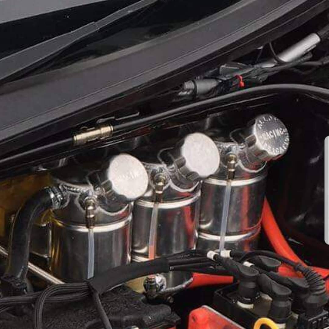

Silicone pipework for the catch can ordered
Spigots for the oz's arrived.

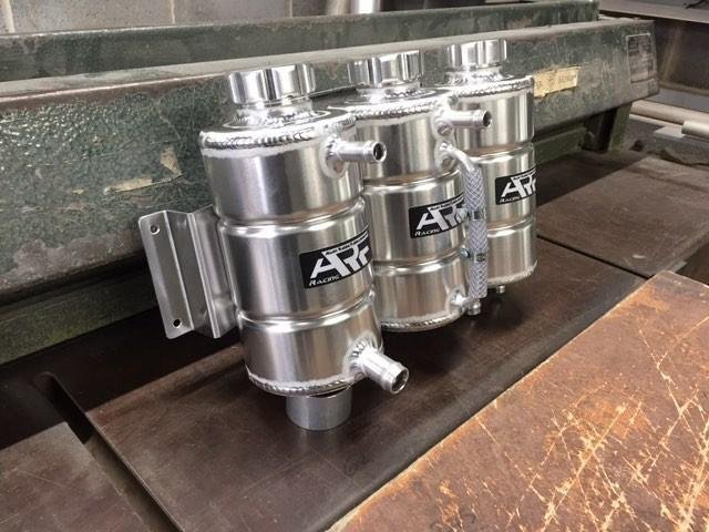

Need to collect the axle from the welders and hopefully he's finished the battery tray and tanks and I'll get him to weld the wishbone plates while I'm there.
Order poly bushes for the wishbones and get those and the rear beam ones pressed in and get that lot built back up.
New ind kit, larger pipework and filter doing away with the breather back to the inlet :)

Tanks are ready
