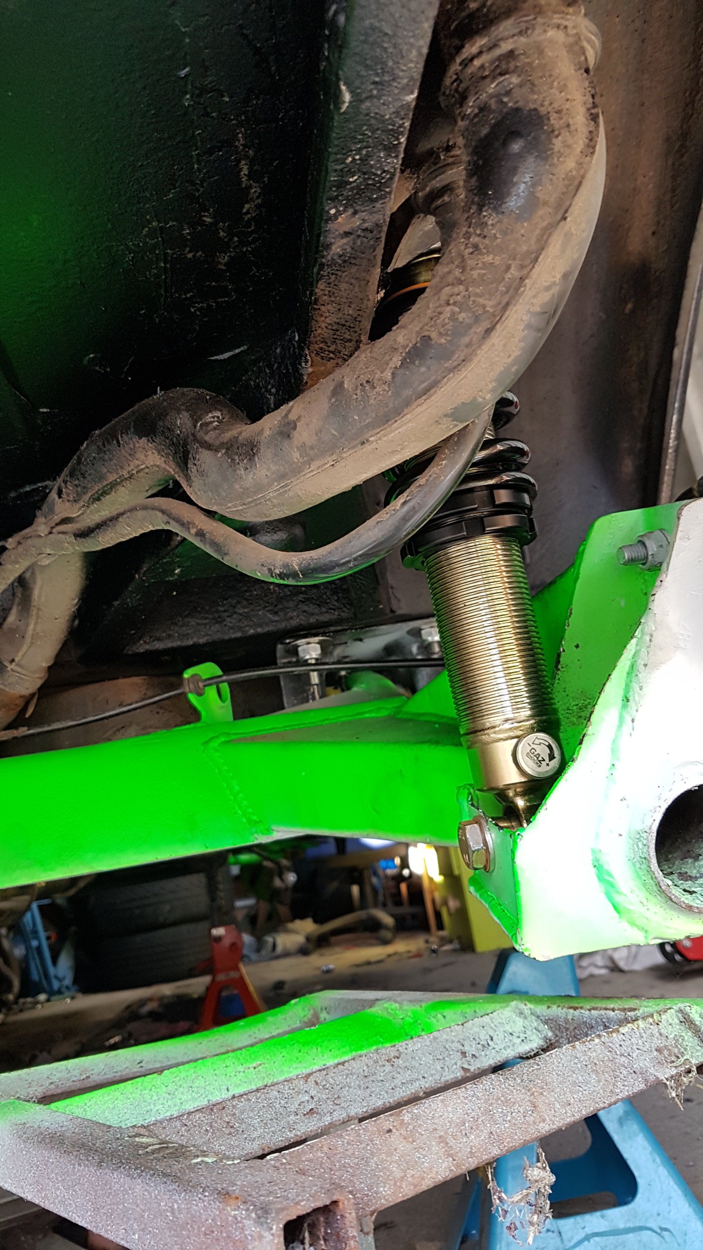

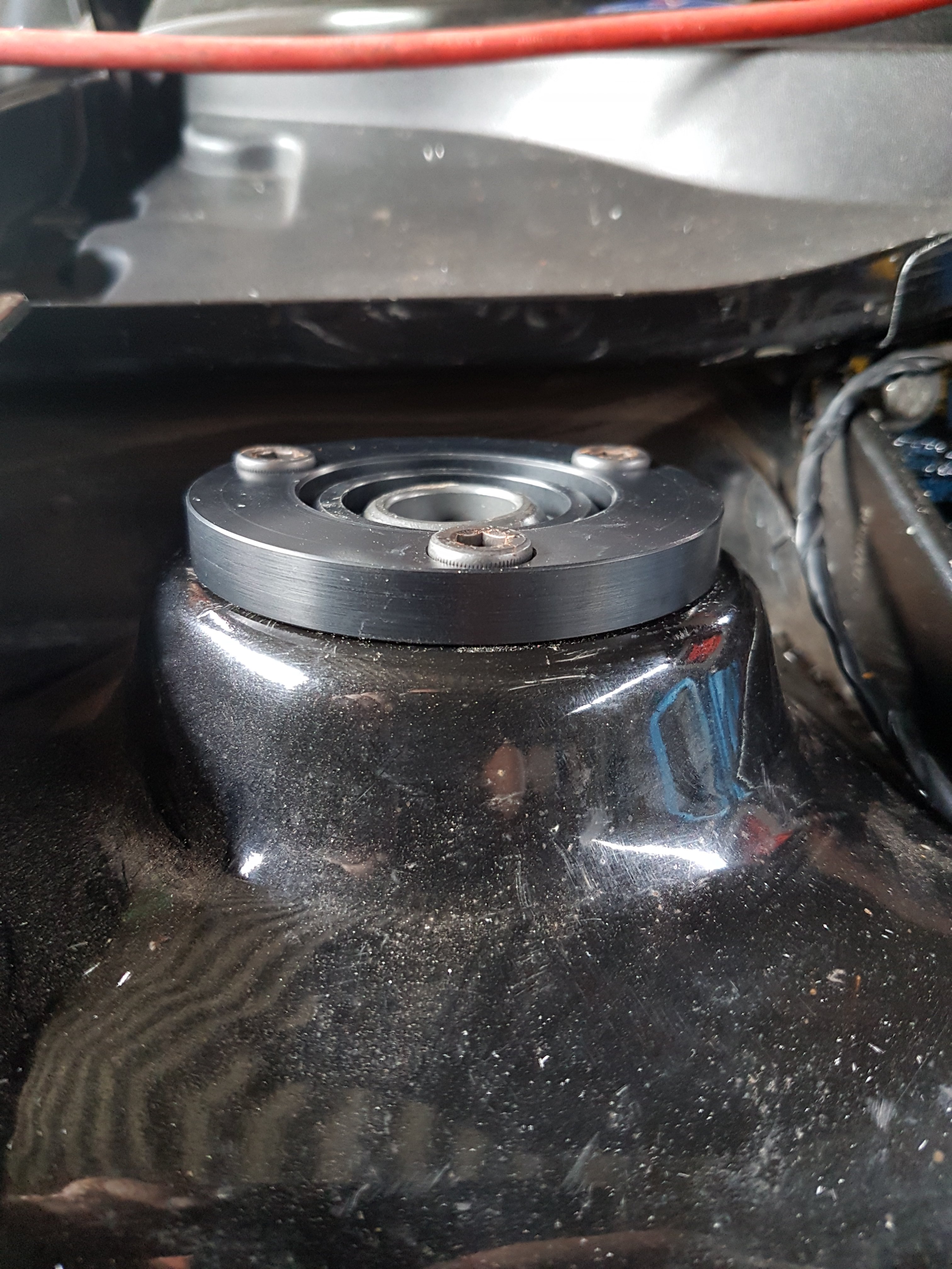

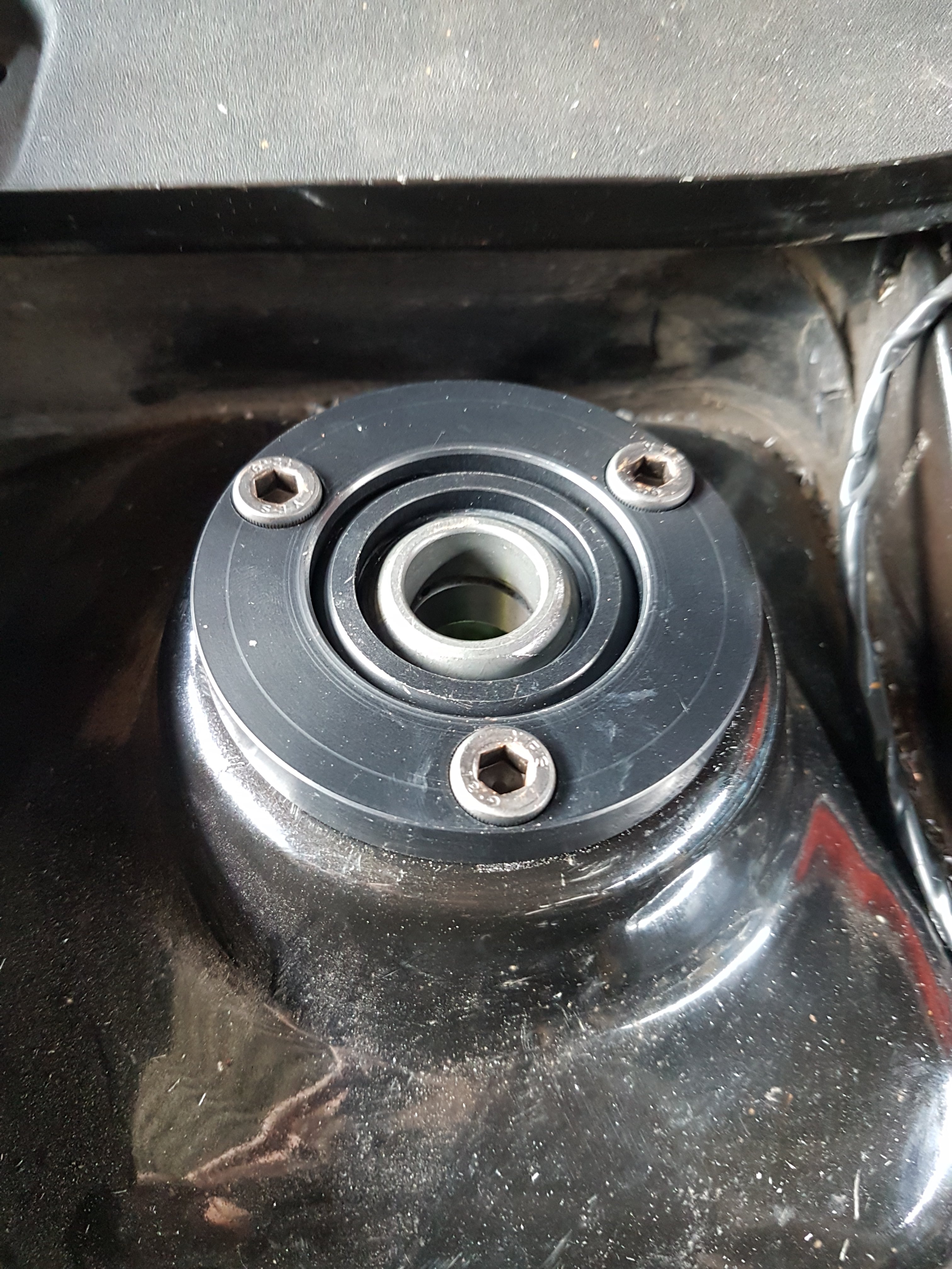

Solid top mounts sorted

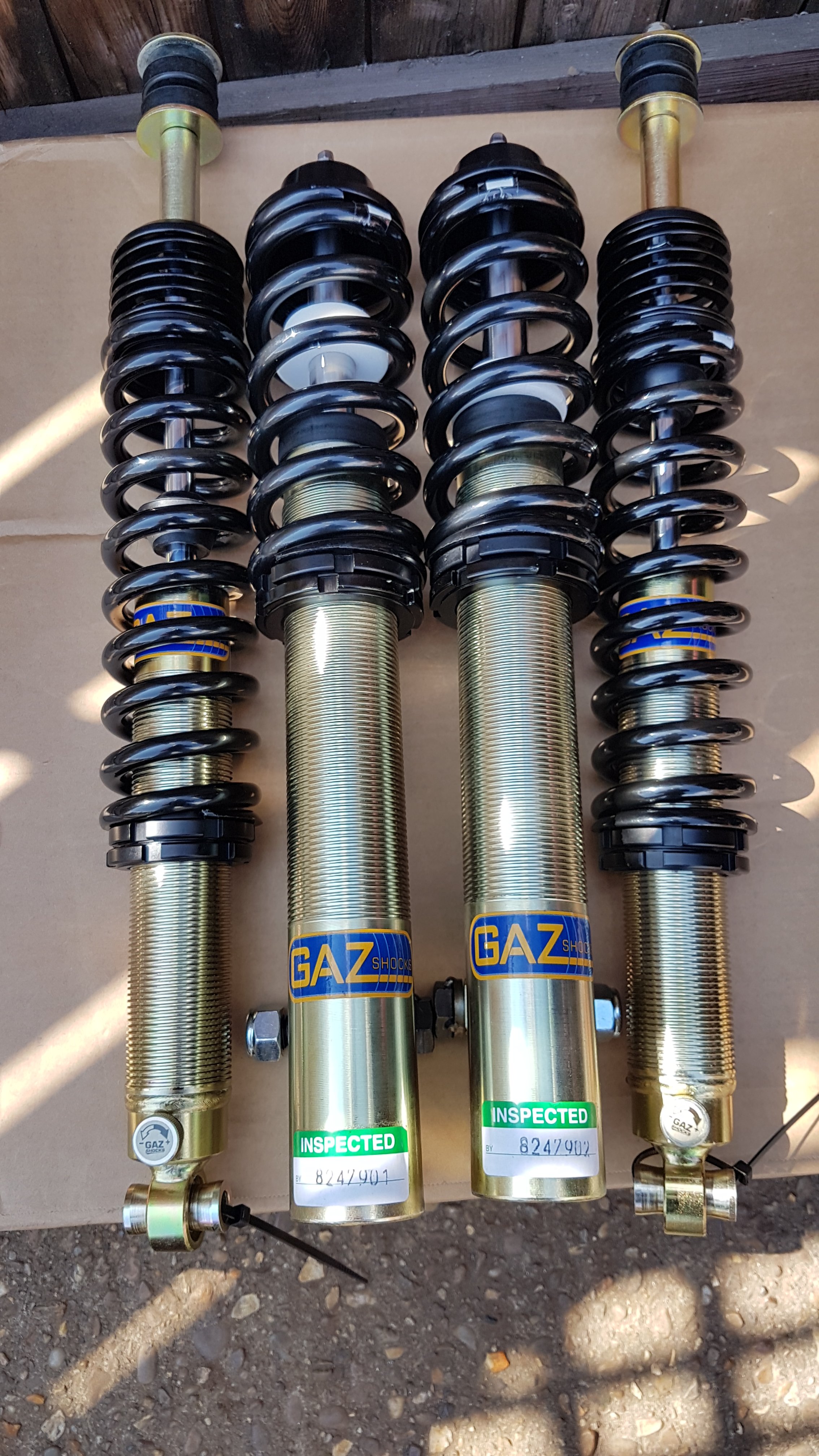

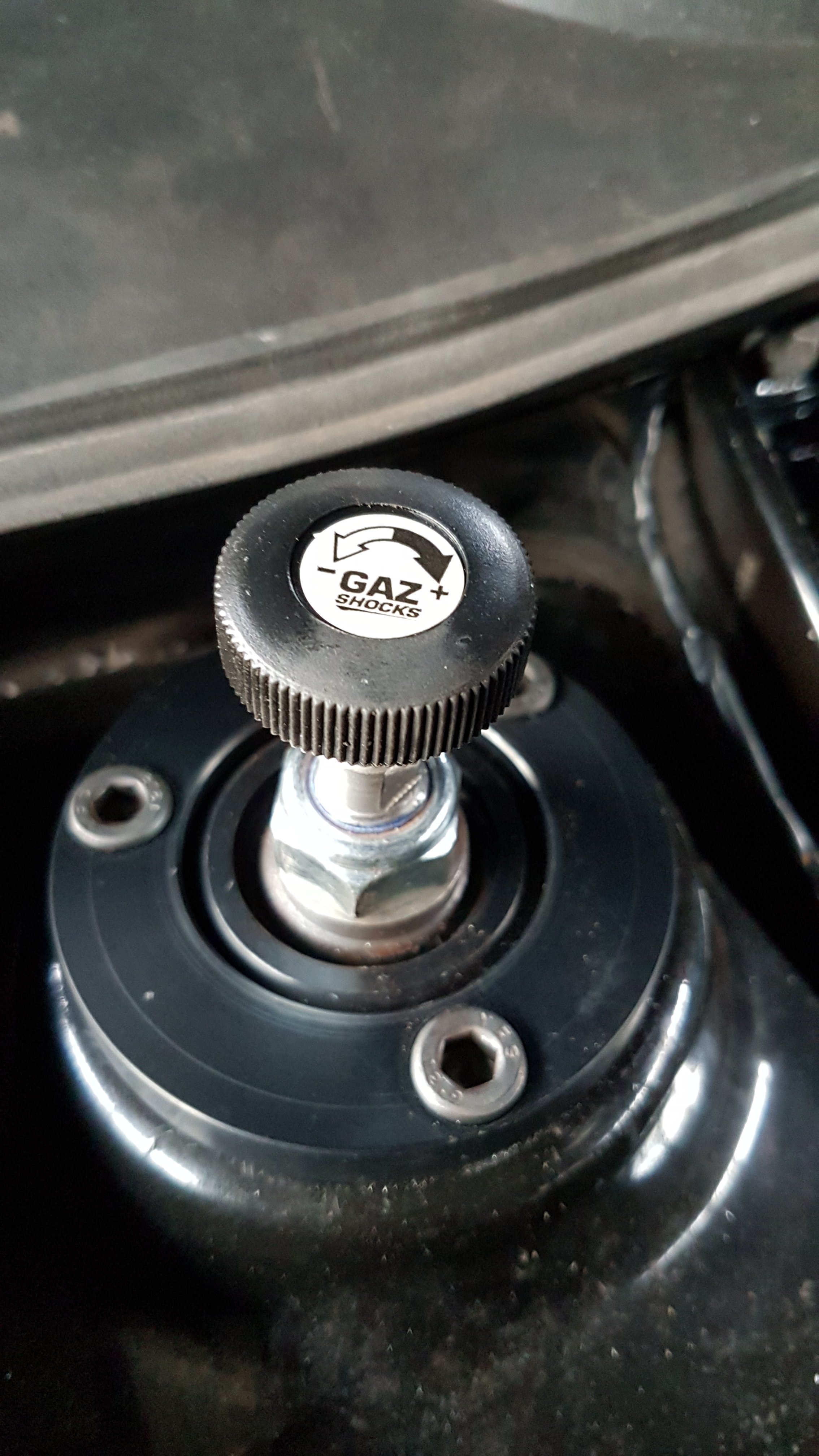

Gaz gha's ordered. specced the front springs a bit stiffer 550lb fr 450lb rear and went with rose jointed rear mounts. 4 week build time though 😞

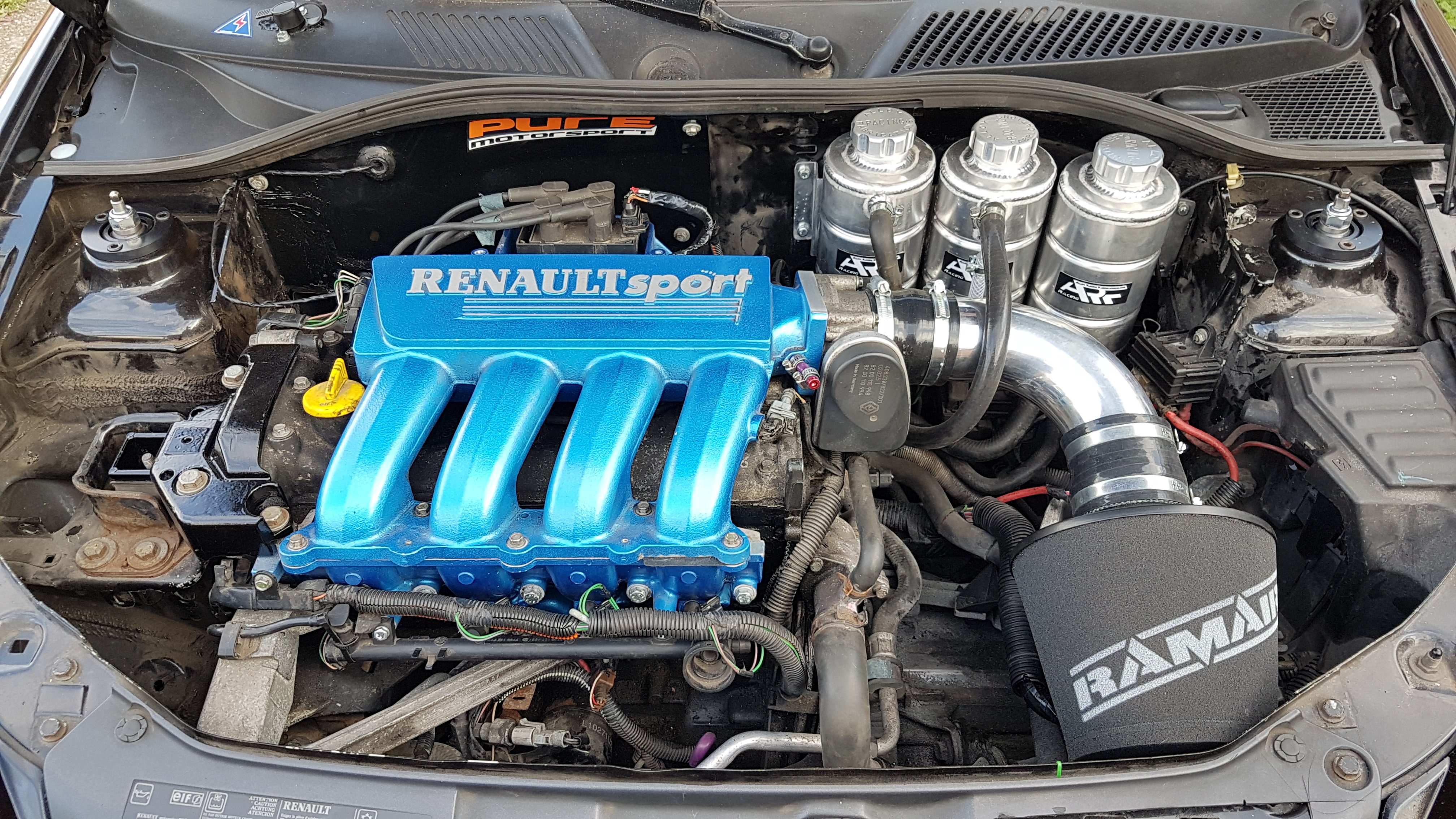

Its had a new injector after one was found to be faulty and a decent lambda again faulty.
Now ticks over nice and smooth :)
Gaz's should be built and here this week :)

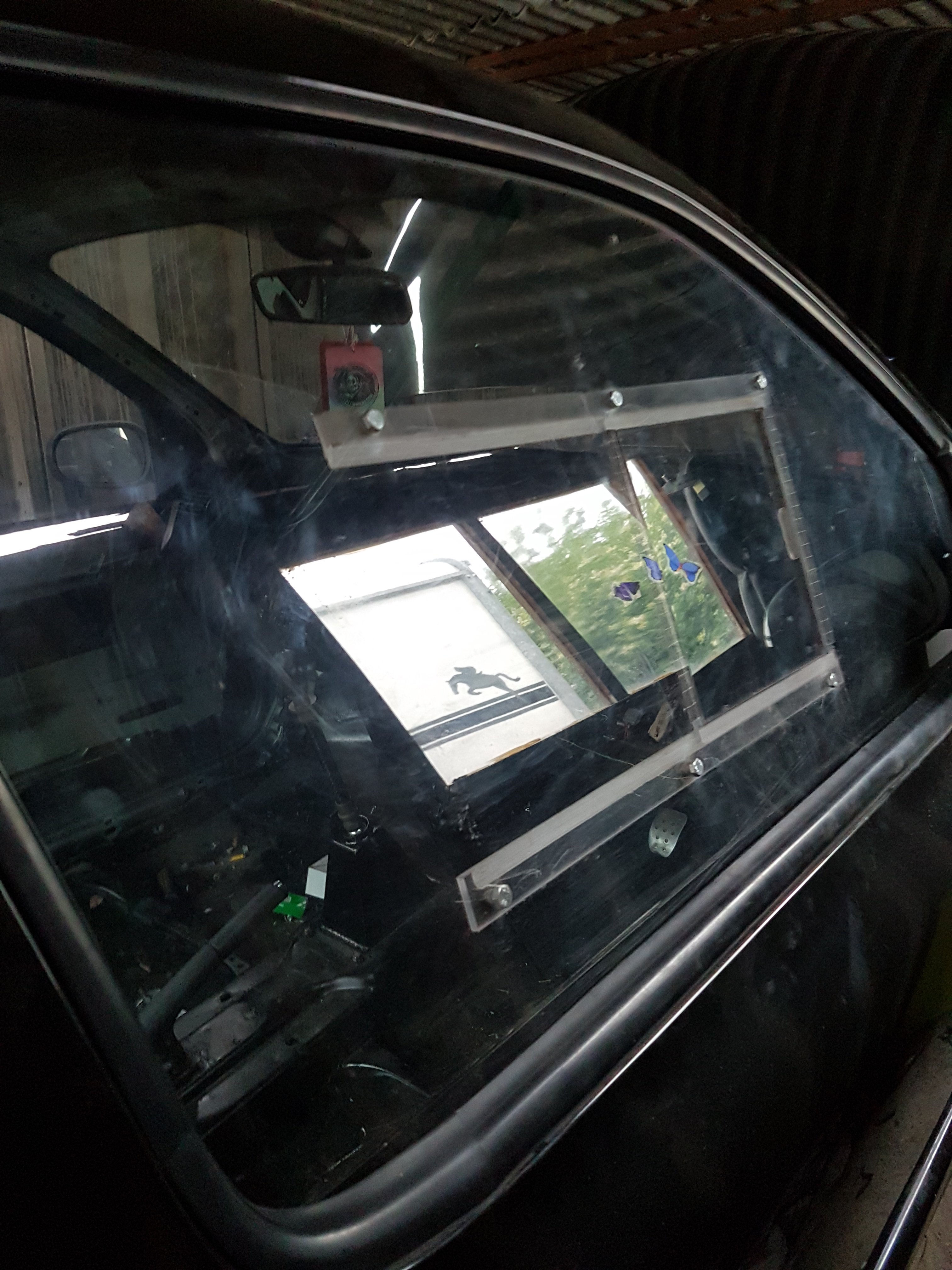

Picked up some poly front windows with lockable sliders, still need to source the rear ones but I'll probably buy new as they aren't that dear tbh.

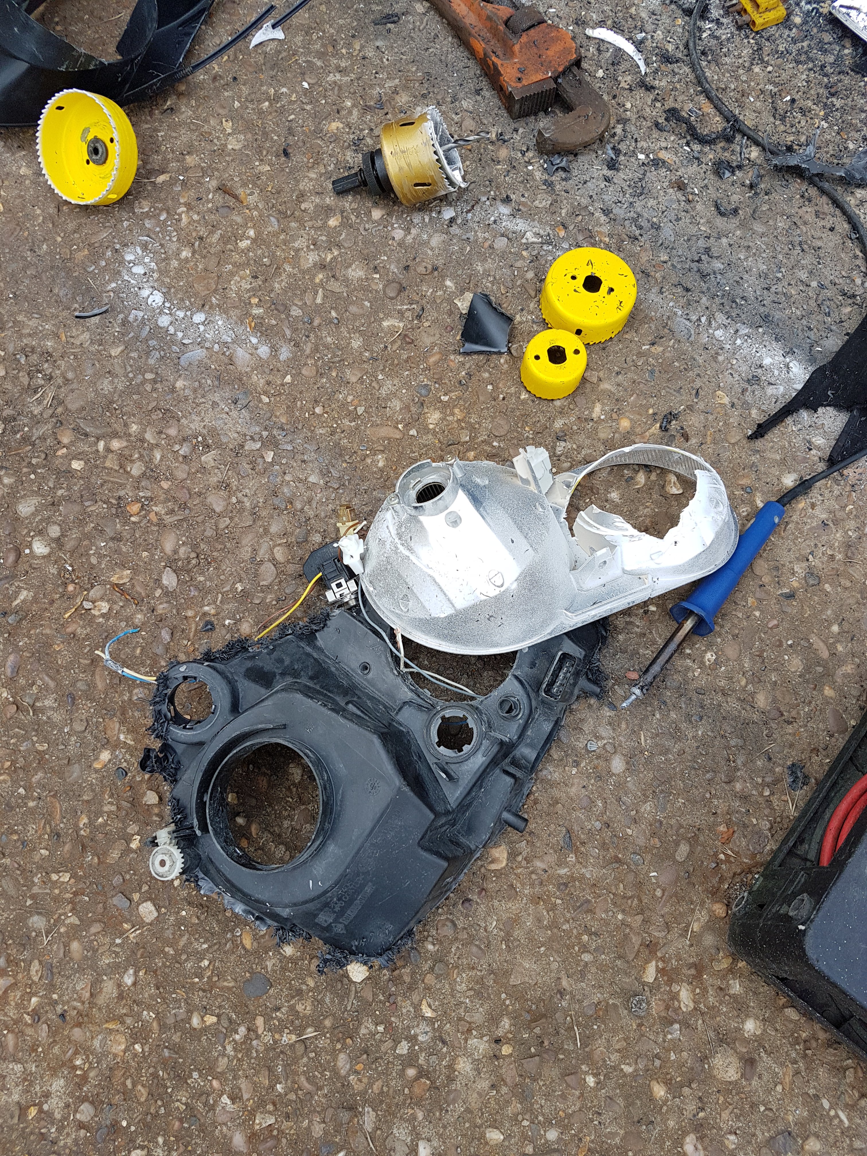

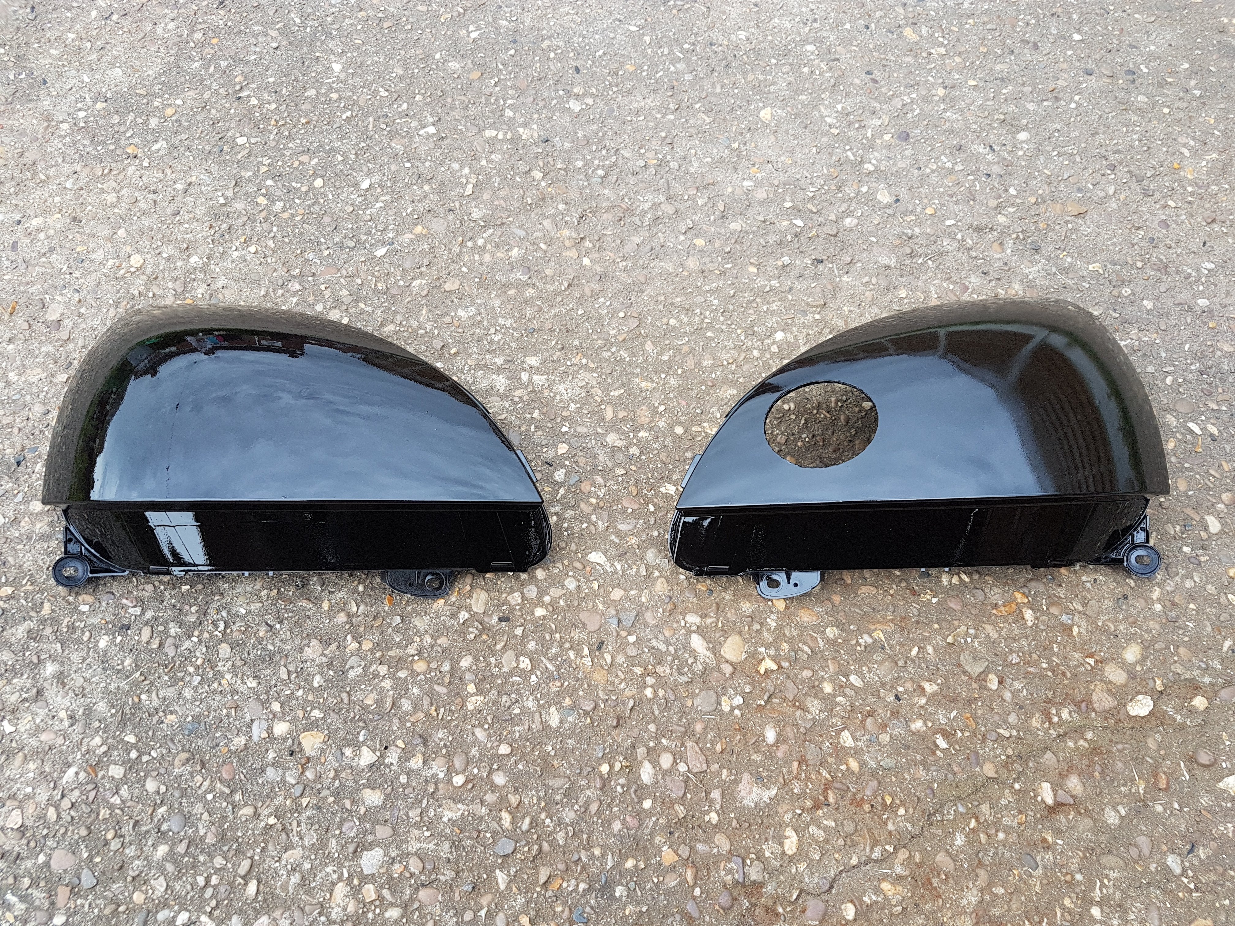

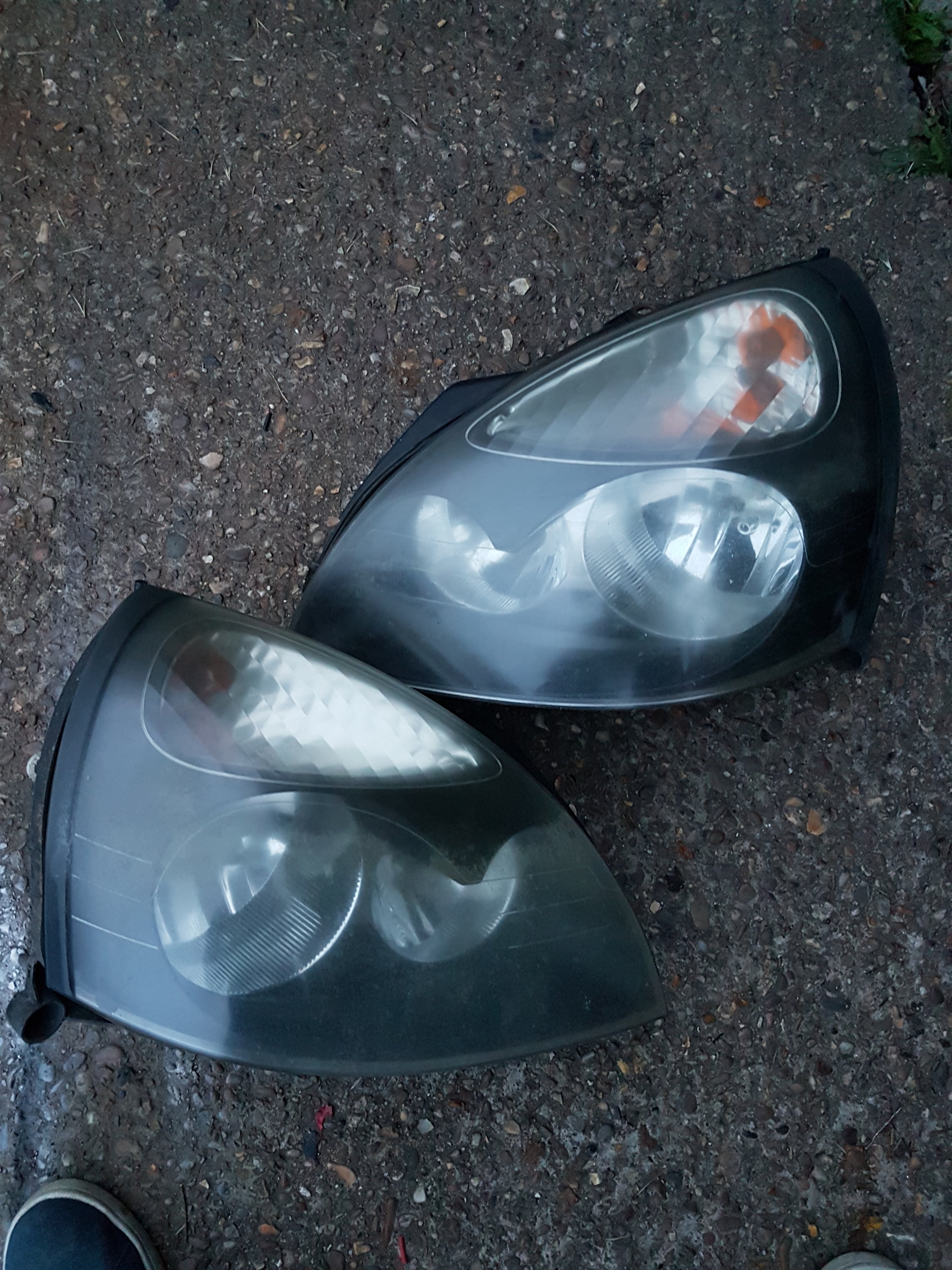

Picked up some non xenon headlights to do a cold air feed mod to do i could still retain lights and use it on the road.
Didn't quite go to plan as it turns out the internals are pretty brittle and having a heavy hand meant i now have headlight blanks instead :D
Edited by SNH
Still need to get hold of a port to tidy it up and i'll just have to settle with swapping them at track days.

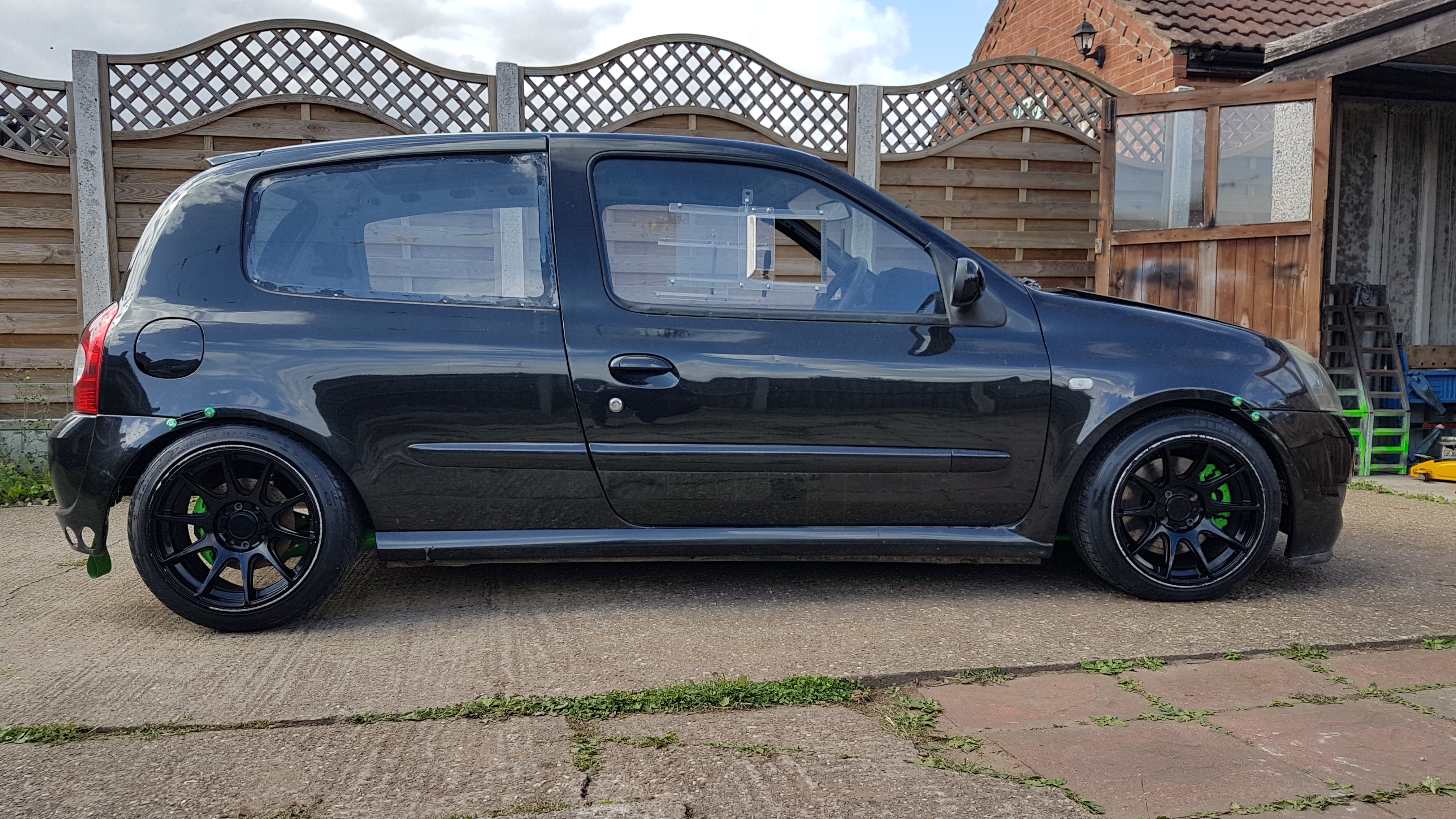

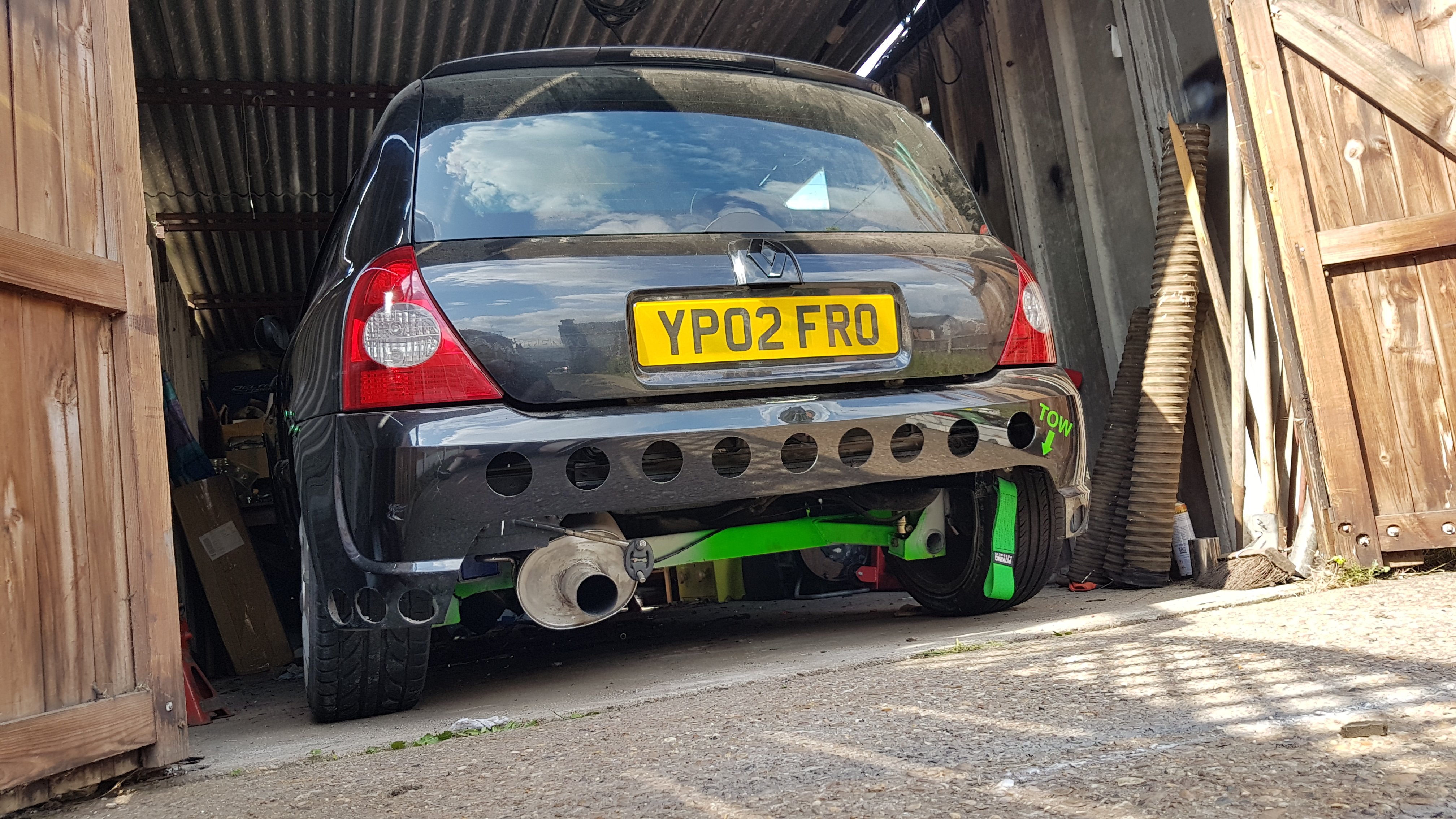

4 week wait was worth it :)
Light at the end of the tunnel!

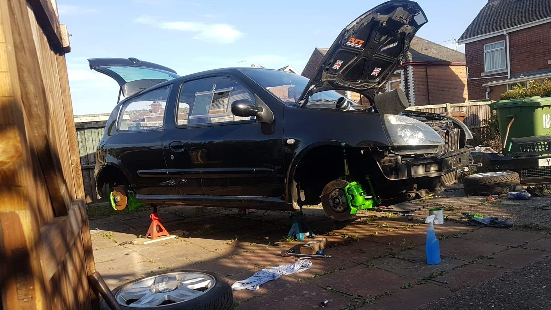

Track rod ends and ball joints then it can have the front wheels fitted so i can roll it about.
Edited by SNH
Edited by SNH
1 minute ago, SNH said:
Nearly there, Got it booked in for a shakedown track day yet?:thumbup:

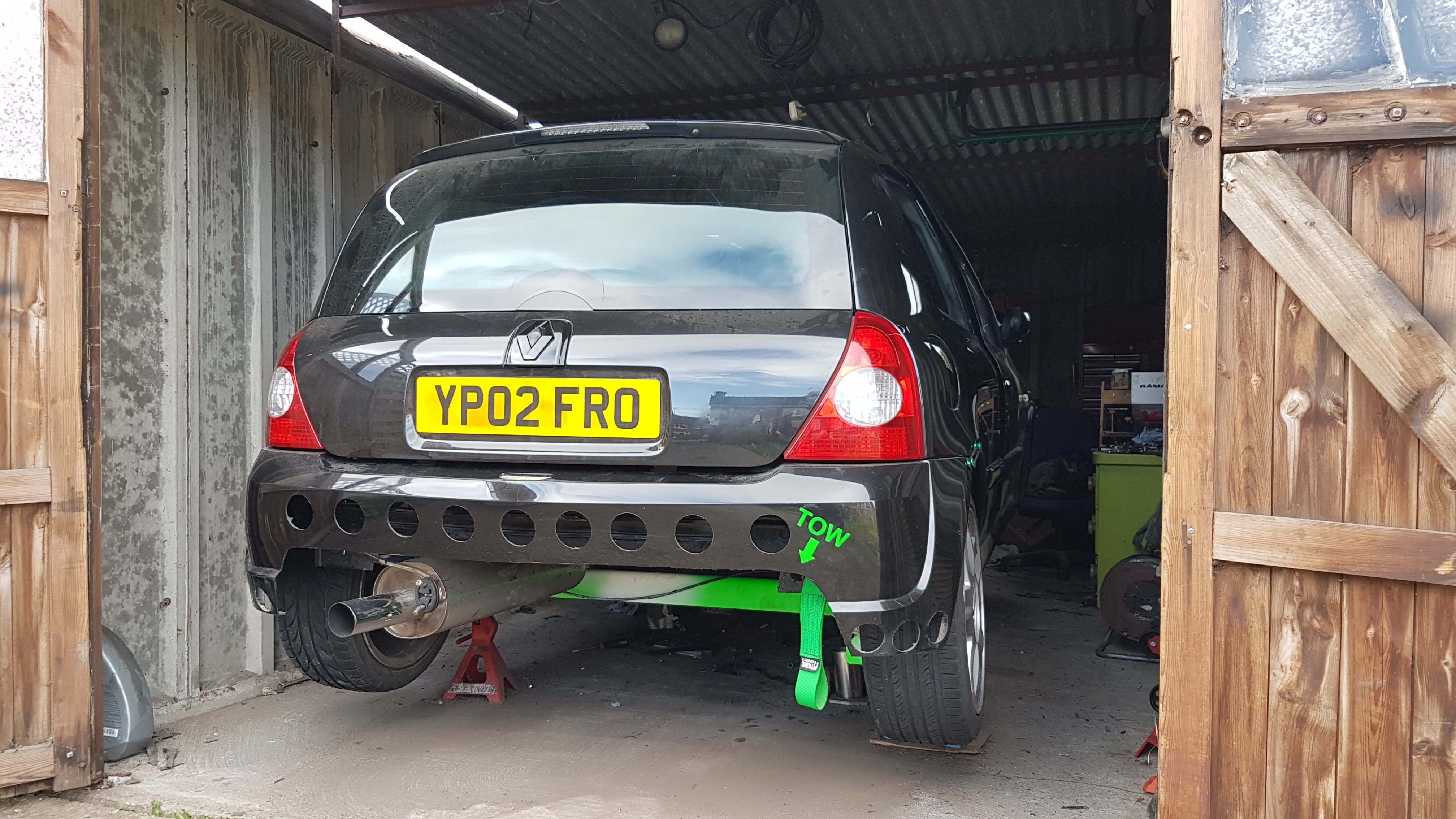

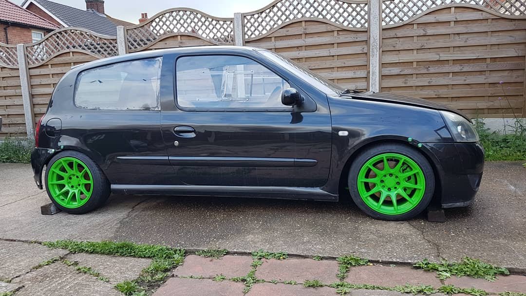

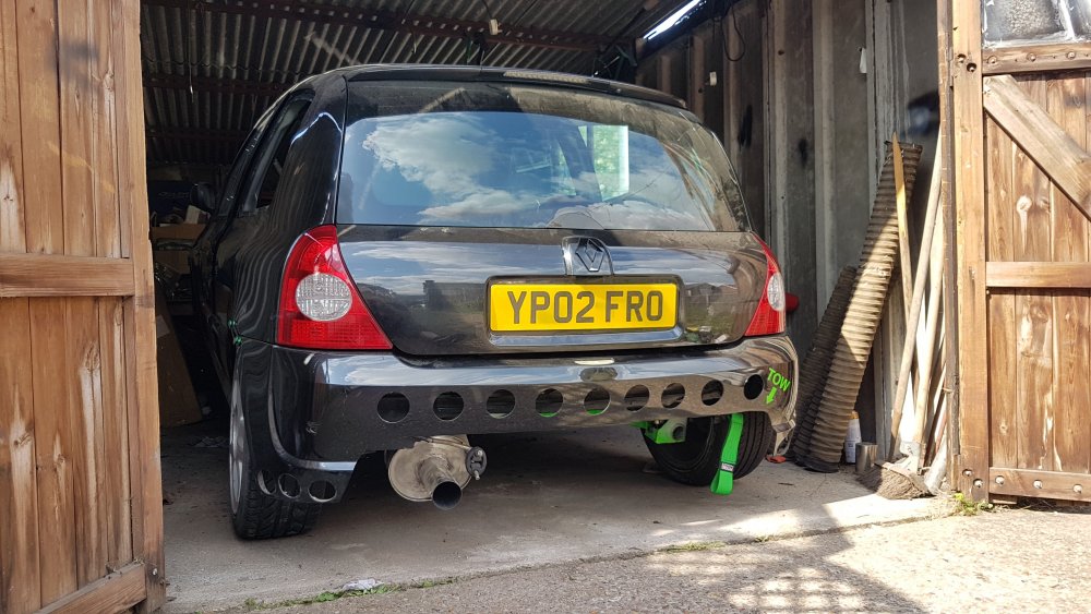

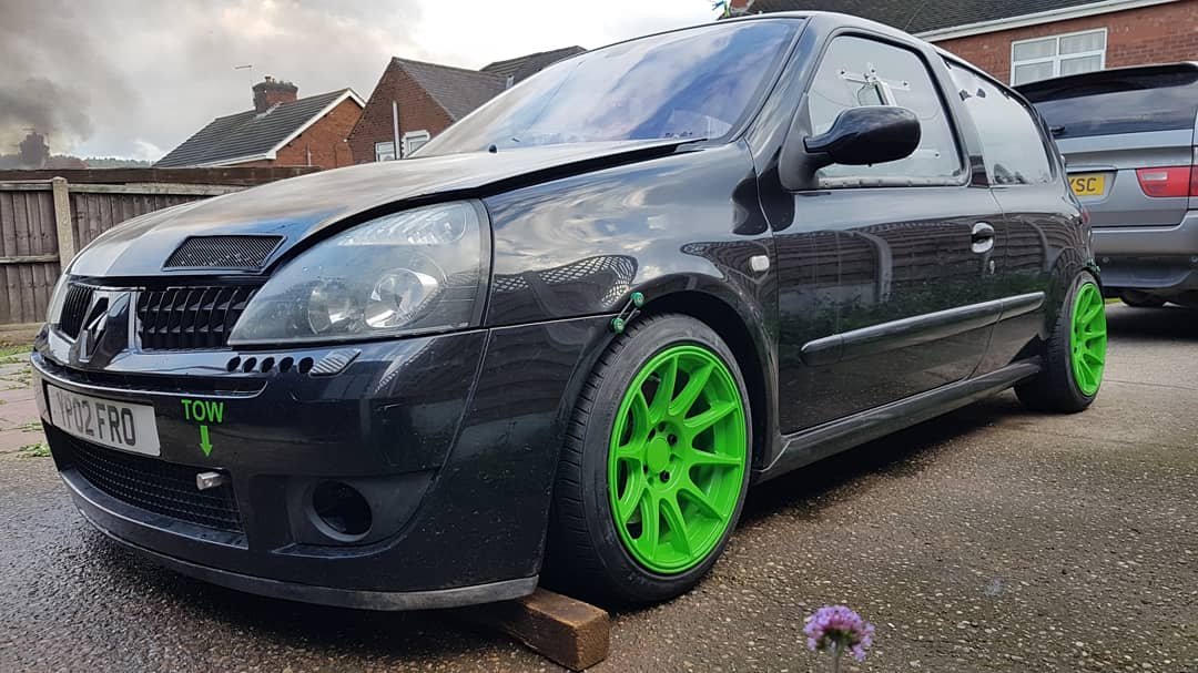

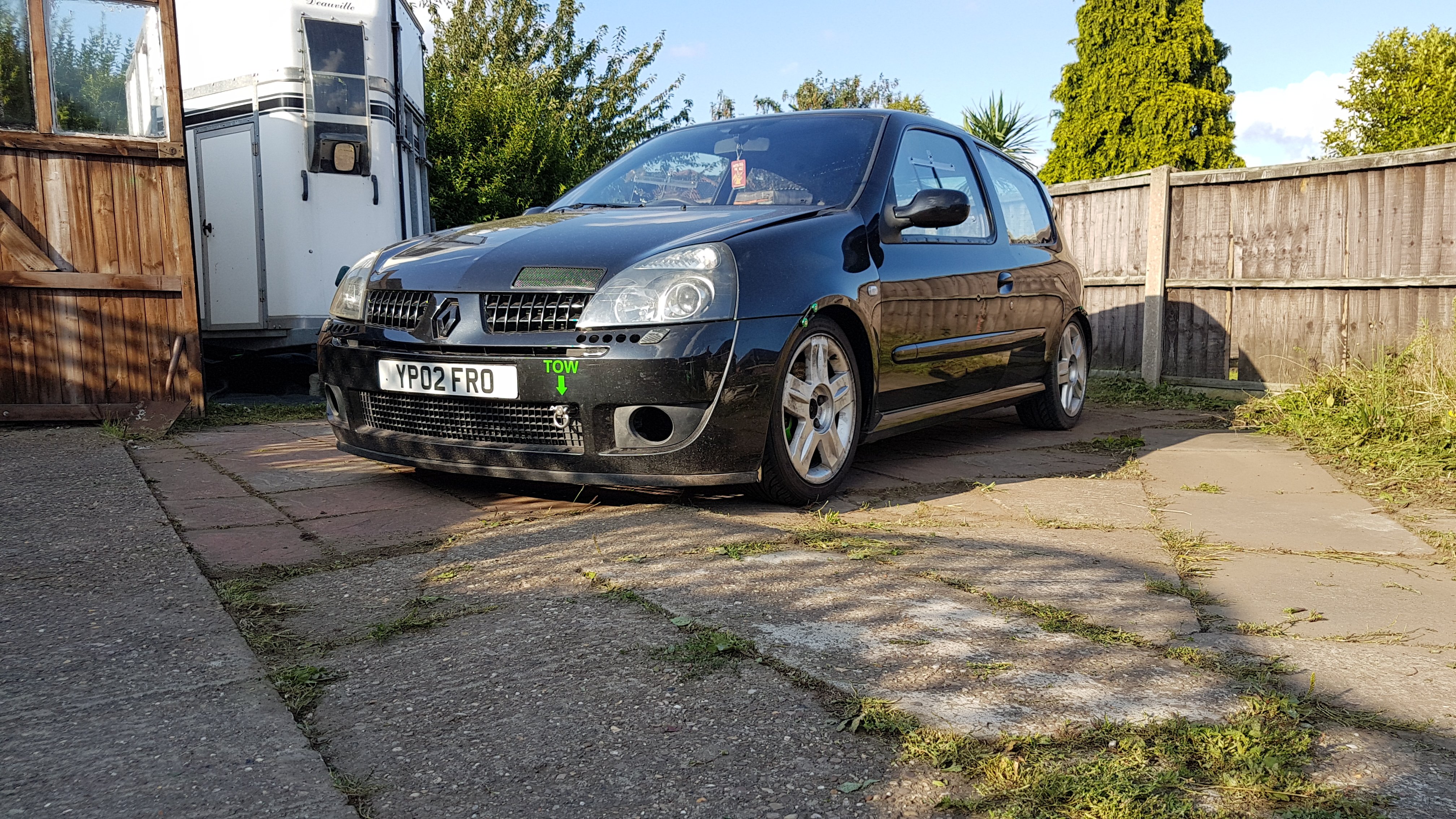

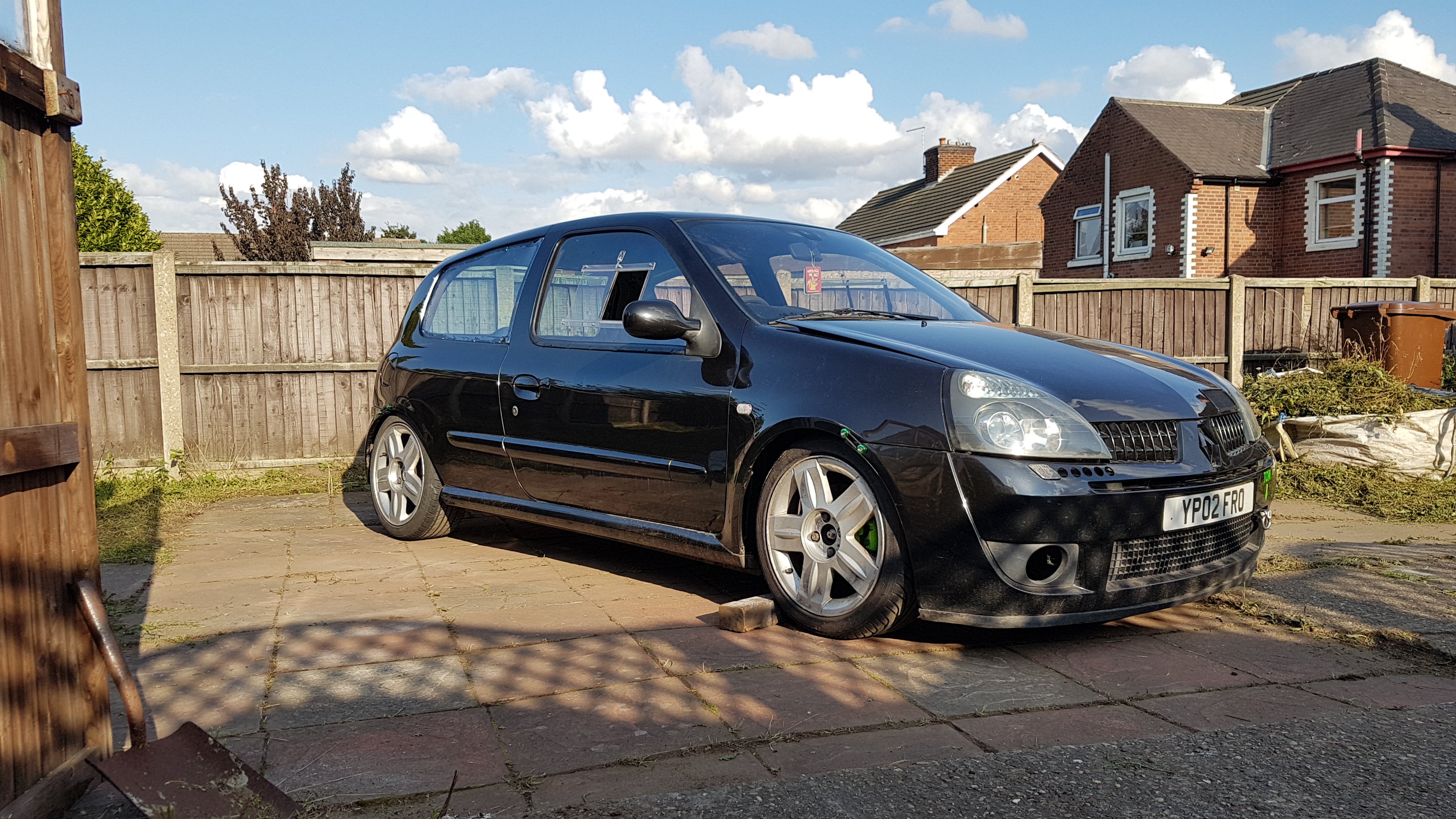

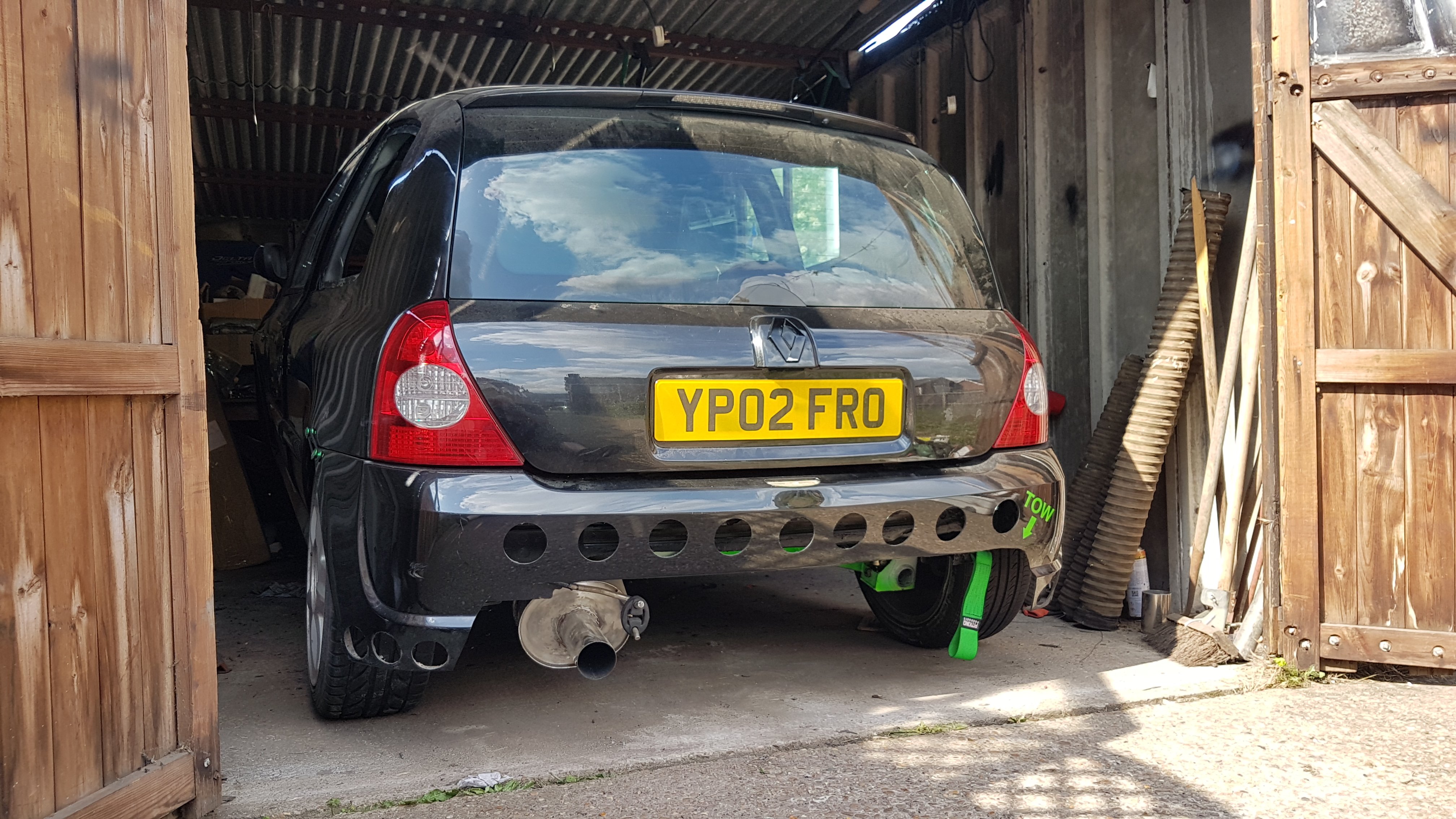

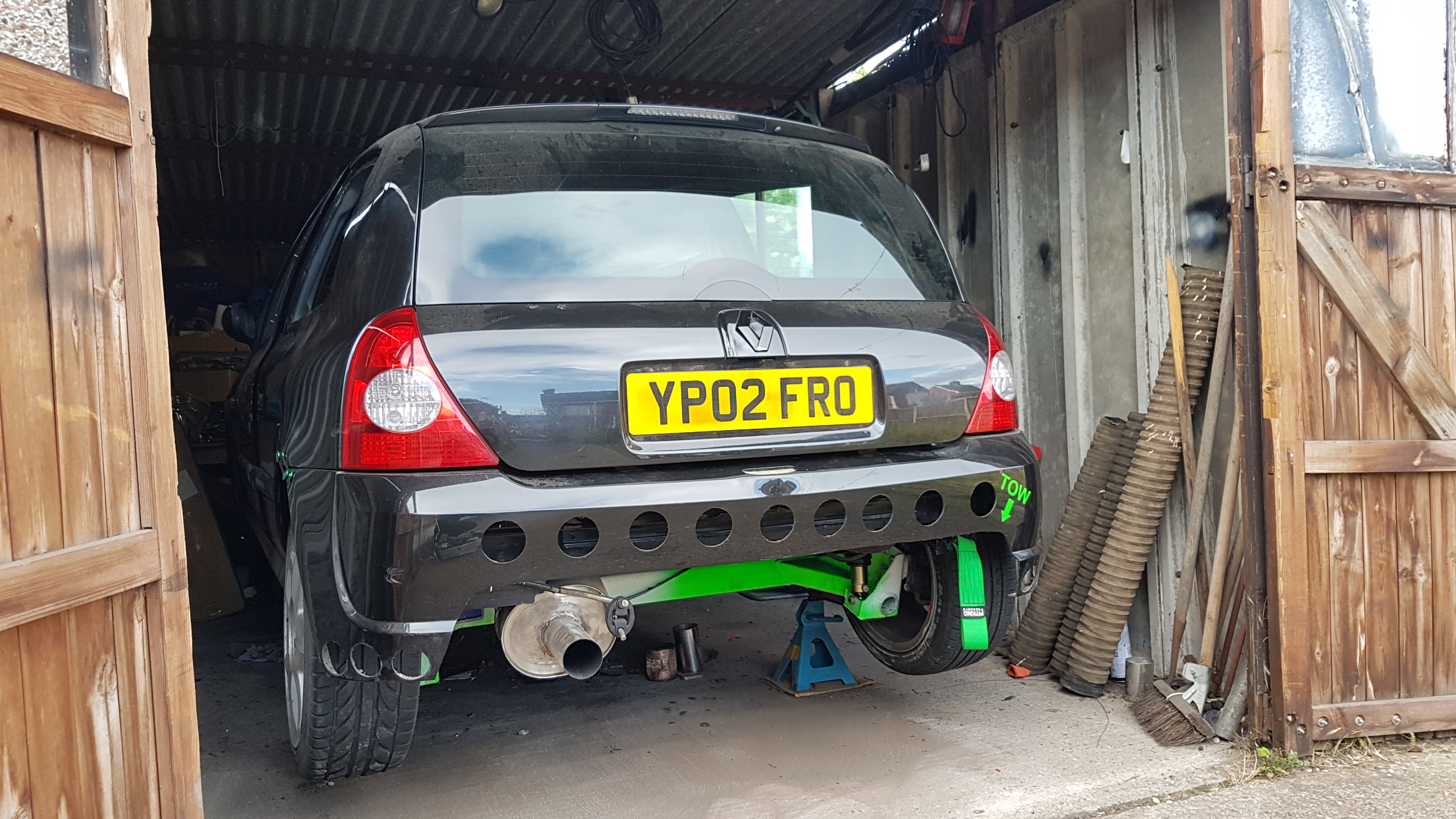

So its on all 4's again!
Ordered lemforder rod ends and ball joints from ecp and for some reason they sent them seperate, rod ends turned up yesterday and joints today :D
Wheels are only temp things to roll it around while i decide on some 15's since getting rid of the super t's,
Suspension wants a fettle to get the ride heights something like front and rear.
Still plenty to go at but its getting there :)

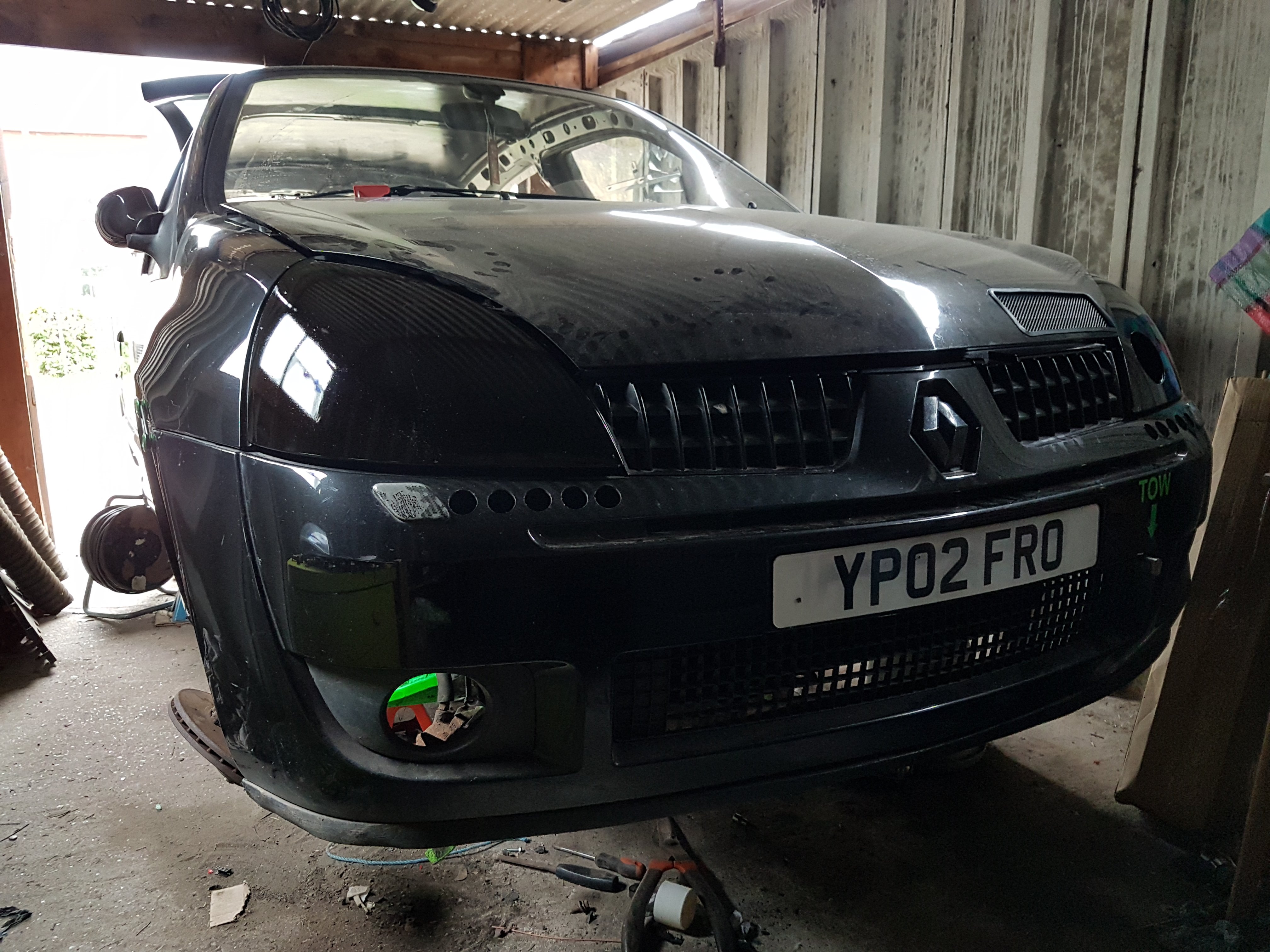

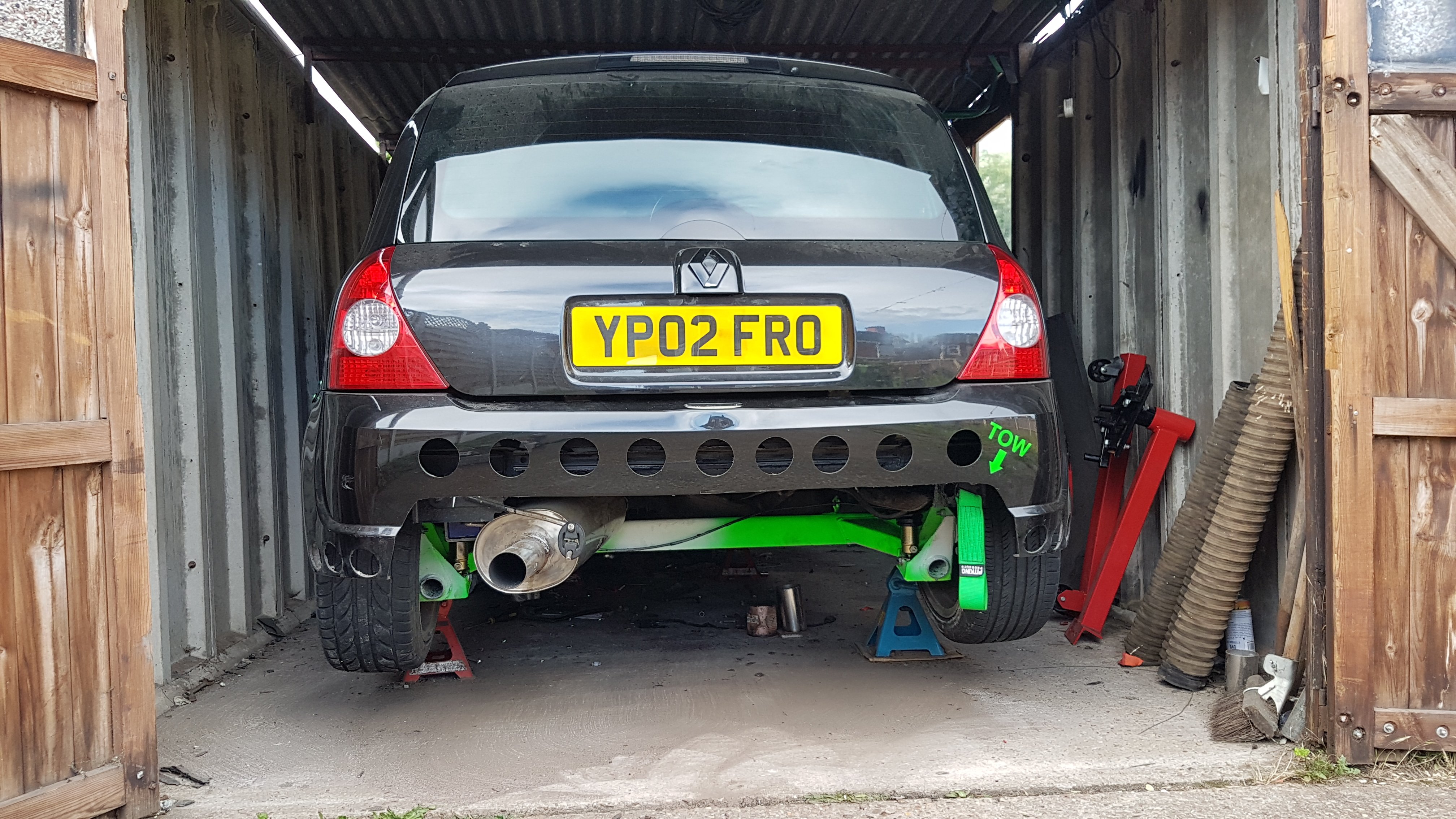

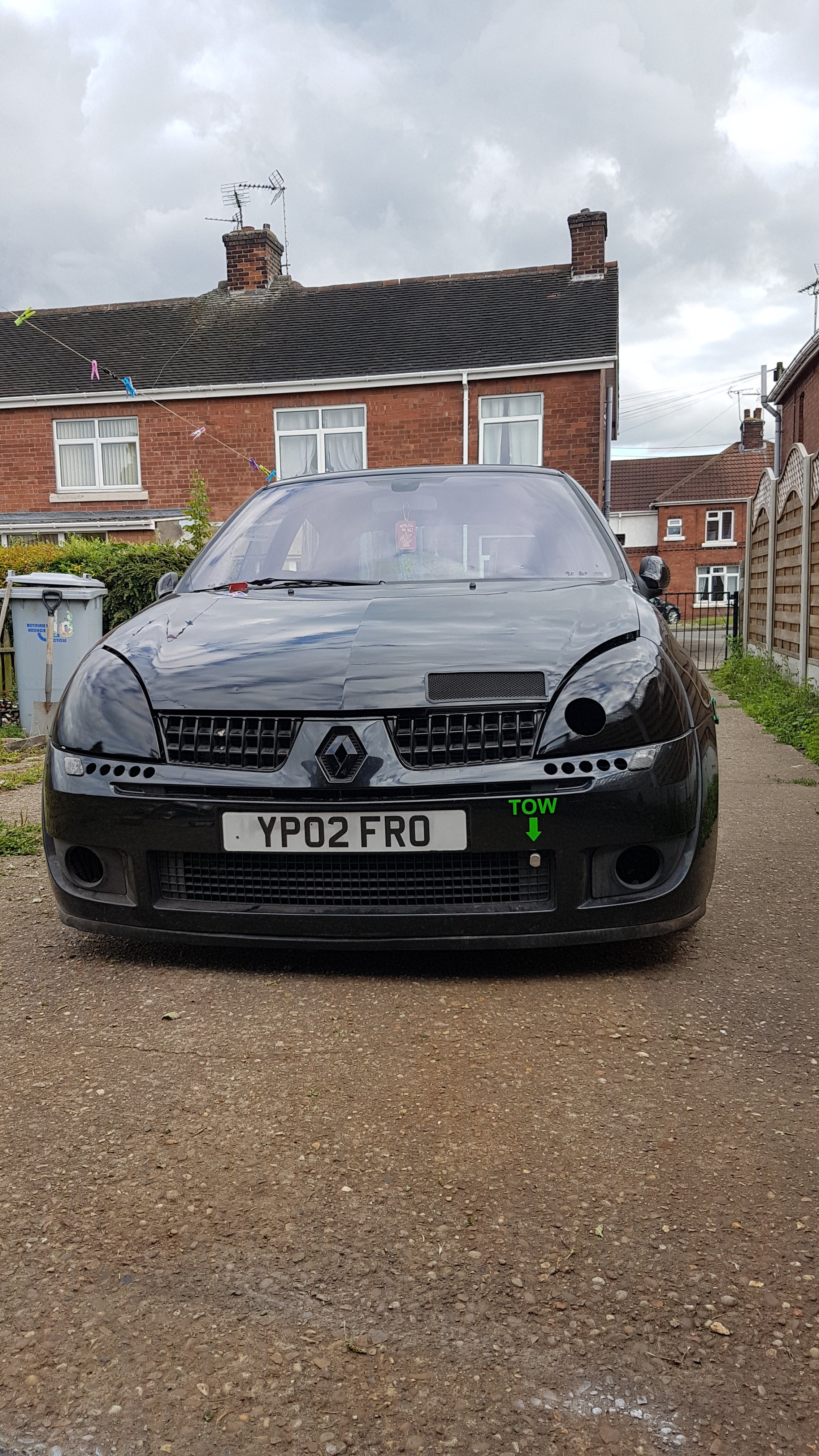

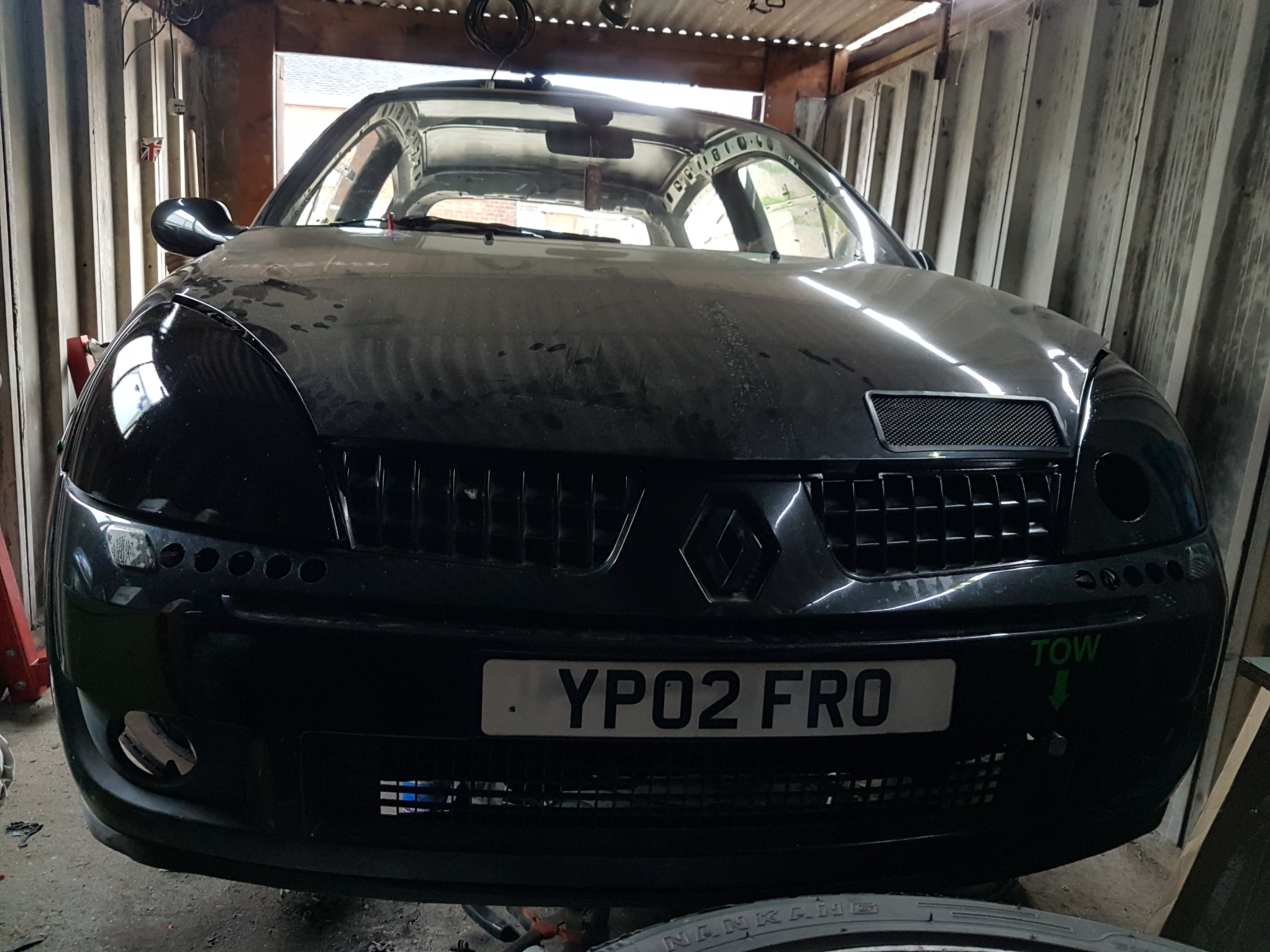

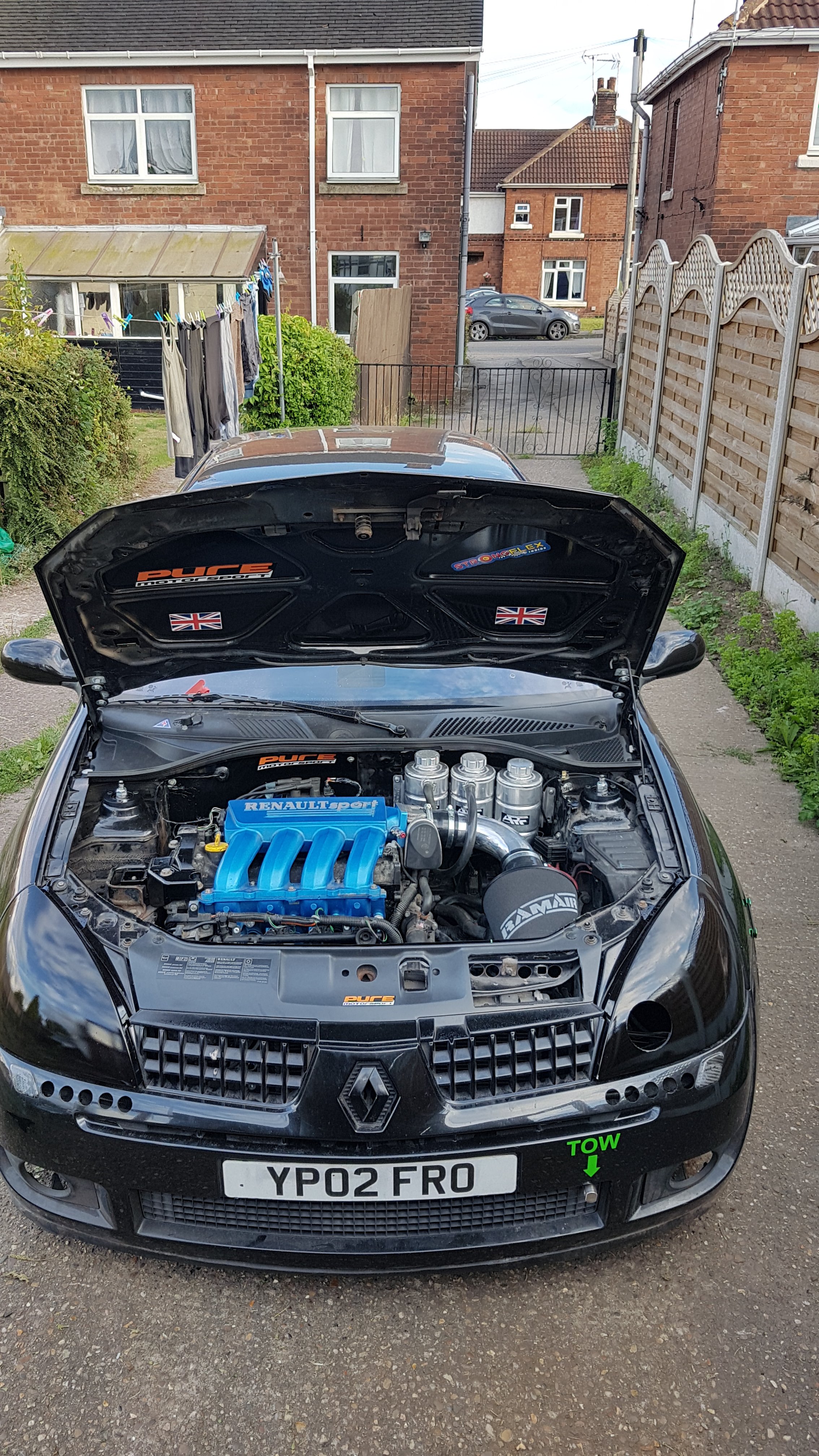

That is the plan,

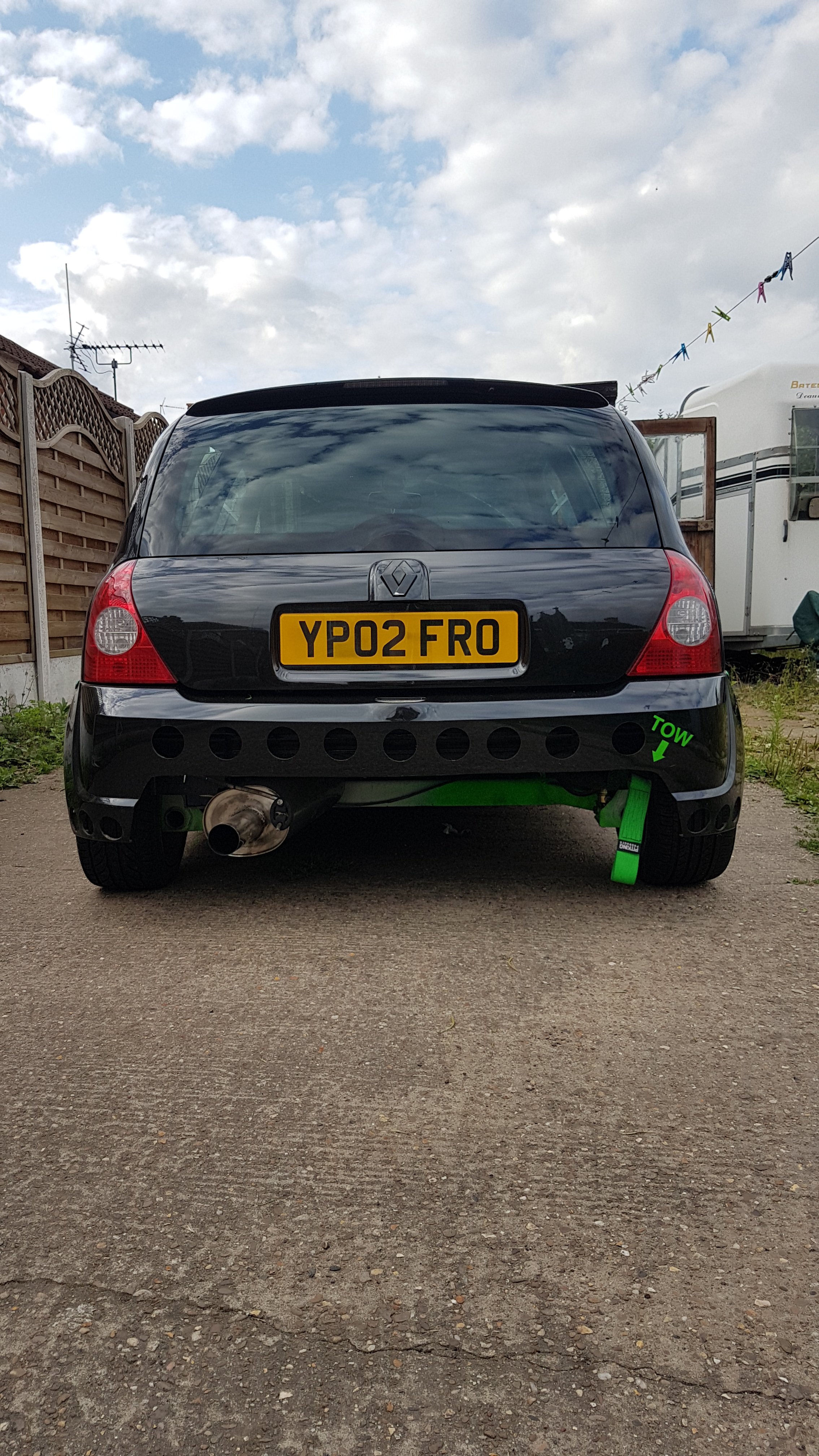

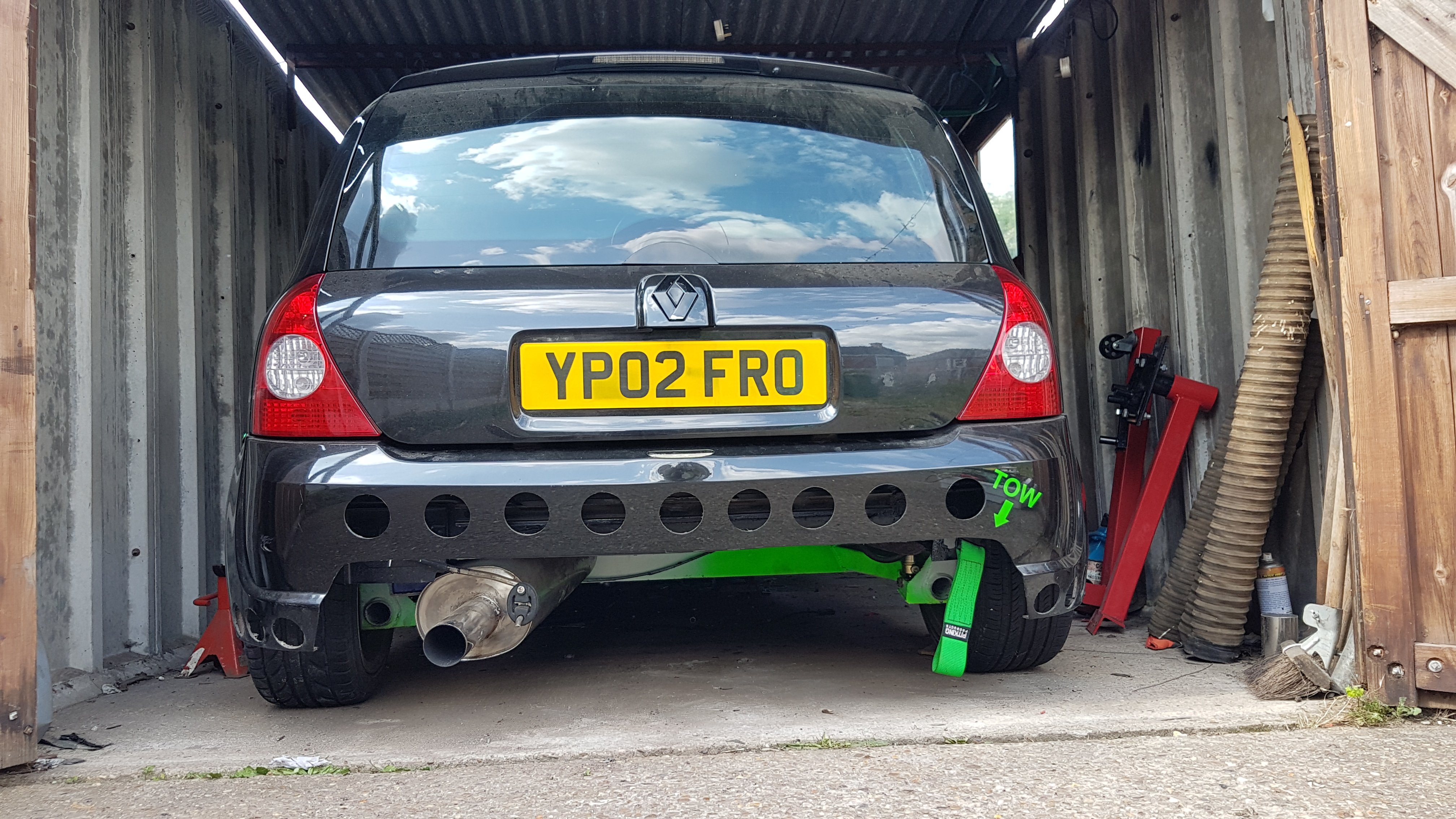

Bumpers now quick release and the light blanks use the oe mount holes so take seconds to swap over at track days.
There's no warning lights on the dash so everything will be pretty much mot'able ;)

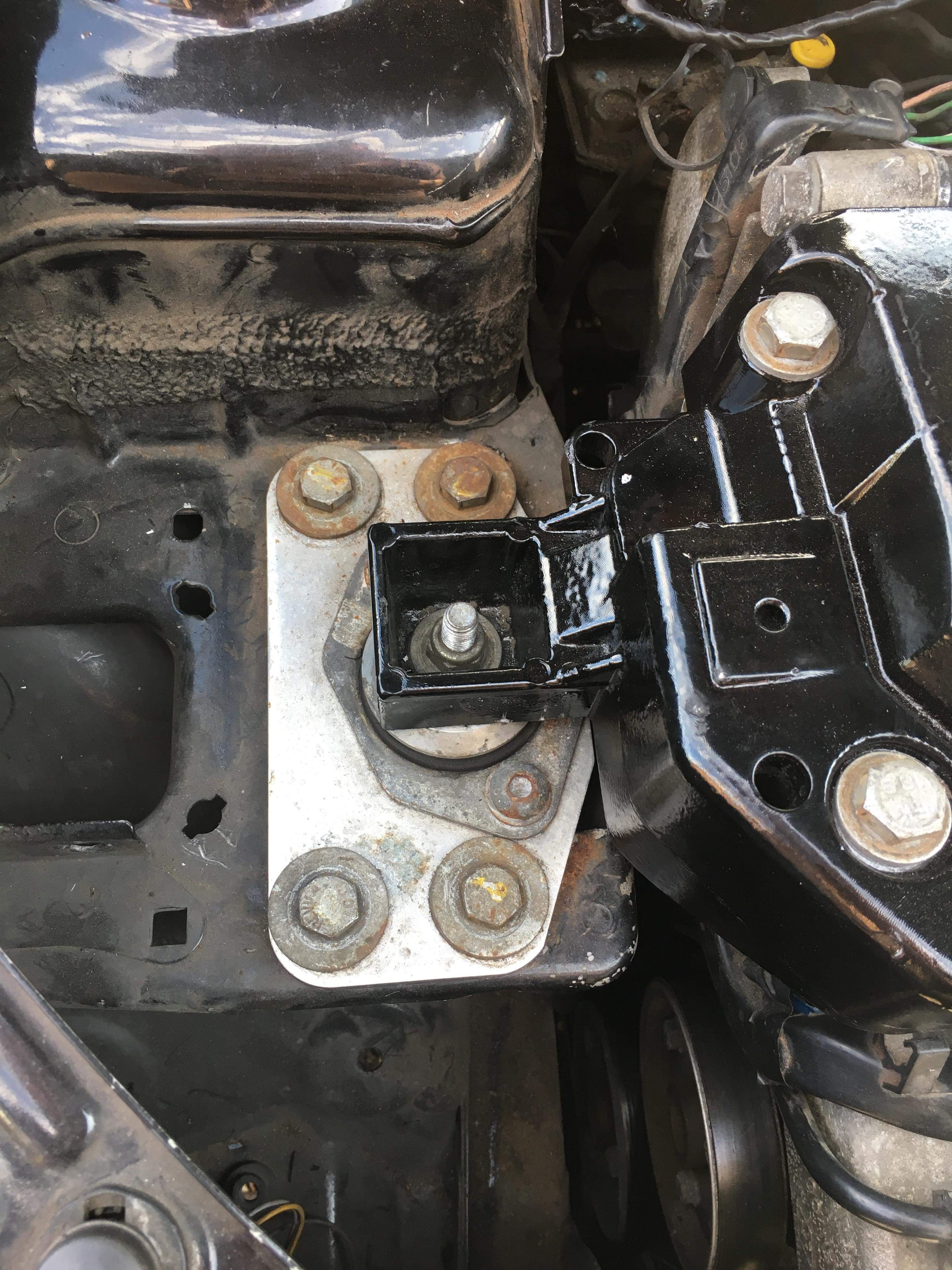

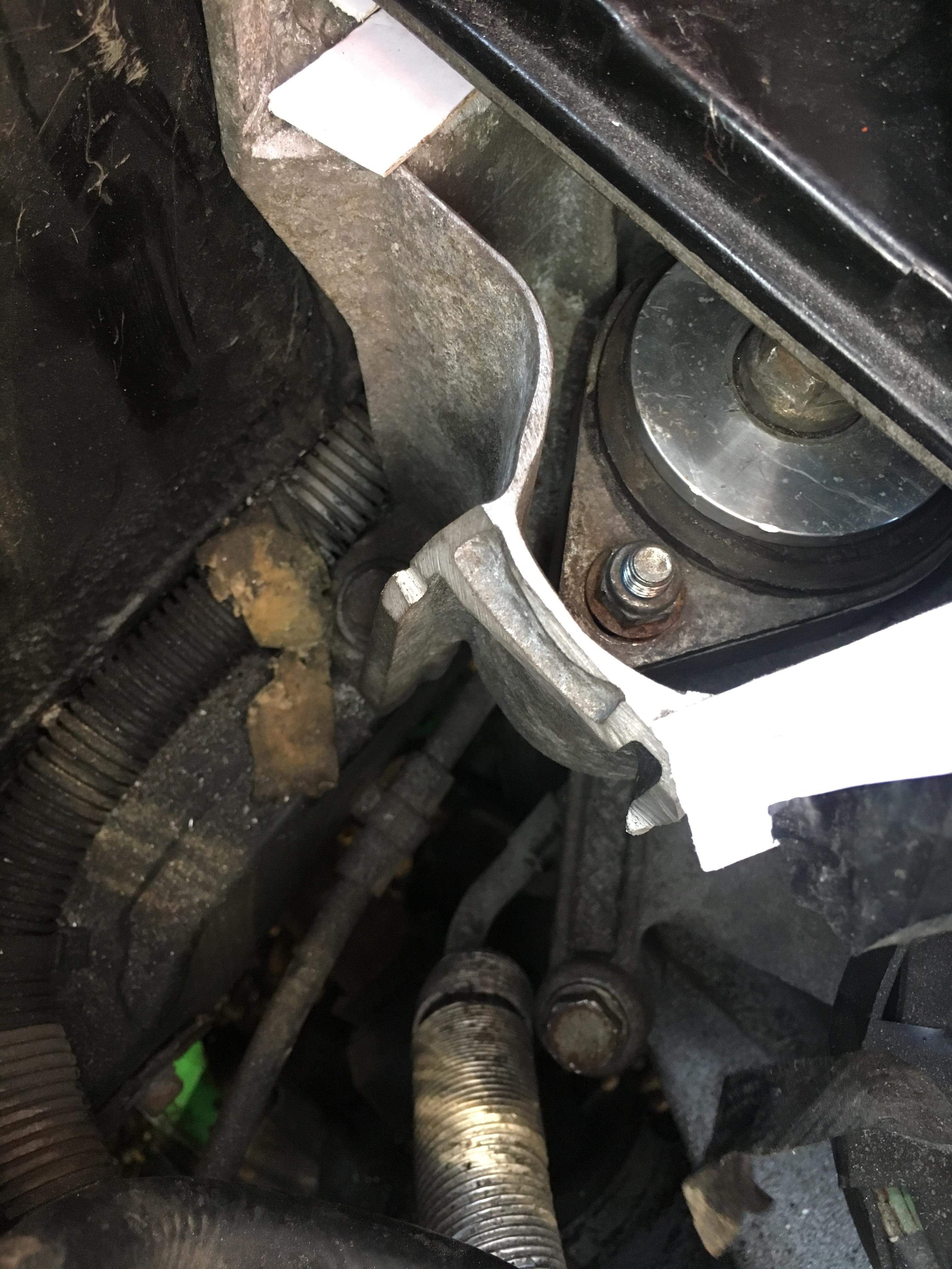

Solid engine mounts on.

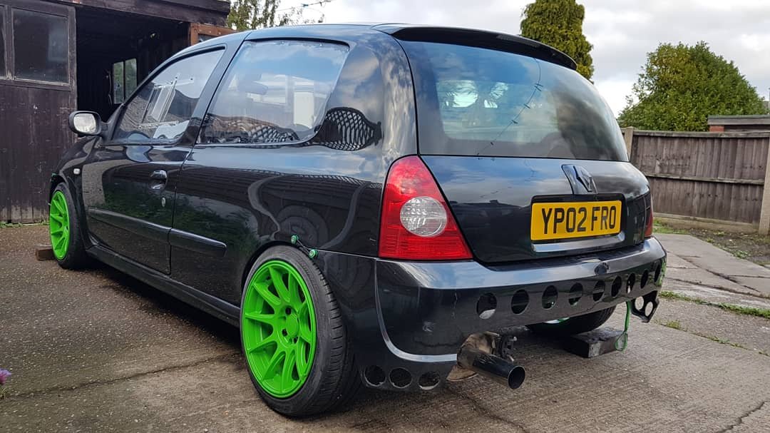

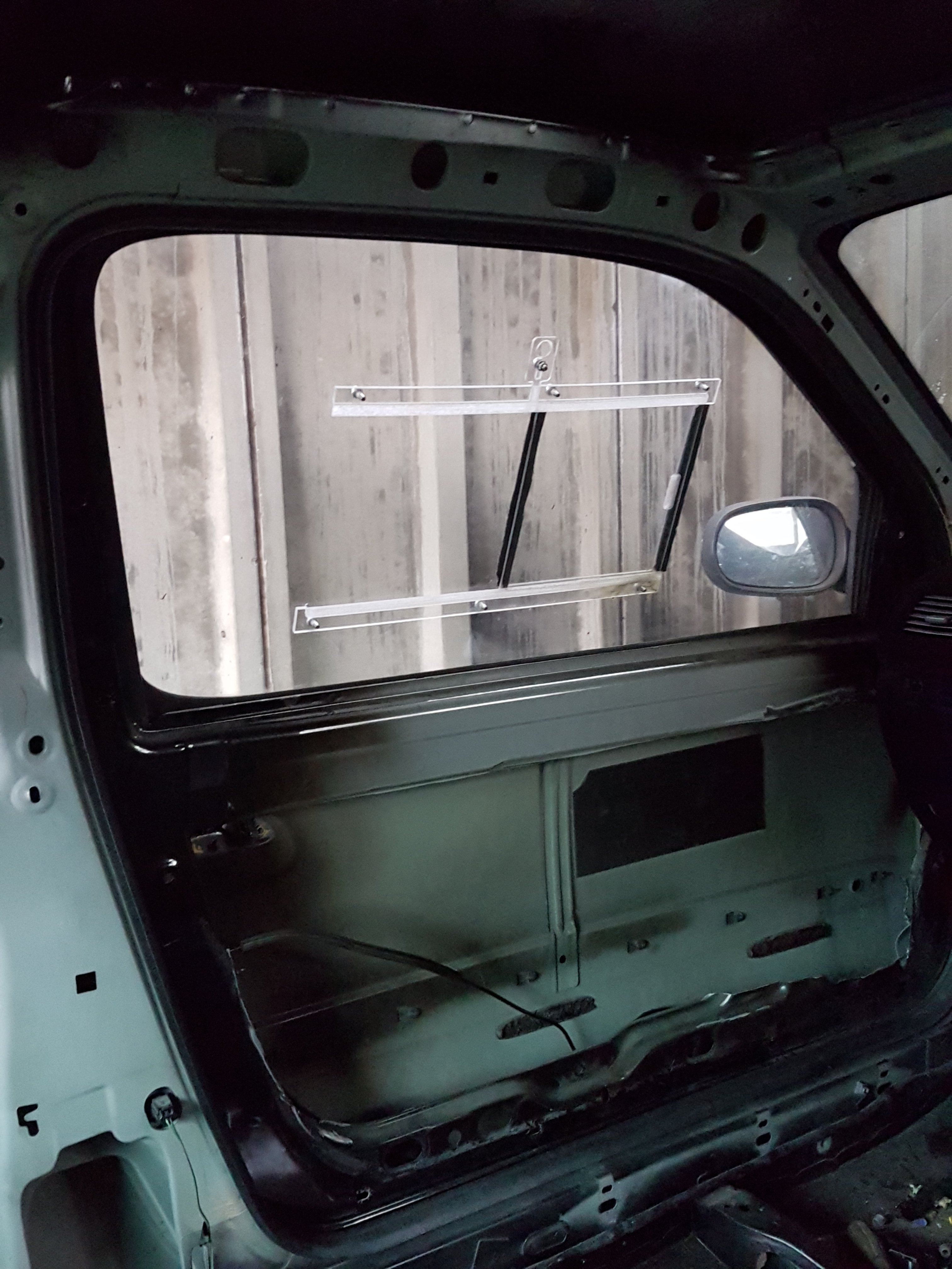

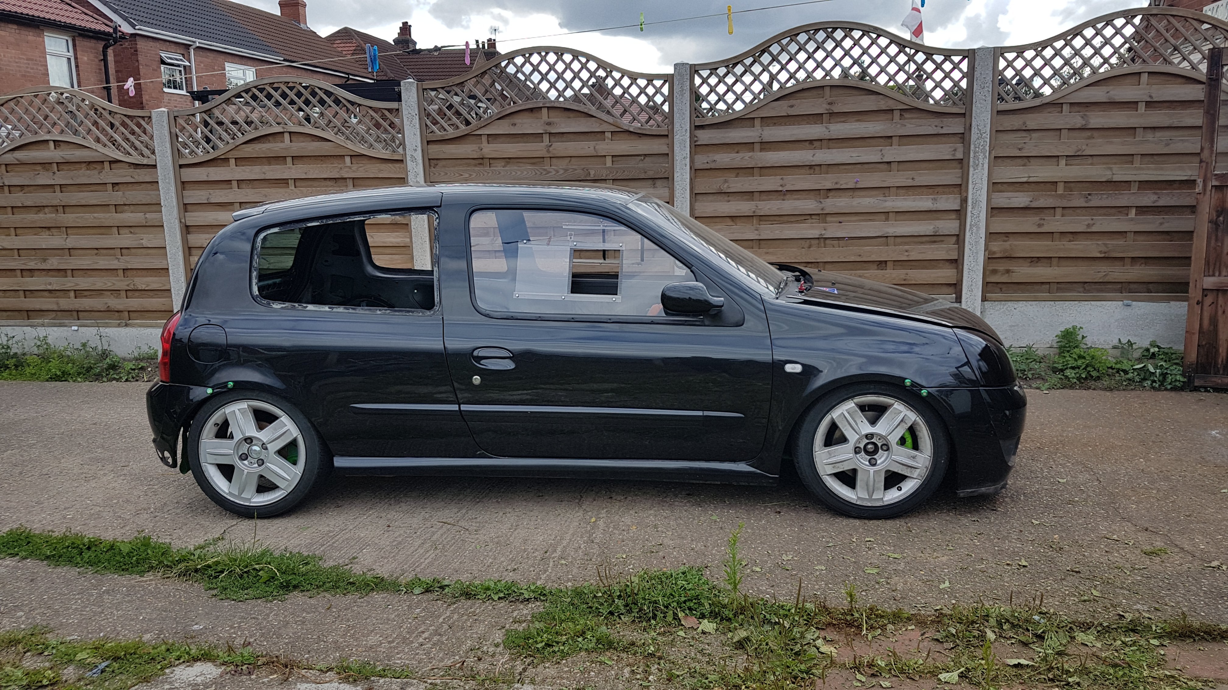

Rear poly windows are in
Abs is deleted (waiting on internal braided kit coming to replace all the lines.
Handbrake cables on

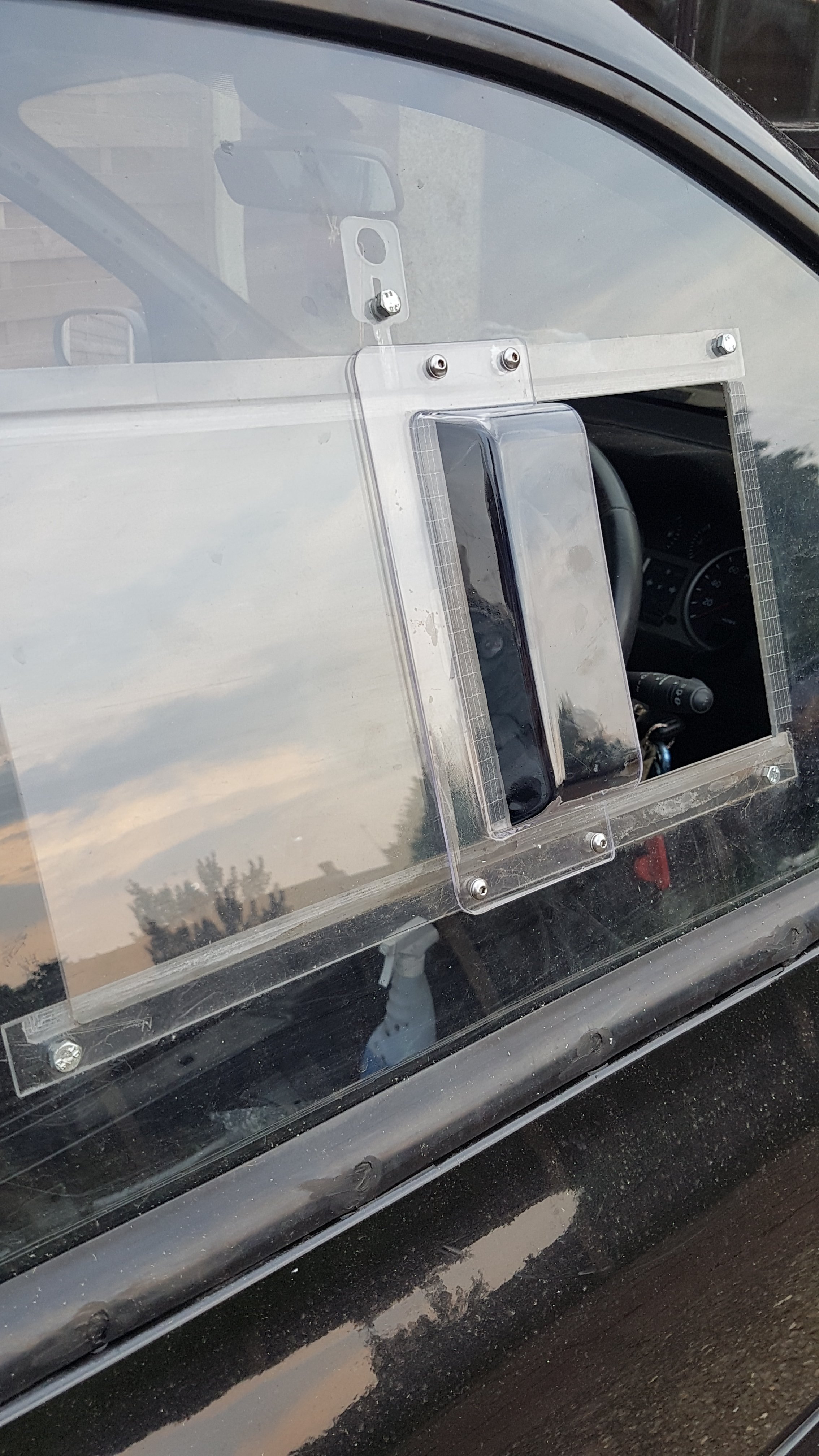

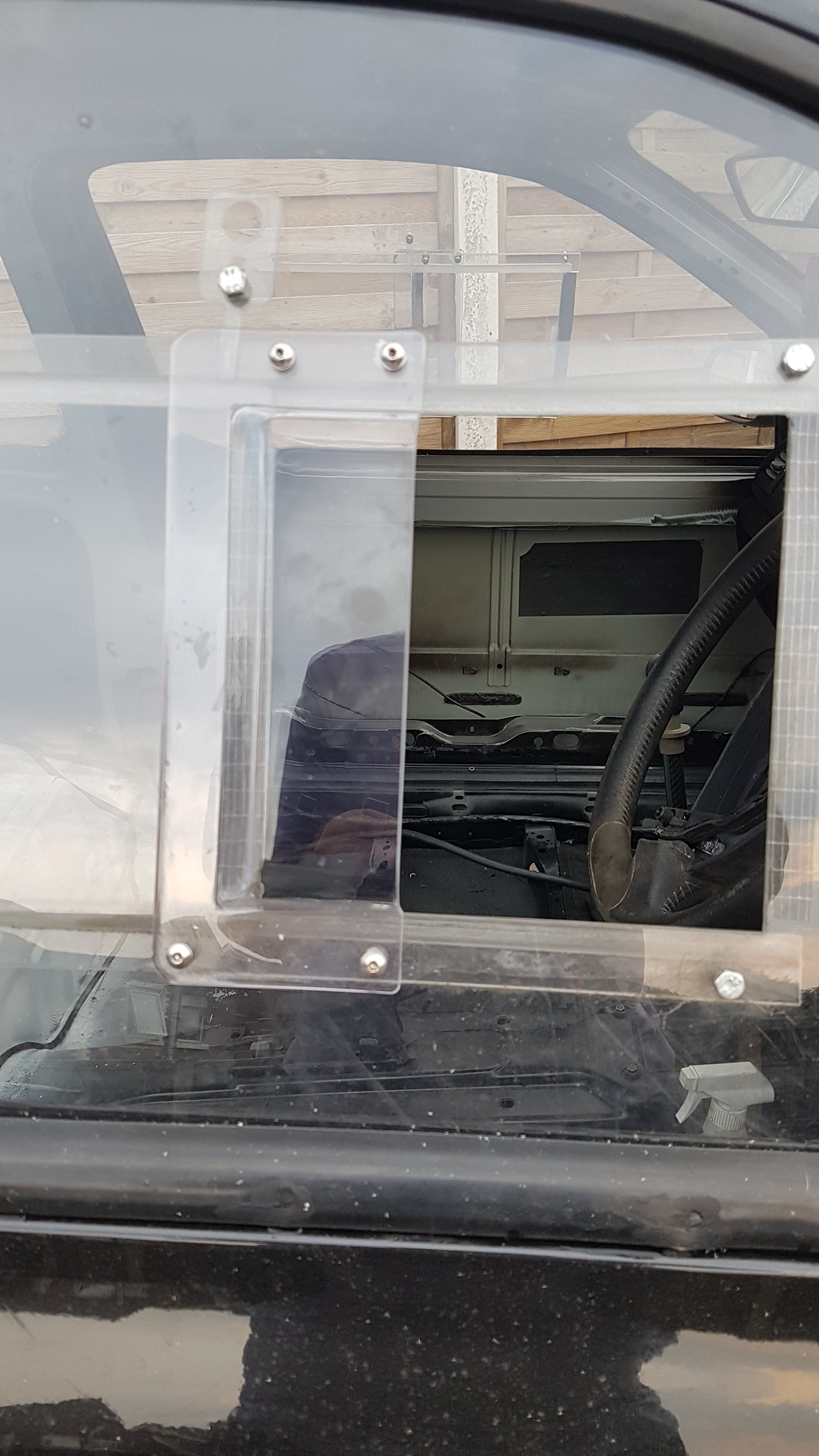

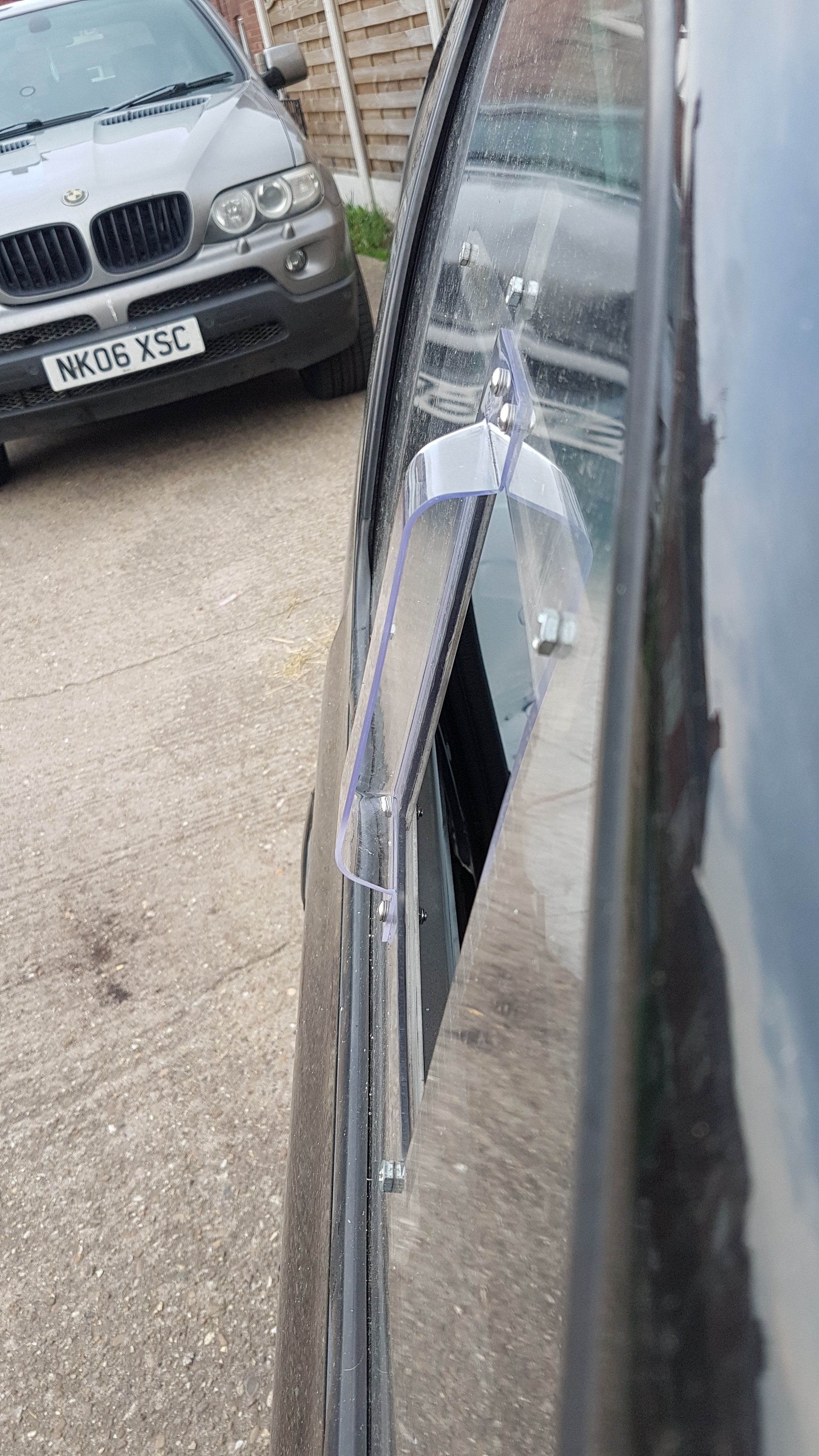

Poly window slider scoops ordered
As there's no aircon i want a roof scoop but have been told to try these first as the scoops tend to be really noisey.
Ordered from acw motorsport plastics (same place i got the rear windows) to give them a try.
Slider scoops to try and force some cold air in :D

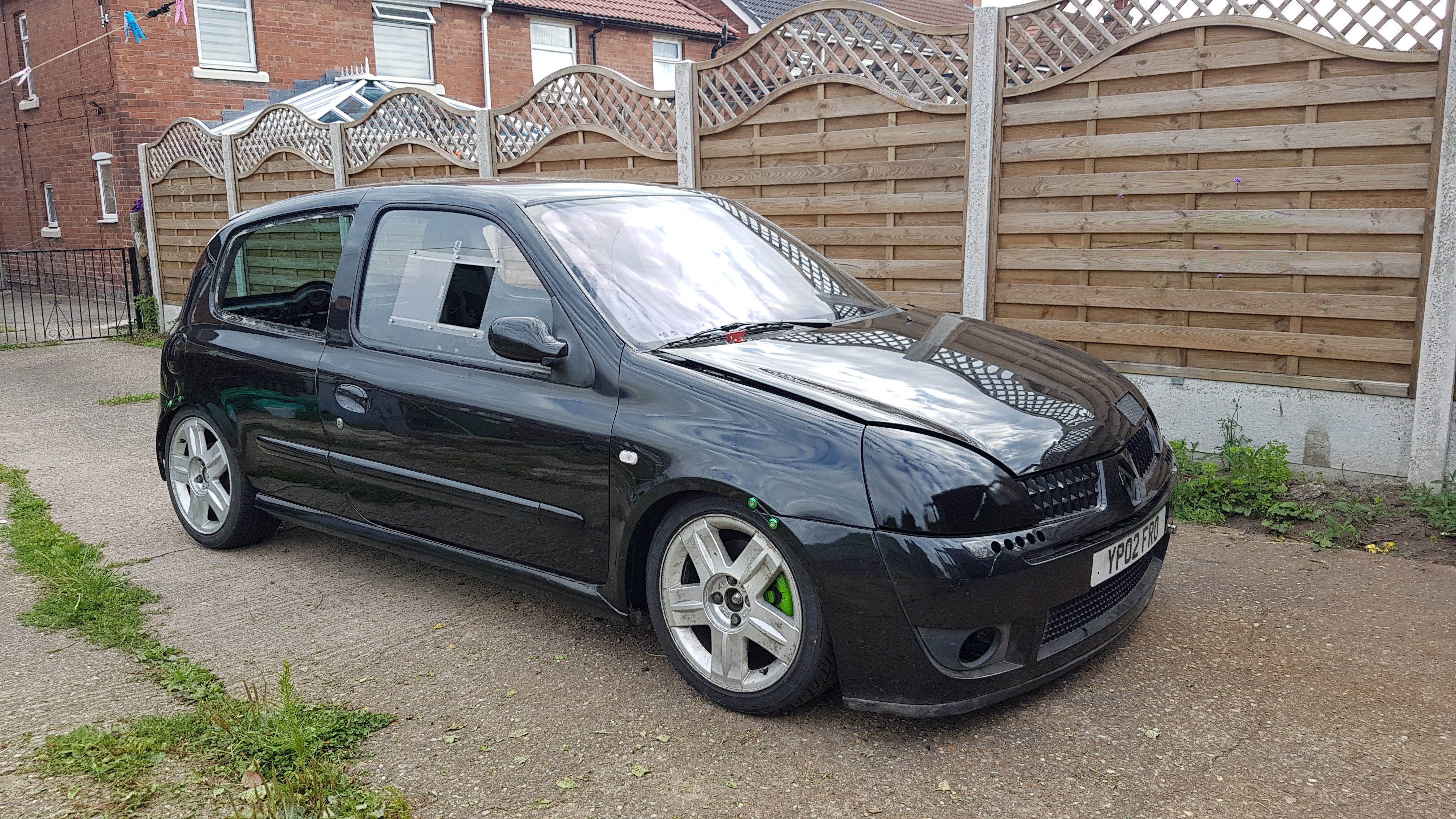

Had a couple of 172's in this last week so I've managed to grab a few bits off them for mine.
Decent rear calipers as i think one of mine is sticking and some 15's.
Not what I'd have bought as i hate multispokes and black wheels but they were free. bit wide for track but they'll do for the road. They want some decent rubber once its driveable and a refurb which is happening today hopefully.

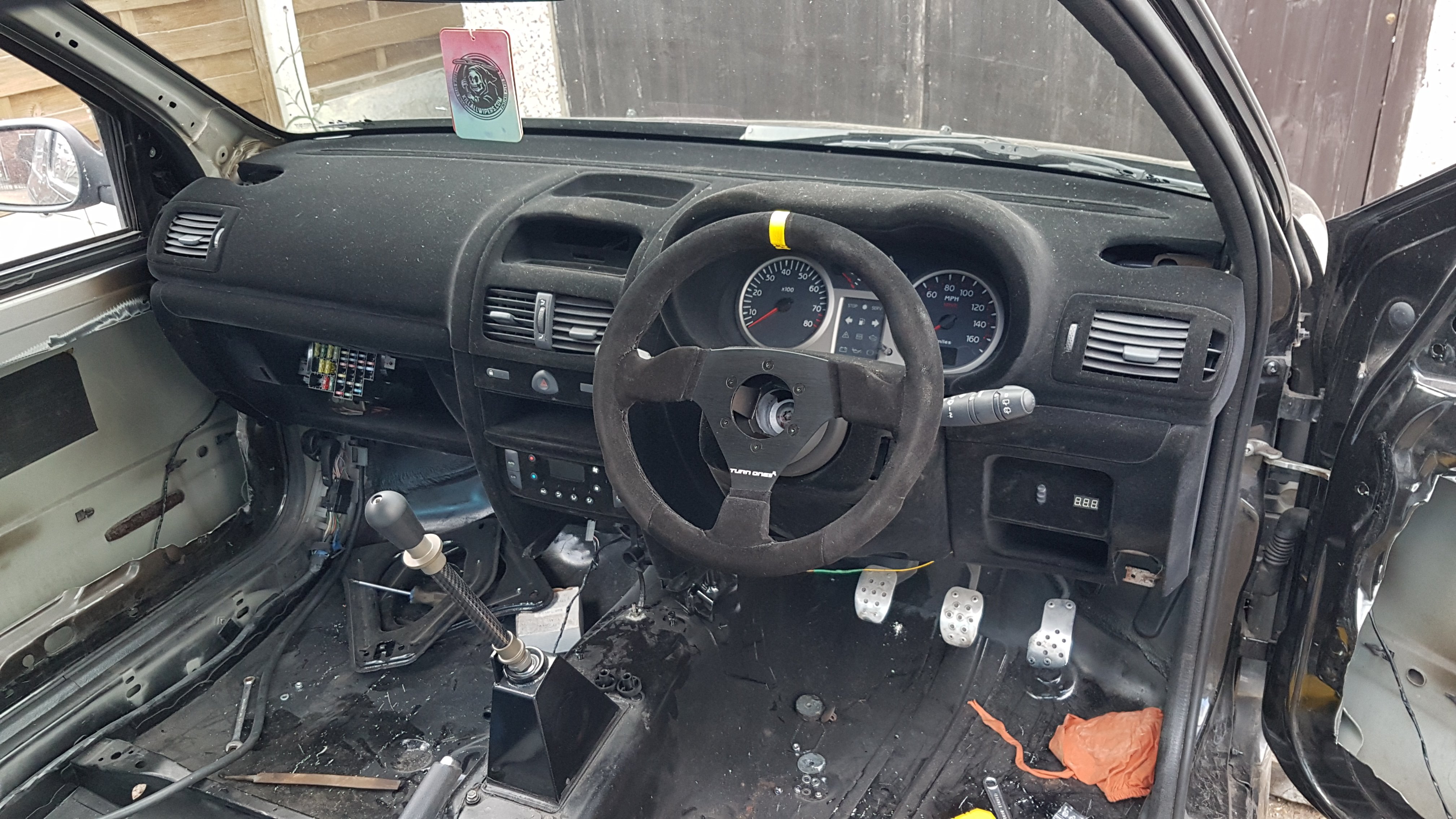

New steering wheel and boss also arrived too :)

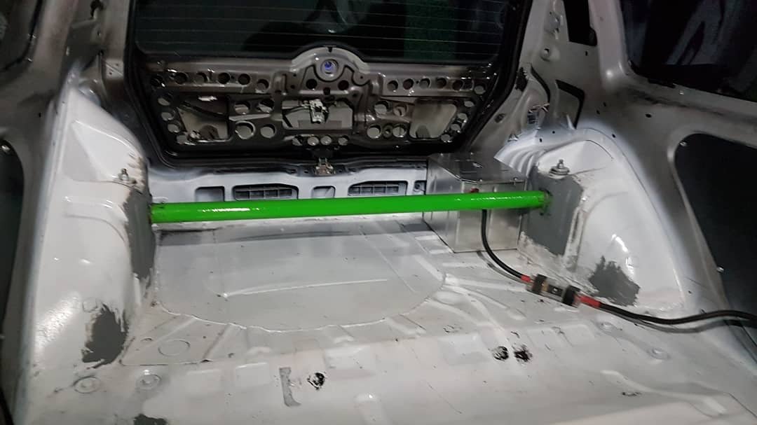

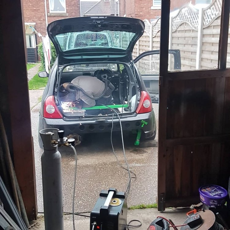

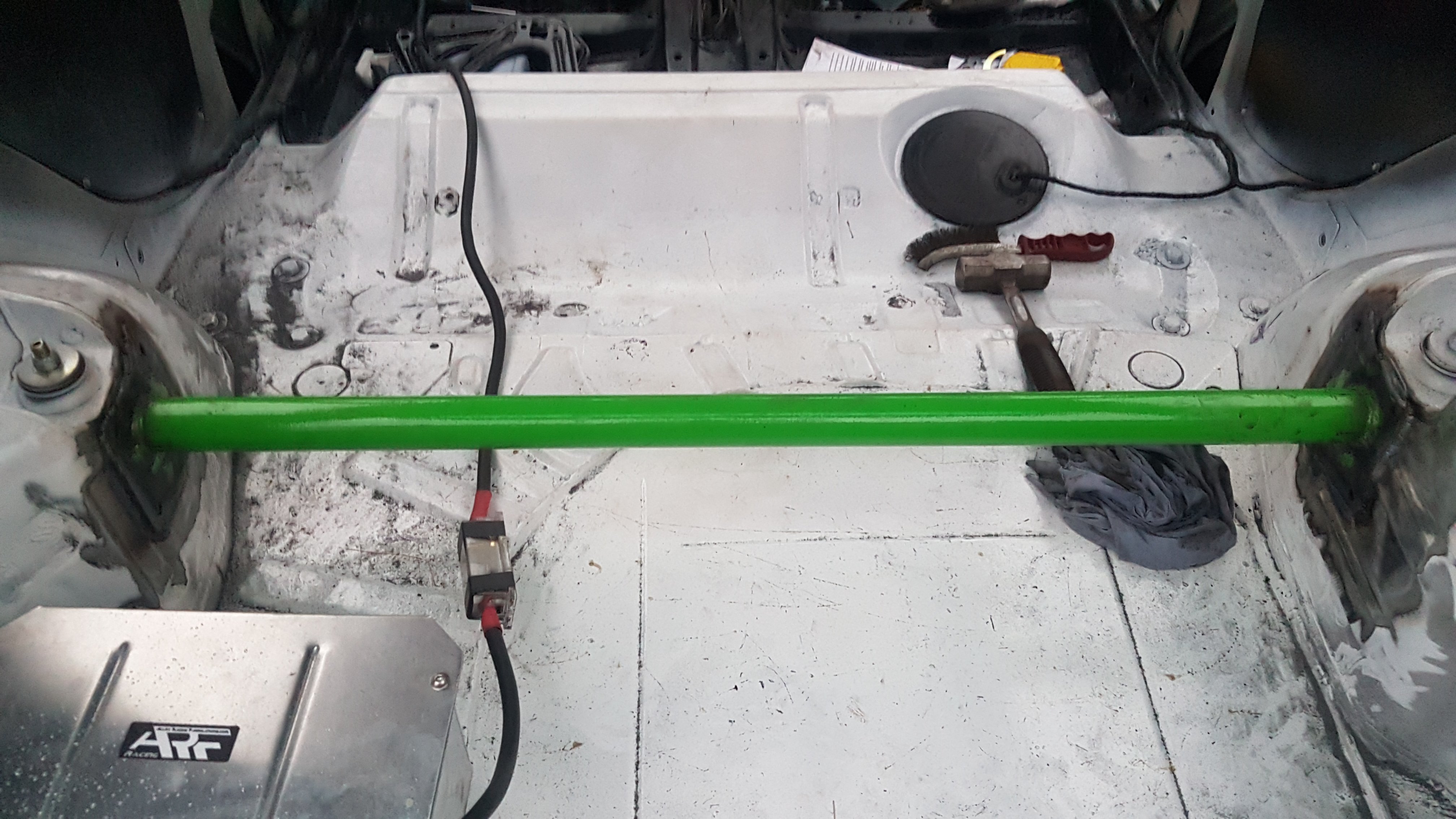

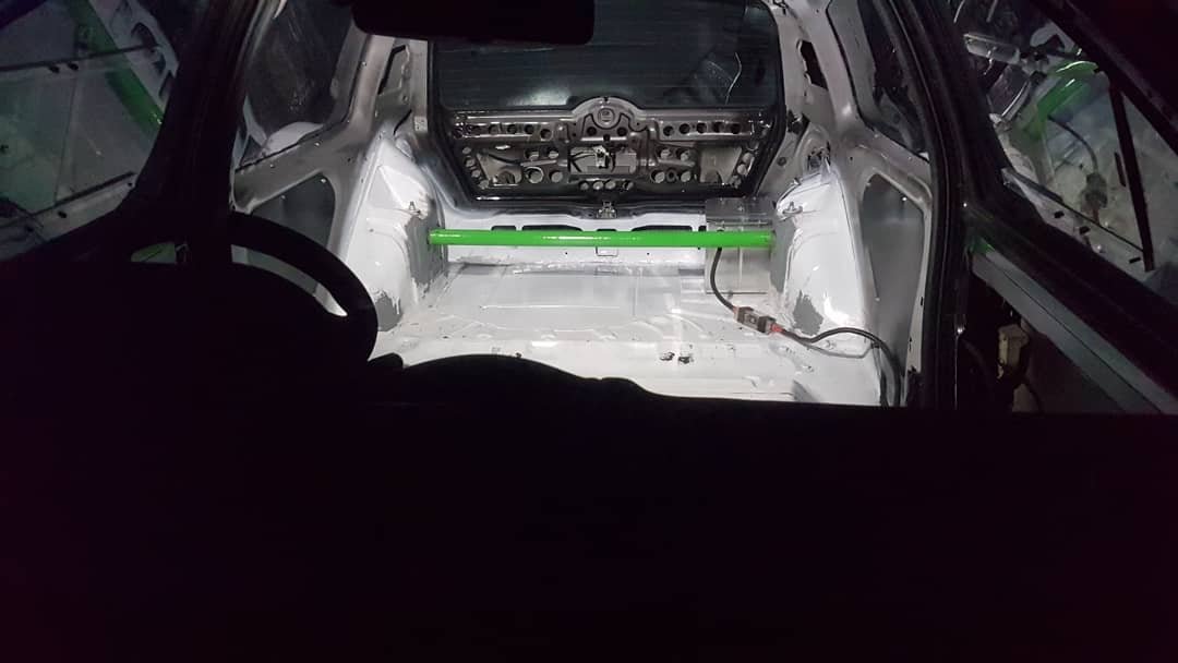

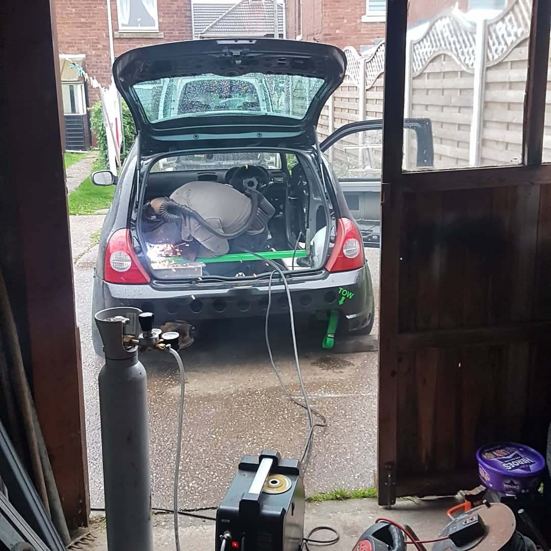

Temp Harness bar welded in
