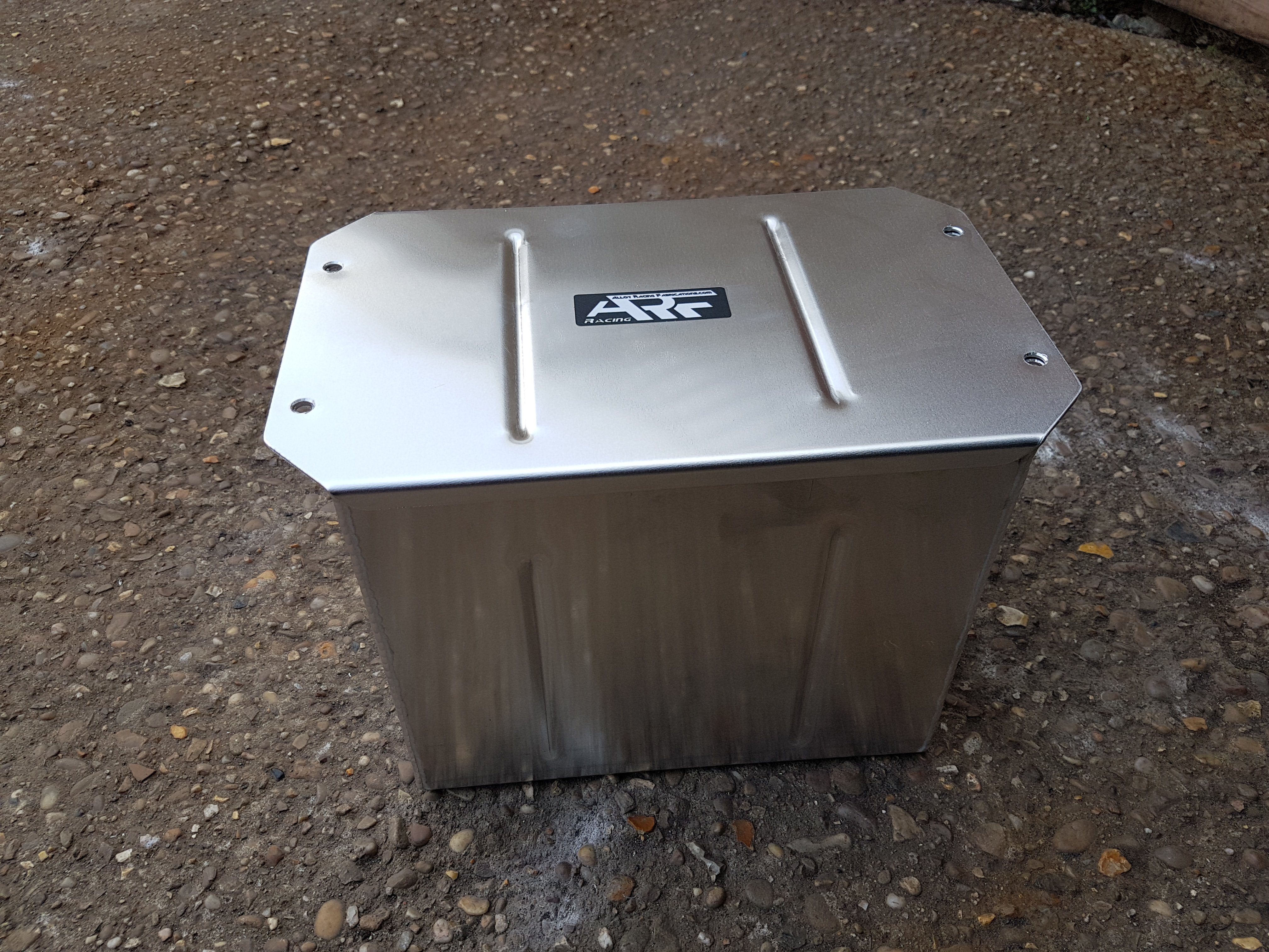

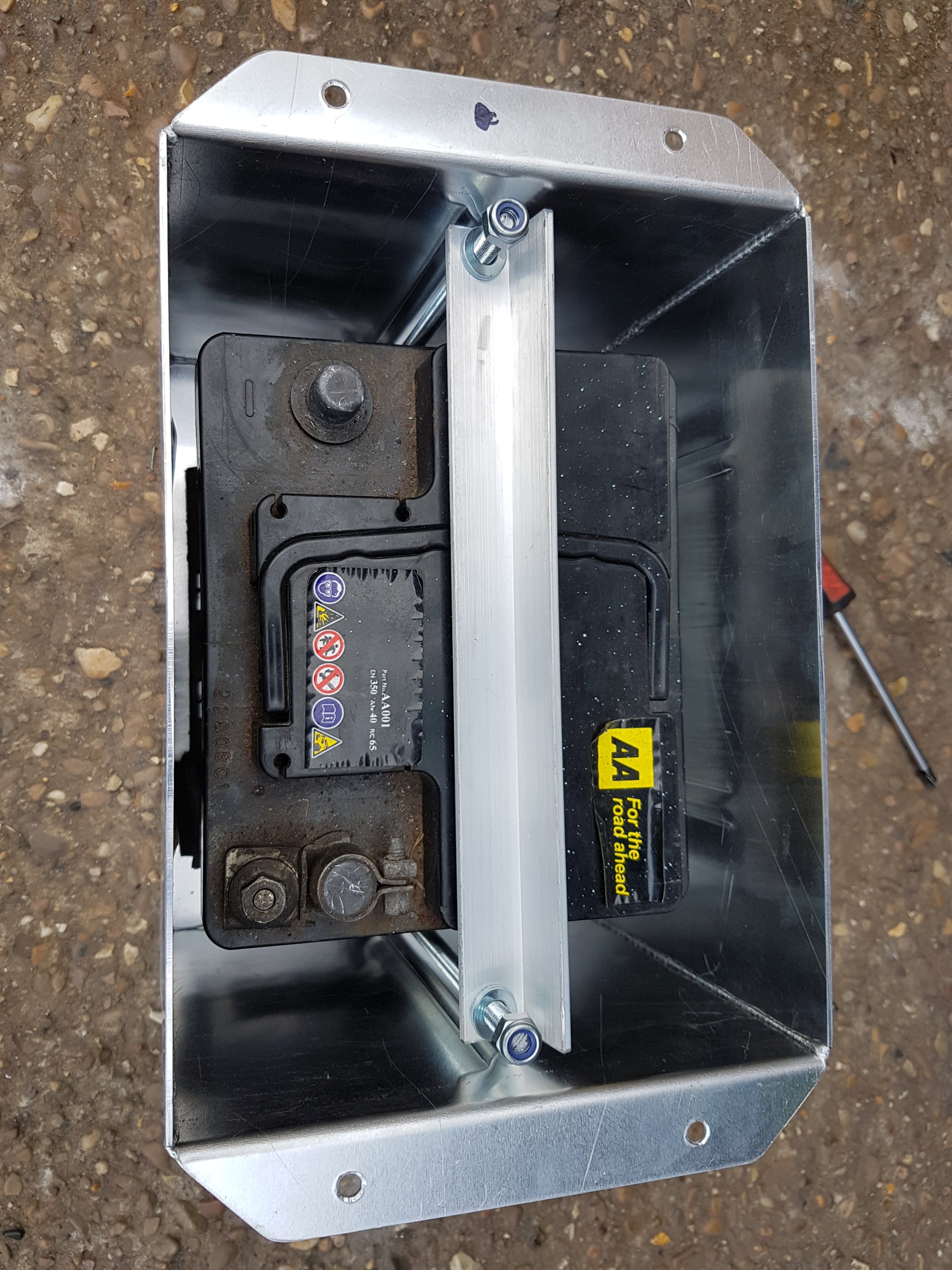

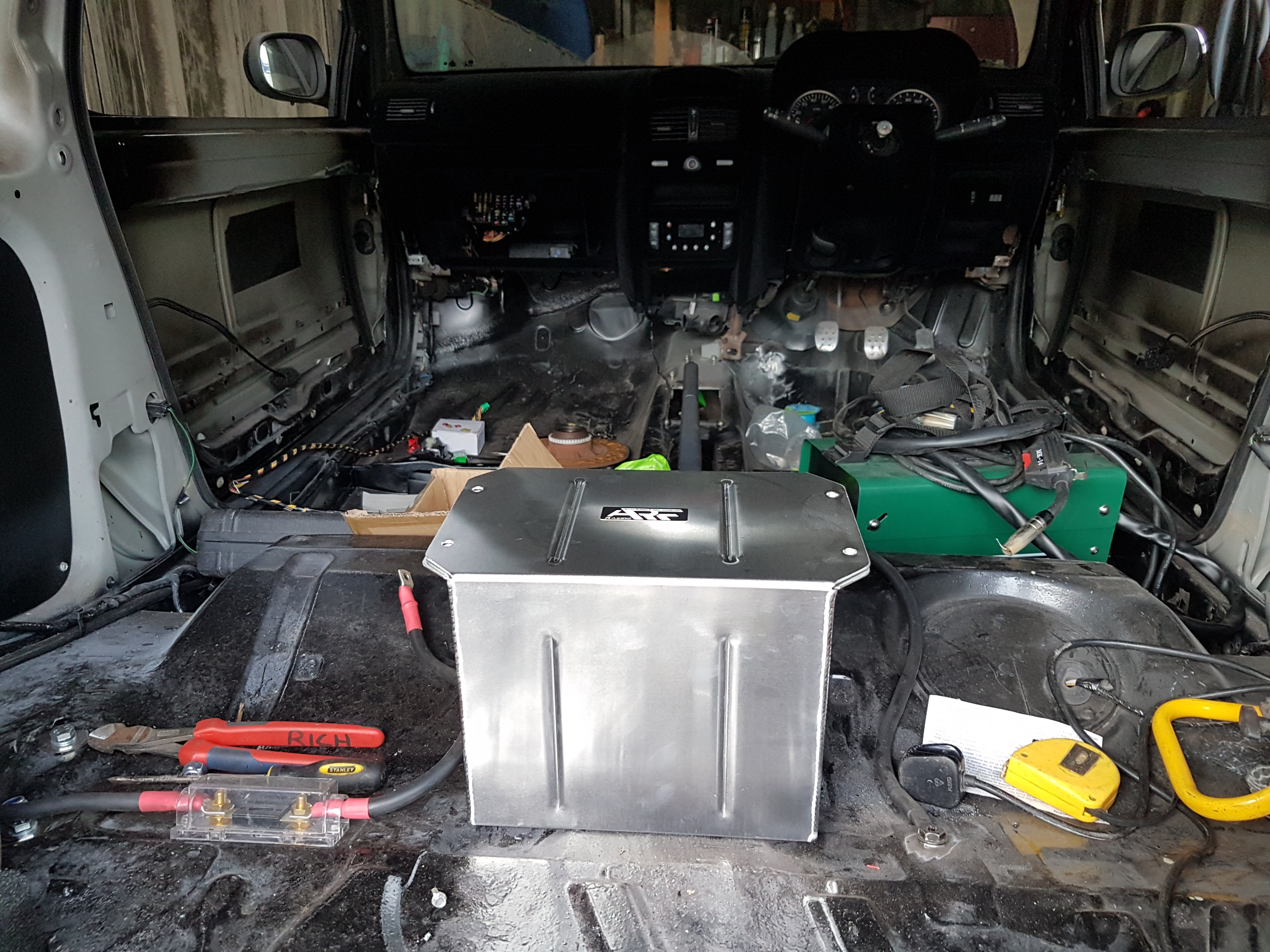

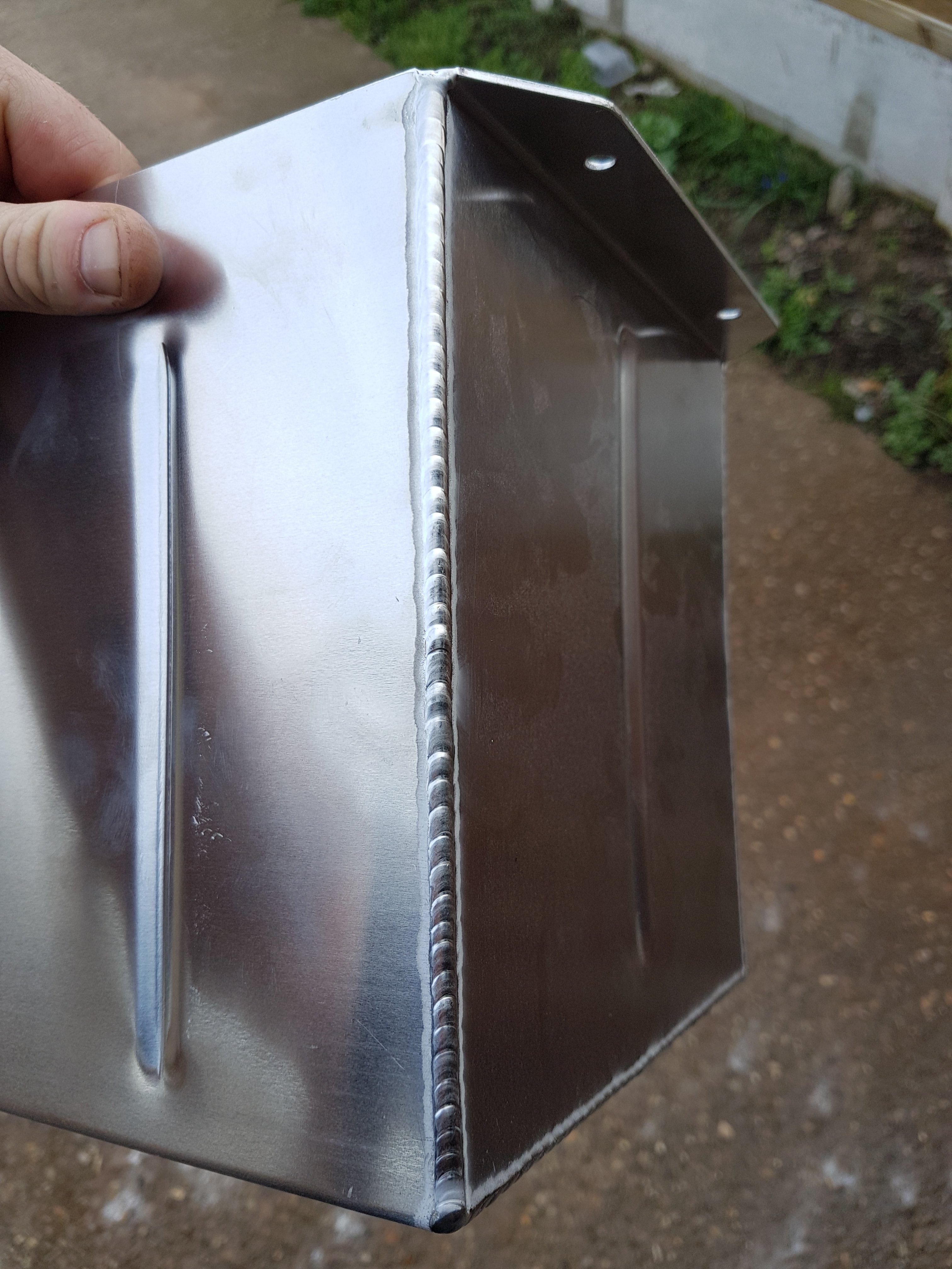

Battery box sorted

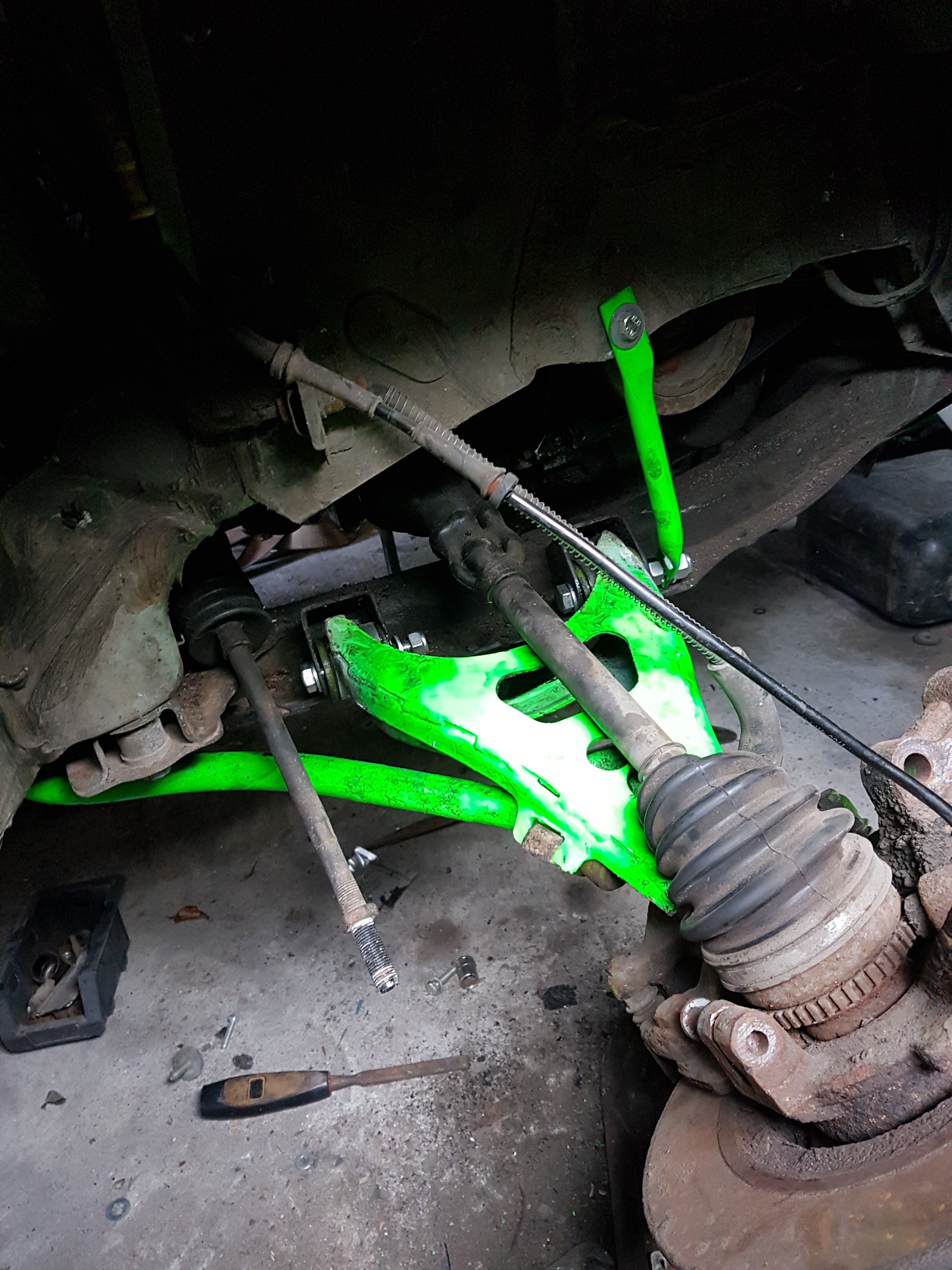

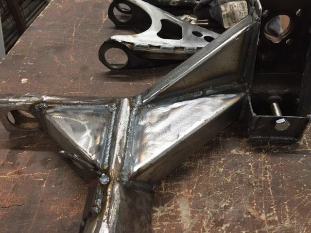

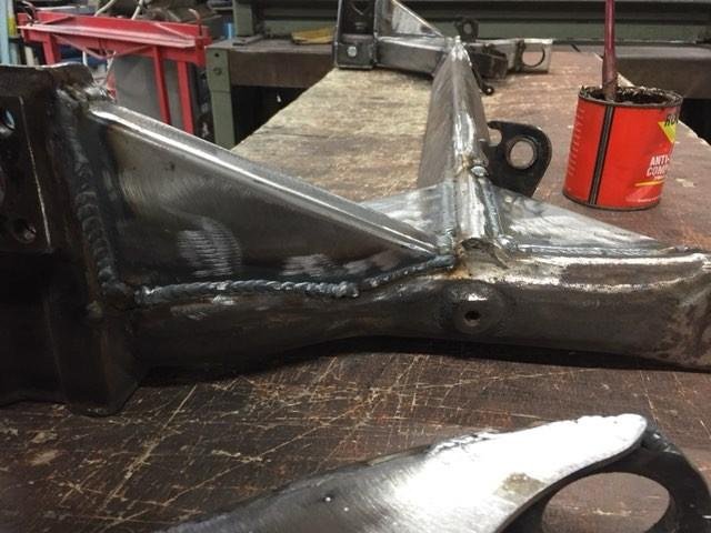

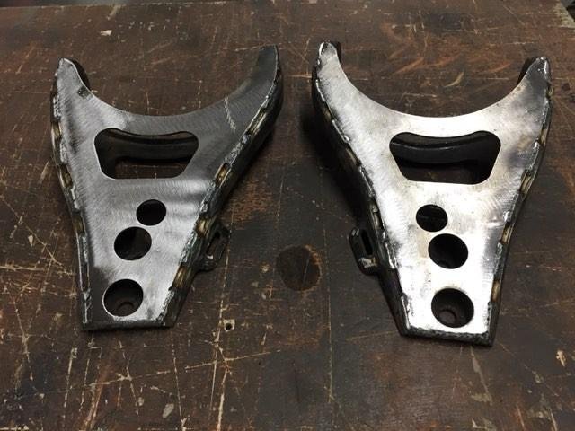

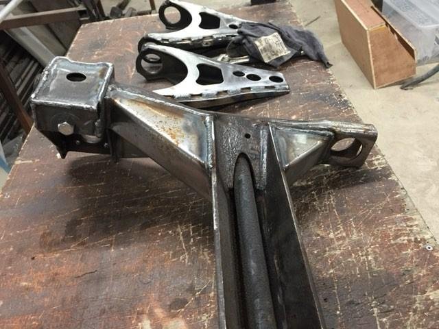

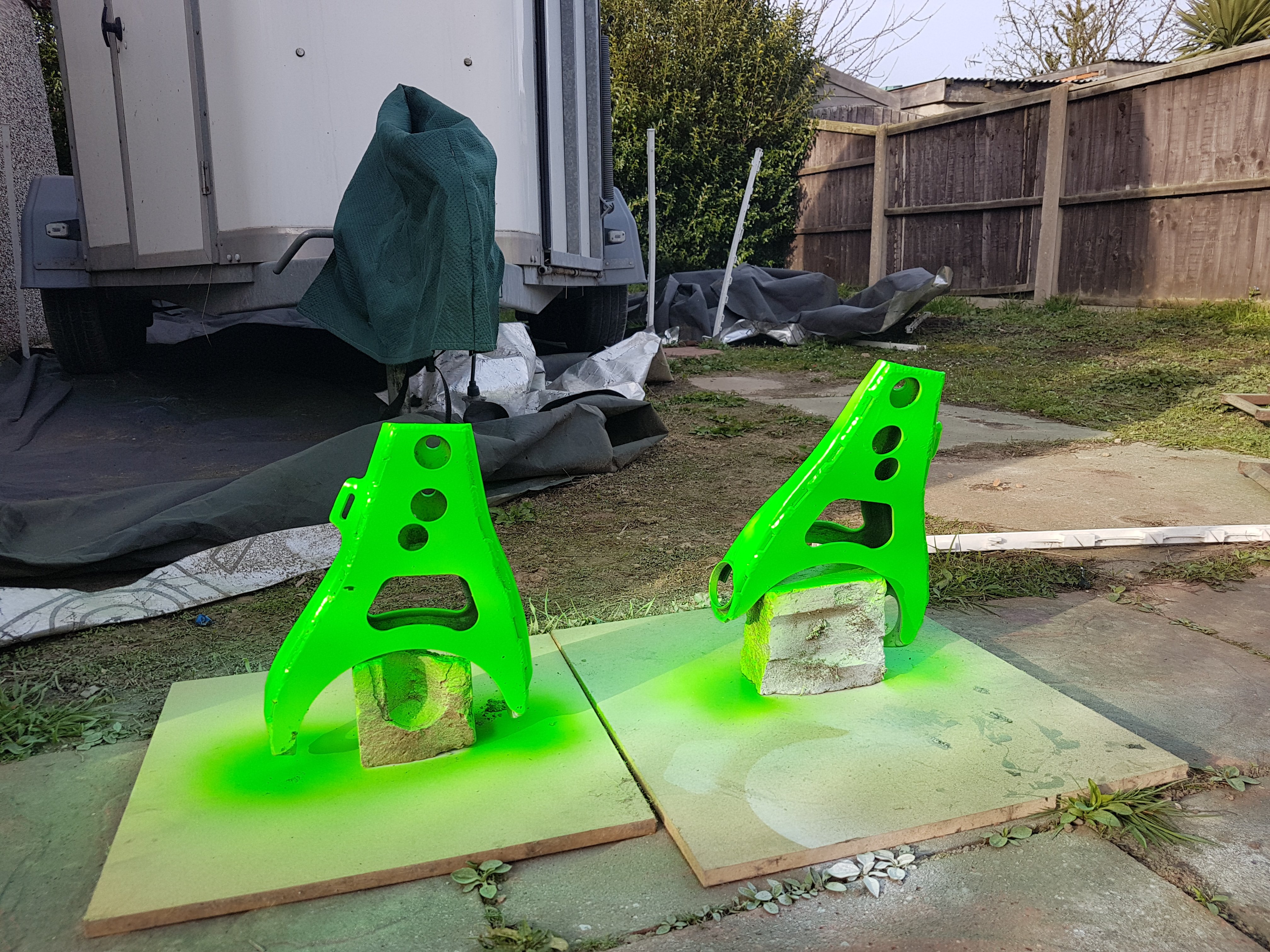

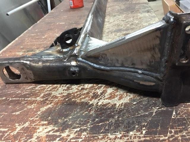

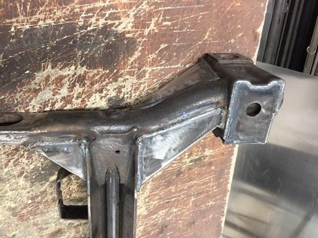

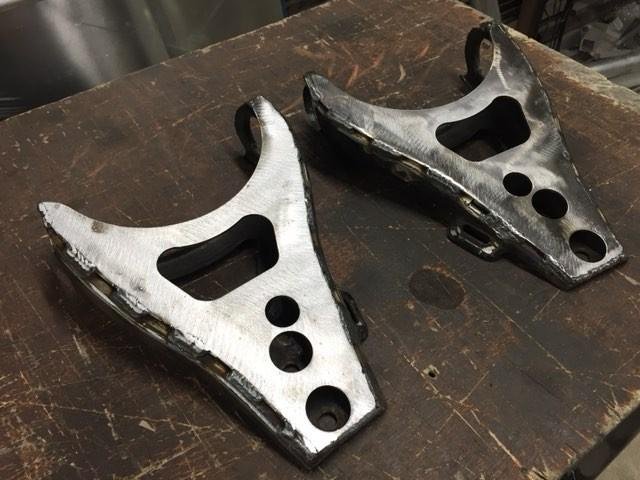

Wishbone strengthening done

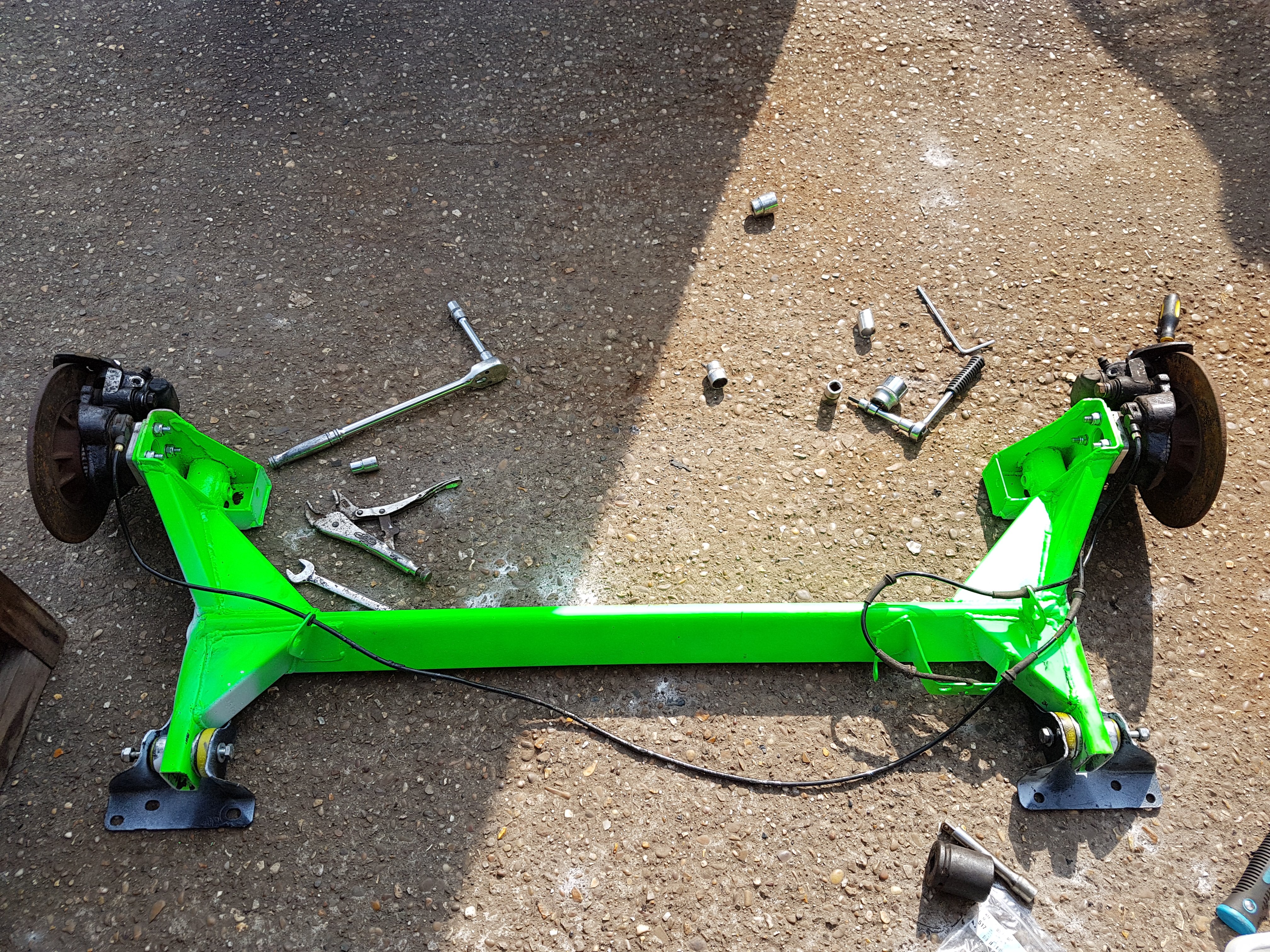

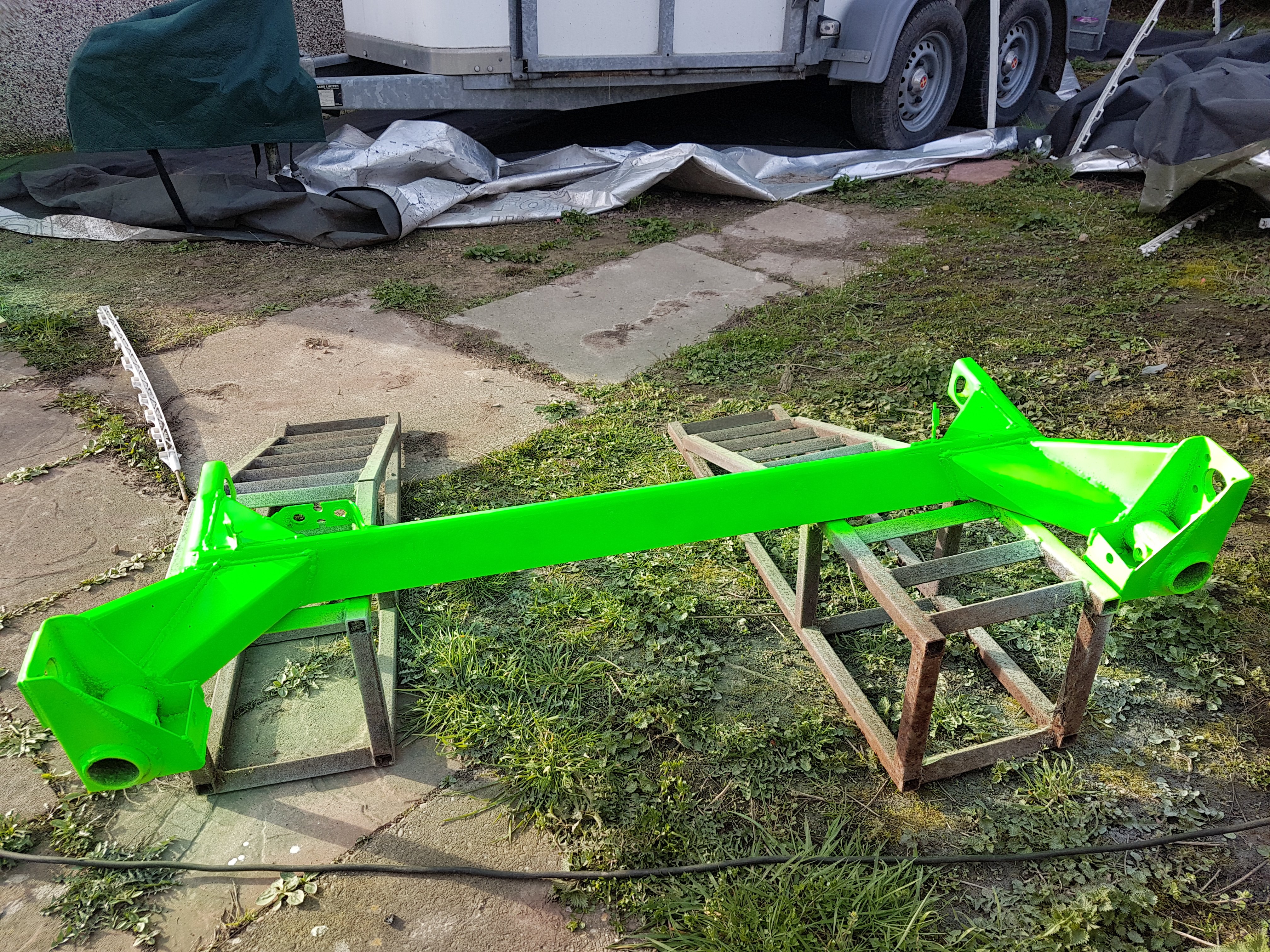

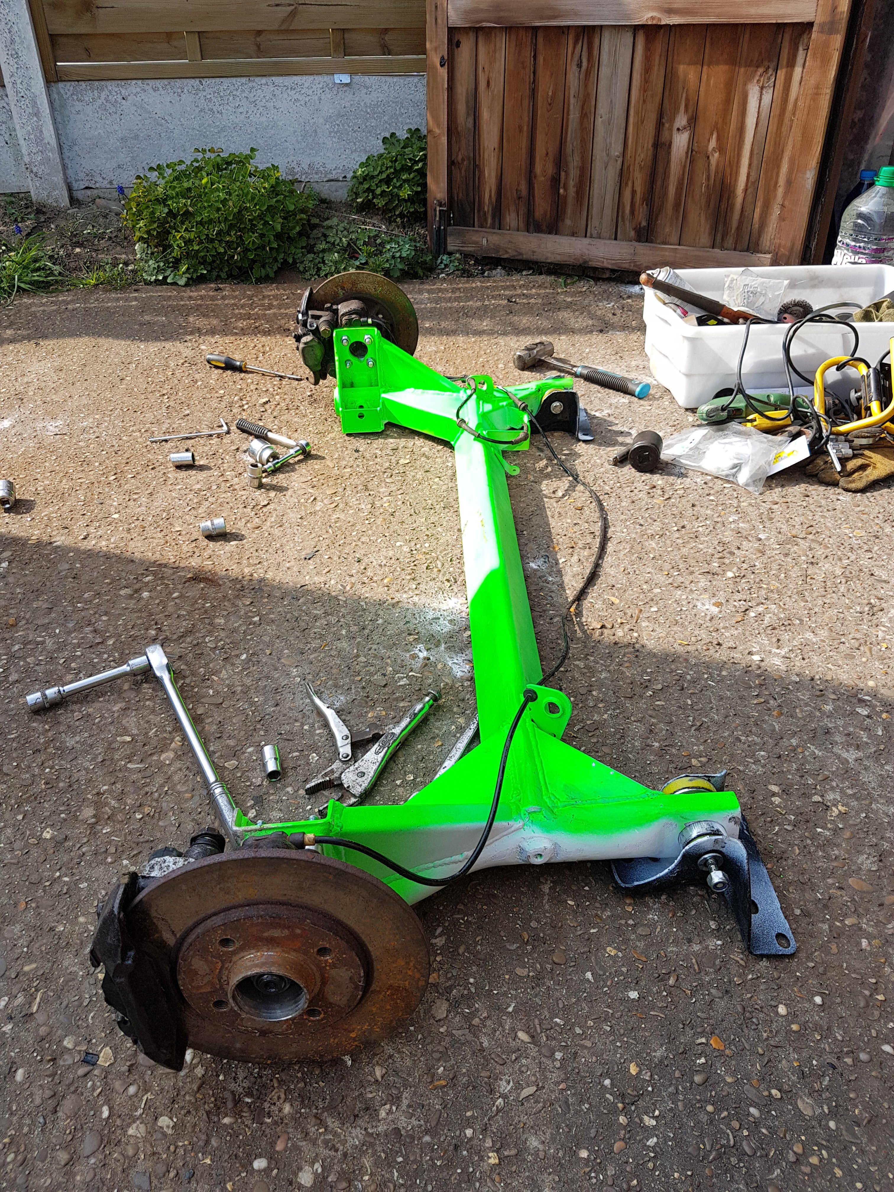

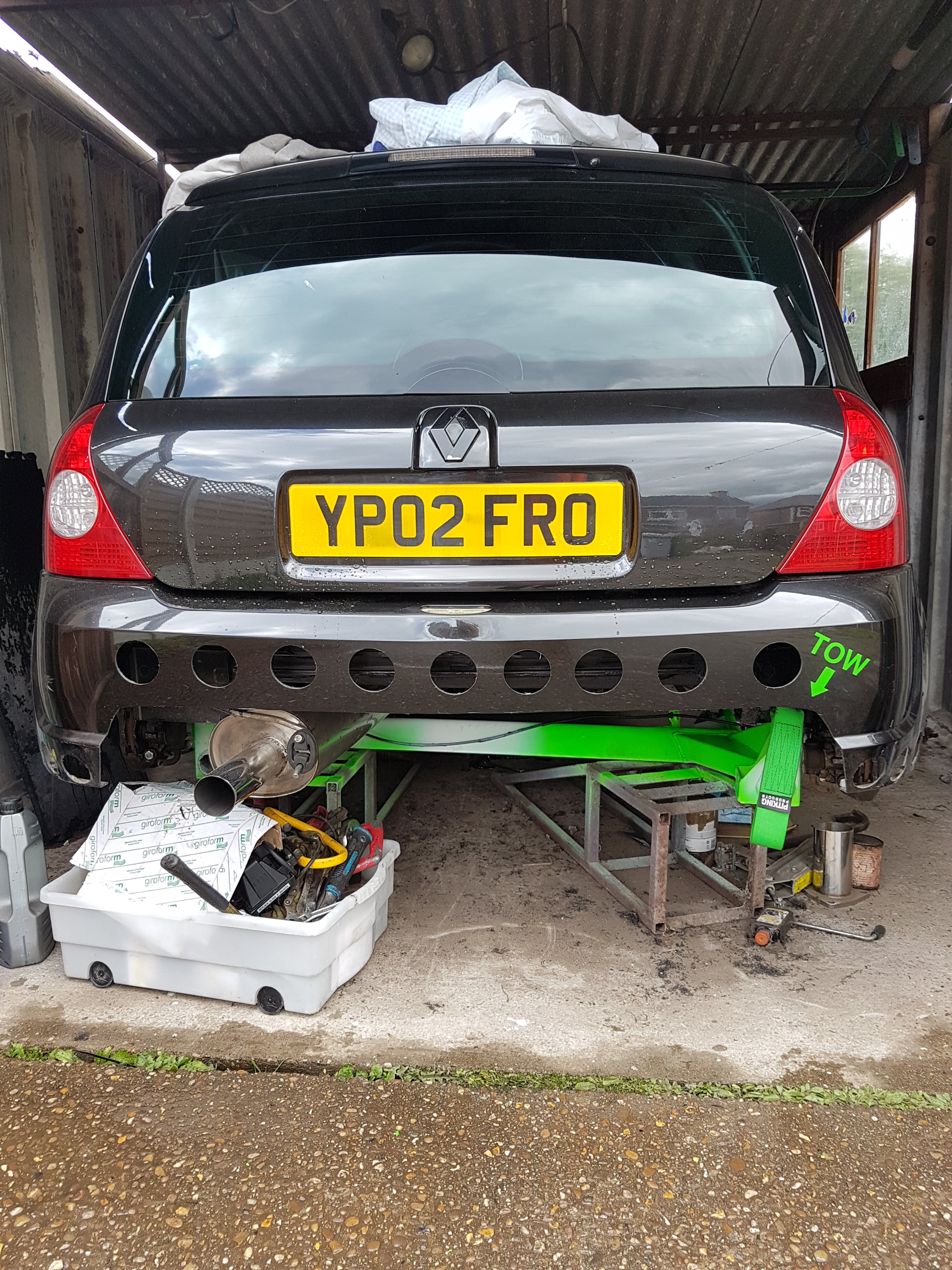

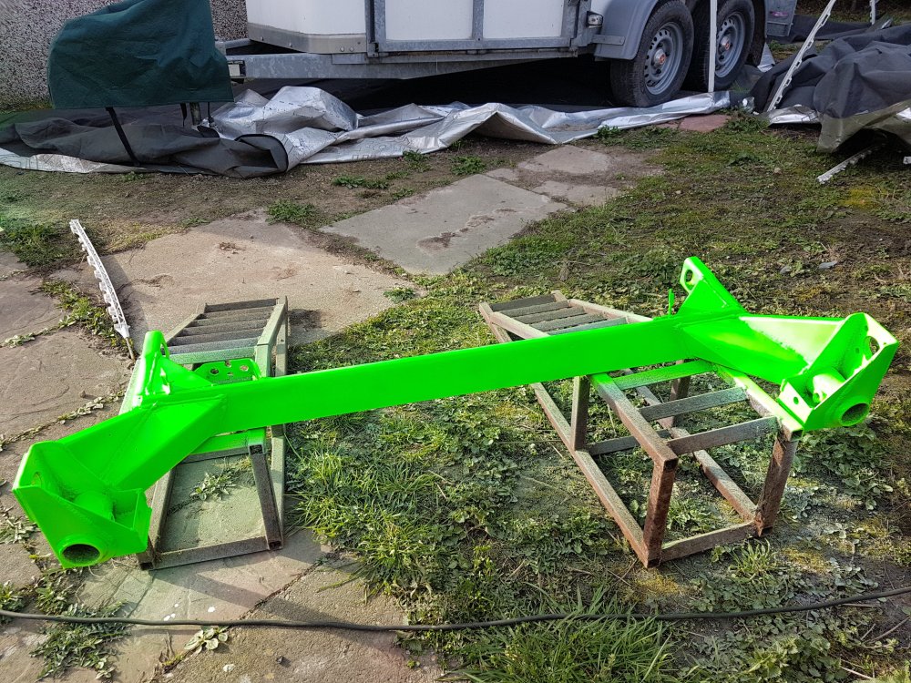

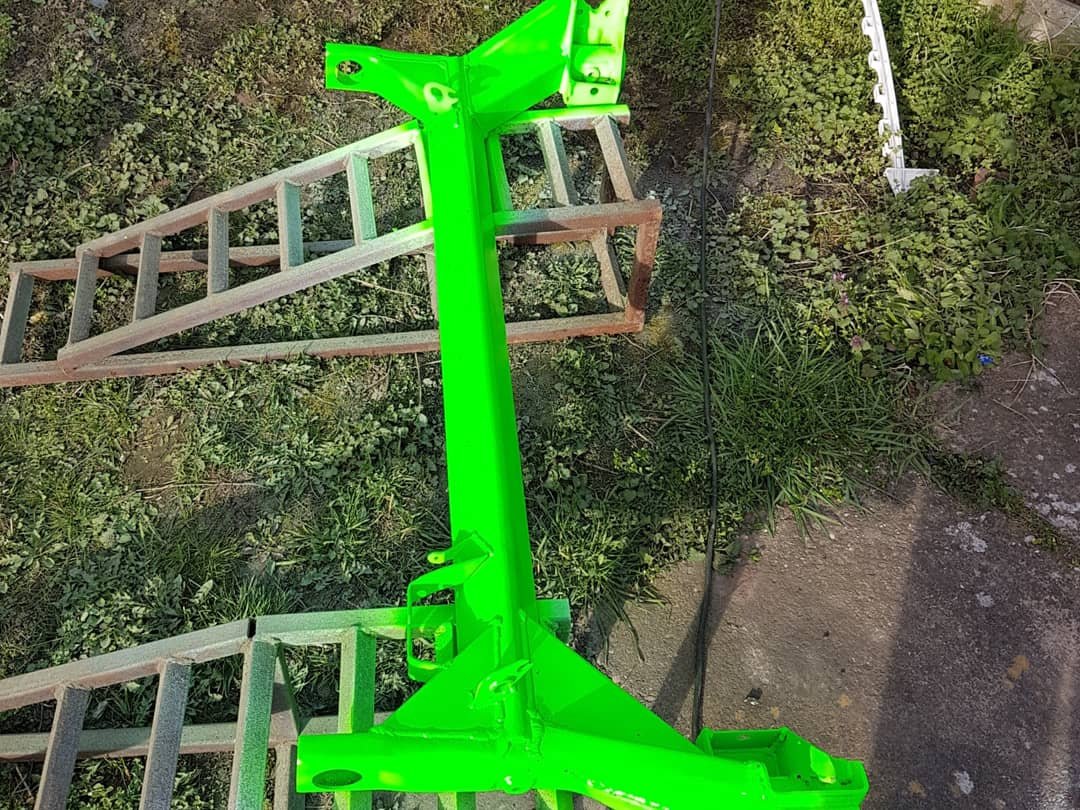

Rear beam all welded up

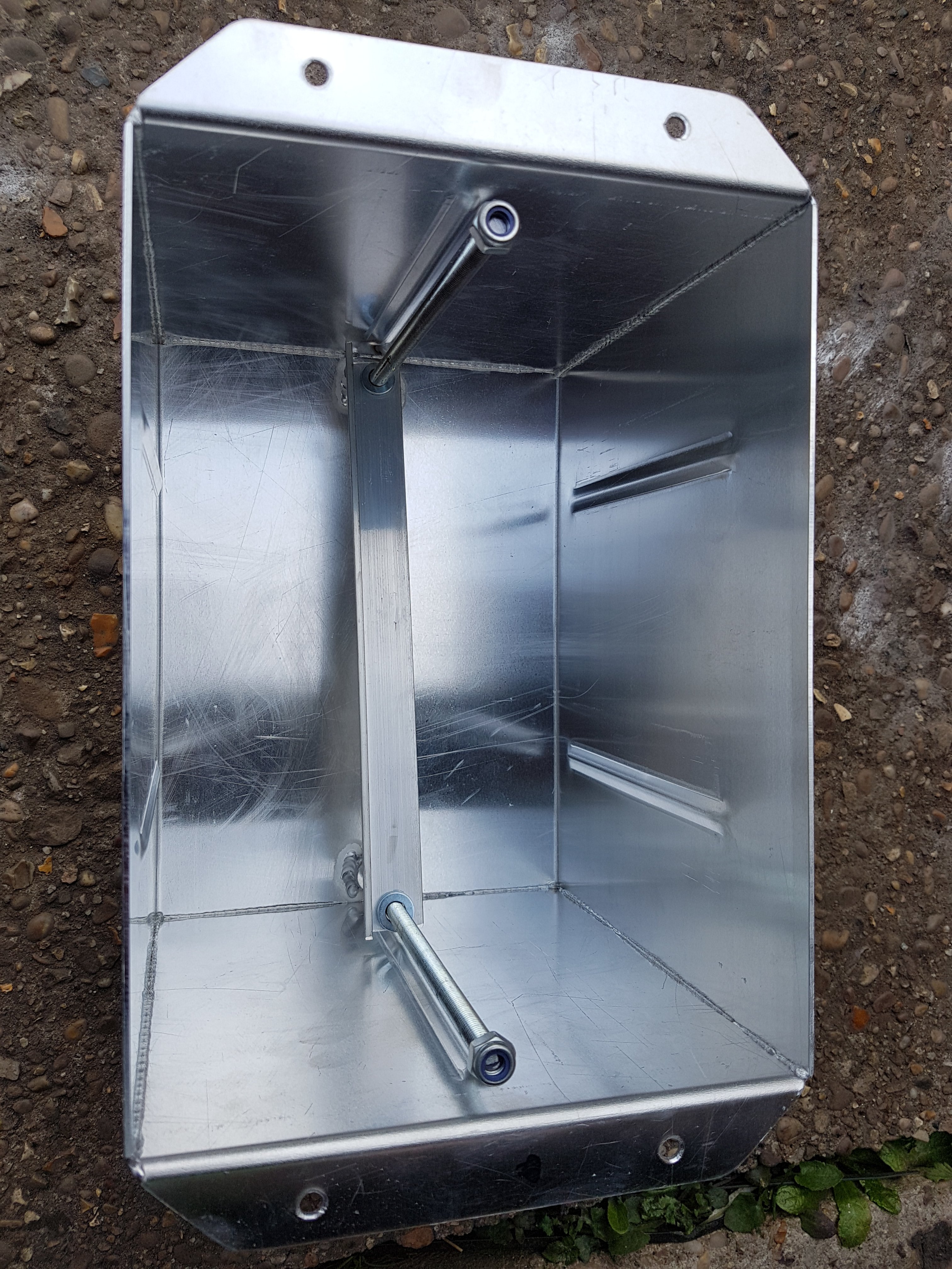

Battery box in just need to fix it in place, floors not straight so bolting it down isnt really and option. Considering 4 90° small steel bends 1 in each corner bottled to.the box and welded to the floor.
Edited by SNH

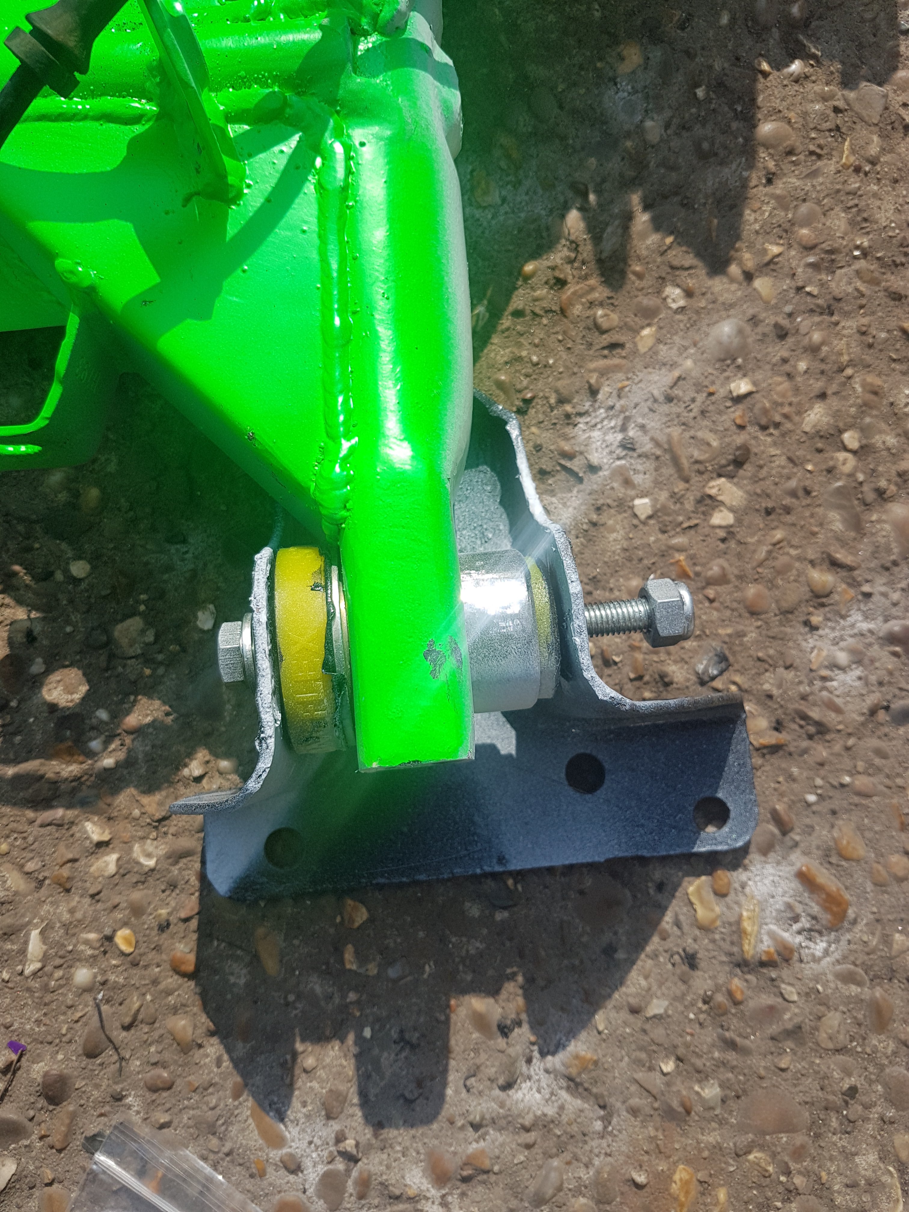

Rear beam poly bushed built back up and back on the car.

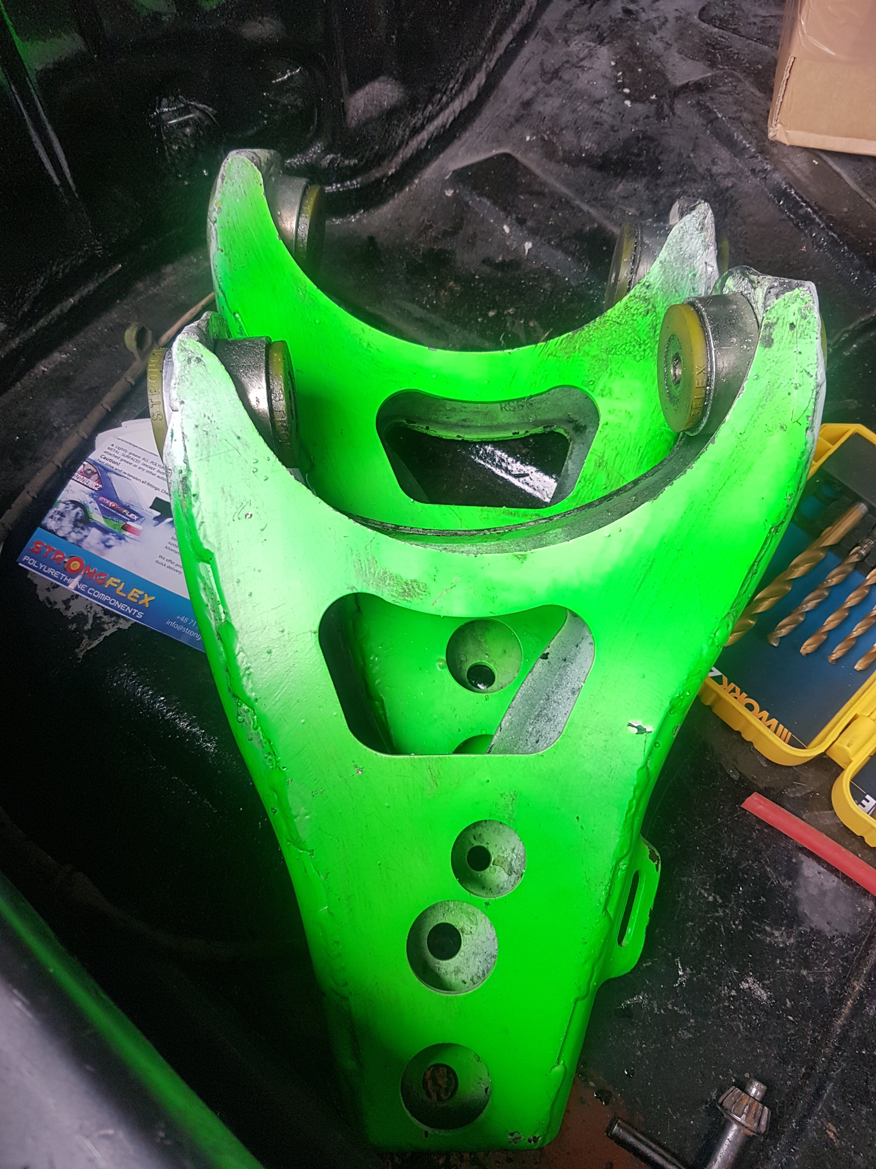

Wishbones poly bushed and back on the car

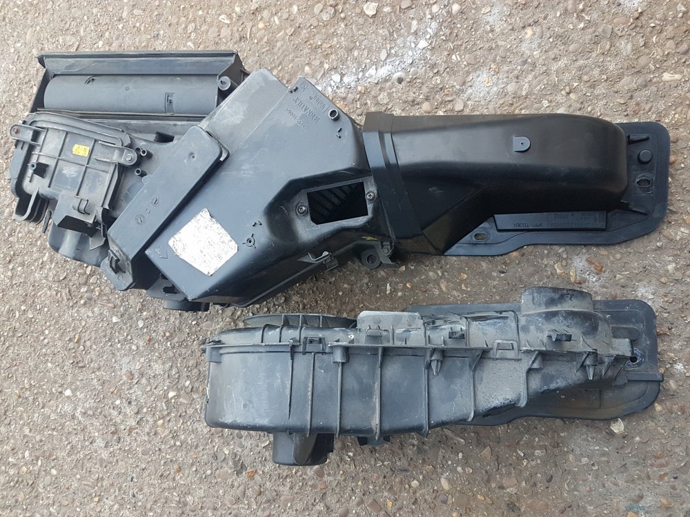

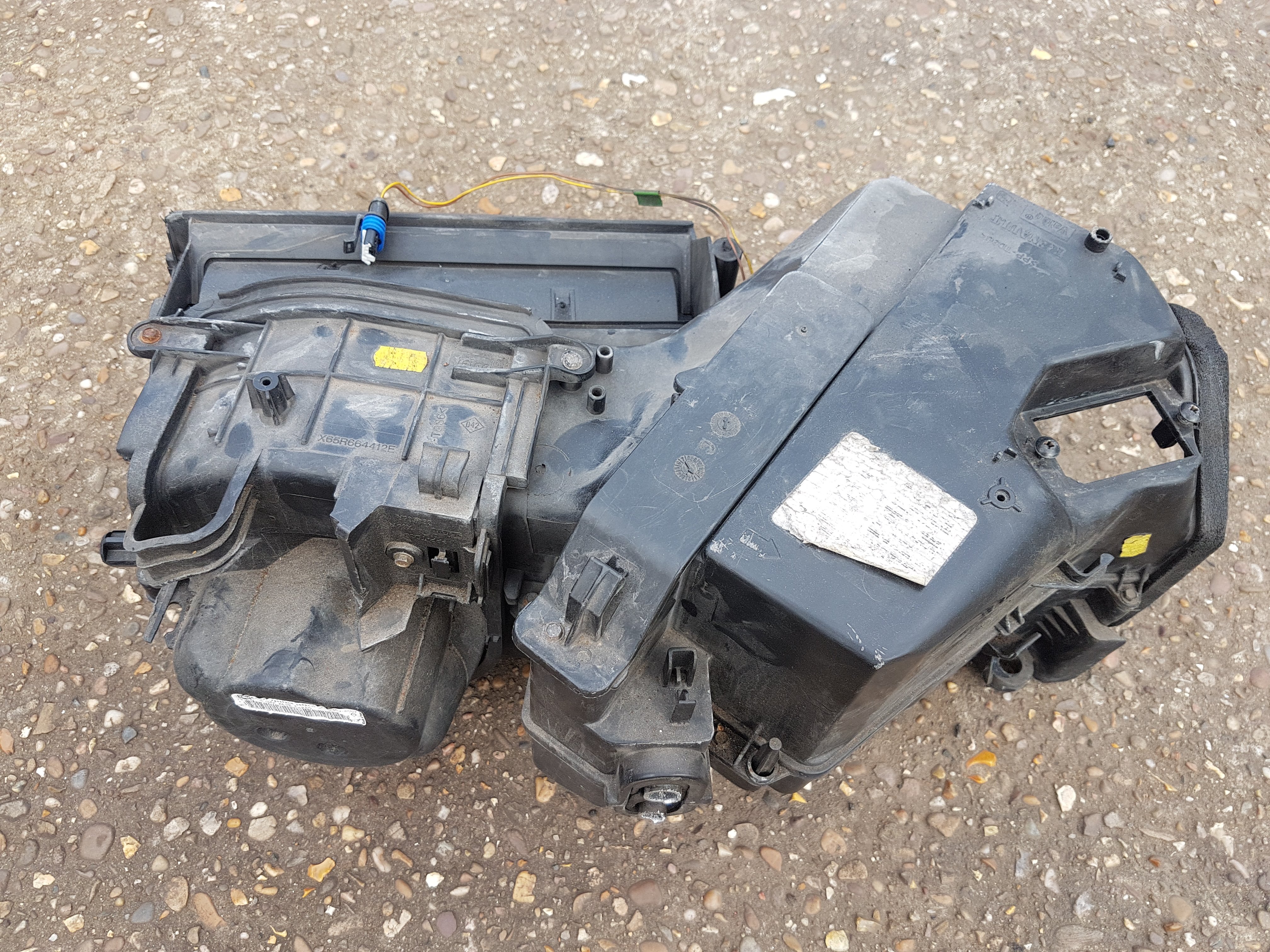

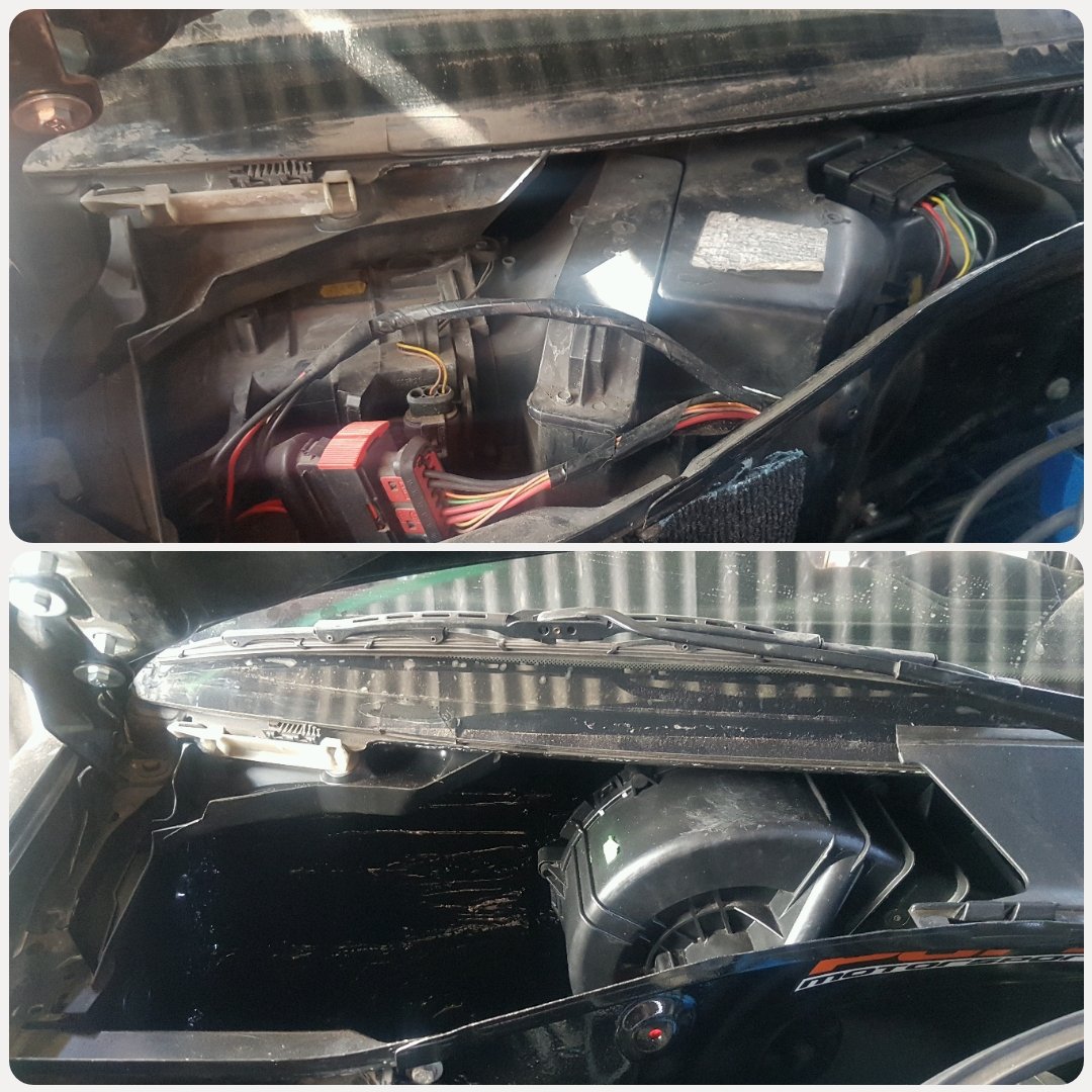

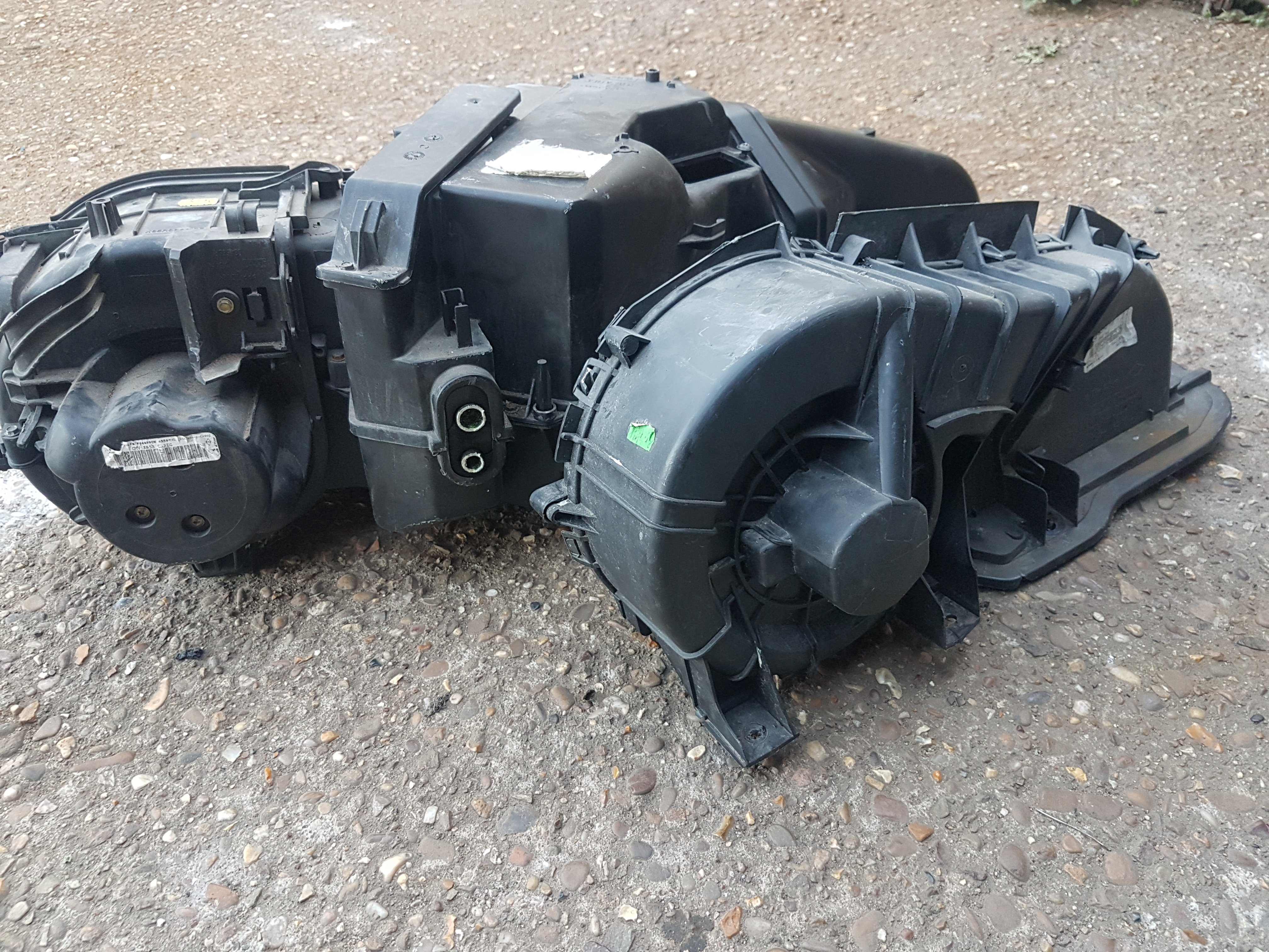

Another moment of madness to chase the weight loss and to simplify things.

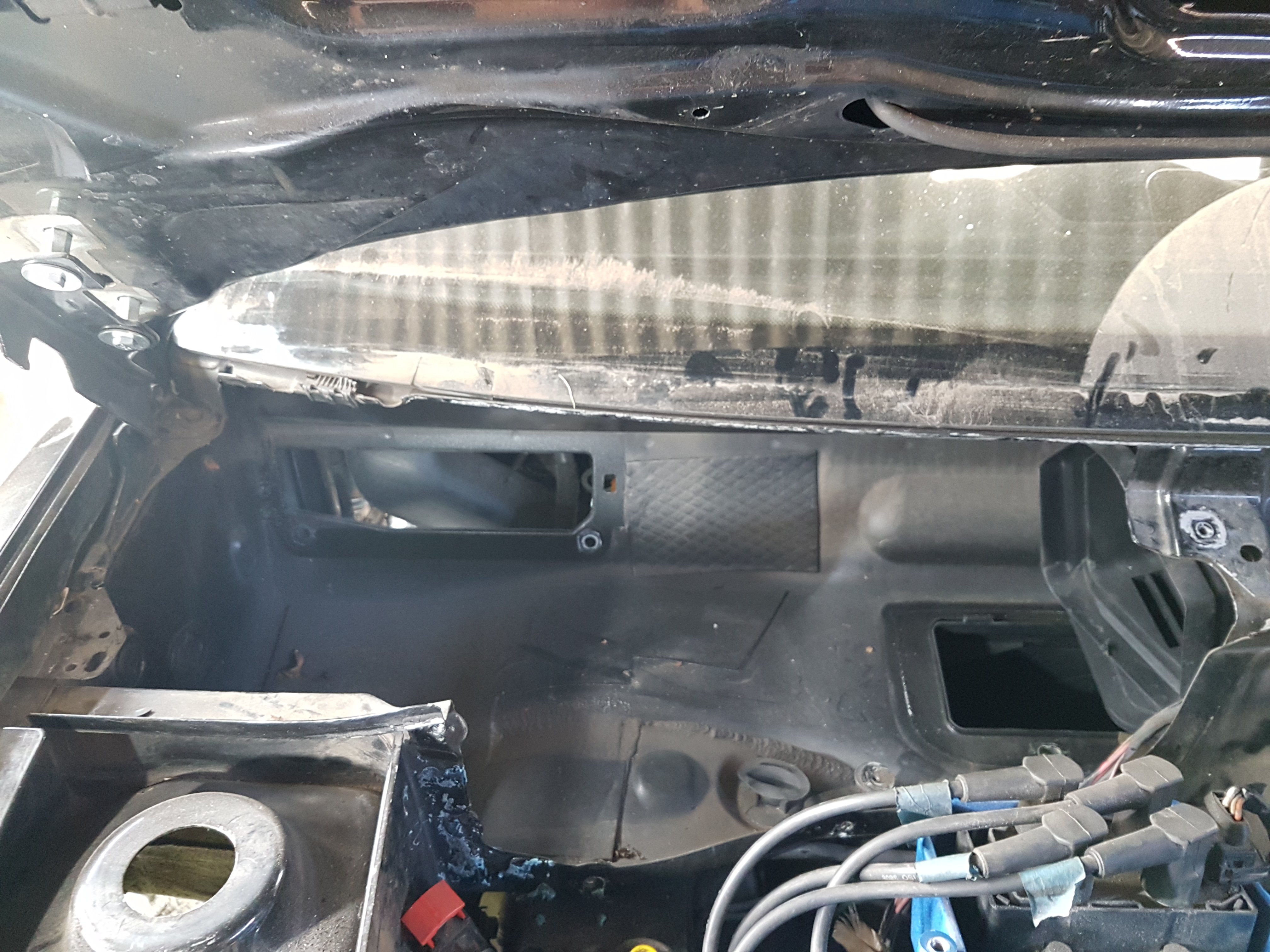

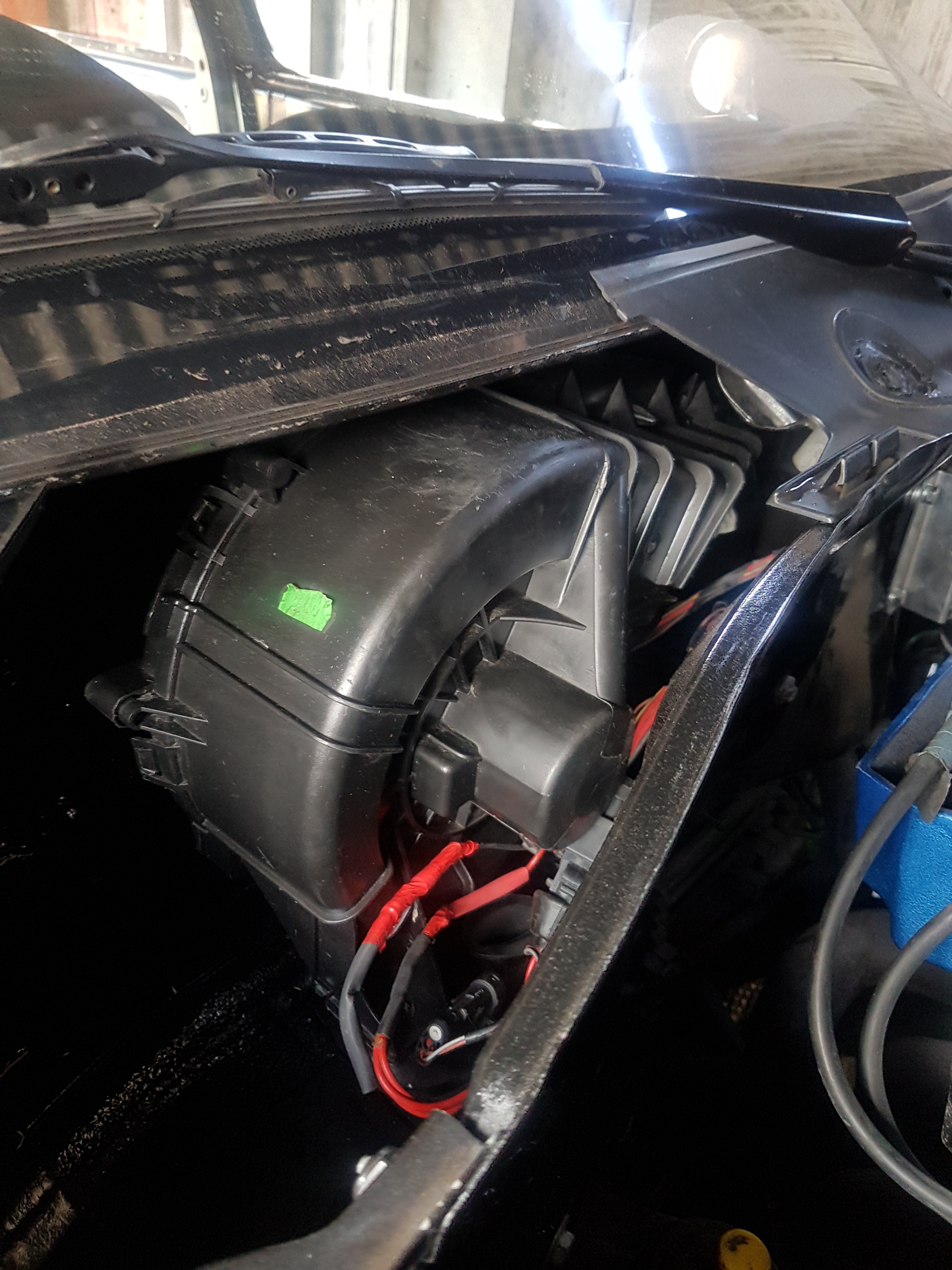

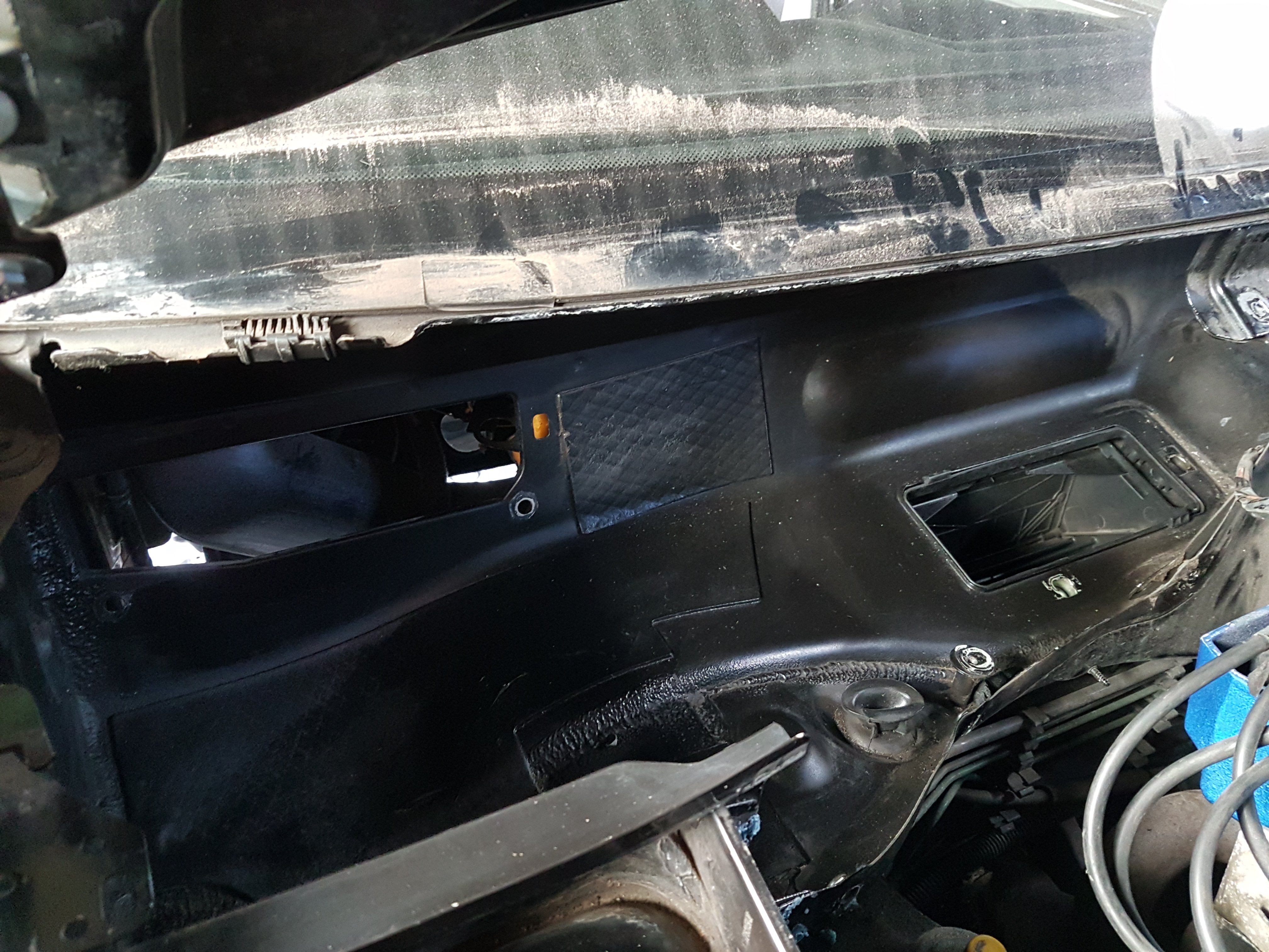

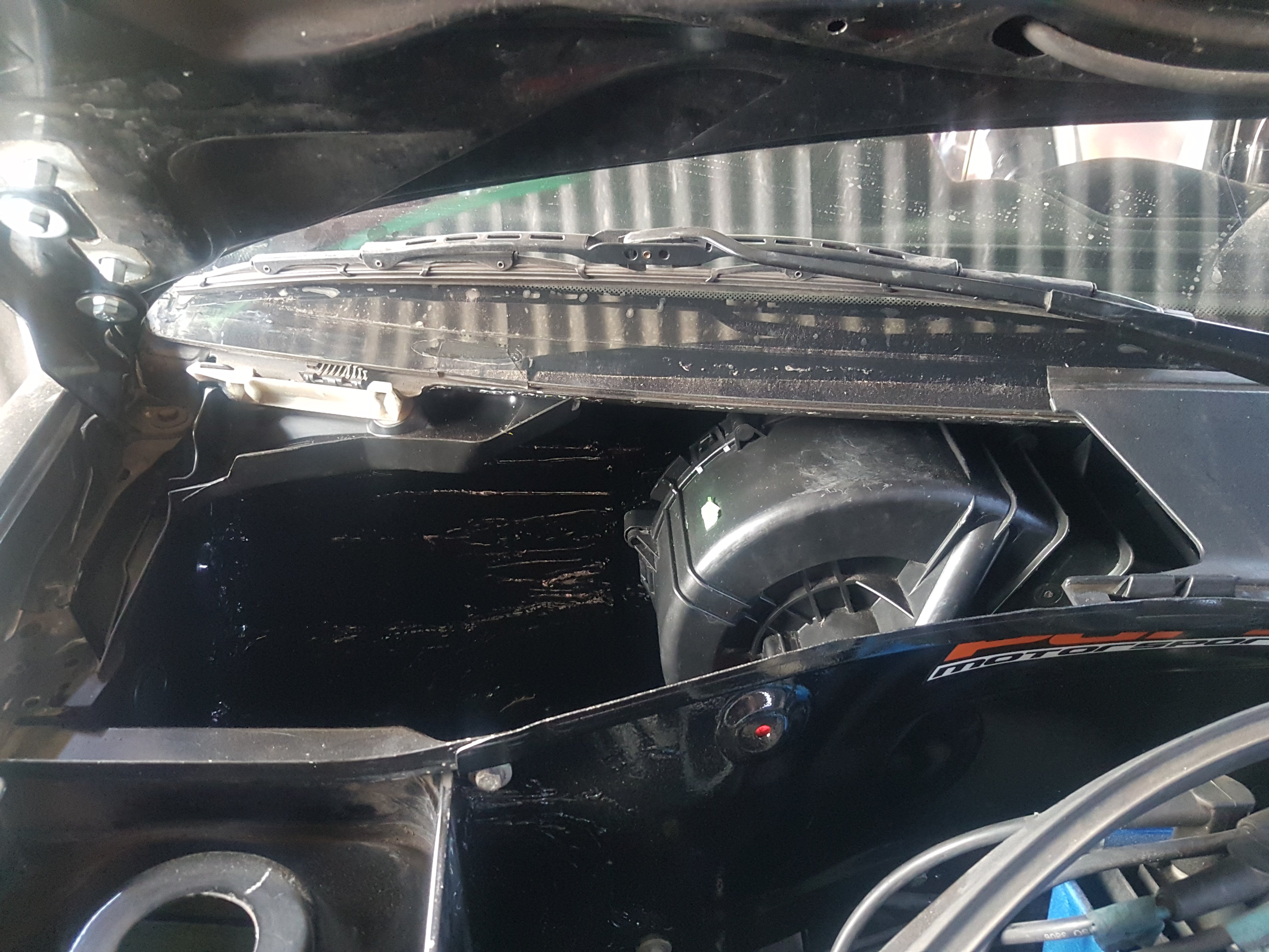

OE heater blower motor removed to make way for a smaller, lighter less complicated cup model one. I do need to make some sort of plate up to cover and seal the hole into the cabin just need to decide whether to rivet or weld.
Edited by SNH

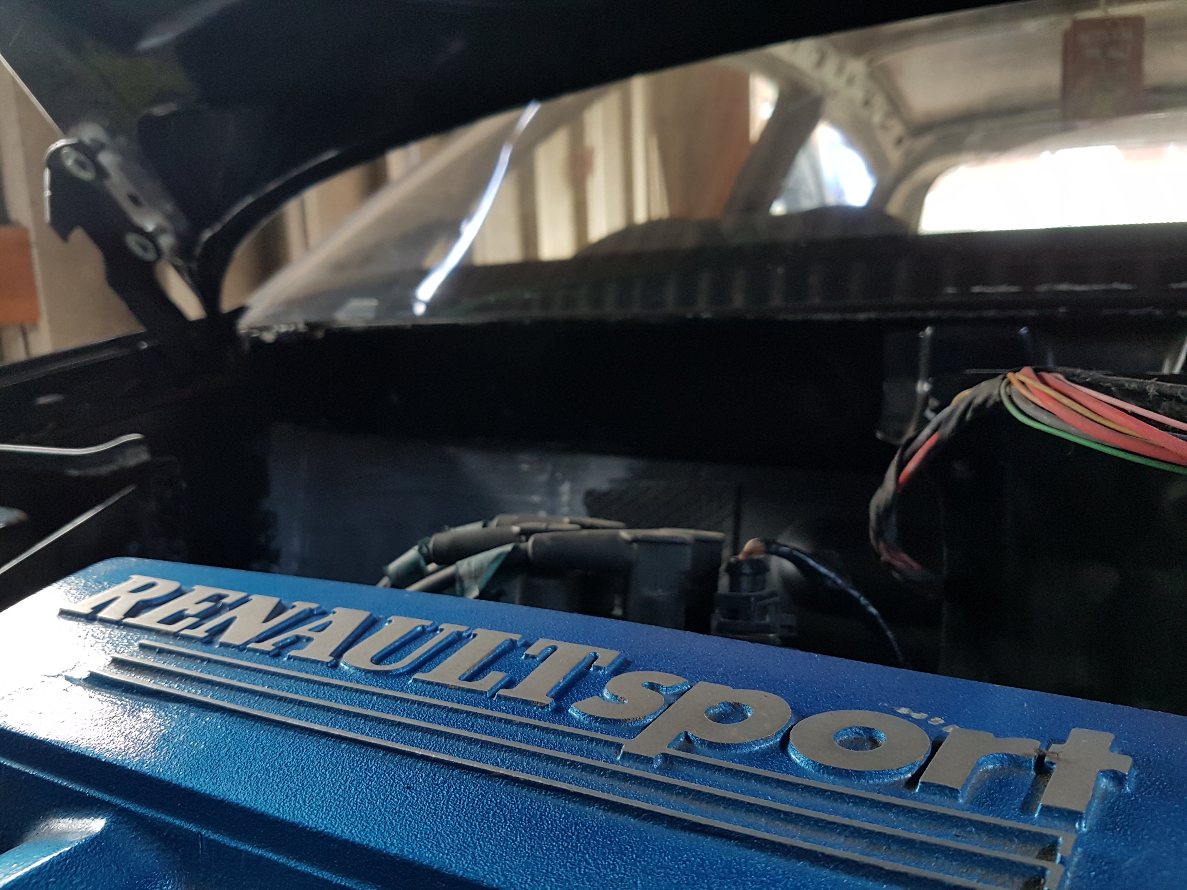

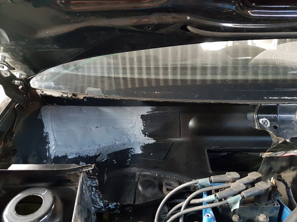

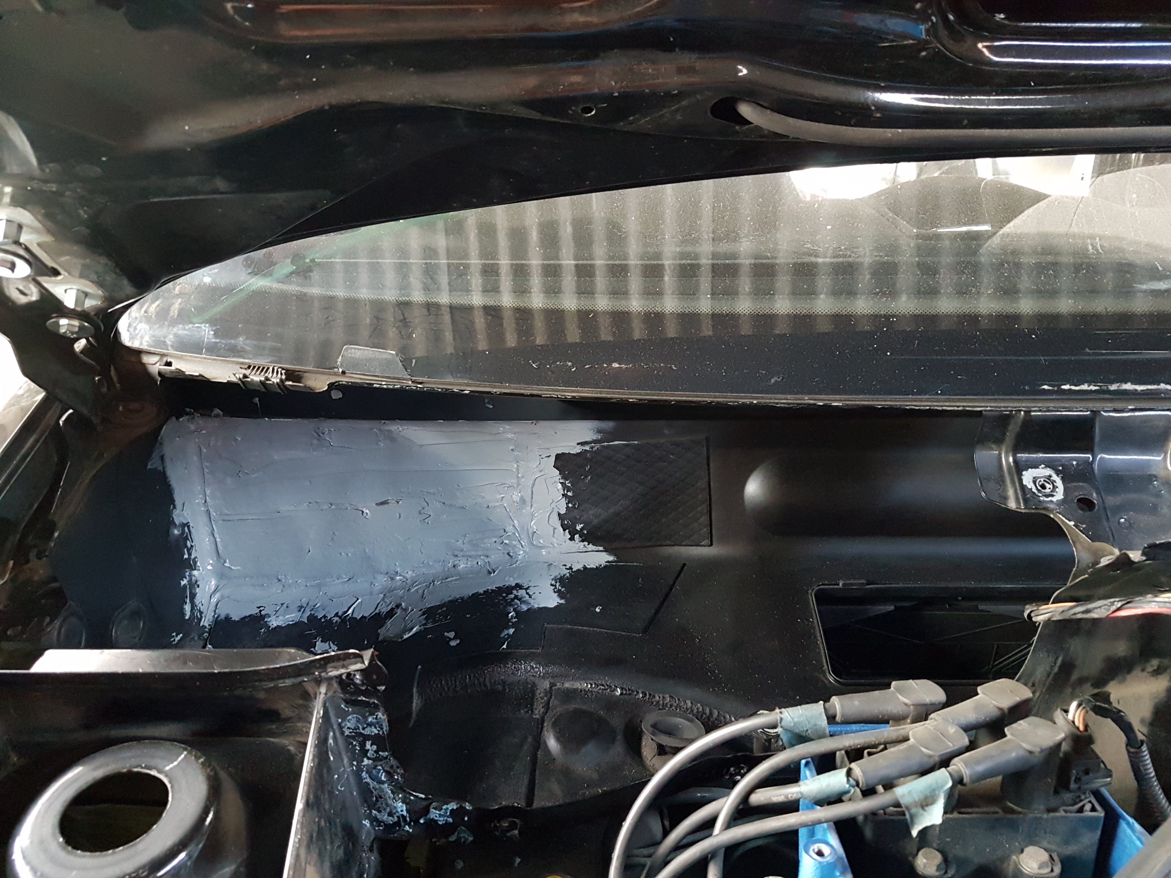

Hole issue sorted.
Thin sheet tack welded in and lashings of seam sealer over it, that should do it :D

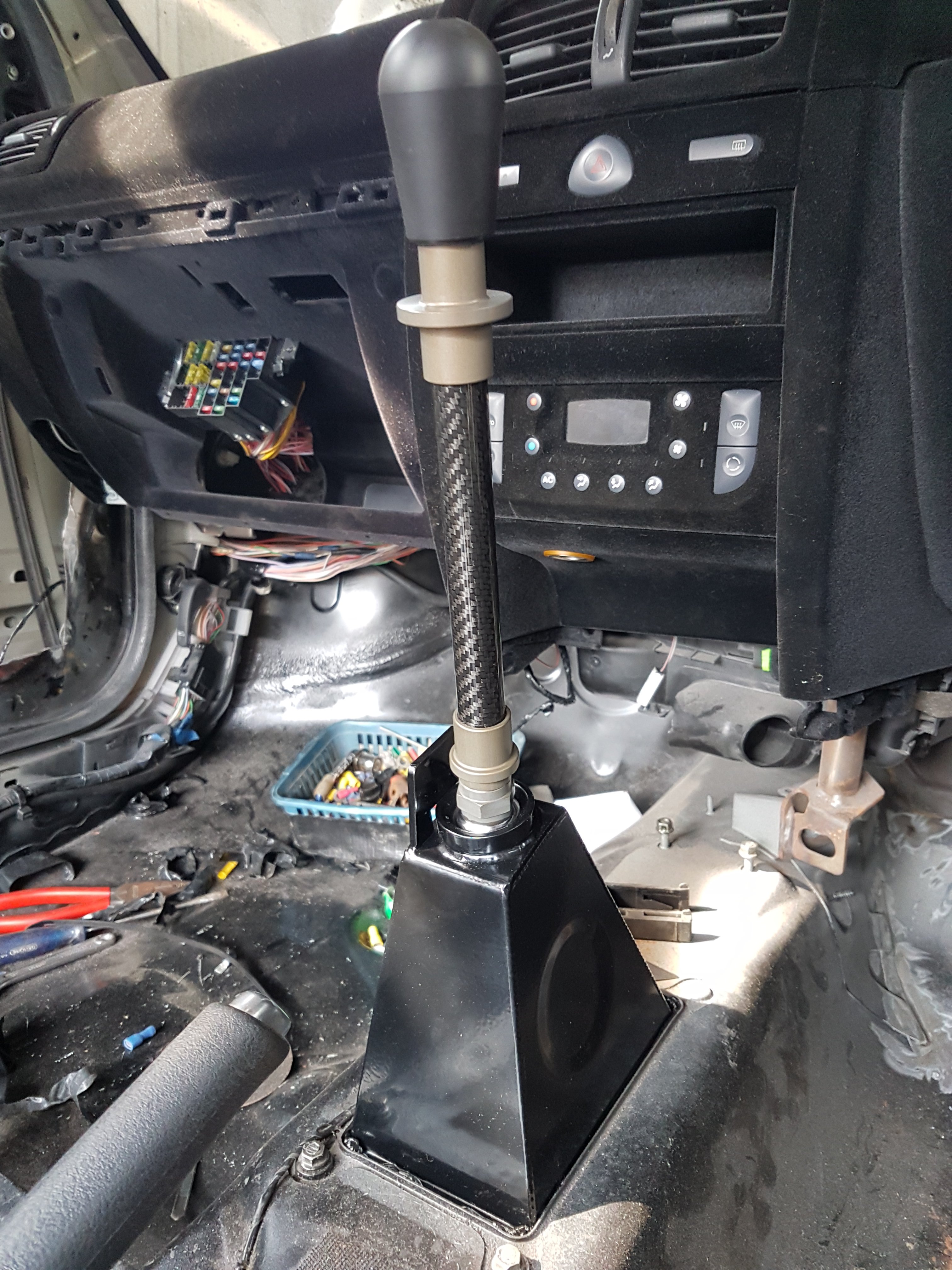

Love a good shaft! :D

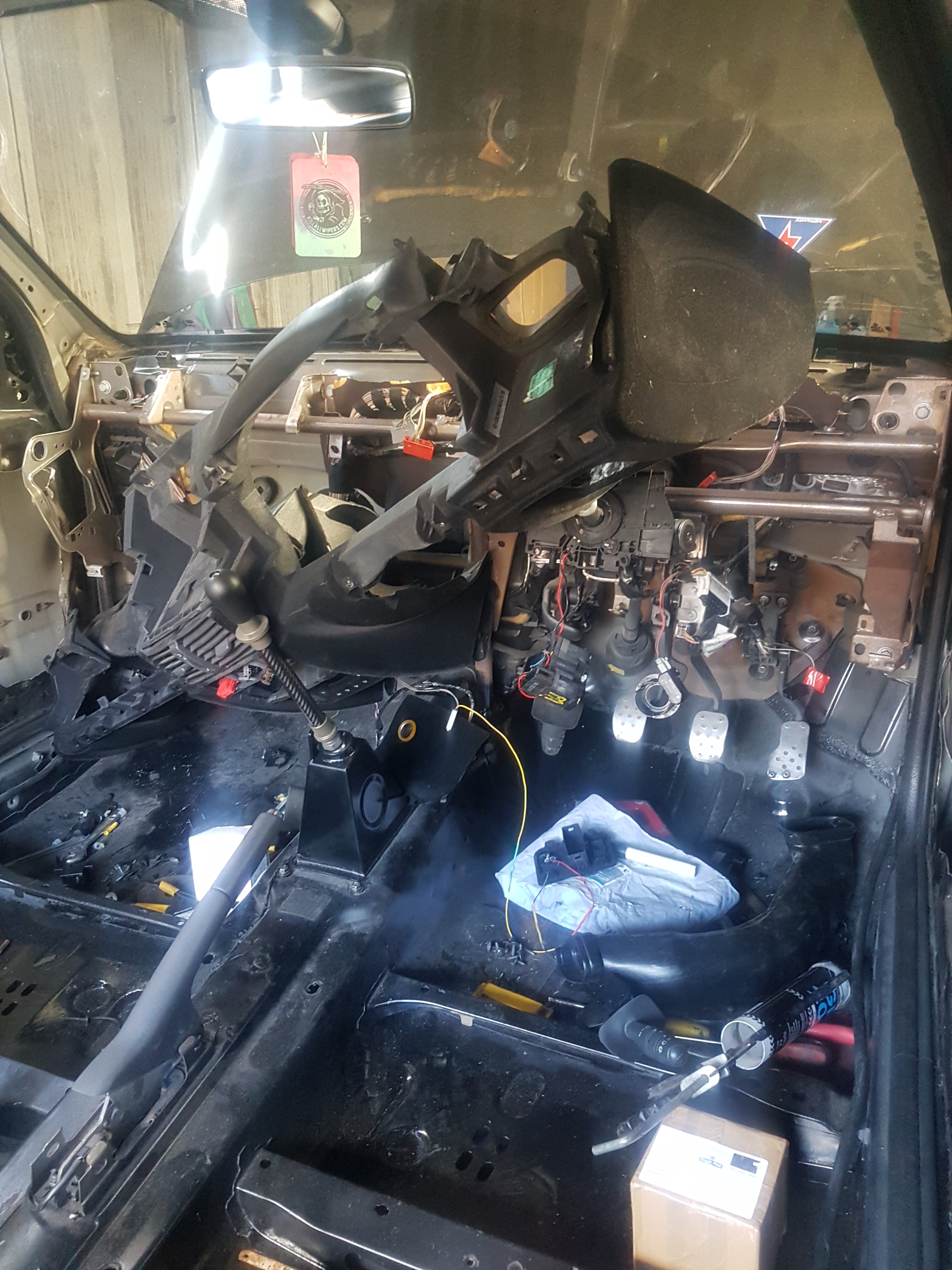

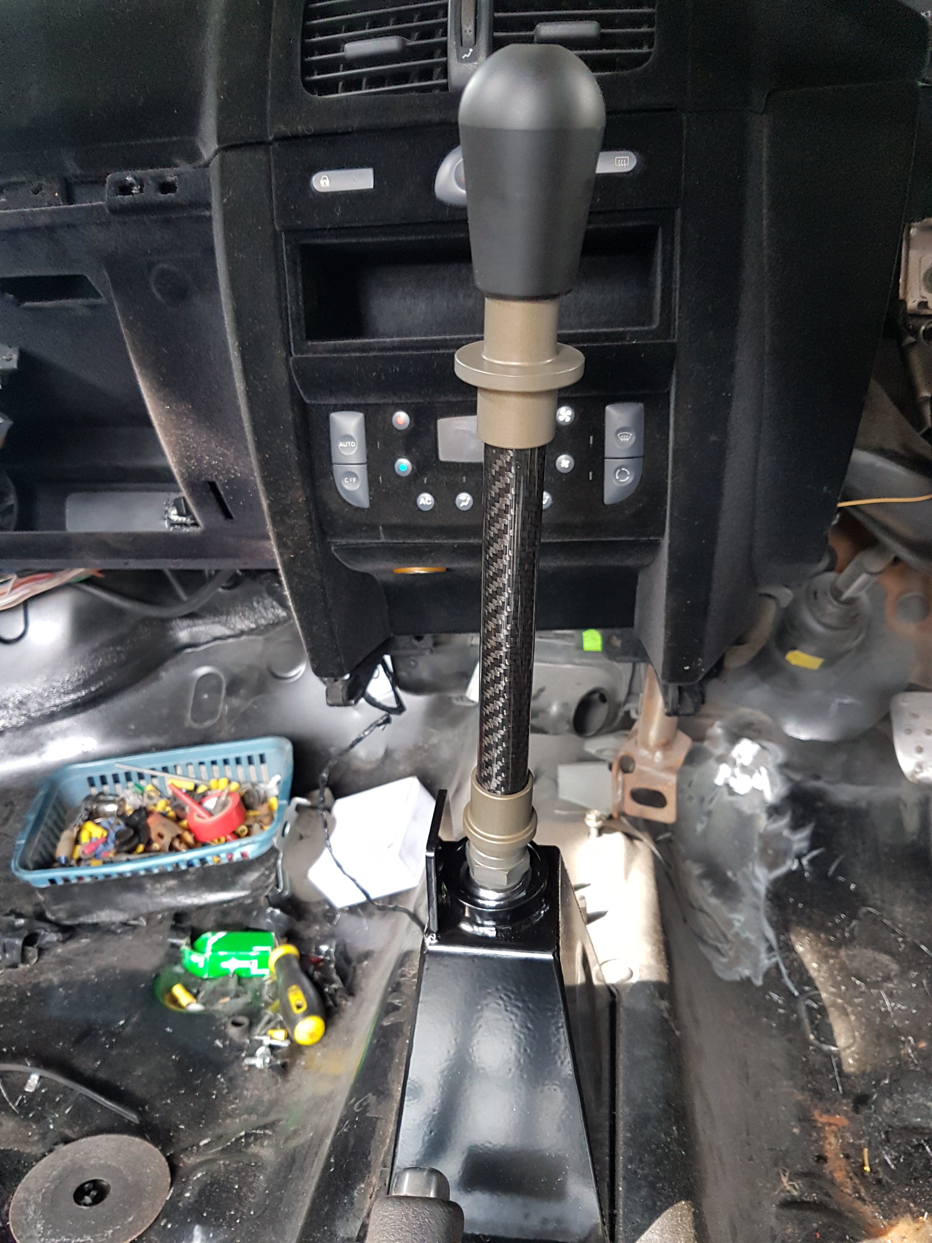

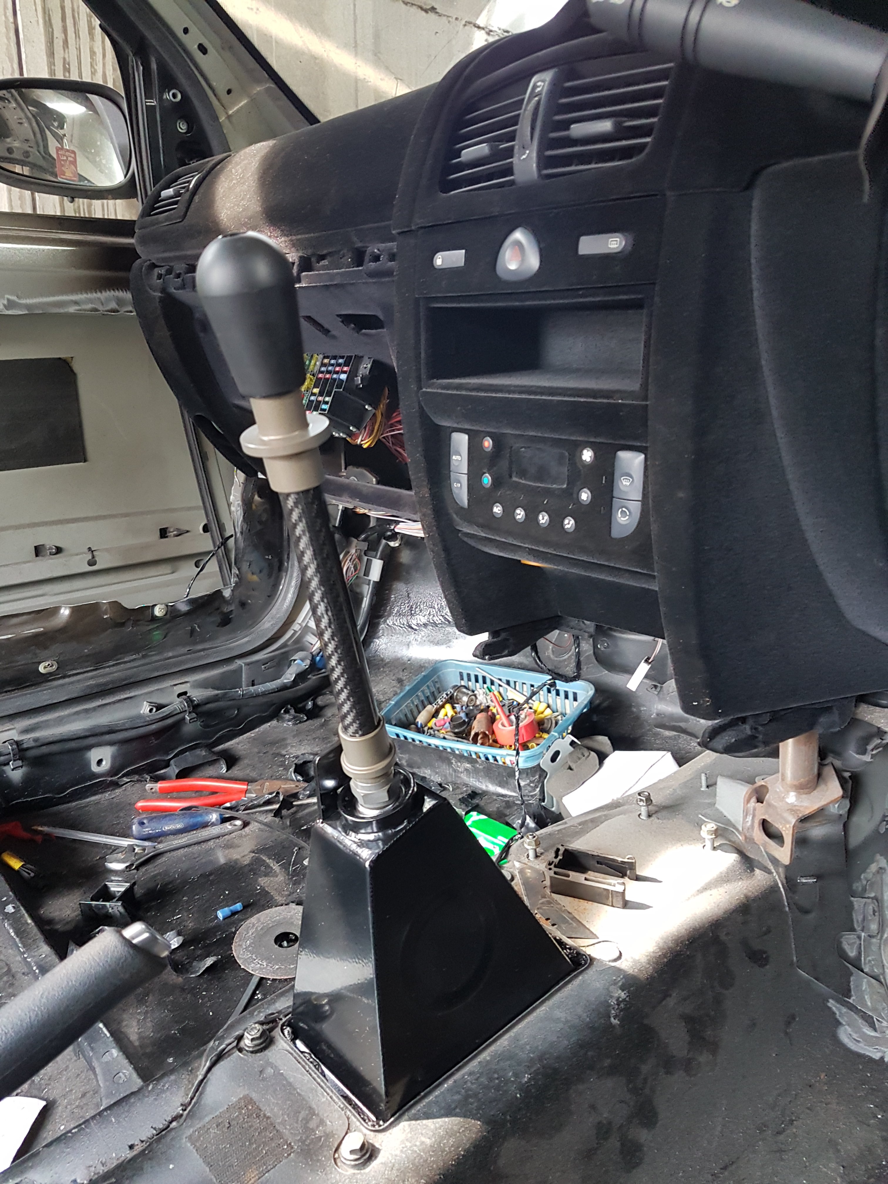

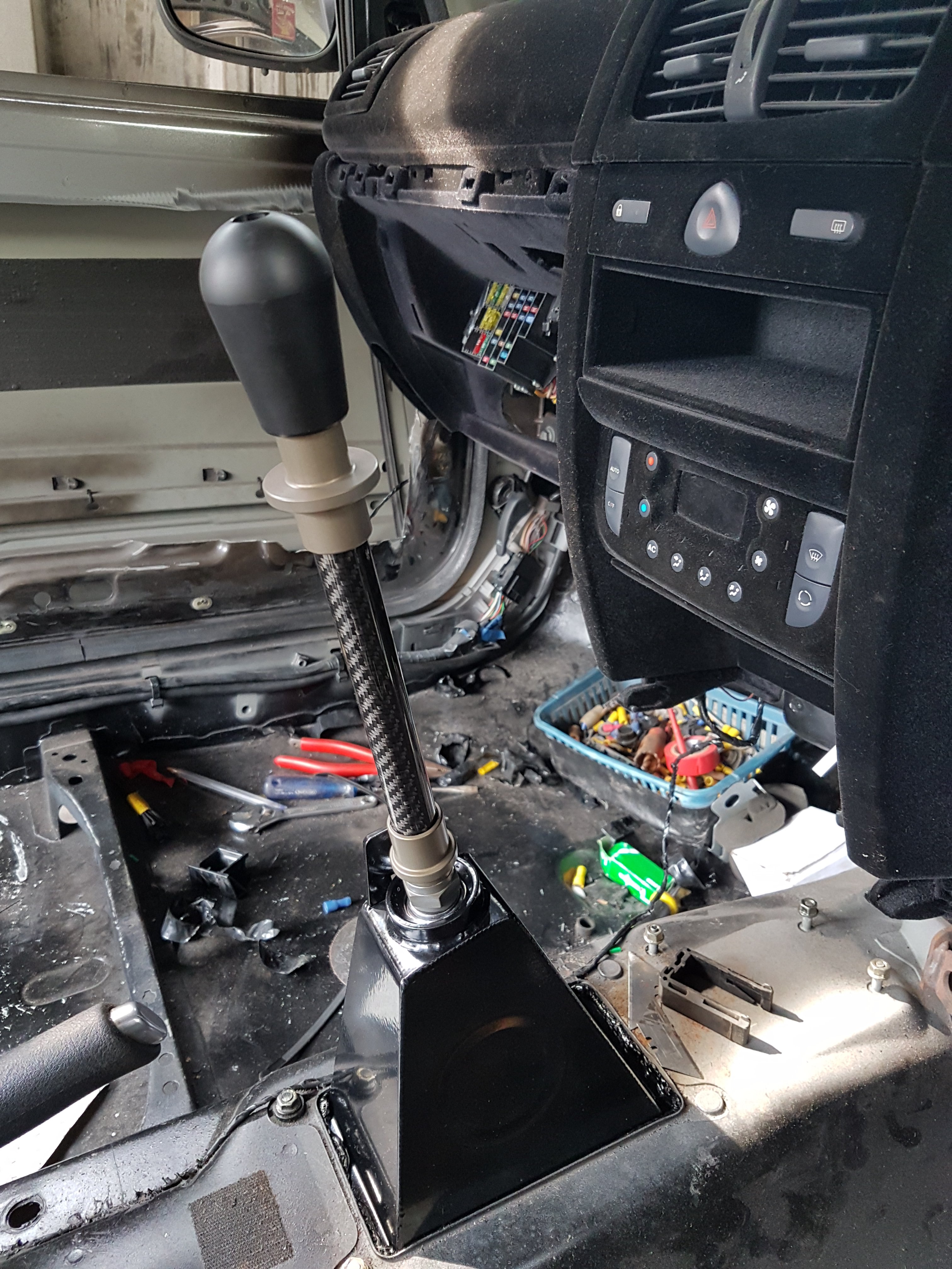

PMS carbon short shift kit fitted.

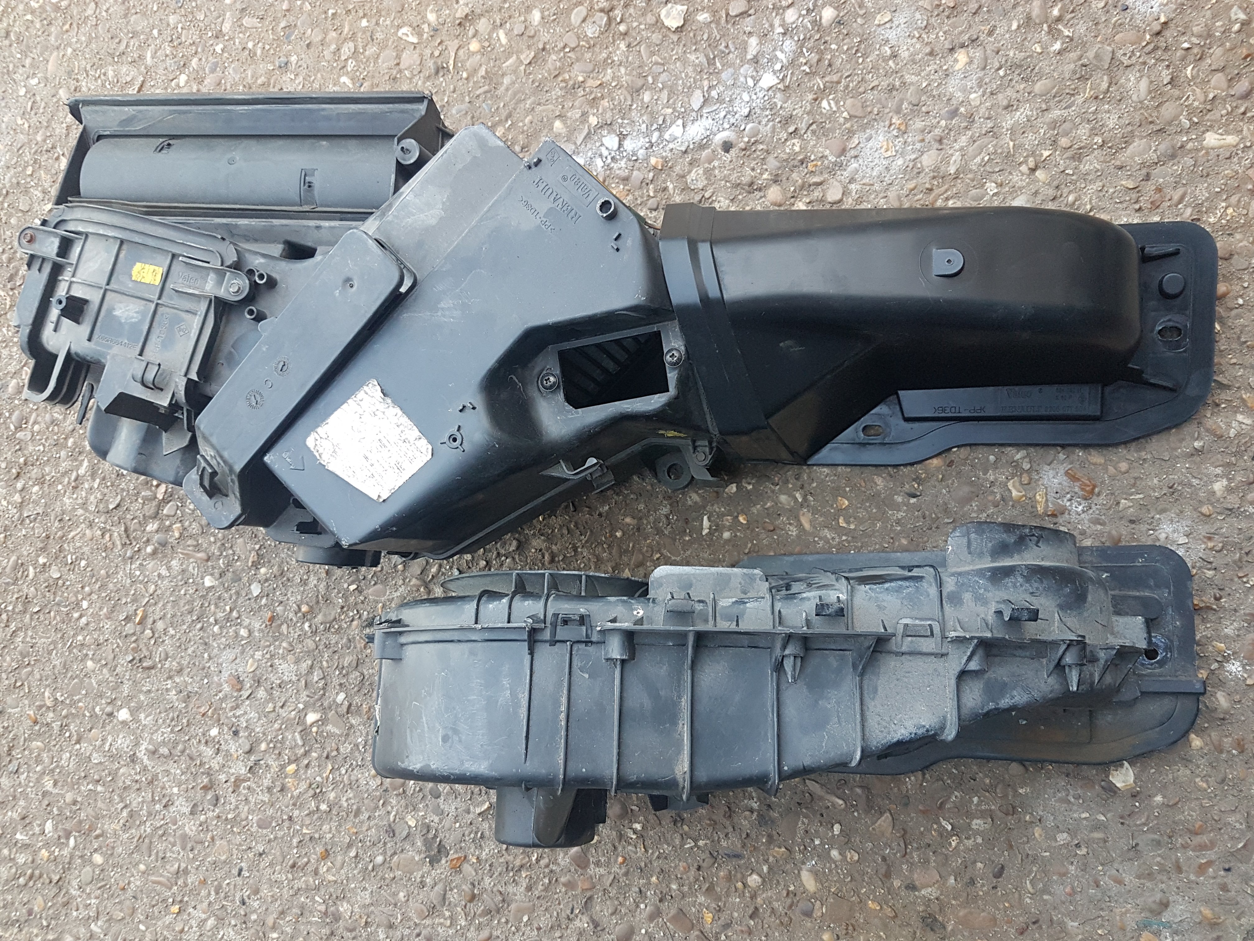

More weight saving.
original heater blower vs cup version
Edited by SNH
Bit of research on the heater swap didnt bring up much other than some pins in the main harness plug needed swapping as mine has climate/aircon and cups had neither. electrics aren't my strong point :D
Bit more digging and i stumbled across an old post saying he'd just trimmed the cup setup to fit the old heater resistor to keep the original plug, so i set to it and bingo it works. Just need to cut a plug off each setup and swap them over and its in and working. Whether it blows hot and cold i wont know till its on the road but it works off the climate controls.

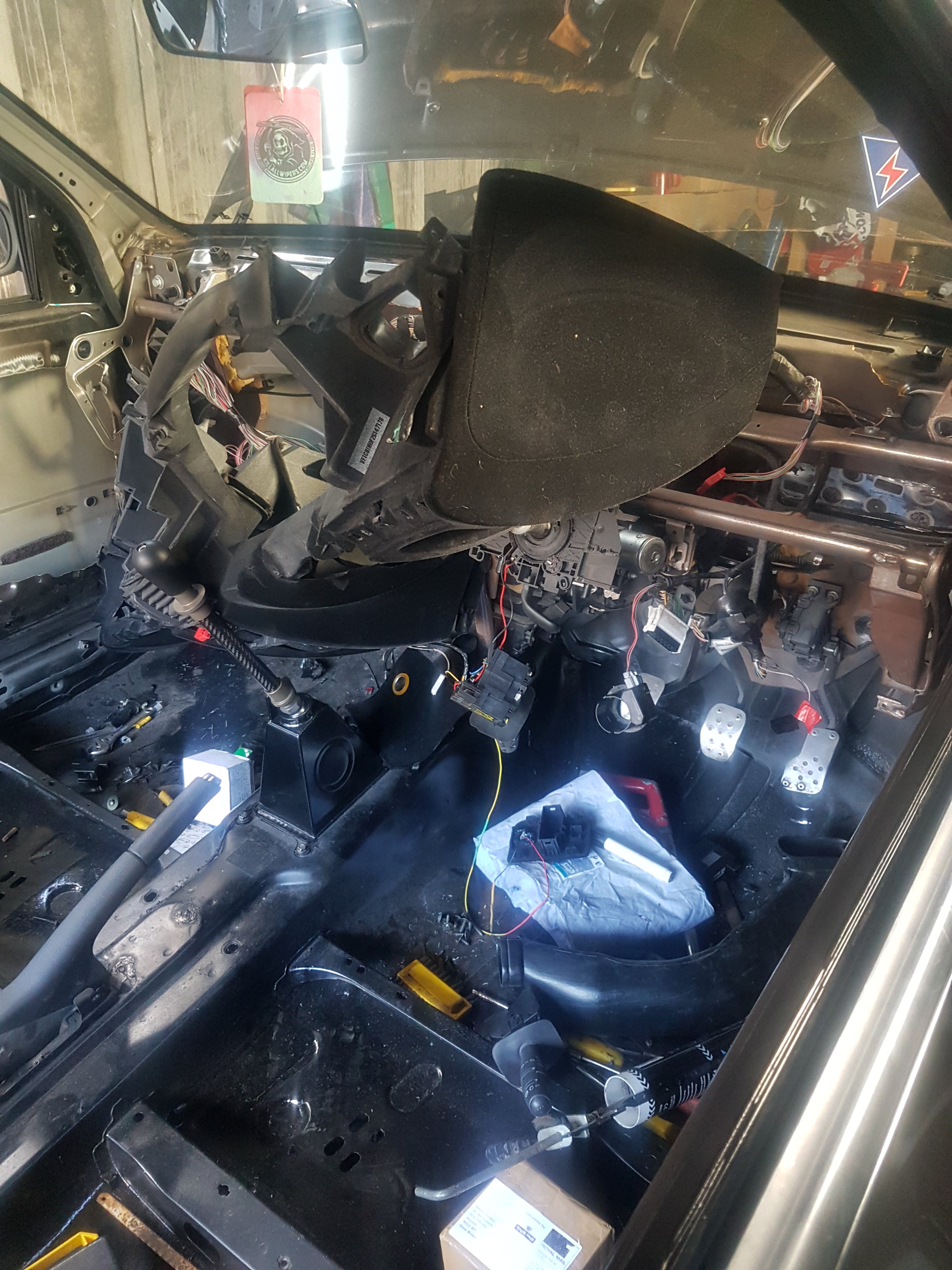

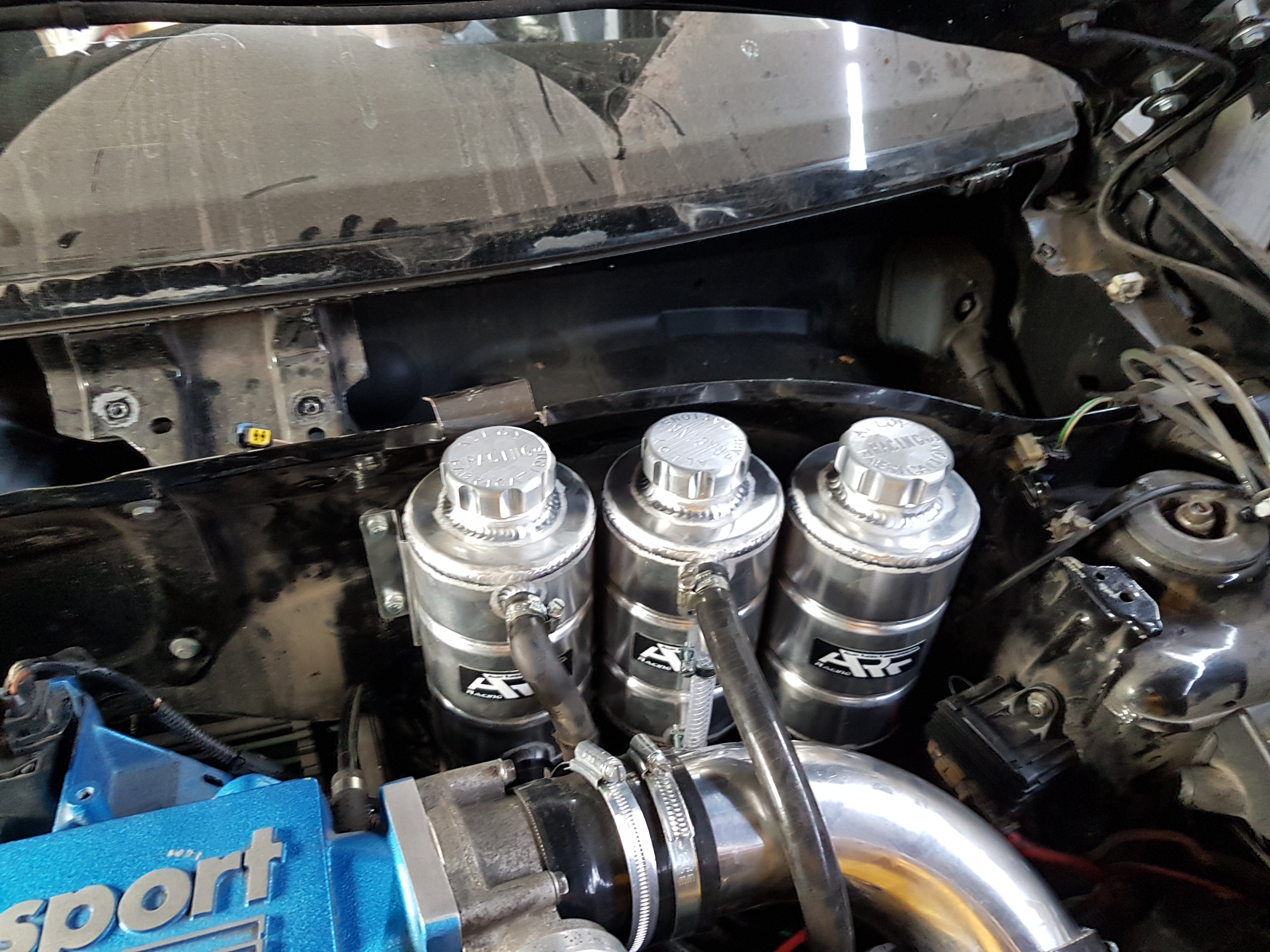

Had a bright idea to fit a battery cut off switch but not wanting to cut the dash to fit it internally i decided it'd go in the Passenger scuttle panel, easy i thought...wiper mechanic is in the way!
Fitted it in the drivers side....happy days. Then realised the dash, wiper mech, alloy tanks all had to come out to re-route the power cable 😞
