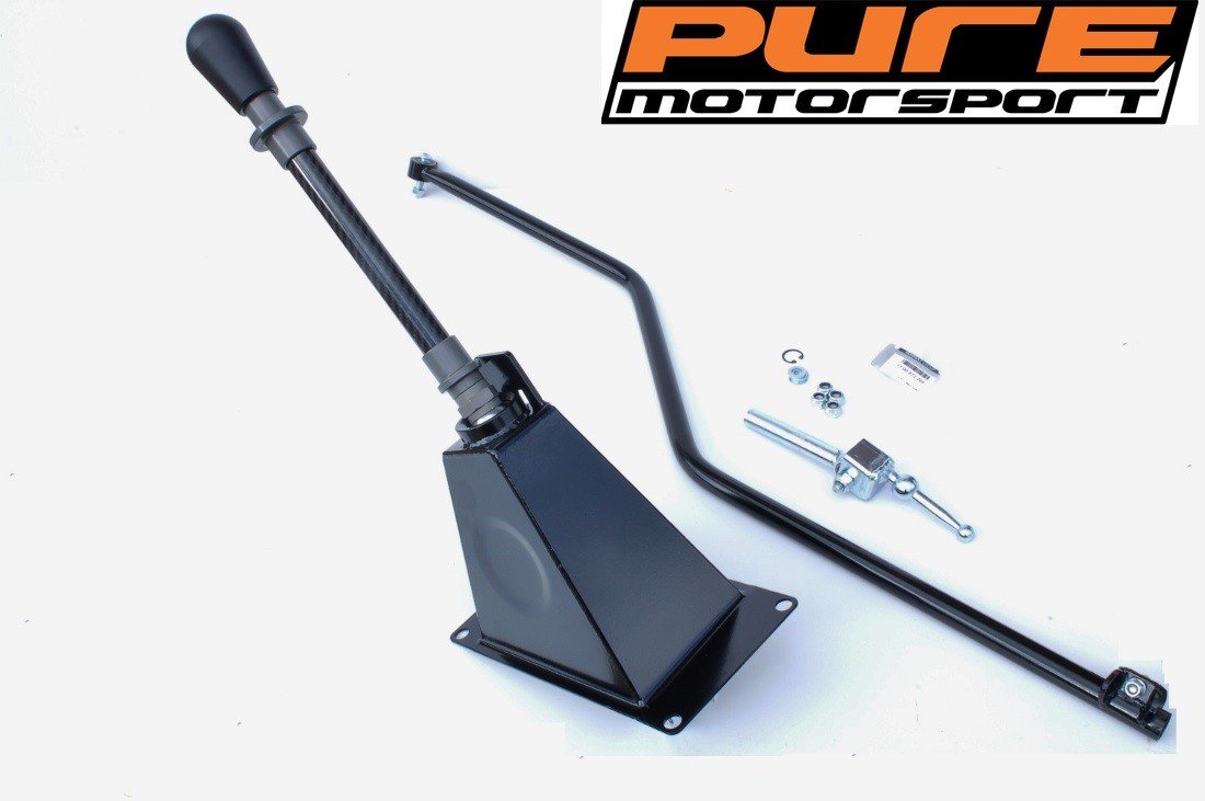

One of the clio sport lads does them so just waiting for him to get some stock, i did look at the PMS one but new im not sure its worth the cost. If one comes up at a good price 2nd hand i could be tempted

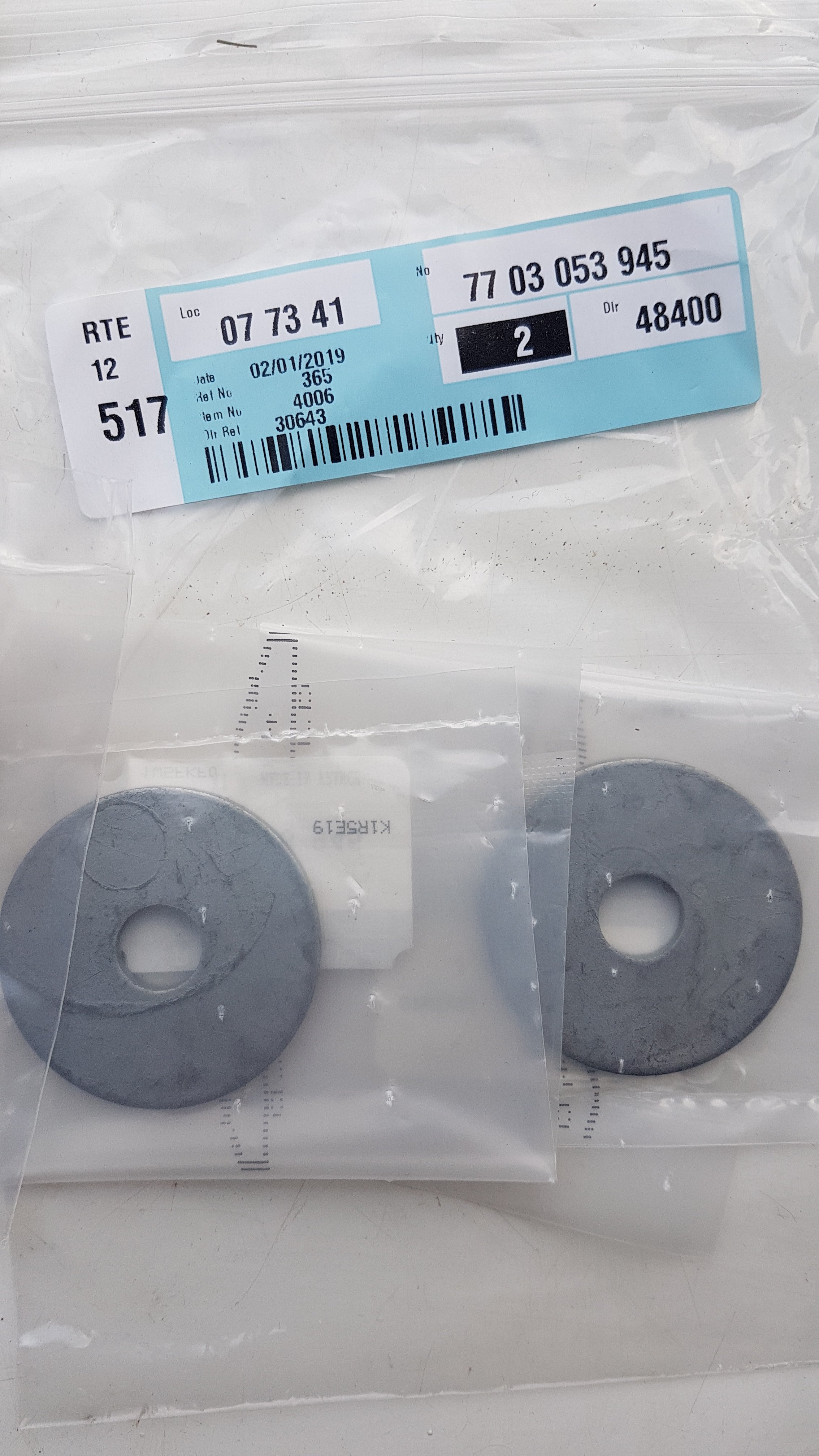

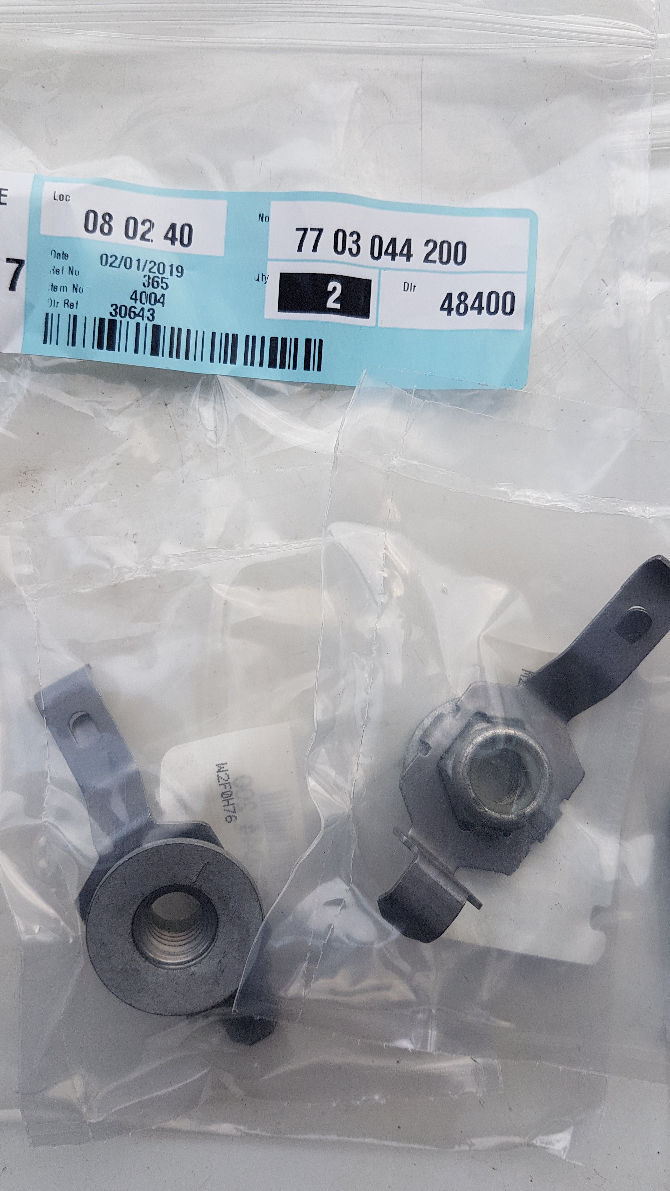

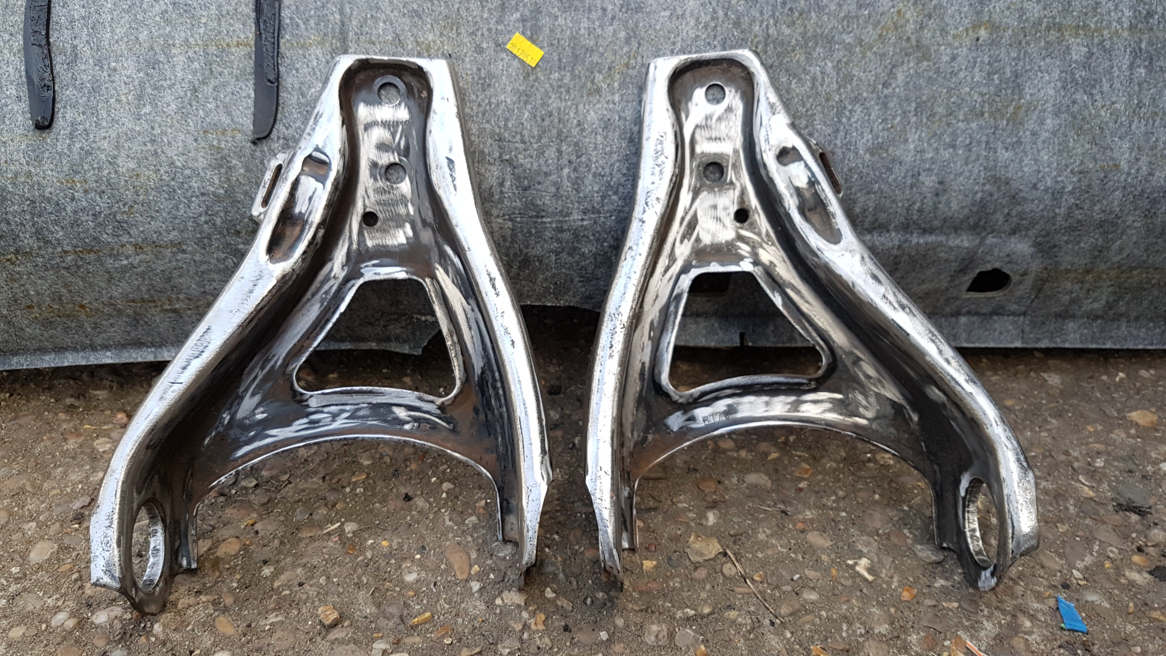

Tackled another job, then decided to buy new as the new type has added castor over the older version :D
Back to work tomorrow so things will slow down now :D
£75 :o

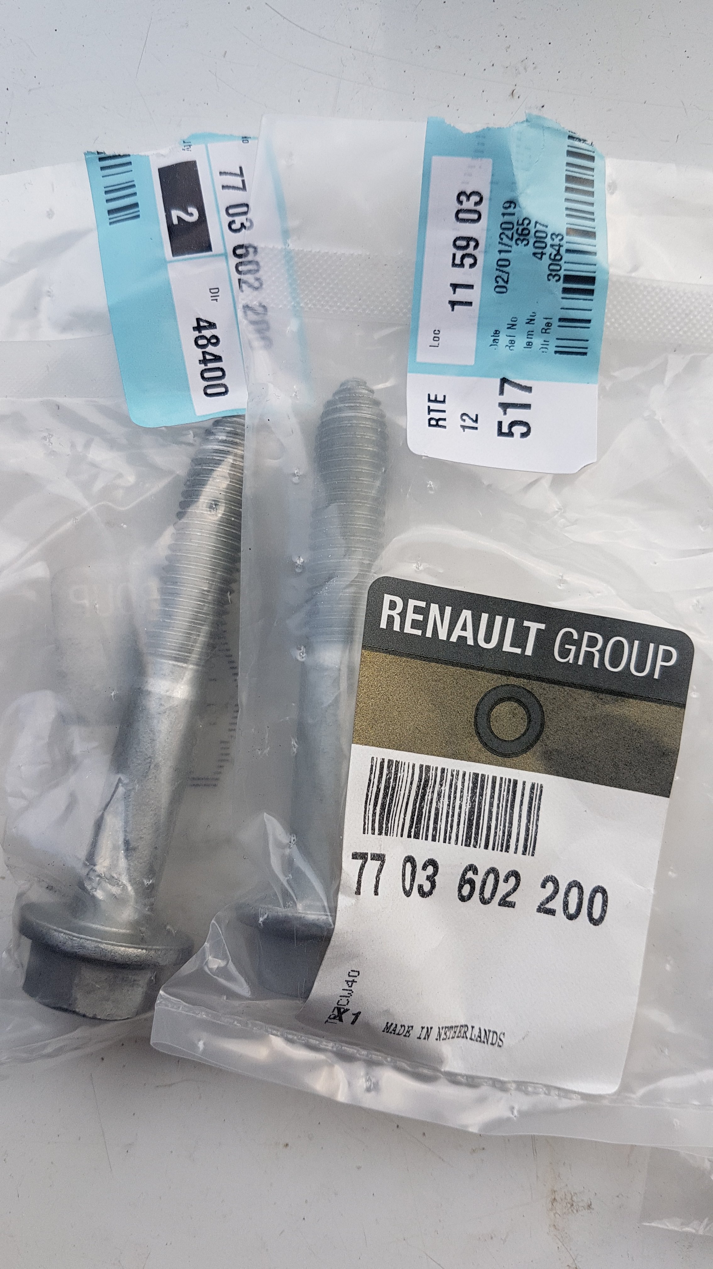

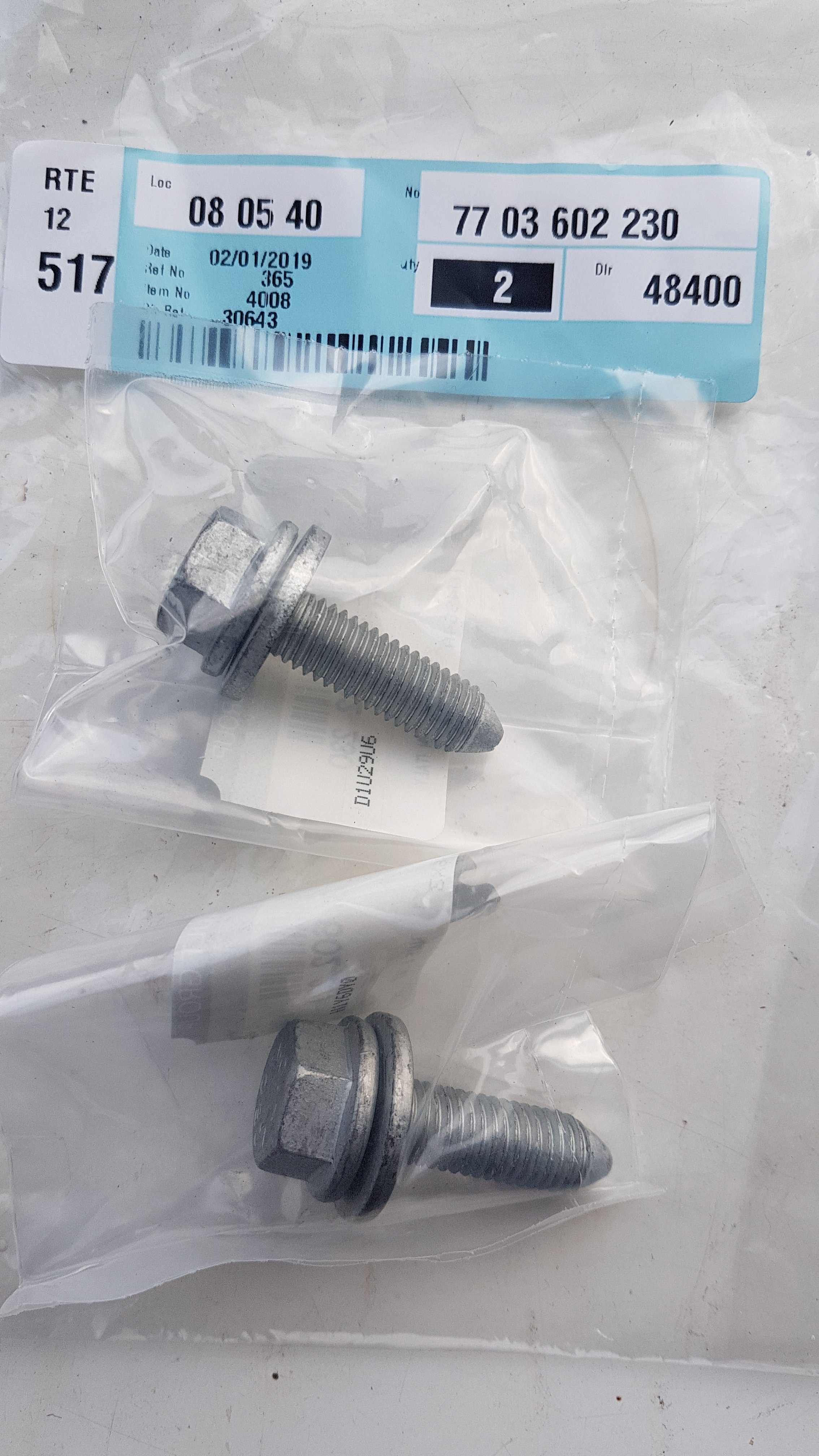

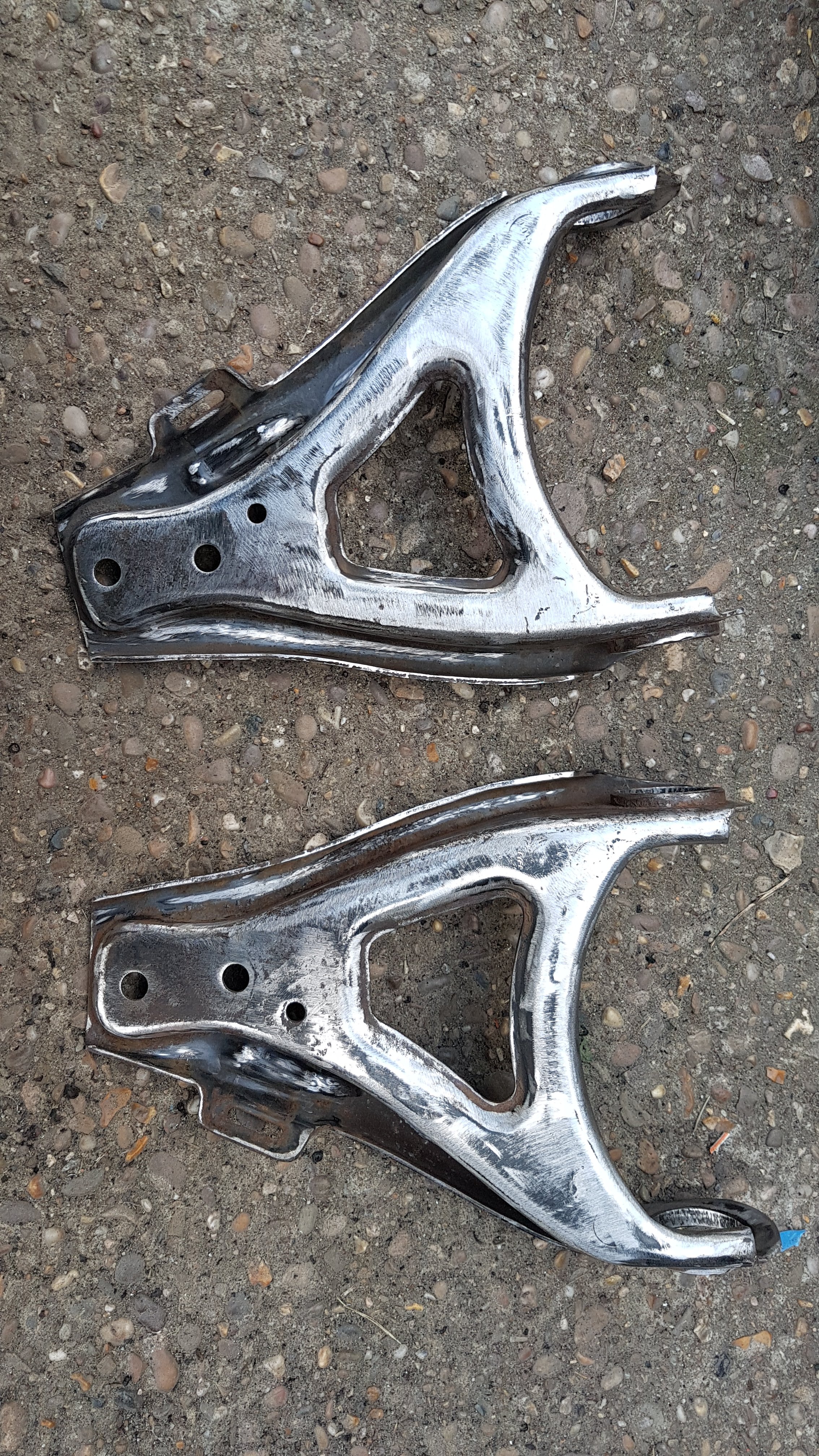

Subframes bolted back up.
Still waiting on the arb bushes from strongflex.

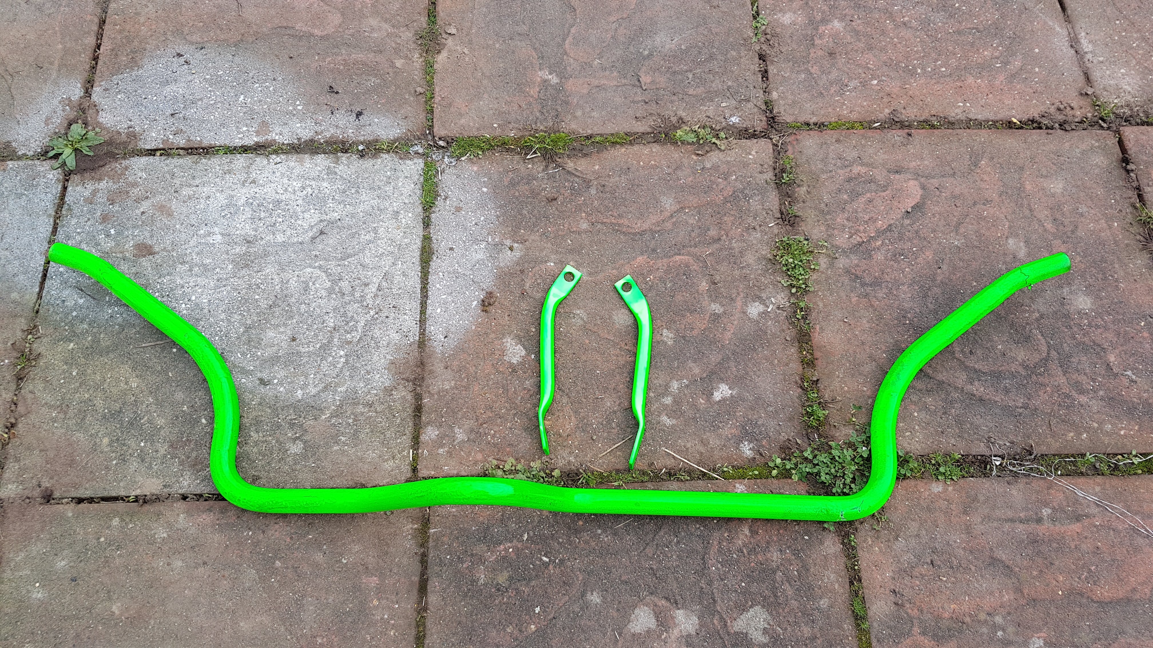

Arb and wishbones brackets painted.

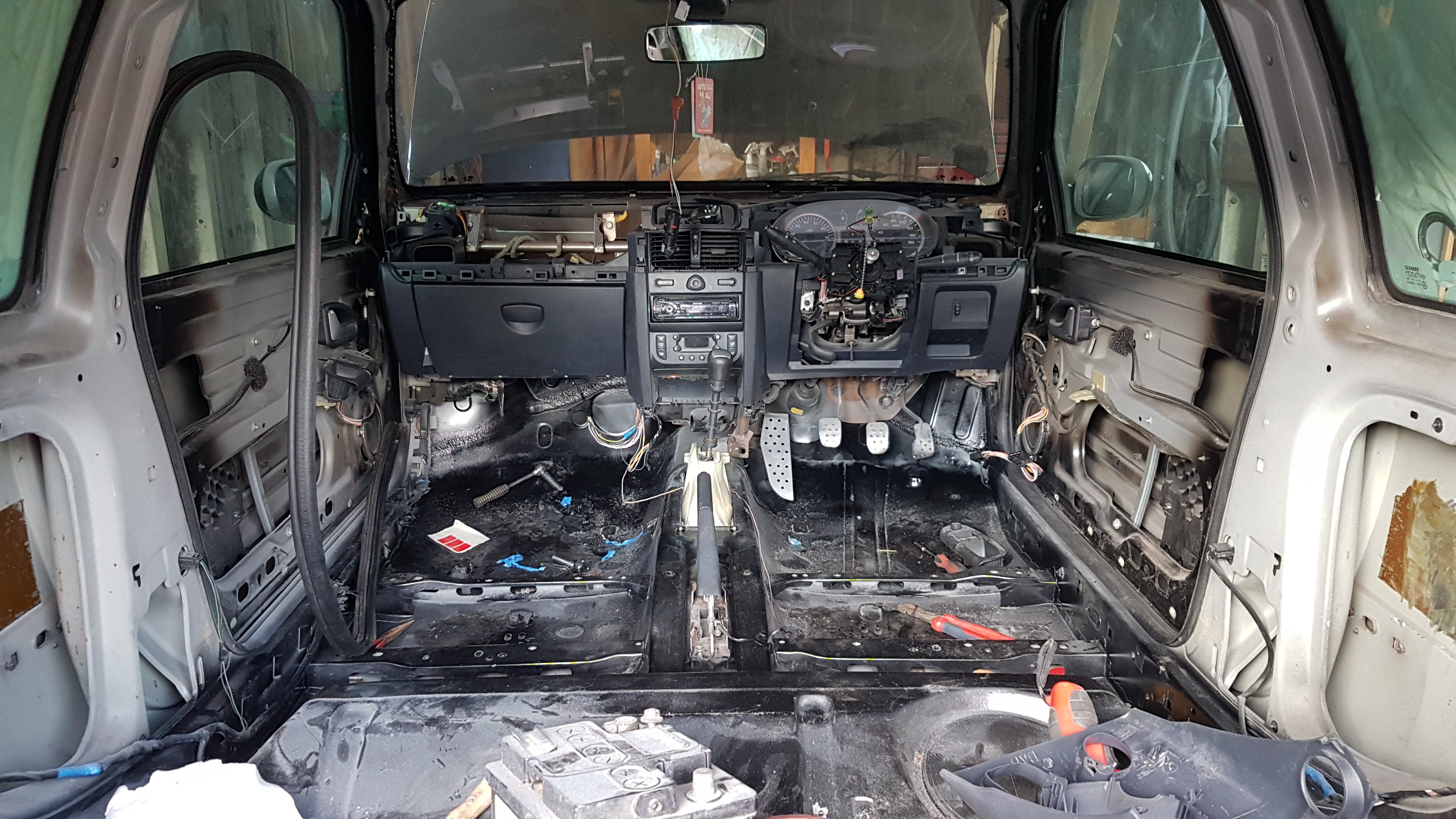

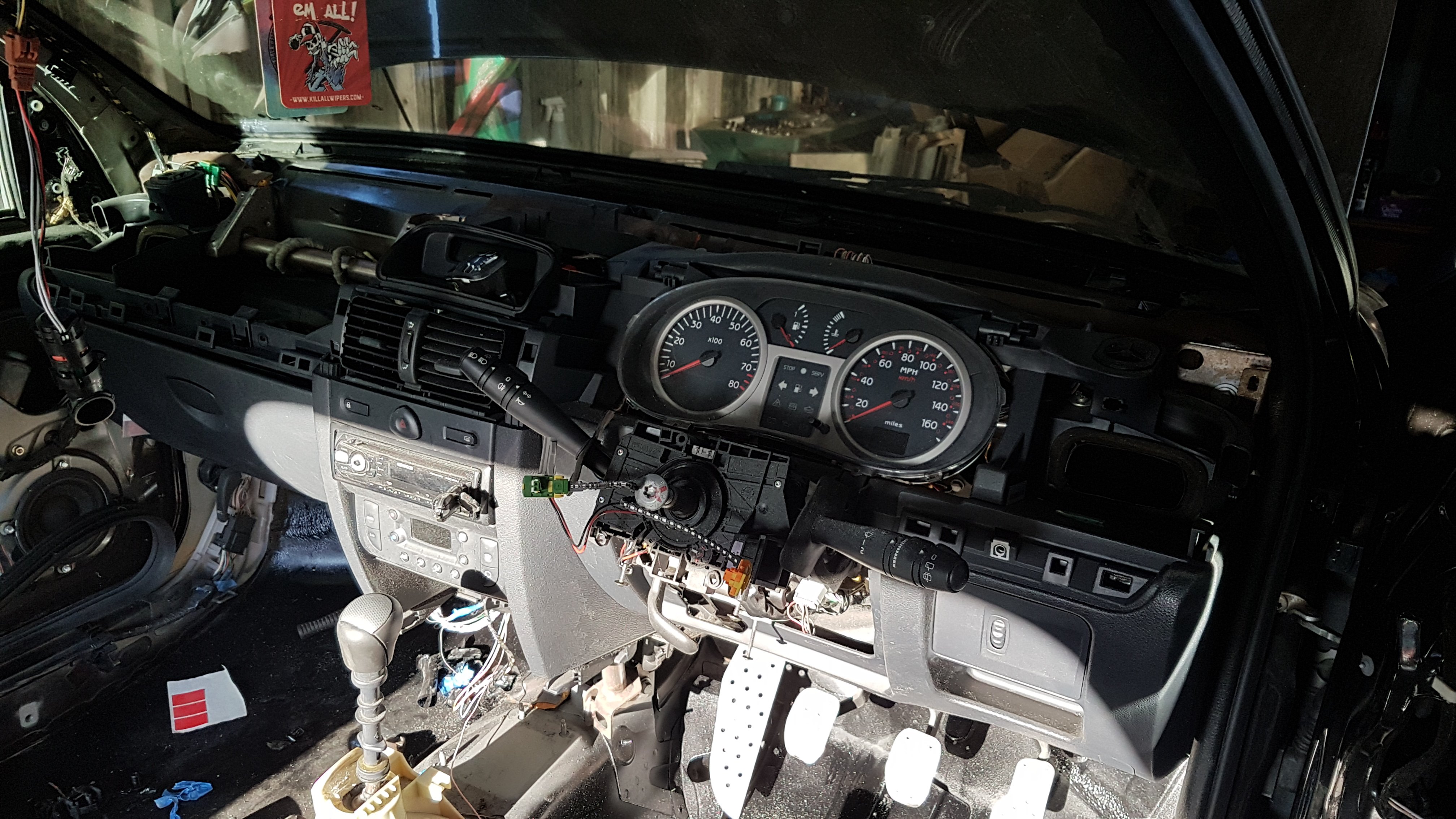

Remove dash top ready for flocking
Remove passenger airbag, airbag ECU and wiring.
Productive day.

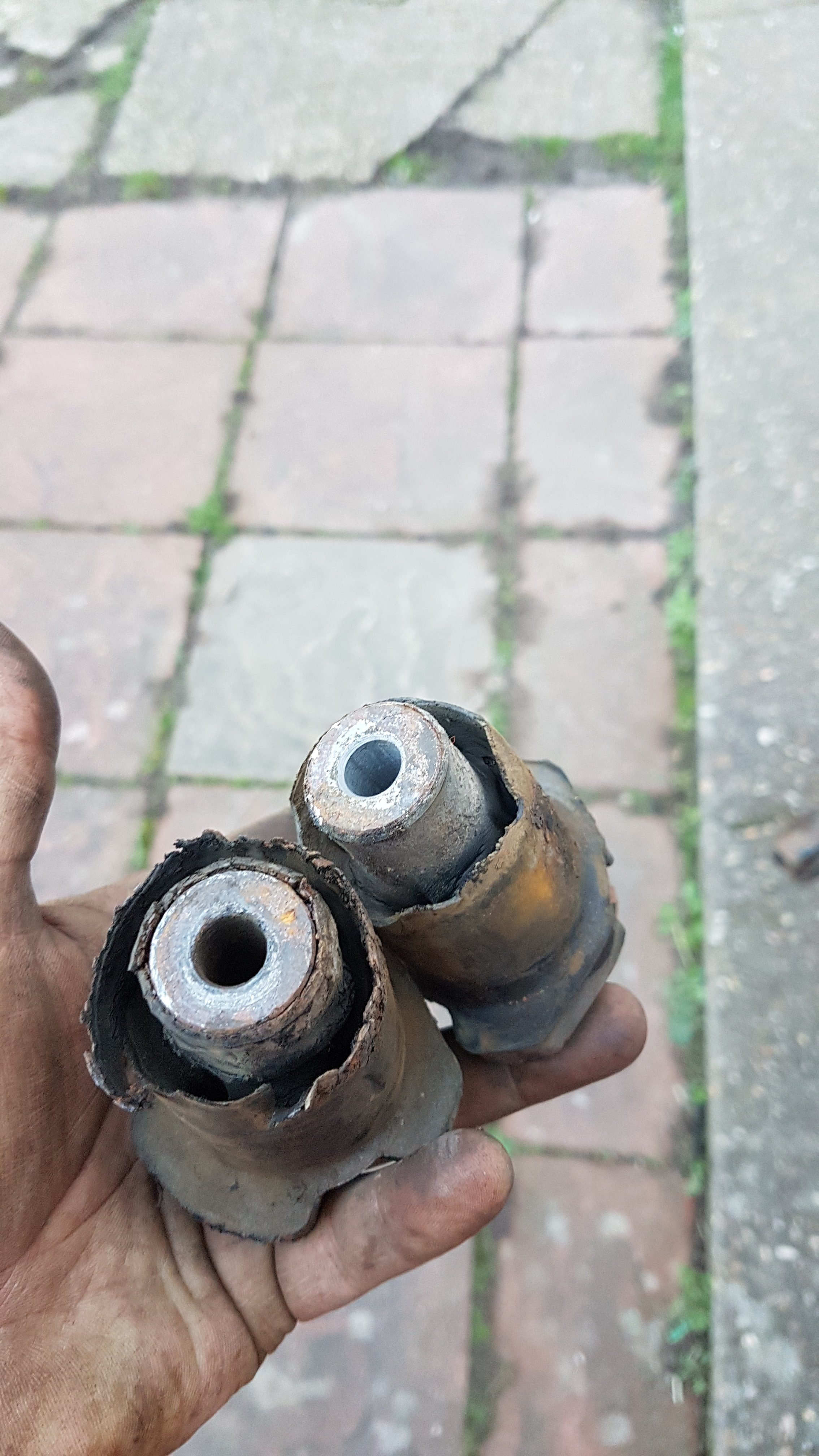

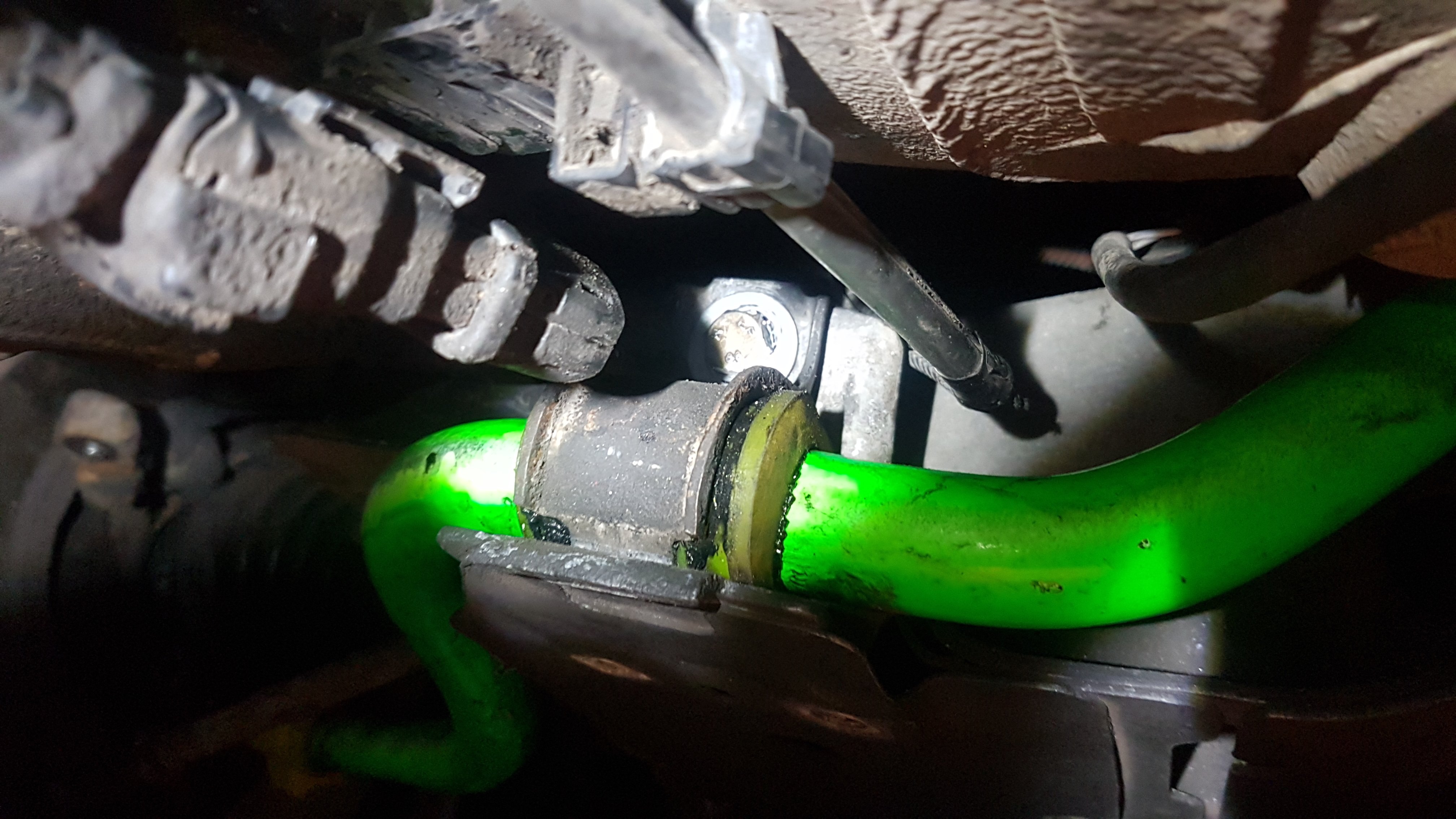

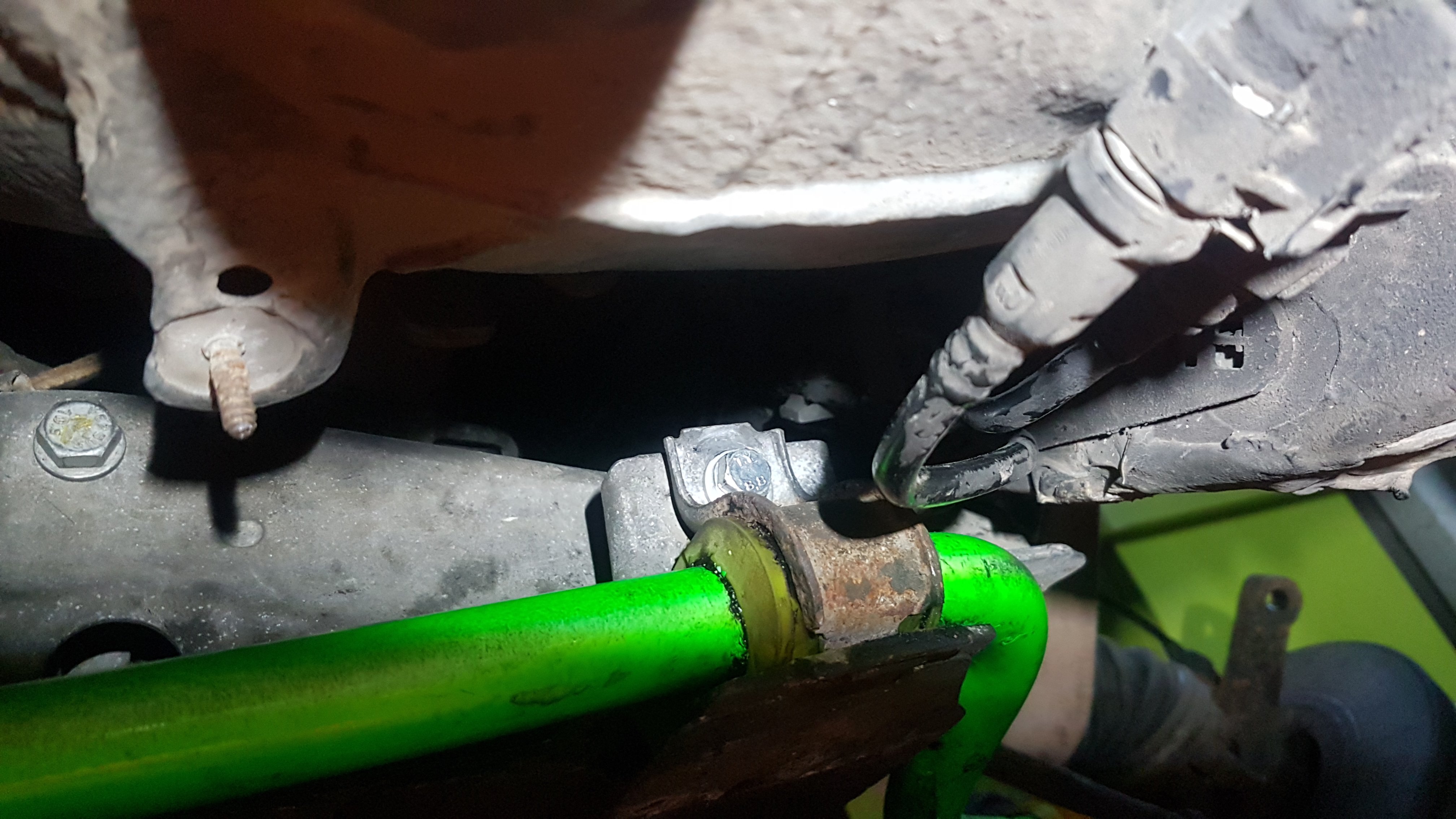

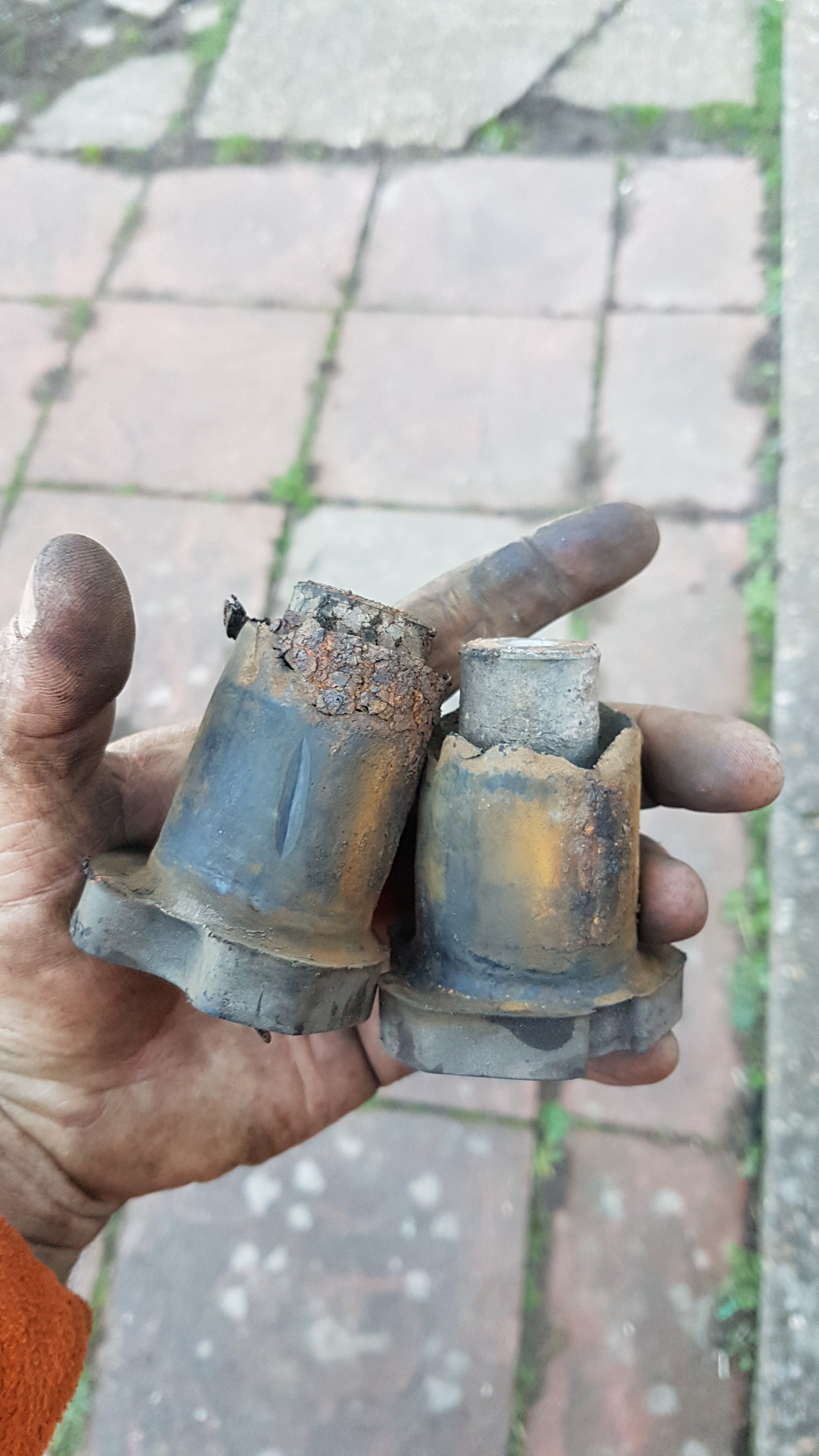

Arb bushes turned up, absolutely pig of a job.
Got angry, locked the garage up, walked away, didn't smash anything.

I expected a few snapped/pain in the arse bolts and haven't been disappointed, i have discovered the engineers workshop at work which is like an aladins cave of nuts and bolts meaning I've been able to renew everything like for like bar the subframe bolts so its saved me some hassle there.

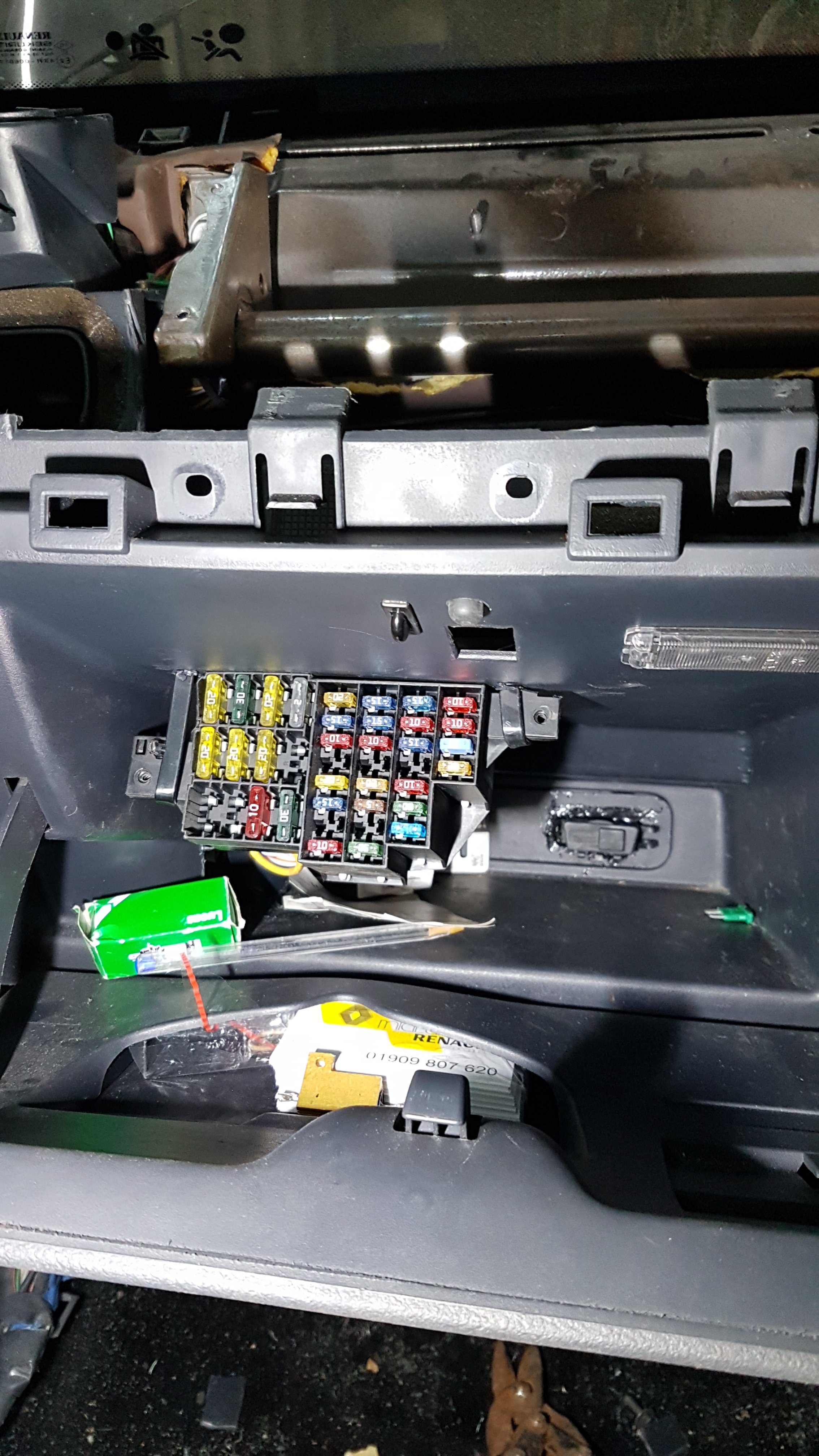

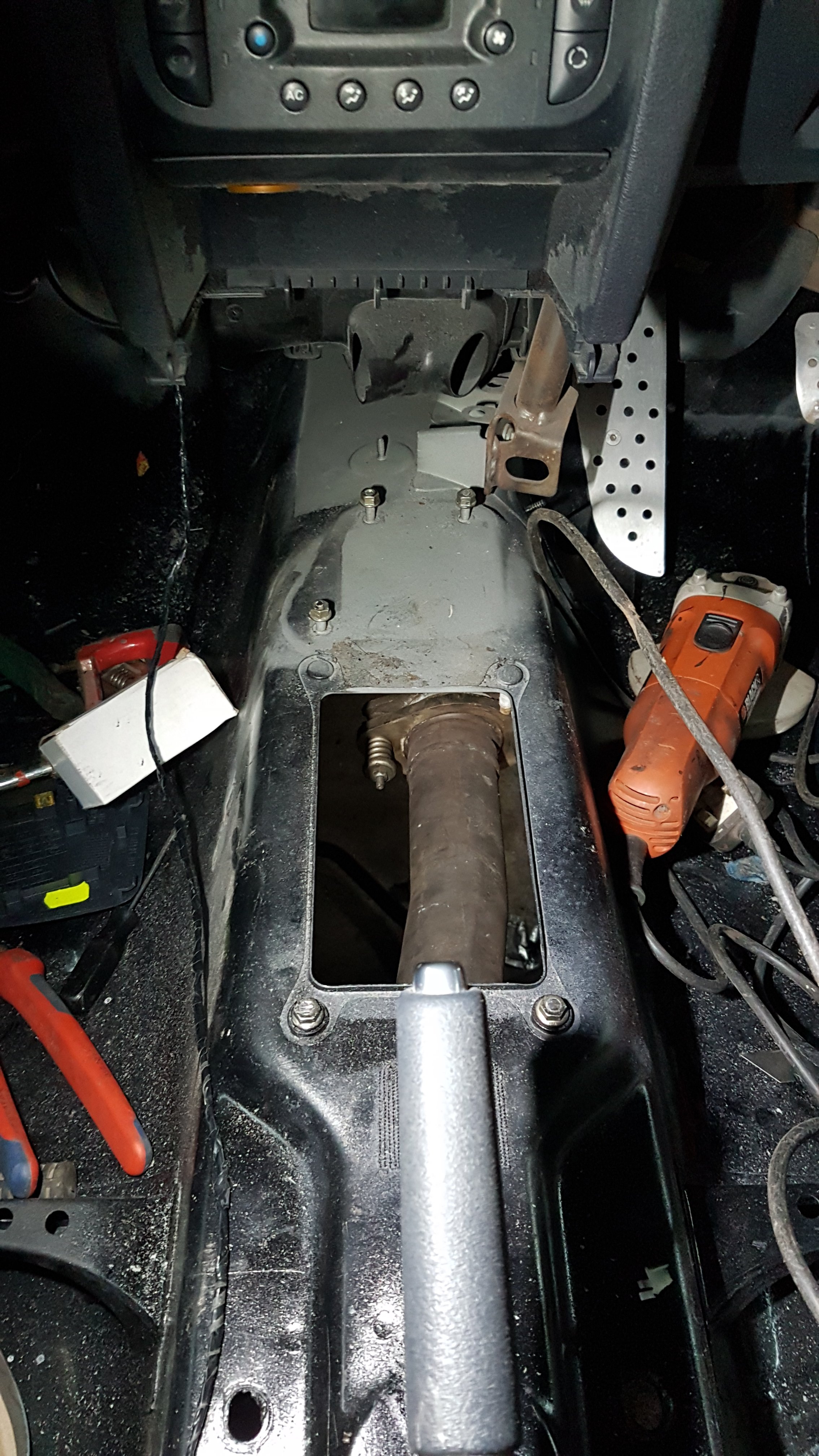

Shifted the fuse box from the side of the dash to the glovebox as it sits directly where the front cage leg will sit through the dash.

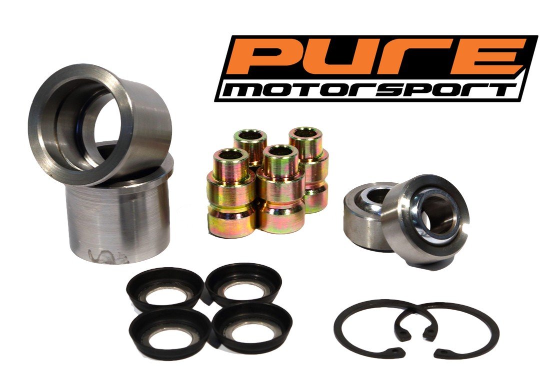

Gear level setup removed as ive decided on the Pure Motorsport setup and it replaces the whole oe setup.

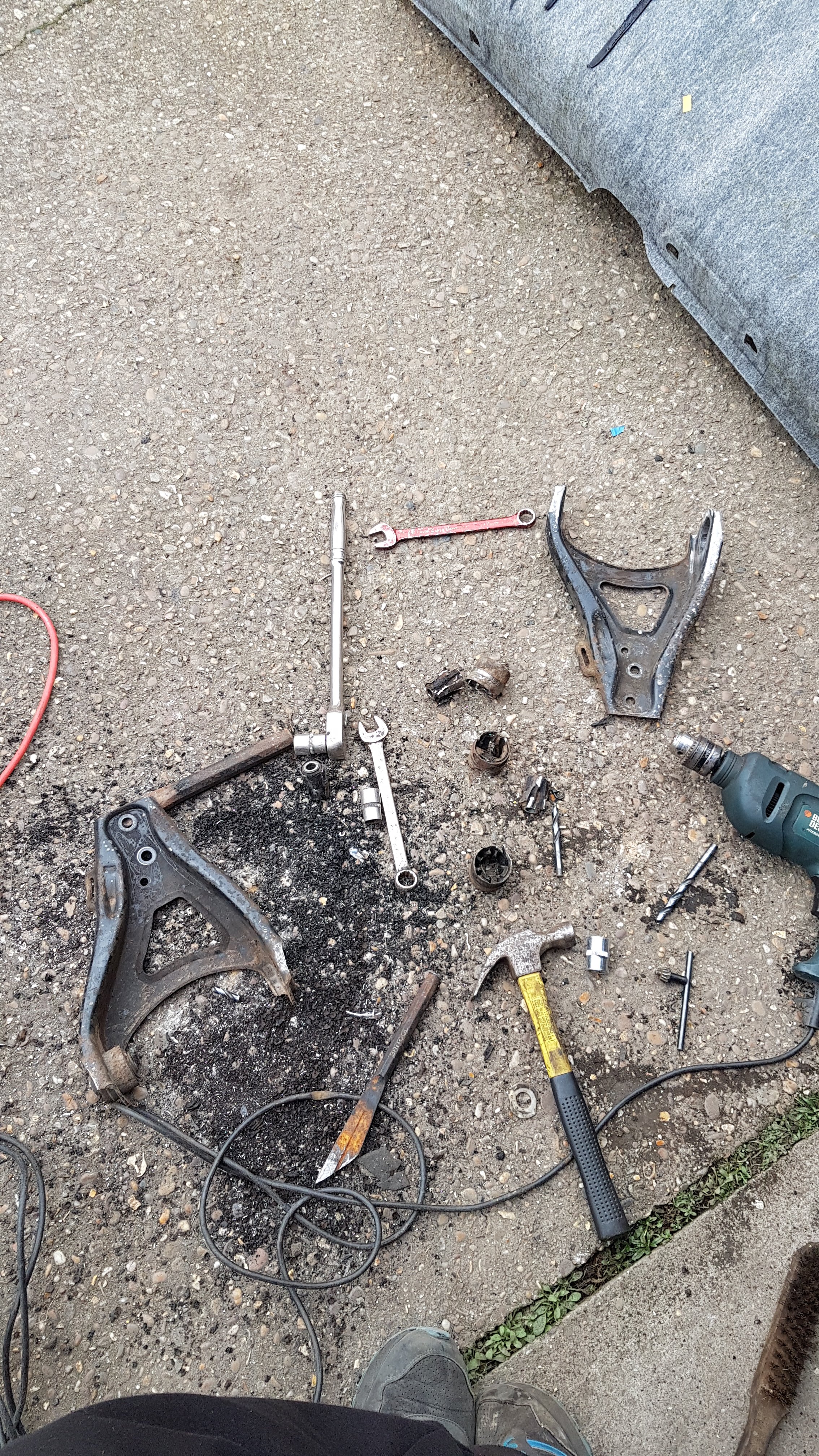

The old bushes near on fell out, just need to bash the casings out.

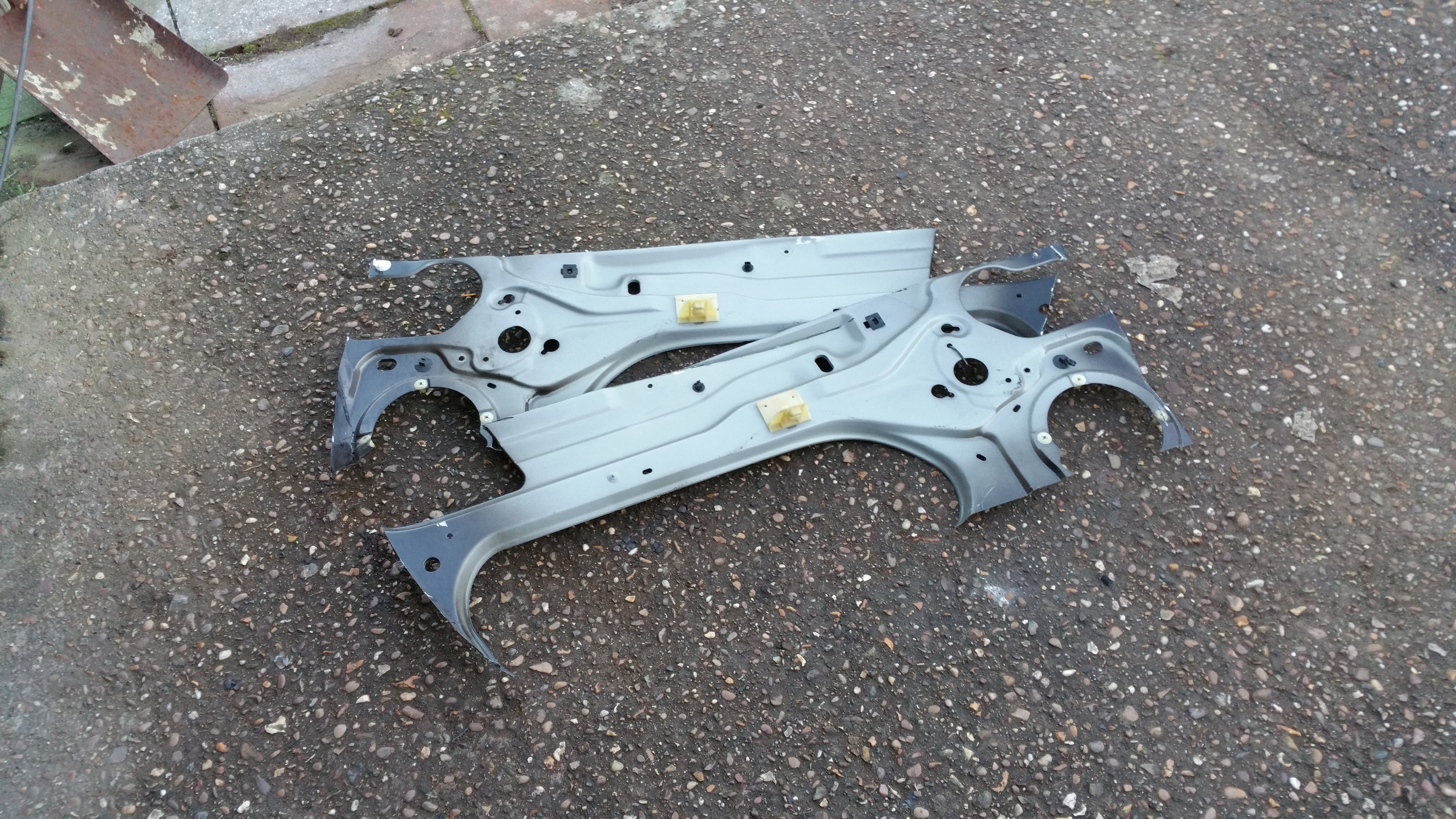

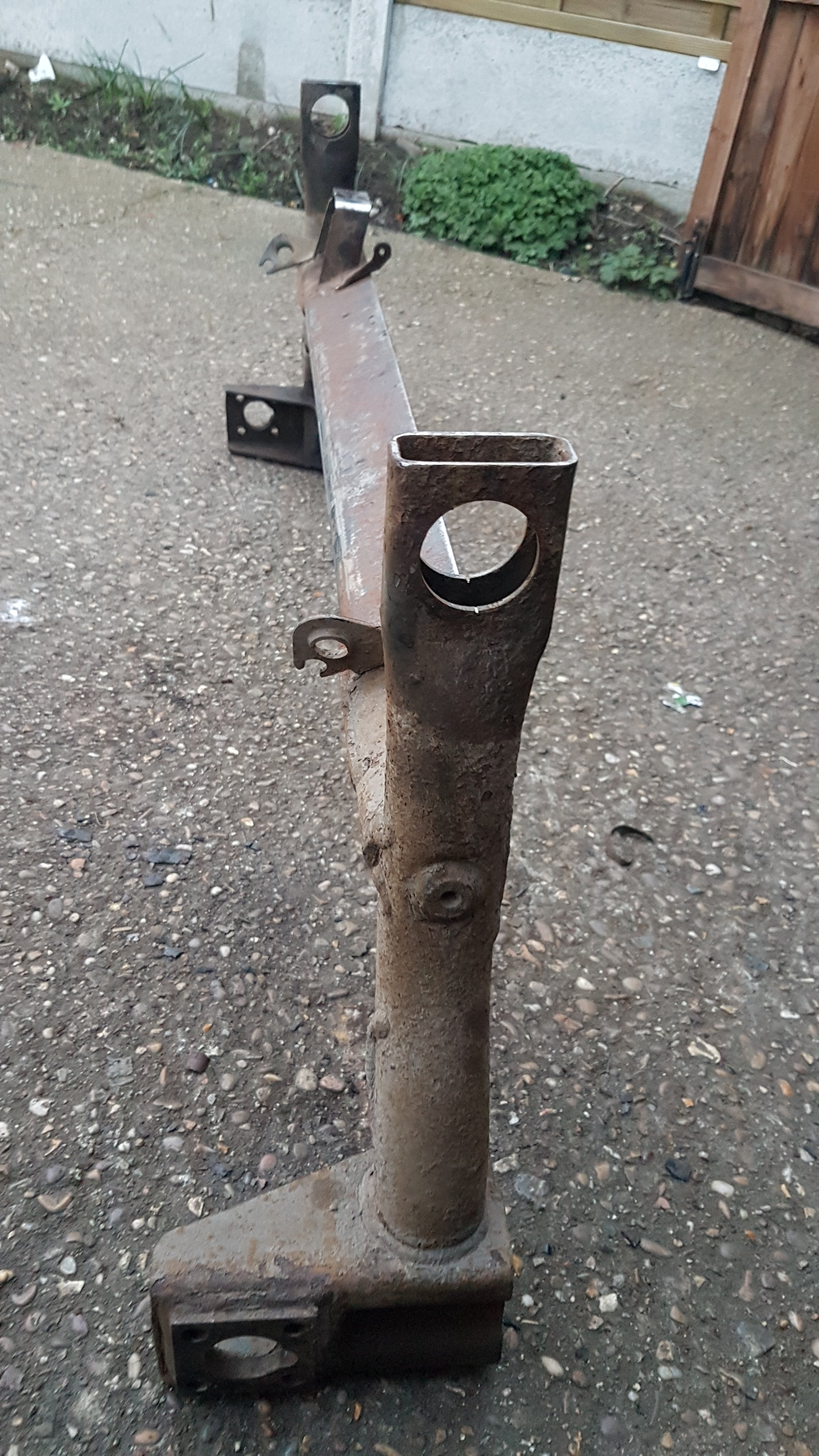

I'll order a strengthening kit up for the bean then it can be blasted and poedercoated.

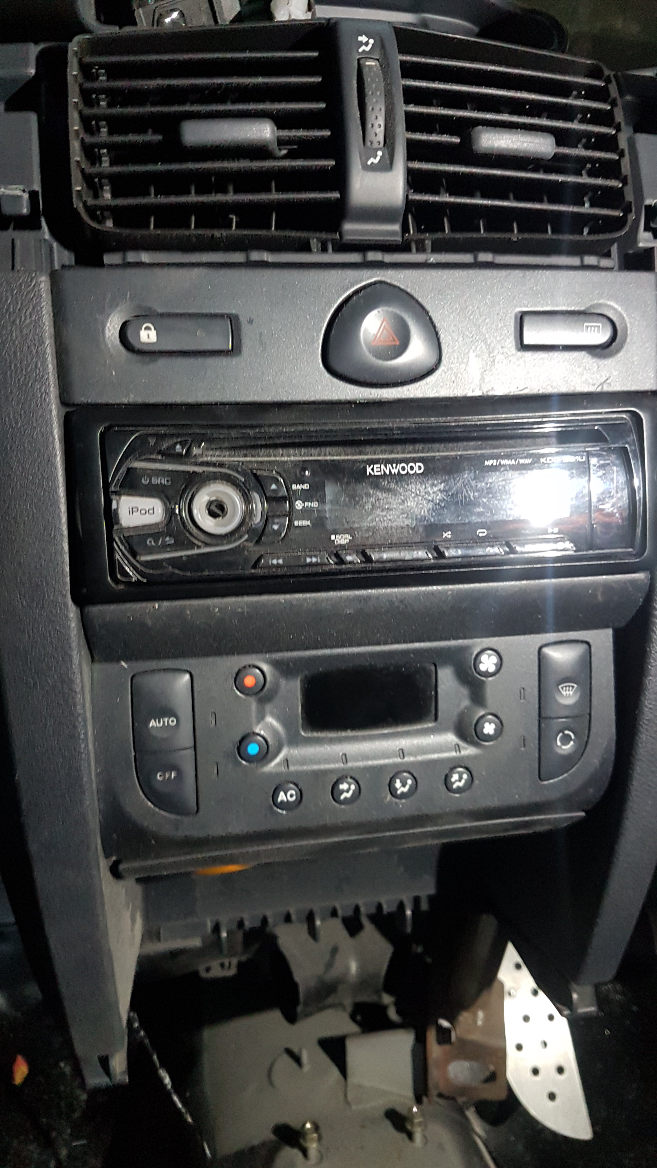

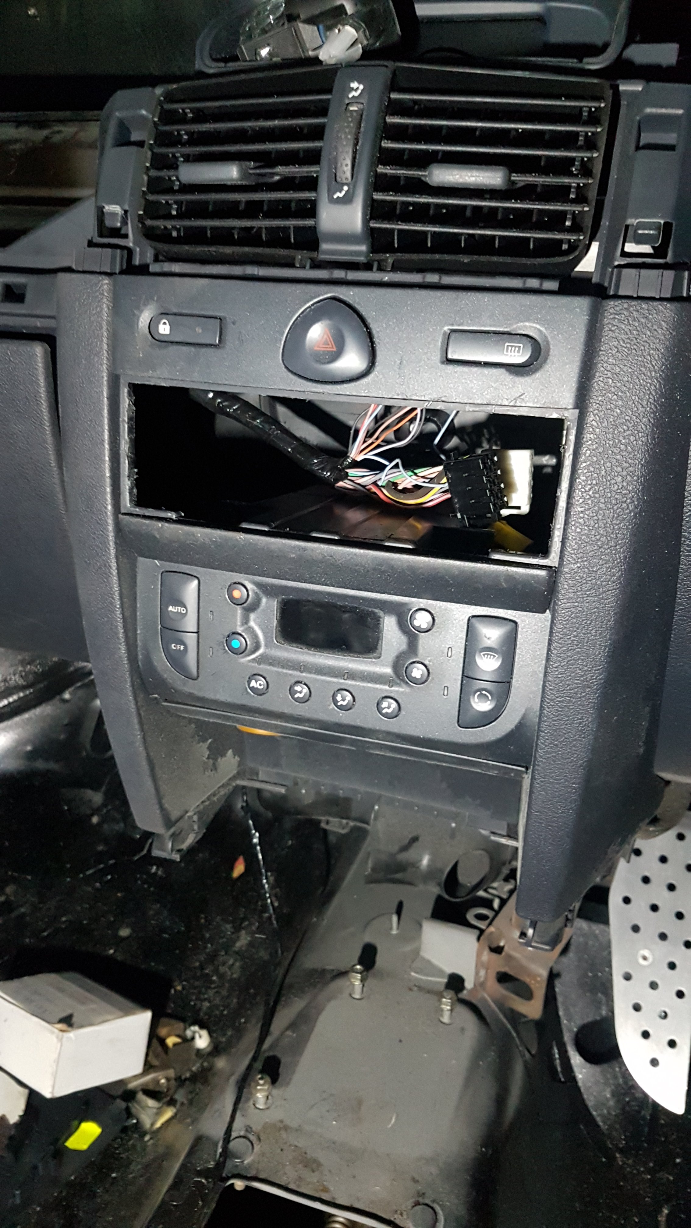

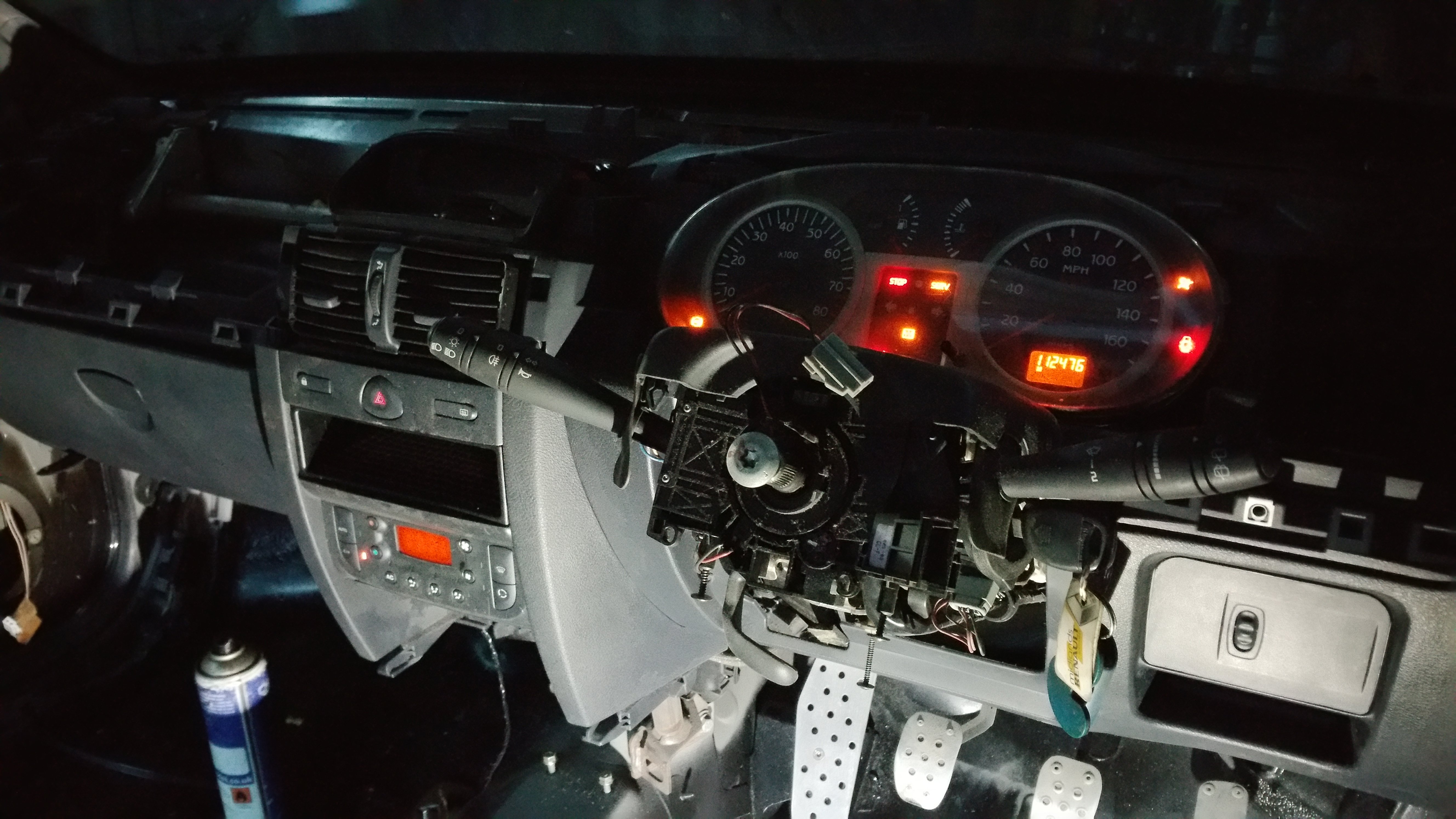

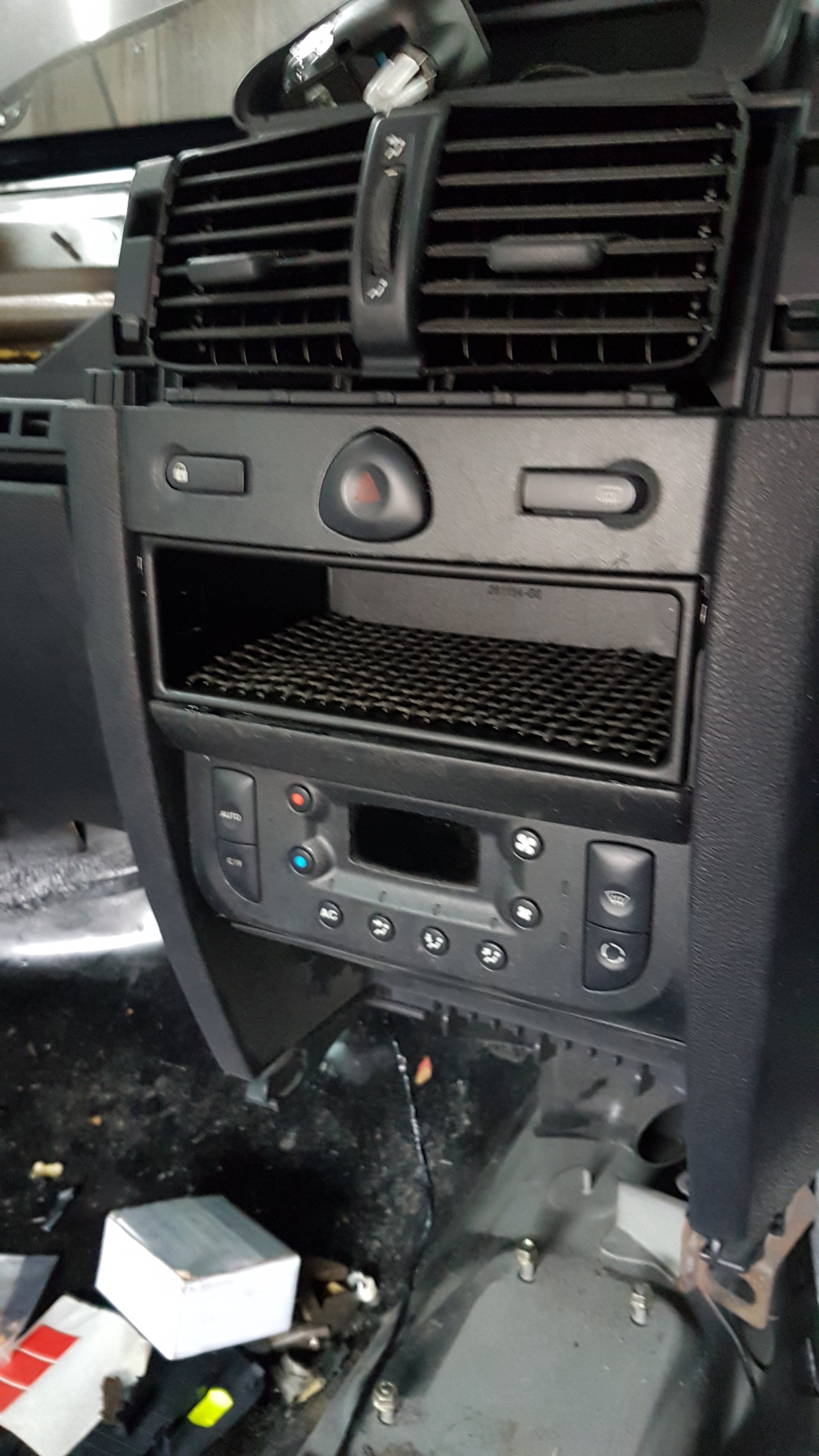

I was in 2 minds whether to remove the stereo or not as i love my music but i noticed yesterday the volume knob was missing, I dont know where its gone or how but i can't find it anywhere :D
Decision made for me then!
Stuck on what to fit in there now? Cubbyhole, blank or a couple of gauges but not sure what i could fit with it being n/a?
Current state of affairs
Edited by SNH

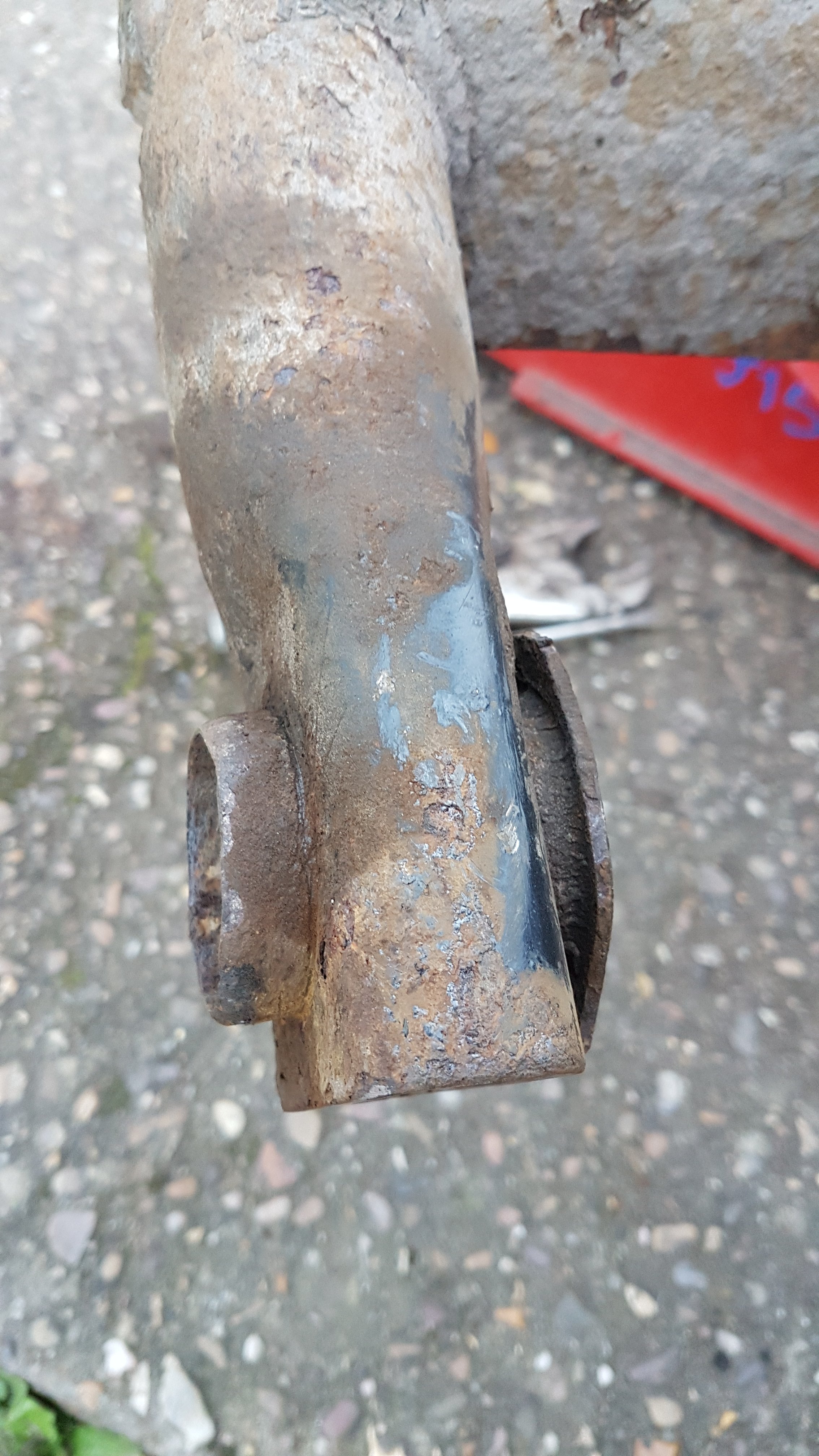

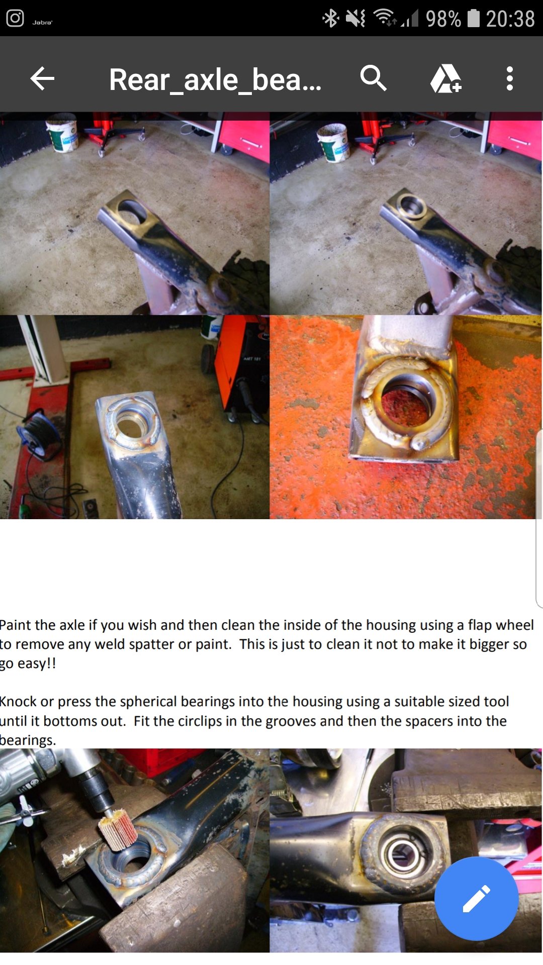

Bush carrier came out easier than expected and the plan was to fit strongflex bushes to match the fronts but I've just found a bearing conversion that's got me interested :)
Stereo has gone. Replaced with a cubby hole as there's next to no storage now it's stripped :D

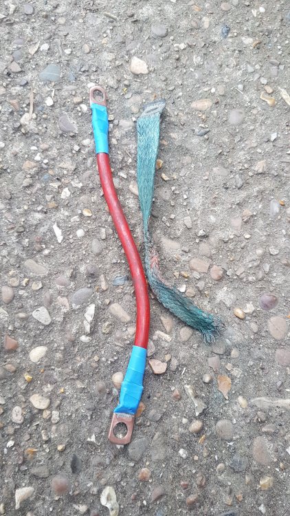

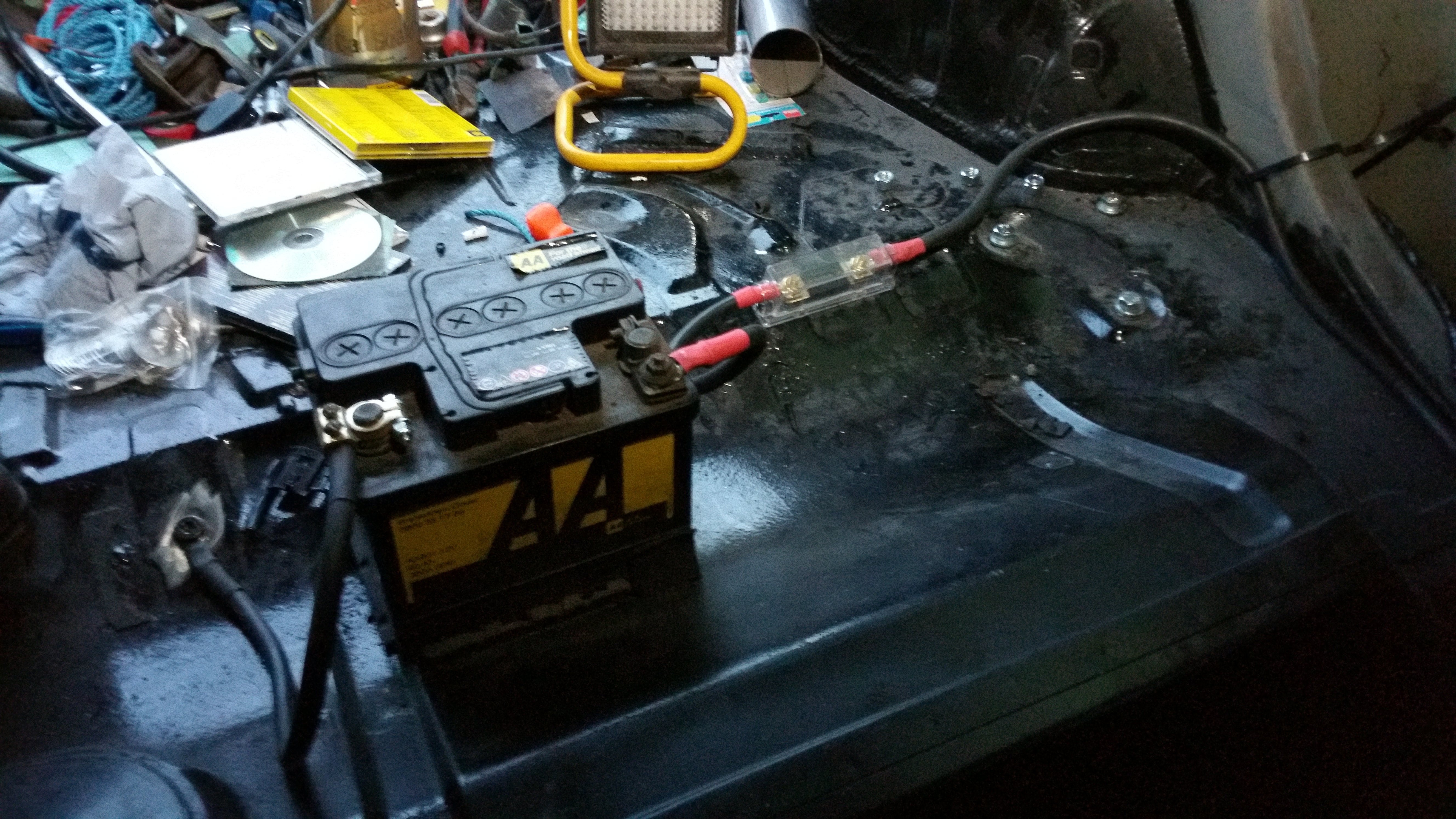

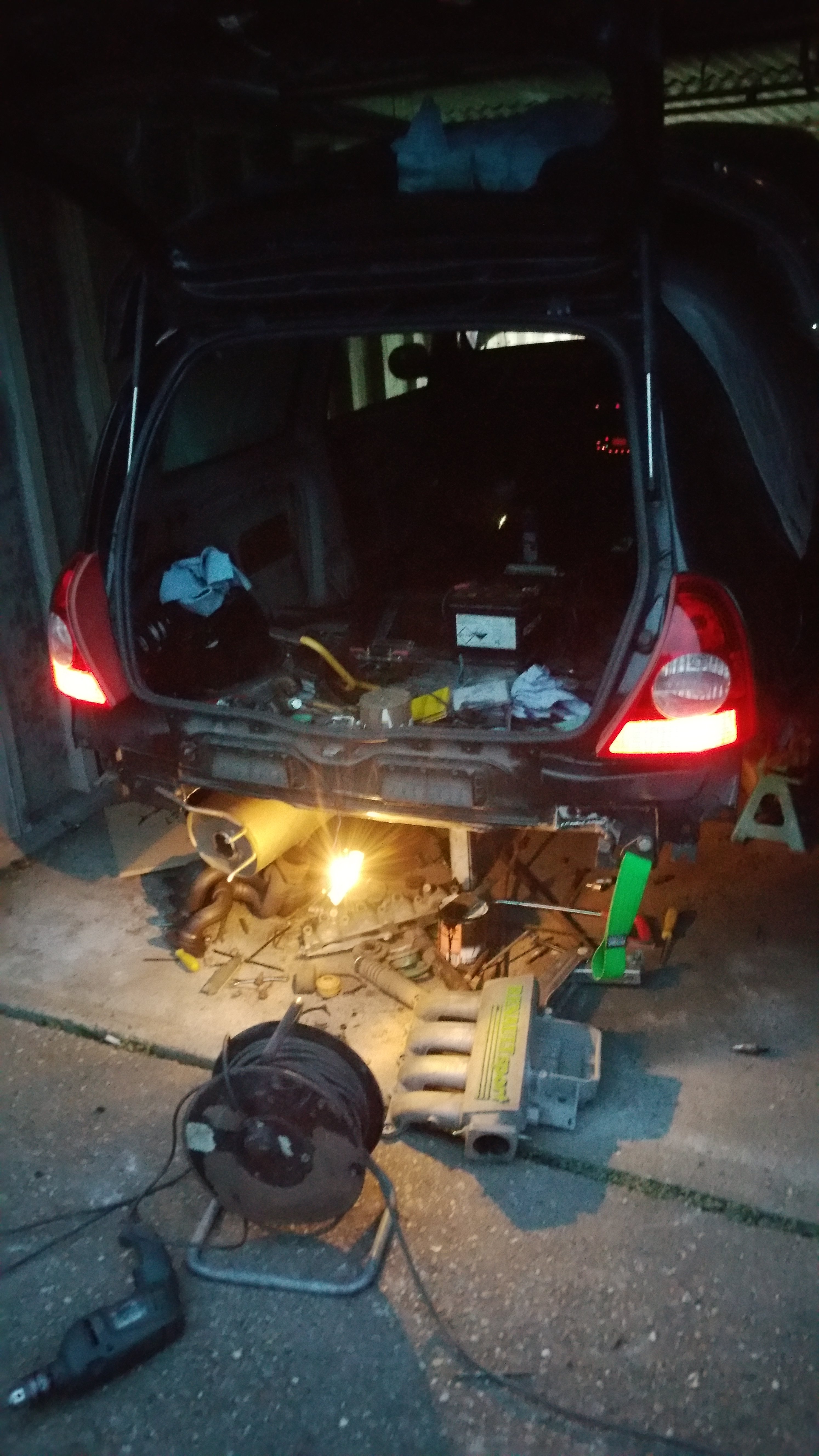

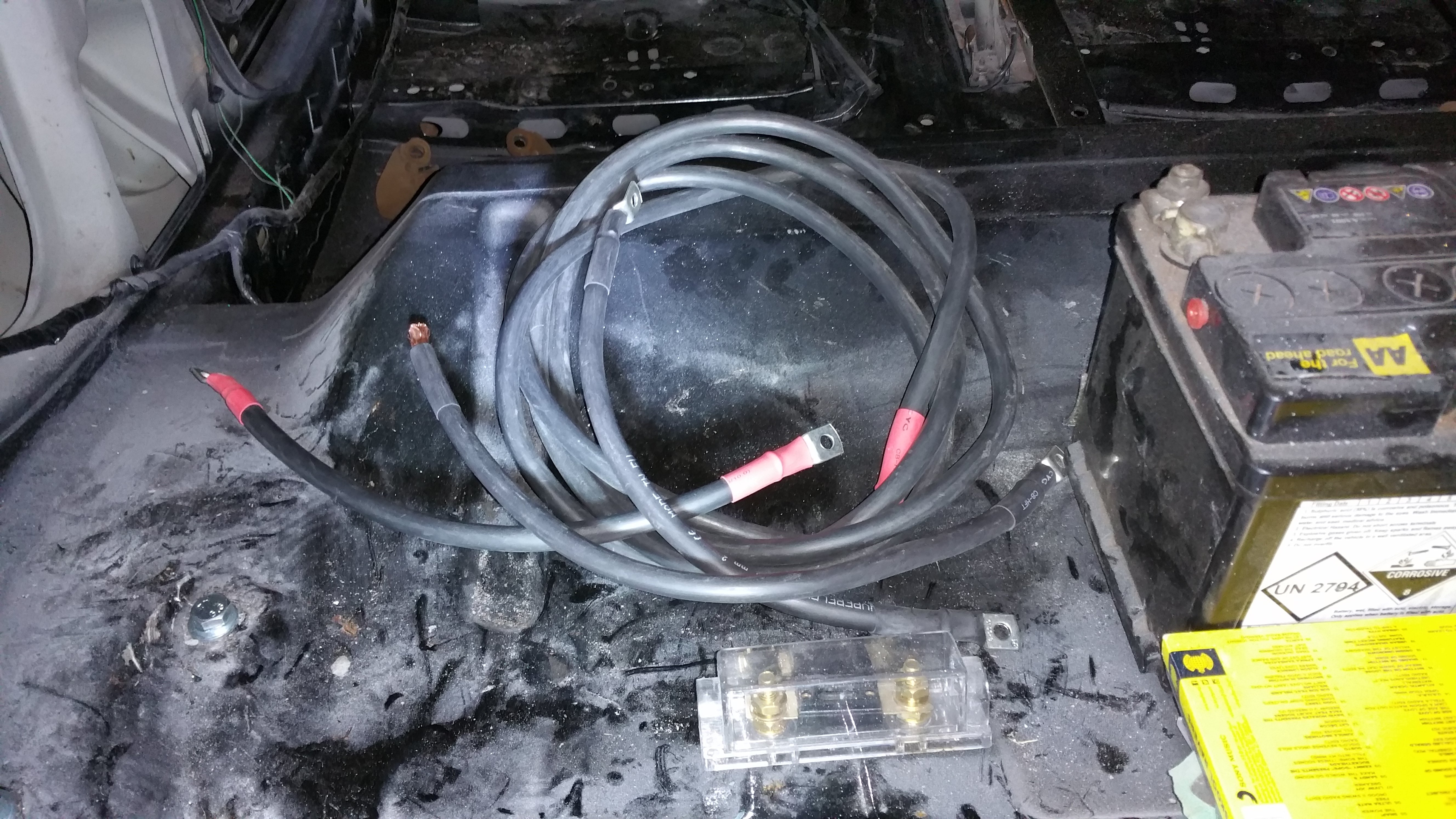

Wiring for the battery relocation turned up and is in.
0 gauge (50mm2)

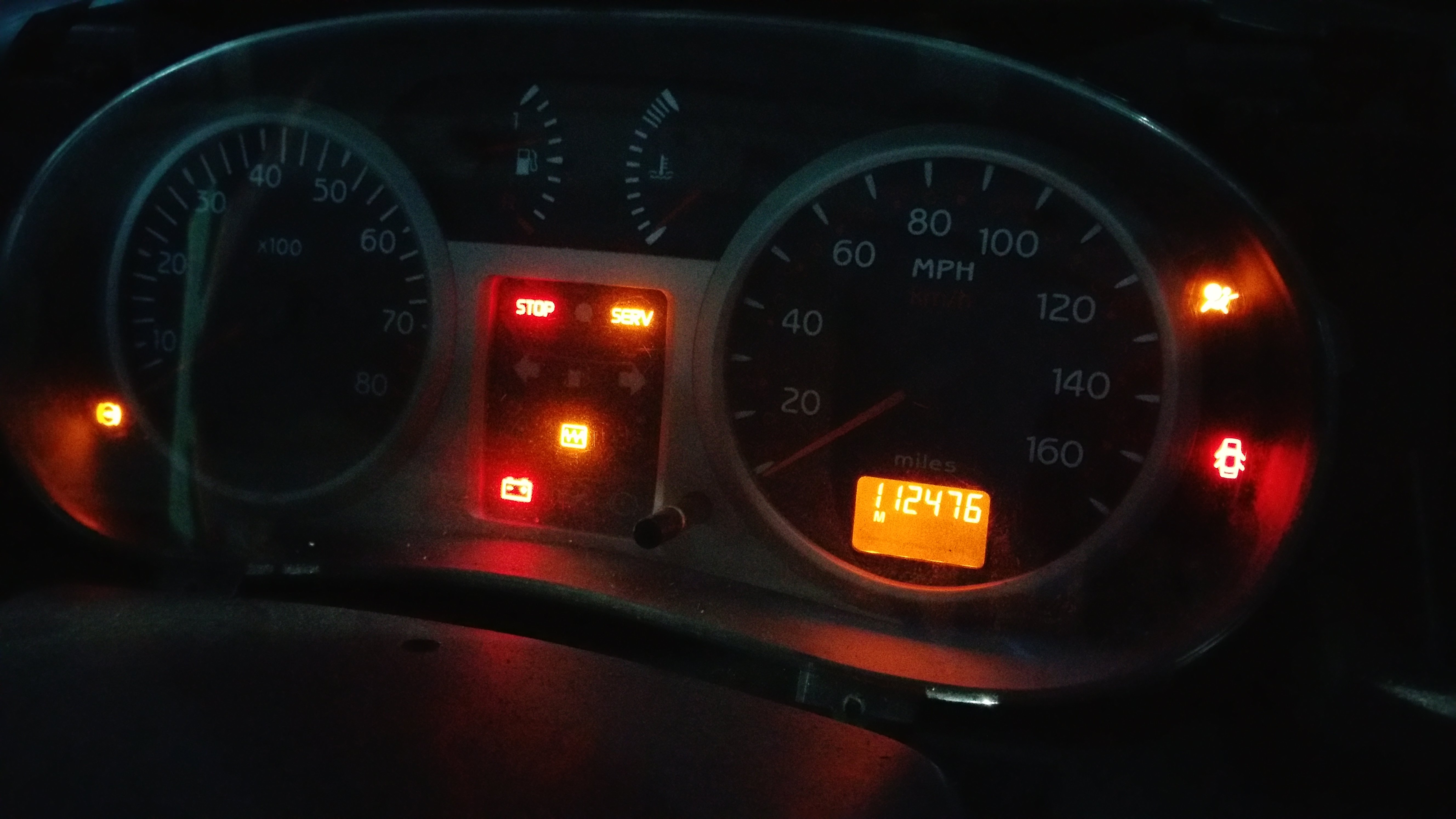

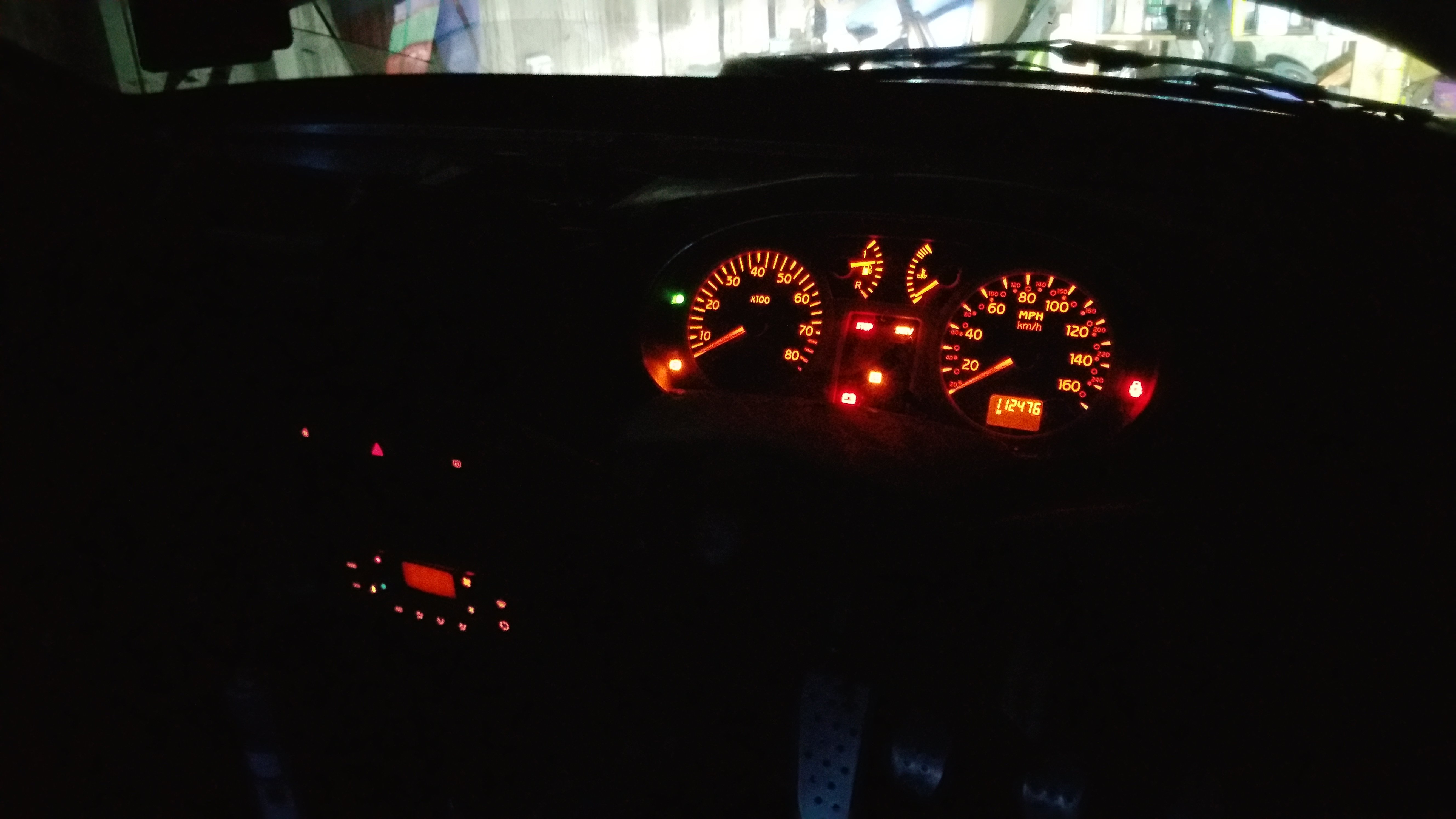

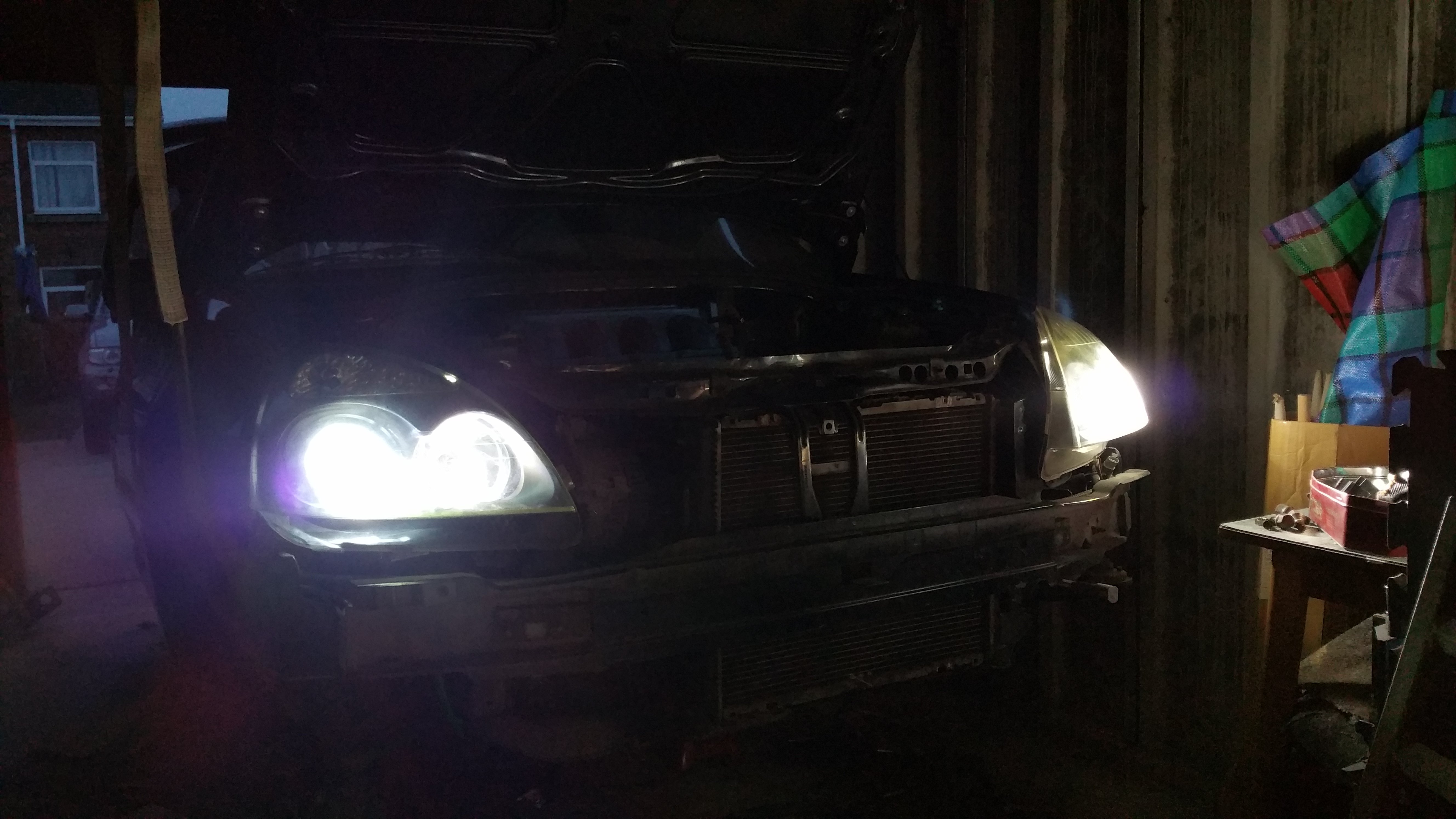

We have lights!
All scanned and no fault codes apparently :)

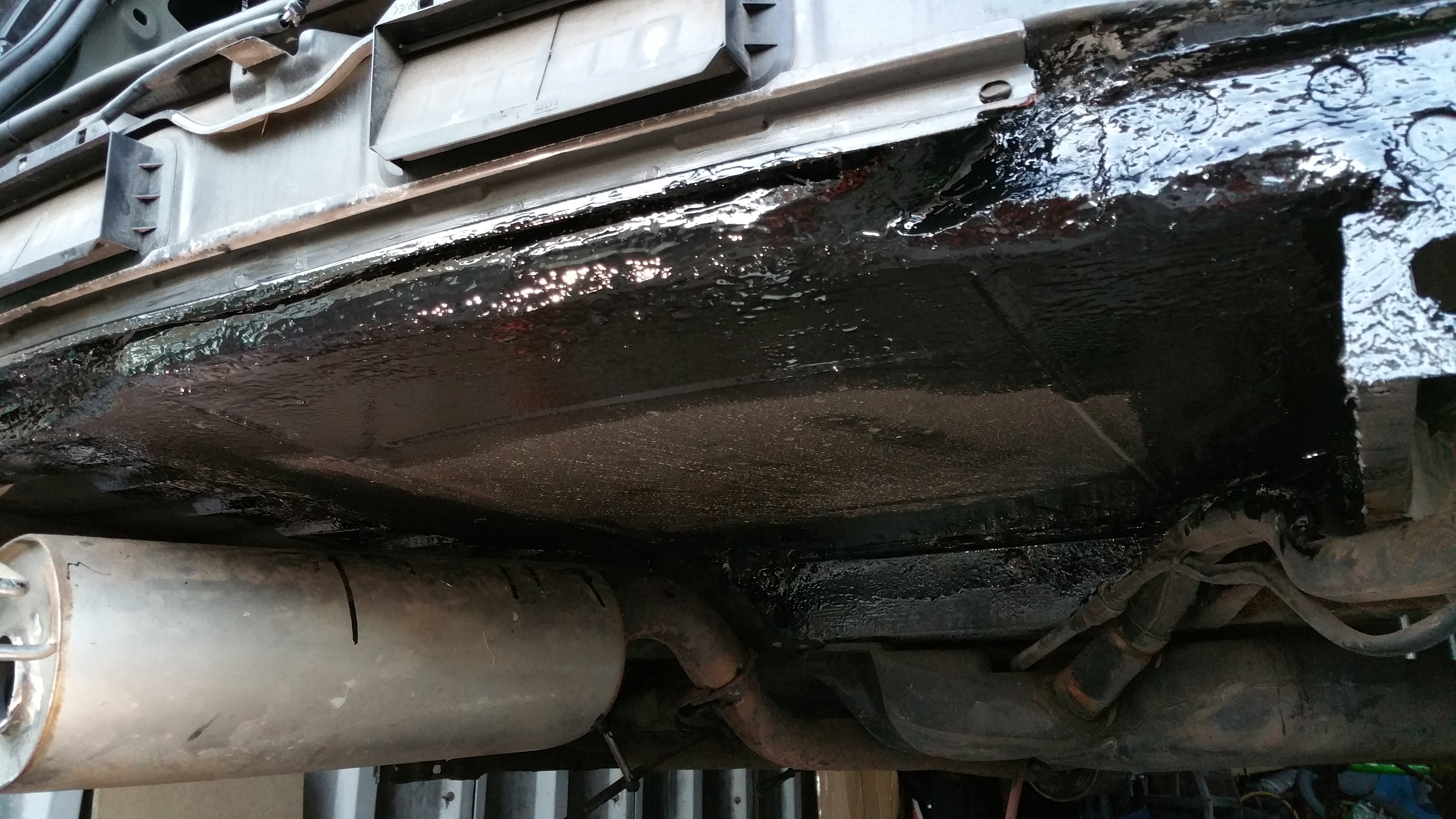

Went over the boot floor again using proper seam sealer this time, had a little leak from somewhere so this should cure it :)

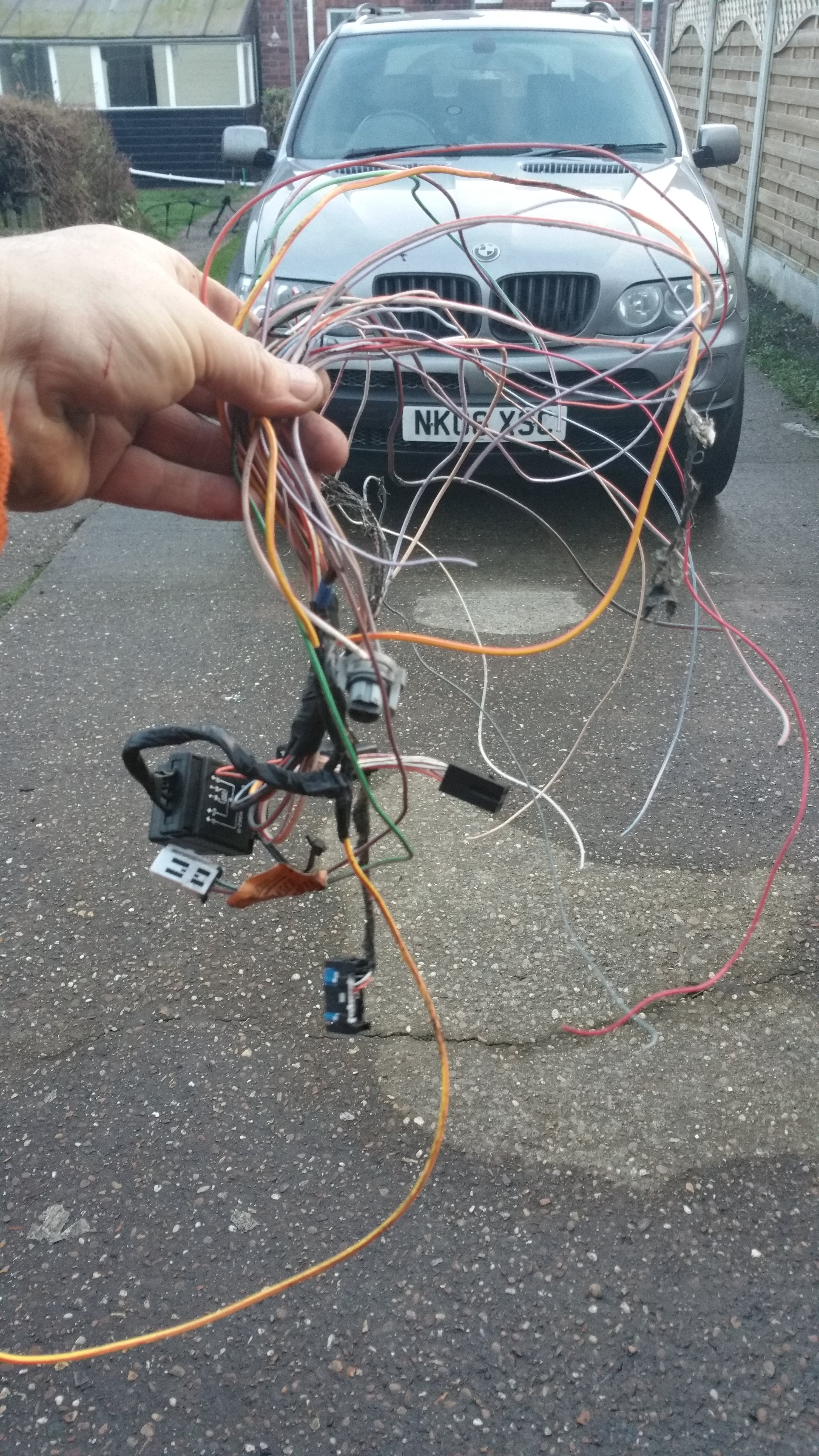

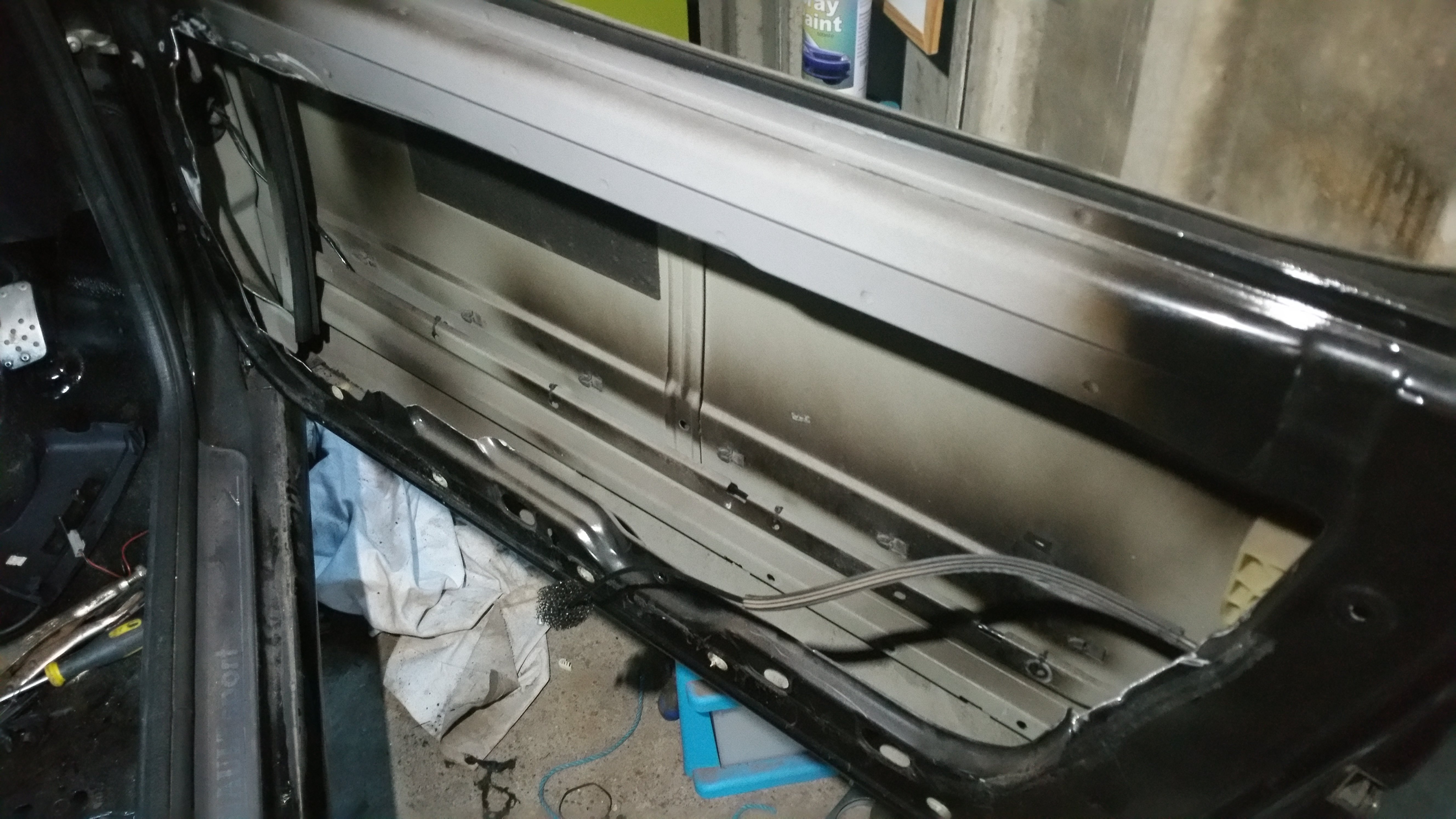

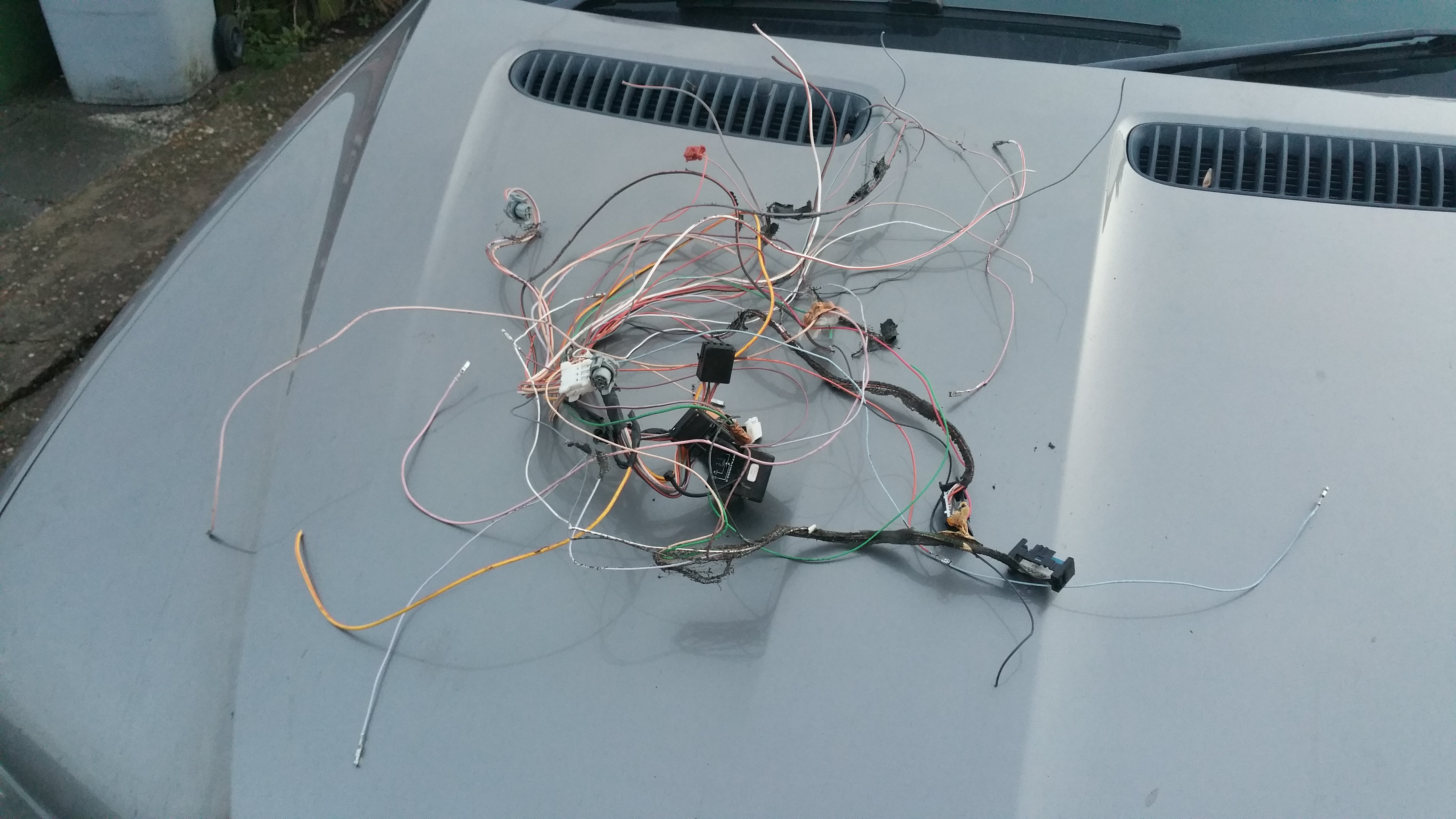

Lost some more weight and left me some more wiring to trim/sort.
Edited by SNH

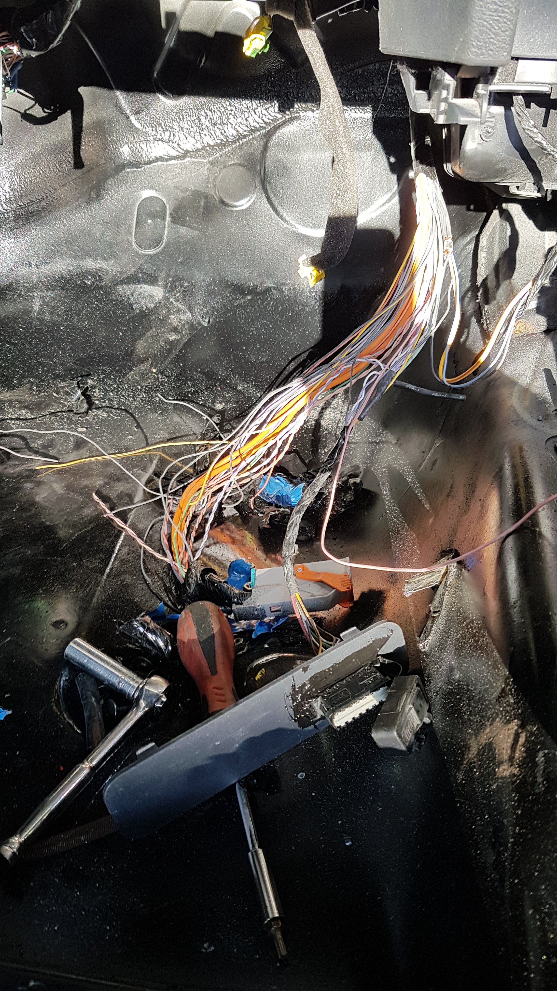

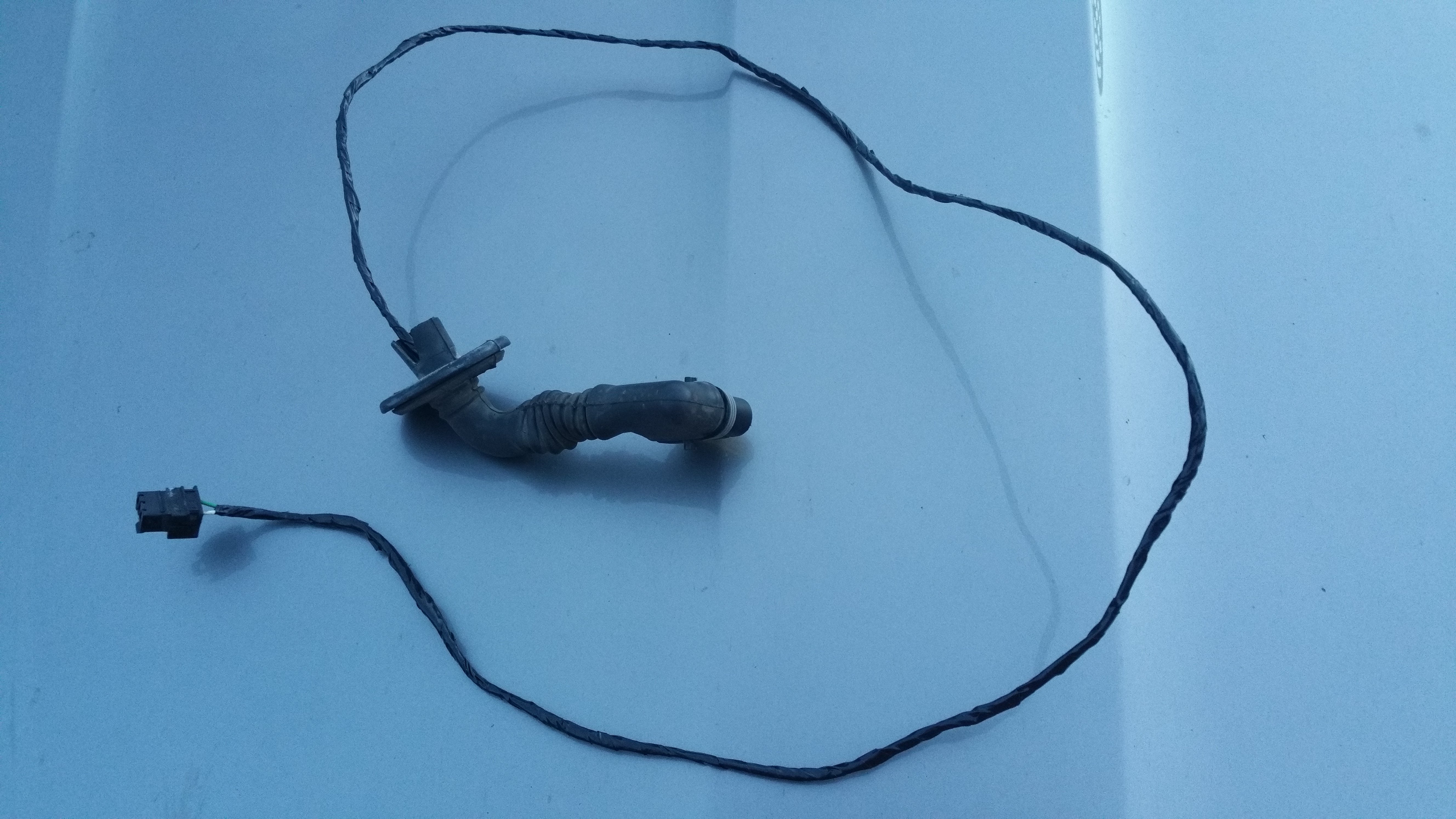

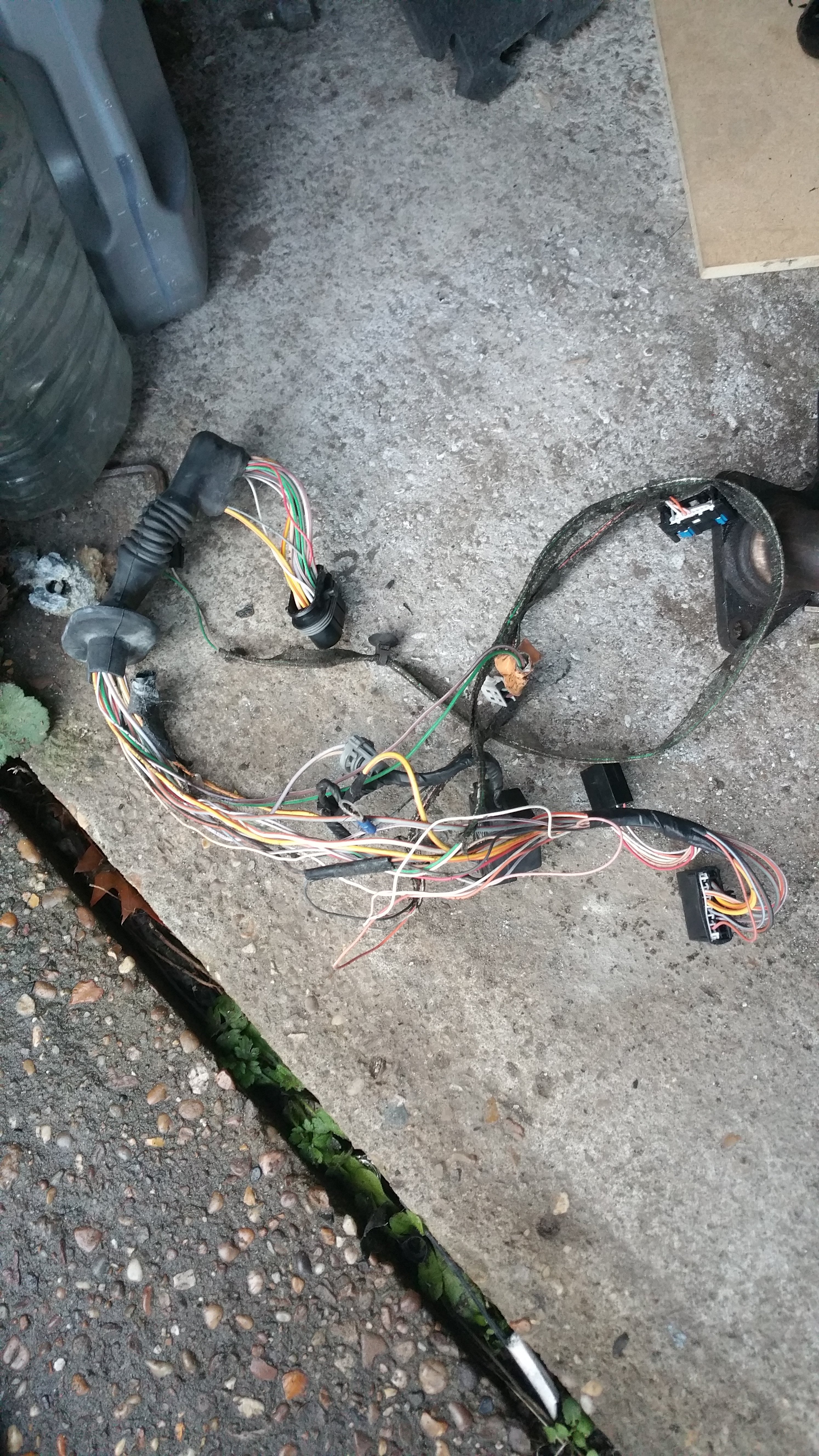

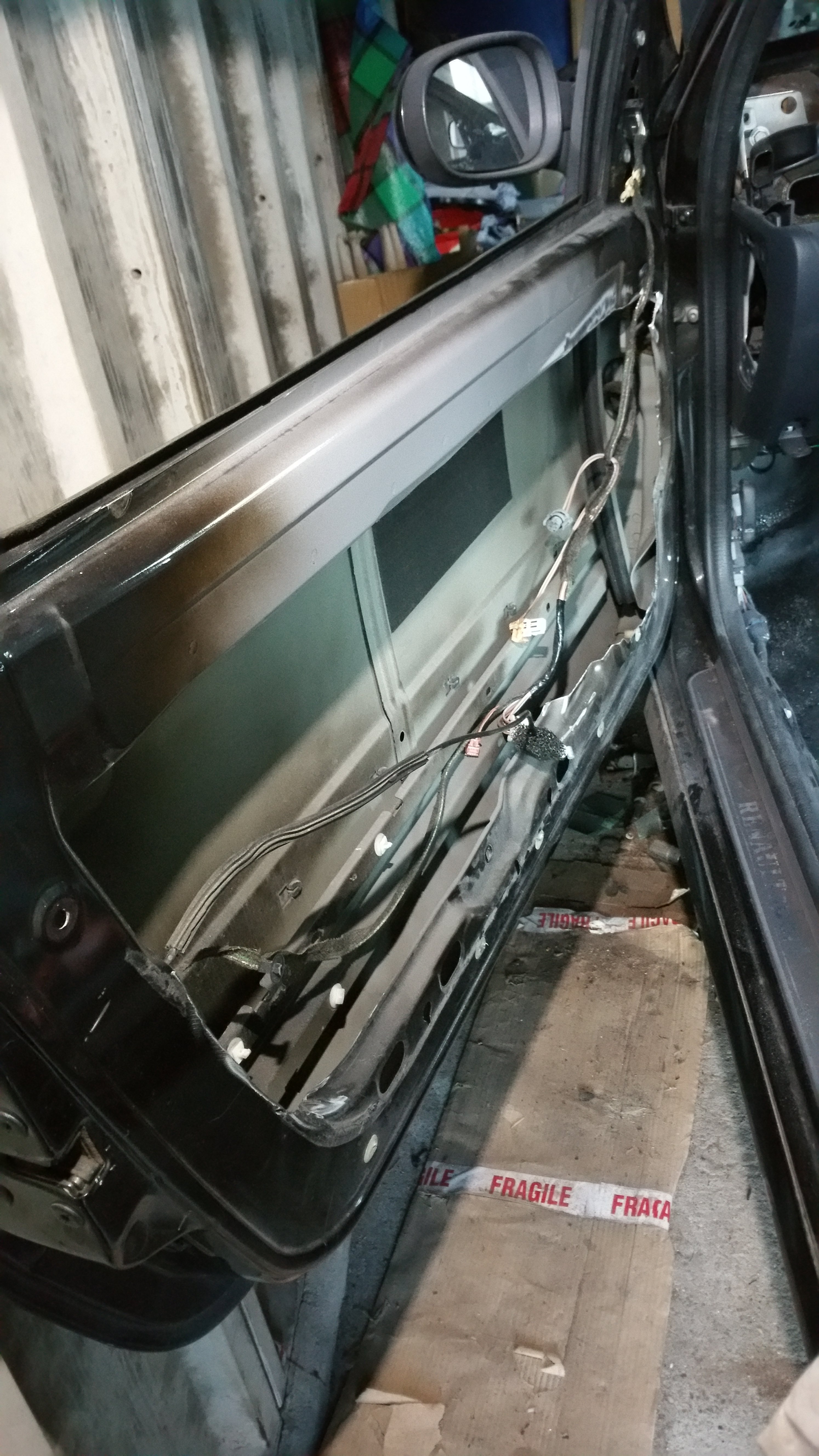

Sorted the door loom wiring :)
