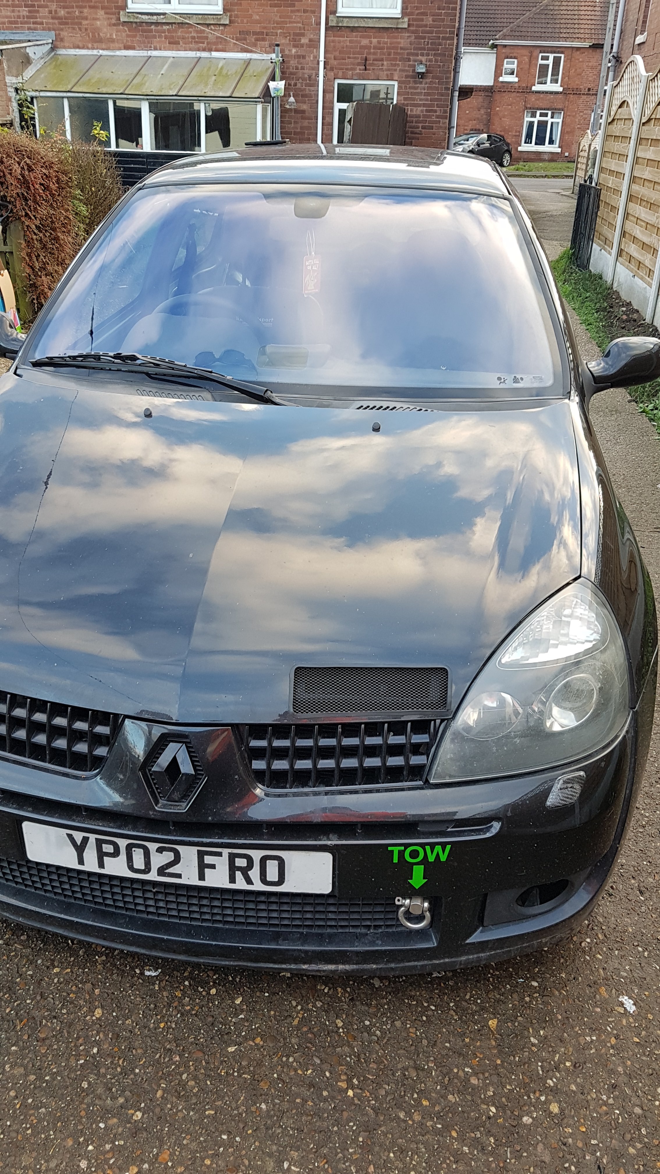

Can i make a suggestion about your bonnet vent?
Take the rubber off, and start it again in the centre of the bottom edge. That way it will have 4 nice rounded corners and the joint wont be as obvious ;)
Its on solid that, it wasnt quite long enough which is why its in one corner.
Its coming off the road for winter so i may get hold of a longer piece and redo it if it'll come off.

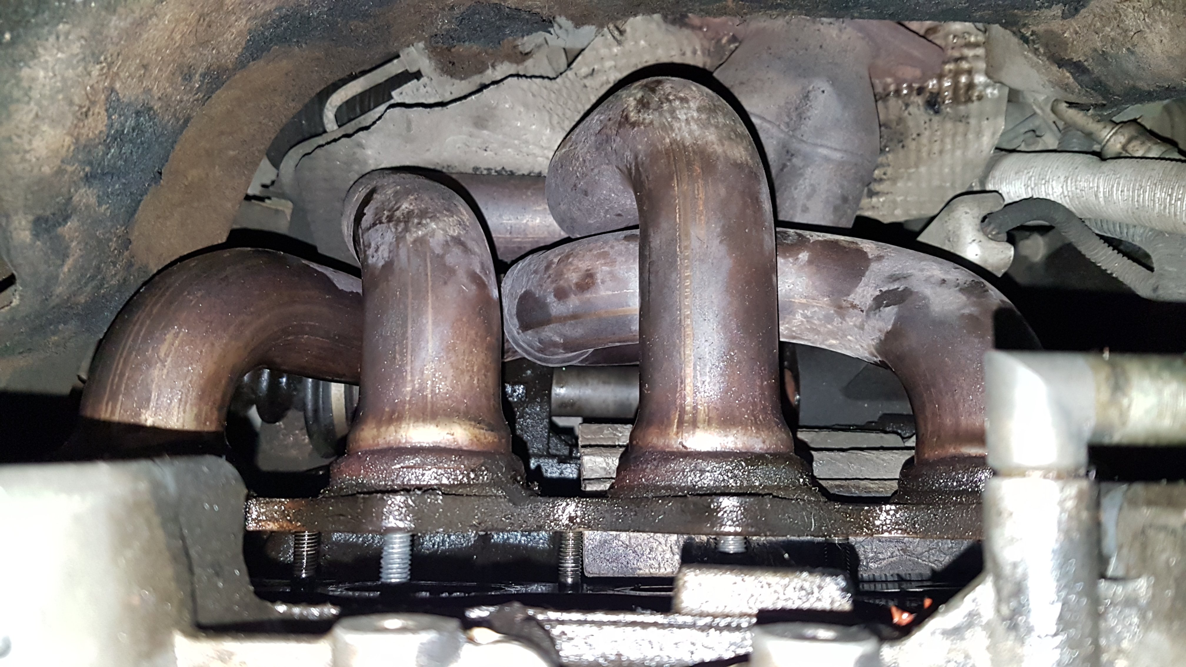

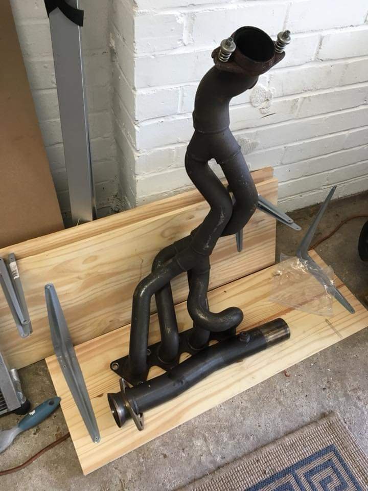

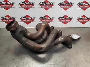

Standard manifold off and swapped for the better 182 one, not looking forward to this as its a subframe drop to get at it :D

182 manifold and link pipe sorted just need to find time to collect from coventry.
Being 4-2-1 is a bit more midrange grunt which should give better driveability on track compared to the standard 4-1 of the 172

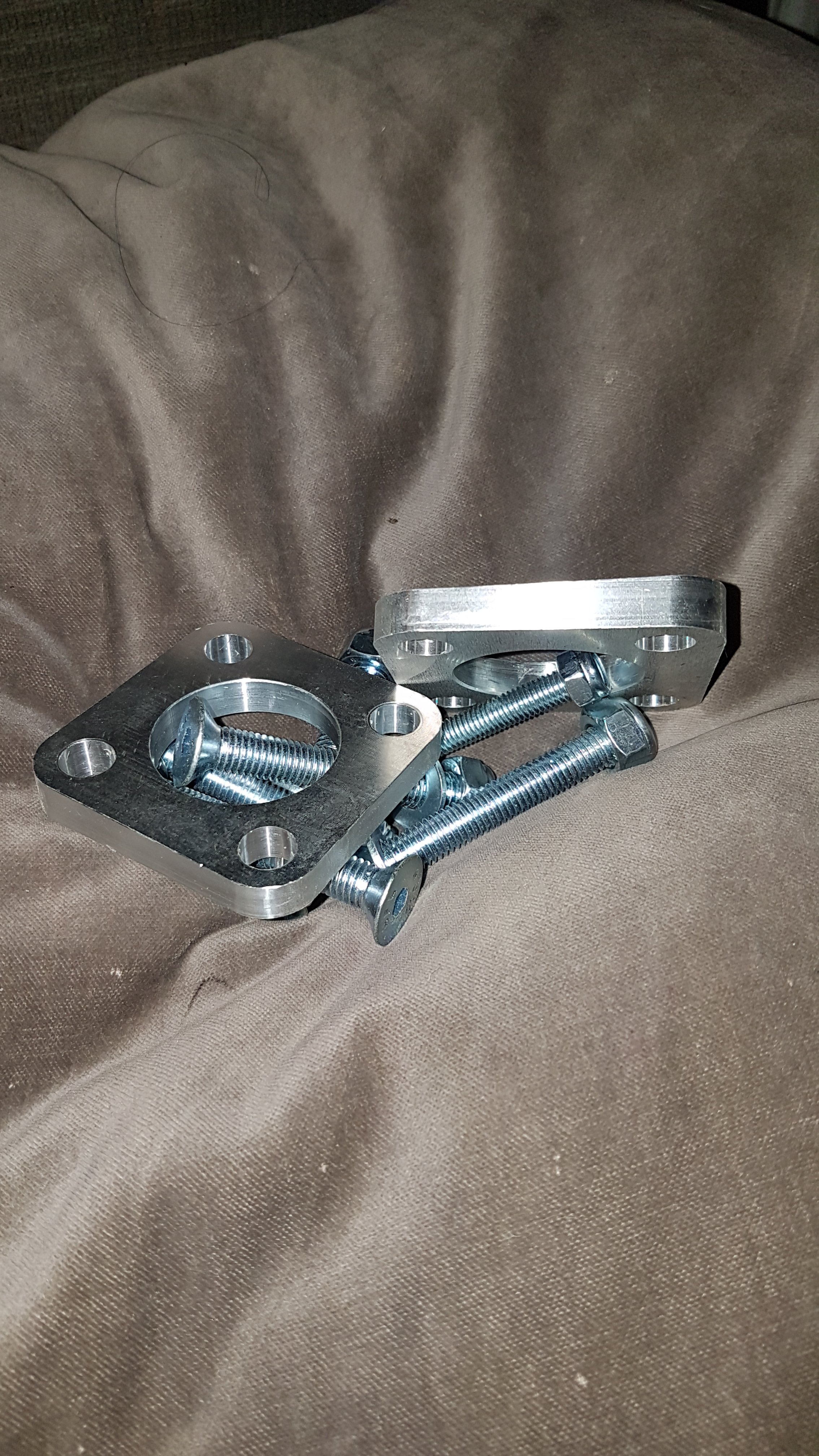

Let the slippery slope begin :D

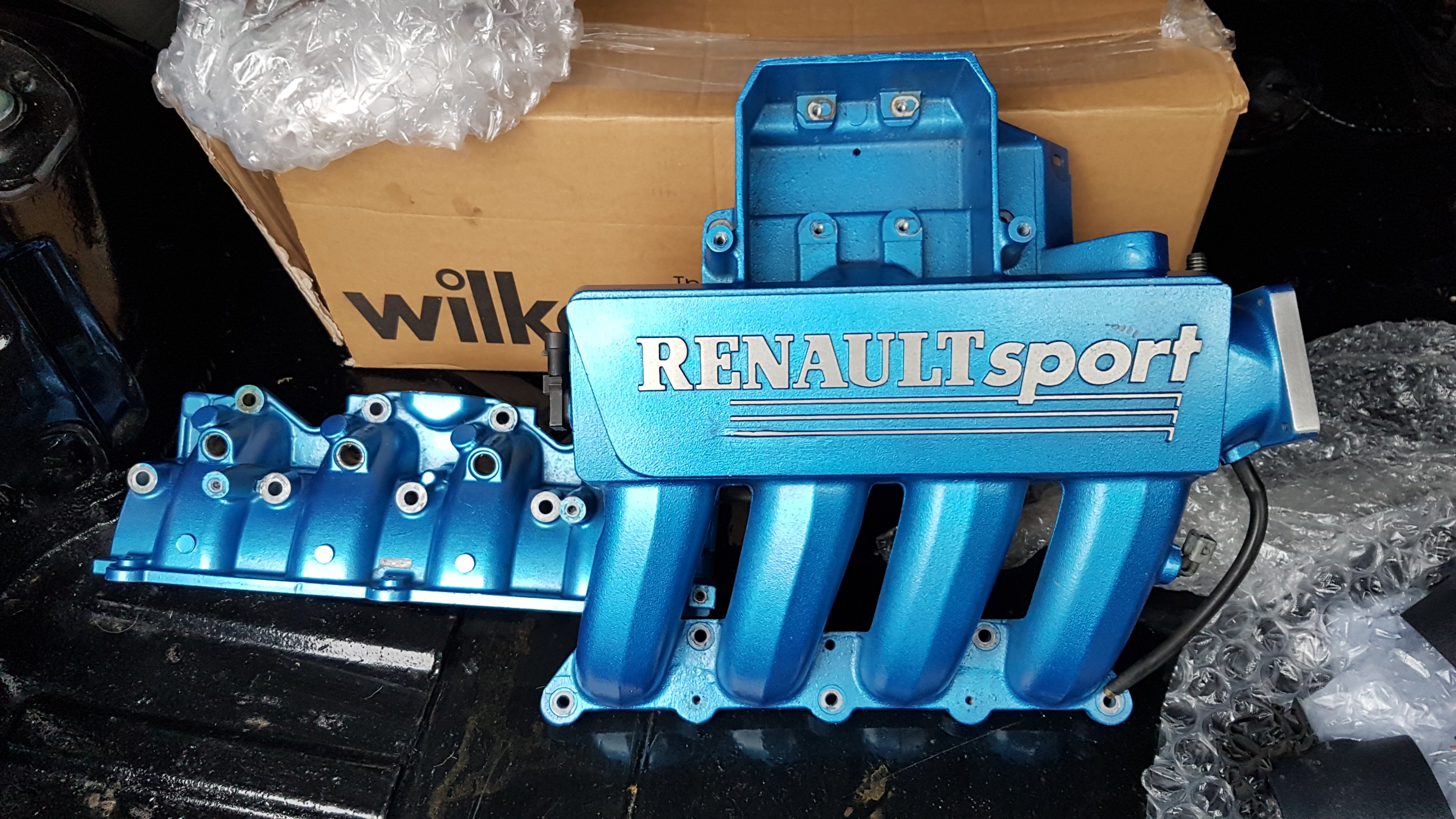

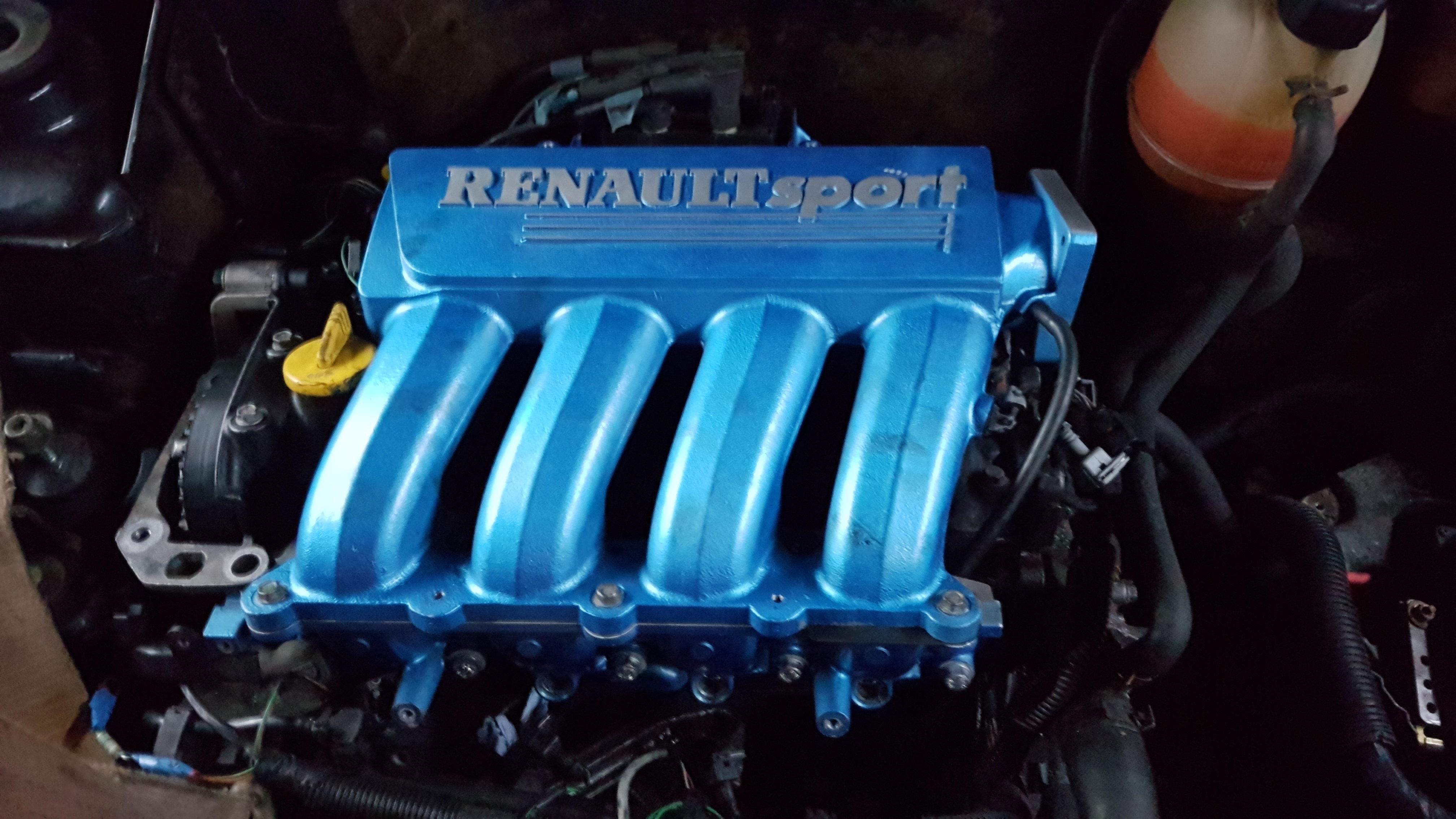

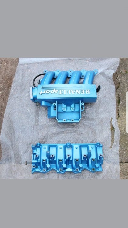

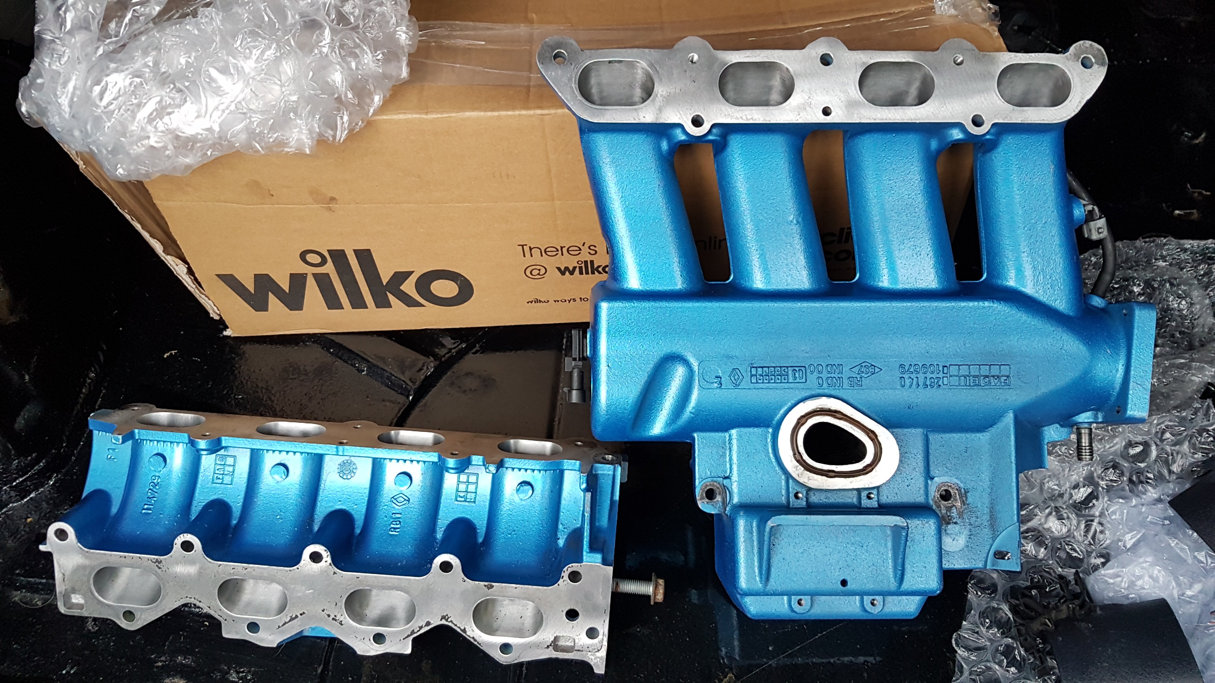

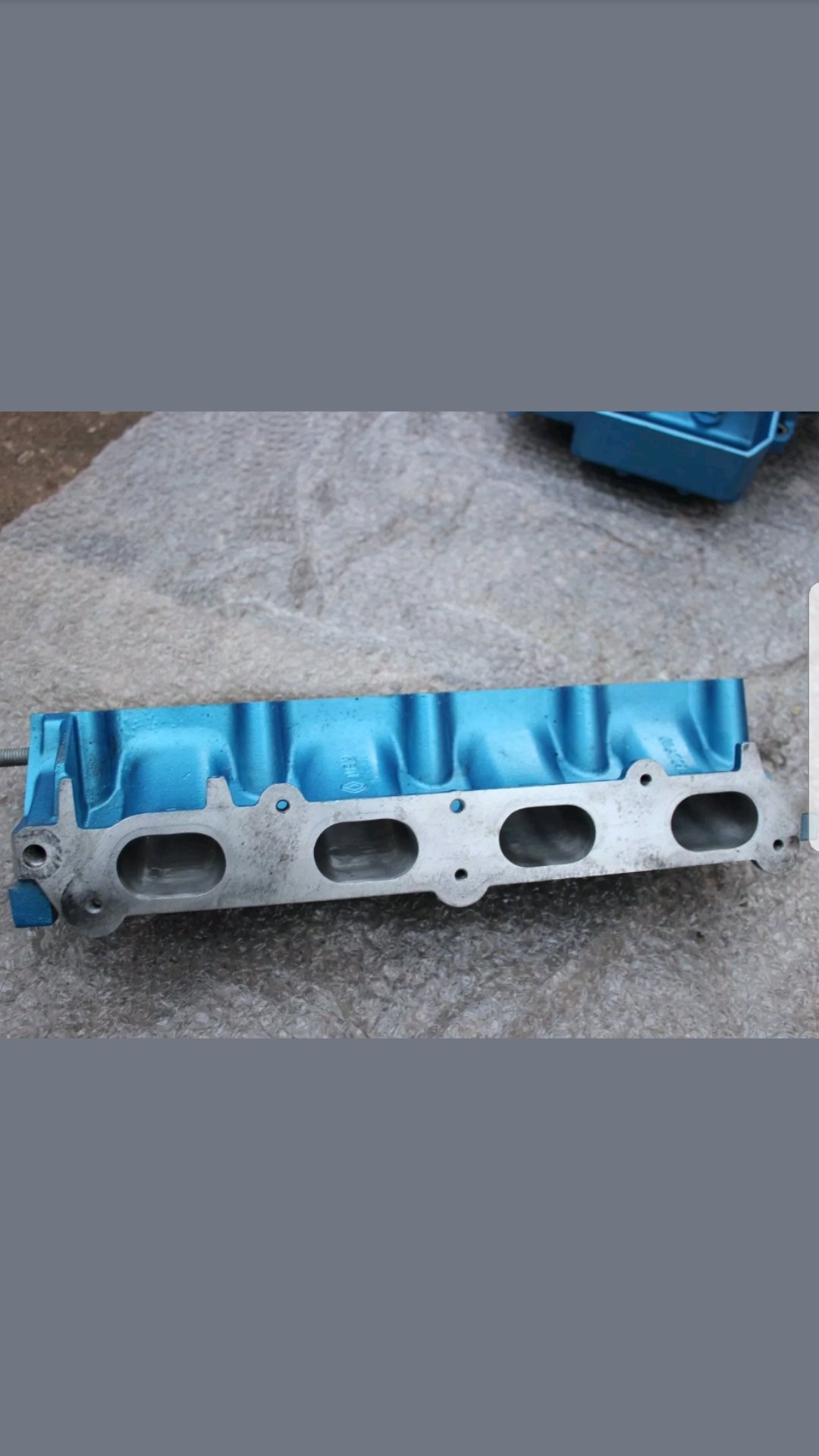

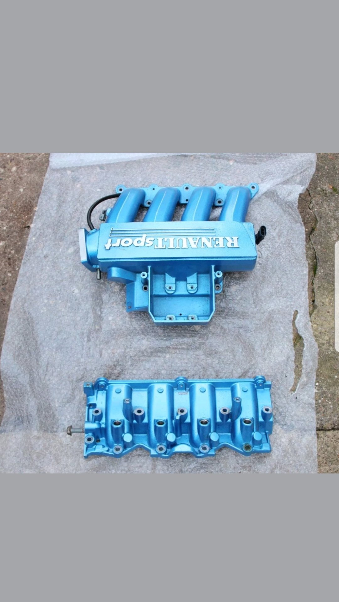

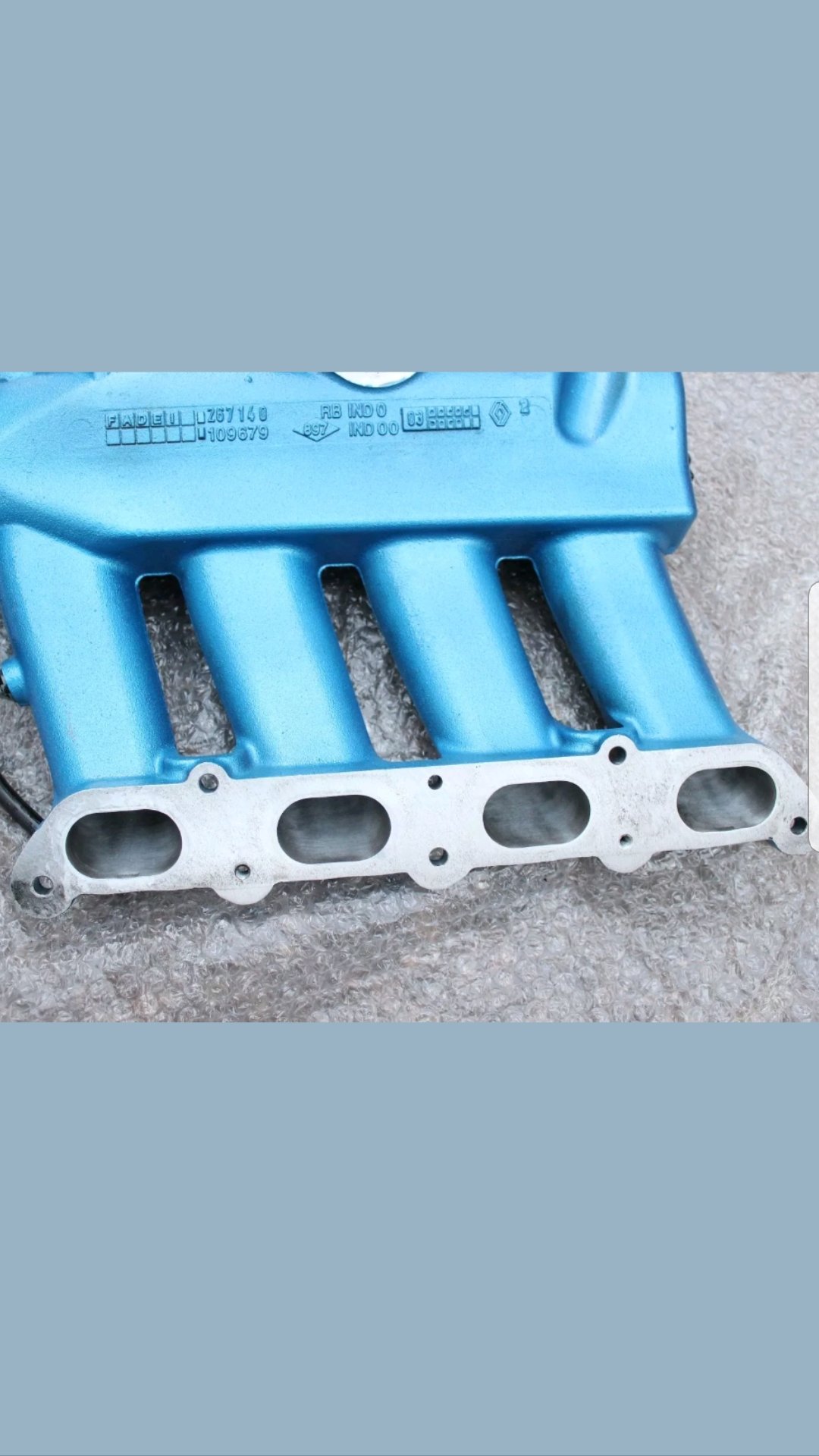

Bagged a bargain this morning, port matched upper and lower inlets :)
Shame about the colour but for £45 the pair I'm definitely not complaining. Saved me over £150 by the time I'd posted mine out.
And collected.
Just need to send the tb off for englarging to 64mm and flowing.
Similar mods on another 172 made 202bhp and 183lbft. I'll be happy if it can make near that :)
Manifold and link pipe collected.
Now comes the fun part of dropping the subframe :(

Exhaust manifold collected, gasket set ordered.

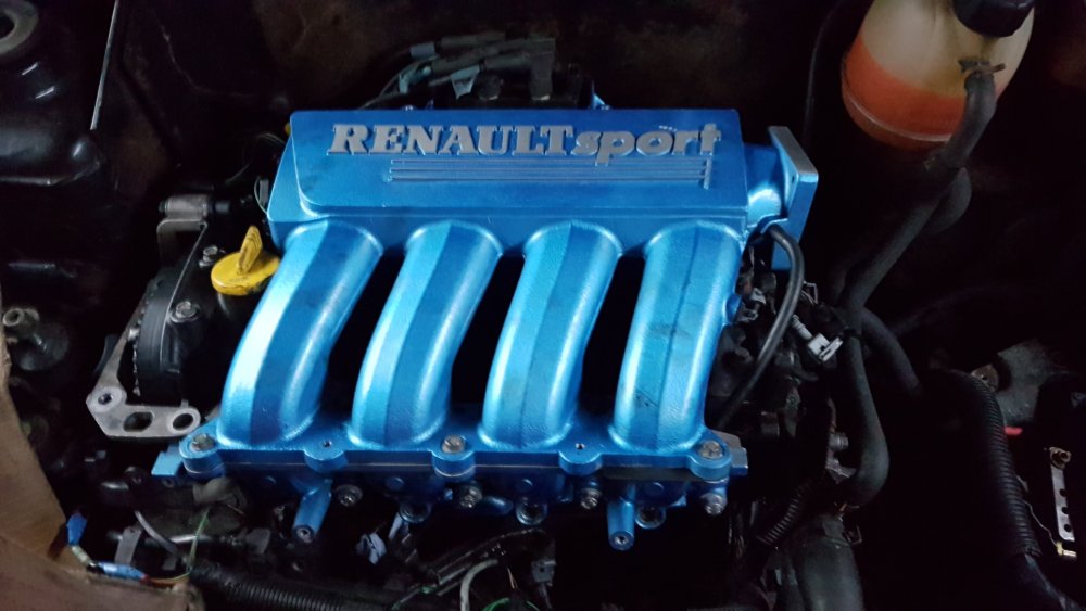

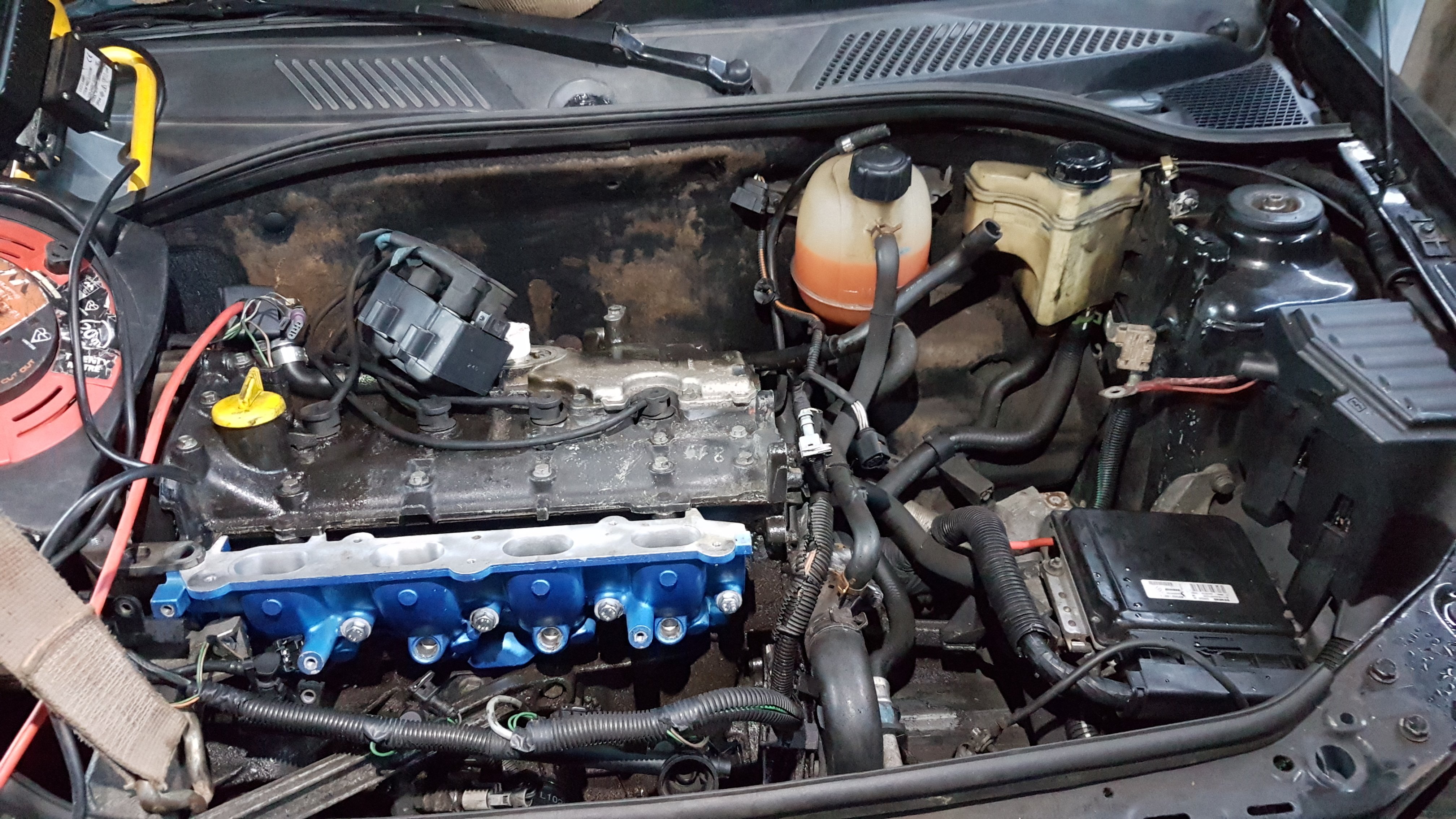

Lower inlets on now I've sourced some bolts that seemed to be missing.

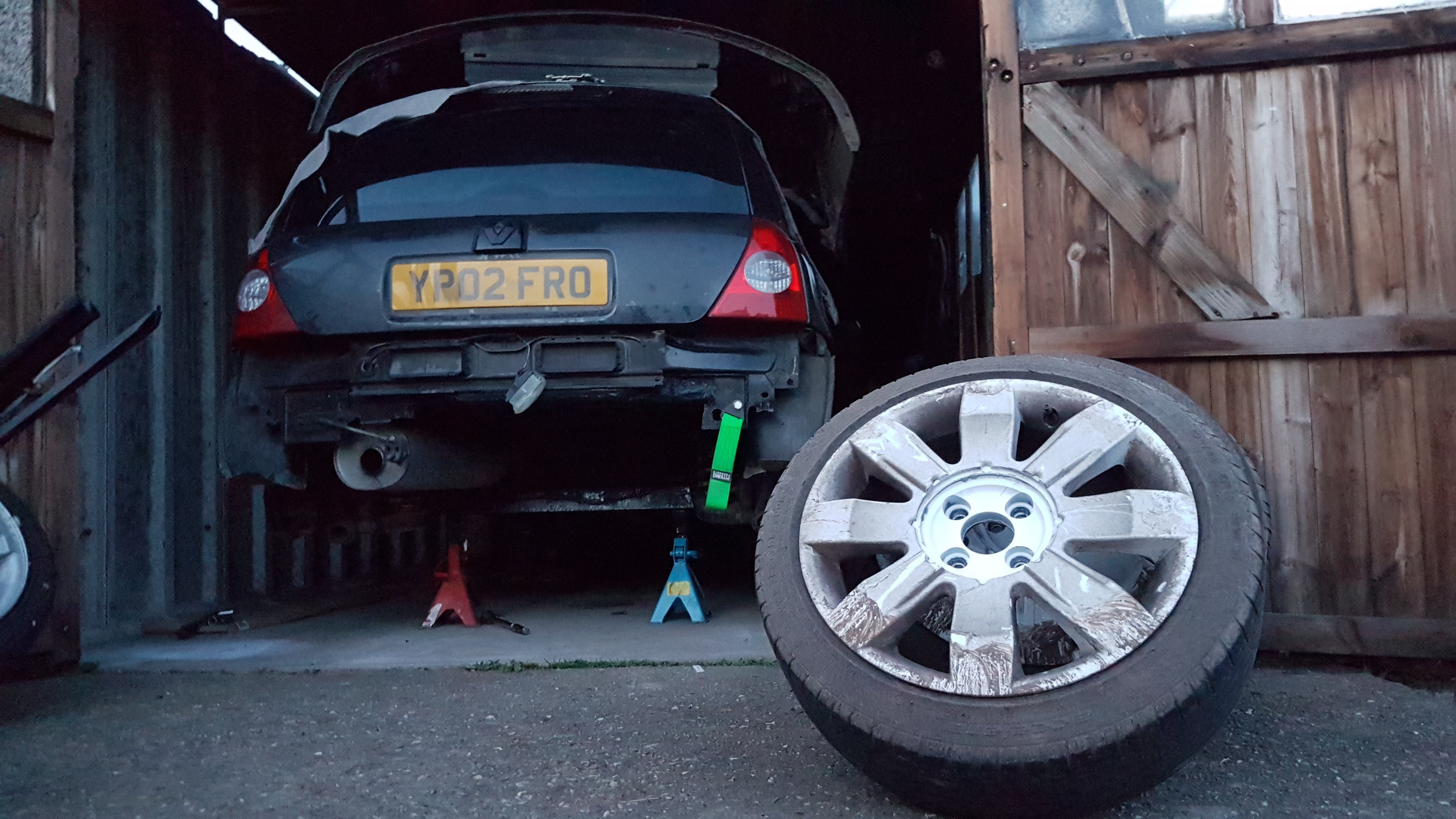

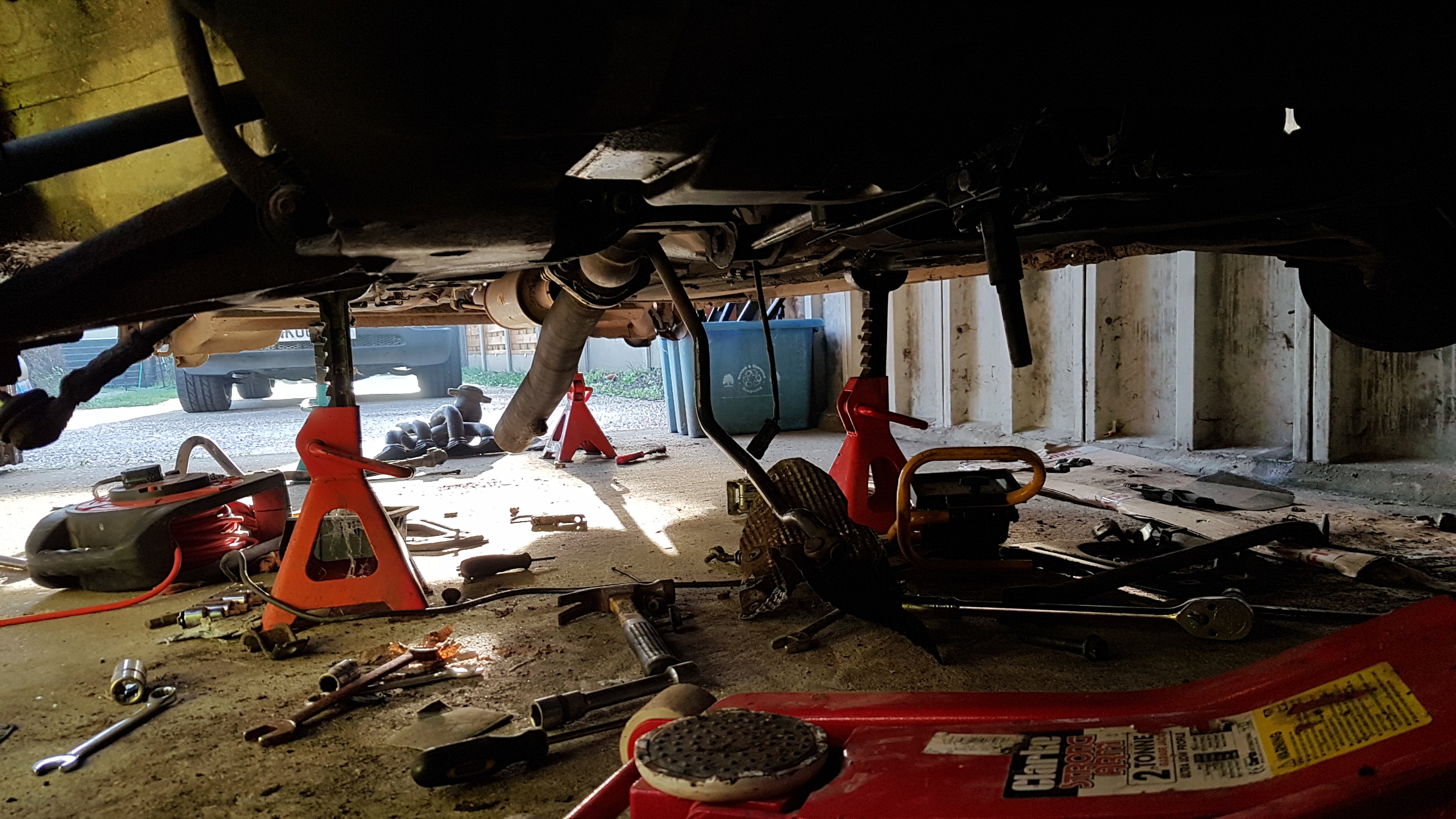

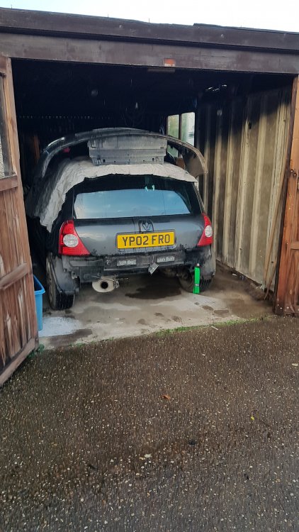

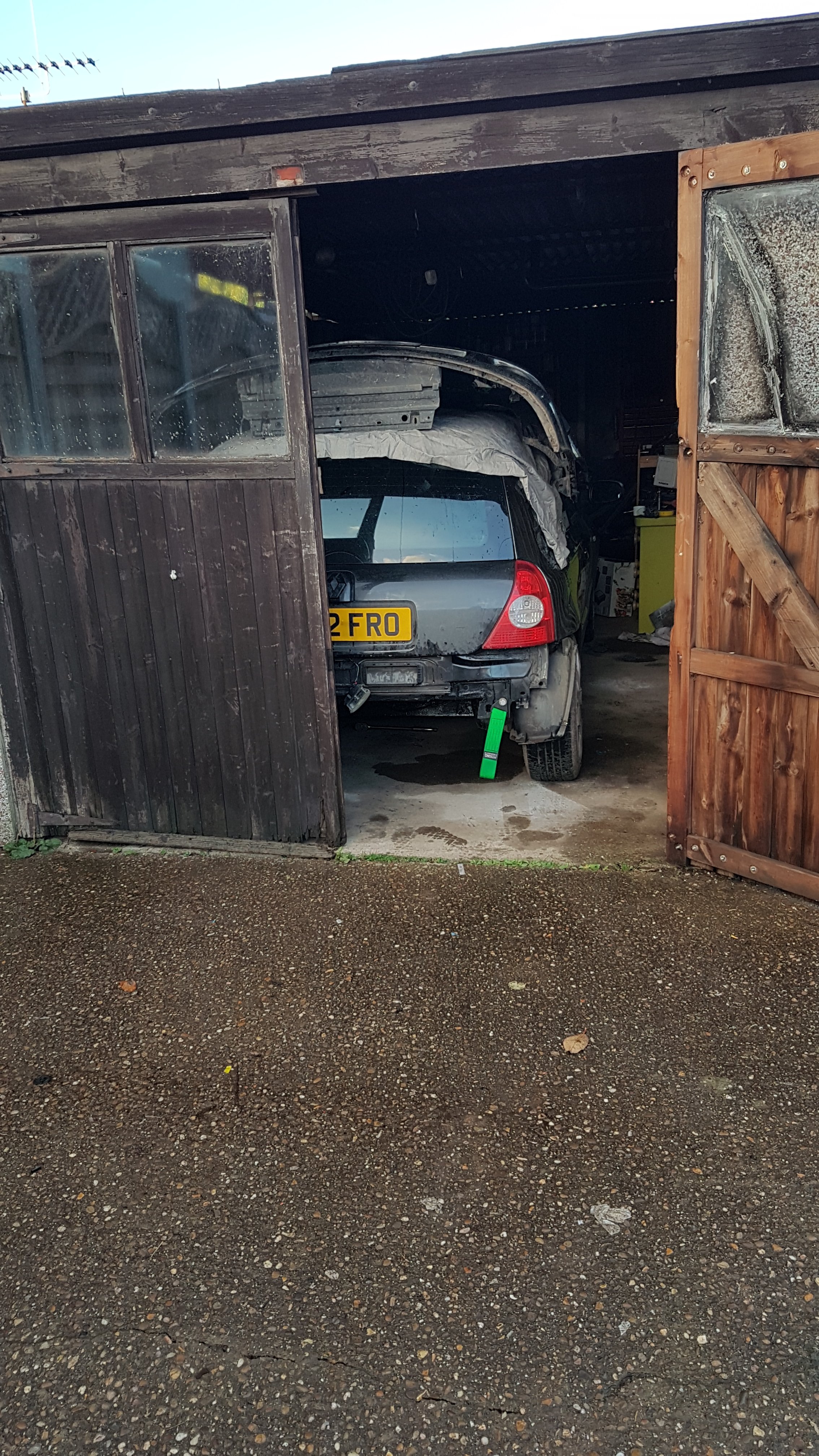

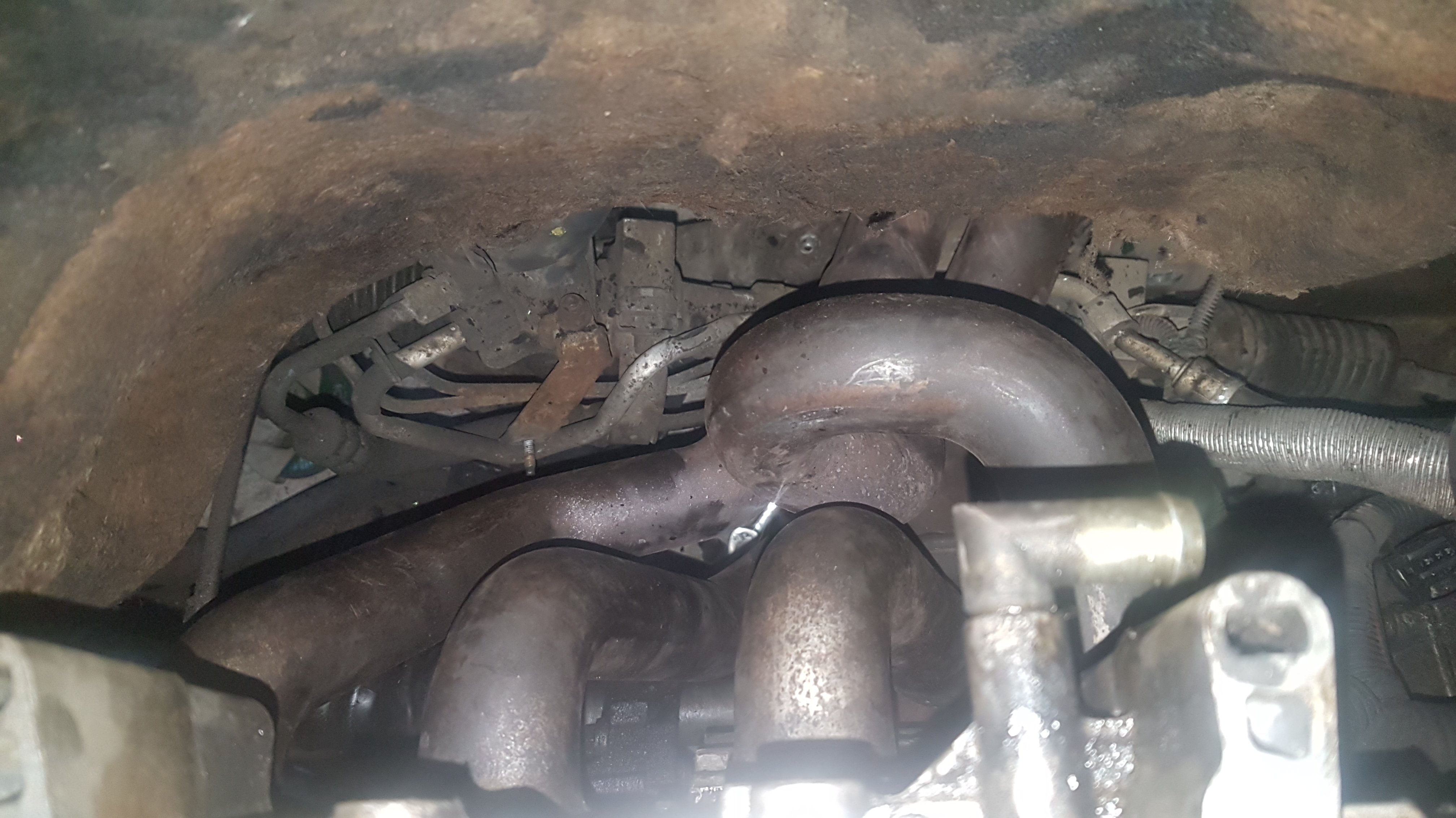

Day 1 (yesterday) of dropping the subframe to fit the manifold..........stupid idea should've just bought a decat :D
Absolute mare of a job, bolts snapped, sheered, rusted and basically spinning in places you wouldn't even think to put a nut! :(
Got it dropped a touch (not enough to fit mani) and notice all the arb bushes are shot.....another job to add to the list.
Bruised/swelled knuckles, cuts and temper lost.......shut the doors and walked away, nothing smashed up :D
Round 2 today
Cutting discs are coming out to play!
Have that! :D
New subframe bolts added to the list :)

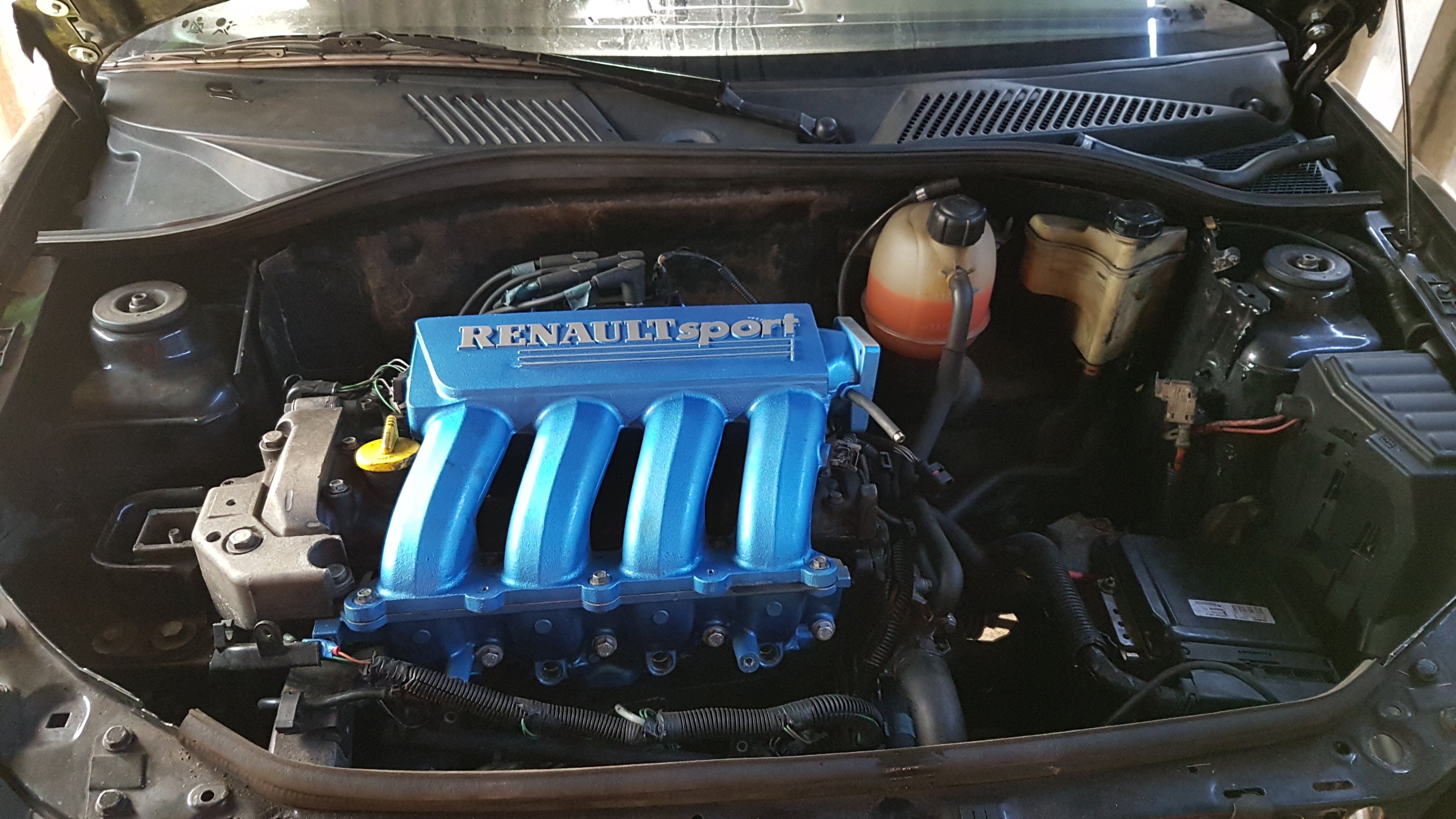

Progress :)

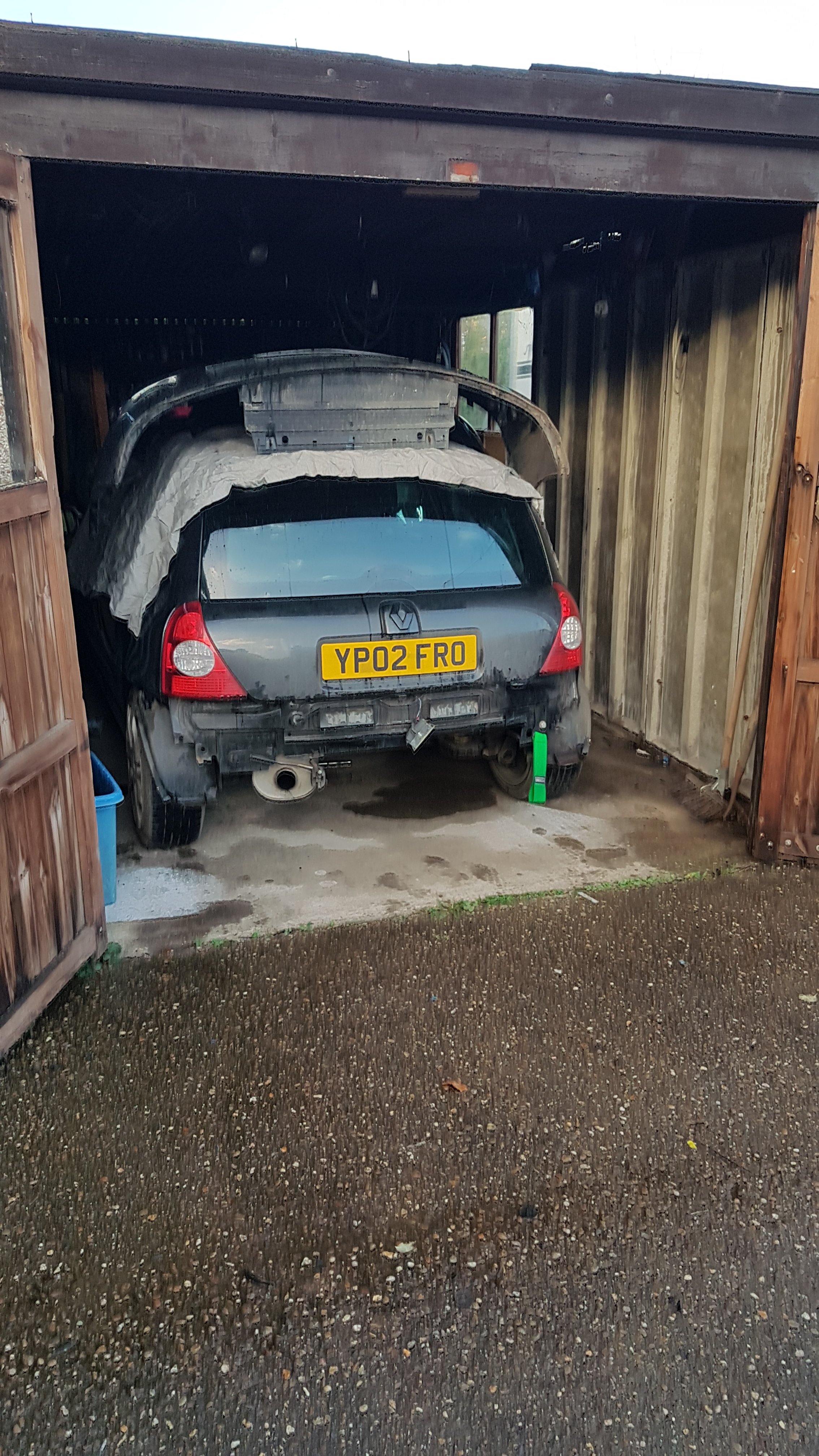

Engines back on its mounts,
Exhaust cut and joiner made to suit.

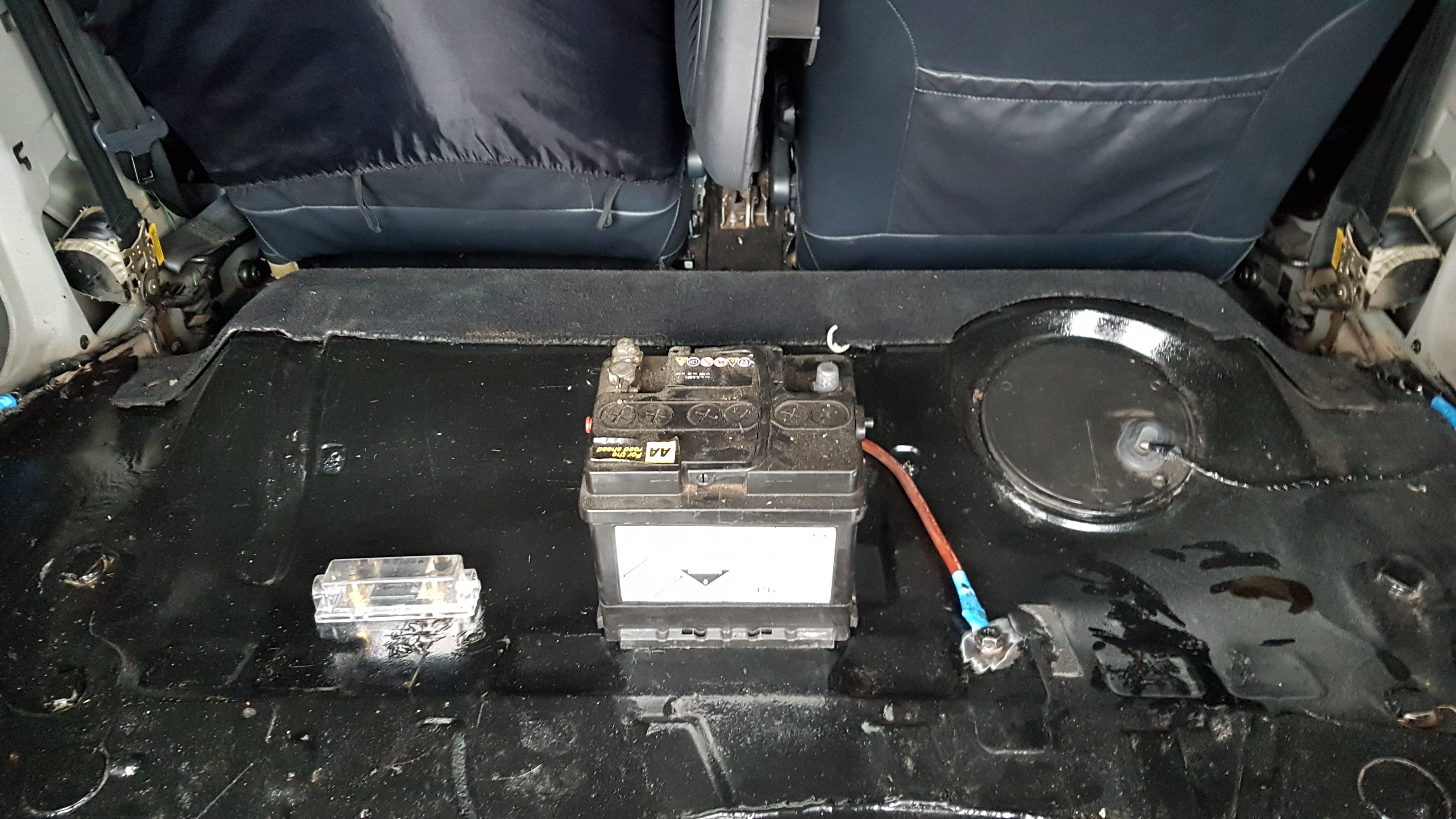

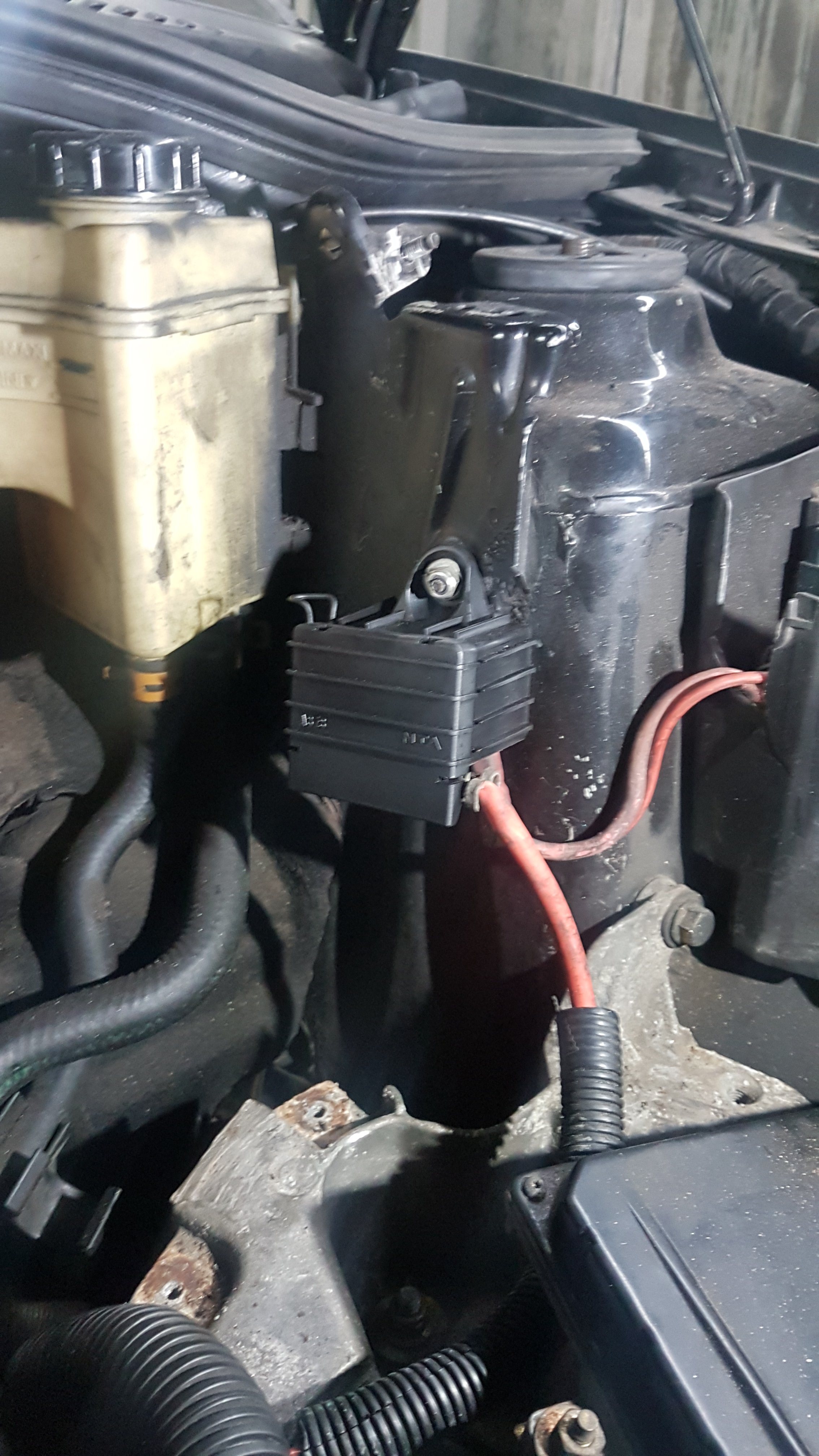

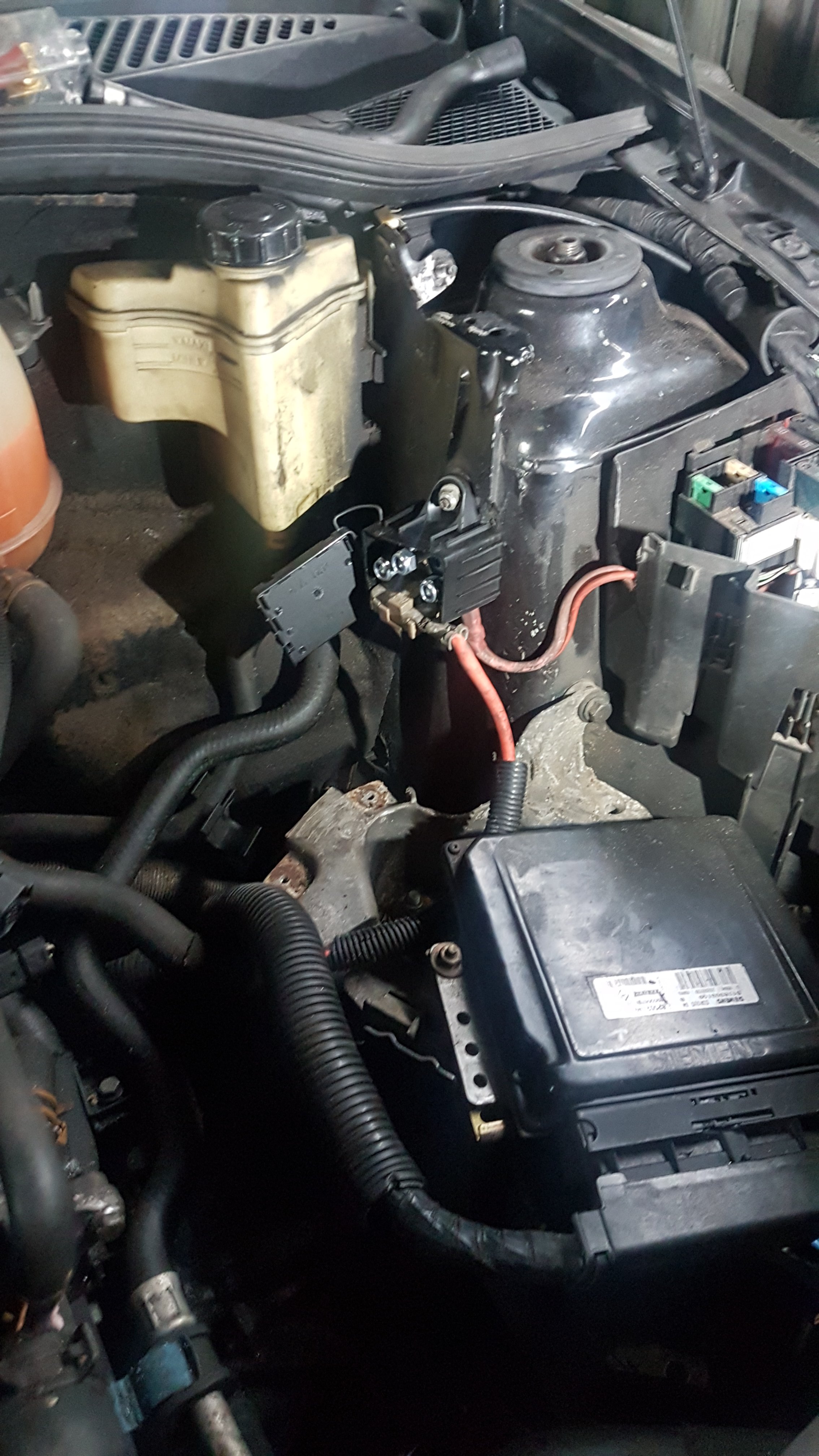

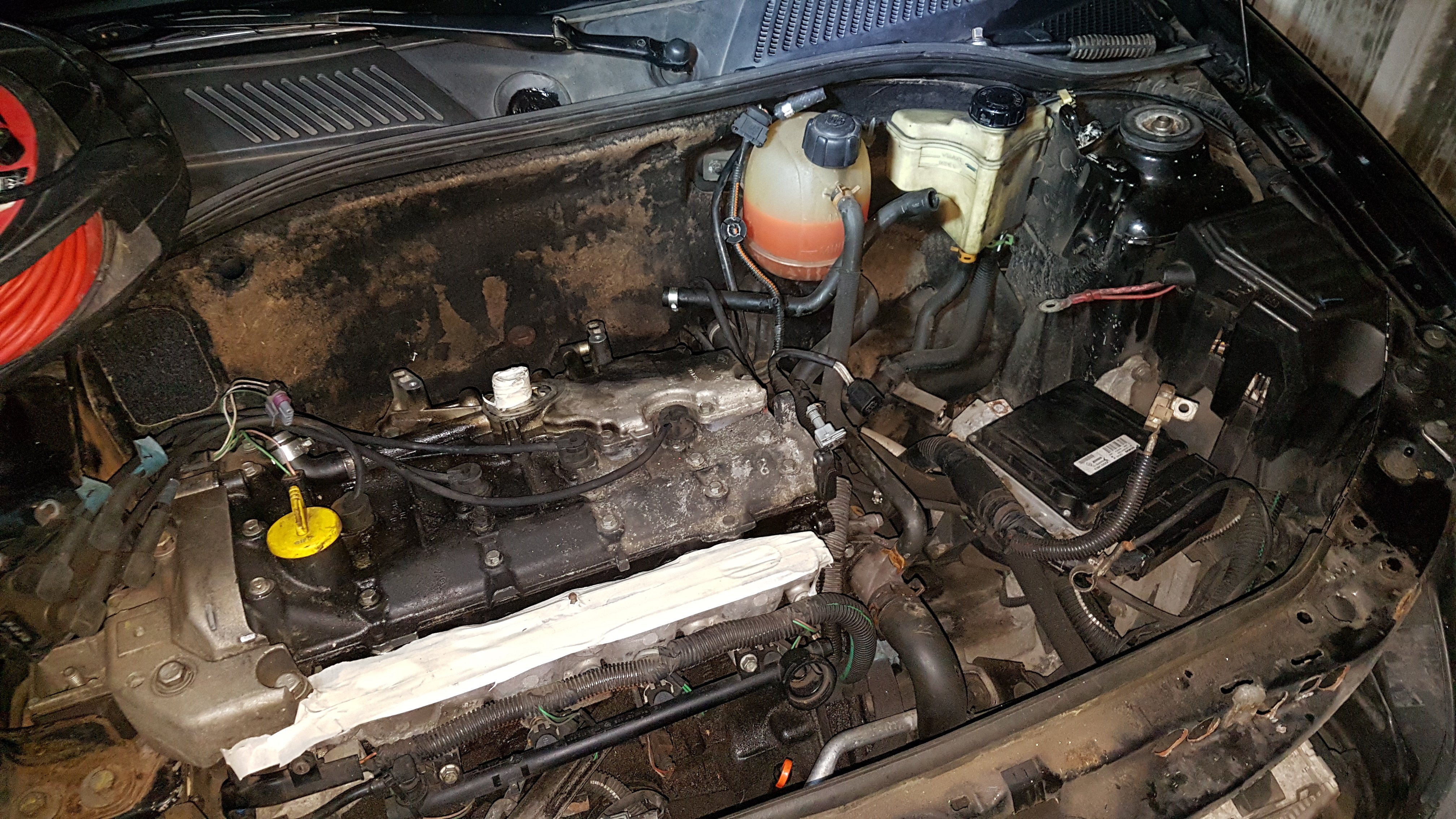

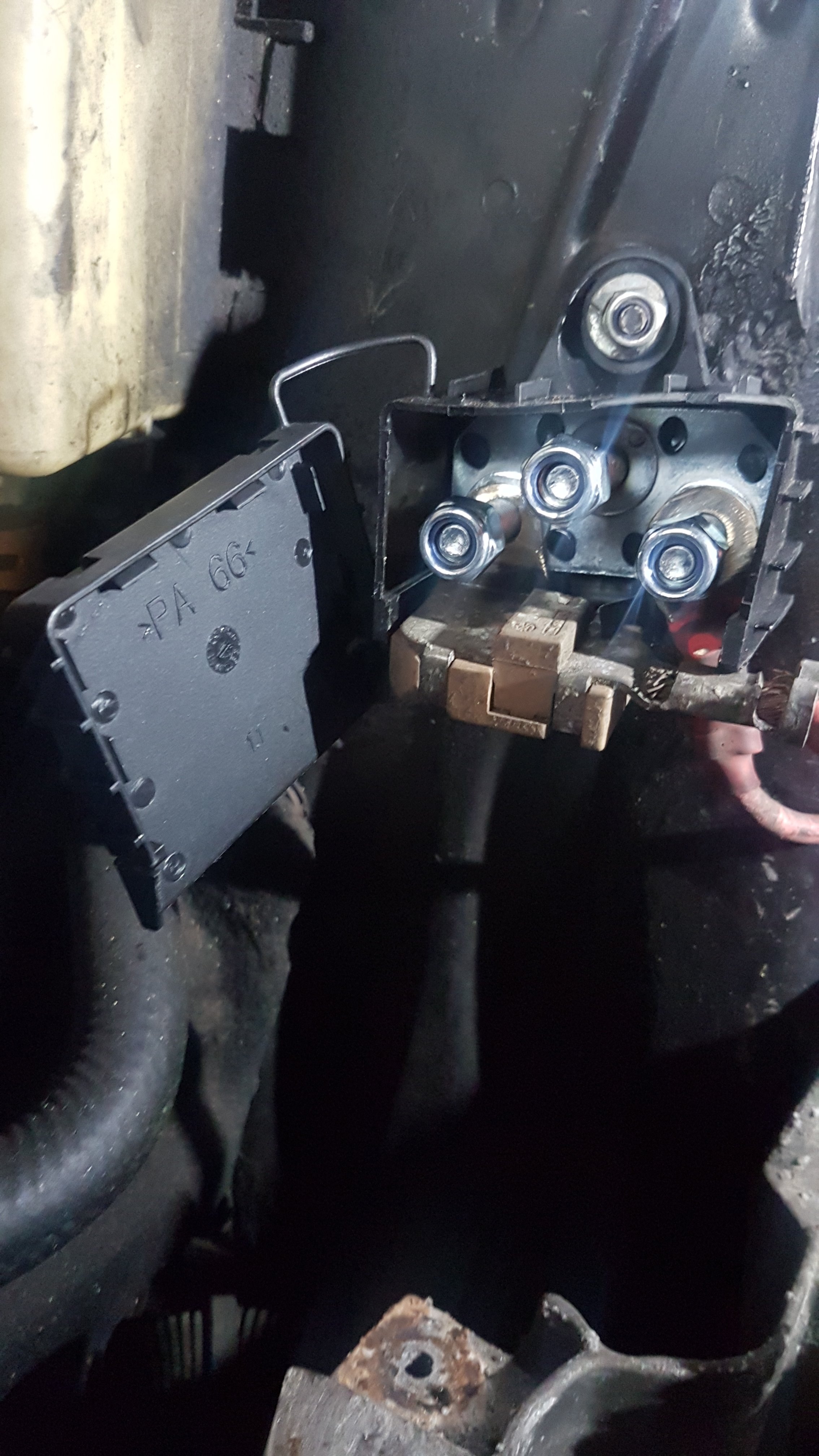

Battery relocation started.
Cant do much else now until the shops are open.
Need subframe bolts, powerflex arb bushes, track rod ends, ball joints, length of cable, distribution block and a battery box.

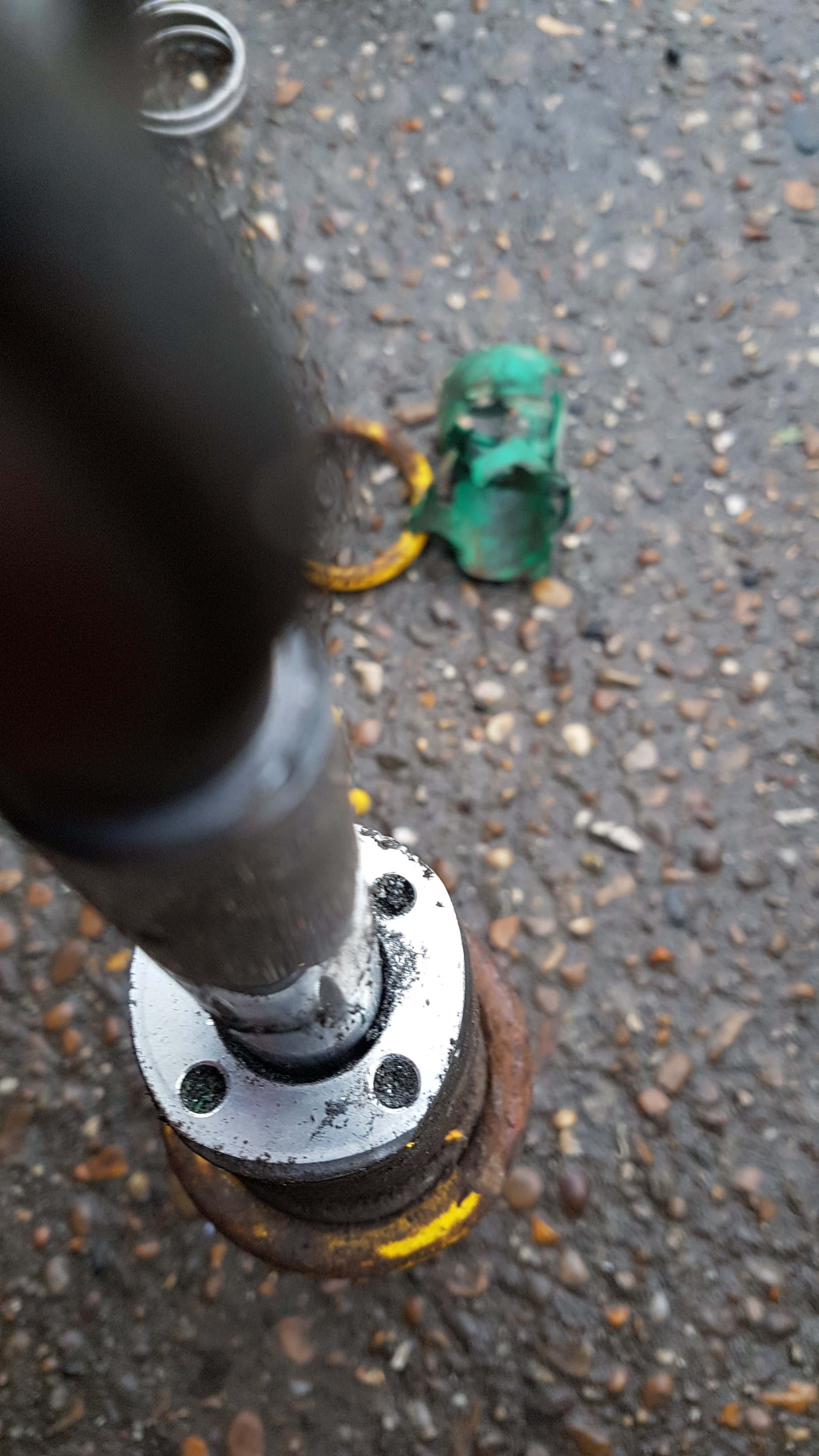

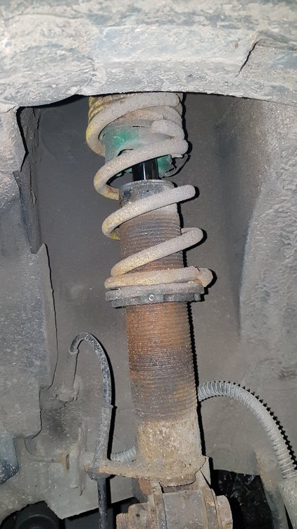

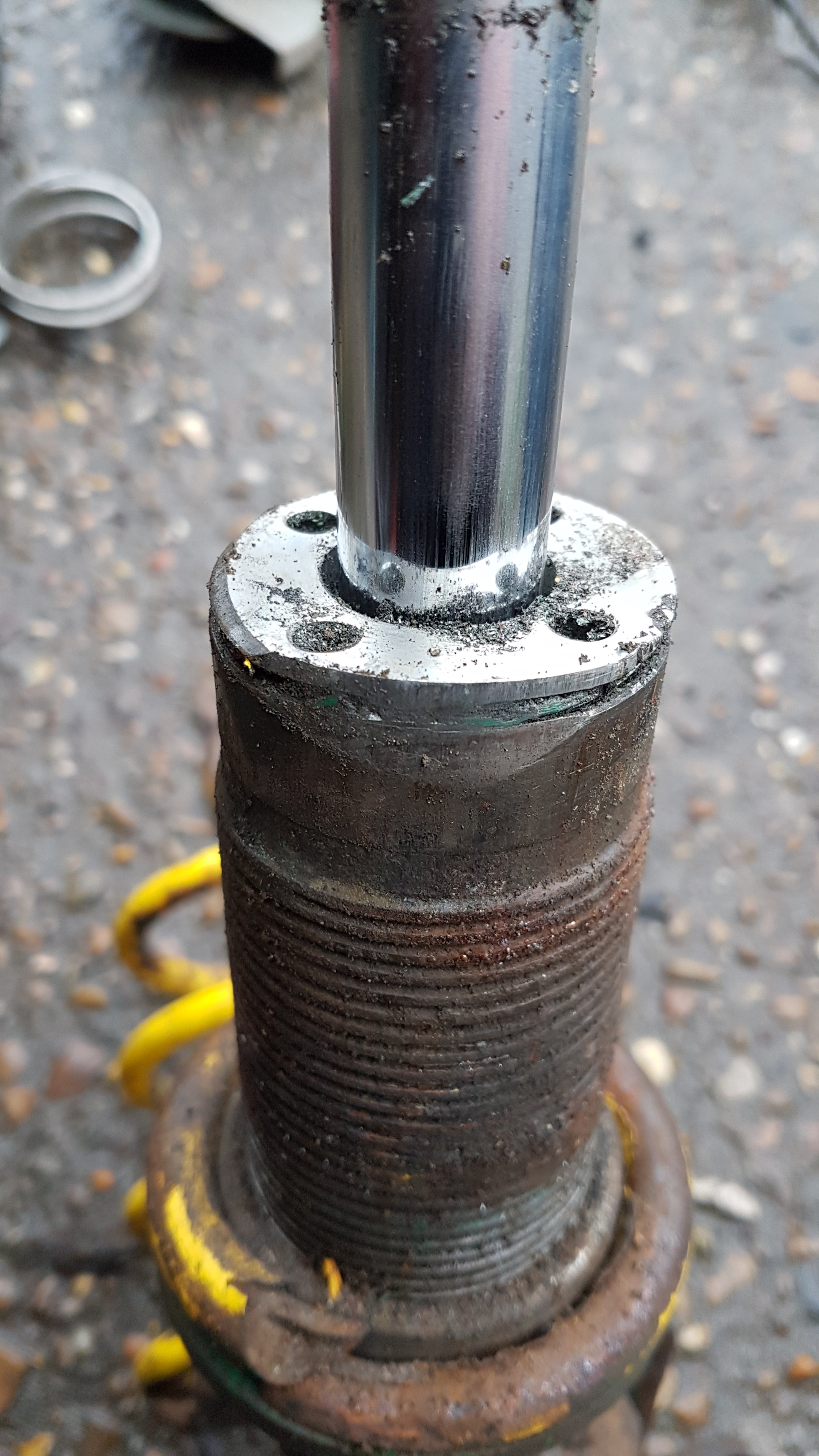

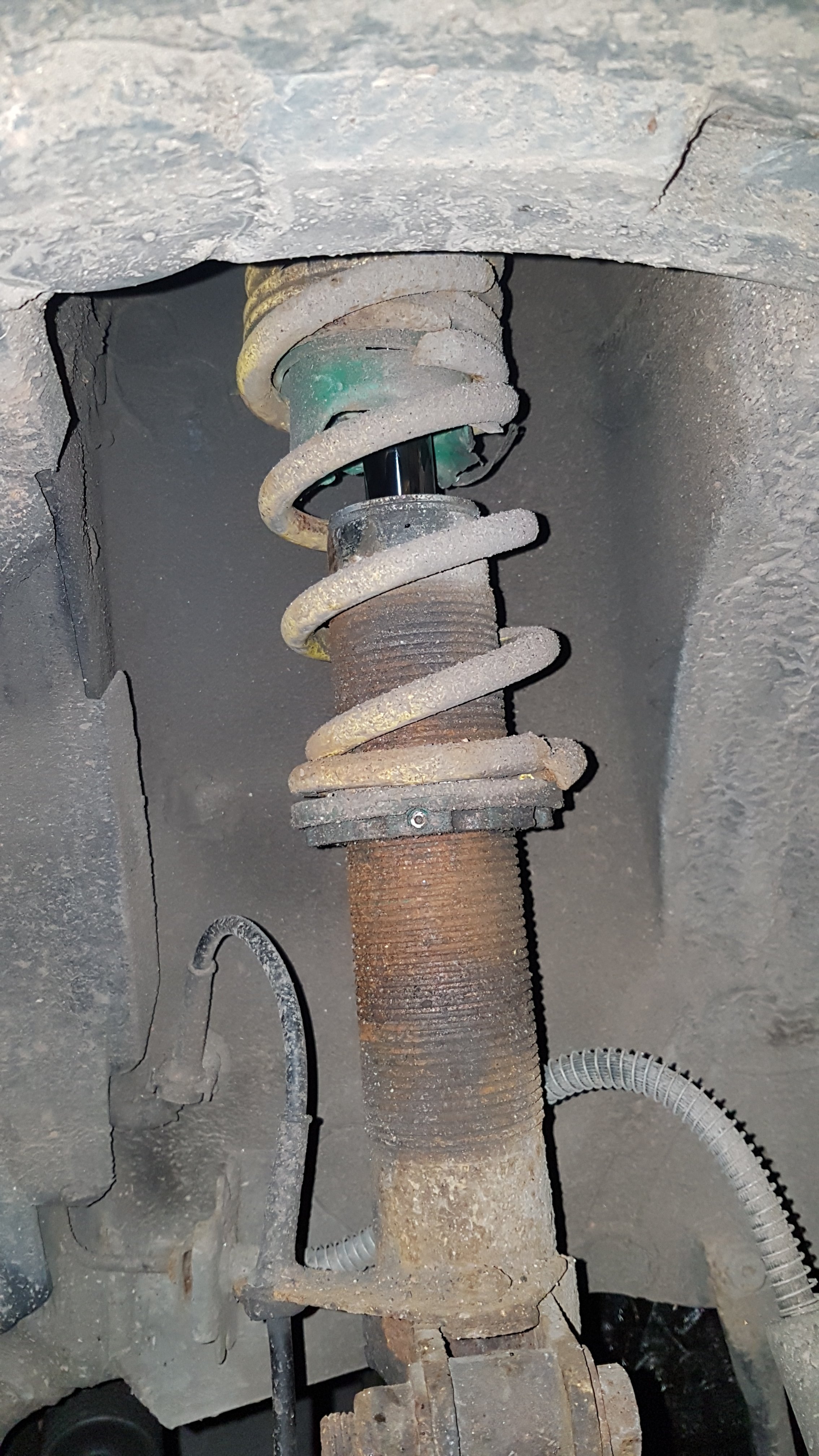

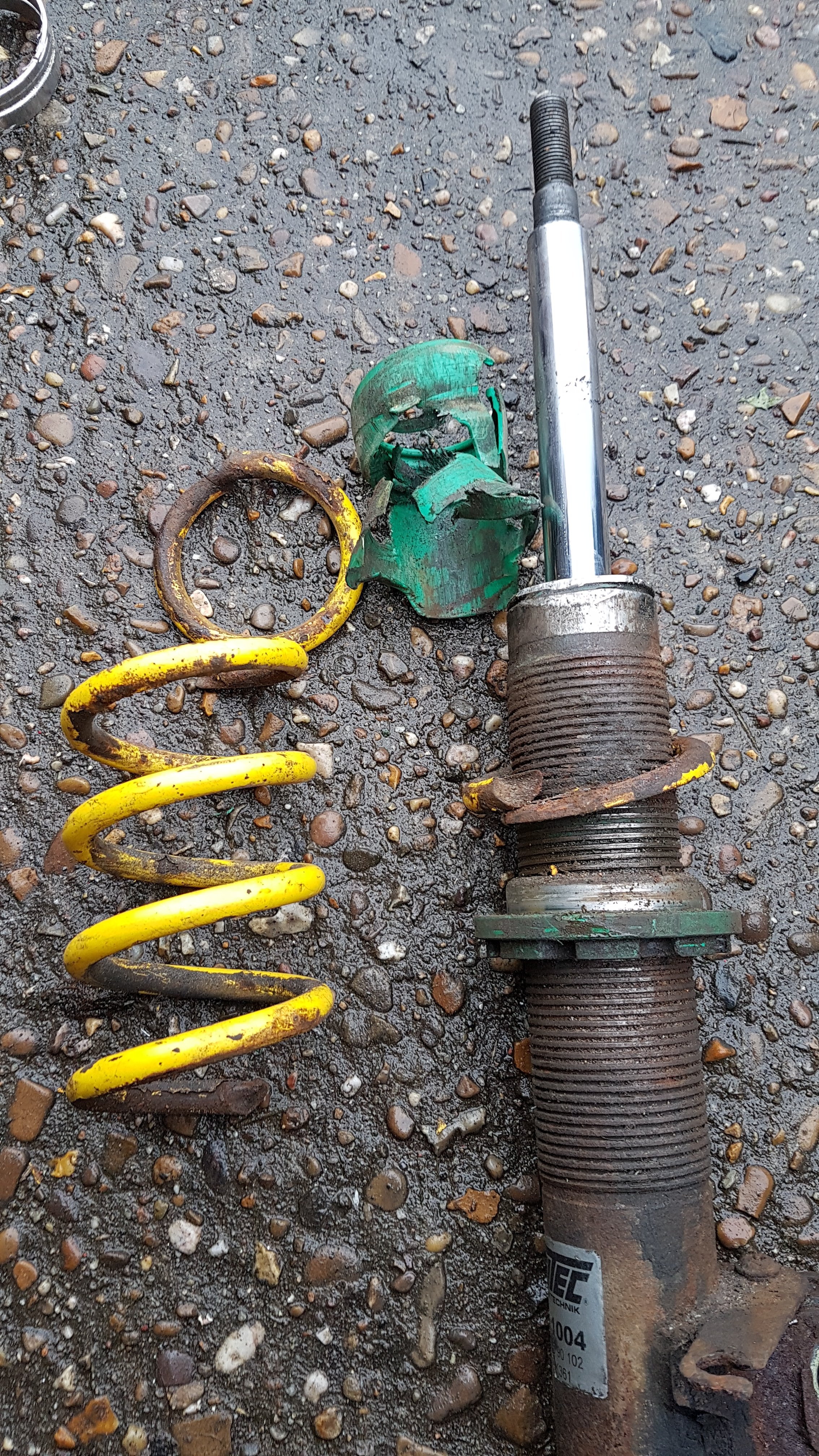

Took the front coilover off to dismatle the spring and found the actual shocks damaged to :(
Looks like i will have to fork out for new so its not so much a budget build anymore.

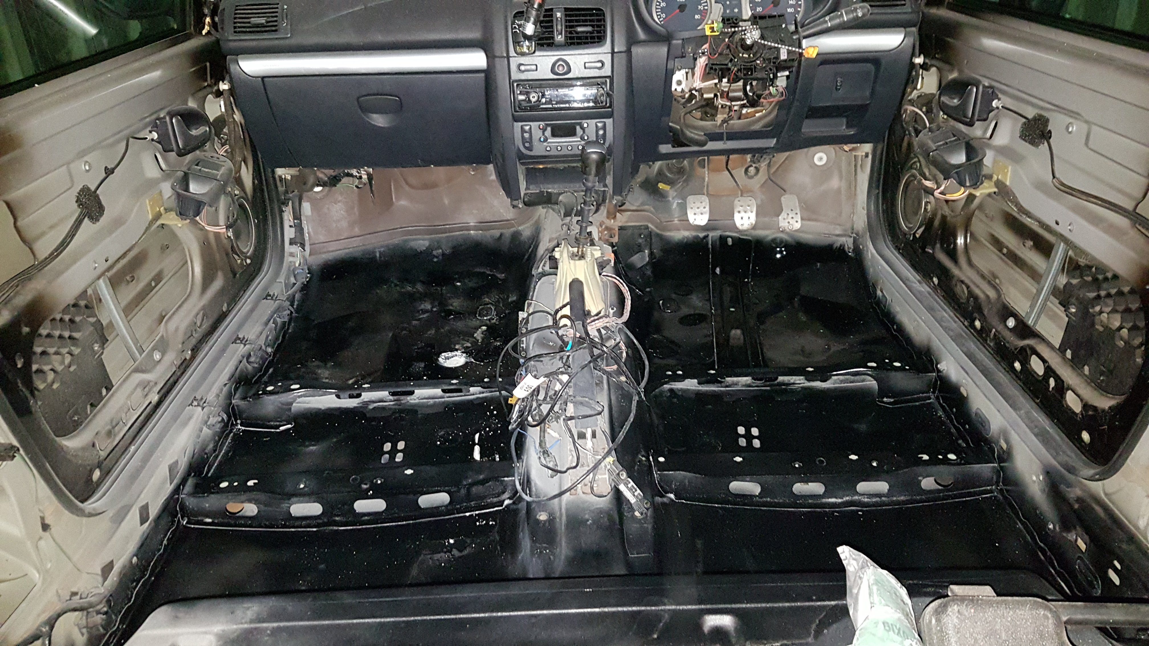

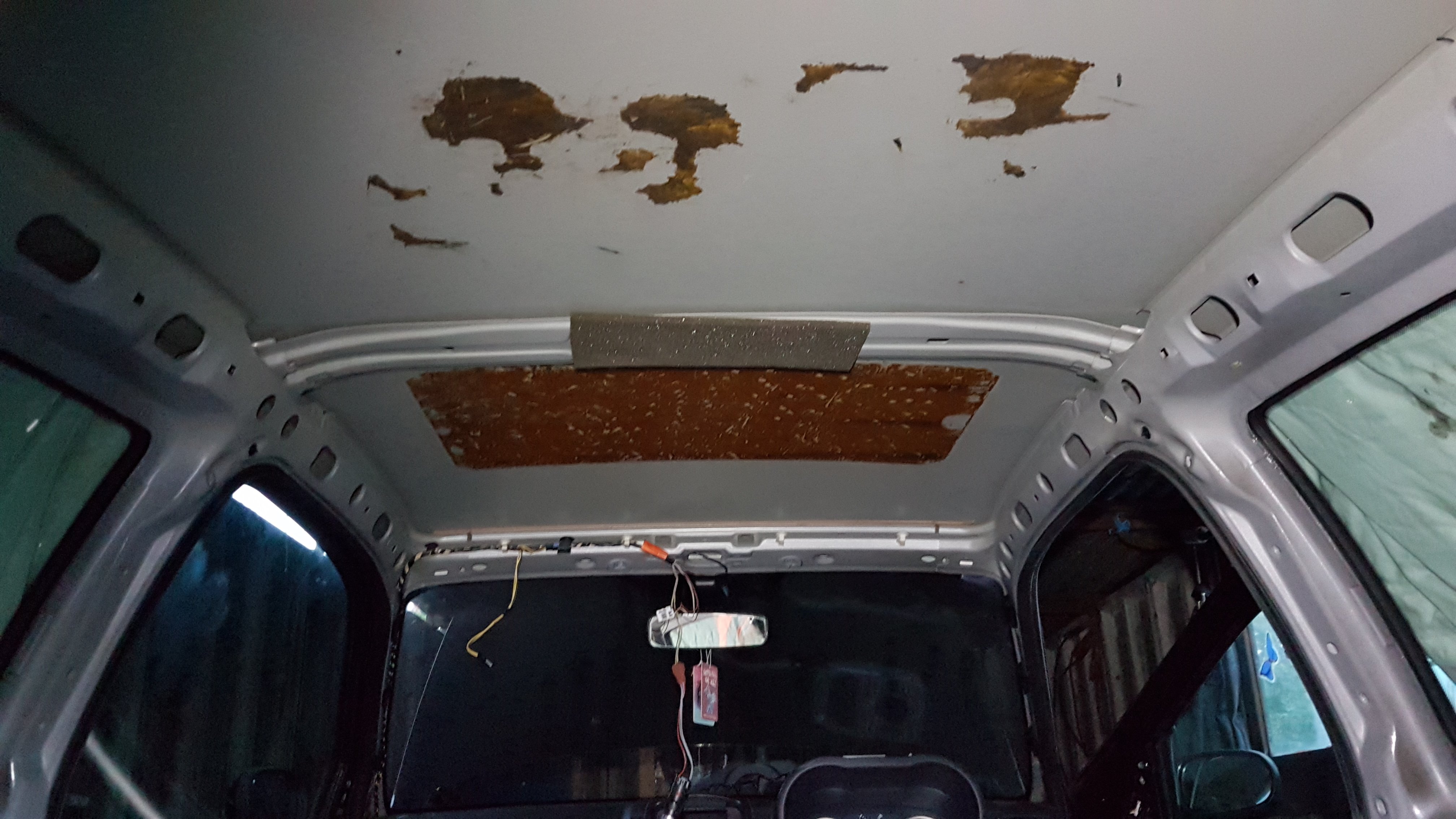

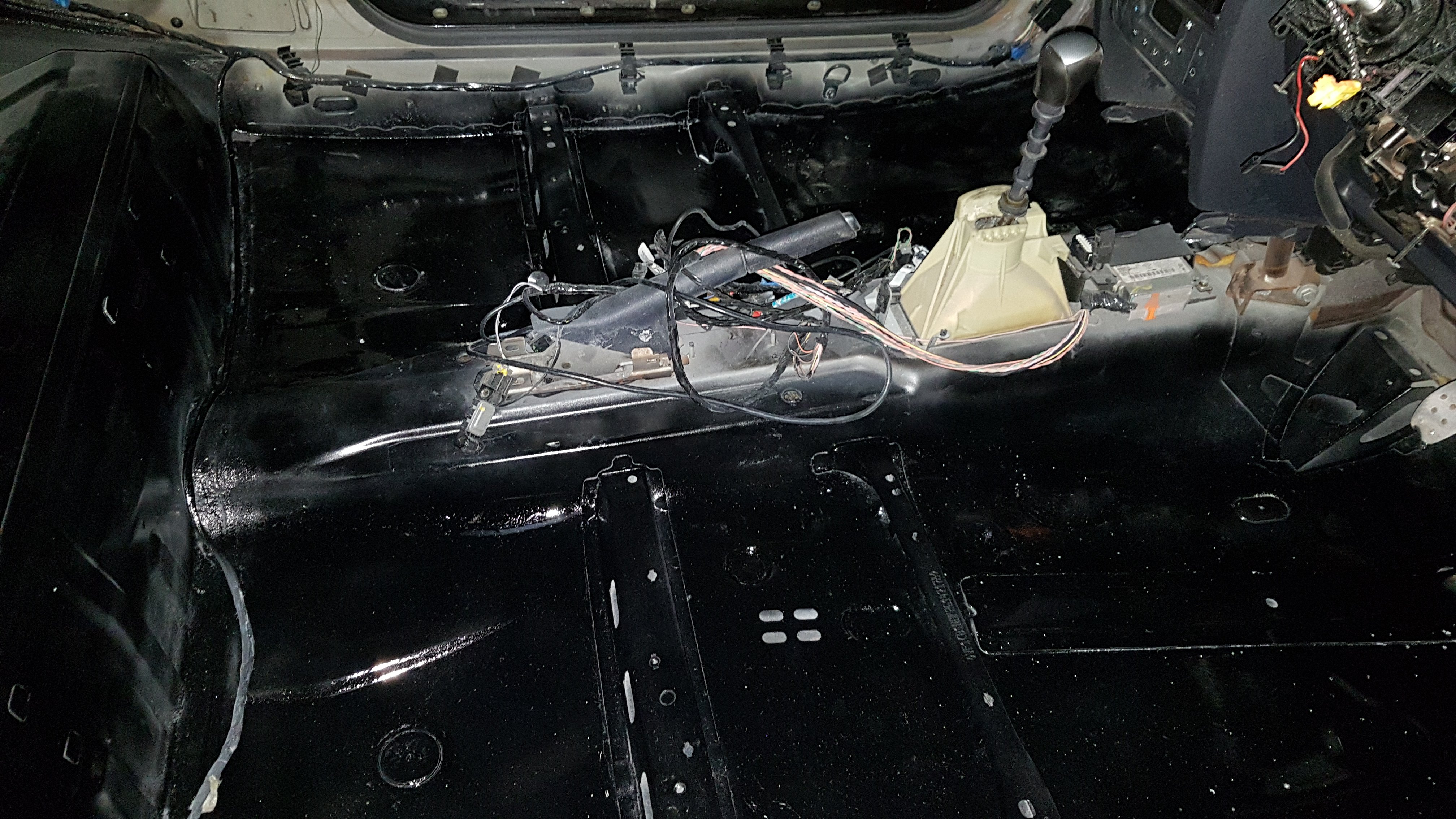

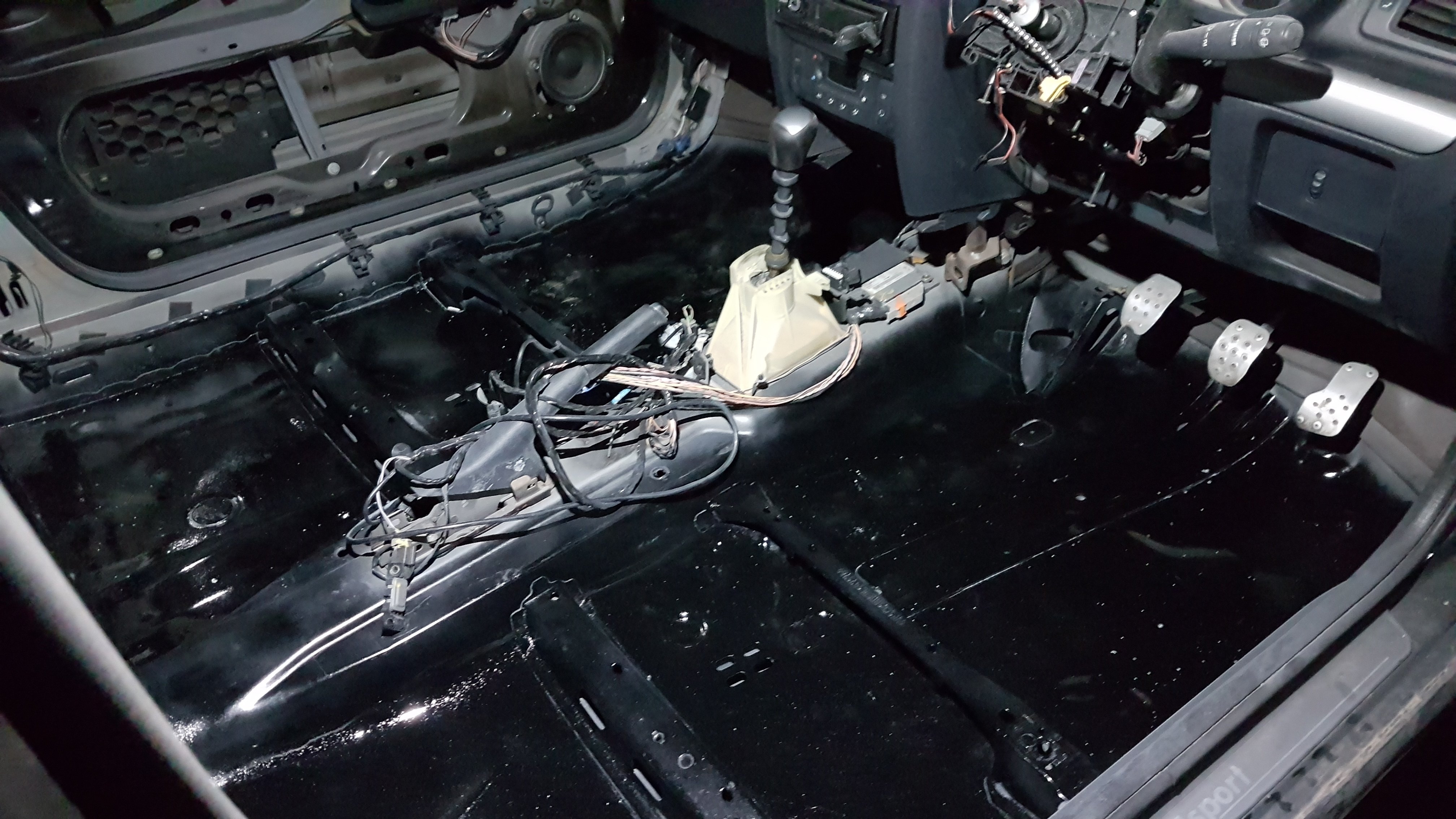

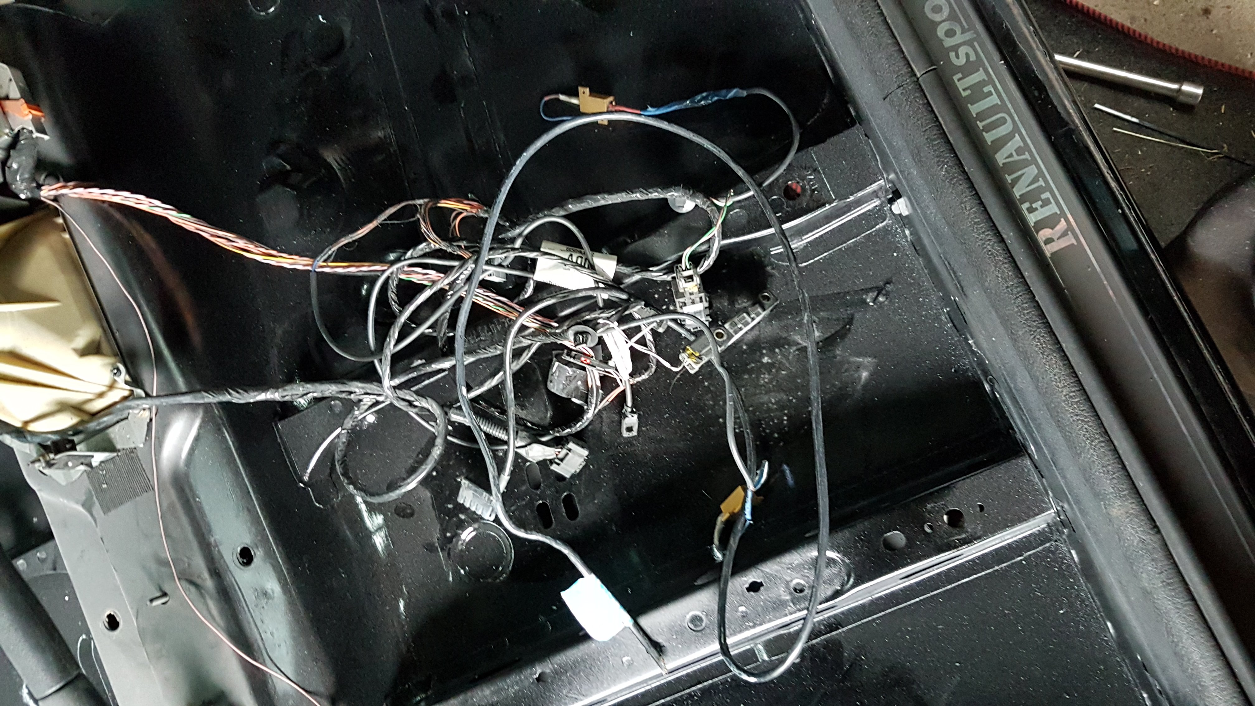

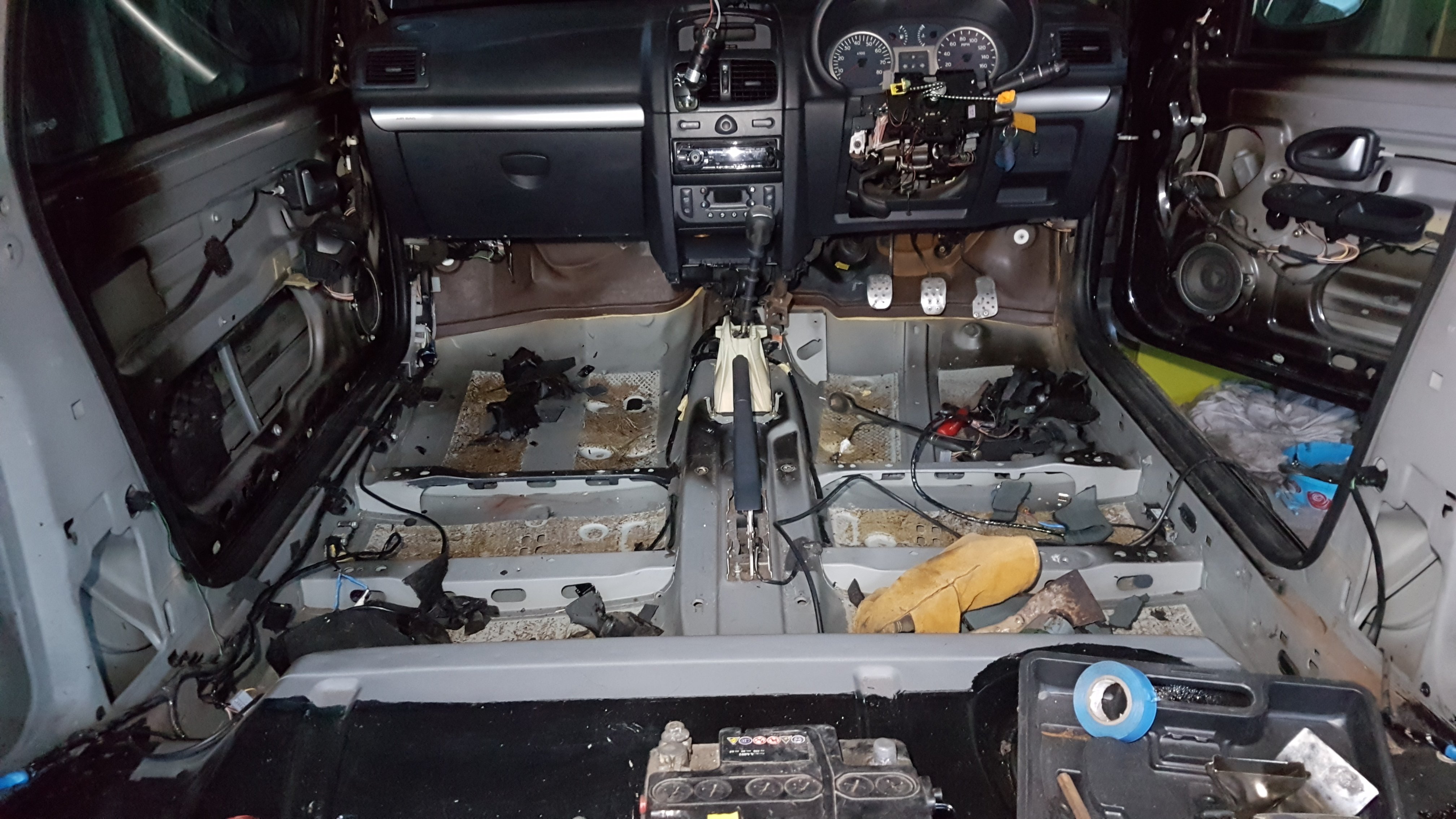

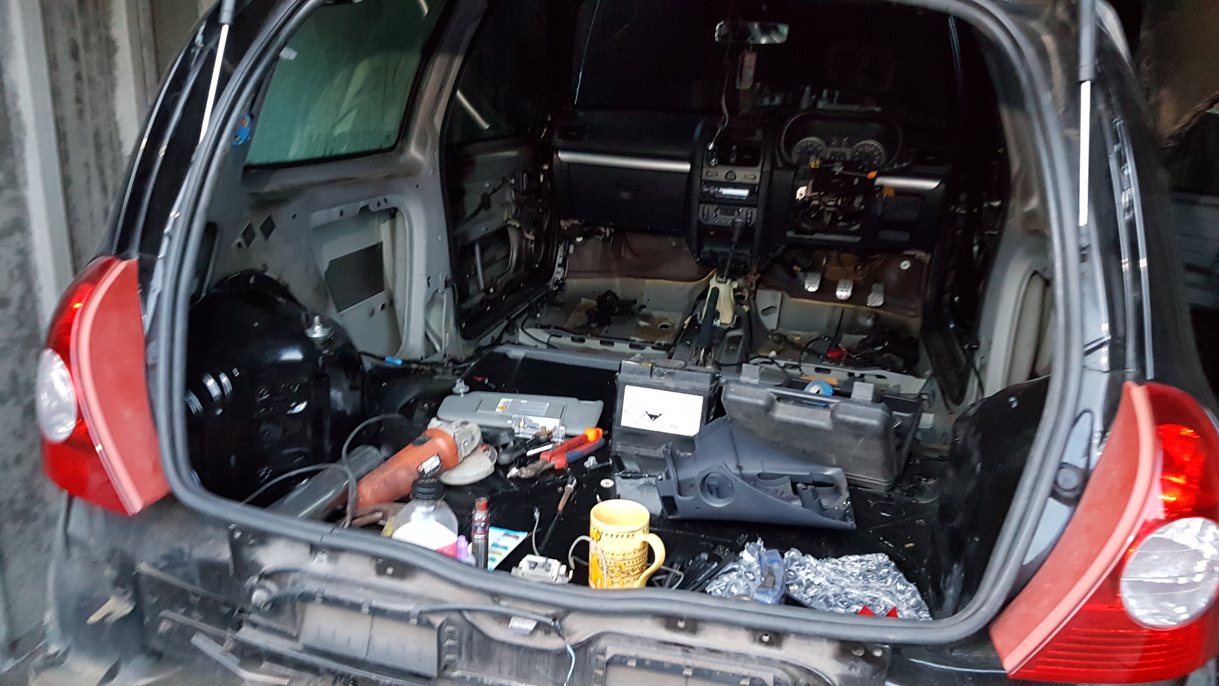

Ripped the rest of the interior out.
Removed sound deadening.....worst job ever!

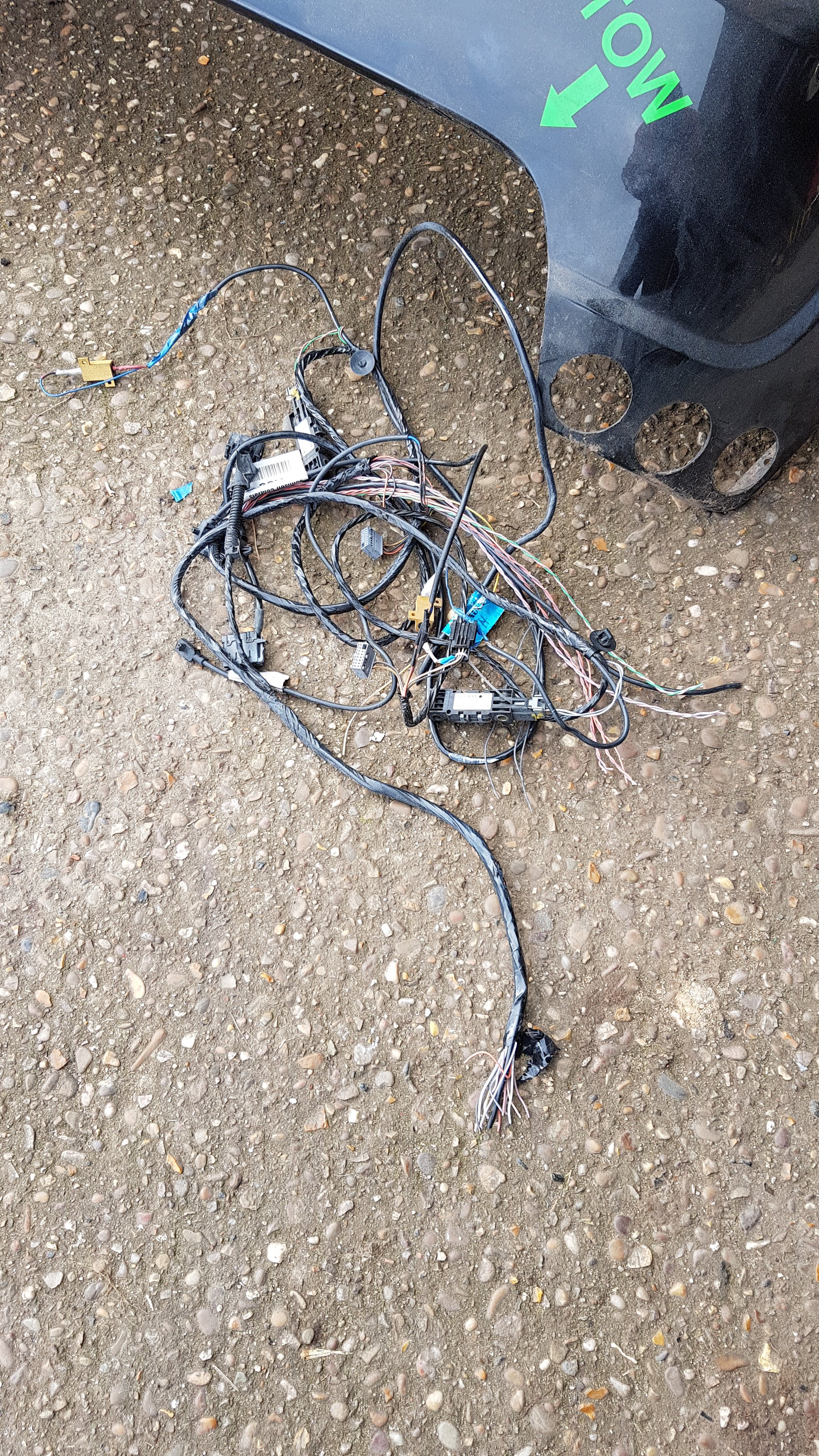

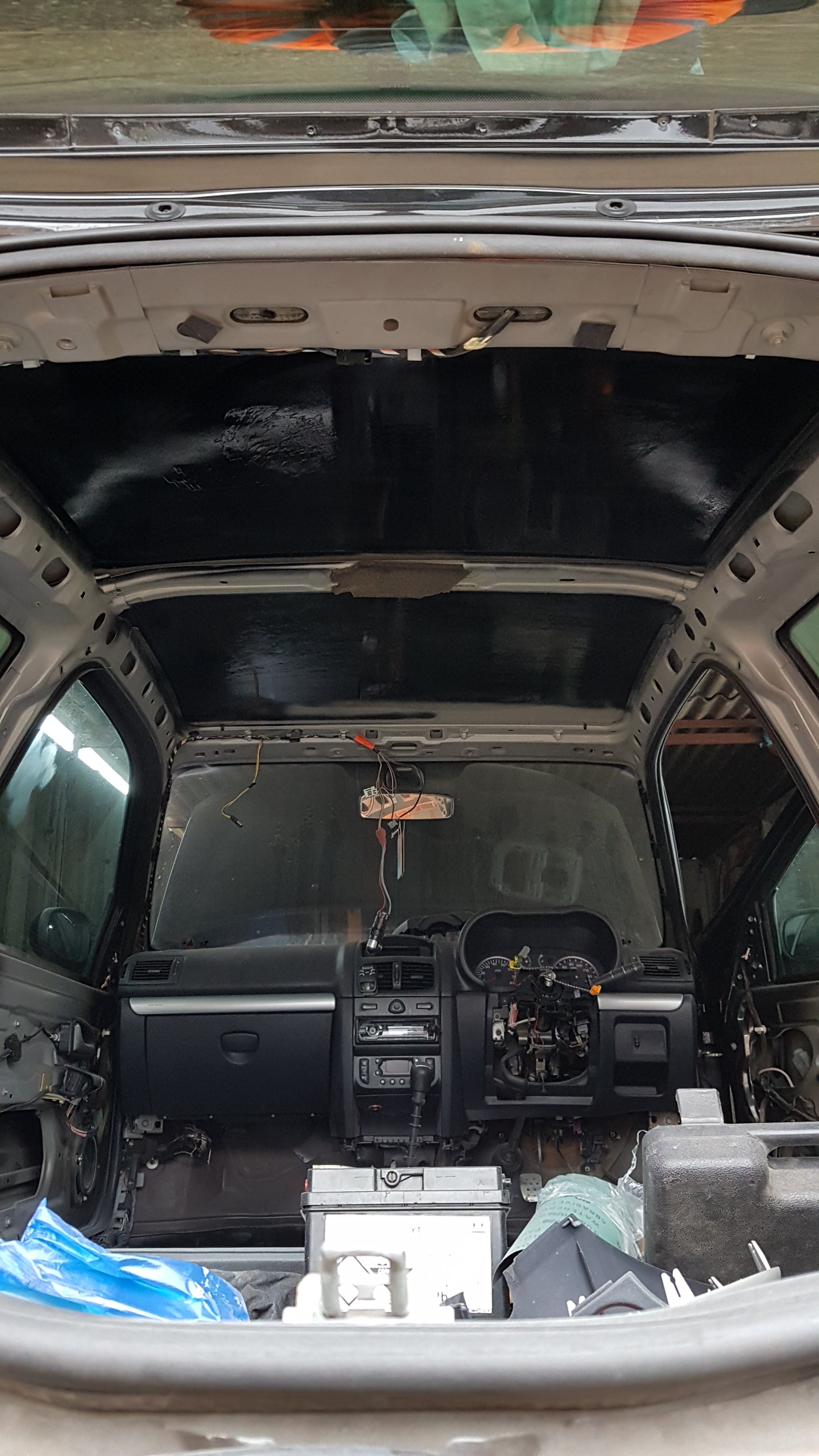

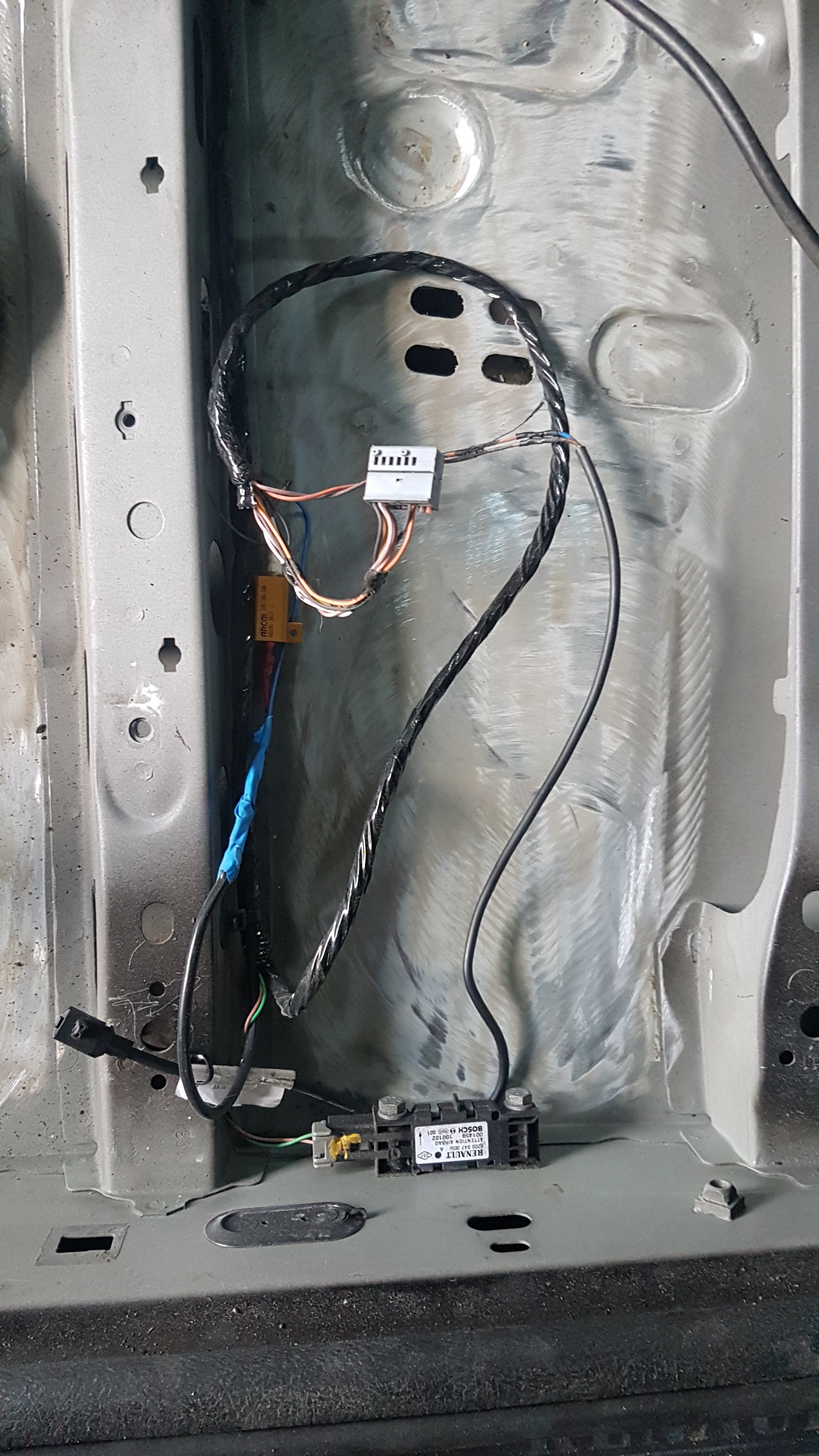

More wiring to chop :)
Deadening gone and a quick lick of paint.
Edited by SNH

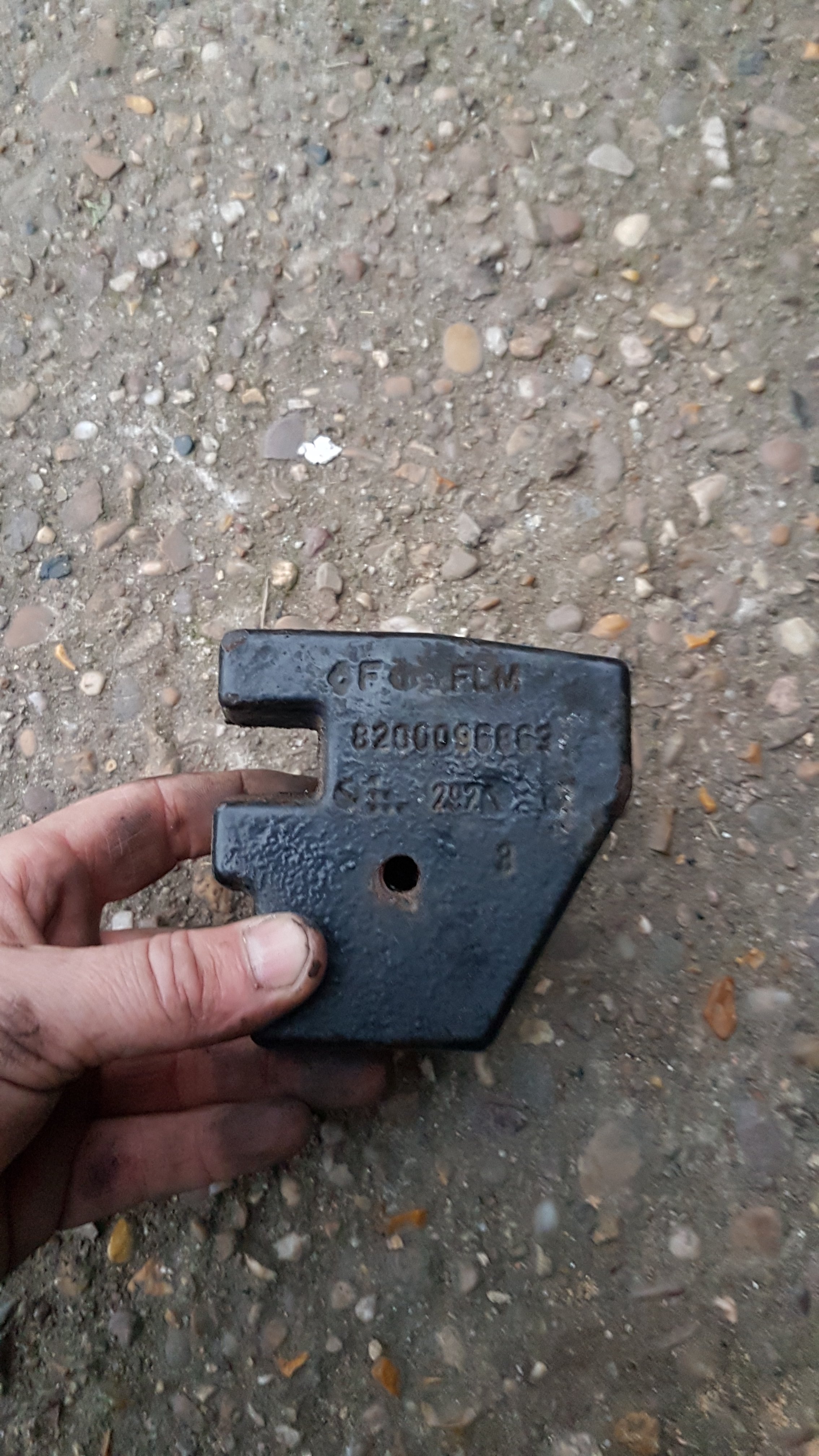

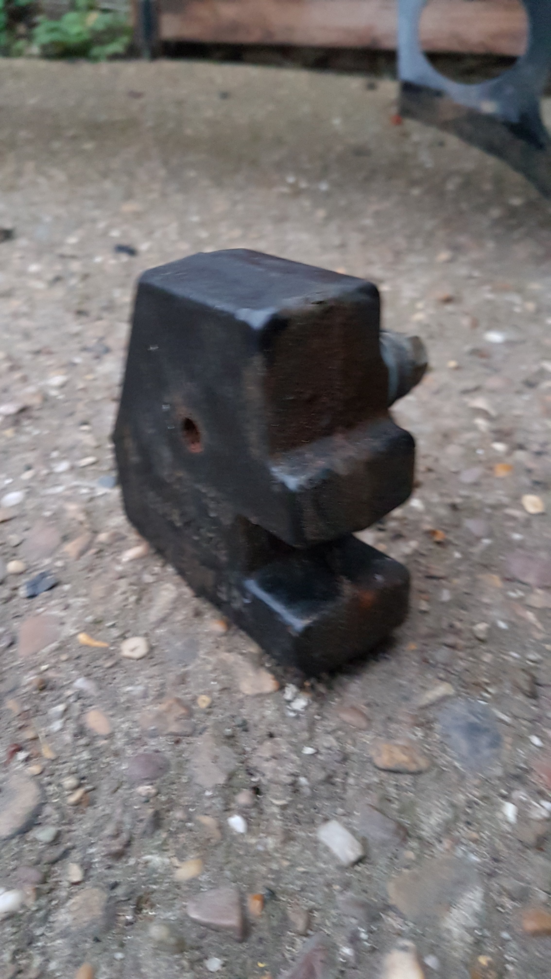

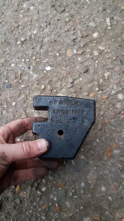

there is a 3kg cast iron weight bolted in front of the drivers side engine mount that can be removed, it acts as a mass vibration damper that does sod all on a track car.
This one?
Cheers for the heads up :)

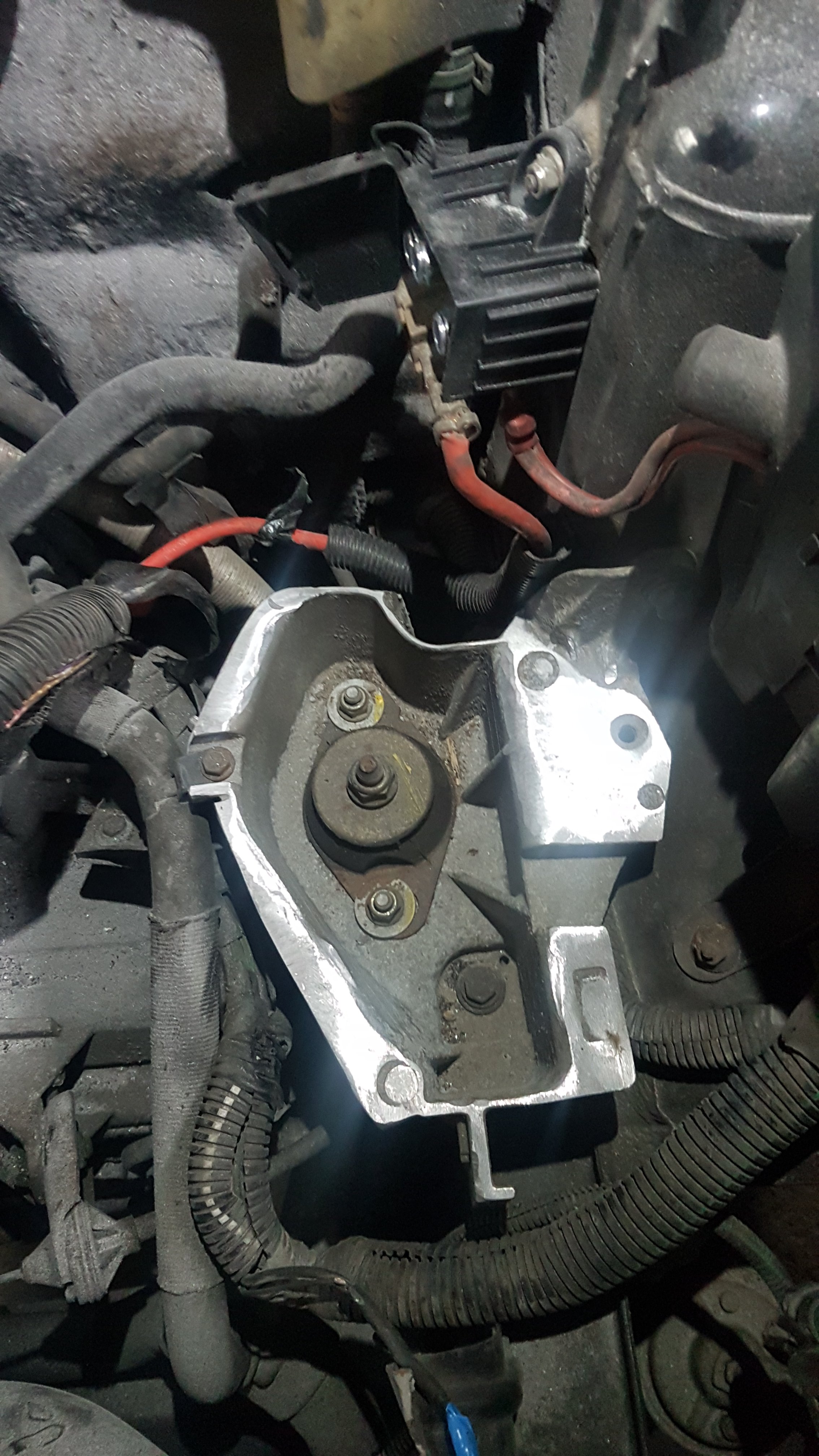

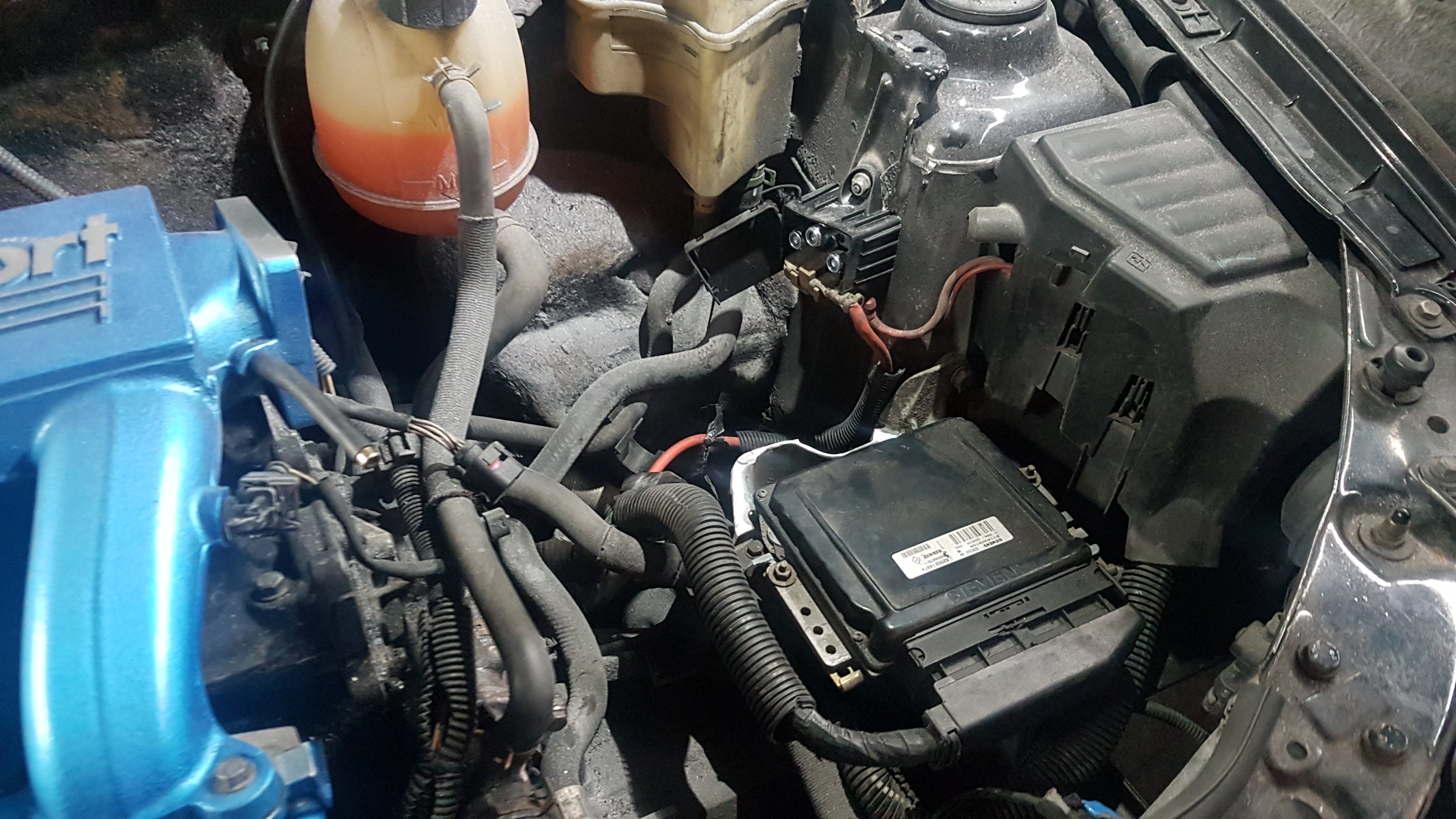

Distro block in ready to run the battery wire from inside the car.
Wiring loom for the seats chopped. I will need to find some with clip to turn all the associated lights off :D
Engine mount trimmed of any excess weight and to allow the ecu to mount fluch on it.
Interior roof painted where the deadening was.
