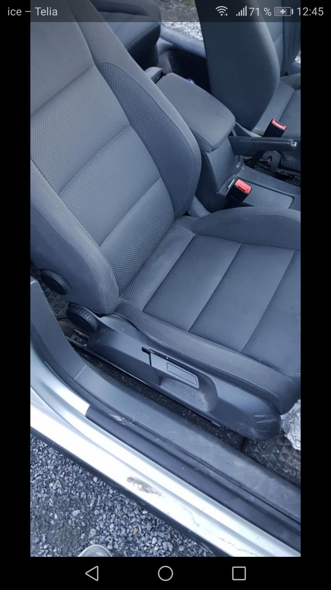

Anyone tried to fit Golf mk5 seats in a Skoda Fabia mk2?
Hey.
My girlfriend are complaining over the seats in her Fabia mk2.
Is here anyone who have tried to fit the seats from Golf mk5 ?
A friend of mine are selling a set with golf seats, thats why i wondering.

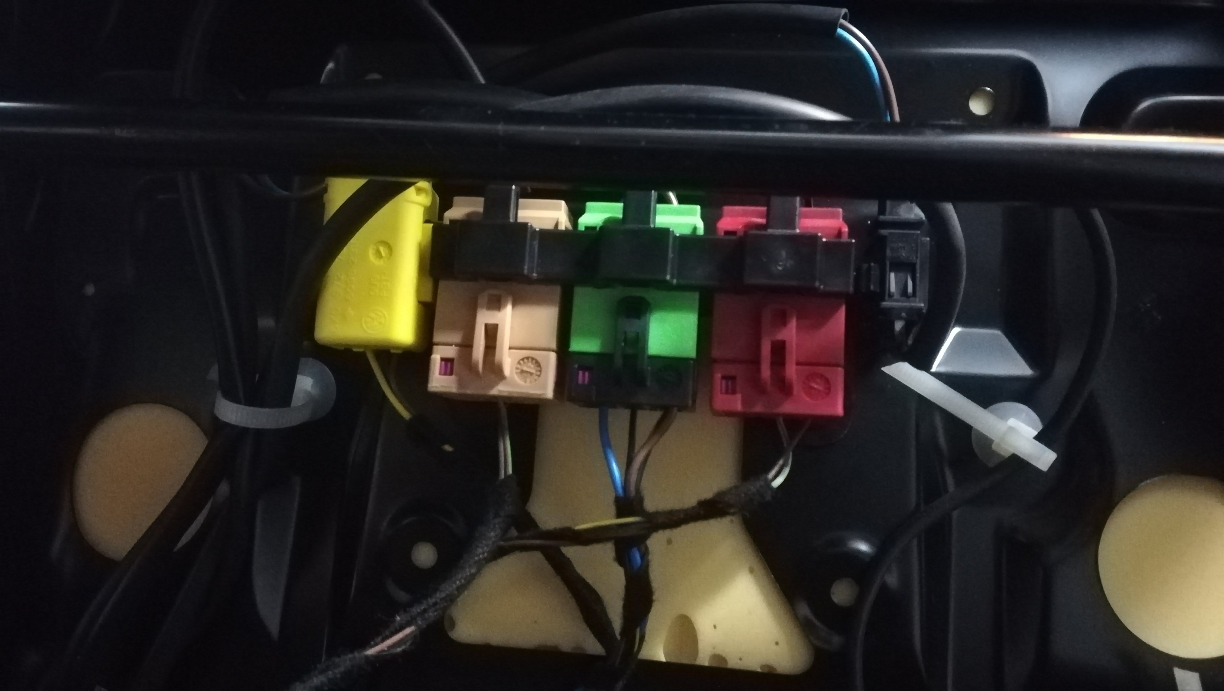

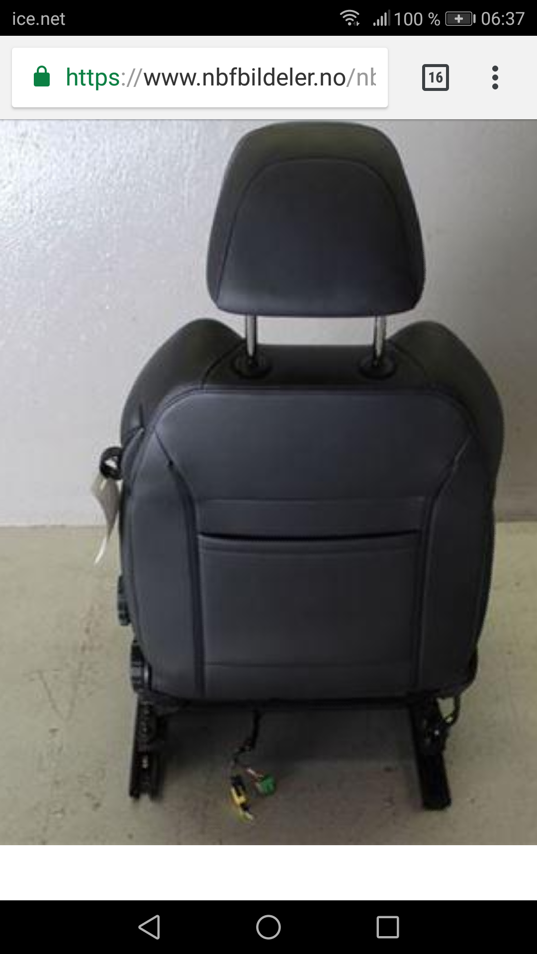

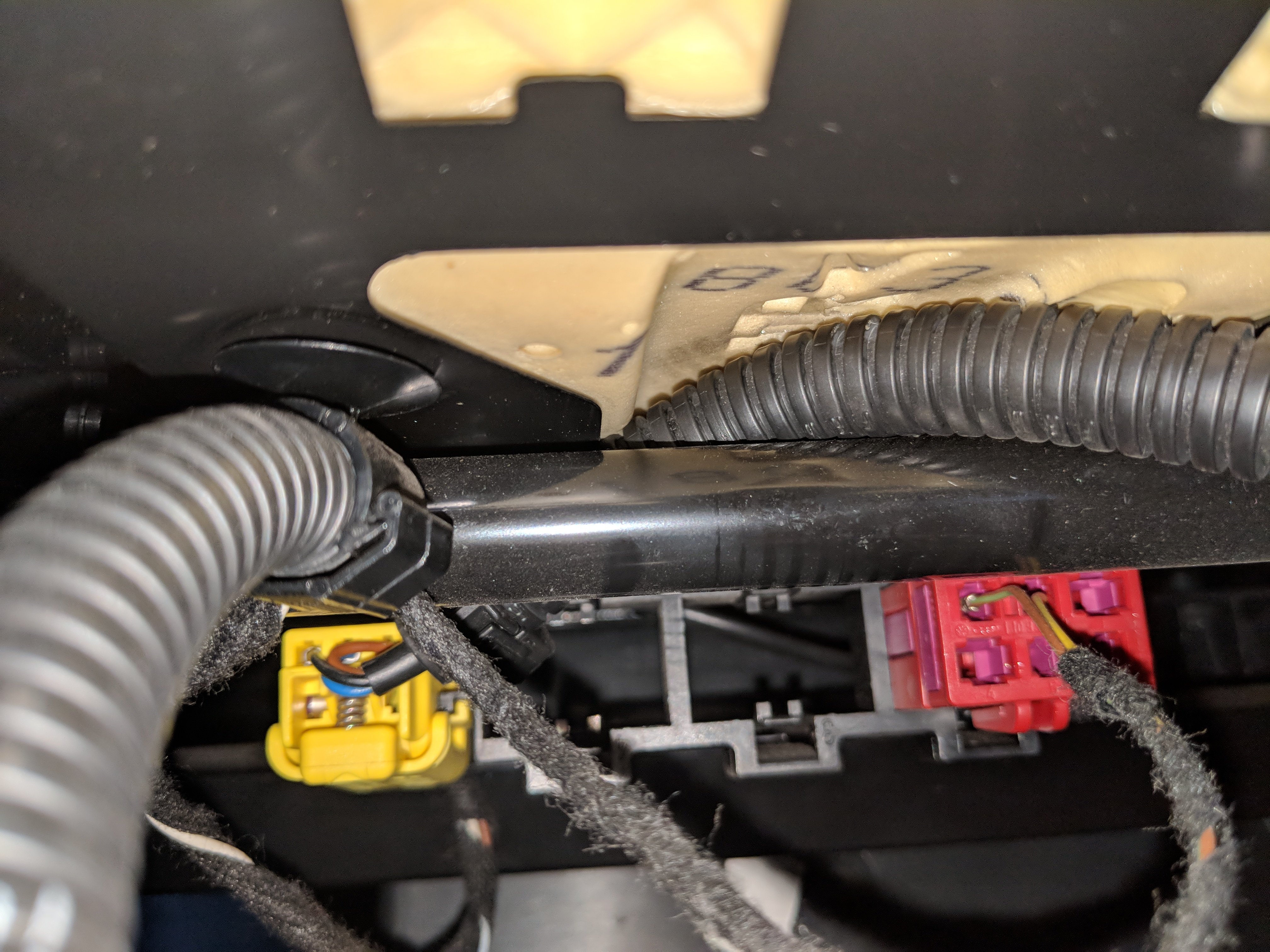

I've found some A1 sport seats but the heat/airbags connectors are different. First picture is the A1 seats with small connectors and the second is under mye Fabia seat.
Do i have to cut wires to get this done?
The yellow plug is airbag, red is seat belt plug, brown is switched by sitting on the seat (occupancy) and green is heated. I know the airbag connector on mine was the same, the others I guess will depend on the year of your Fabia.
I've only got airbag and seat belt warning on my car.
Okey, Thanks! Good to know! Maybe its possible to buy new plugs now that i know what the colours are (or use the ones who are connected on the Audi seat) :) my car is first time registered 24.05.2007.
