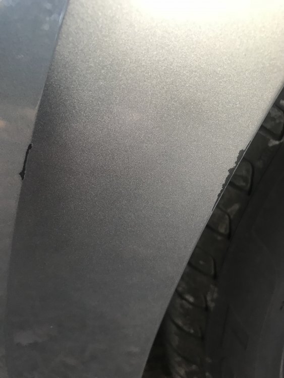

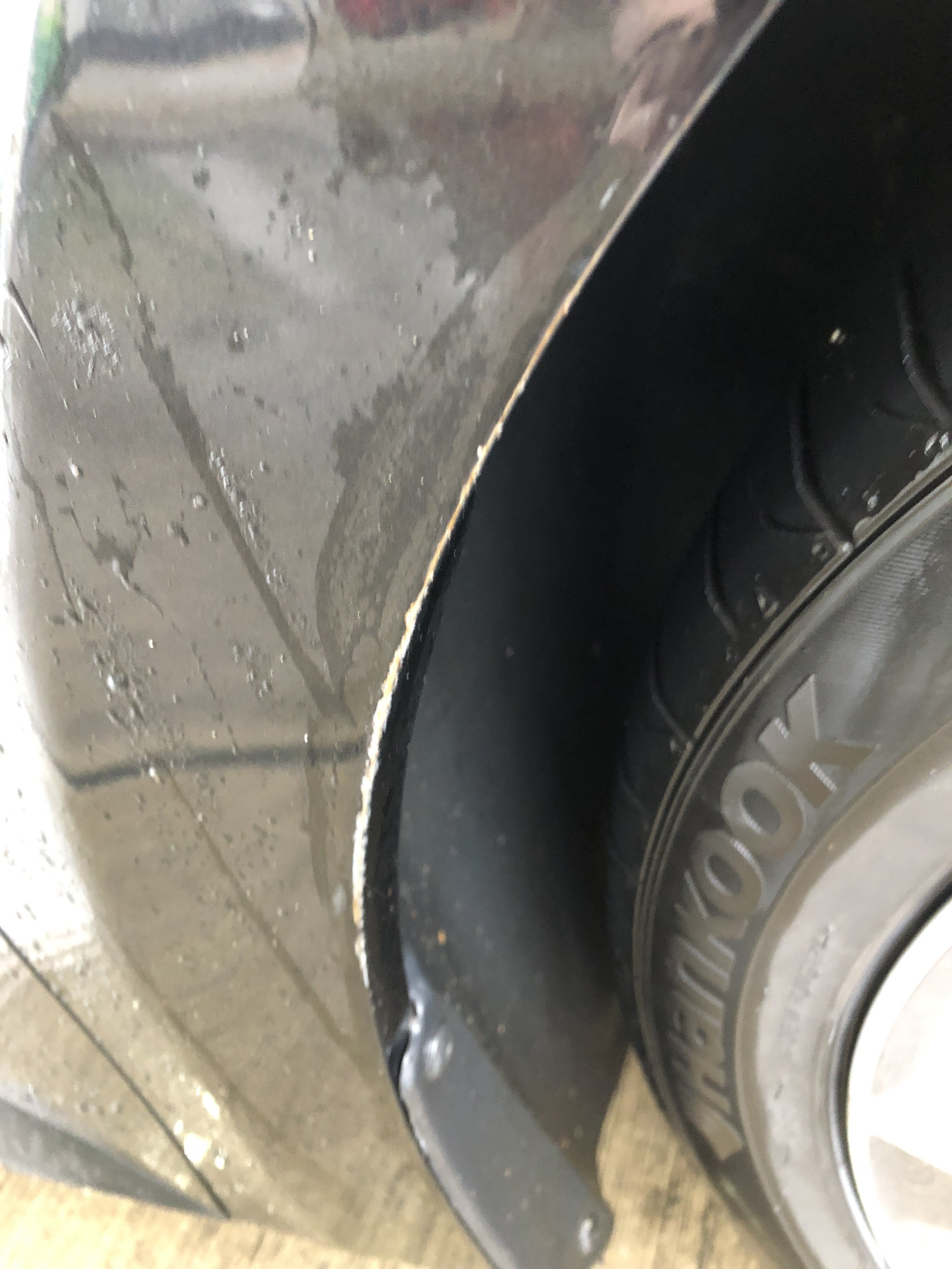

Has anybody experienced a small but annoying loss of paint on the arrises or sharp angles around the wheel arch. There are no scratches around the areas the paint has just come away.

I have this issue too, I bought car 10 months old so not 100% sure yet whether it’s a quality issue or a bodied repair.
