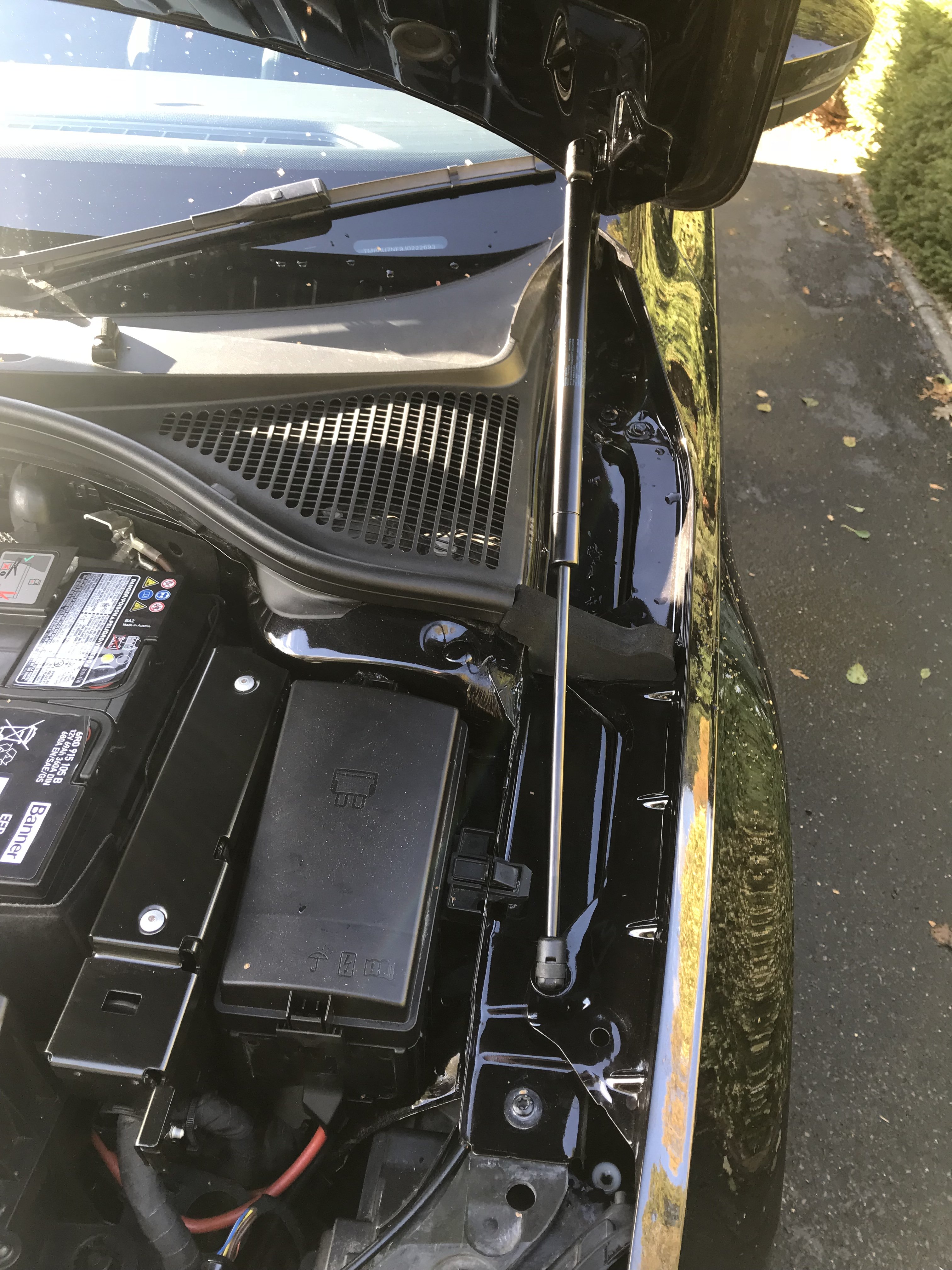

Bonnet lifters added today. See this thread if your considering it https://www.briskoda.net/forums/topic/311228-superskoda-hood-power-damper/

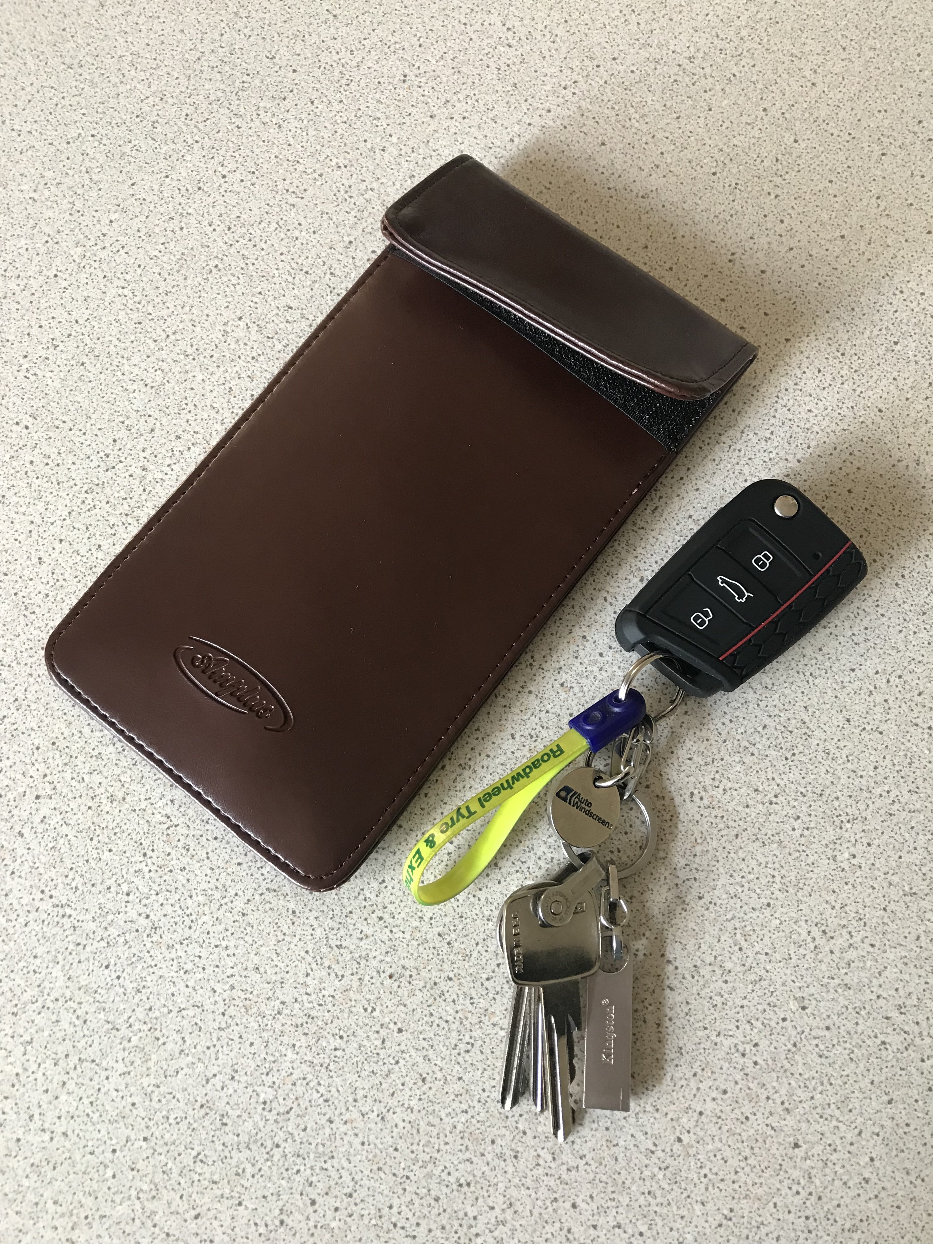

Also purchased faraday pouch for Kessy key. Keyless entry is backwards when it comes to security!
Kessy wasn't a must have for me but huge improvement for driving position as I no longer have a key sticking out of steering column into my accelerator leg. Just wish Skoda would move key barrel from steering column to centre console. Now I have to worry about theives scanning house for key signal instead. Well the pouch solves this.
https://www.theverge.com/2018/10/22/18008514/tesla-model-s-stolen-key-fob-hack-watch-video
While I gained in one area I lost in another as I have adaptive cruise control stalk sticking into my clutch leg instead! Damn it. Poor positioning of internal parts in my opinion.

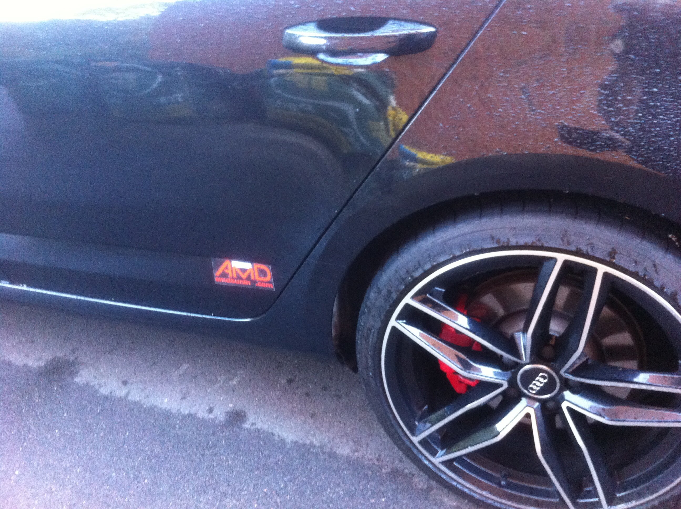

Remember them decals are gonna cause drag. Also what's with Audi wheel inserts?
Edited by JimmyUK
40 minutes ago, JimmyUK said:
Nope battery still not fully covered. Any weight I've added is less than a small child so I think I'm gonna OK. :notme:
Have you not been paying attention young Jimmy (said the teacher). Audi RS6 replica wheels would look odd with Skoda centre caps, plus not much standard left on my car anyway. My power to weight ratio is fixed now (for a 245) at an amusing to me anyway at 245BHP per tonne. Extra drag from the wider wheels/tyres absolutely.:D
