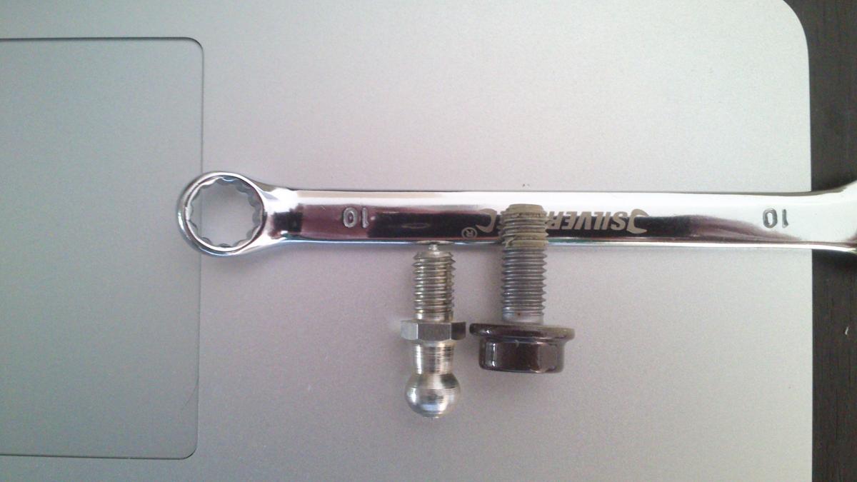

I just received an order from superskoda with the hood power damper. Has anyone gotten these bad screws from them?
I ordered 2 sets and both of them had a good screw and a bad one. The one with a thin rim cannot be tightened with a key like you see in their install video.
Plus, another thing that seemed strange to me when I watched the install video, the original hood screw that they unscrew seems longer that the one they put back. And indeed, it is so. Add the washer that you need when you install their screw and you get a much shorter screw then the original.

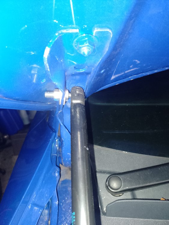

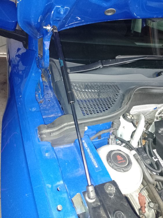

I've done this mod using Fiat Bravo/Brava 95- 520x200 dampers as suggested by @wlange. Type of dampers is Polcar 3018AB1 and it actually says the're 370 N (althought they're sold as 350 N). Got a pair including and a pair of M8+M6 ball bolts from local car parts dealer for 25 €. They fit perfectly, installation is very easy and didn't took more then 15 min. I colored the ball bolts to black for more OEM'ish look.. See attached pictures and video in action.

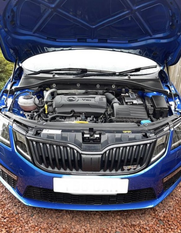

Hi, I am very interested in fitting this mod to the hood on my Octavia (MY16) - the standard support stay is a bit low rent isn't it? Can anyone advise on the best kit for this - or is it better to source the parts separately from BMW / VAG as a few posters mentioned earlier in this subject? Do the lower mountings for the gas strut require additional reinforcement plates in the wings? I would assume that the upper mounts (on the hinge plates) are already strong enough.

Well my dampers arrived from, dare I mention it, Superškoda, fitted in about 10 minutes all in, but had to source some M6 & M8 washers as non provided. They hold the bonnet up ok but they don't lift it of own accord from down, a little helping hand needed. M8 ball screws are a little shallow on the hexagon as florino mentioned, but manged to tighten ok with ring spanner. All in all quite happy but a few little niggles re Washers. I would have put a photo on but not mastered that art yet.
Edited by stanian
I'd agree with Stanian. 15 min job, also had to source my own washers (fairly poor really). Other than that they do the job of holding the bonnet up.
Other than not including the washers, pretty good kit.

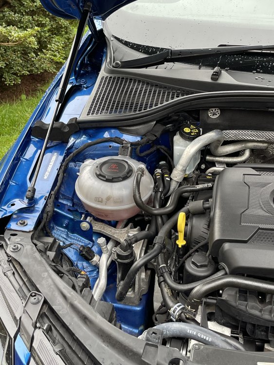

I had this modification on my 2008 Octy vRS and really wanted to get it for my 2014 Octy vRS. So I've just gone and ordered the following from Onlinecarparts.co.uk, so hopefully everything will turn up and be just as required:
FEBI BILSTEIN, M6 Ball Socket x2, №: 04006
FEBI BILSTEIN, M8 Ball Socket x2, №: 04260
FEBI BILSTEIN, Gas Spring x2, №: 27709 - This is for the IBIZA II
Those that have fitted their's, does the M6 go on the bonnet or the wing?
Cheers
Edited by benjamino
M6 to the wing, M8 to the bonnet.
