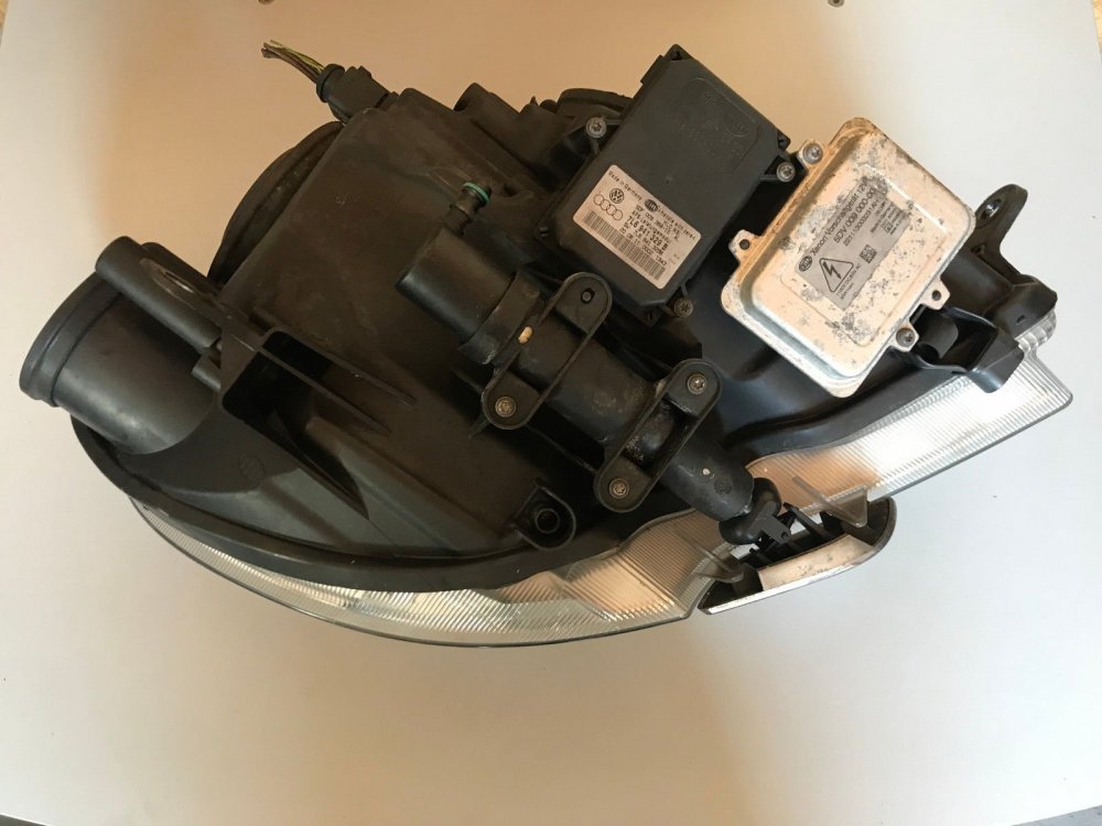

Ballast is on the underside of the headlight, here is an image from eBay.
The silver box is the xenon ballast and the black box is the AFS/range control module (moves the xenon projector up/down/left/right).

Brilliant!
That's exactly what I was looking for. Thanks again. When I looked at the unit in the car I could only see the black box and not the aluminium case. So it looks like its light out as a minimum and problem to do that its bumper off too.

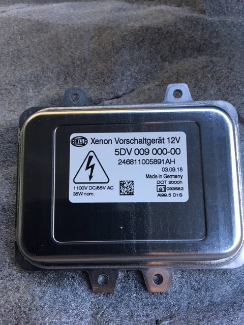

As a help to others who might find this thread with the same problem I sourced a new ballast and the replacement has sorted the problem.
I should point out that Skoda parts wanted over £250 for their version of the component.
I managed to find this website https://www.buycarparts.co.uk/ and bought a hella replacement for £83 including postage from Germany.
The Hella part is brand new and appears to have been manufactured in sept of this year.
