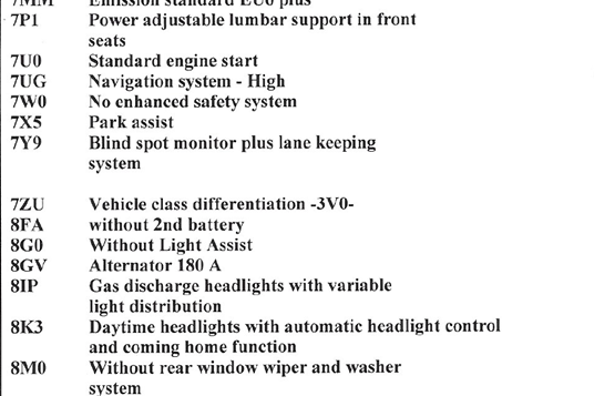

Did you look at the spec sheet before ordering/committing? I got mine ex-demo, but it was the first thing I asked for before even putting a deposit down. Mine runs to 6 pages, and some of it is in badly-translated (or not translated at all) German, but it's generally pretty easy to see what the car has or doesn't have from it. For example
7Y9 was lane assist. It wasn't clear to me from this whether it also had the Active Lane Guidance, which I really wanted, so I rang the dealer and got them to check in the car's infotainment system while I was on the phone (I bought from a dealer 150 miles away).

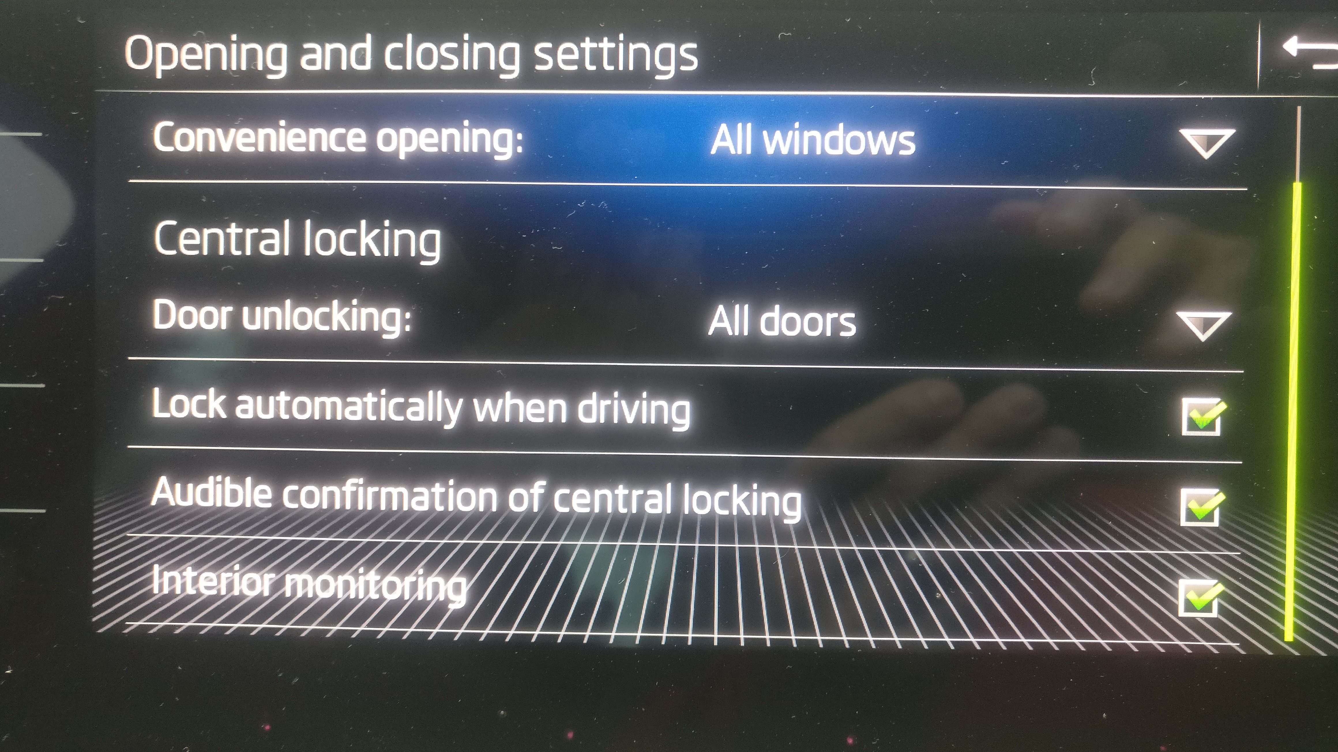

I also have a 220 sportline. Ive coded a few things in like the audible chirp when lock/unlock as well as a few other things with obd eleven ( i didnt use the apps as i have been told these can mess with other stuff that isnt intended)
Once i coded it, it appeared on the infotainment screen as shown above.
