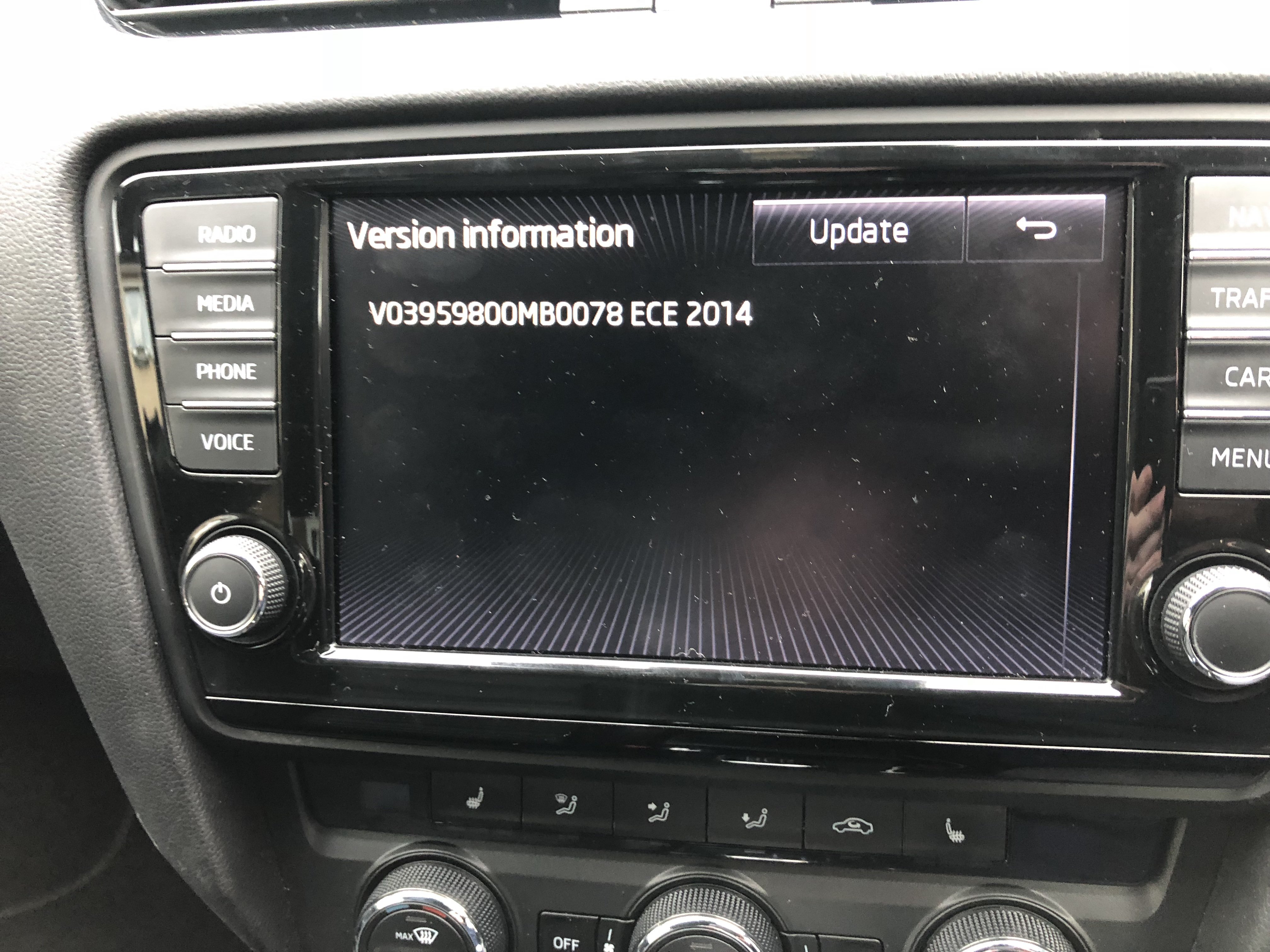

What version do you have currently and what version are you trying to update to?

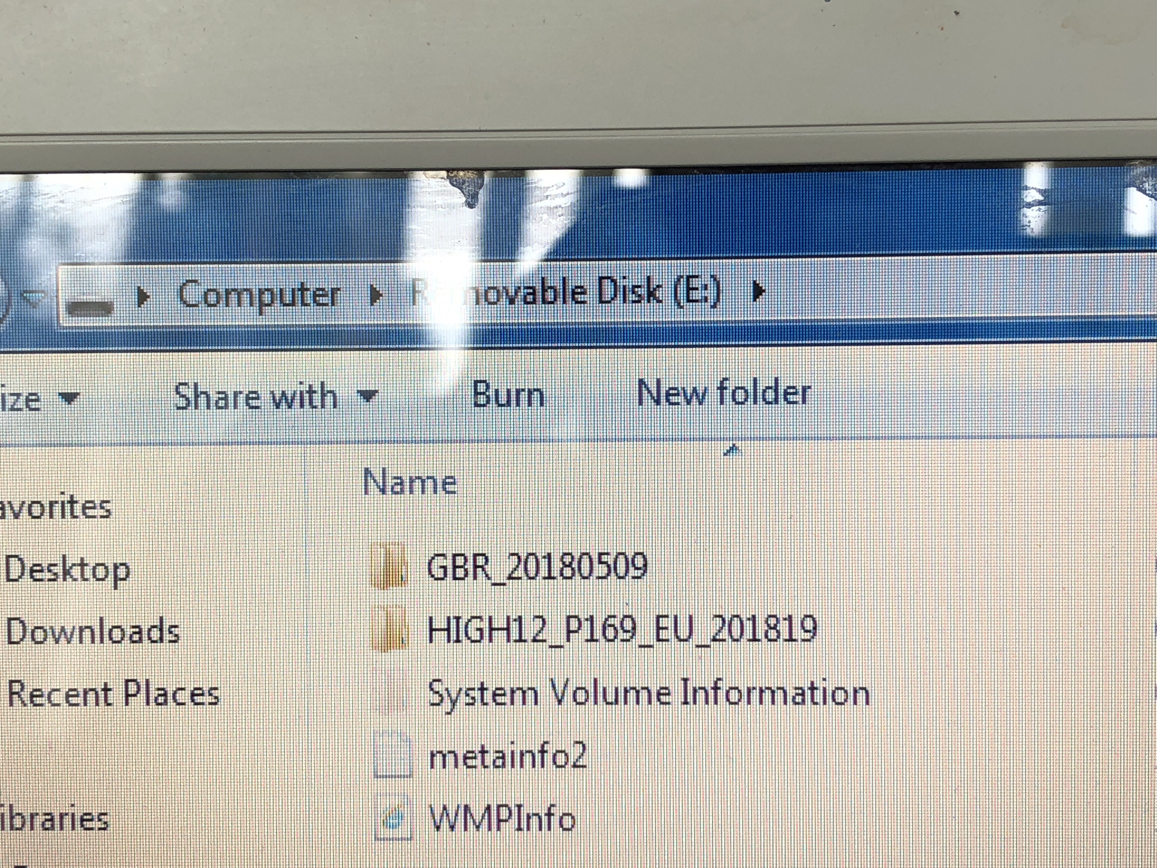

This is the current map and the one I’m trying to install. As you can see neither file is zipped.
There's your problem then. As per my post earlier in this topic, you need the MIB1 and MIB2 folders and the metainfo file at the root of the SD and nothing else.
You need to remove everything else and pull the files/folders out of the HIGH12_P169_EU_201819 to the root.
There was a post with a screenshot of exactly how it should be in the topic link @logiclee provided.

This is the problem using the "direct link" method instead of the Skoda downloader.
If you follow the instructions on the website using the Skoda downloader it will download the file & then copy it correctly to the SD-card for you.
As an SD-card is quite slow, you can also use a USB stick or USB-harddrive to update the Columbus.
You need to copy the contents from Inside the folder: HIGH12_P169_EU_201819 onto the SD-card.
From memory, you should end up with 2 folder:  MIB1 & MIB2 plus a text file called metainfo.txt
Put it in the USB or sd-card slot then turn on the Columbus, it should recognise the update after a few seconds if its in the correct format.
