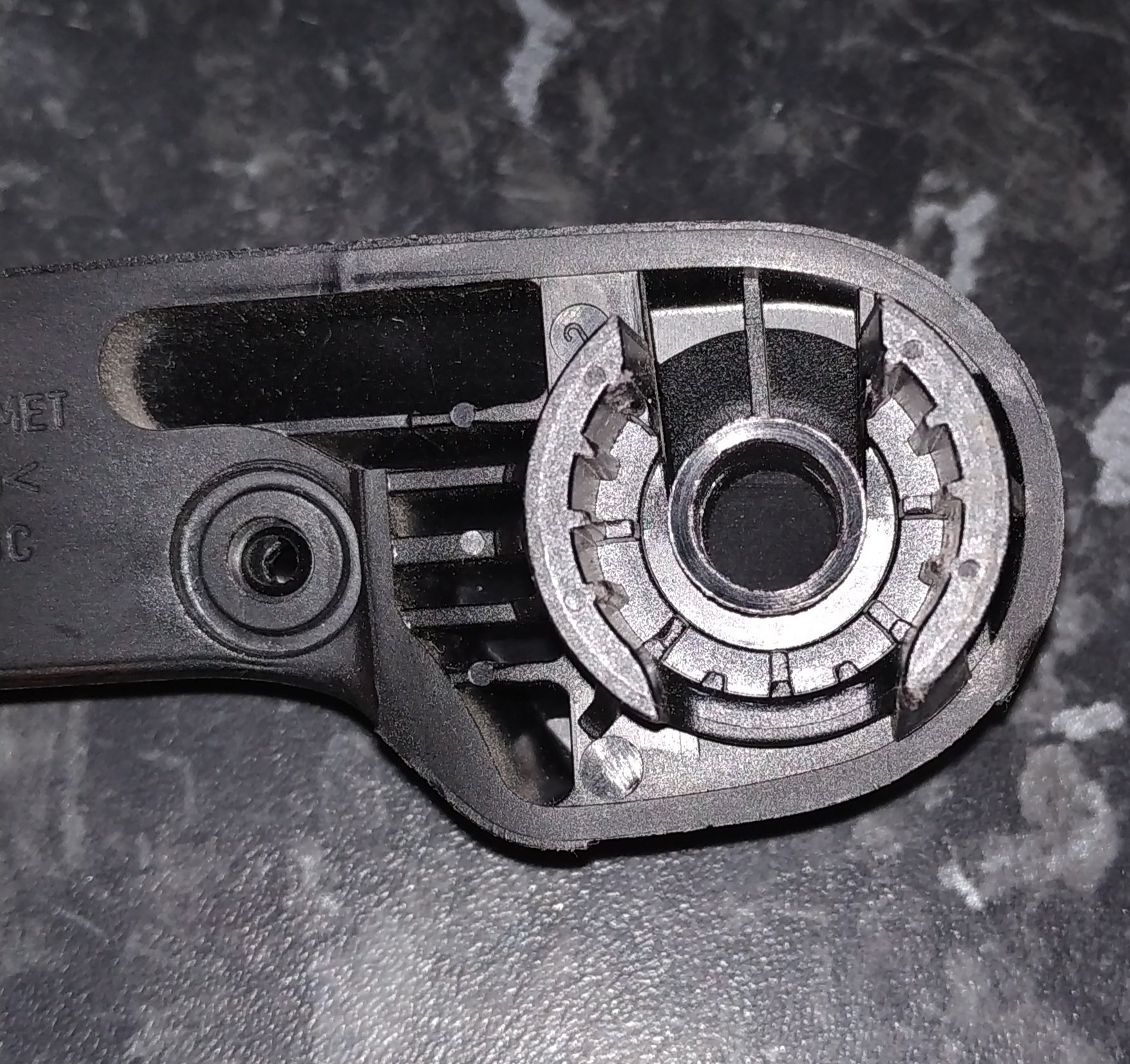

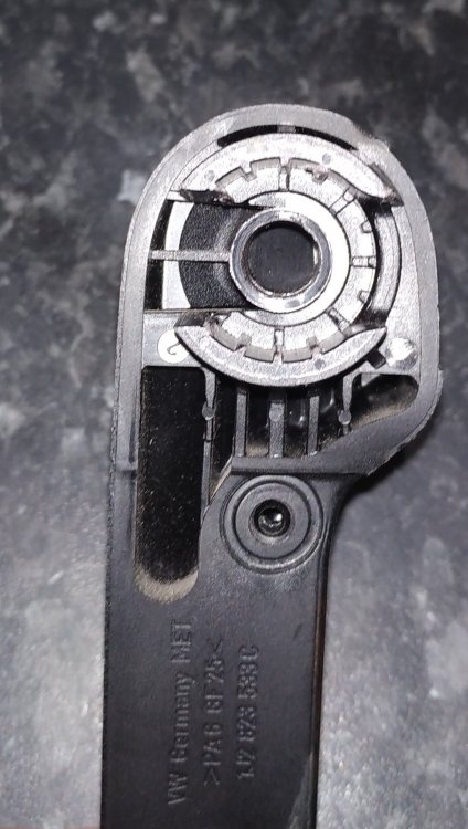

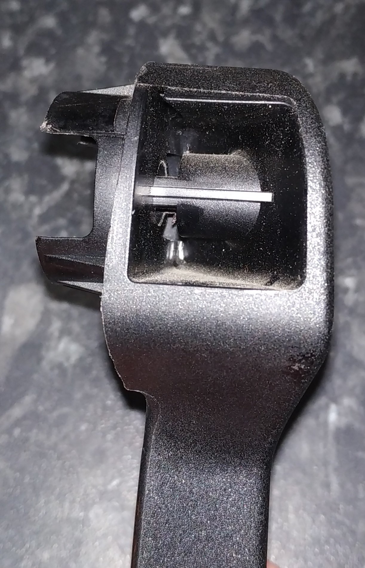

I think Iam missing the clip must have gone long ago. Can it be bought separately or just a complete new handle? I have added some pictures of just the handle close up last is the aperture.

Thanks for that I just lifted the par number of my part also in the pictures same as your part number bar a single digit guess that's the trim colour 1J2 823 533C
Ah, that's it! That final picture is where the clip slides into. No idea if you can get it separate or not, but you're deffo missing it if you have nothing that fits in there. Would imagine it's either a whole new handle or a trip to the scrappy... and one off ANY octy down there!
That cutaway bit you can see on the left hand side of the central spine as you look into the gap is what the clip, erm, clips around. Sort of works like a circlip of sorts, if that makes sense, and stops the handle from dropping off the spigot fixed in the car which you push the handle onto. When you get one and see it, you'll get it straight away before you even fit it! ;)

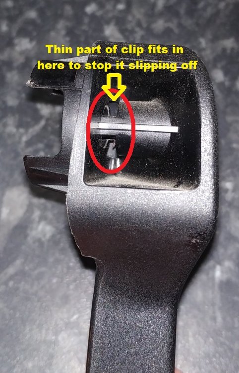

Here you go, now you can see the clip properly. :)
https://www.ebay.co.uk/itm/SKODA-CITIGO-FABIA-II-OCTAVIA-ROOMSTER-HOOD-BONNET-RELEASE-HANDLE-1J1823533B/192363167043?epid=3009417063&hash=item2cc9bcfd43:g:-gkAAOSwPzhaCXrG
The lesson here is if you think a part is broken, put in the part number on ebay and see what comes up... it may show you what it's supposed to look like! :D
Good find there :)  And it's now clear exactly what the clip looks like and I agree an e-clip is not the best answer.
