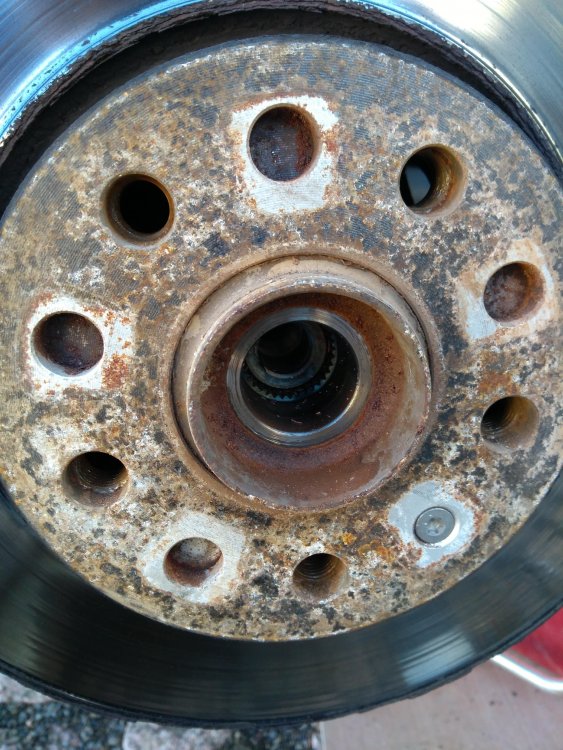

1 remove road wheel to allow the removal of the wheel centre cap.

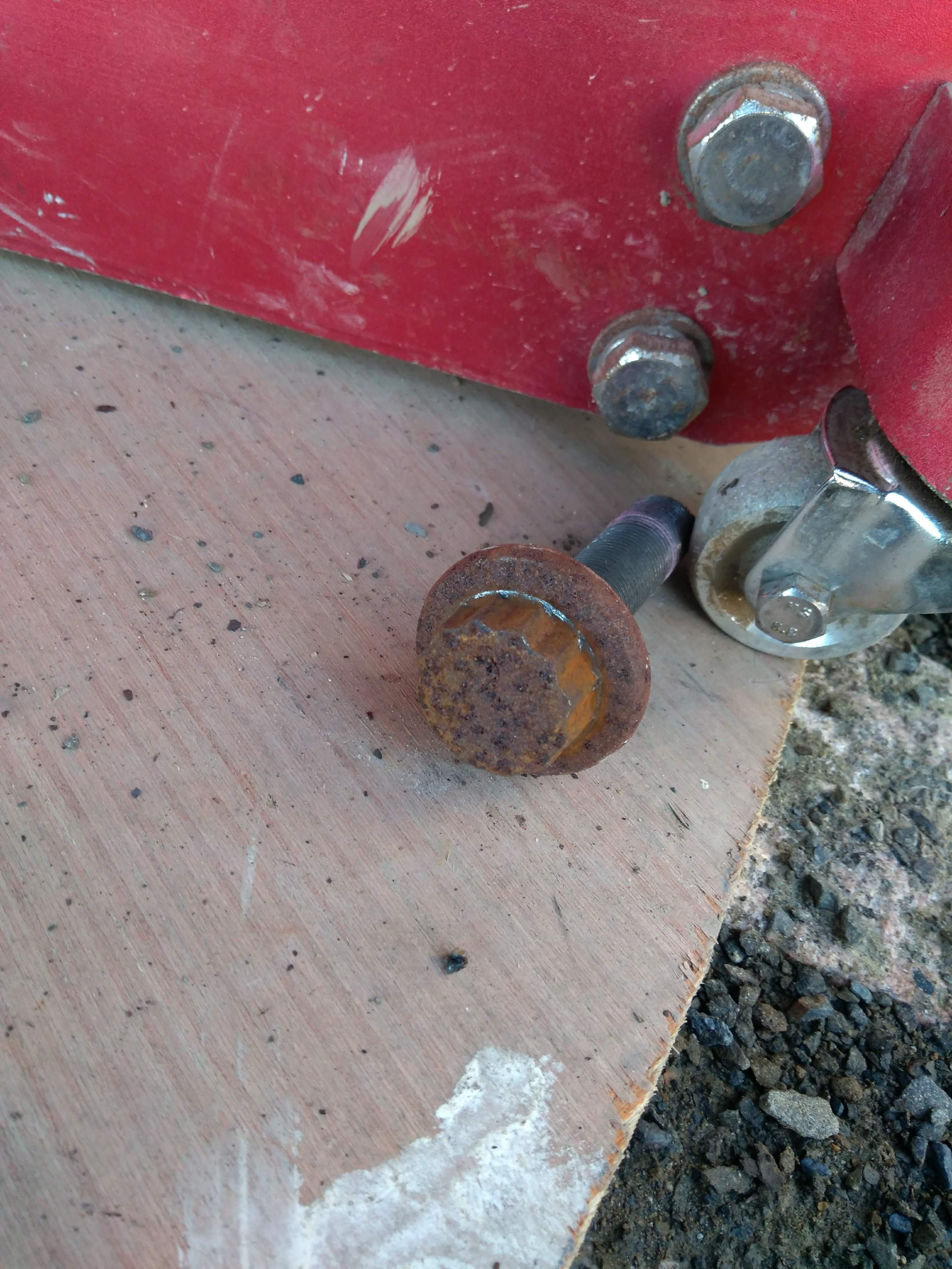

2 Replace and lower to allow the removal of the hub bolt when the wheel is on the ground (you could apply the foot brake). The original bolt was a 12 point 24mm I removed it with a 15/16AF.

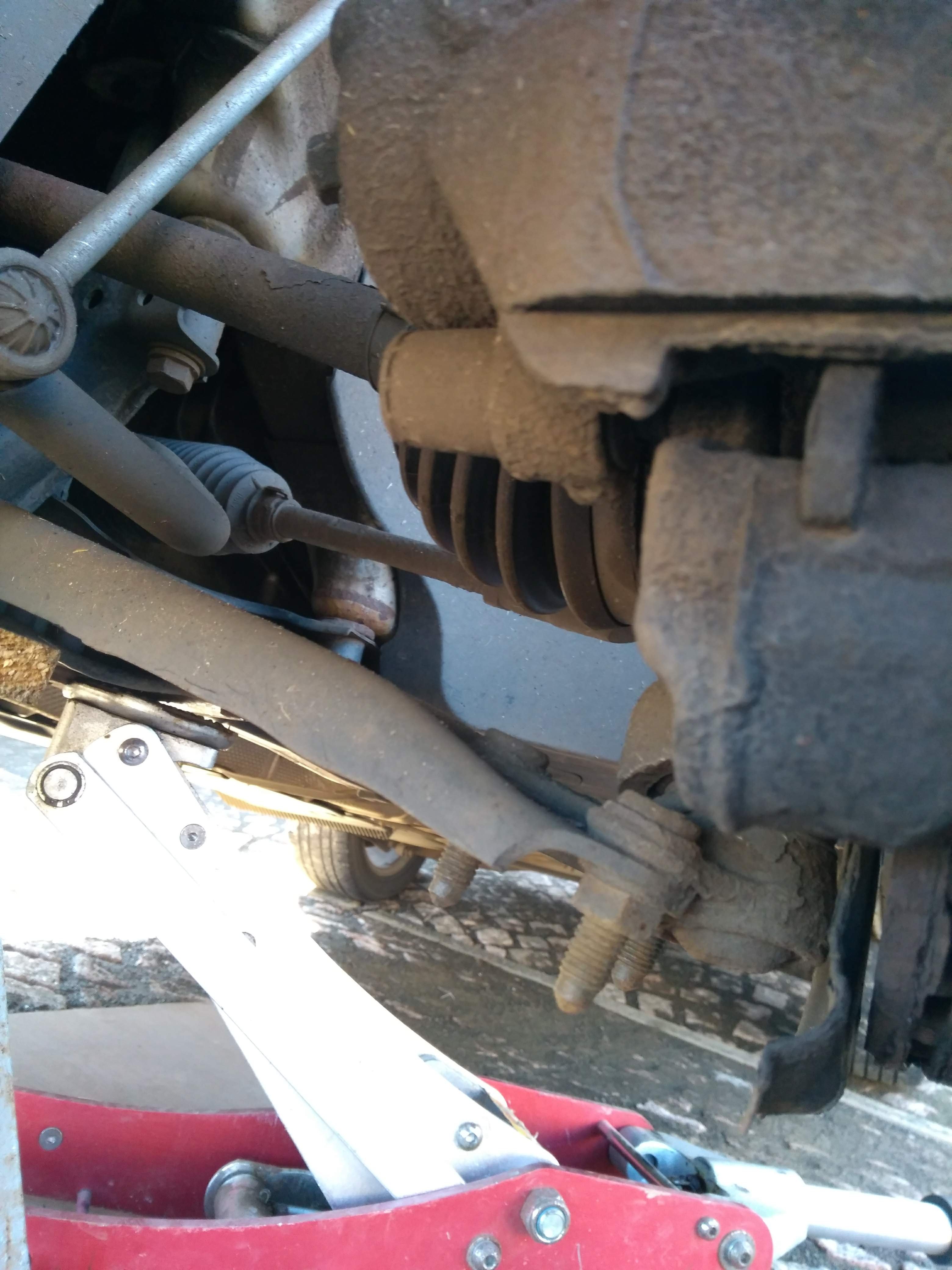

4 Remove the three 16mm lower ball joint securing nuts (photo).
5 Push down the wishbone and pull the whole strut / hub assembly out and off of the CV joint (you may need to turn the steering). The inner CV remains attached and there is plenty of room to work I rested it on the track rod end.

7 Hold the CV straight and screw in the old hub bolt until it pushes the CV off its retaining circlip.  This will take some force, I used an impact gun.

11 Pack the new CV with grease and install onto the driveshaft.  I screwed in the old bolt and gave it a tap with a soft faced mallet to get it over the circlip.

I tried to hammer the old CV off at first and got nowhere, using the old bolt worked best.

The new hub bolt may be a different size.
