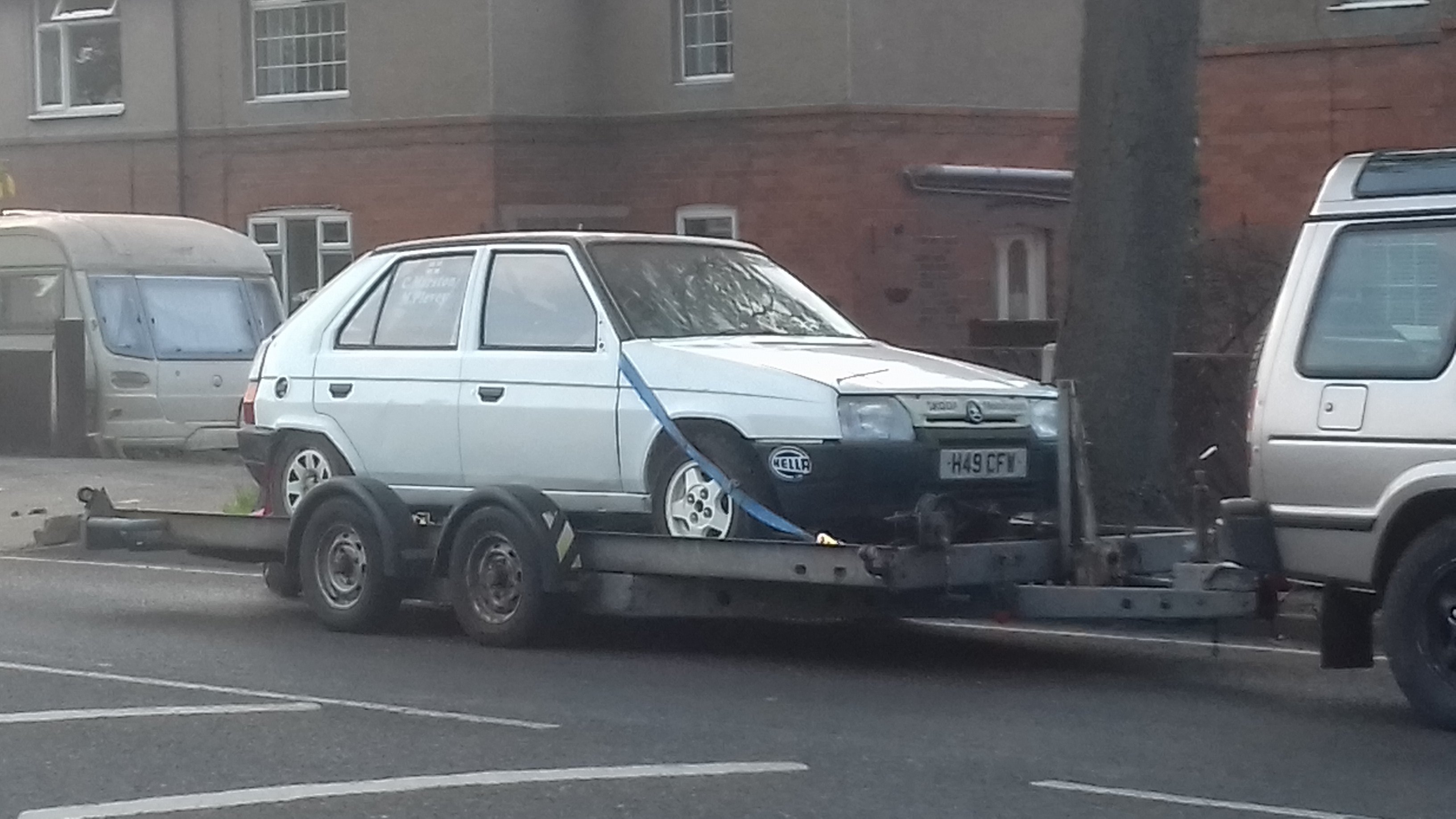

The first photo shows the car going through the watersplash at Chatsworth House on the 1994 RAC The start number was 166. If anyone is able to share any photos of the car I would be very grateful.

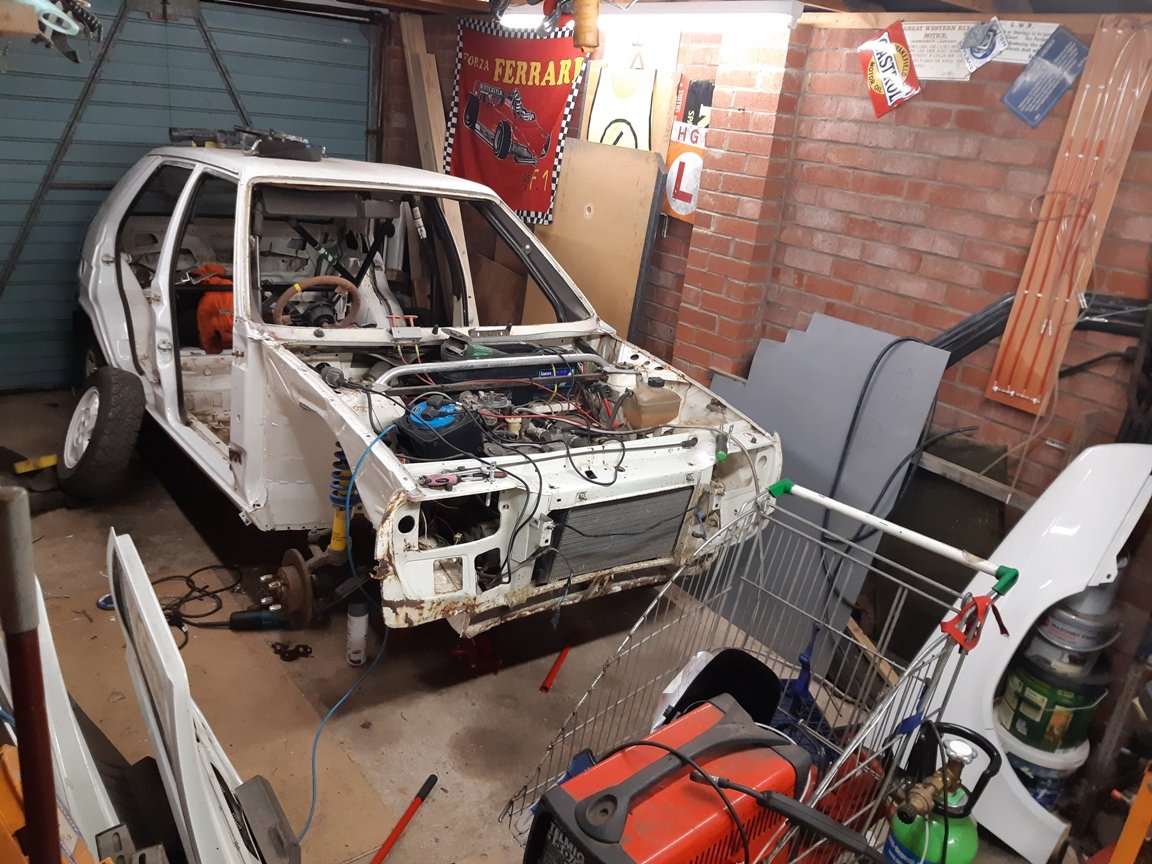

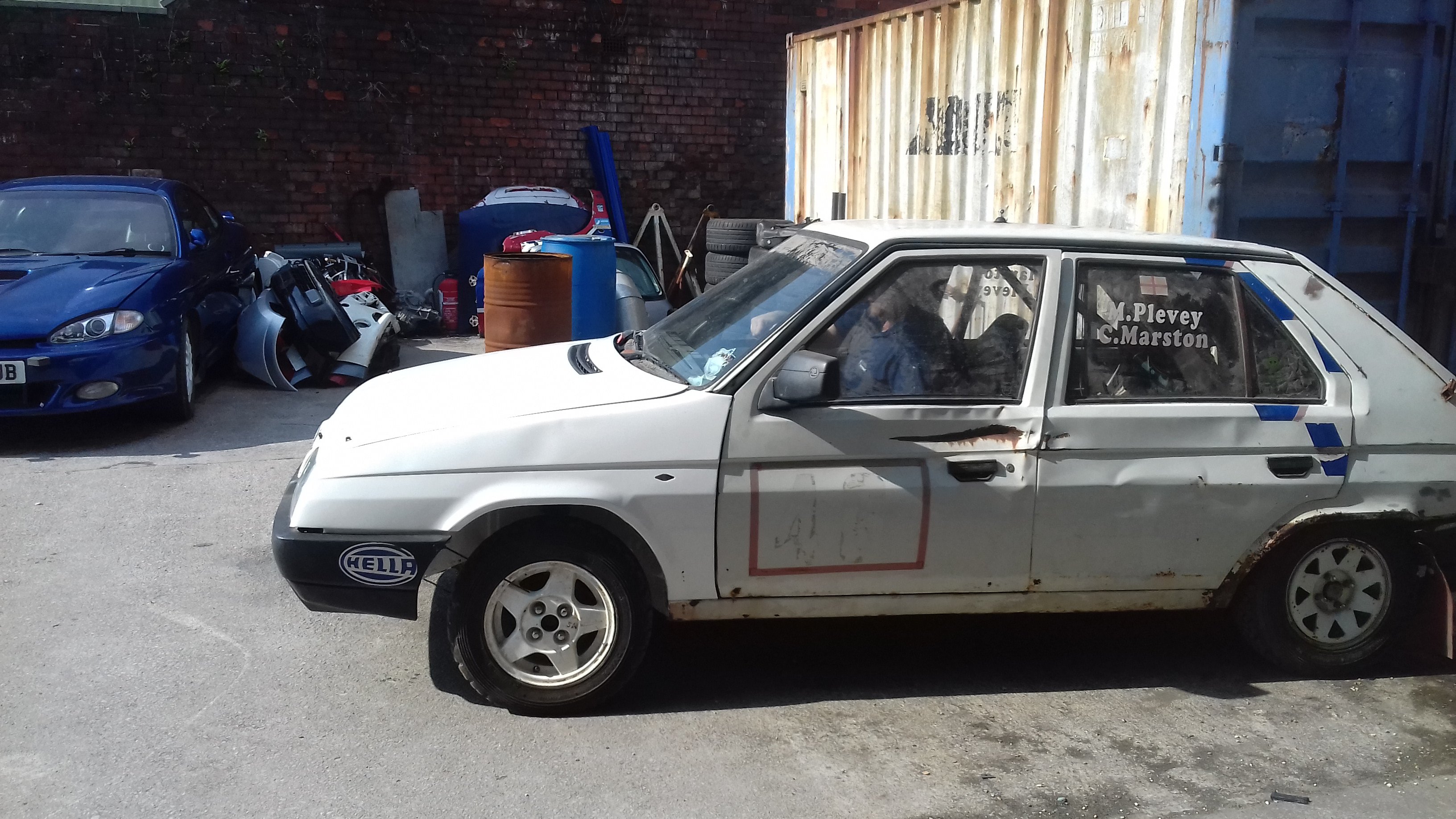

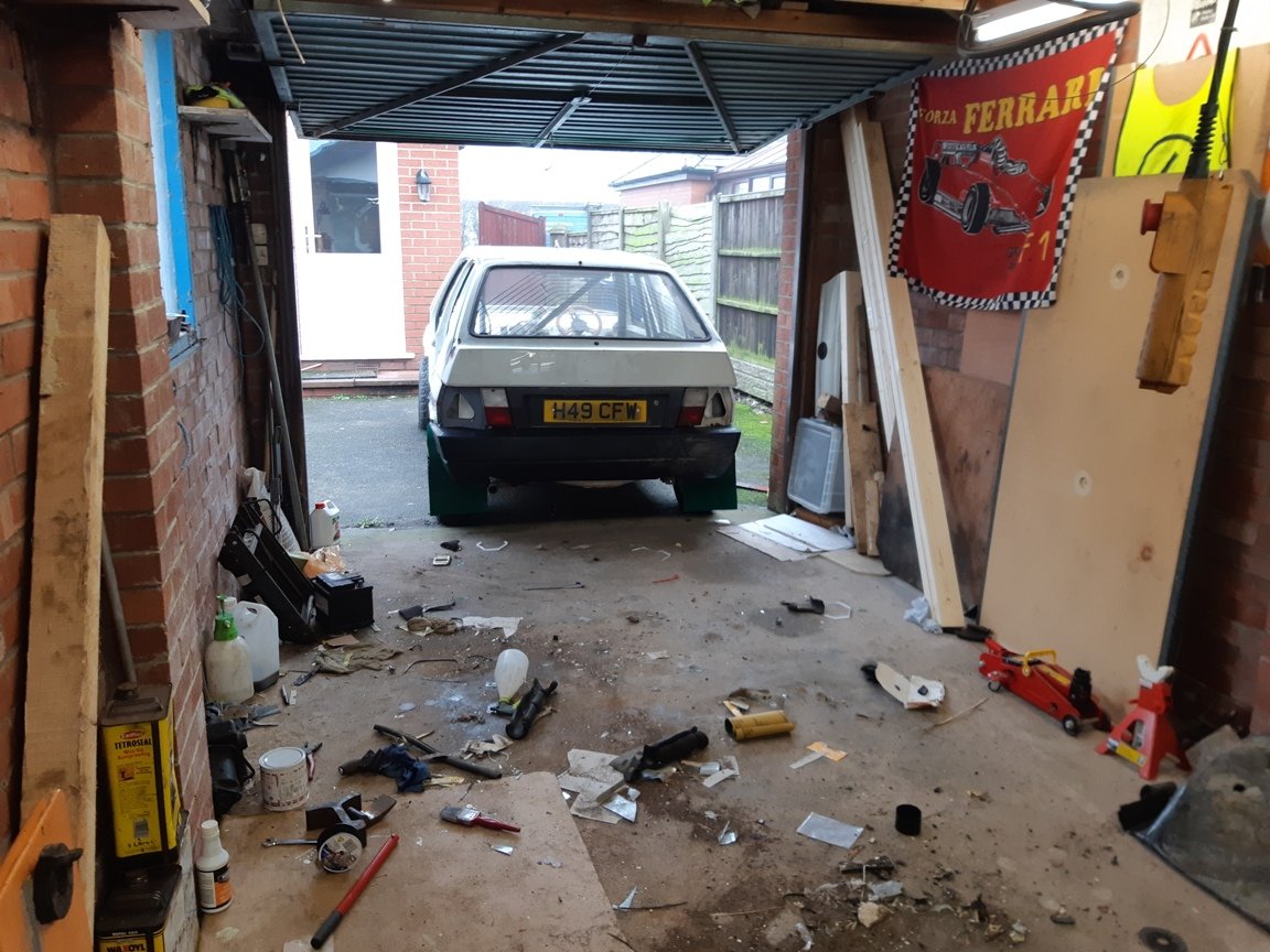

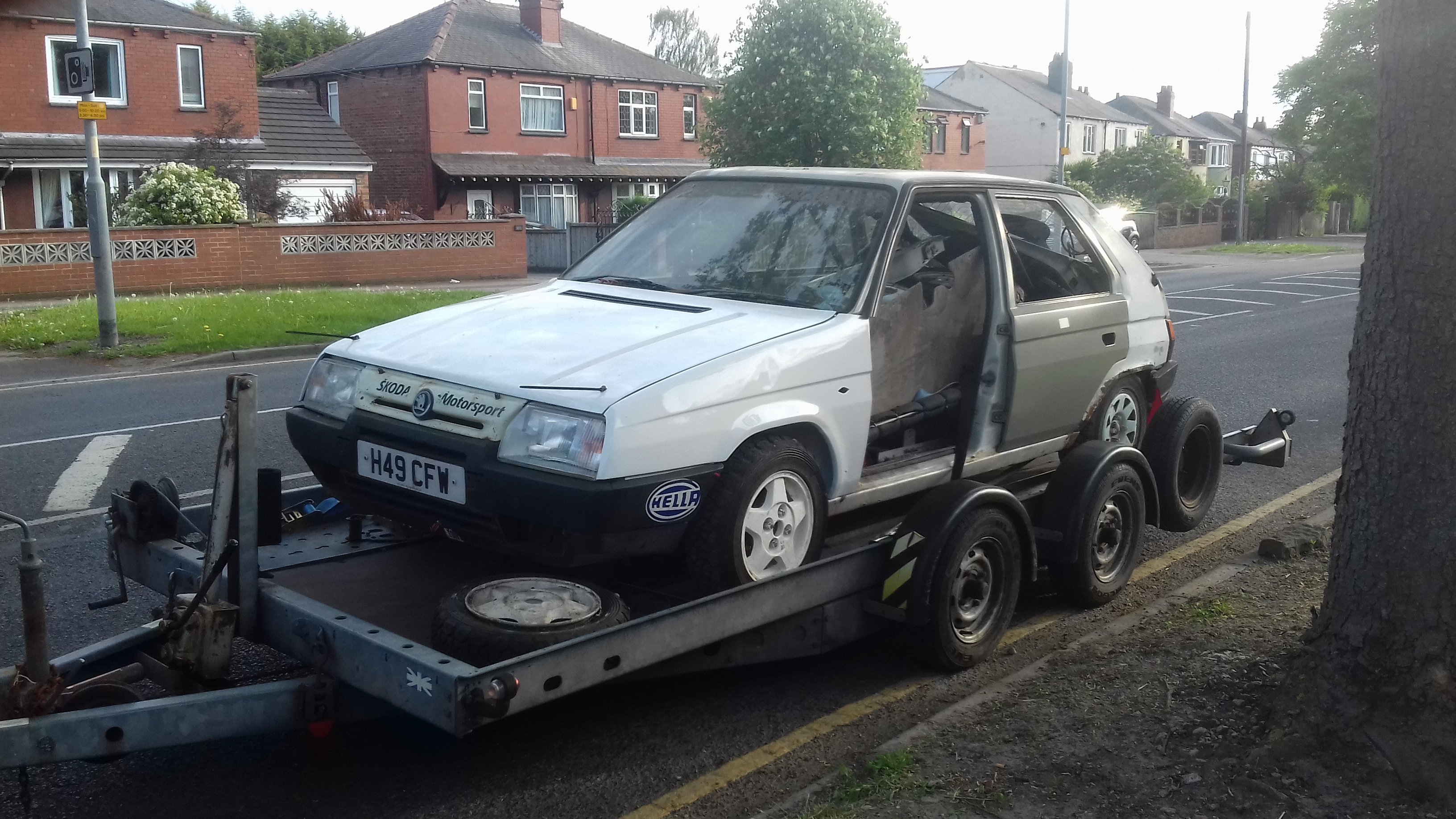

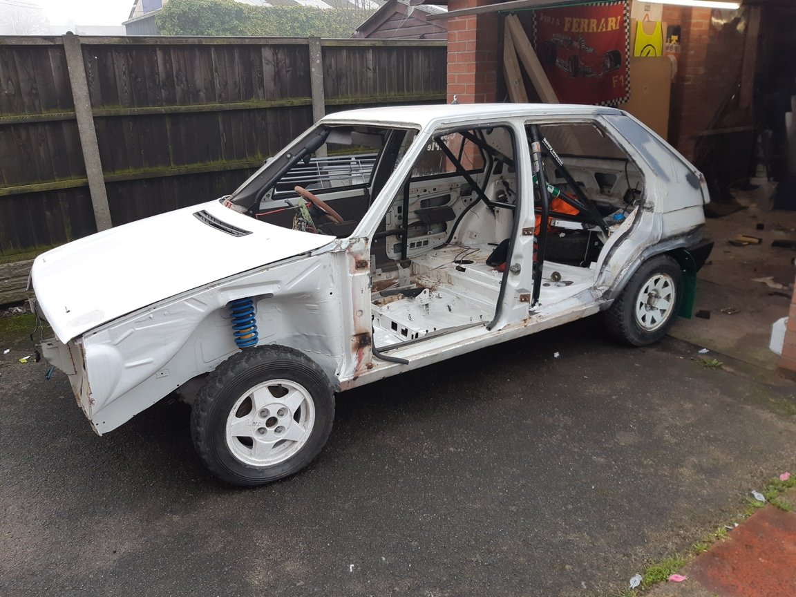

The second picture was taken on collection day back in May this year.
The previous owner had started a restoration and had completed the drivers side before he put the project on hold, the doors on the passenger side were both damaged and the rear arch needed attention. The third and fourth pictures show the less tidy near side.

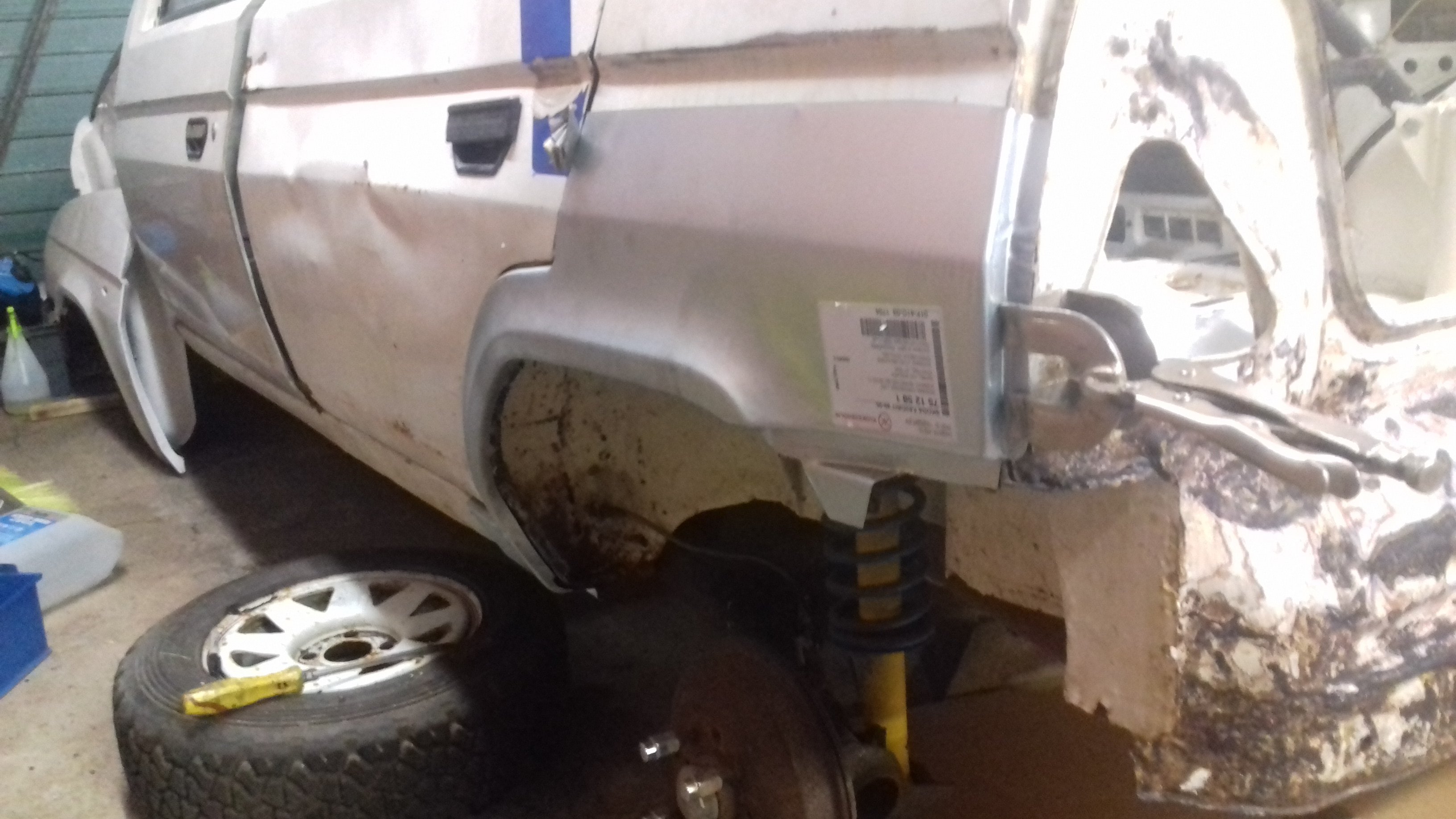

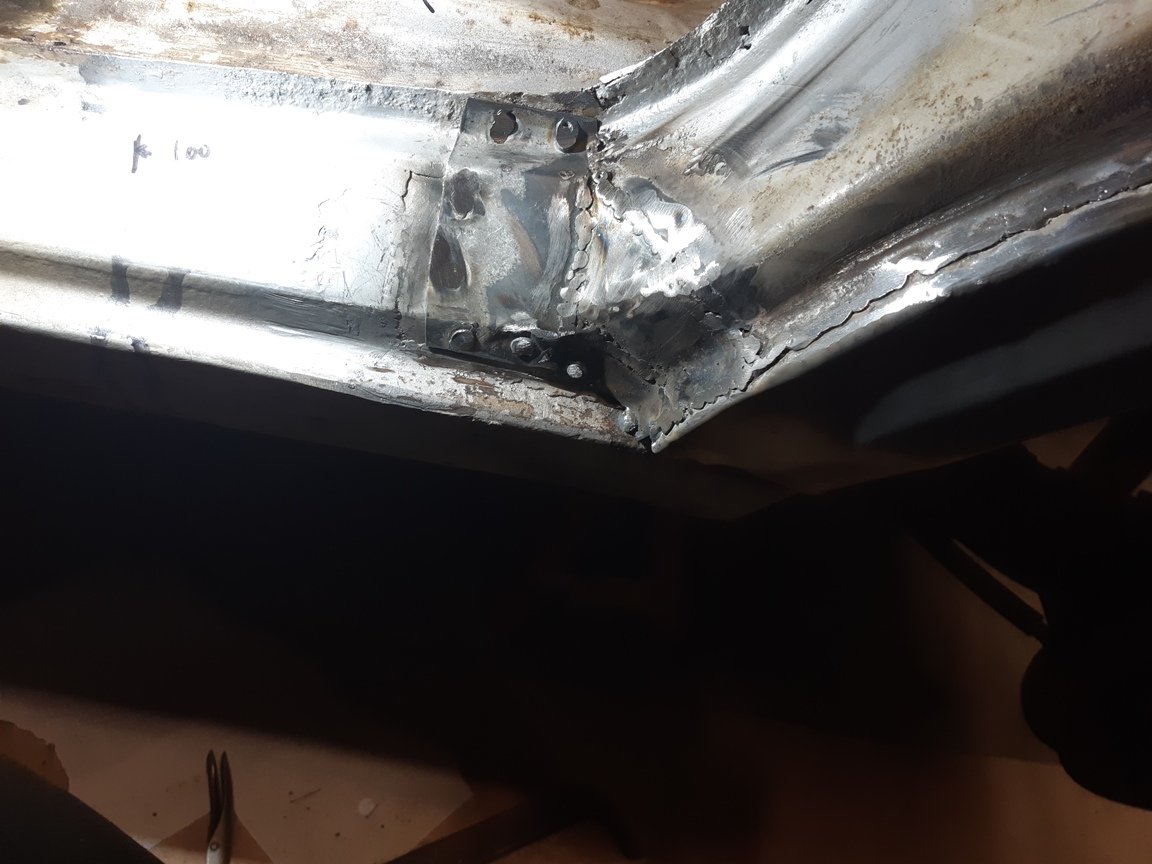

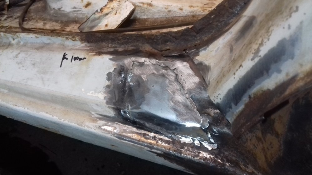

For its age, and the abuse H49 has undoubtedly endured during its active career  the bodyshell is in amazingly good condition with only a few tears in the floor pans. However the nearside rear quarter was quite badly corroded so this is the area I will start. At some time in the past a replacement quarter panel has been fitted most probably due to accident damage. Unfortunately very little if any paint was applied to the inner faces of the arch panels which resulted in the corrosion I am now in the process of cutting out and replacing with parts cut from a pair of repair panels I bought.

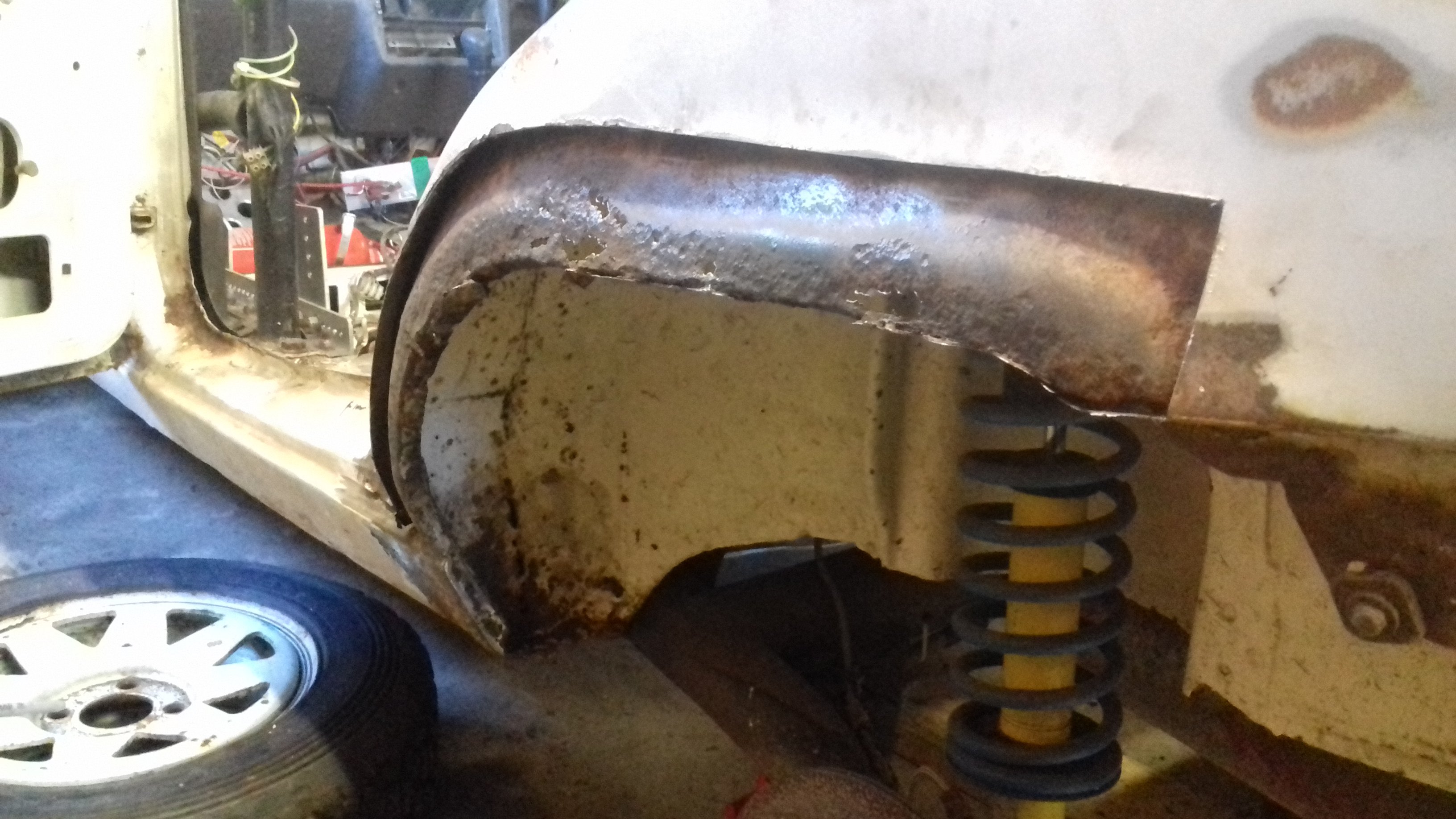

Picture 1 is the state of the inner arch after I sliced the outer panel off. 926

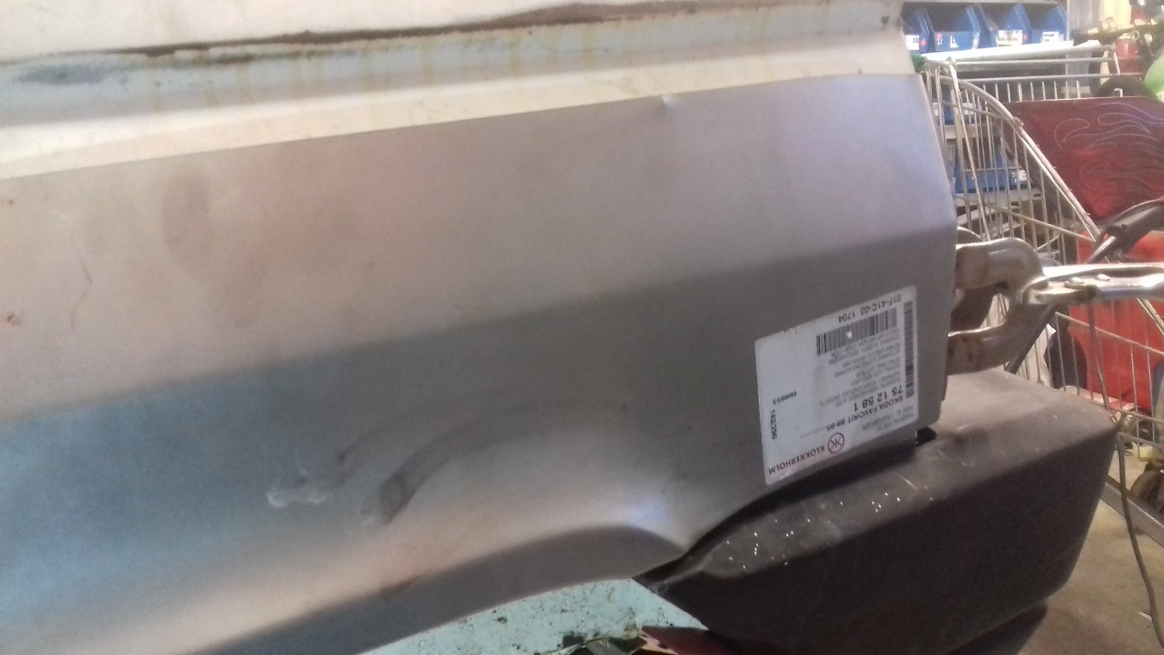

Picture 2  is a sneaky trial of the replacement outer repair panel which I am sure will fit much better when I have finished.746
Picture 3 is with the inner repair panel in the process of being cut down to fit into place.749

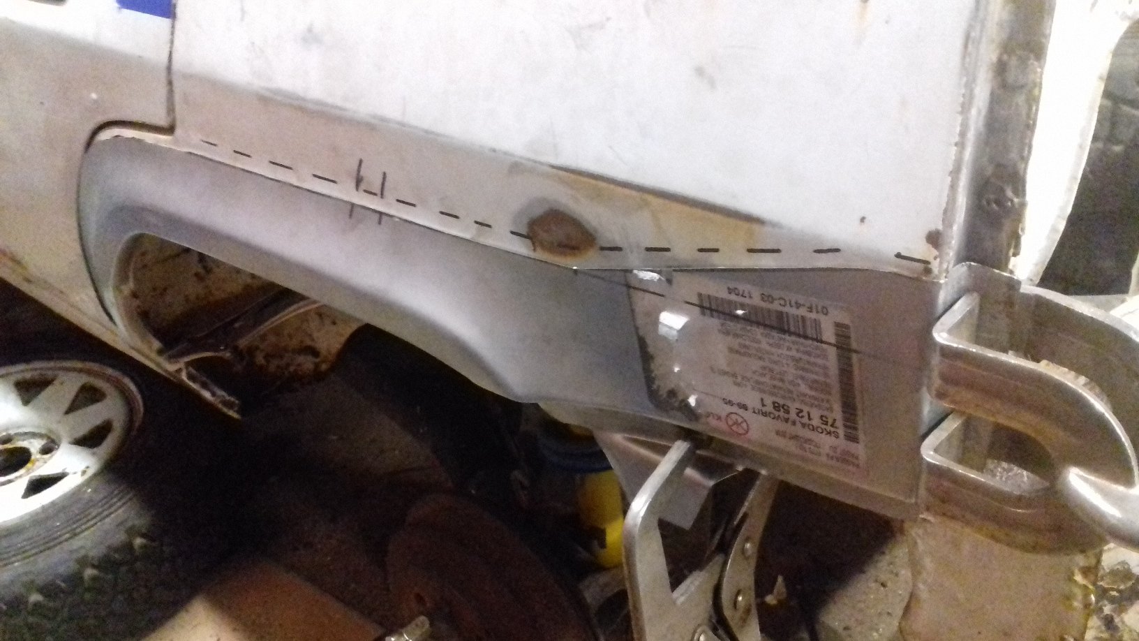

Hi All

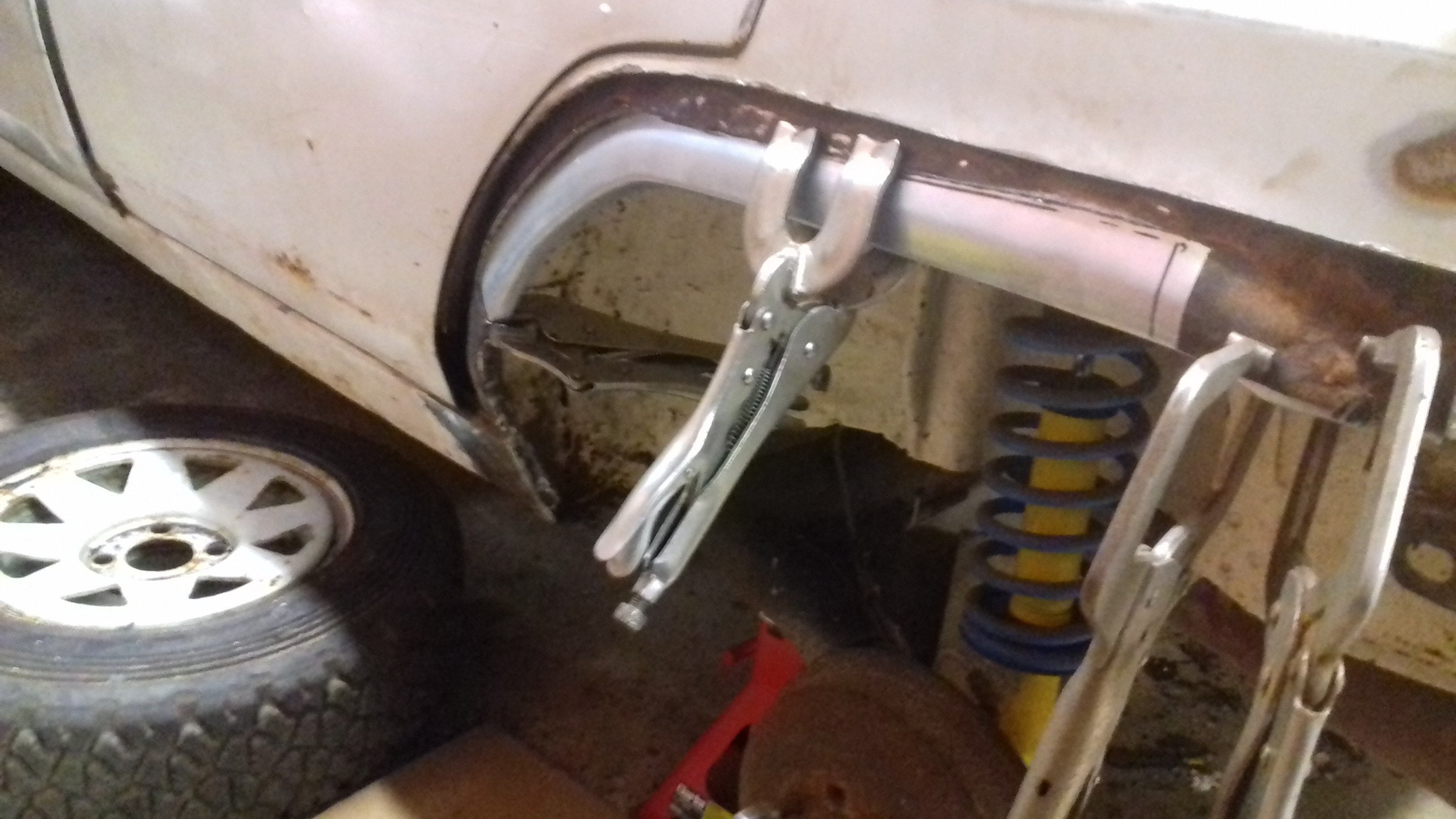

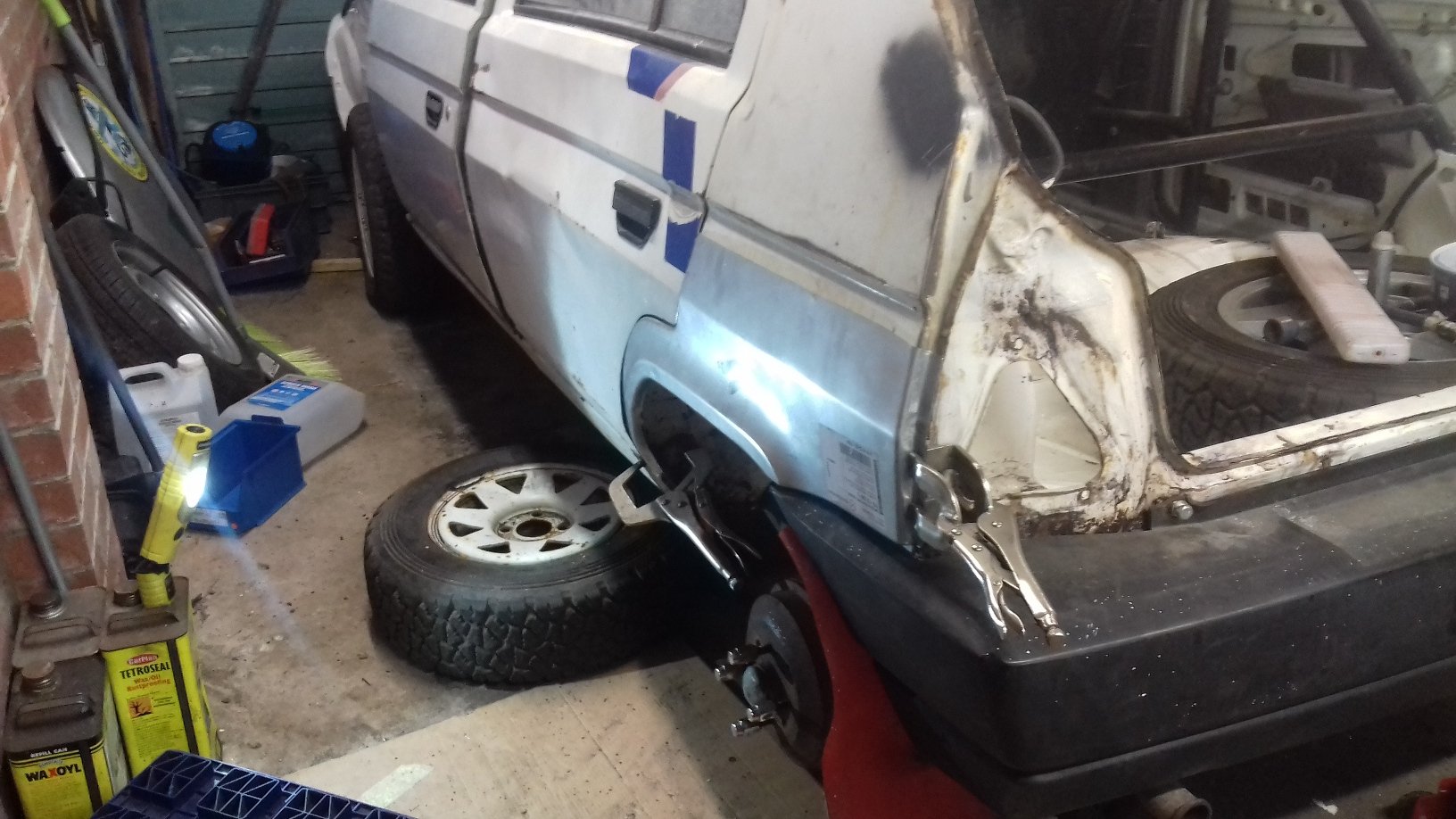

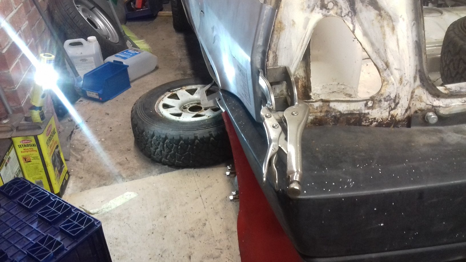

I spent a productive afternoon on bodywork repairs to the Favorit.  I made little plates to fit and fill the old redundant bonnet pin holes, tack welded them in and added a little filler to level the repairs. I also made new spare wheel well bungs and welded them in. The originals were missing. Sorry I forgot to take any interesting pictures of these 2 jobs.
I spent the rest of the afternoon repairing fully the inner arch lip where I cut it back due to rot. I trimmed the repair panel to fit my needs and then very nearly got it welded in. I failed due to a lack of gas. So with the inner lips position now fixed I started to trim the outer repair panel again to fit my needs, I do not need or want to fit the entire panel.
The first three photos are with the bumper fitted back to see how everything lines up. I was very happy with how close everything fitted. This is after all a cover panel so I did have to reduce the rear flange standout. I will also have be creative around the door opening.
The forth photo is after I had started to reduce the outer repair panel's size.
Sorry for the repeated use of the same camera angle witch is not even a good angle but I am restricted by my garage's dimensions.

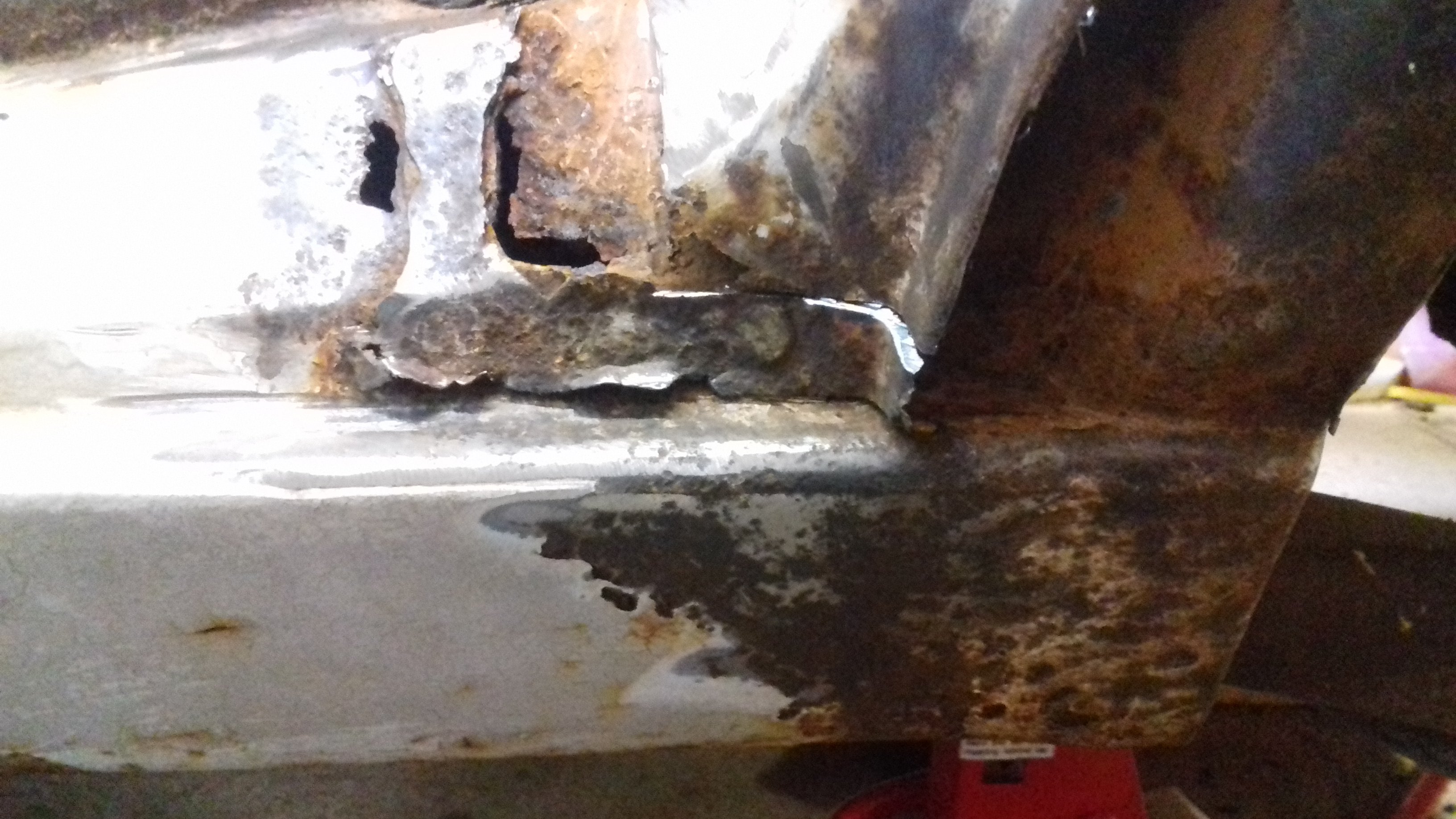

Hi All

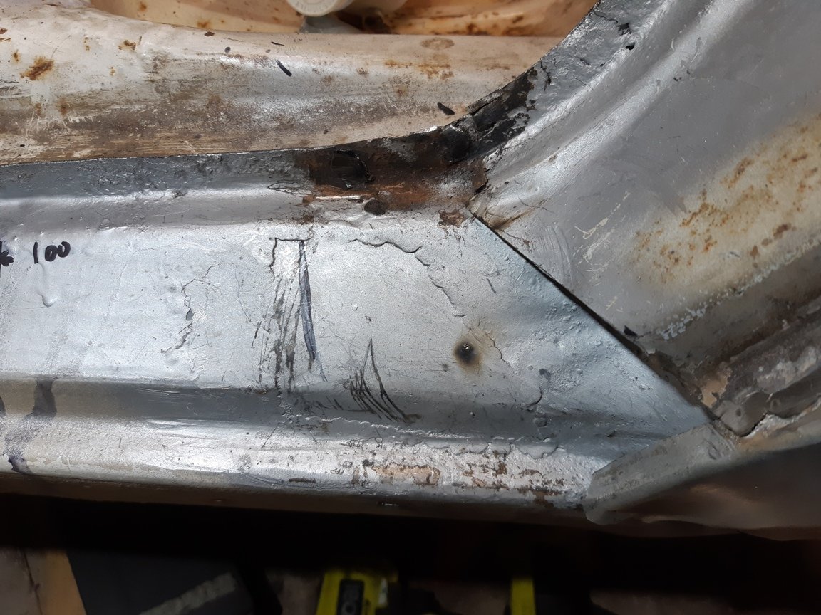

So with more gas bought it was again time for some welding. Firstly I finished welding the arch lip from Saturday.  Next I trimmed the repair panel to perfectly fit the areas of the outer arch or quarter panel which I have had to cut out. I also cut this outer repair panel into 2 halves, I hope that this will greatly ease fitting time will tell.  The photos tonight document the fitting of a repair piece to the rear end of the cill where it had corroded again due to a lack of paint when previously repaired.
The first 4 pictures are taken during the cill repair.

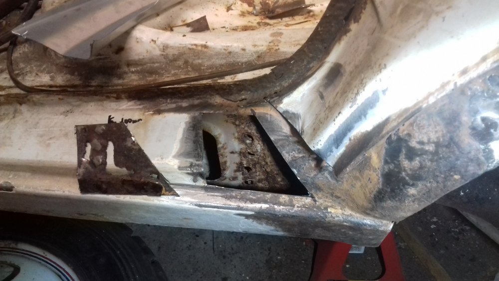

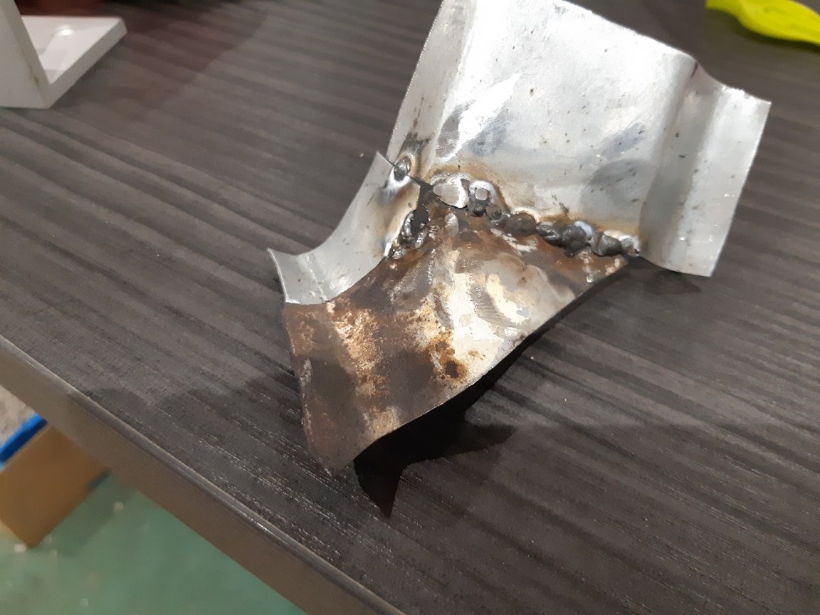

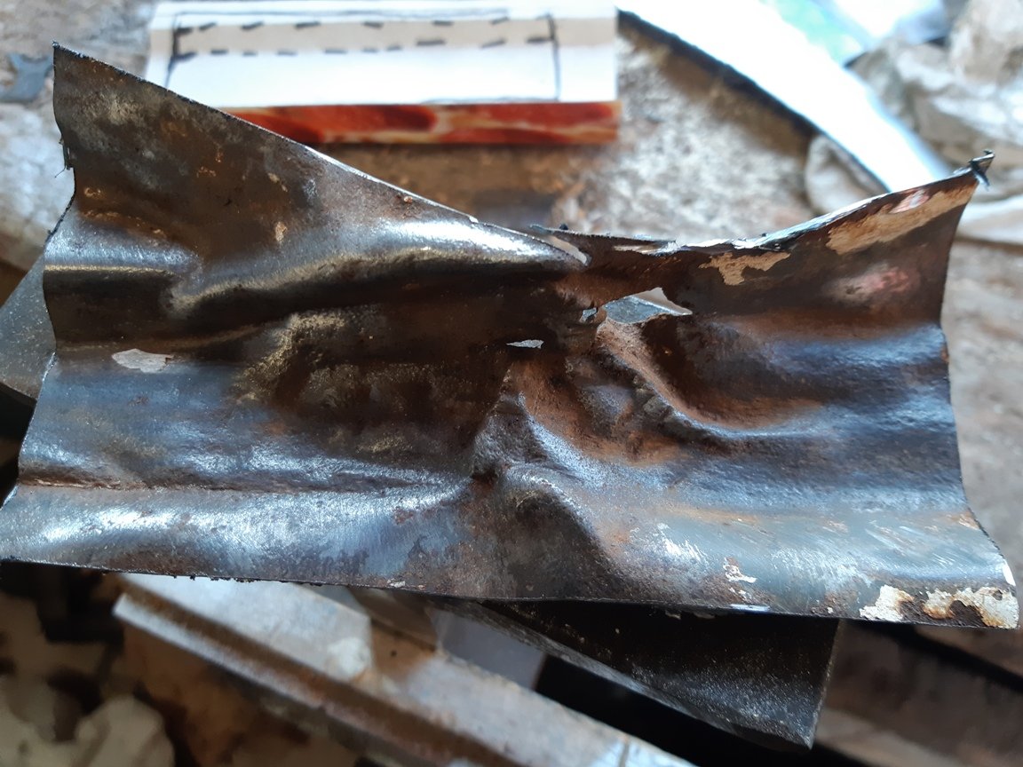

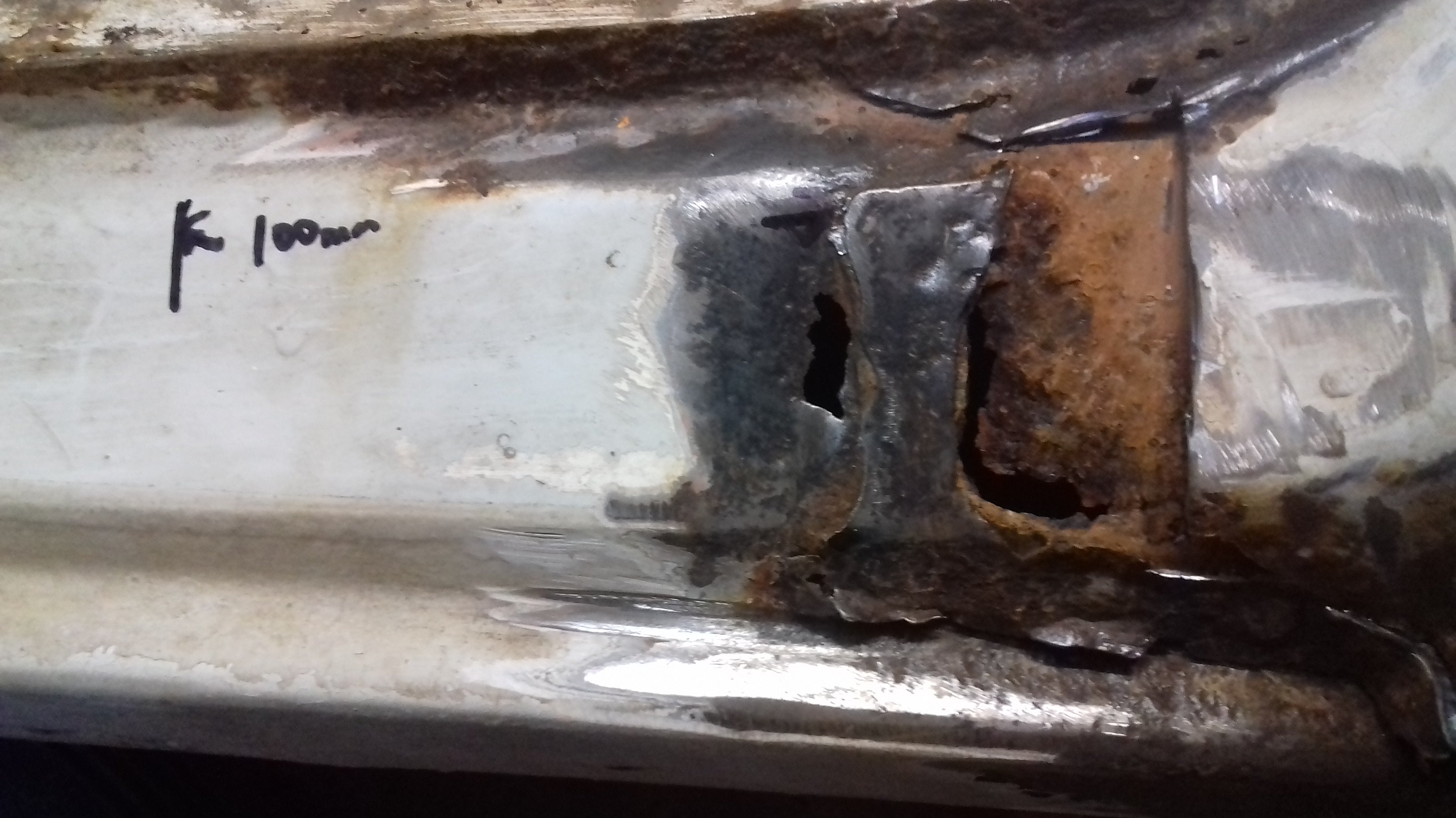

I spent the afternoon trying to get the quarter panel finished, it keeps fighting……..
I got the last of the welding of the arch repair panels finished, leaving just the final little last piece to recreate. Unfortunately this little piece is not included with the repair panels I had bought.  I had 3 attempts to try and create it, the many compound curves always defeating me. Finally I decided to try incorporating the reasonably solid part of the arch curve, which I had only cut out to gain access to the cill top repair panel that I remade the other night, see the first photo below. Using this piece lead me into making the repair piece in several parts, rather like a 3D jigsaw, which then proved far easier than all my previous attempts. I now just need to weld it all together on the bench, dress it up, de rust it, weld through primer it and then finally weld it in place. It will need some filler to make it look acceptable but not much more than a thin skim.
The other pictures show the repairs needed in this area.

I was going to suggest doing a fillet like that using "Cardboard Aided Design".
Cracking project, good progress and look forward to seeing updates
Thanks for your replies guys, its good to know my posts are reasonably interesting.
All attempts involved CAD, the problem was a lack of the required skills to form the shapes in metal........
Anyway the part spent the day de rusting in some cider vinegar which I find works very well, I welded it up tonight and will flap wheel it smooth when I get a new flap wheel tomorrow. Then weld it in place.

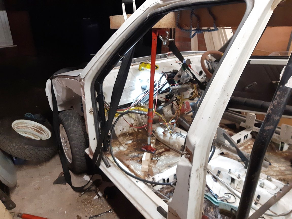

Now that I can move on from the outside bodywork I can make a start on the floor pans which are quite battered but only have a couple of tears and splits. As far as I can see so far there is surface rust a plenty But NO ROT :call: so a bit more welding perhaps the odd panel to be let in and it will be a proper job.

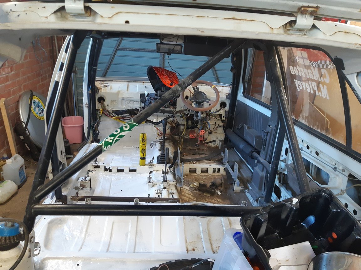

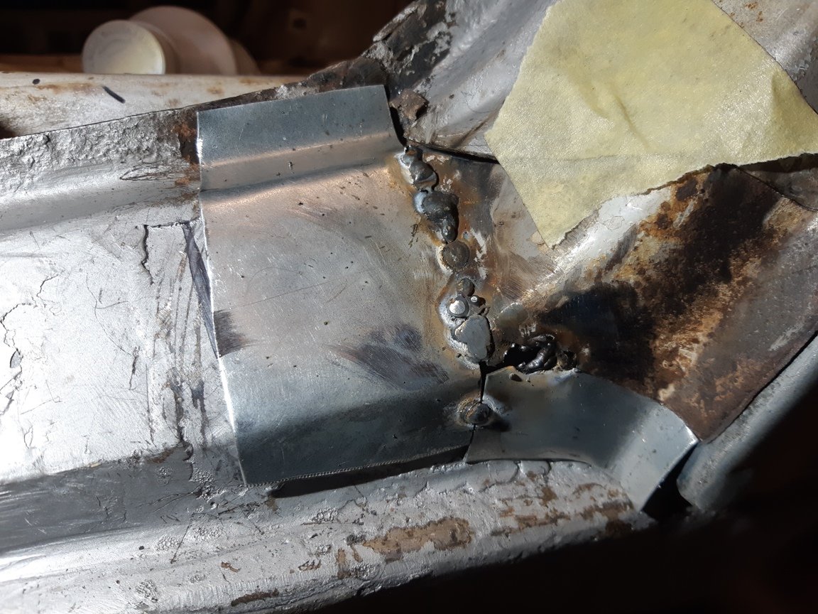

Hi All
I finally got the motivation to weld the last repair piece into the rear quarter tonight, I think there is another hours welding and tidying then I can call it finished. Because I didn’t feel like welding last night I started on the next part of the project which is cleaning and de-rusting the cabin. The brake pipes and fuel pipes also need tidying along with sorting the fire extinguishers.

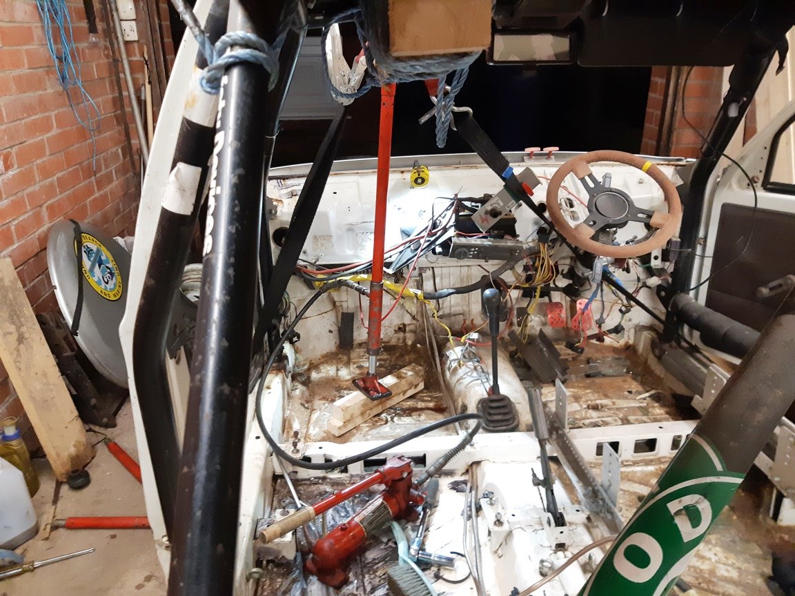

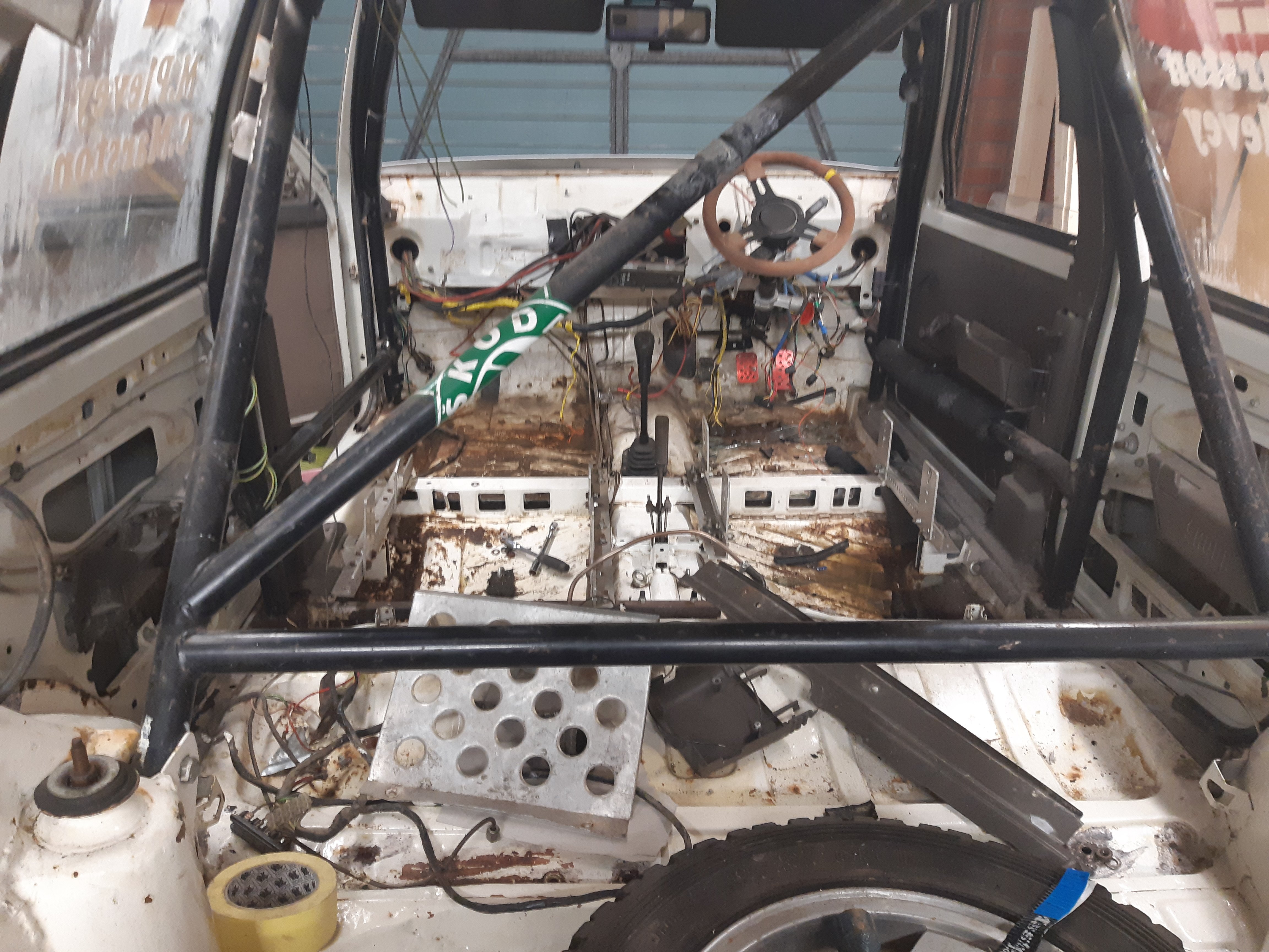

I took the front screen out (it was cracked when we bought the car) to give me easier access to take the dash out. I am glad the screen was cracked and needed replacing because it disintegrated into fairly large shards of glass that I am sure should have remained stuck to the plastic layer in the middle. I wouldn’t like to have been involved in an accident with that screen fitted and been showered with all that glass.
Whilst I will still have some holes to repair in the floors, but by this weekend the shell should be ready for the outside painting which will be a huge step forward. The painting is planned to happen as soon as possible.
The photos tonight are a general view of the interior, a close up of the repair piece mid cleanup.

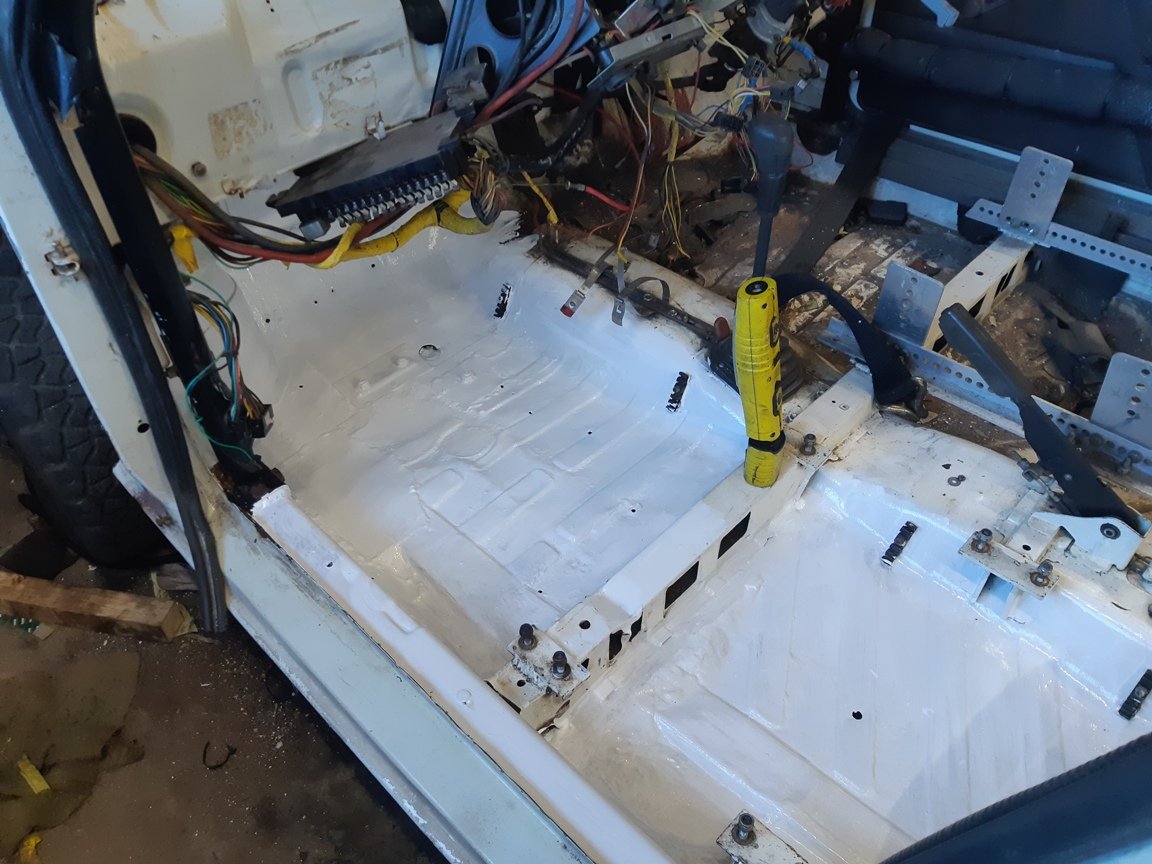

Hi All

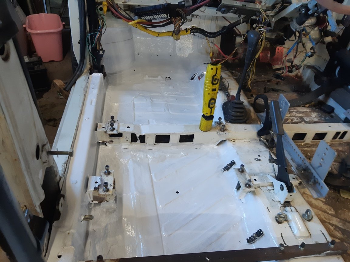

With the rear wheel arch now finished I moved on to the floor pans, seemed logical to start with the passenger rear one, it saved having to moving the tools very far……
So onward and upwards.

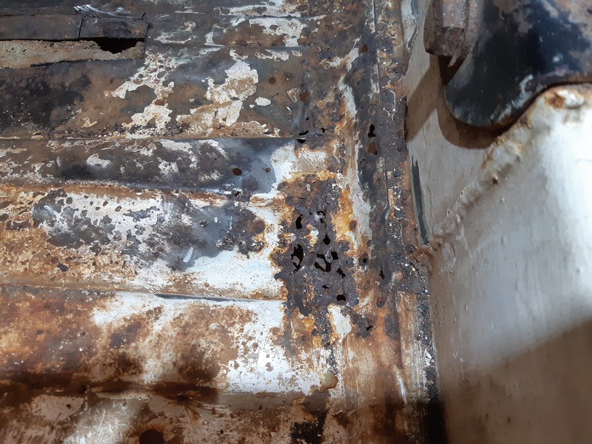

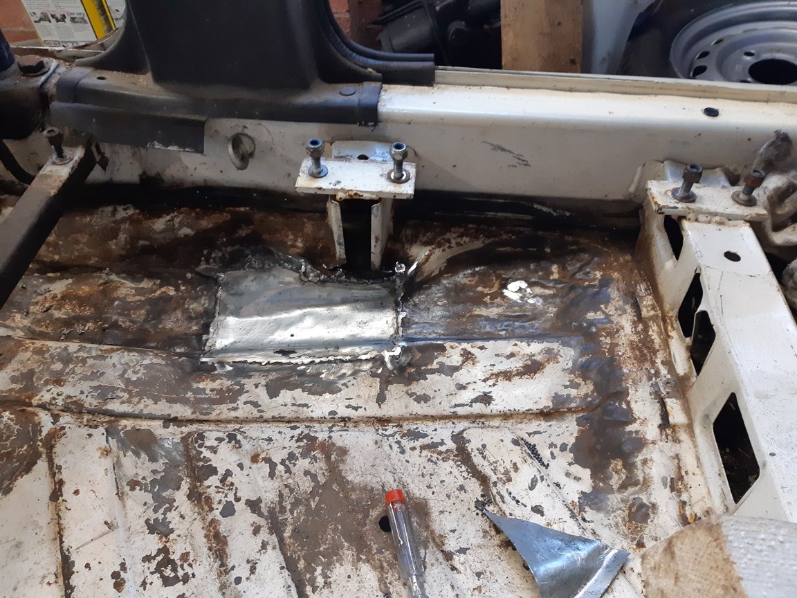

The pan looked awful, with what seemed like loads of rust and any paint left being very discoloured, however a quick rub with a cloth moved some rust revealing paint. A dawn raid into the kitchen gained some CIF multi surface cleaner with lemon smell which I applied and left to soak for 10 mins. Removing with a sponge and plenty of clean water removed loads of mud and most of the discolouring. I did this before removing the brake pipes and fuel pipes do did not get everywhere clean. The red arrows on the first picture point to un cleaned areas the green arrows point to the 2 areas that had tears in the metal. The pan was surfaced rusted but not holed from corrosion. The first repair piece had been fitted when this photo was taken. A second application of the CIF cleaned the remainder of the dirt.
The second photo is the badly battered piece of the floor I removed and replaced as shown in the photo above. As stated previously I am not fighting rot here it is the more easily repaired dents and tears from the battering the floors have received in the past. Removal of this piece allowed this area to be panel beaten back to shape more easily.
Another view of the repaired piece fitted near the seat mounting. Due to the way the competition seat is mounted further back than standard the square box section, shown with the blue arrow above, forms the rear seat mounting. Whilst I am not the greatest welder in the world the photos don’t do my welding any favours. I have tried to get more representative photos of the welding but without success. I went out to check my welding when I downloaded the pictures from my phone I couldn’t believe how awful it looked.

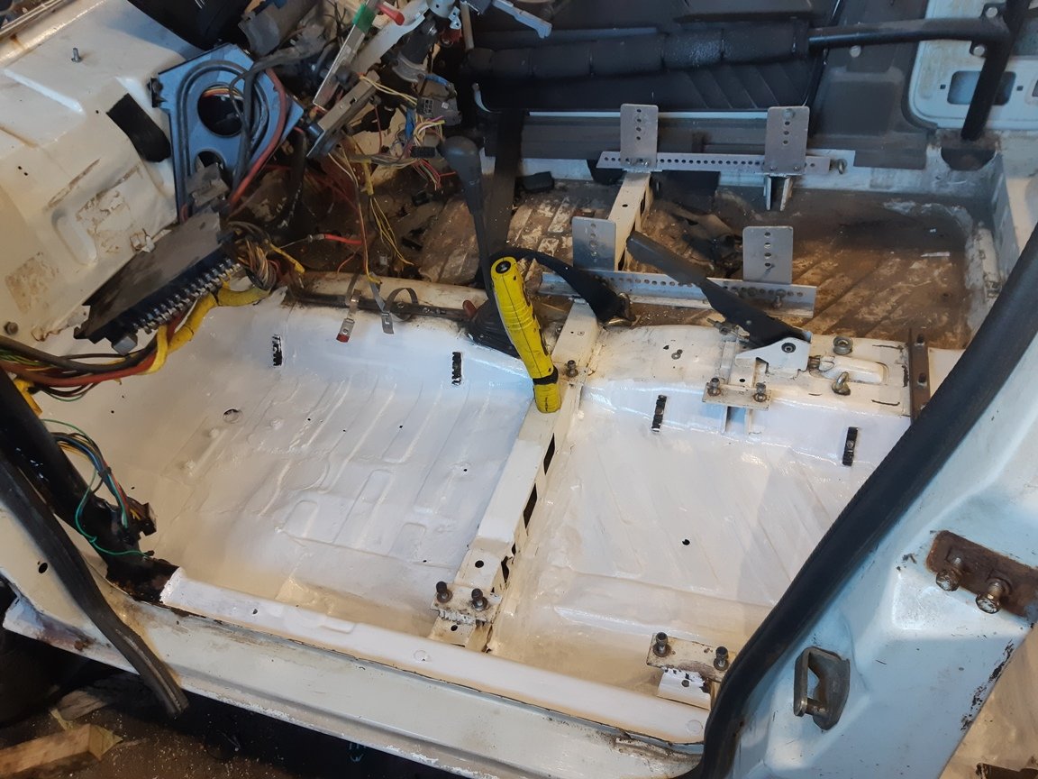

Hi All
Do they say that power is nothing without control?

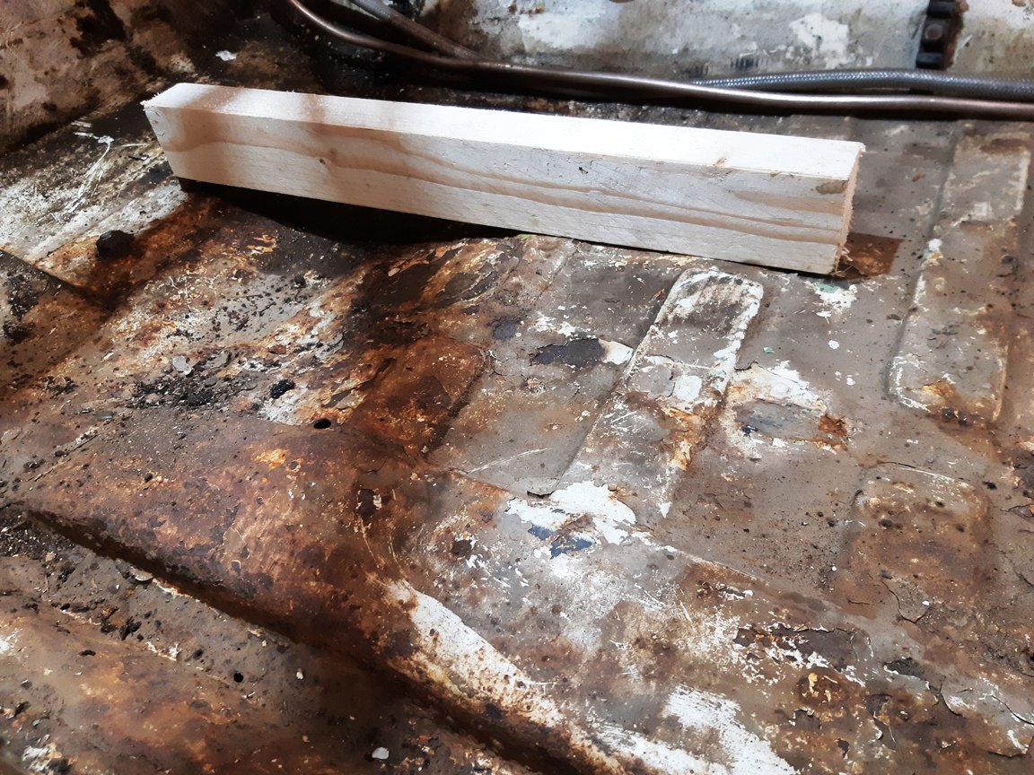

Having got the rear passenger side floor pan as straight as it needs to be and all the tears repaired it was time to move onto the front pan. So firstly the front door was removed so I now own a 3 door Favorit…….. The door removal revealed a previously sheared bolt in the lower hinge plate that will need extracting. Fortunately a small stub remains so it should come out OK with a bit of weld and a nut.
The first photo attempts to show the damage to the area of the floor above the chassis rail that is positioned behind the rear wishbone mounting. The chassis rail had been pushed up taking the floor with it. So out with my port-a-power, a ratchet strap and a piece of 6 by 6 timber I made a DIY jig, I was able to use the cage to push off, I would not recommend using the screen opening on a car without a cage. Judging by the ominous crunching I suspect the chassis rail will need some more repairs, however it already needed some from its previous brushes with the passing road.
The second and third photos show the jig arrangement.
The last photo fails to convey that I have moved the floor down somewhere between 30 and 40mm. It also shows how much of the “rust” was removed with my trusty CIF.

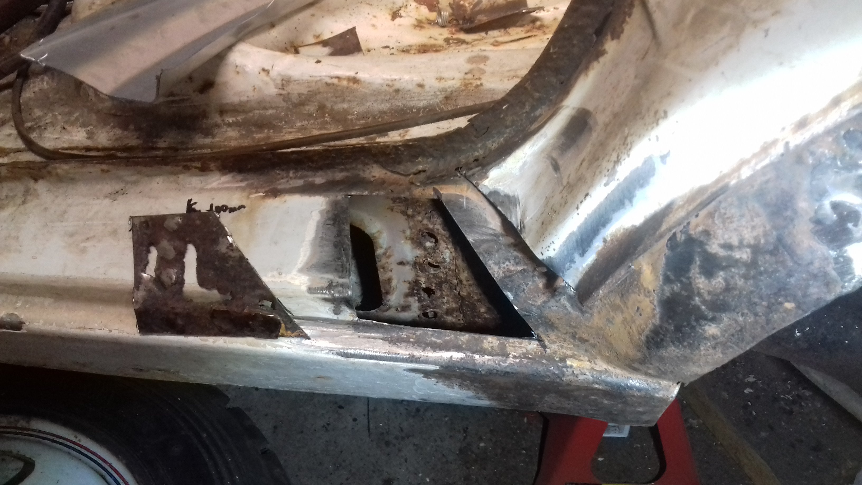

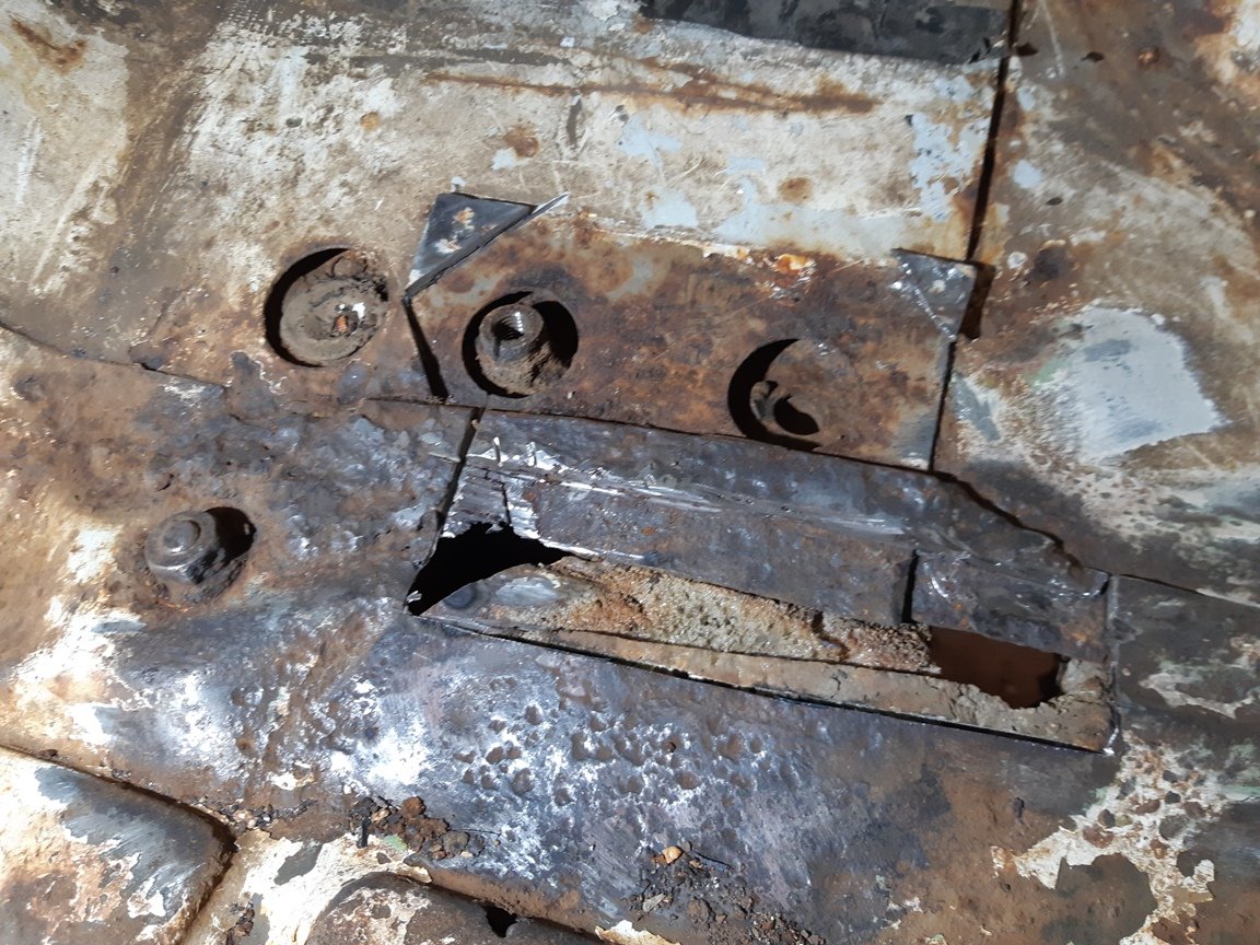

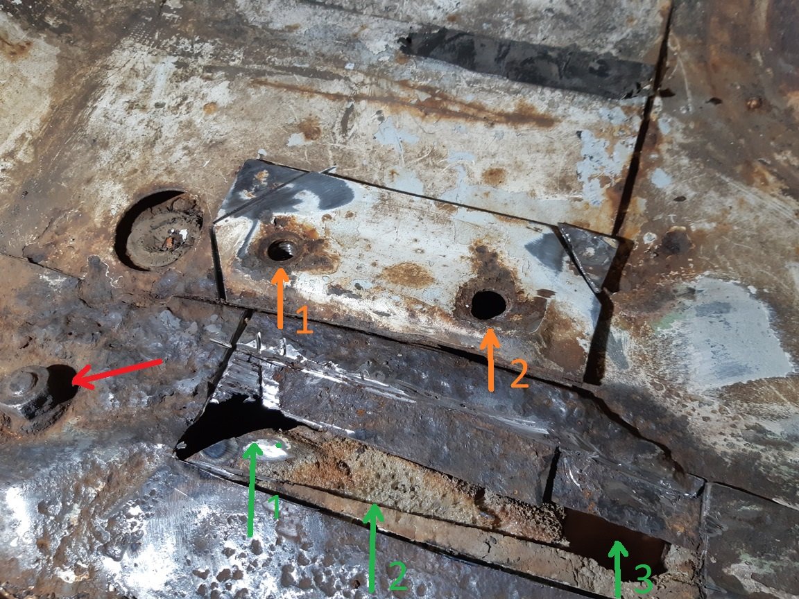

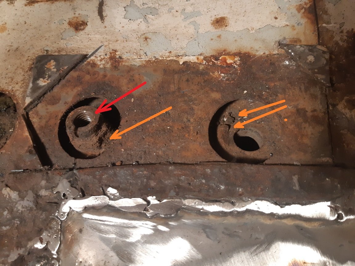

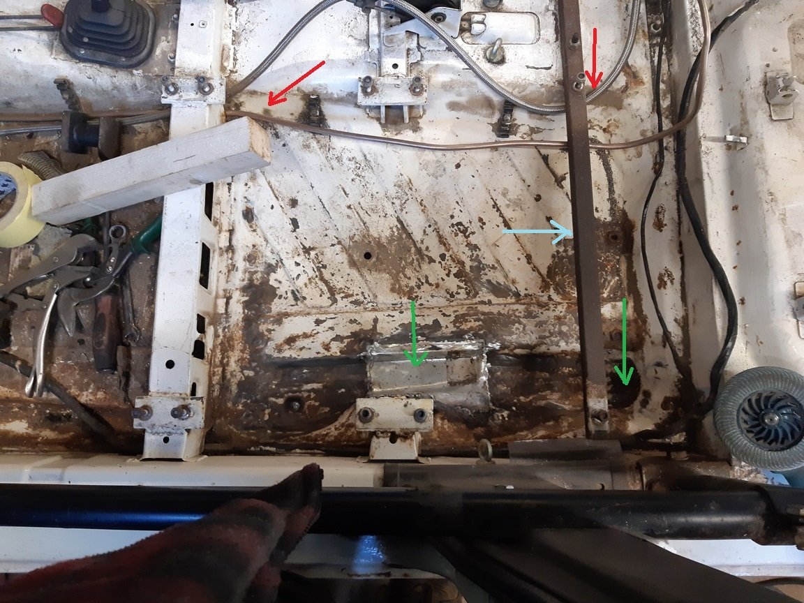

Hi Ken, thanks for taking the time to reply. As you will have seen in the last restoration photos, about 5 posts back, the welded in captive nut must previously have come loose and which must have been a pig to sort out. When I fully removed the support plate the captive nut was missing. The nut has to be 13mm high to fit tightly under the stiffener and is M10x1.25 which is a metric fine thread and not as readily available. I would prefer to retain the M10 x 1.25 thread to avoid any future complications. Furthermore to enable full welding the replacement fitting would ideally have a flange on the bottom to give access for welding. The hexagon part would also need to be reduced as much as possible again to give more access for welding. These design requirements mean that I need to find someone with a lathe to turn me the part. Hence my statement “I just need to plan and execute the replacement of the missing wishbone mounting nut”
Below is a close up picture of the area, the red arrow points to the remaining captive nut, the orange arrows indicate welded areas.
