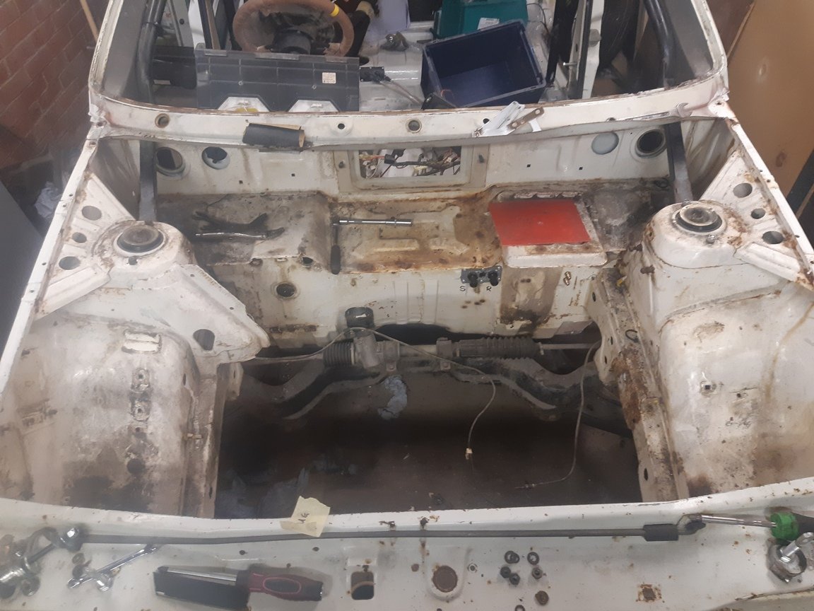

Hi Everyone
I am still on with Project H49 but recently and life the cold spell have got in the way and slowed progress, but hopefully I am back on with things. Tonight I broke the out wire wheel out to clear the paint from the front end of the cill, to weld a mudflap mounting bracket. The first picture shows the holes revealed. In the past few weeks I have replaced the petrol and brake pipes and refitted some front calipers that I overhauled.
In other news I am now the part owner of another rally Favorit, this time a very early car. It is going to need a full restoration, it needs cills floor pans and rear wheel arches. It also needs a roof because it has had a light roll in its recent past. The windscreen hole appeats to be the wrong shape as well. As is always the case it was local, not!, it required a quick 720 mile round trip to Inverness to collect. The third picture is copied from a 1989 magazine and shows the car with its famous driver.

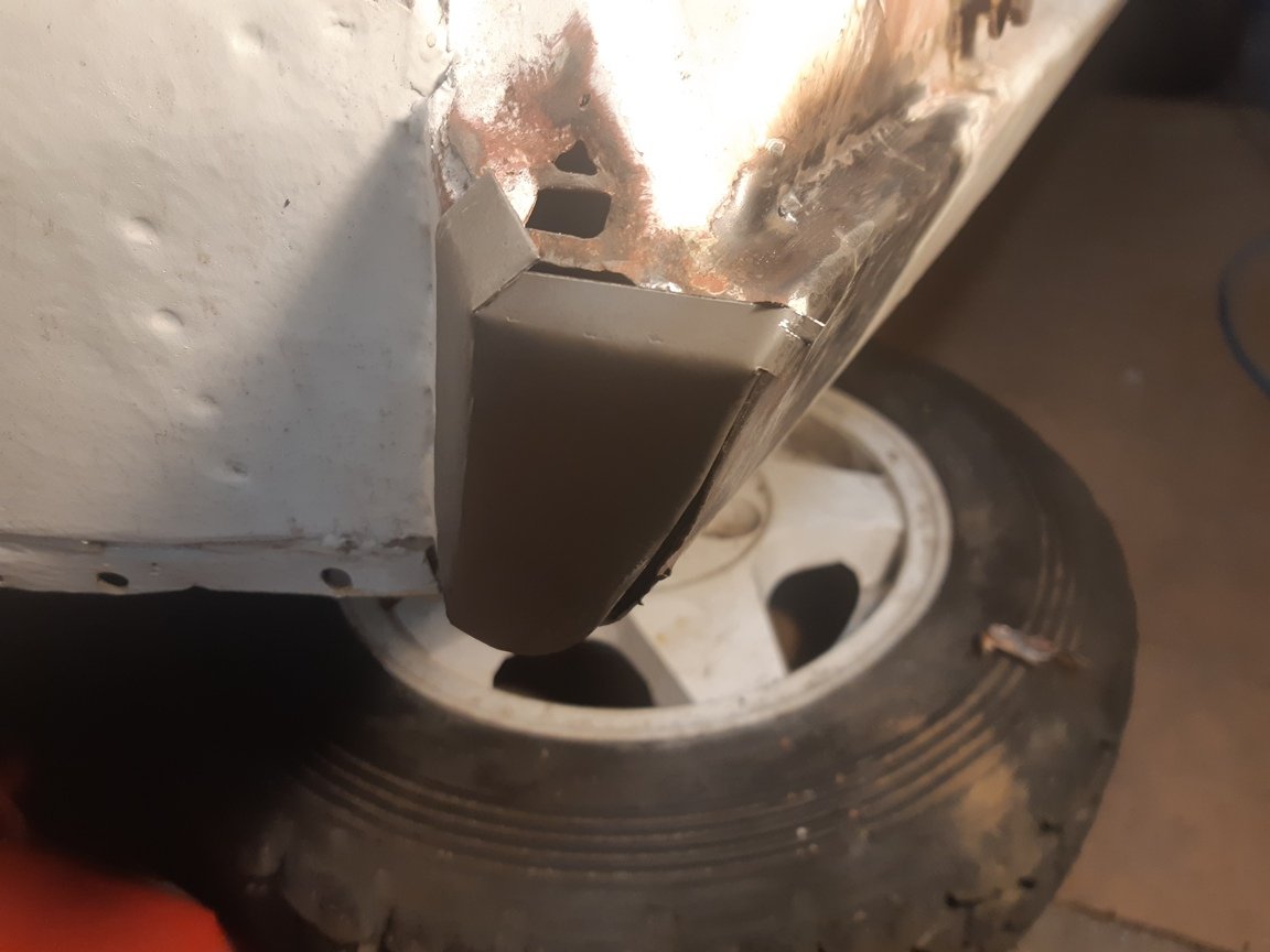

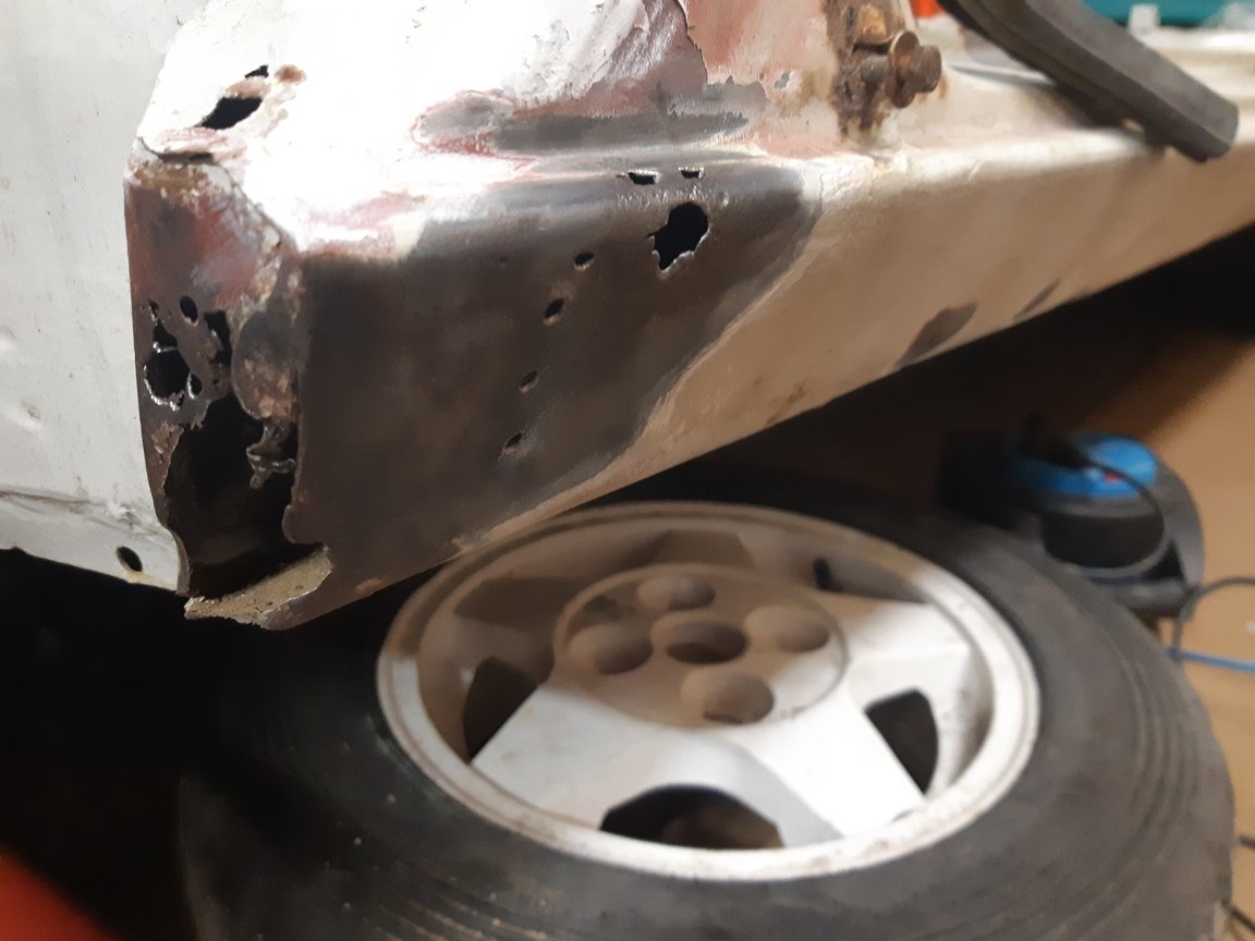

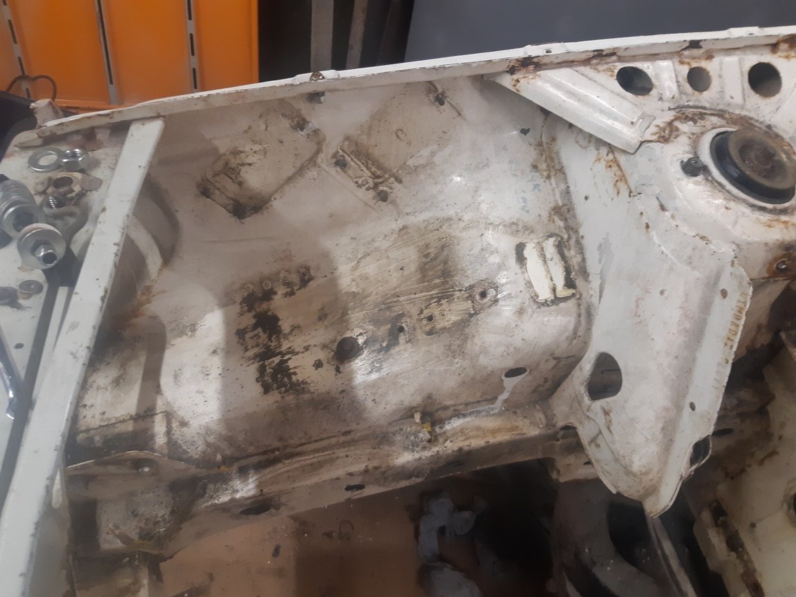

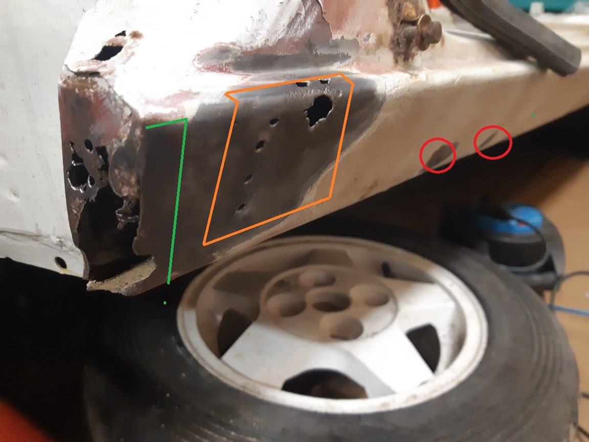

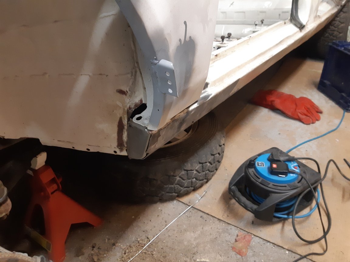

So I left things last time with the revelation of a frilly cill end at the near side oh joy. The cill is rusty inside and will need copious quantities of waxoyl to preserve it for as long as possible. Back to the repairs, firstly I inserted a patch panel to repair the area bordered in orange on the first picture. I did this to test the weldability of the cill, if it was too thin to weld it was beyond help and I would have to replace it. The second picture shows the repair whilst grinding the welds back.
Back to the first picture the 2 areas circled in red are 2 small rot spots I will sort with micro patches, with the end of the cill shown with the green line showing the approximate size of that repair part needed, this repair piece will also need a return to weld to the front face of the cill closing panel referred below.
The third picture shows the panel I formed to close the front end of the cill. This was the part that drew my attention to this rot in the first place.
The forth picture shows the part being trial fitted.

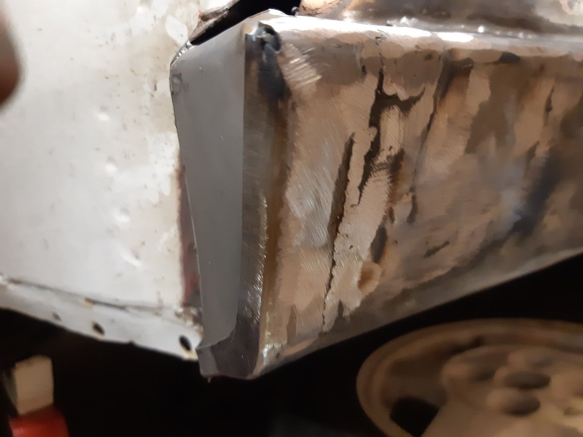

The fifth photo is with the cill closeing panel welded in and trail fitting the wing.
The last period photo is a thumbs up from Tim Green.

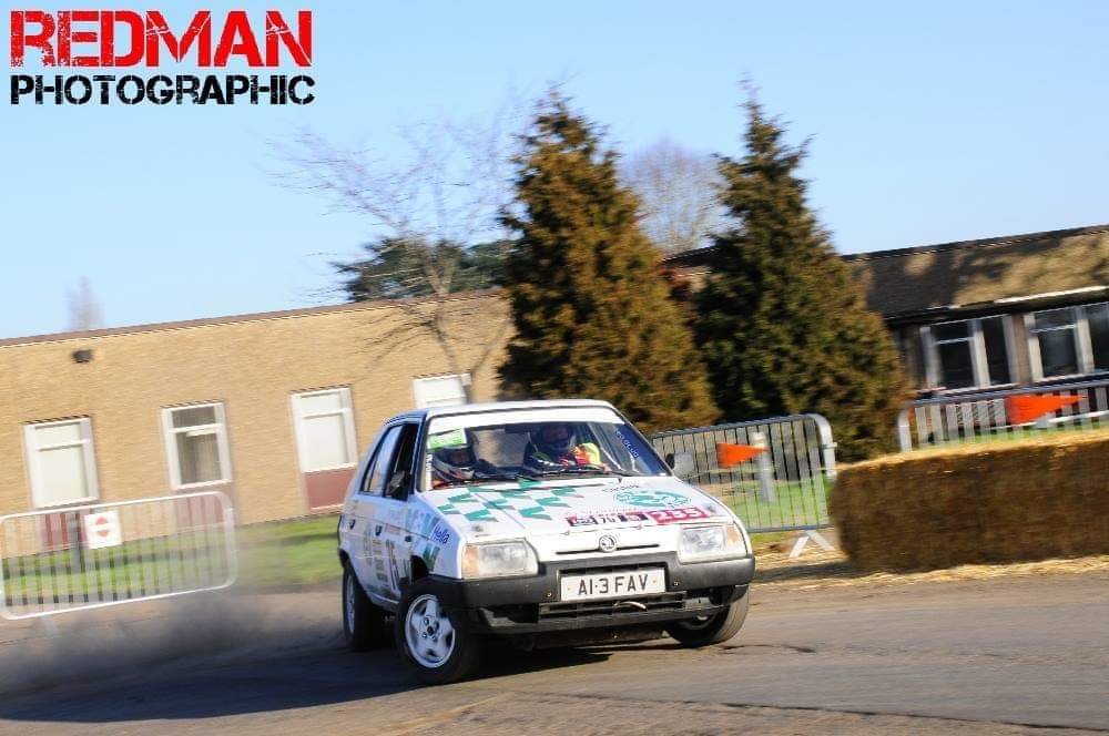

No welding this weekend ........I am off to Race Retro https://www.raceretro.com/ supporting Simon Daly with A13 FAV. If anyone is going come over and say hello I will be near the Rally Rides all weekend.

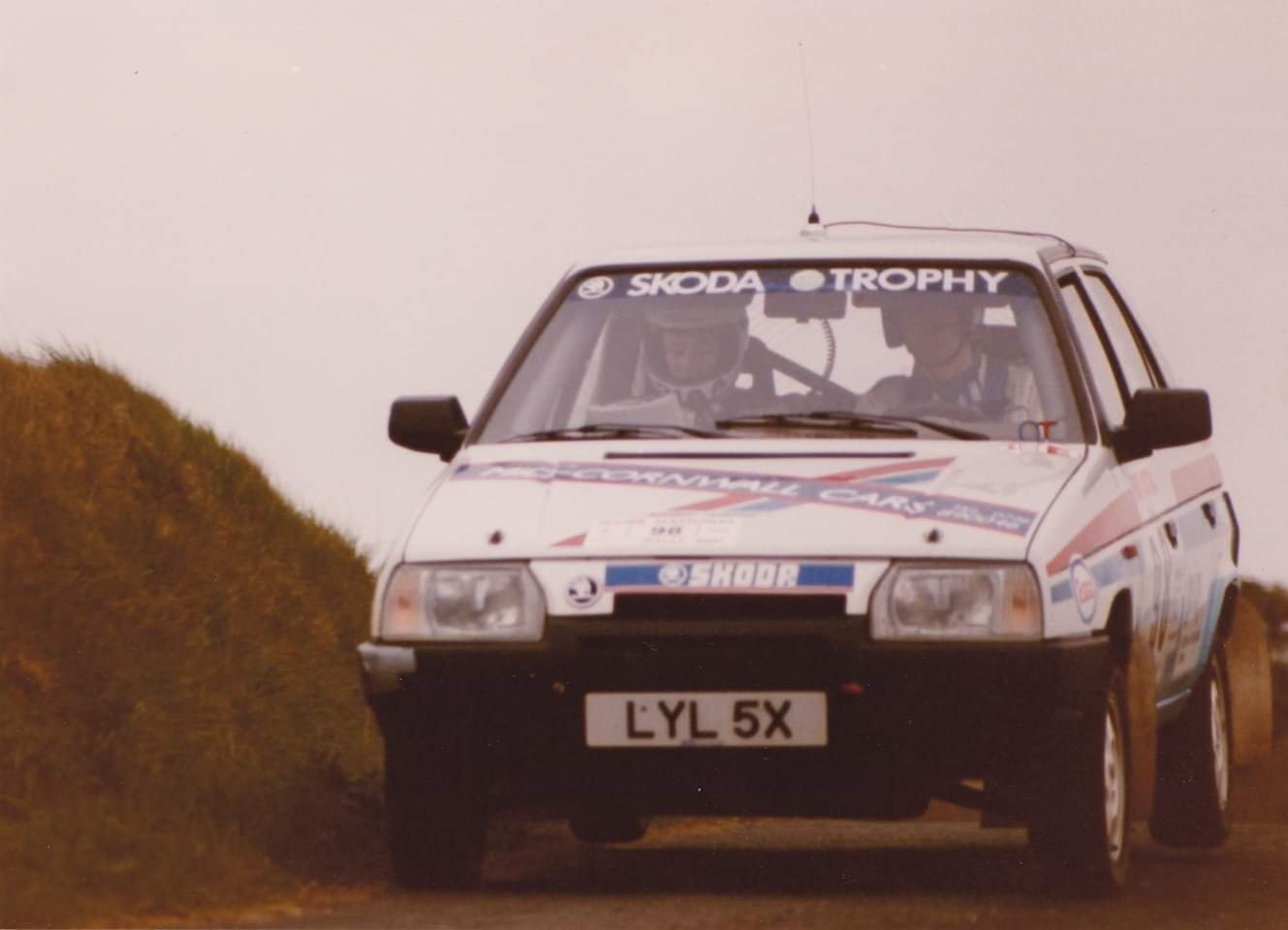

Pictures tonight of A13 FAV, first is a Stage start on the 1993 RAC which was the cars last rally as a Works car, and is the livery the car now carries. The second photo is of the car in its trophy guise owned and driven by Carl Stevens. The last picture is at last years Race Retro where the car was on static display. This year we hope to be demonstrating it and using it for rally rides. So a Favorit being used in anger........

 and a couple of photos from the weekend of A13 FAV, coincidentally note the names on the wing of the Peugeot  car parked behind FAV in parc ferme

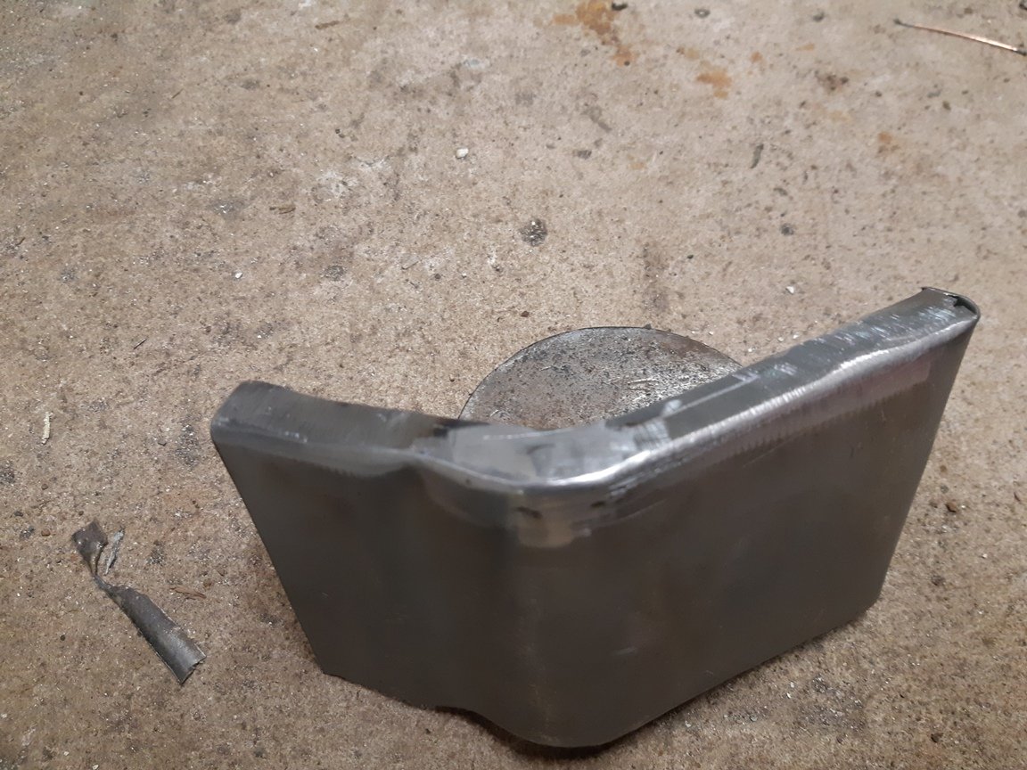

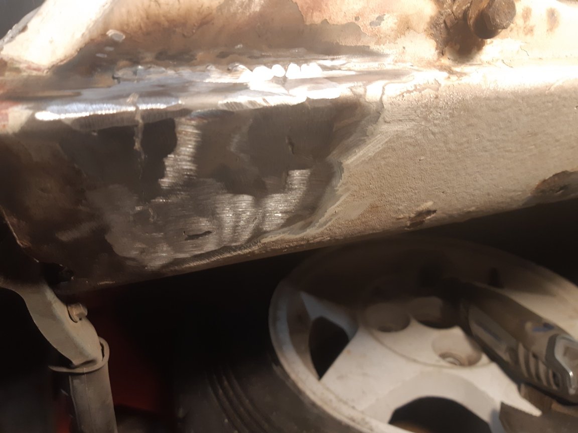

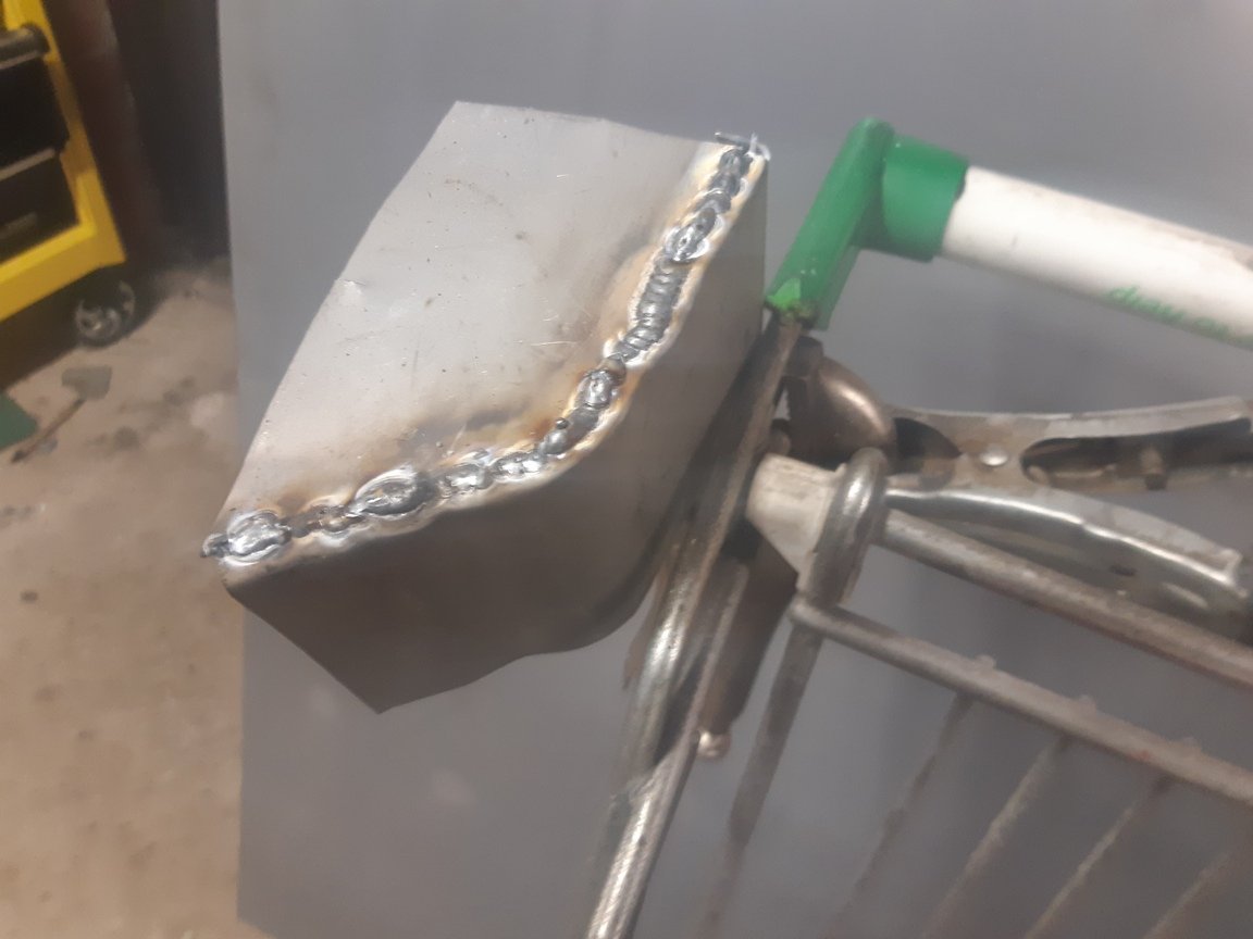

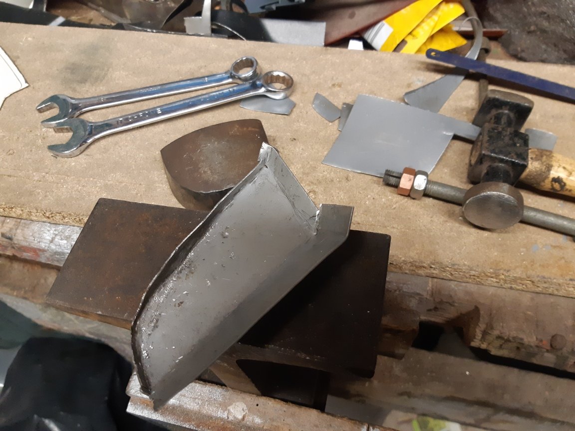

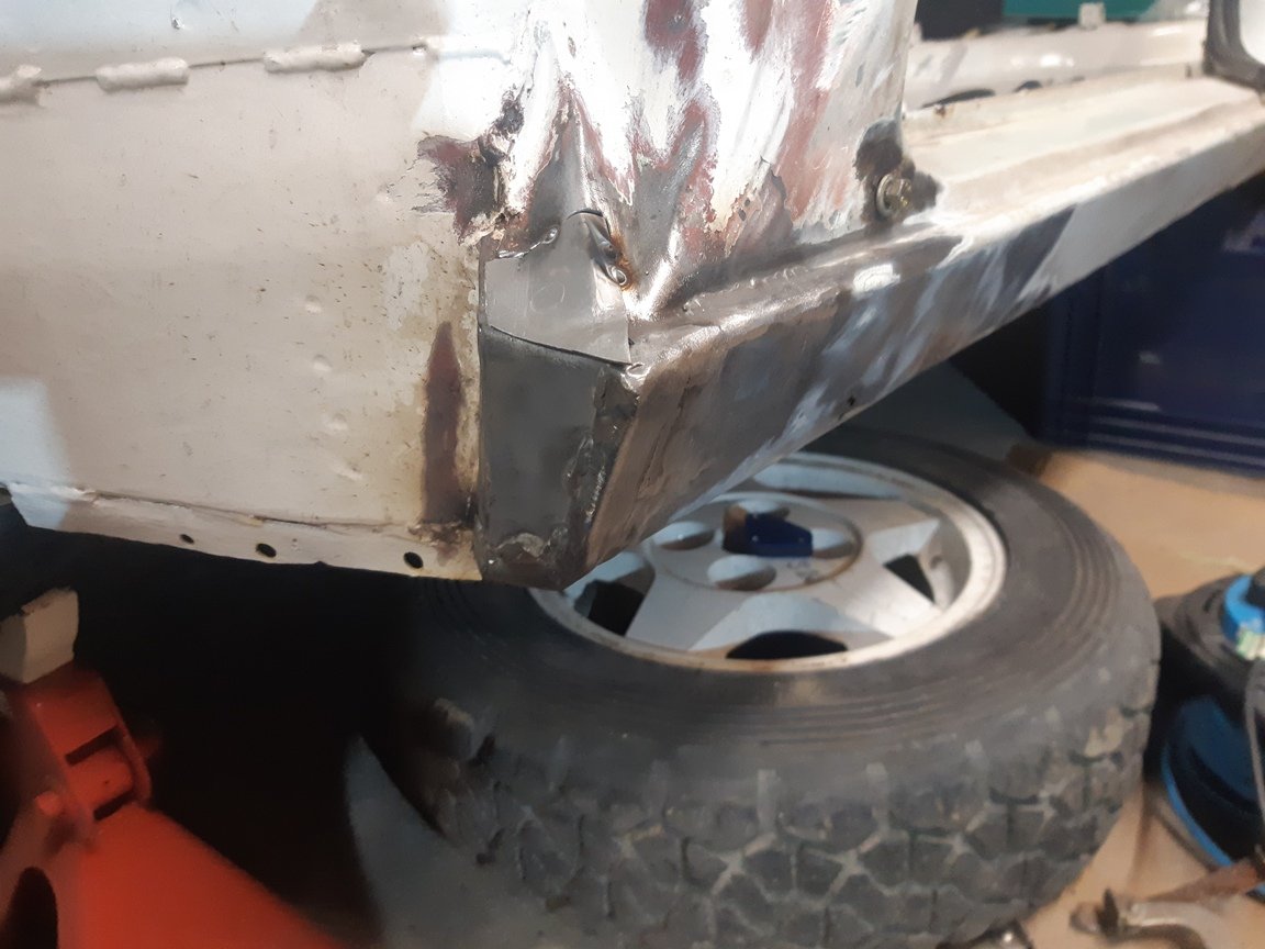

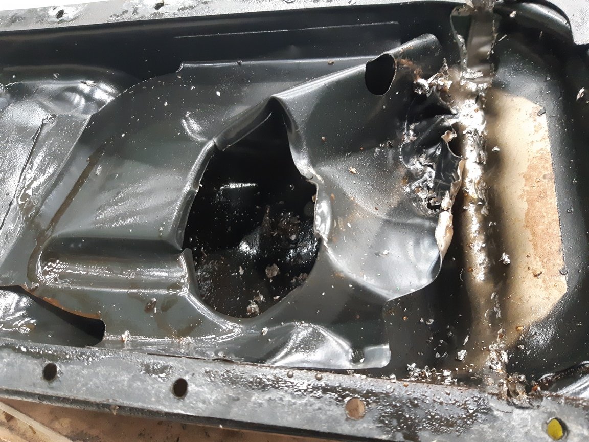

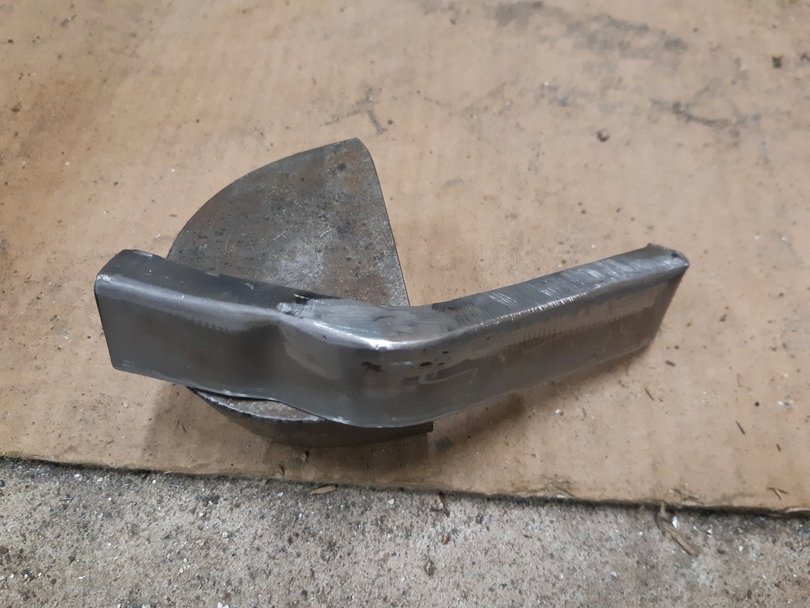

Tonight I spent butt welding the repair panel that I have made to the front edge of the cille and around the cille end closing panel which I fitted the other night. I will let the photos do the talking.
Photo 1 shows the repair panel during manufacture I bent a piece of metal to the profile of the cille and then turned a small flange on what would be the front face. To this small flange I welded a fillet to create the shape shown. It is clamped to my welding trolley which as you can see is re purposed. I found it, phoned the owner who declined to collect it, so I found a use for it.
Photo 2 shows the front flange cut down to the correct size after I had cleaned the welds back.

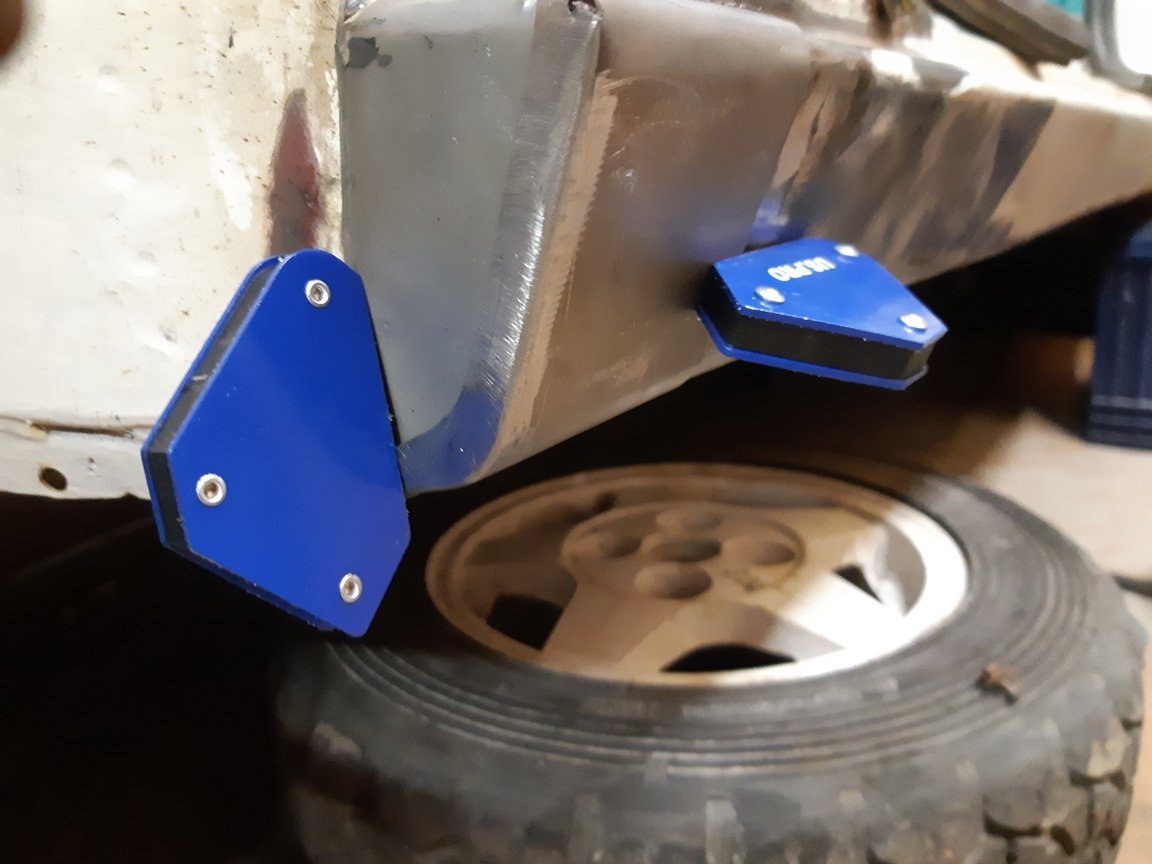

Photo 3 shows a trial fit held in place with my new magnets.
Photo 4 shows the panel with the excess now cut from the cille side. I find it makes life much easier with parts like this to make parts over size and cut them down, rather than struggling with small parts which are harder to hold , weld, grind etc.
Photo 5 is of the part being welded in. I had quickly dressed the vertical weld back to check everything.

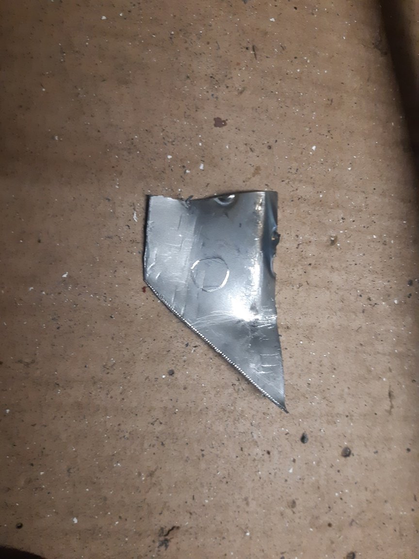

Photo 6 is with the panel fully fitted and the top triangle tacked in place to mark the position of the captive nut which will hold the bottom of the wing.
Photo 7 is of the triangle removed to to fit the captive nut in the centre of the circle.
The final photo tonight is with H49 along with H288 XES with its green bumpers. Supposedly A13 FAV is in the background but under its first UK registration number of L910 ORP. The event is the 1994 or 1995 RAC rally. H288 XES is still about as well although it needs a full body rebuild.
Thanks for looking and do please comment.

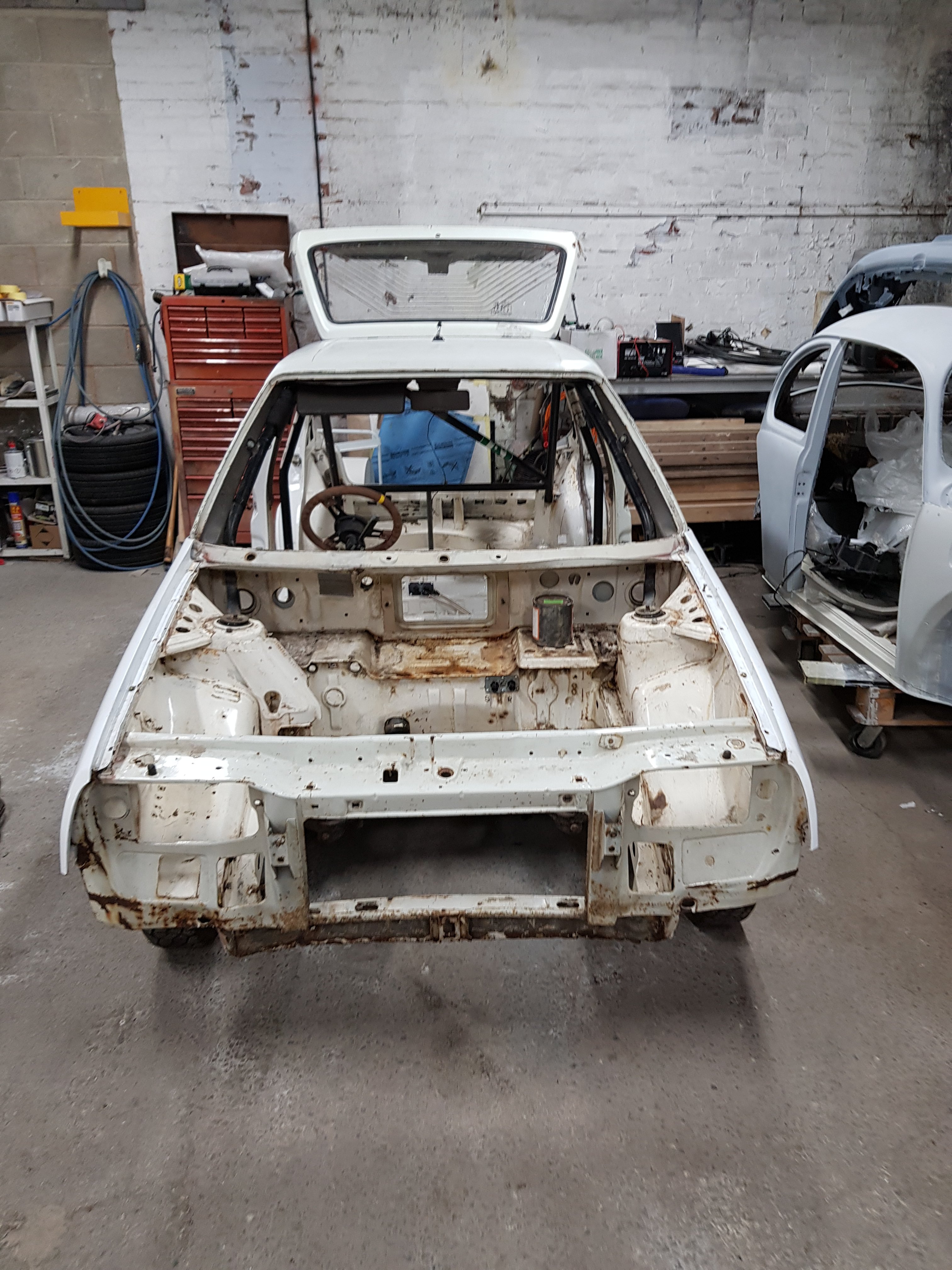

Hi Everyone

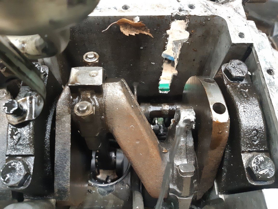

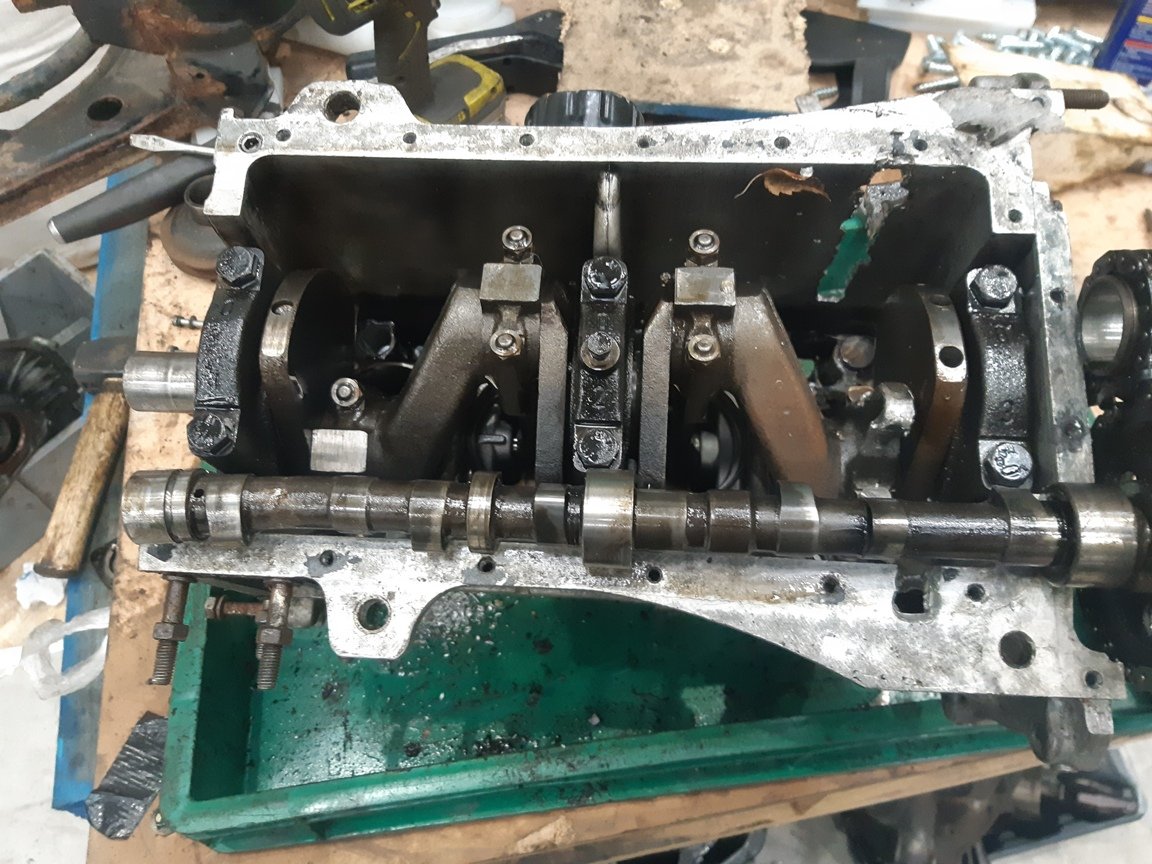

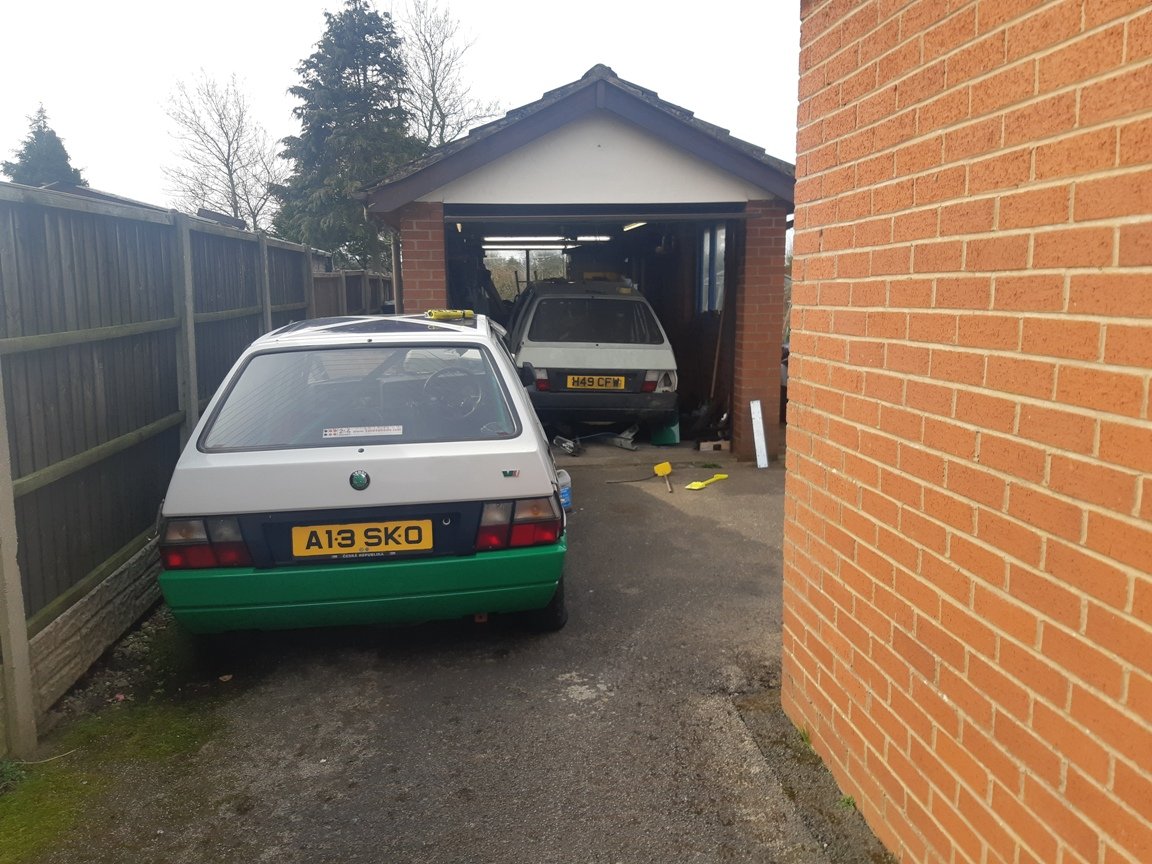

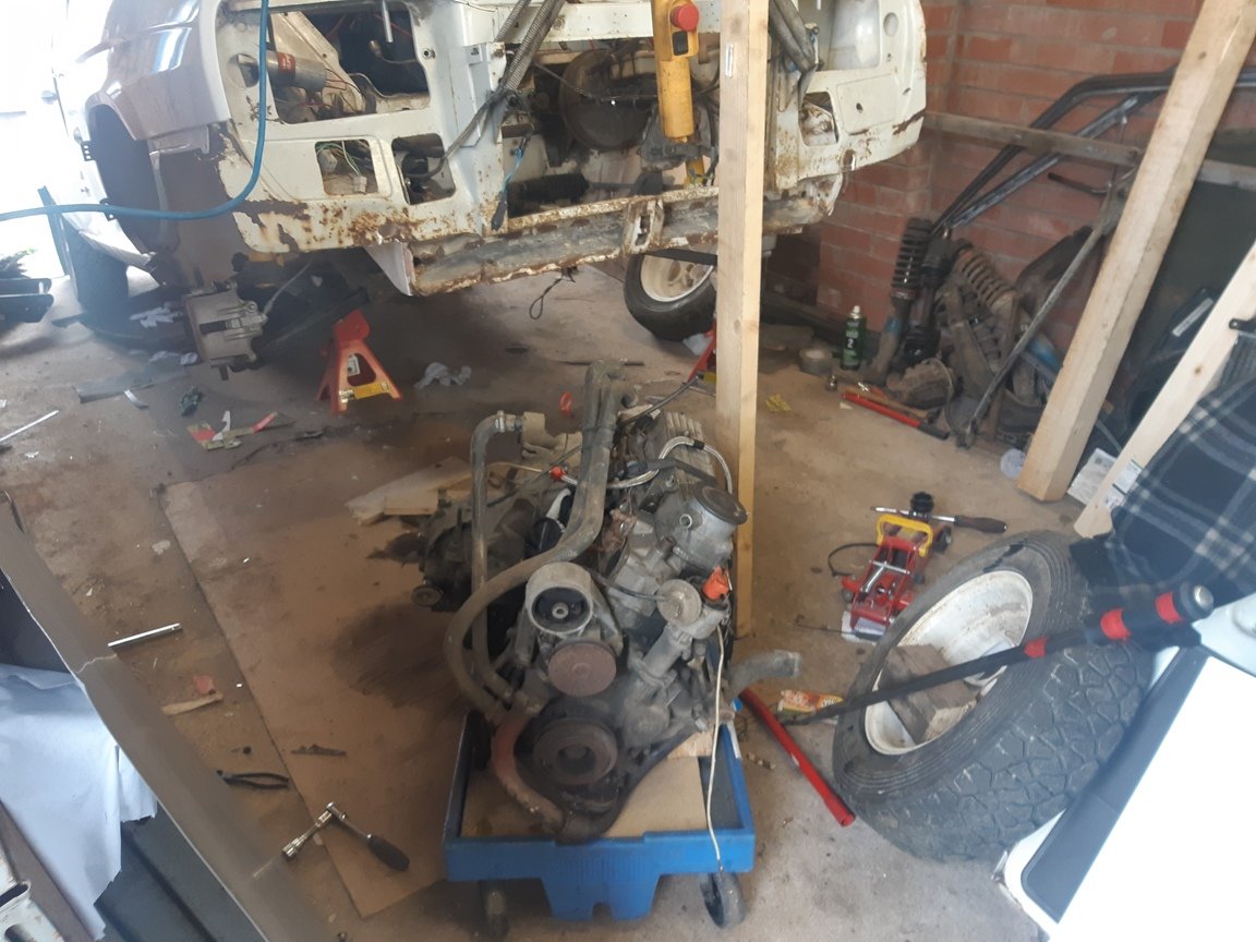

Firstly apologies for a lack of updates recently, I got busy and couldn't find the time to update. The welding is however almost finished and I will put up the last instalment soon. I am currently removing the engine, it has a high antifreeze content in the sump and a very rattly timing chain. So a quick rebuild and freshen up is called for.
So to the reason for this post.

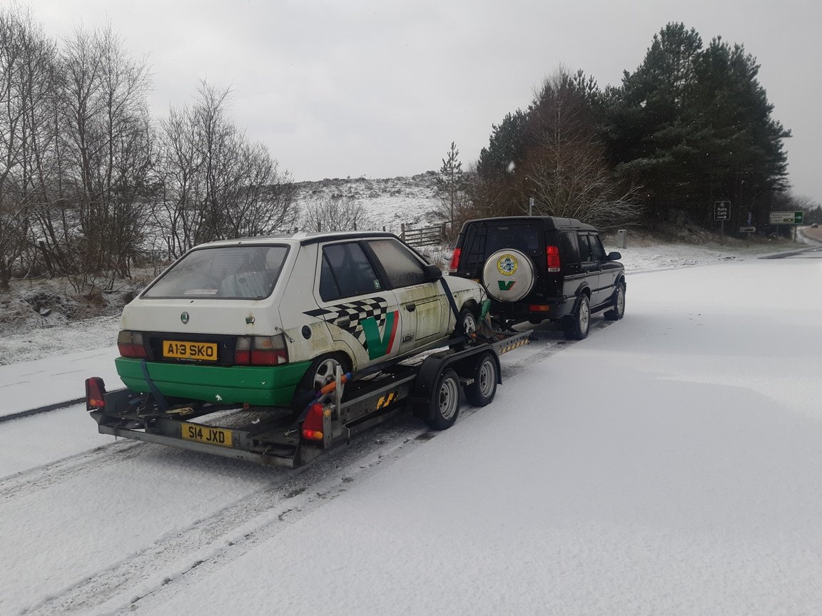

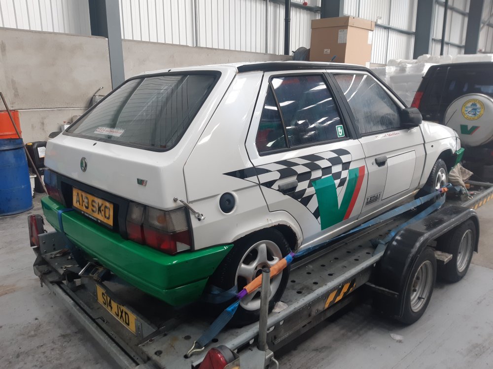

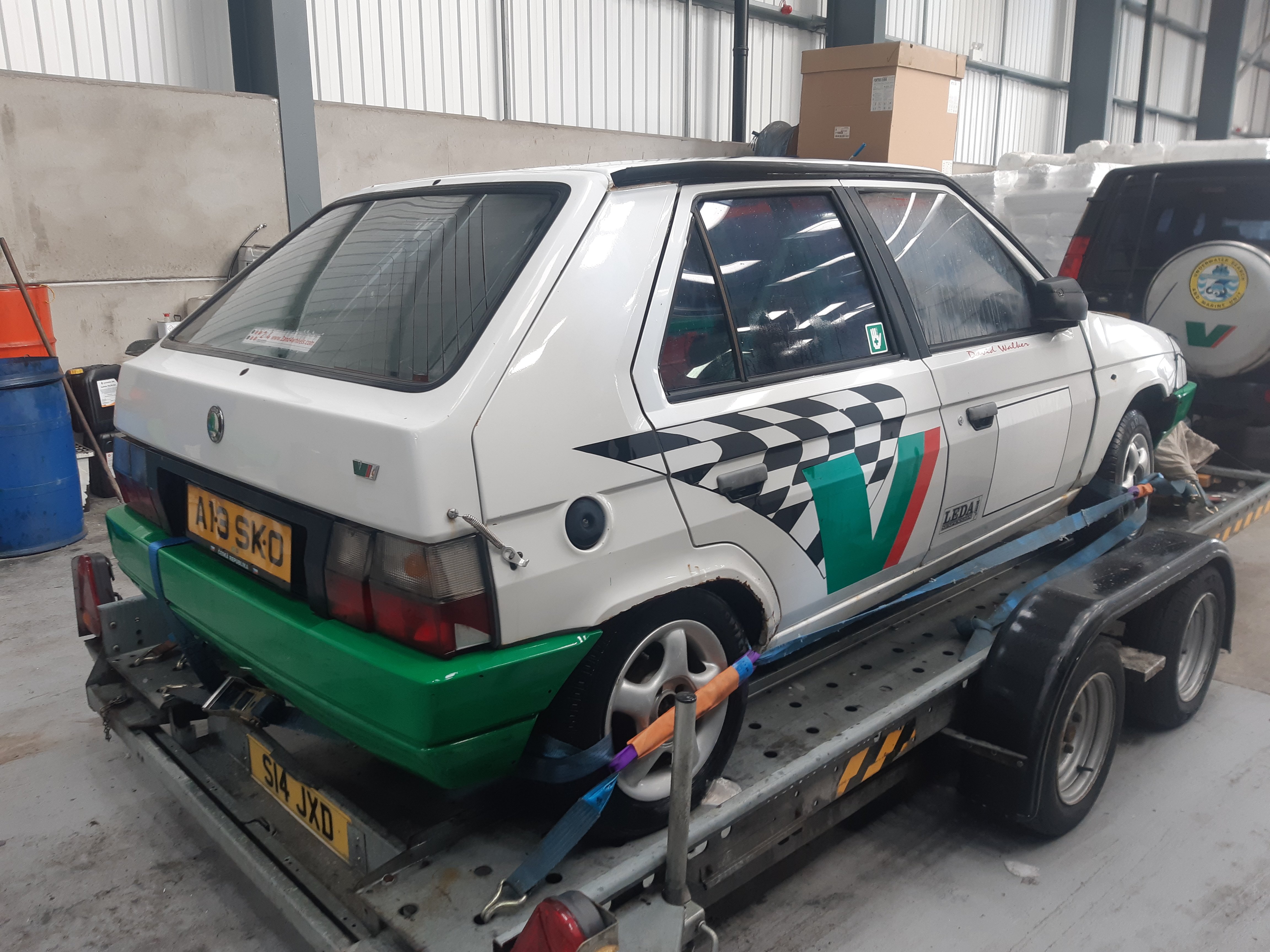

You might recall that in early January we had a small road trip to Inverness to collect another ex works Favorit. The car came with a huge spares package including another Favorit rally car. Last weekend had been pencilled in for the return trip the first picture shows the start of the trip home, we took the picture then before the snow got worse.....which it did.
The car as shown in the picture contained 5 gear boxes and 2 engines along with a large pile of spares hence the lowered stance.
The second picture is back in Lancashire after a quick steam clean to remove some of the green mold. The number A13 SKO had been transferred before we got the car.

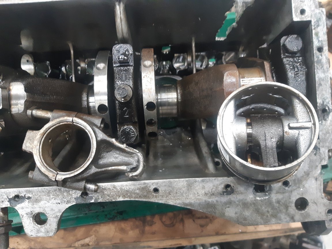

The last pictures are the stripdown of one of the engines, we knew it had blown up but wanted to hopefully save the head and the cam, it was supposed to be a quick engine. Its certainly light weight now. The head is good and saveable, I fear the cam may have opened its last valve....................
The engine let go on a stage but carried on running for about a mile to the end of the stage.
