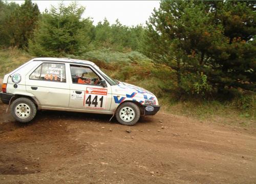

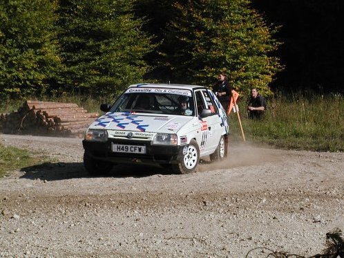

Hi Toonarf
I was wondering how you are getting on with repairing H49 CFW. I used to help the owner maintain it back in 1999-2004 and my dad did a few events in the co driver seat.
Some information on the car and some of its rallying history is on eWRC Results.https://www.ewrc-results.com/cms/plates.php?plate=89558. which i help out on so anymore information you can add let me know.
Some pics
Regards
