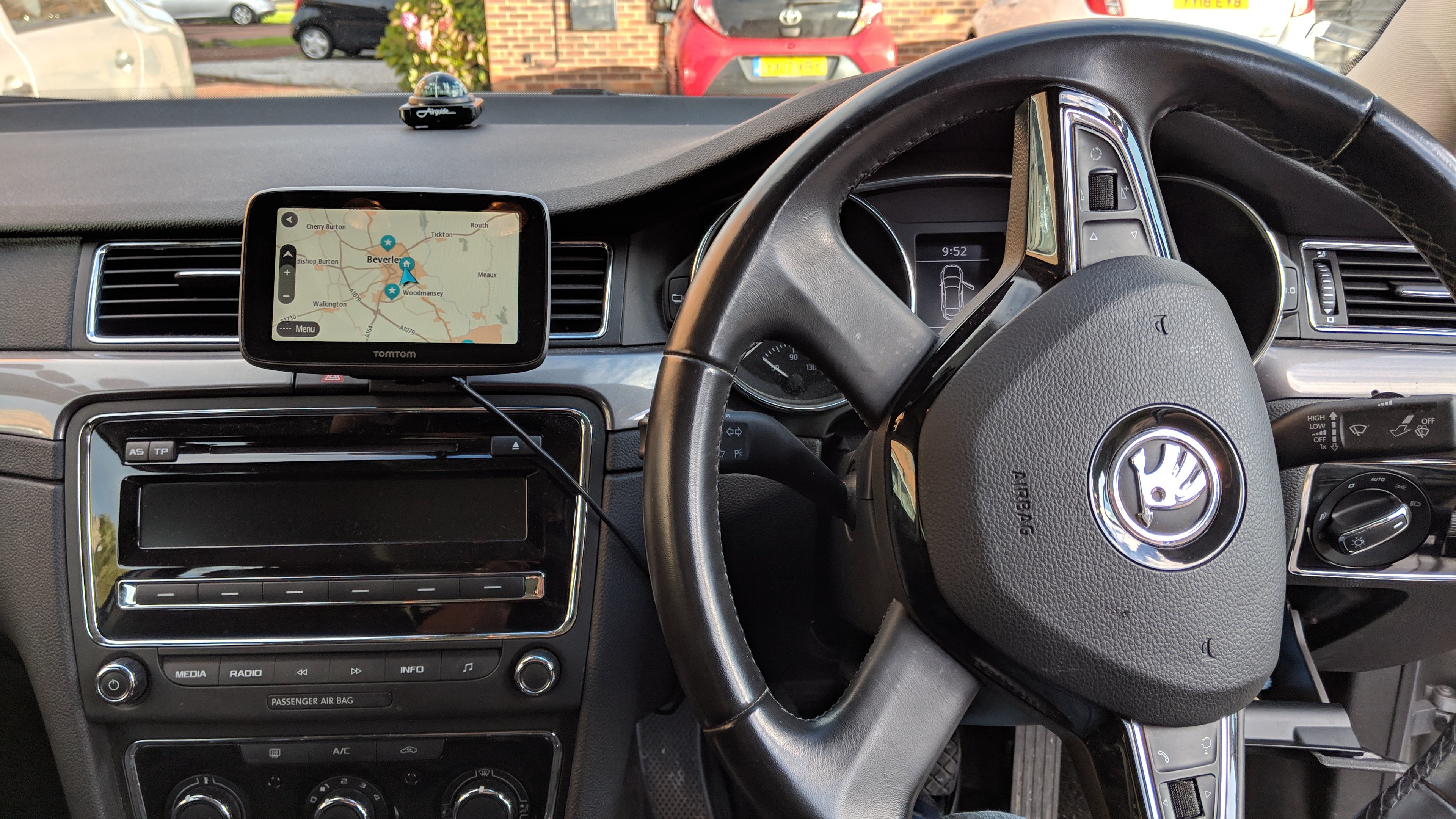

Re Satnav - I'm sure I've seen stuff on this forum to install an Android head unit which looks interesting. However I have a Tomtom 5200 and a Brodit clip to neatly fit over one central air vent. I've tried allsorts of satnavs (built in, google etc..., other makes) and for me the latest Tomtoms work really well especially re the detailed traffic stuff:-
