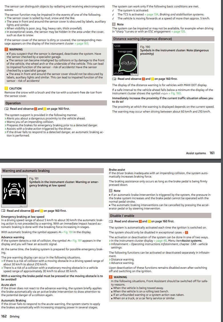

How do I prove/disprove that Front Assist works? I haven't had any warnings from it despite setting it to "Early" and driving too close for comfort just to see  if it triggers. Obviously don't want to do something really dangerous.
If front assist isnt working it will throw a fault up. I have tested it unintentionally a couple of times and it does slam on the brakes for you. You get the audible "beep" along with the red car symbol with lines around it on the maxidot as an initial warning. If thats ignored then it will slam on

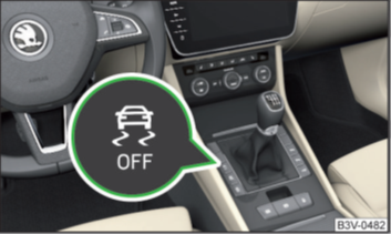

Then, while still stationary, turn off the stability control using the ESC button near the gear / DSG selector (shown below). In the maxi-dot it will say "Front Assist unavailable". Press the ESC button again to turn it back on and the front assist unavailable message disappears demonstrating Front Assist is working again.
If you want more concrete evidence / proof, try this - carefully. If you are "too close" to the car in front at speeds above c40mph, you will get the first symbol you showed in your post (shown below) coming up on the maxi-dot. But be warned, it is small in real life and could easily be missed. This can be tested safely on the motorway by engaging ACC and setting the ACC distance to the furthest setting*, then accelerating gently towards the vehicle in front (effectively over-riding the ACC). You will still be a safe distance behind as long as you have set ACC distance to its furthest setting when the symbol below appears. It goes without saying this should only be tried on a straight stretch of motorway in dry, clear conditions, and only for the short time it takes for you to see that the symbol has appeared.
The final symbol you show (copied below) and the automatic braking is, in my experience, a rare occurrence. FYI on my car, like @Adrian55555's, the symbol is red not white. Unlike the symbol above it covers the whole of the maxi-dot display. I really wouldn't recommend trying to test it as the one time mine triggered for real the distance to the car in front was very small (a car dived out into the outside lane of the motorway directly in front of me - I'm pretty sure the driver never even saw me).
Like Adrian and @facet edge, mine has triggered "in error" more often than it has triggered for real. I too have had it flash up when someone in front is exiting the motorway, and once in an almost exact replica of one of the scenarios the manual warns about, shown below. A blip on the throttle cancels the warning.

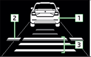

* To set the ACC to its furthest distance setting, engage ACC then push the toggle switch on the top of the ACC stalk to the right until it shows the maximum number of solid horizontal white bars - from memory it is five, which seems to be confirmed from this diagram from the manual below. In this diagram only three bars are "activated", so just toggle the switch to the right until all of them are shown as solid white.
