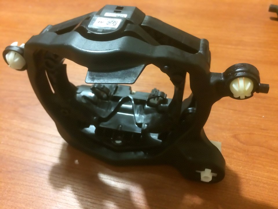

You can see the two white manual adjustment screws on the rear of this headlight: https://www.ebay.co.uk/itm/352326838286
It's the 'learn' part I need to get into.
Tried an Alan key on the white points but feel like they 'free-spin' without making any difference to the beam.
The learning procedure won't help if the adjusters aren't working...
I assume you've got the headlights on against a wall or garage and you've tried turning them 2-3 turns in one direction before coming back?
It's possible that one or two could be broken but I'd be surprised if all four were on such a new car.

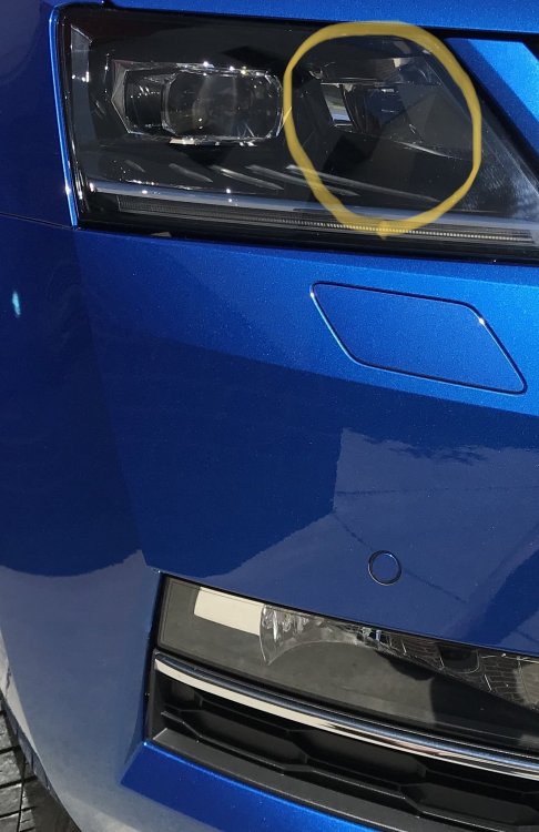

I've done a little video..
City mode is where both my static cornering lights come on when i'm going under 55km/h and the main beam is lowered, when i'm going back over the bridge toward the end you'll see my headlights dip down and the static cornering lights switch on together
Country mode is where the main beam raises slightly and the static cornering lights are inactive
Highway mode is where the main beam raises again ever so slightly over country mode over 120km/h (or 115km/h if you're my dashcam)
Don't mind my a**hole attitude blasting that subaru that left his light bar on too long and killed my eyes...
For some reason my cornering lights don't react to my steering position or my indicator.. they're just on...
In country mode (I suppose that what you call speeds above 55km/h?) the visibility is actually really bad.. and I think the black spot is created by my right headlight being too low causing a staggered cutoff.
** Where it says "TITLE TEXT HERE" I was meant to write... Country mode reverting to City mode at the bridge
Edited by Felvo
