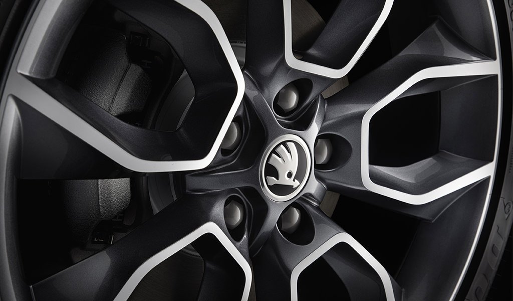

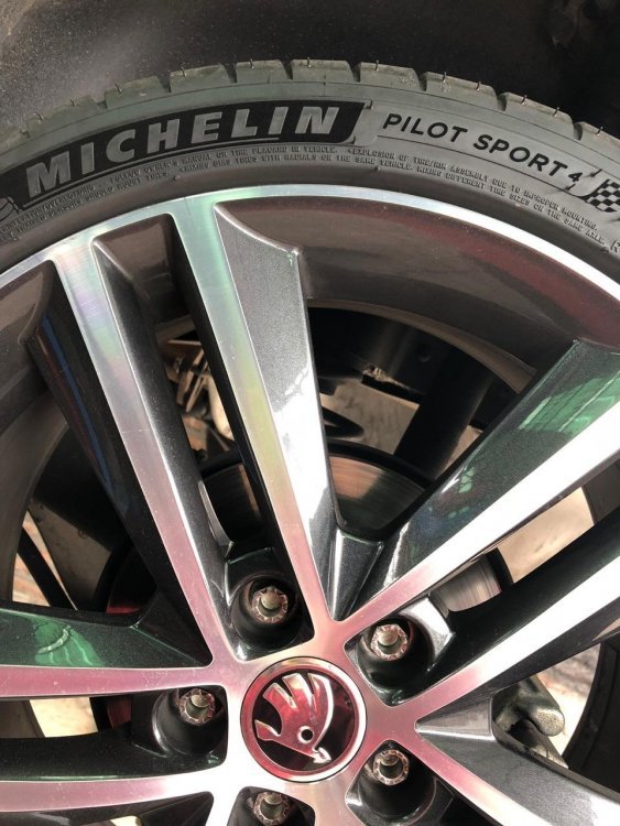

Really!?
Without...
8A665FA7-AED3-441D-B711-088859F1BB6B.thumb.jpeg.5010a369dad2d5ac7bbd3db33c87a6df.jpeg.b28b20bc4375f99d83a82c1d77119436.jpeg
With...
1392508623_21211caffynsskodakaroqcomingsoonwebpage_gallery600x10245.thumb.jpg.27aaf0322330d218f99840138064cbfd.jpg

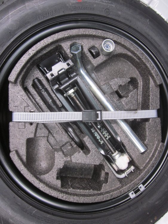

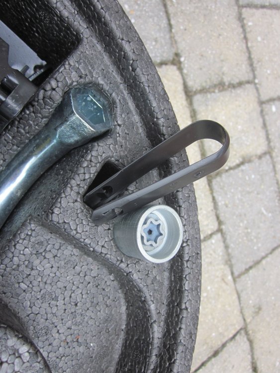

Yes, as above, they are well hidden as they are stored vertically.
This isn't a Karoq, but the principle is the same...
IMG_0326.thumb.JPG.ad40e3166ac37680c8b4cb3f103faa09.JPG.e84f4e0128d860d678fc63b2e8b42c13.JPG
IMG_0341.thumb.JPG.89bc7fcb24ca9ba028374dd818f2659c.JPG.0a9f151629d9c79c4b83b6cdc7a88416.JPG

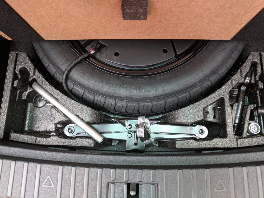

Here is the Kodiaq which I'm hoping might be similar to the Karoq, you can just see it on the far right near the locking wheel nut key ......
IMG_20180518_185807.thumb.jpg.946cb26f6b78a370a349876a01268ec4.jpg.72f67274dad9b113257aca02367b9630.jpg

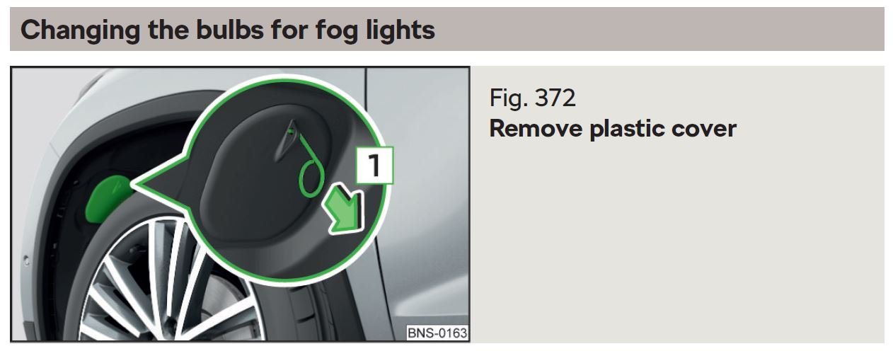

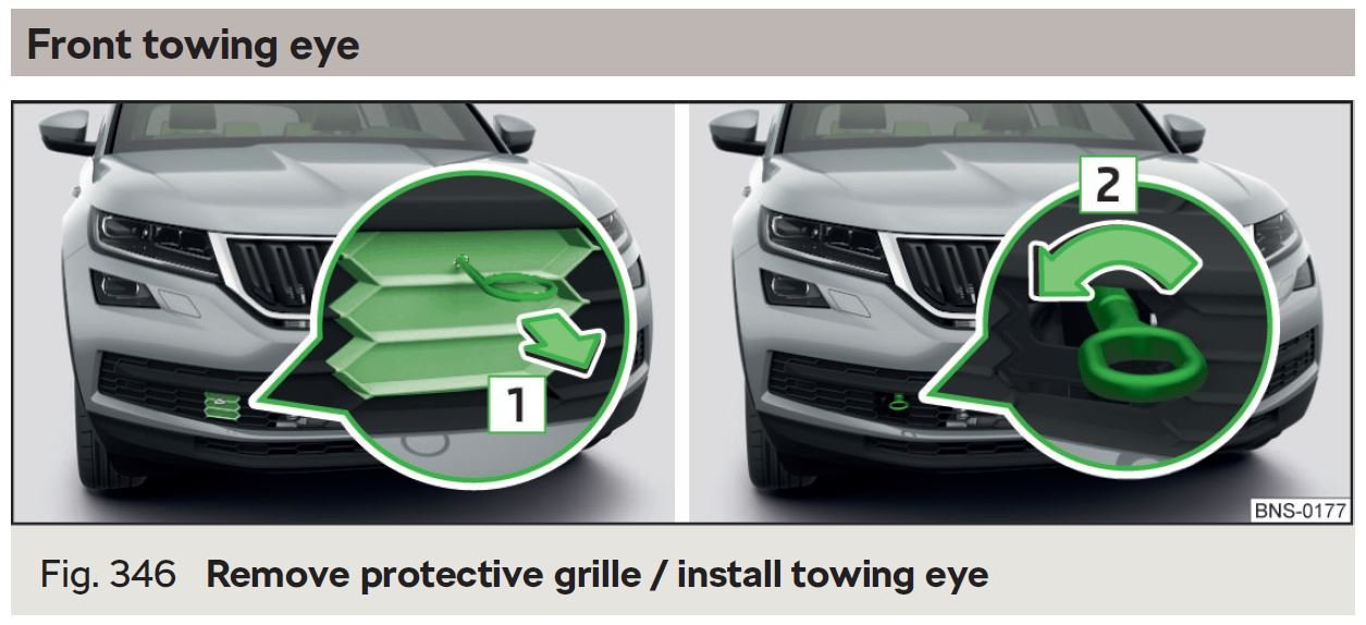

19 hours ago, Boxerdog1 said:
Just checked ... no tweezers !!   But one of those metal hook things they use to remove the bolt covers with holes in middle as on VW's .  Perhaps my new covers will be 'Holy VW ones'  :)
Skoda have found another use for the VW cap removal key. On the Kodiaq (and presumably the Karoq?) it is used to access the front foglight bulbs and remove the front towing eye cover...

Definitely not located within the polystyrene tool holding set up or indeed anywhere else in car .   Got the hook though !!

Different configuration in my Karoq I'm afraid and definitely no tweezers !!

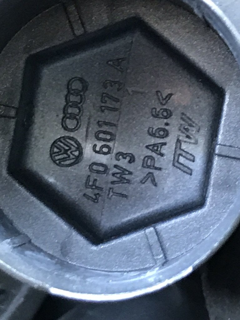

Set of nut covers arrived from dealer today , mat grey part number 321 601 173 A Z37 . Tried fitting them and they are very very tight .  Checked part number on Superskoda site which states 1Z0071215AZ37 !!    Before I get involved in another debate with dealer could I ask a favour of one of you lovely folks ?  Can you remove one of your nut covers and post the part number on a reply please .  Nothing seems simple anymore in this new age of technology :sadsmile:
Hi Boxerdog, don't know if you got sorted with the part numbers for the nut covers, but it's been a bit wet & windy to expose my nuts until today! Here's a couple of pics of both the locking wheel nut cover & the regular wheel nut cover. Hope this helps.
Trev.
Thanks westie38 ... seems like they sent the correct ones !   Very tight fit mind you , lets hope the new tweezers can cope if I need to remove them :)
I guess they need to be tight, otherwise after they've been off and on a few times there might not be enough friction to hold them in place.
Also be careful when jet washing the wheels. If enough water is squirted on them it can get behind and inside the caps and loosen them so that they then fall off whilst driving.

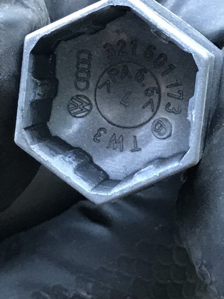

I received some exact replacements off eBay today. I just needed 1 that either fell out or got nicked. The seller sold them in fives or the full set.
Mine is the 321 601 173 B TW3. The description in the listing didn't have the B but I added a note to the seller in the order and I got the right ones.
