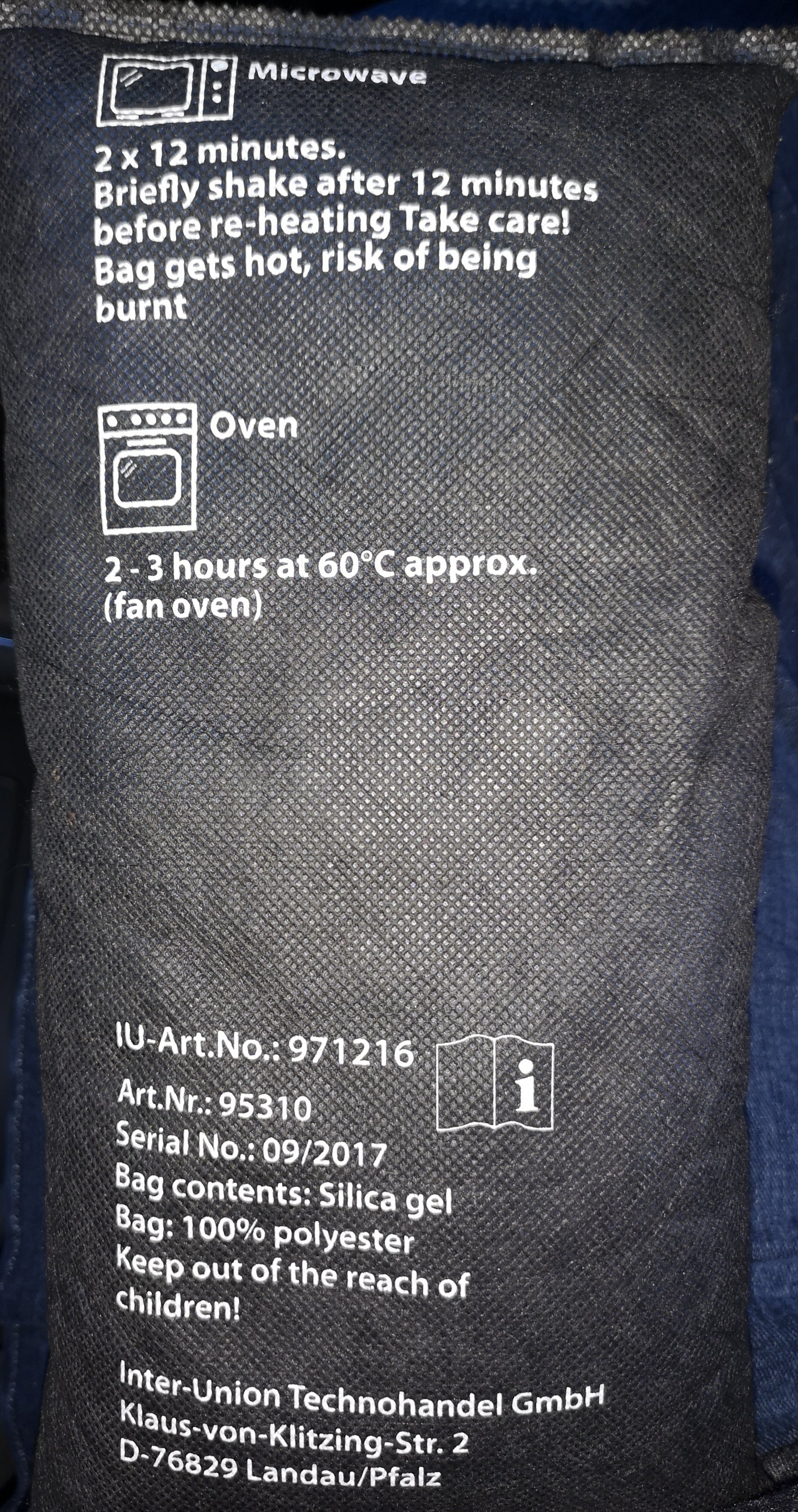

These are the bigger moisture absorbing bags (typically placed under the front passenger seat).
Where did you buy those bags?
Halfords
Mine came from Amazon, but are no longer sold by the same retailer.
Re: silica gel packs (actually 120g) - I got mine from work, but found some on amazon with a quick search
