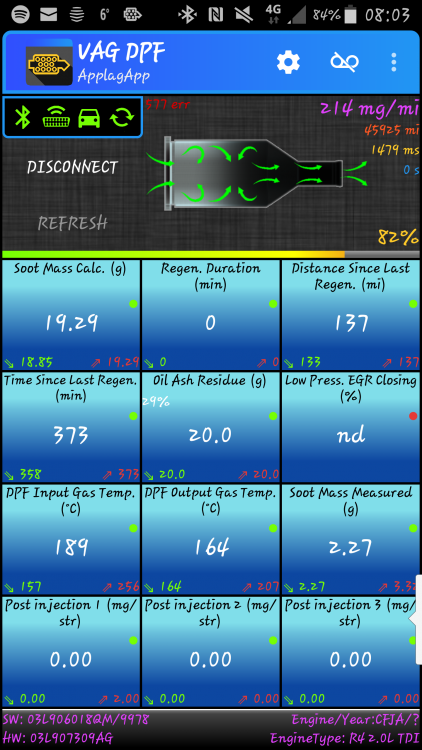

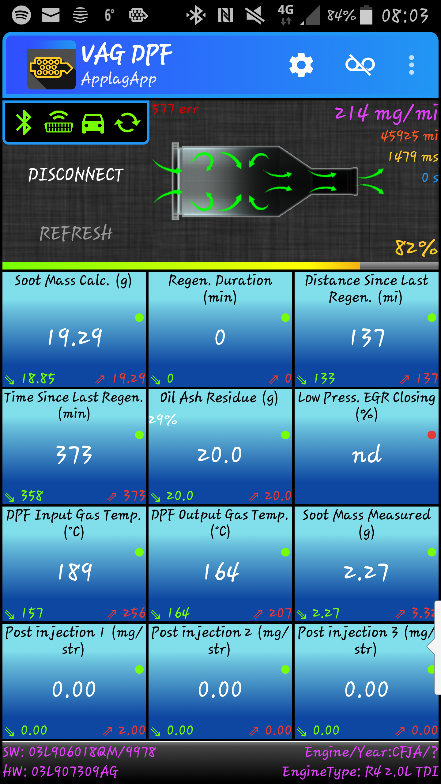

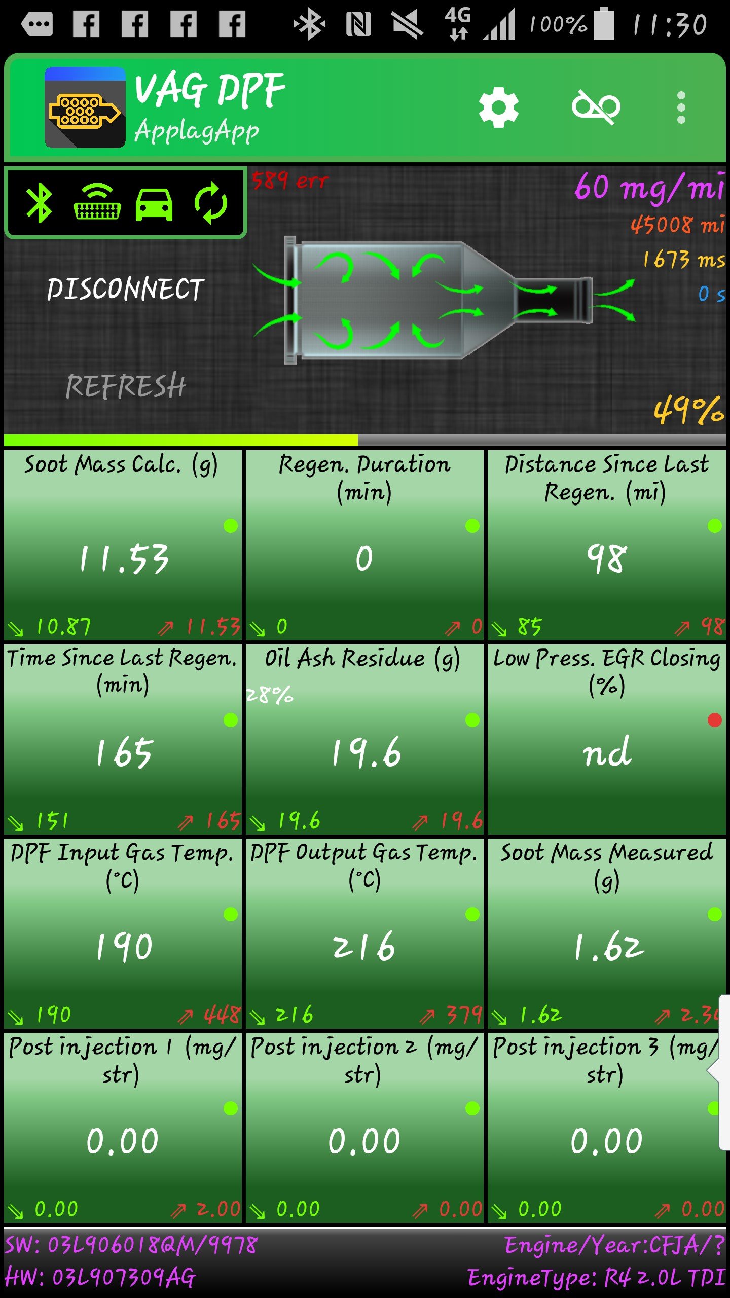

I have attached a screenshot of my recent VAG DPF app' readings, the mileage is at the top of the picture. By my reckoning I should hit full at about 160, 000 miles if the rate of increase is linear.
I still think you are incorrect though, live monitoring with the app' sees my soot go up a lot quicker driving around town whether I work through the gears hard or not, if by sensible driving you mean economically then the soot rate increases alarmingly if I don't work the engine. This obviously means that I am producing less soot on motorway journeys. Once the engine is up to temp' there is very little difference in temp readings whether on motorway or around town so it's not that I'm burning it off more on a motorway.
I think this is reflected in the way diesel engines have developed, bigger diesel engines love motorway journeys, they are easier to maintain, have less issues and produce less soot and oil ash.
I'm on a similar milage, 44,216miles, and only at 19% oil ash residue (15.4g). Take from that what you will.
