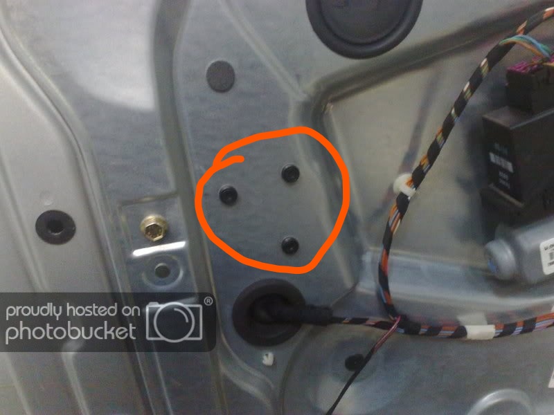

Just one last question on the lower side of the door carriers there are 3 black plastic lugs/inserts are these anything to do with the window as in my passenger door they are missing and the window rattles unless I open it a touch and I can see signs that this trim had been off before I suspect maybe the window had been smashed any thoughts as it's a really annoying rattle lol :sweat:
Not sure if you're referring to front or rear, but if you mean front, do you mean the three plastic rivets? They are only needed when the car is being manufactured as they hold a plastic bracket that has the lock unit attached to it so they can assemble the carrier complete with lock unit attached. The plastic bracket is not needed for home repairs and is usually thrown away. Just put some tape over the rivet holes.

Yes those are the ones seemed strange as all the other doors had them on Thank you for clearing that up :)
