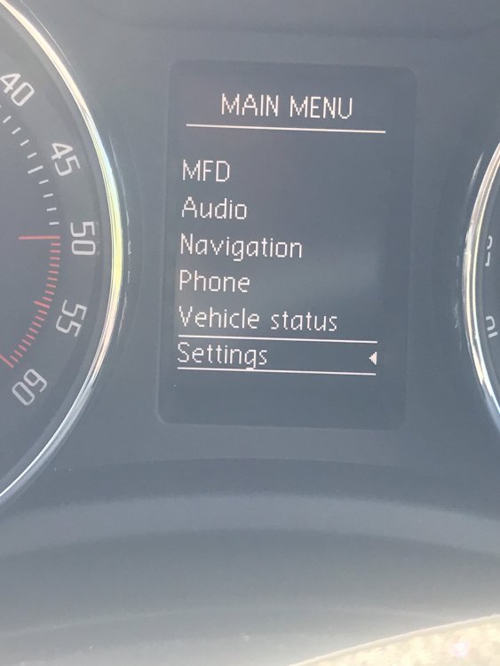

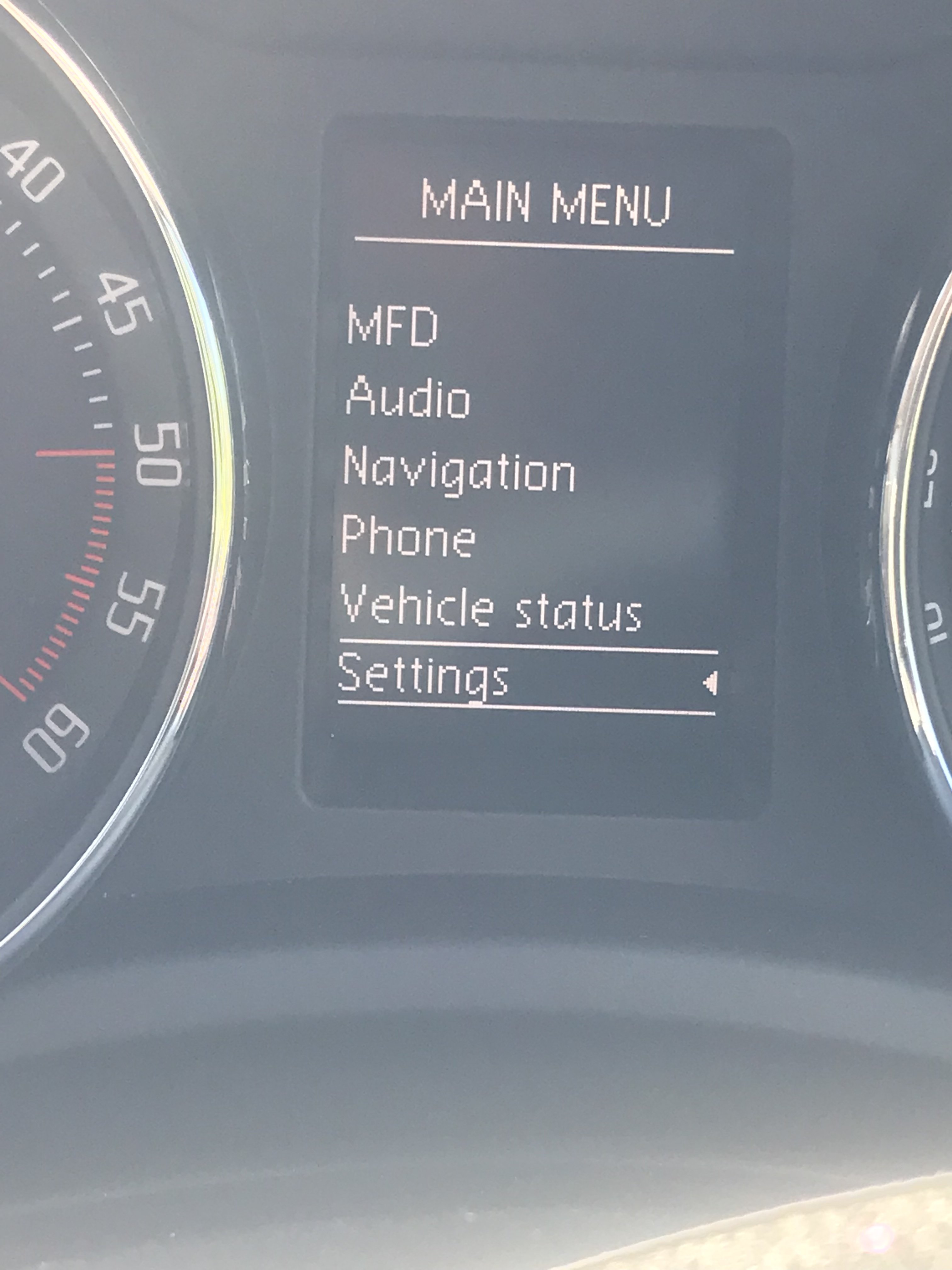

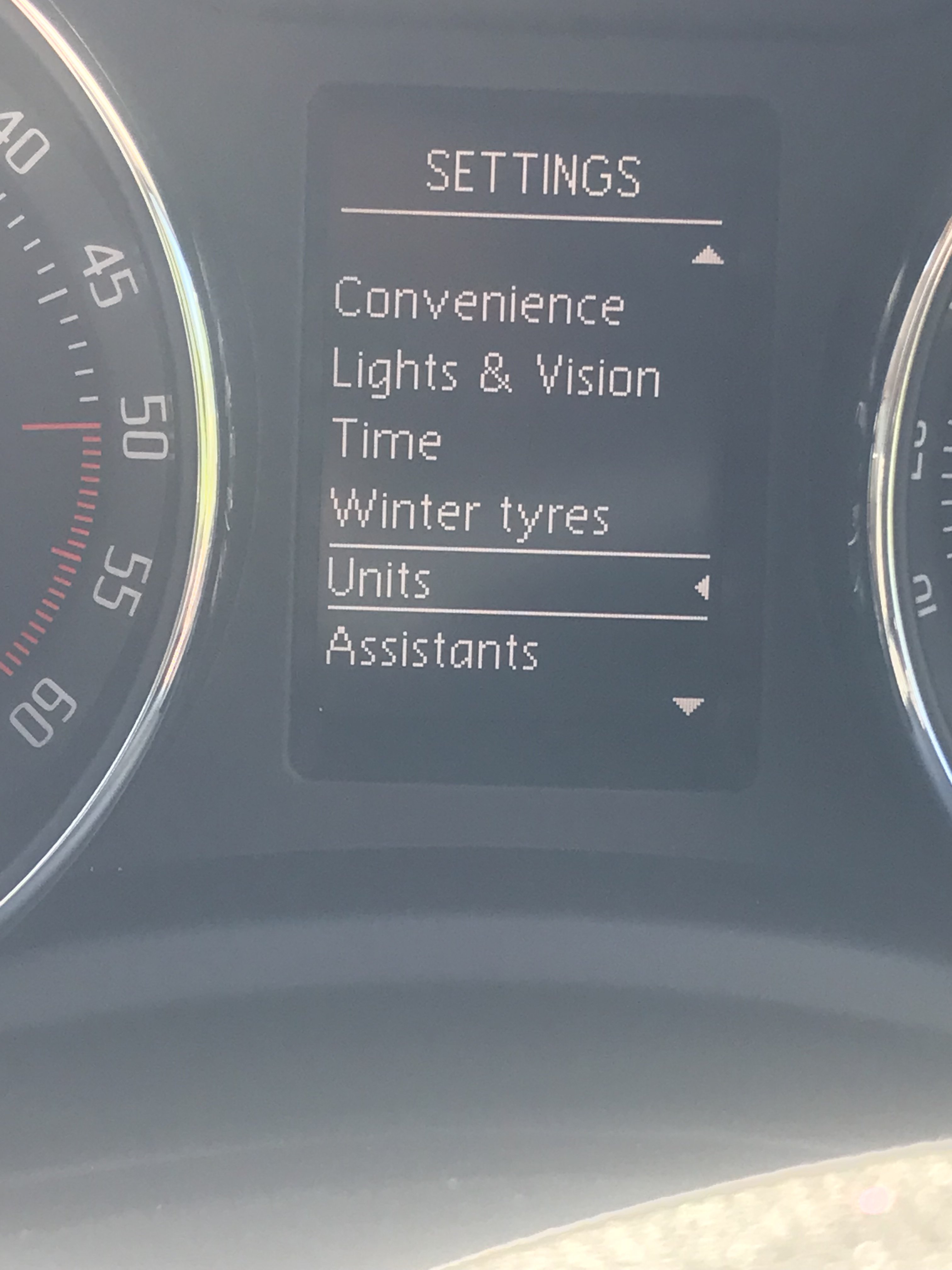

I confirmed today: Settings > Units.

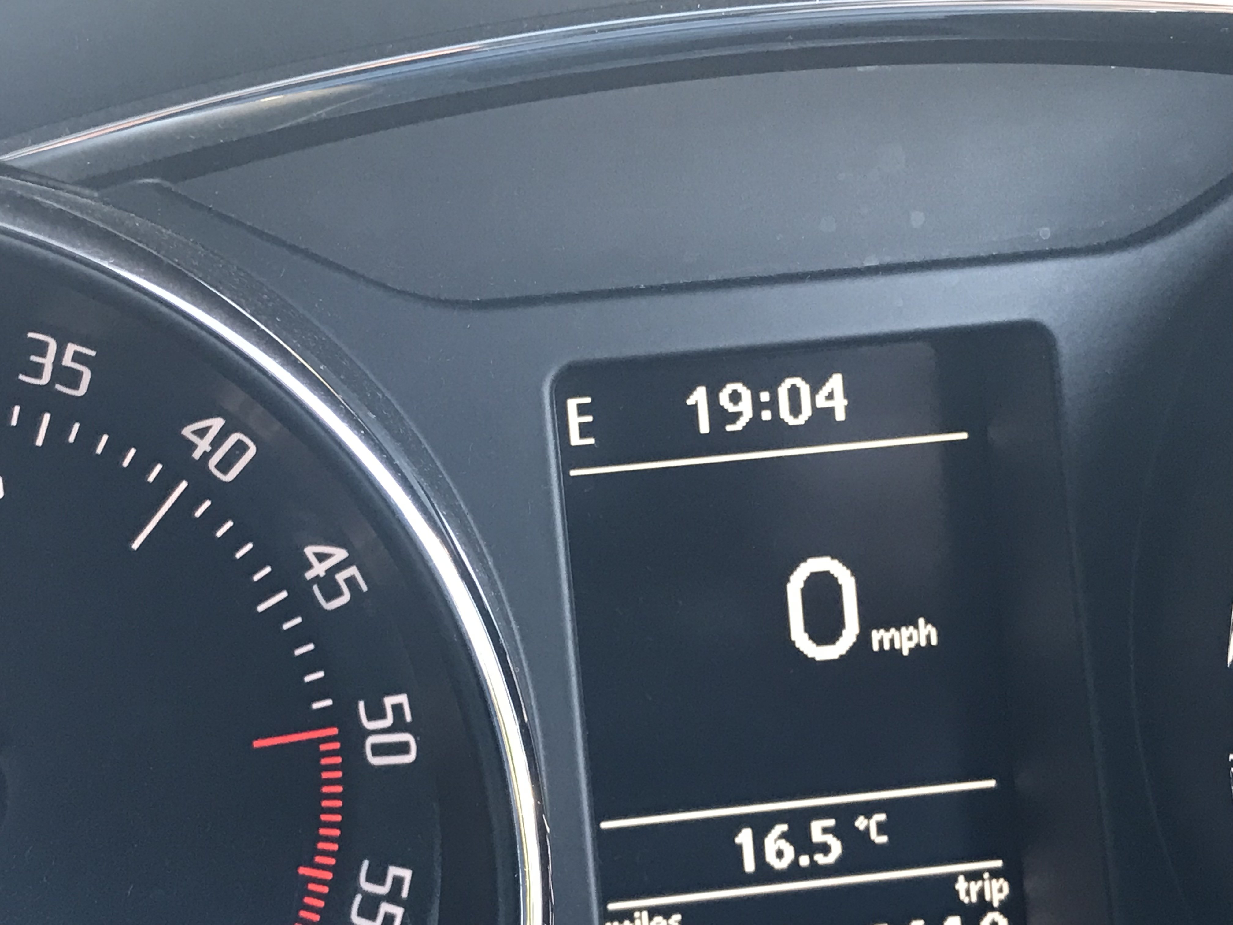

Hi I'm not sure if anyone is still interested in doing this but I've changed my display to large mph using carista it's cheap on Amazon and you get 1 month free membership it has a few different customisations and can read fault codes

I can confirm I did this on mine and it works. Just go into settings in DIS to change to MPH once coding set, you may also need to uncheck/check speed display in MFD list too.

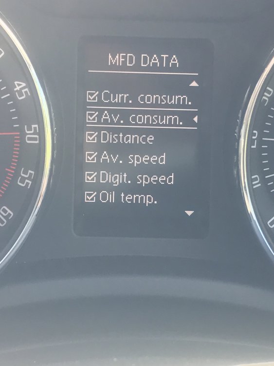

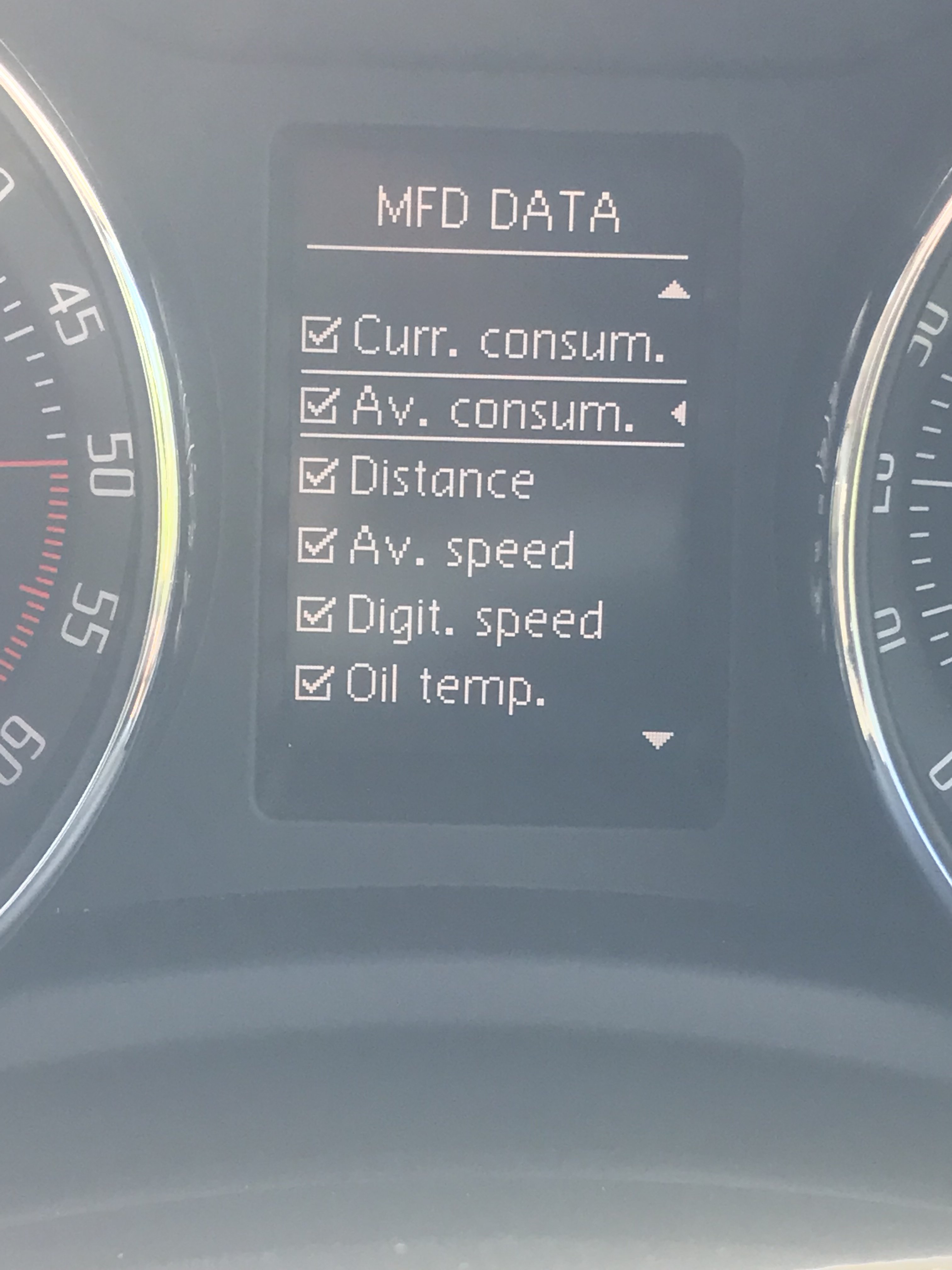

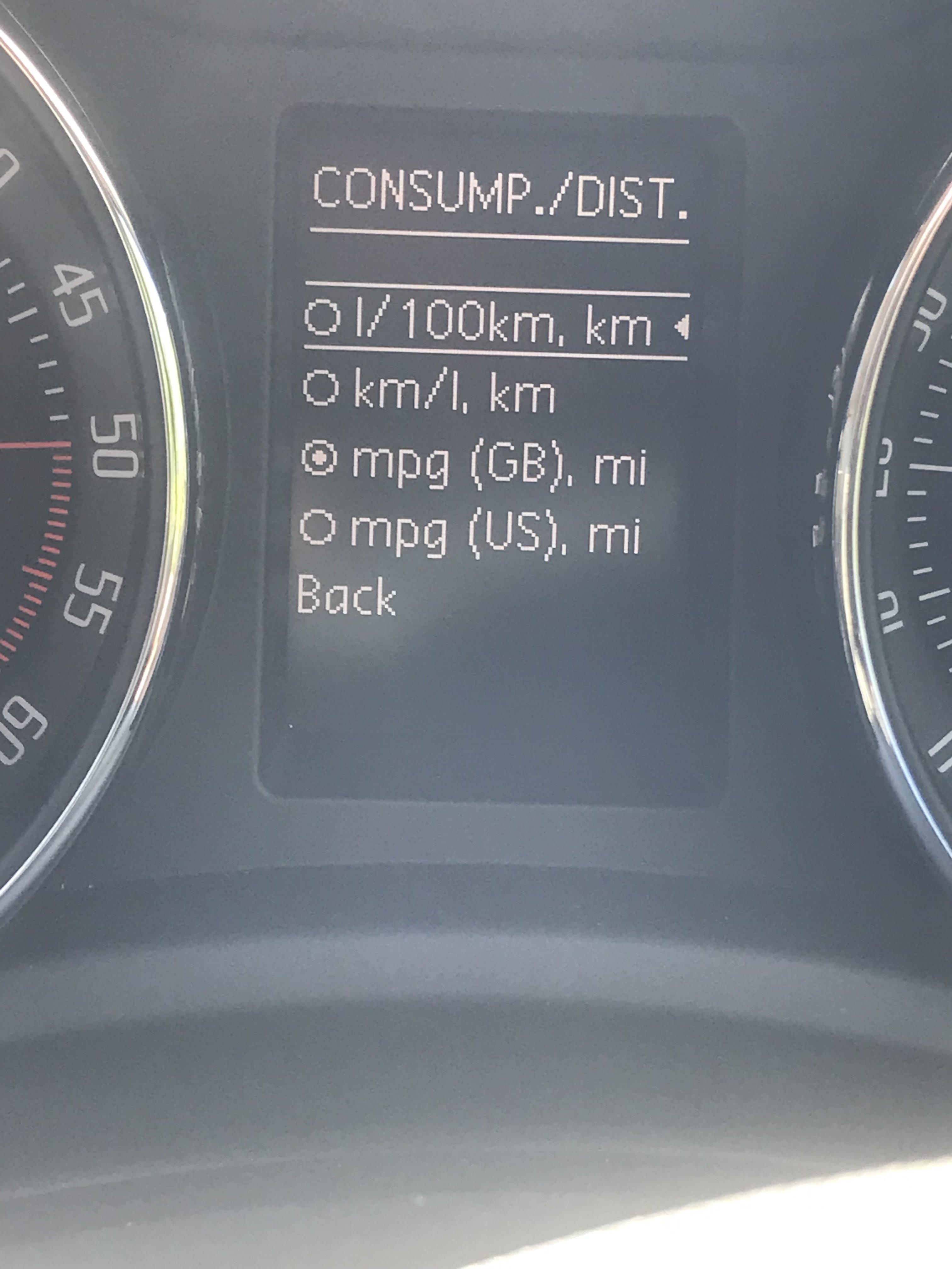

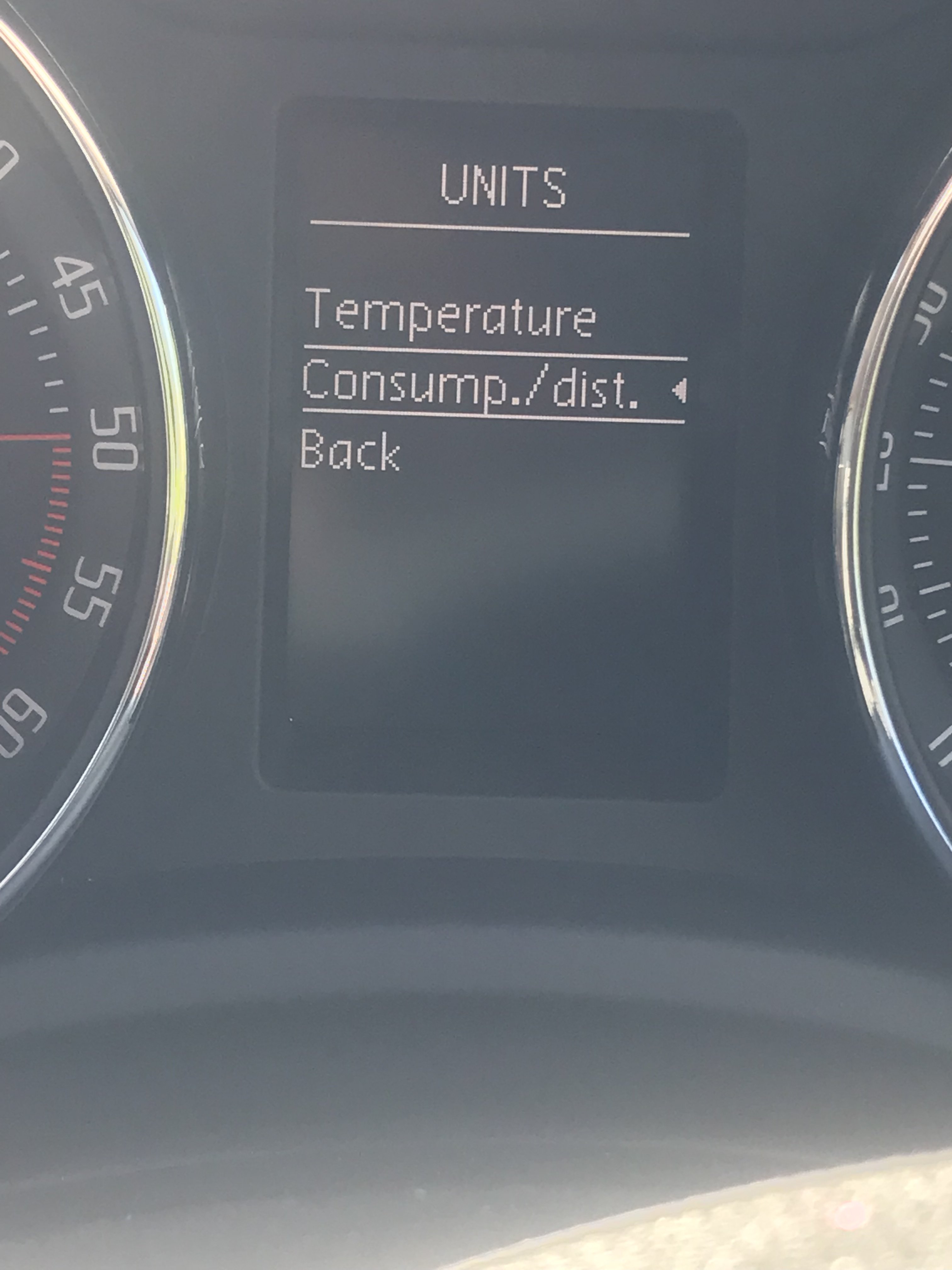

I changed the coding to rest of world then go into DIS settings then units then cons/dust and change from Kms to MPH
Also make sure to tick digital speedo which should show up after the coding change. You may need an ignition cycle to get it to populate the menu
