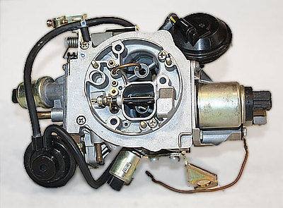

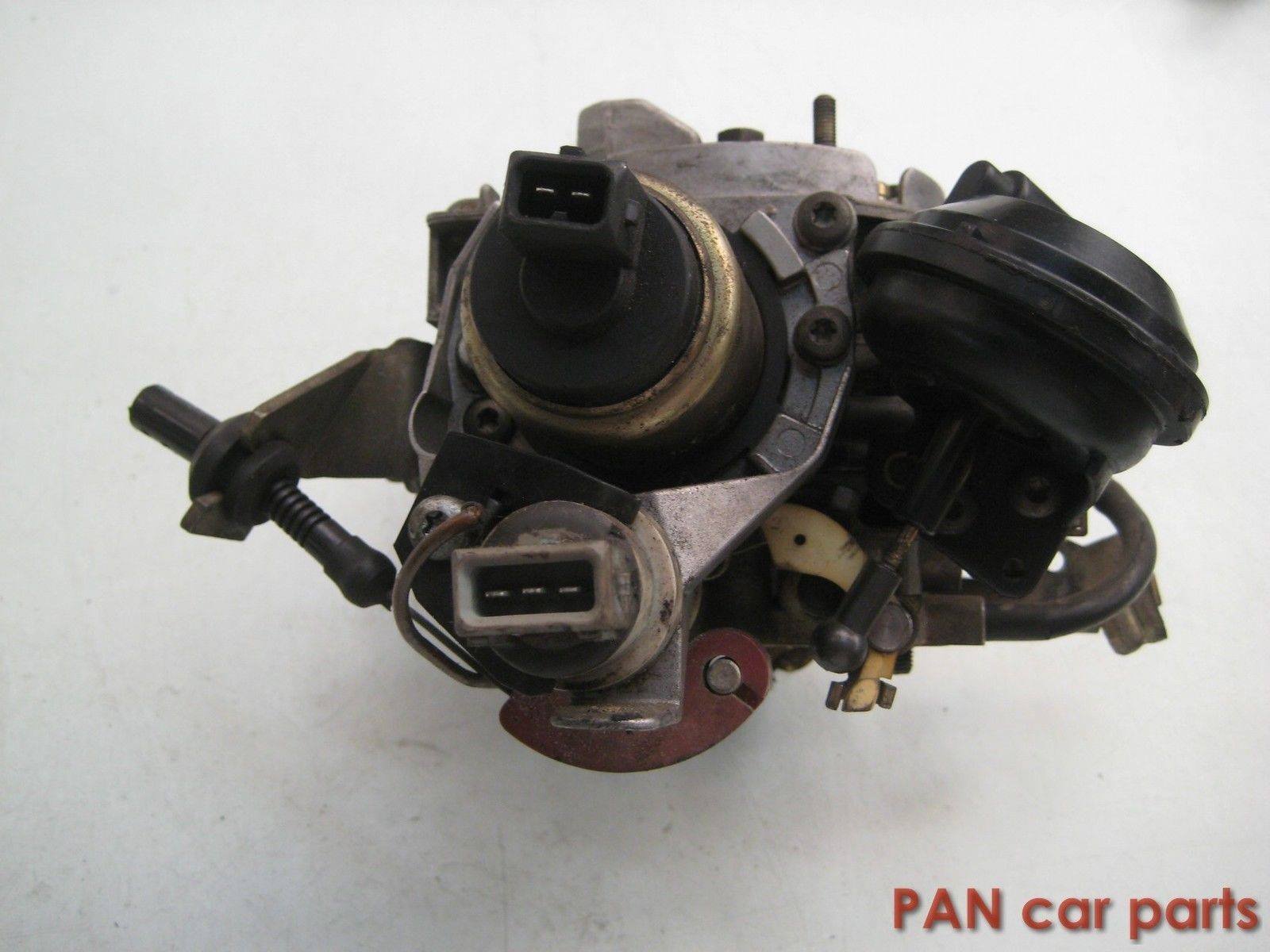

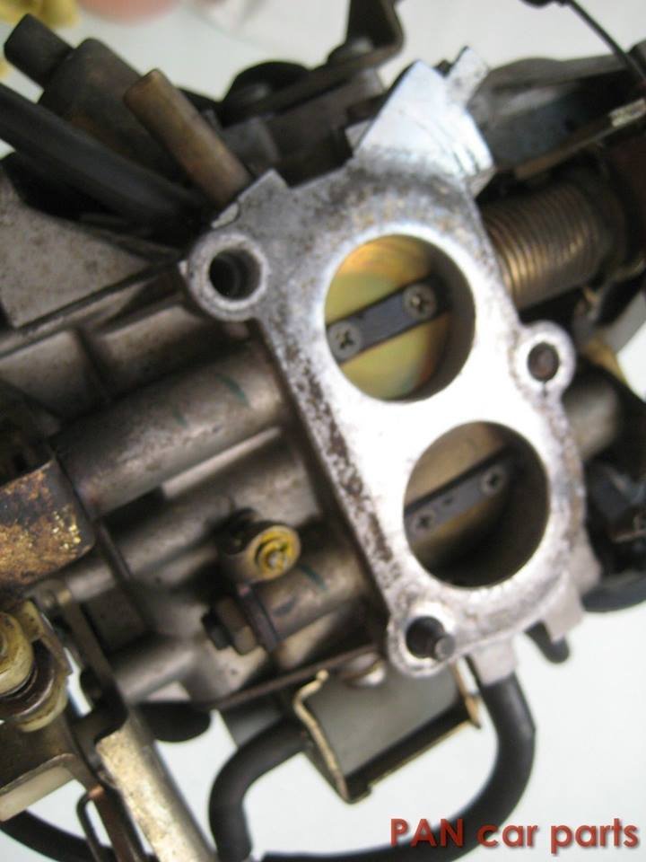

I have a scoda felicia model 1996 combi ,engine 135 with carburetor  I want to replace the carburetor with another one in the attached pictures and whichever one is performing better. Can anyone here help me?
Not from pictures no. What model numbers are both carbs, and do they have interchangable jets and chokes?
the new carb. no. 150616- 32 i think that no sure
  • Sponsor
Photos show a Pierburg 2EE, I think. Needs a bunch of wiring and a little ECU to control it.
Not sure how easy it would be as a retrofit.

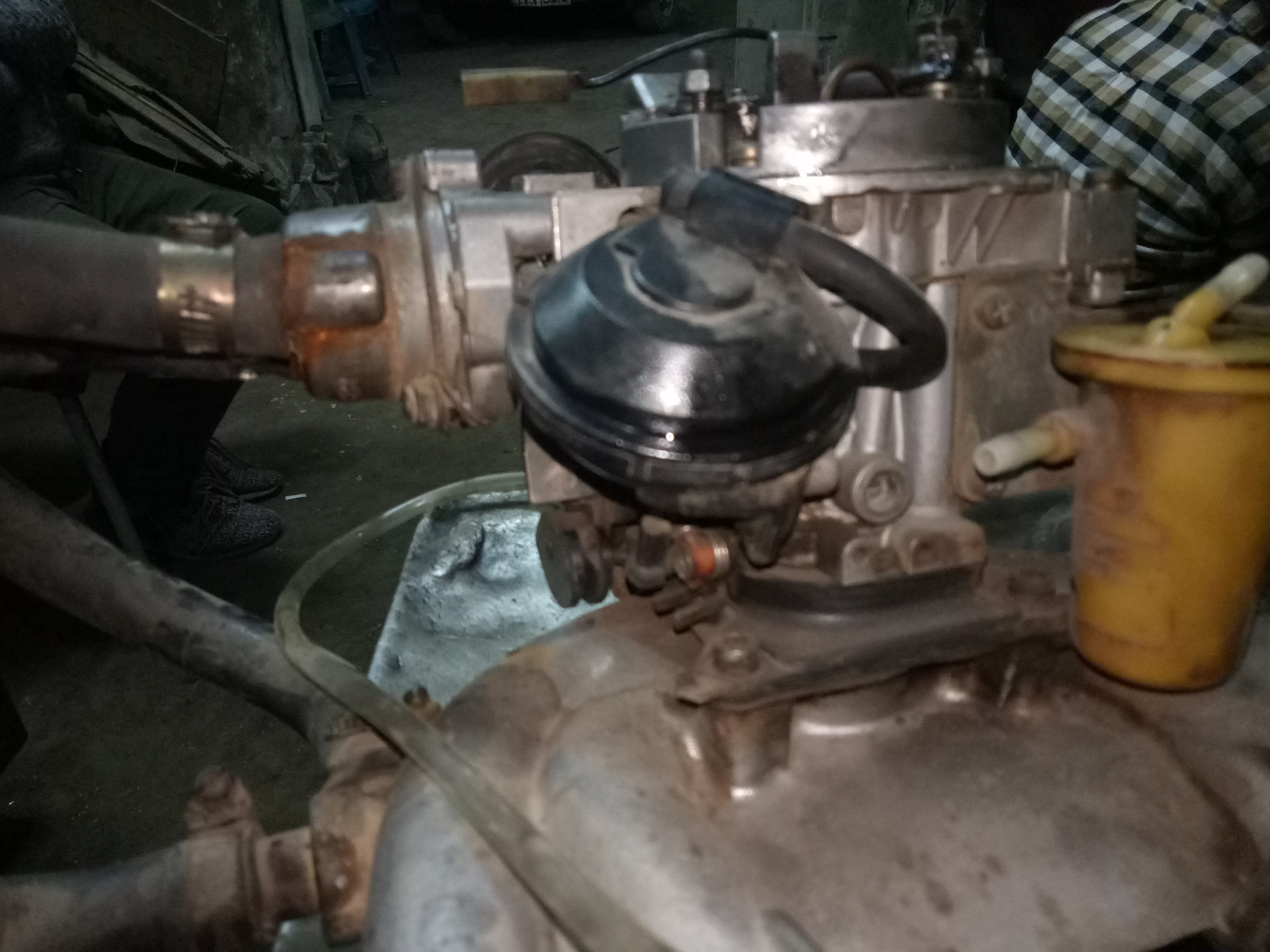

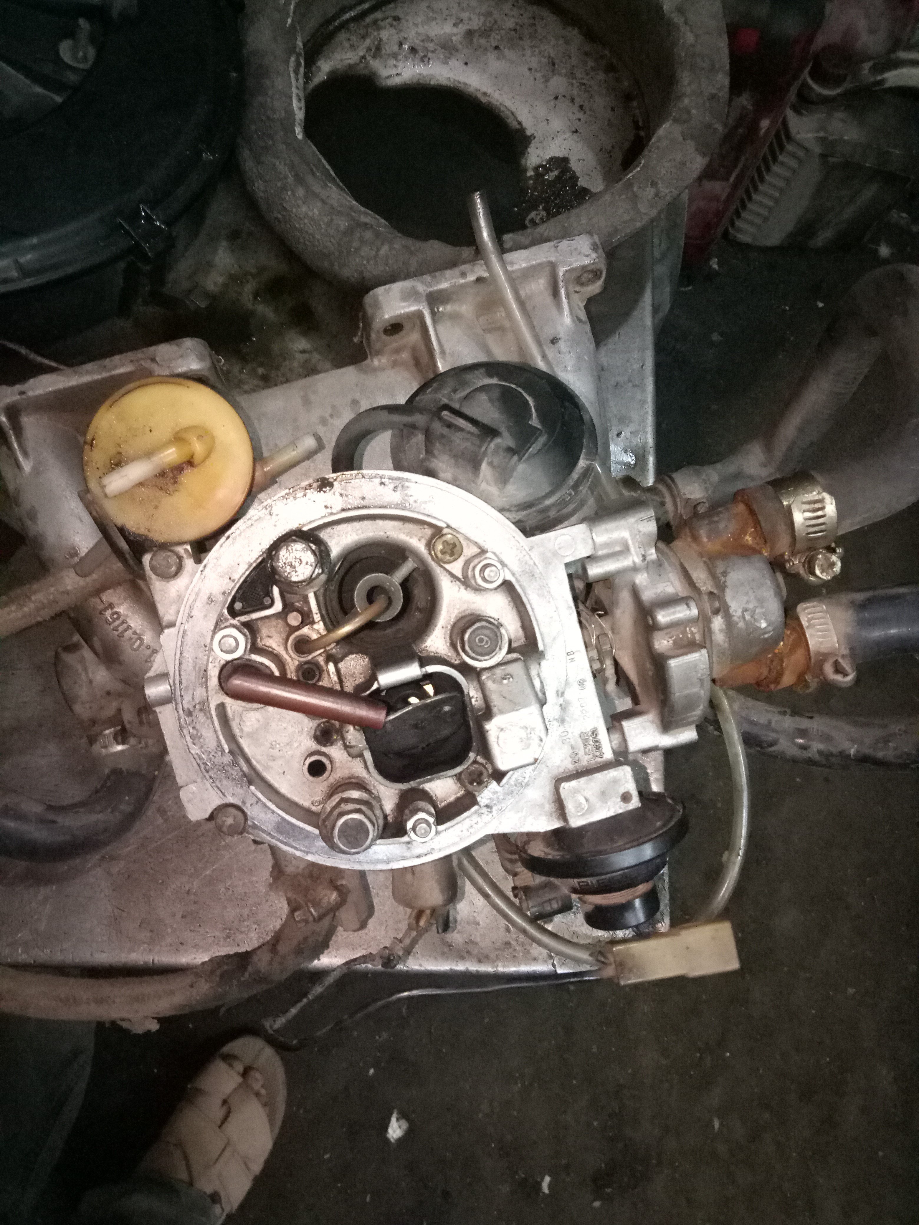

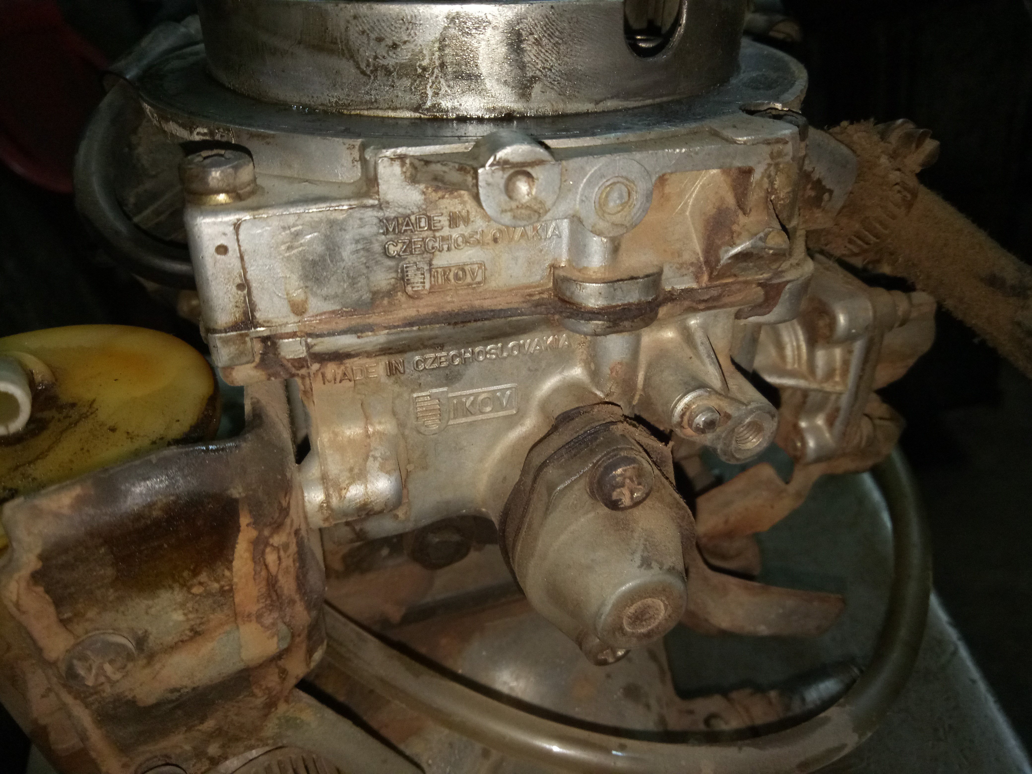

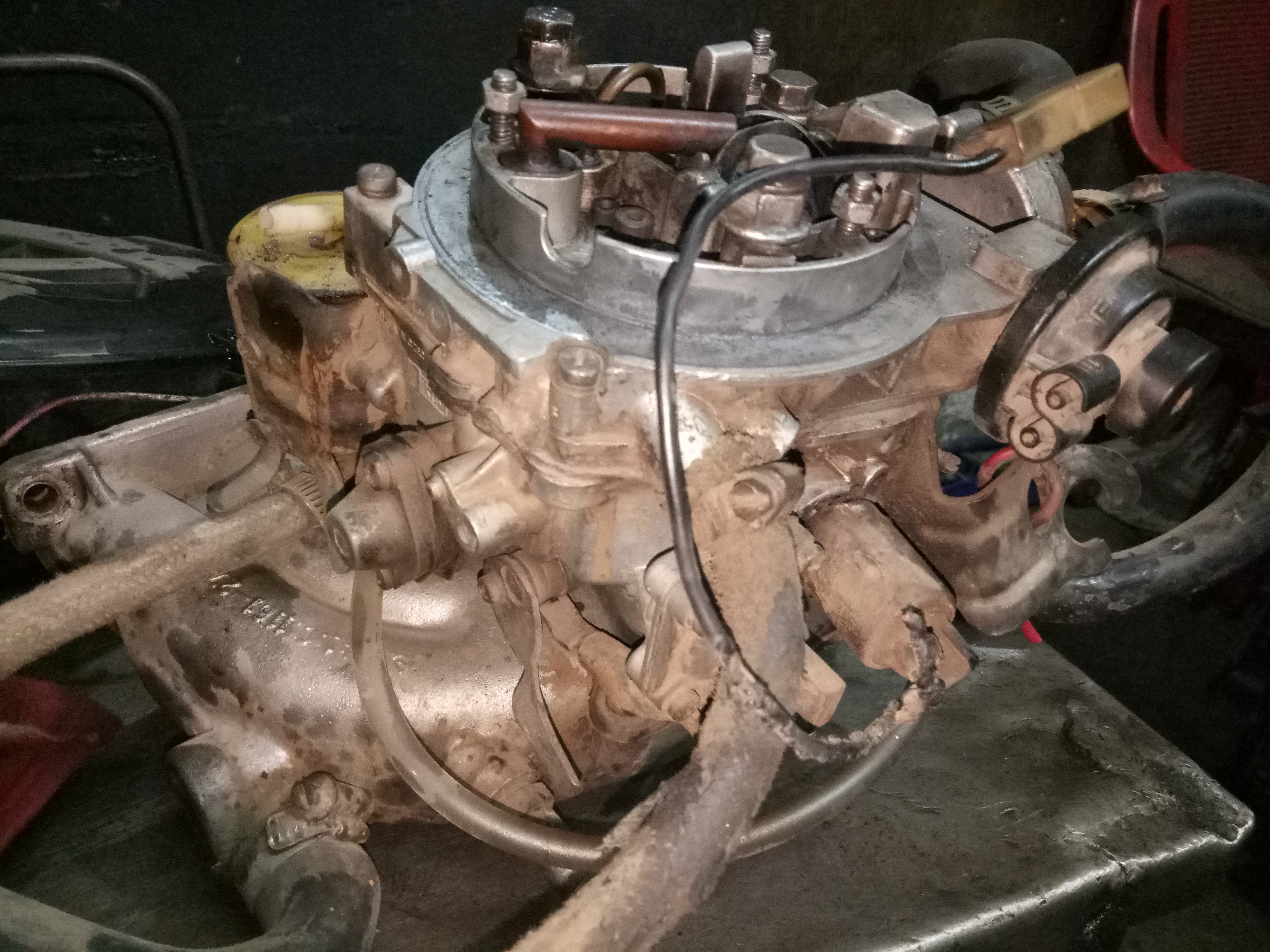

thanks for your interesting ,I will take a photos for my engine carburetor to see which  parts of it destroyed and haw to fix it
As you can see in the carburetor images, some parts are missing and the heater has been canceled365524483_IMG20181228181832(2).thumb.jpg.e1957375c21176956bfb1c3f1967f75f.jpg1195875205_IMG20181228181821(2).thumb.jpg.49d37b363da7f5daa1fe00237bbb297f.jpg1765418527_IMG20181228181721(2).thumb.jpg.7a76b8465ec330593950452b0ab68bf1.jpg202304451_IMG20181228181708(2).thumb.jpg.6d1547b418f9ba0c99626301937737df.jpg
( heater has been canceled )I mean the choke system not working
Not at all. The so called Thermo Time Valve that is missing works only at -10 degrees Celsius. I don't have it either and the engine starts well without it. I have plugged the hose that goes to it.
My advice is to disassemble it, clean it, and connect it as required.
Thanks I will try to maintain it .
